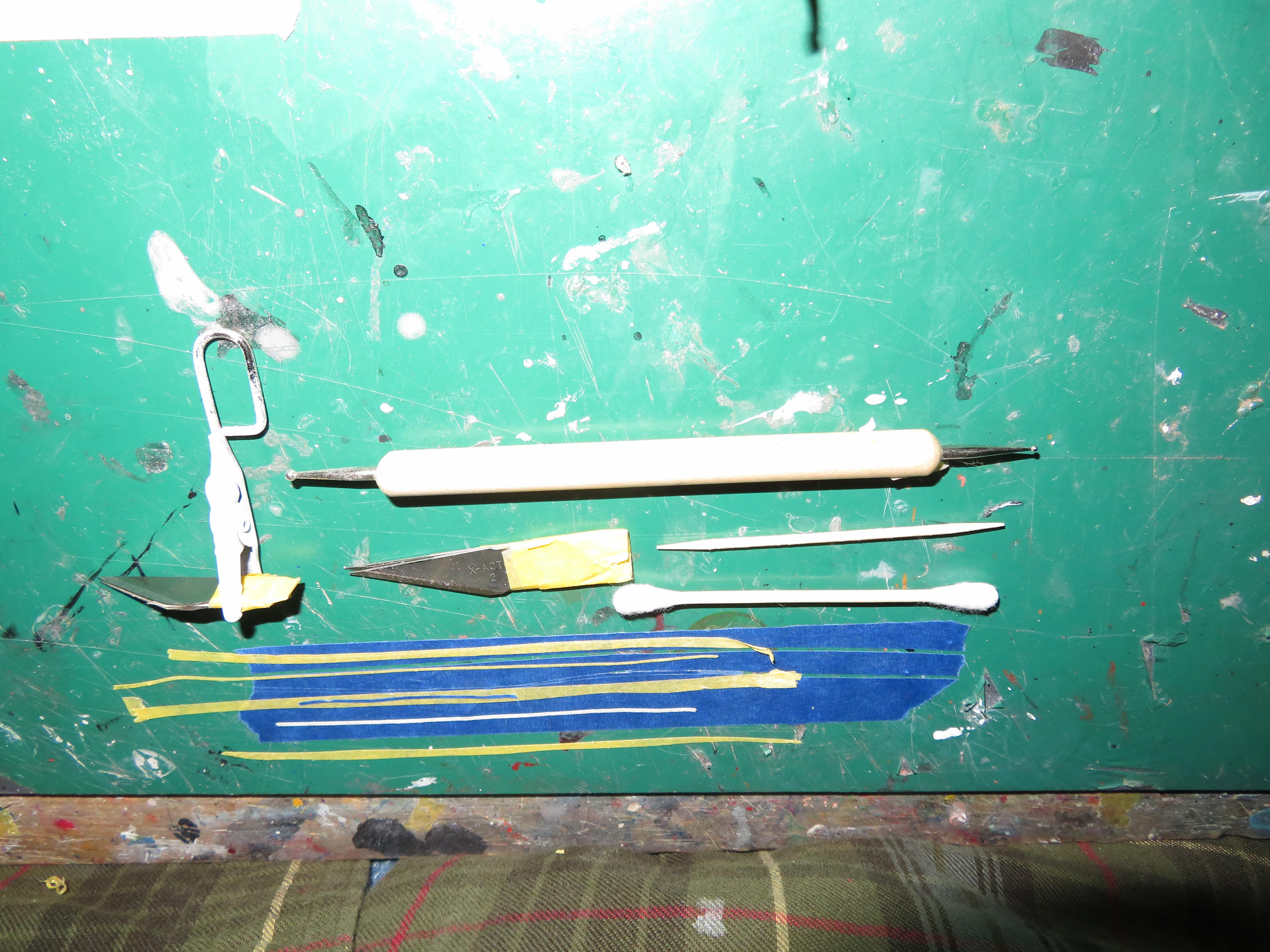

Mike 1017 Posted December 4, 2021 Posted December 4, 2021 I gave up on using BMF. Now I use masking tape and airbrush Molotov Chrome. Stick in my dehumidifier for a couple hours. Which makes the Molotov very hard and durable. I experimented using my dehumidifier because if it can dry Testors enamel paint it could certainly Molotov. It does work. Mike

Mike 1017 Posted December 5, 2021 Posted December 5, 2021 21 hours ago, TransAmMike said: Well Mike, masking and spraying the Molotow sounds good but, there are some curves and areas that would be hard to do (well at least for me). Also, what happens if you get a bit of bleed thru? I sure would hate to mess up a good paint job. I make very sure that the masking job is perfect as I can. I make sure that the tape is burnished . As for curves I tape 2 knifes blades together and cut out thin strips from the masking tape. Using them as a base line burnish then mask again following the curve. Also airbrushing the Molotov in thin layers reduces any chance of bleed thru.

SfanGoch Posted December 5, 2021 Posted December 5, 2021 5 hours ago, Mike 1017 said: As for curves I tape 2 knifes blades together and cut out thin strips from the masking tape. Using them as a base line burnish then mask again following the curve. Why don't you just get an Excel Dual Strip Cutter? It doesn't look like you're getting any uniformity in width using that contraption.
Sandboarder Posted December 6, 2021 Posted December 6, 2021 4 hours ago, SfanGoch said: Why don't you just get an Excel Dual Strip Cutter? It doesn't look like you're getting any uniformity in width using that contraption. I haven’t seen that before. What is the minimum width?? I believe 2 blades taped together is 1mm

Mike 1017 Posted December 8, 2021 Posted December 8, 2021 On 12/5/2021 at 5:09 PM, SfanGoch said: Just ordered this contraption from Amazon .Thanks Mike t j
