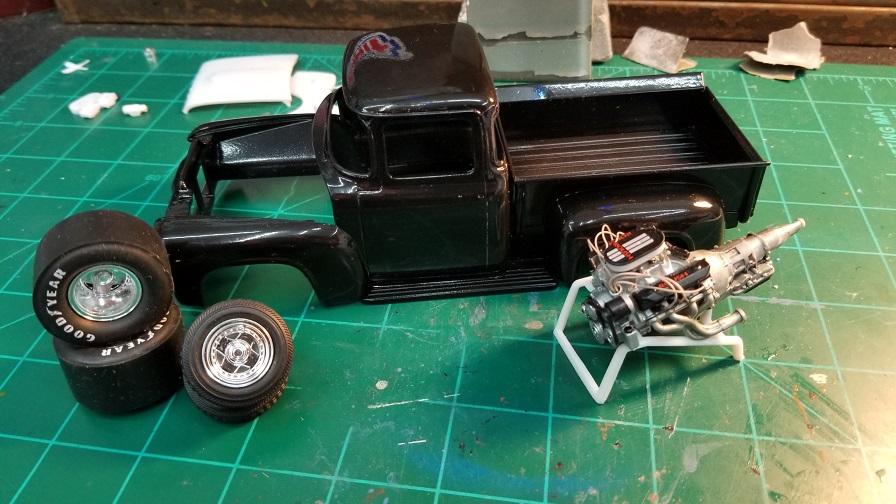

Zippi Posted December 10, 2021 Posted December 10, 2021 (edited) Ok fella's....I've been wanting to try my hand at tubbing something out for a while and I think I found my Huckleberry. Doesn't look like I'll have to cut into the chassis which is great for my first time. I'm thinking it's just going to require cutting into the wheel well and into the bed and then making some tubes for the bed. Once I get everything cut and modified I'll be stripping the body. Not sure on a color as it's just to early in the game. The one pic shows the look I'll be going for except the rear wheels will be tucked in the fenders.....hopefully. Maybe a straight axles under the front and make a Gasser.....just thinking out loud. This will be a VERY slow process fells's. All input and comment's are welcome. Edited December 10, 2021 by Zippi 3

Zippi Posted December 11, 2021 Author Posted December 11, 2021 I went out into the garage this morning to take the trash out and I had to do a little cutting. So....I pulled out the Dremel with the 1 1/2" cutoff wheel and the sanding drum. I made some rough cuts and it's looking like what I was wanting. Still need to clean up the cuts but I'm getting excited about this now. 4

espo Posted December 11, 2021 Posted December 11, 2021 I was going to suggest widening the rear fenders, but a little late for that. The rear wheel tubs into the bed you might see if you have any old prescription plastic bottles around, they can be cut to length and make perfect wheel tubs.
Zippi Posted December 11, 2021 Author Posted December 11, 2021 4 minutes ago, espo said: I was going to suggest widening the rear fenders, but a little late for that. The rear wheel tubs into the bed you might see if you have any old prescription plastic bottles around, they can be cut to length and make perfect wheel tubs. That's what I was thinking about Dave. I saw some pics of the pill bottleS used as tubes but can't remember where I saw it.
espo Posted December 11, 2021 Posted December 11, 2021 6 minutes ago, Zippi said: That's what I was thinking about Dave. I saw some pics of the pill bottleS used as tubes but can't remember where I saw it. They come in several diameters and even an Asprin bottle can be used depending on what will fit your tires. I just cut them in half length wise and the bottom serves as the inner splash panel. You should have plenty of width to work with and just cut to fit. They do seem to require a little extra primer before they will hold paint like the rest of your kits body, but this can depend on the type of plastic in the pill bottle.
Zippi Posted December 11, 2021 Author Posted December 11, 2021 2 minutes ago, espo said: They come in several diameters and even an Asprin bottle can be used depending on what will fit your tires. I just cut them in half length wise and the bottom serves as the inner splash panel. You should have plenty of width to work with and just cut to fit. They do seem to require a little extra primer before they will hold paint like the rest of your kits body, but this can depend on the type of plastic in the pill bottle. Thanks for the info Dave. I found a couple pics I saved some time back. Just thought it was a neat idea not knowing I would be doing it myself. 1

Steve H Posted December 11, 2021 Posted December 11, 2021 Bob !!! That second mock up photo is killer. Love that you diving in to this. You’re on the right track with pill bottles for inner tubs. Plastic lids from other household, (or your wife’s makeup?) products could be a source too. One of the tips I learned somewhere on this forum that I would recommend… For gluing the tubs, use a mixture of CA glue, and styrene cement. This gives you some working time to get things lined up, then creates an extremely strong bond. I use this often in my builds. I am definitely watching this one. Have fun with it. You’ve got me fired up!! Cheers, Steve
Zippi Posted December 11, 2021 Author Posted December 11, 2021 (edited) Thanks Mark & Steve. I found one empty pill bottle so I'll have to wait for another. I checked and it's just the right size. Edited December 12, 2021 by Zippi 1
