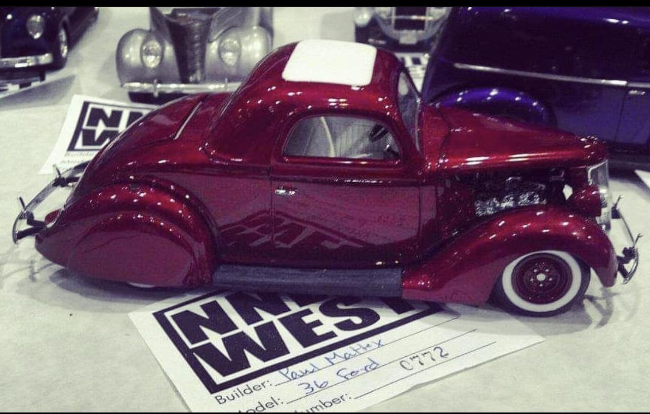

No problem RR. I have another ‘36 in my stash that I have been wanting to get at. I found this pic on the net and was hoping to do something along these lines. Your build got me into googling stuff and I came across that fellows build. I hope you don’t mind me following your build and gleaning a few tips…or maybe a lot!?

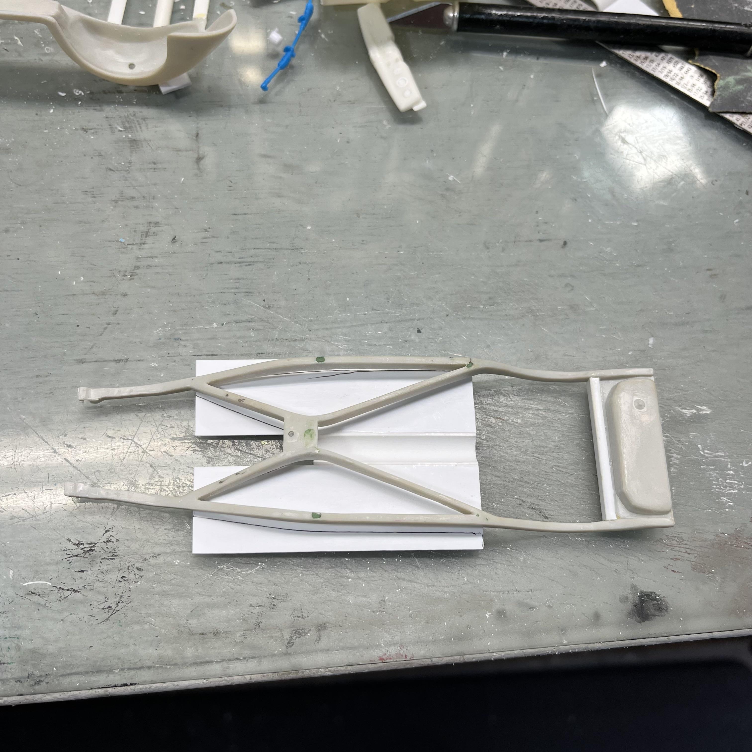

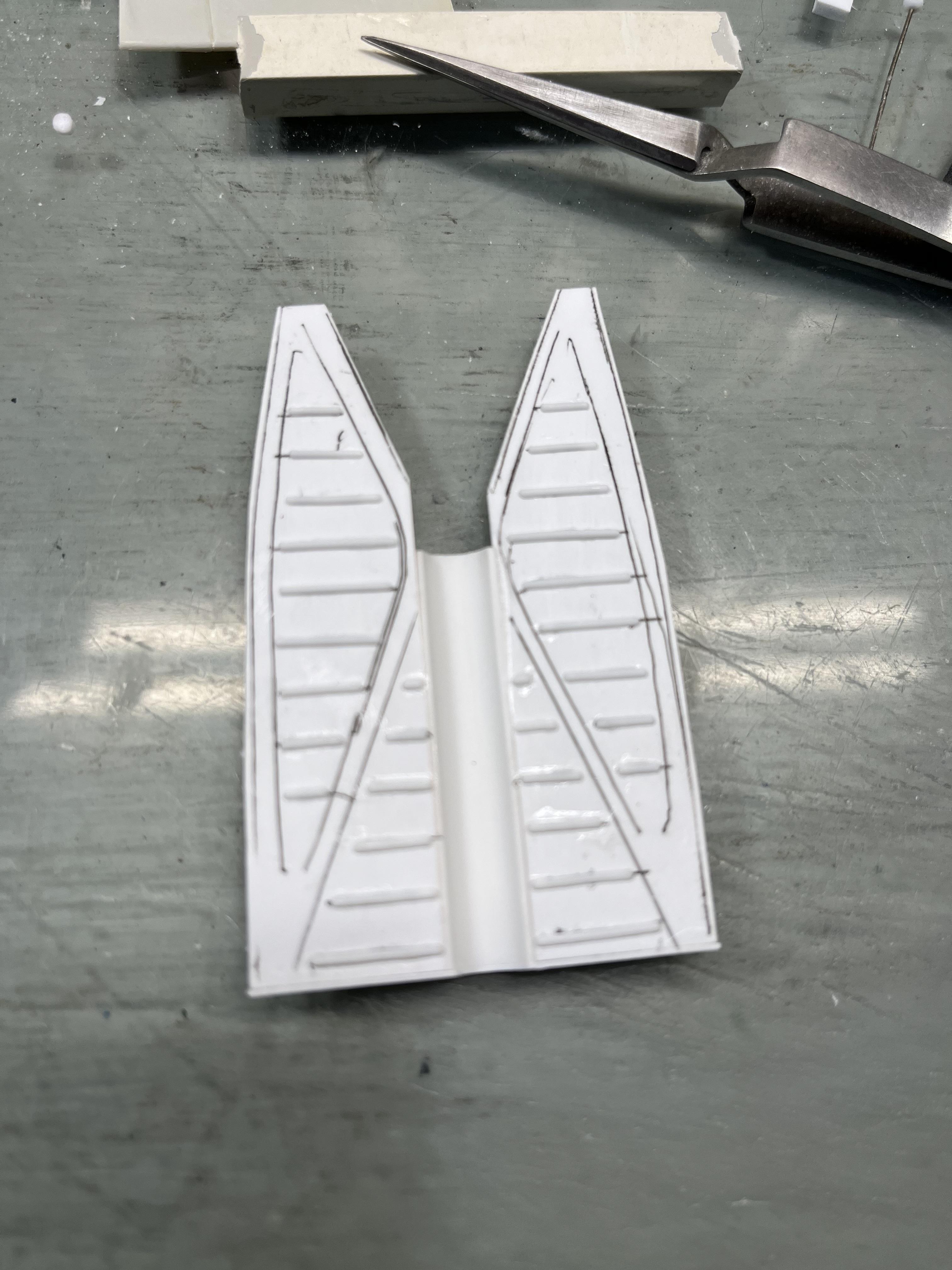

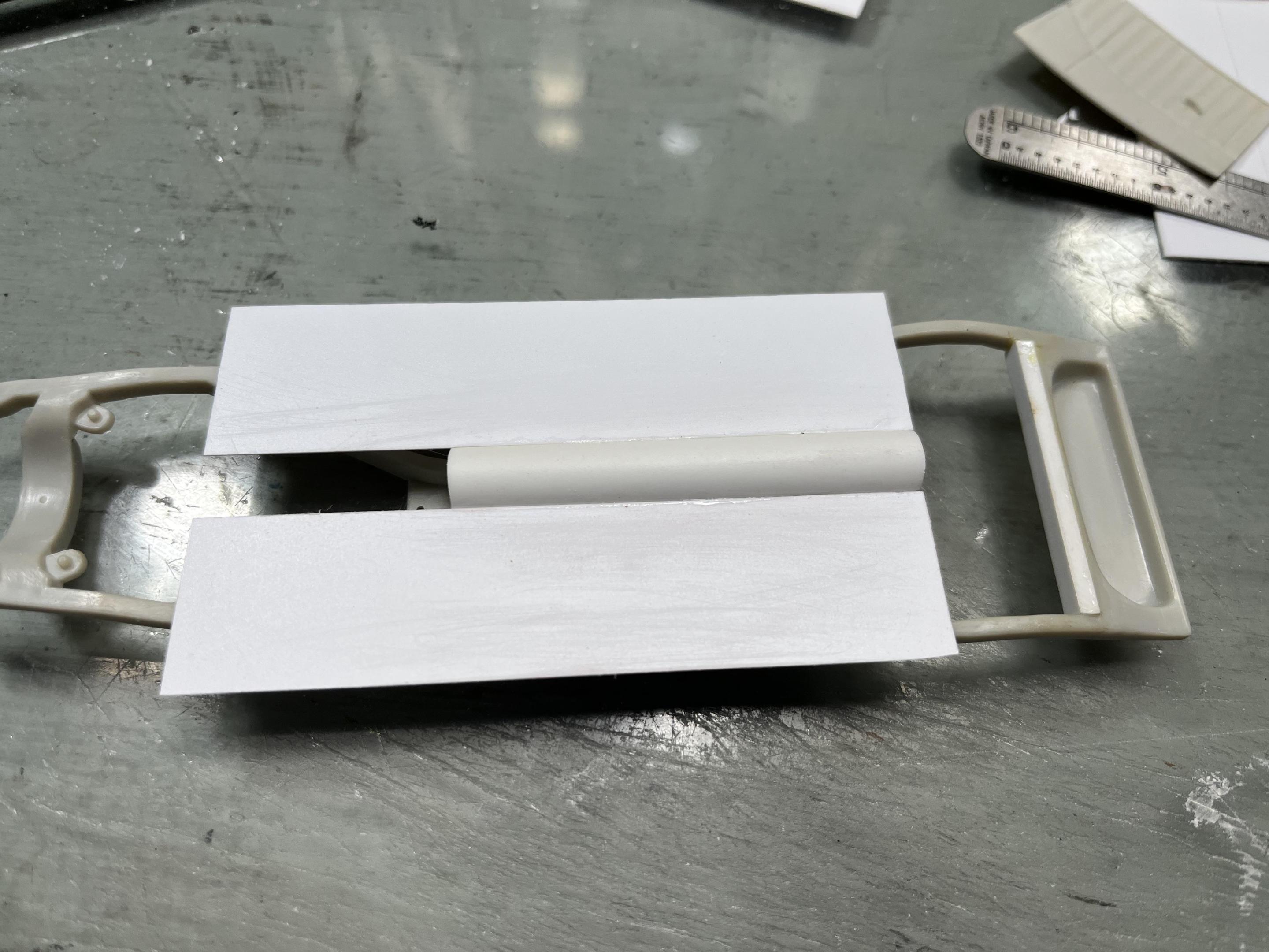

Today's installment concerns replacing the floorpan that was cut of the frame.

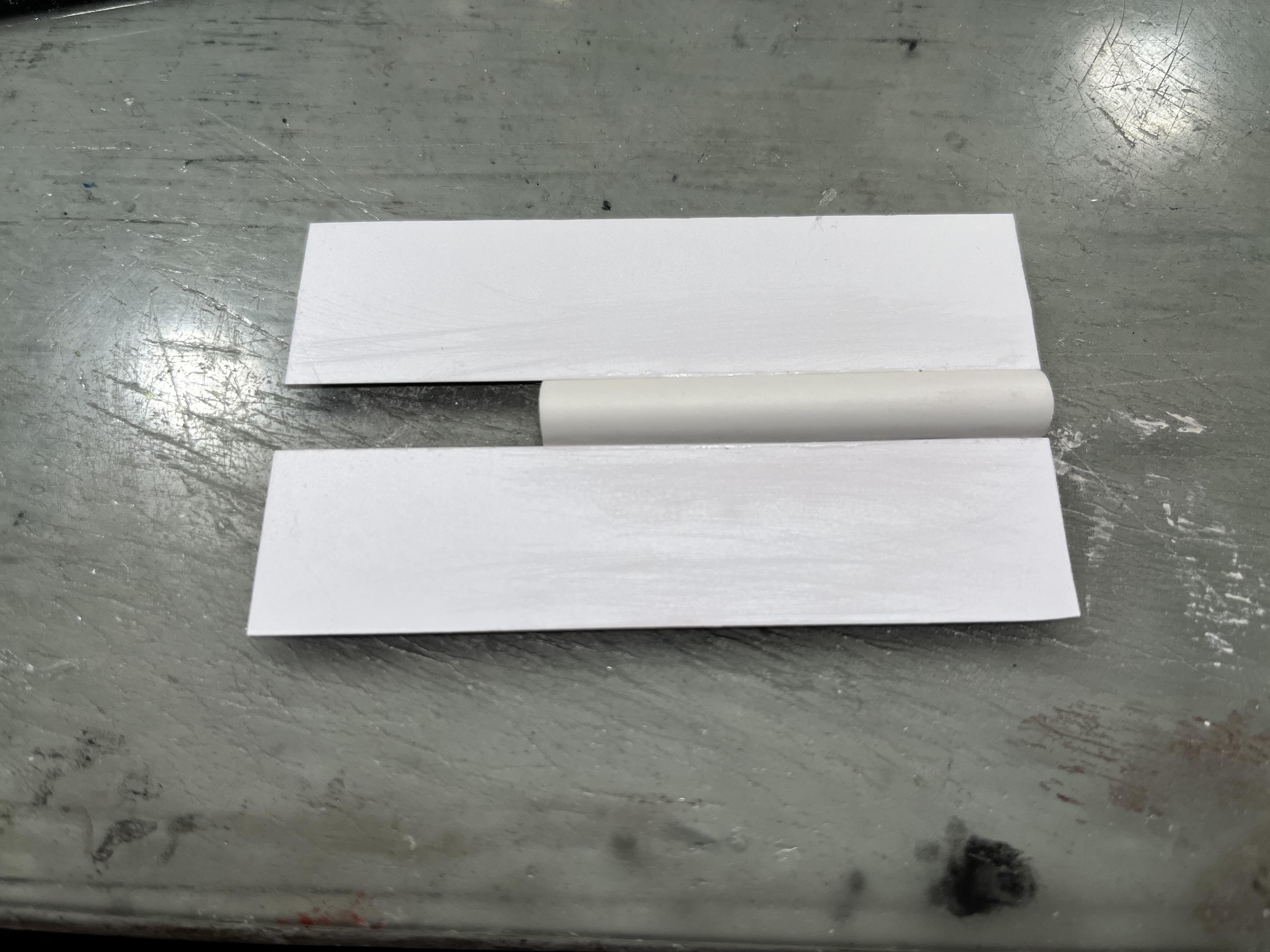

Starting with a piece of .02" Evergreen sheet and a slice of tube for the driveshaft tunnel...

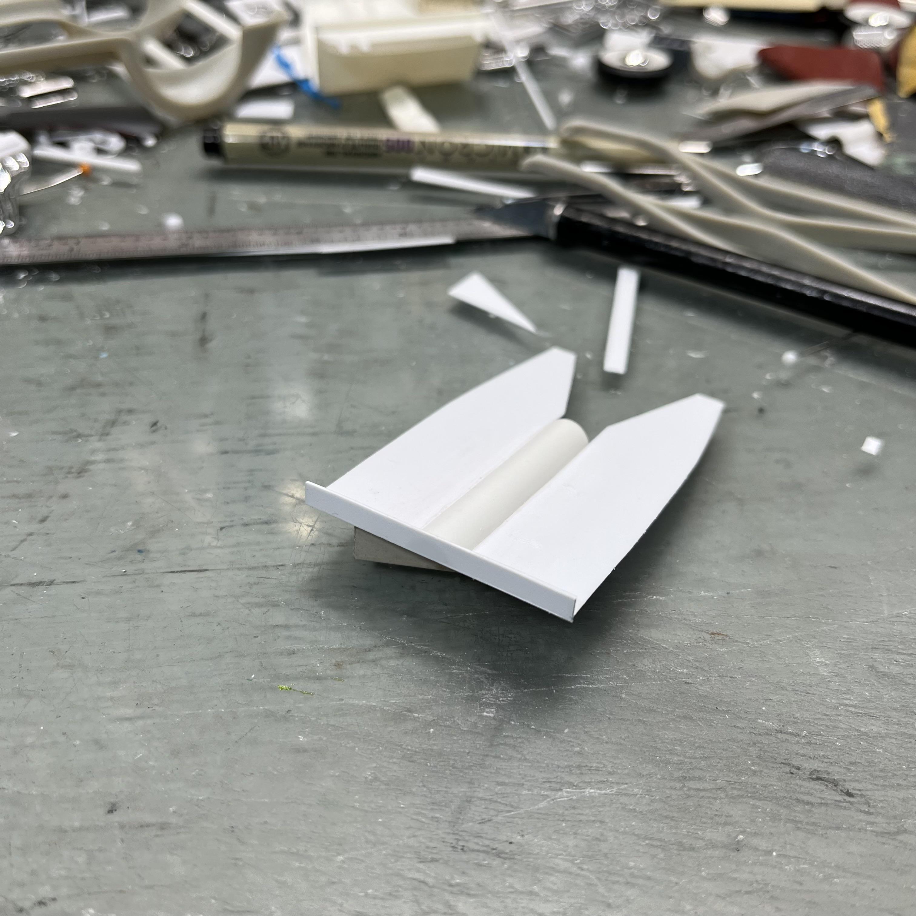

Cut two pieces of the sheet plastic and slightly bevel the edges and then glue each piece to a side of the tube...

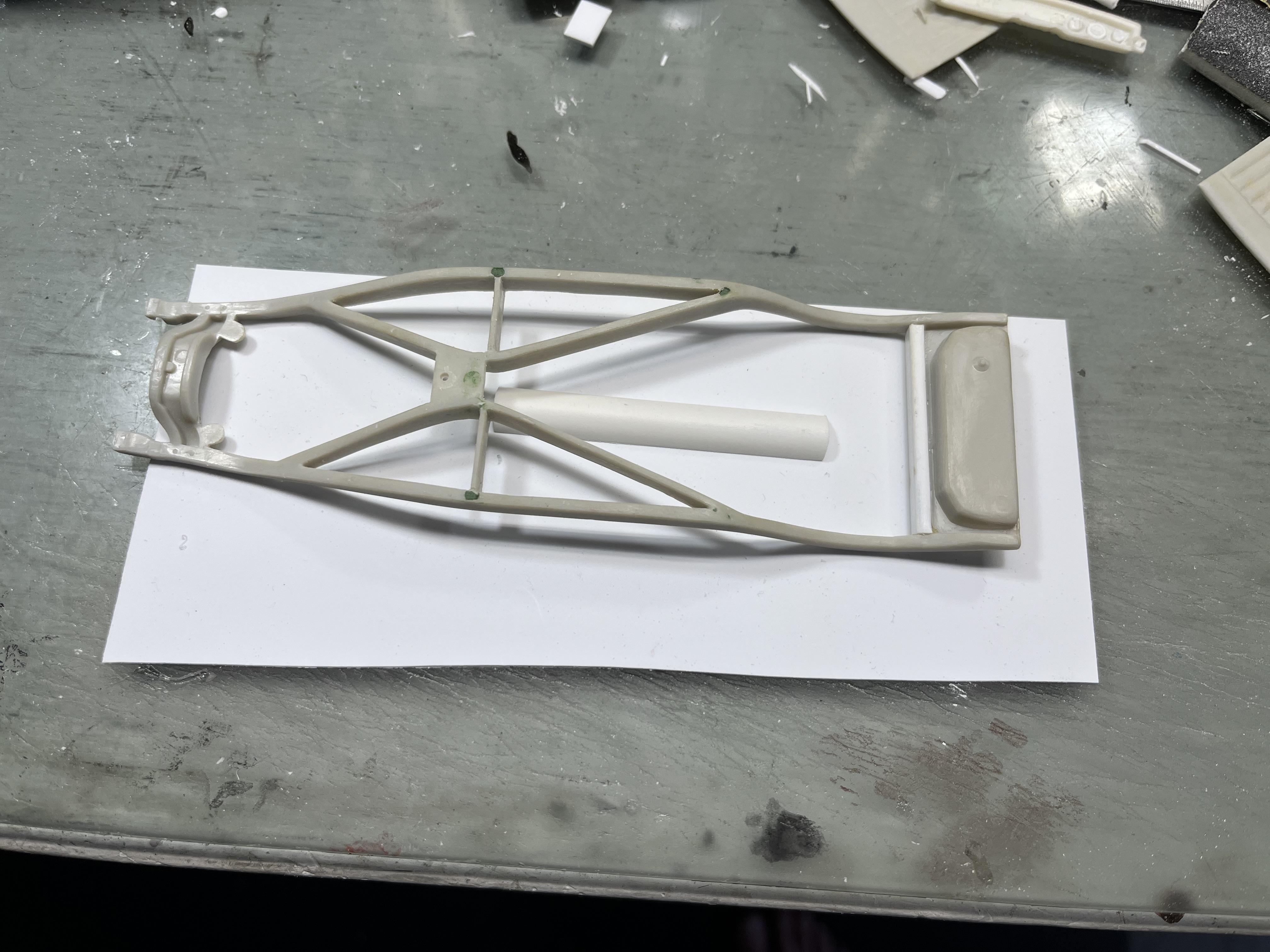

It will sit on the frame like this...

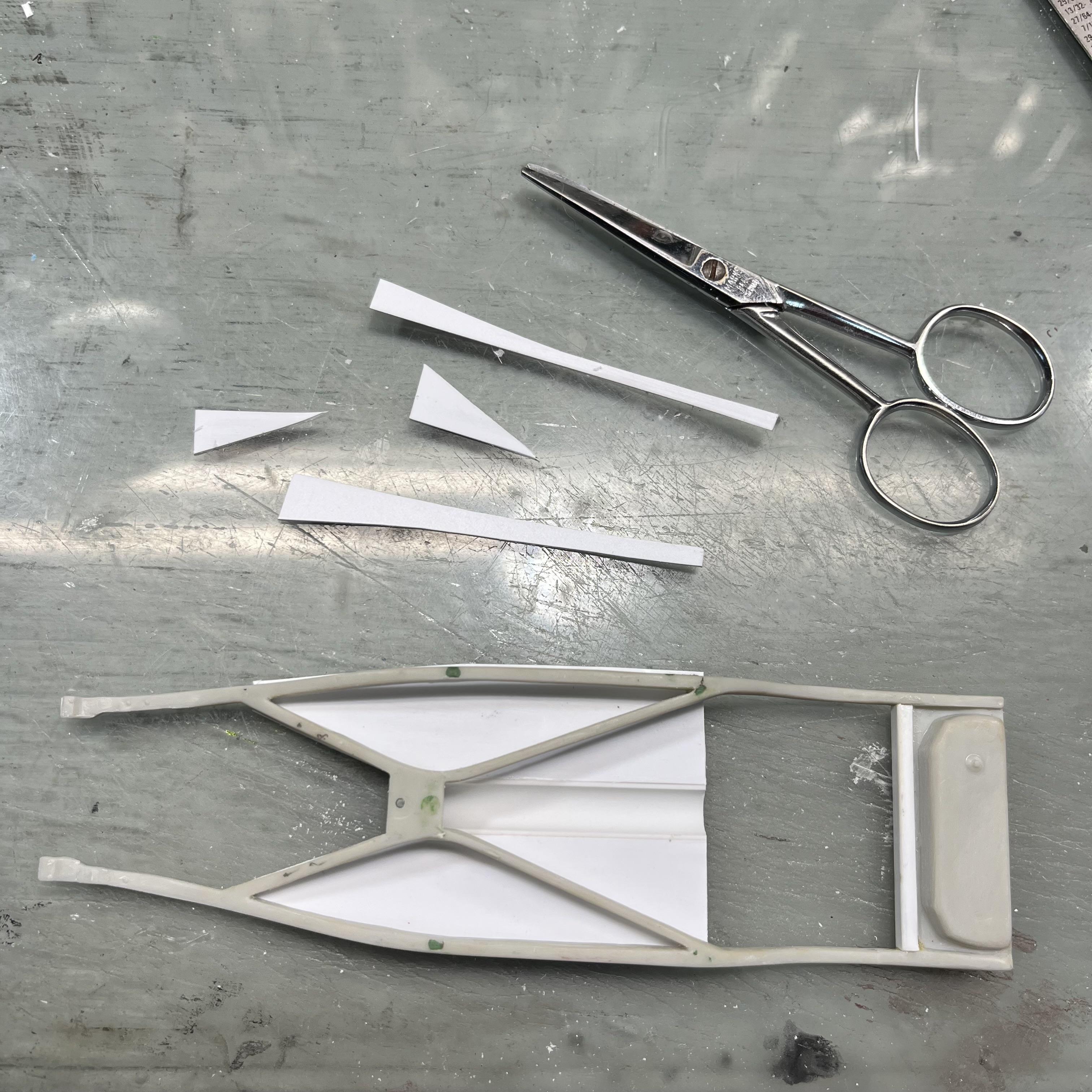

Viewed from underneath like this. Mark the frame and crossmember edges with a pen...somewhere along the way, the front xmember was cut out...
Cut the edges off, leaving a bit of extra...as Kit Karson famously says "Leave the edge when cutting". It will be trimmed to fit later... The plastic is thin enough to cut it with scissors...
I added a small piece across the back to give it some strength. The section where the tube goes across has since been cut away...

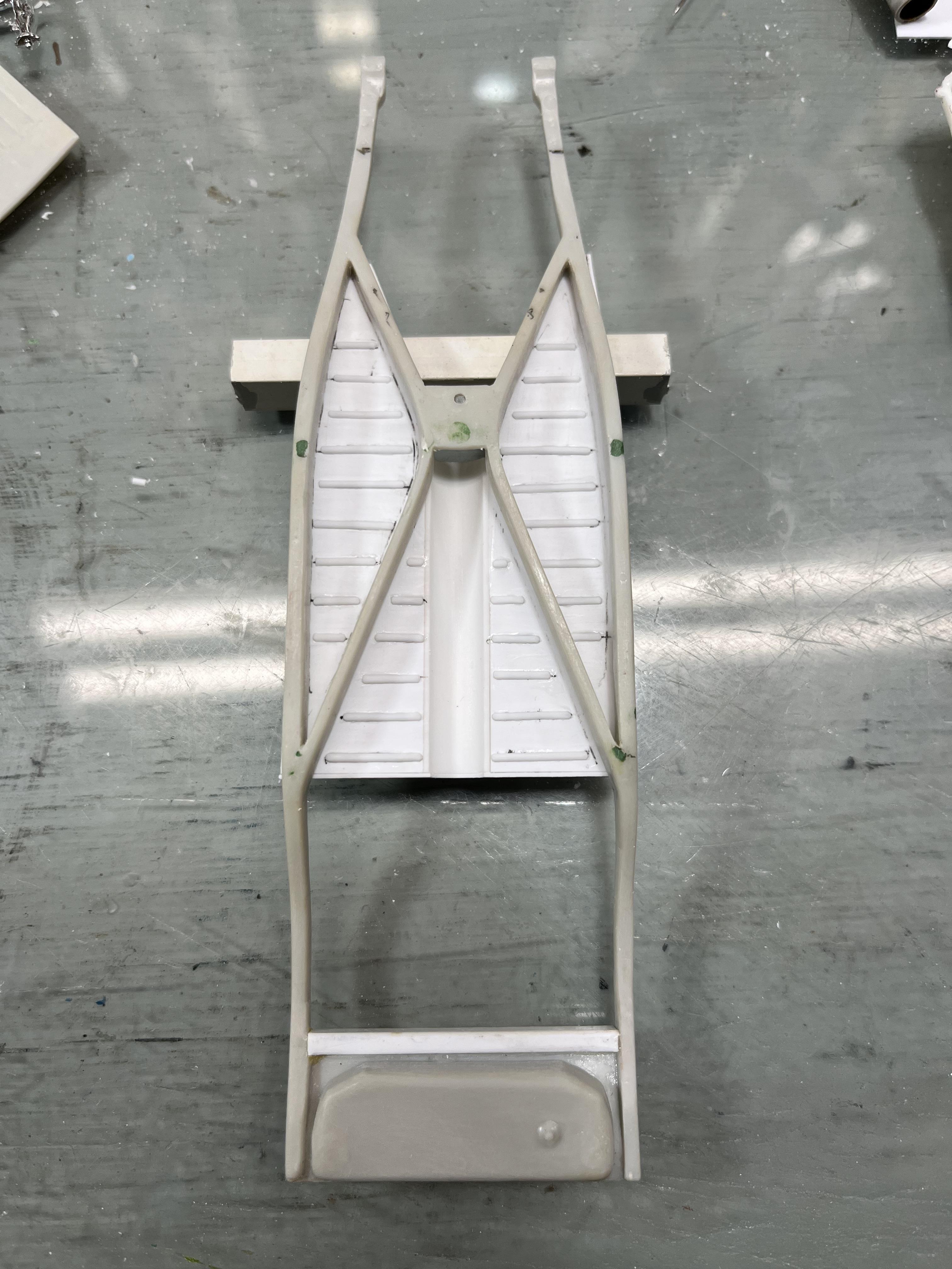

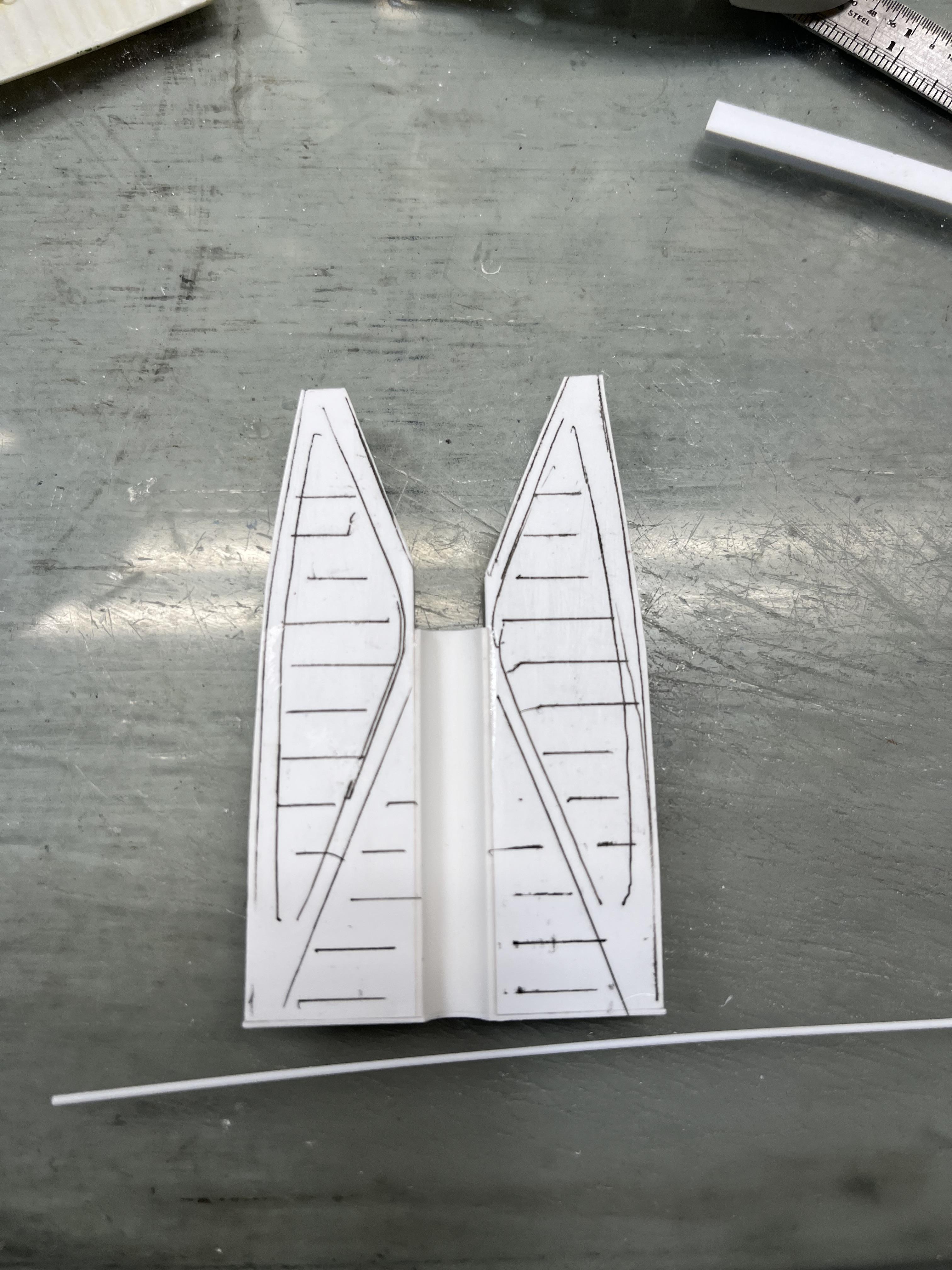

The next step is to replace the ribs on the pan that would have originally made by an English Wheel https://en.wikipedia.org/wiki/English_wheel or a bead roller to give the pan some strength and not buckle under weight. In our scale world this is done by cutting strips of .04" Evergreen half round. I scribed where the frame and crossmember areas go under the pan and then marked off where the ribs will go, I used a piece of rectangle as a guide rather than having to measure...
I cut the half round pieces to size, sanded the edges to round them off and glued them on...kinda tedious...

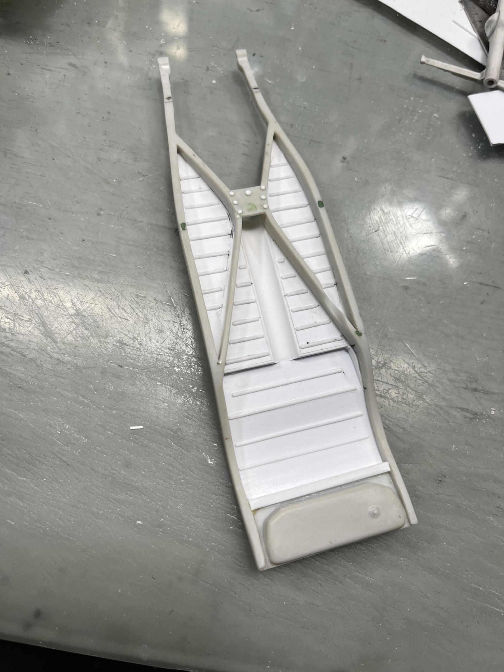

I sanded the whole thing down to remove some of the gloo..it will fit like this. A lot of work for an area that will hardly be seen....next up is the finish the rest of the pan over the back end of the frame...

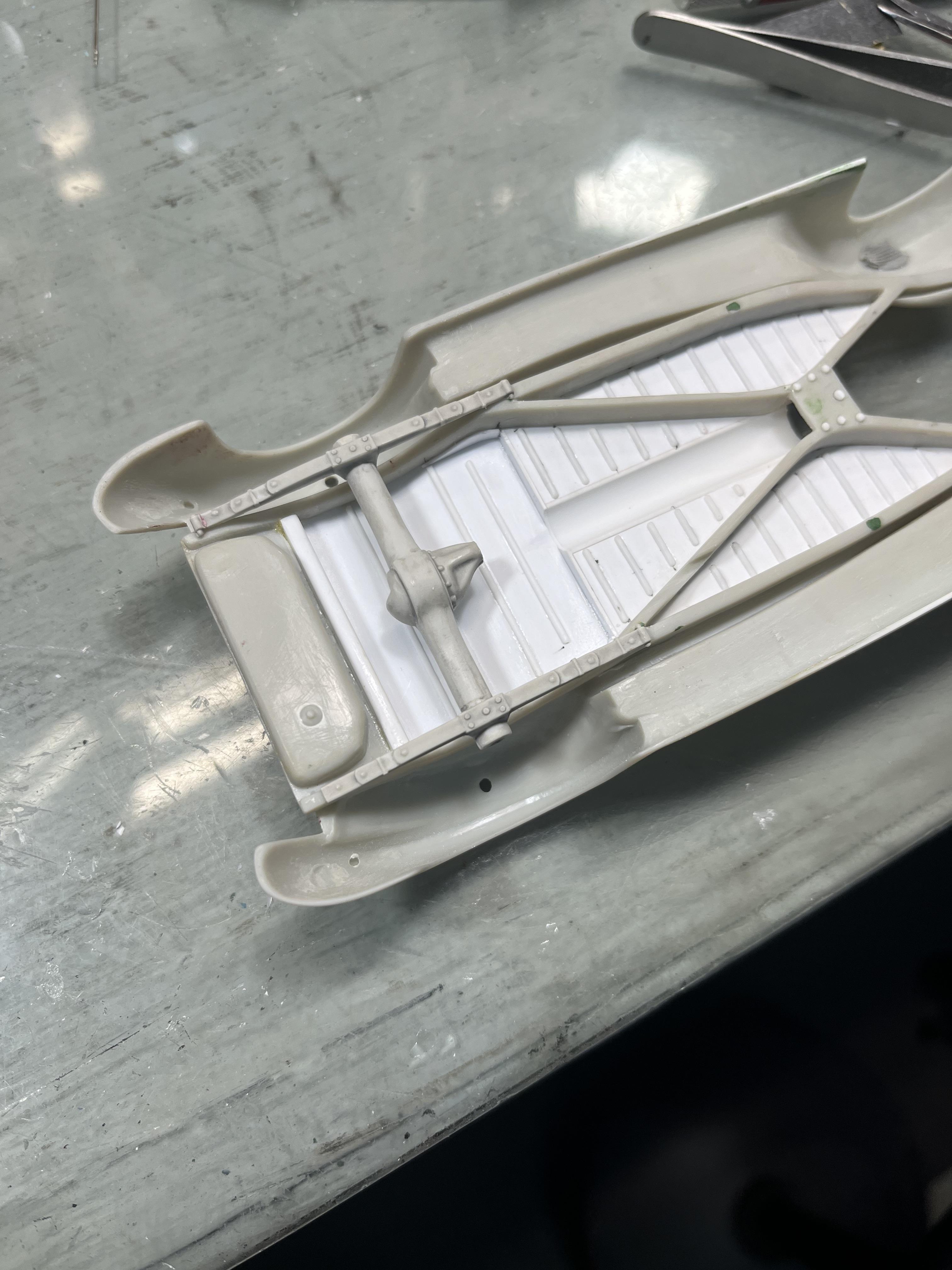

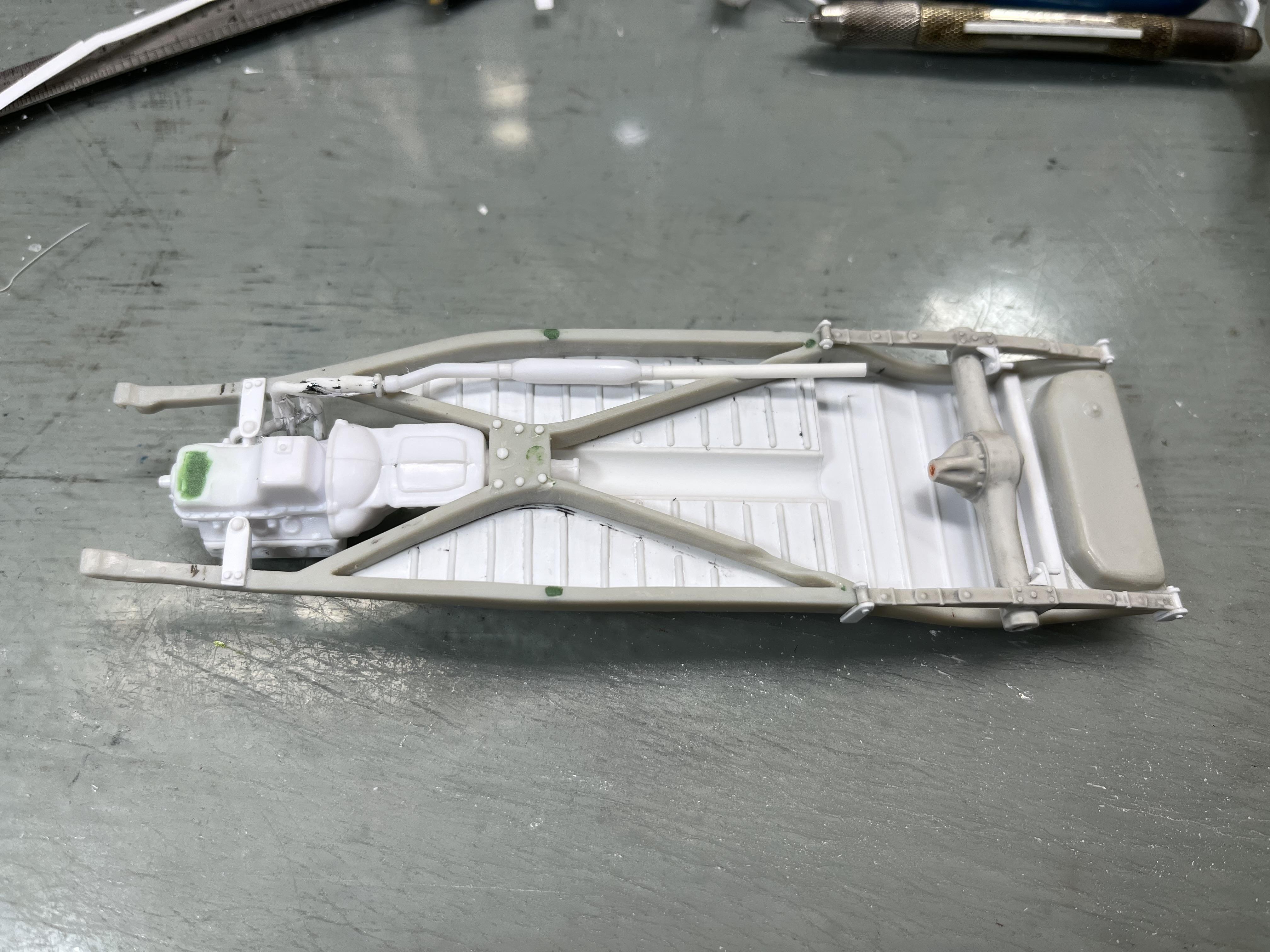

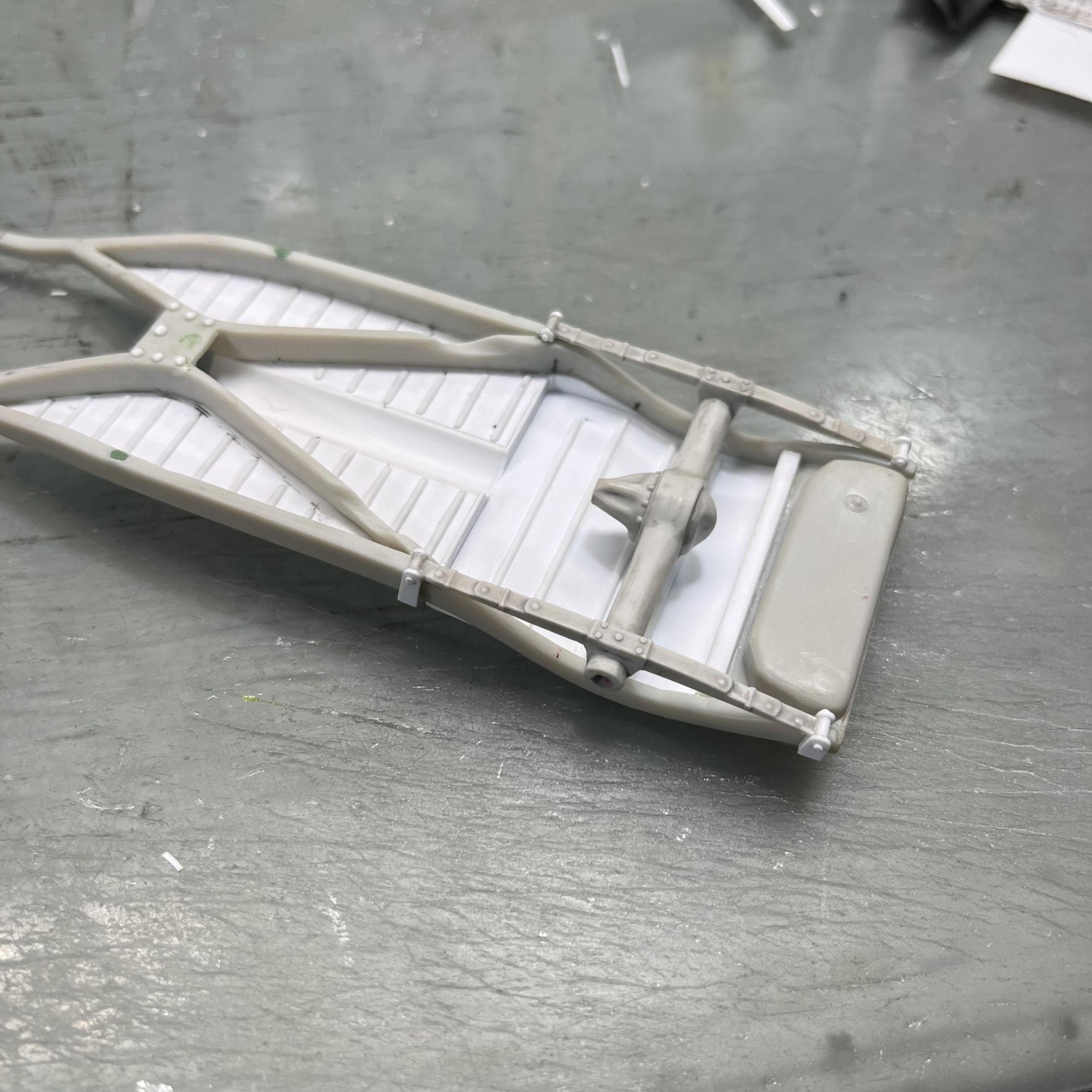

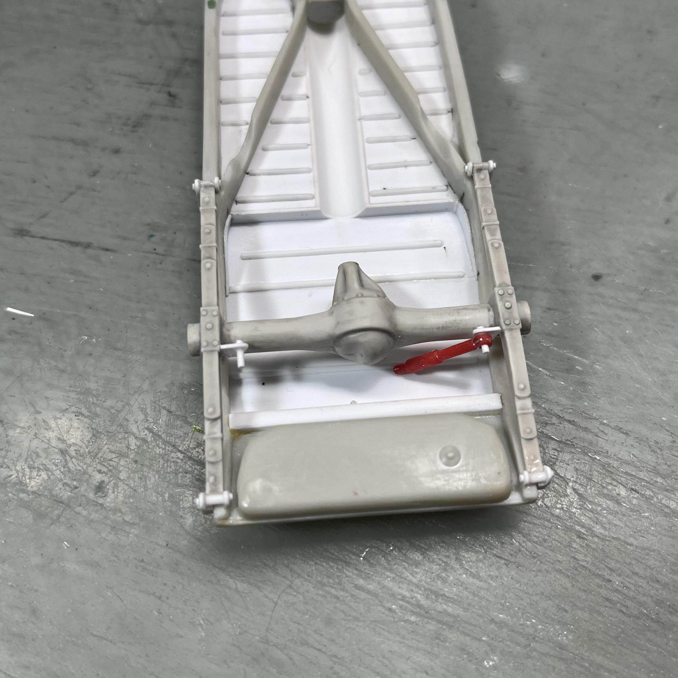

Slowly working on the '36 as time allows over the holidays with family from out-of-state here. I got the floor pan installed and the rear suspension dialed in and the spring hangers fabbed up. I'm not sure what kit that axle and spring setup came from. Obviously from an AMT offering with that grey/beige color.... Also cutting in area for exhaust in trans mount brace.
978h08h908yh.thumb.jpg.d5ae14bd8e6f6112d4355f5c4b1701a8.jpgyg9y9y.thumb.jpg.2506d14380995197e2b61f8408f2a6b2.jpggh8yho9yh.thumb.jpg.86782d81fb4a6534a813f91bc6492414.jpg867g08987h.thumb.jpg.ce6e0c4692f094f35cd7a124bbf009f2.jpg
Shocks will need to be shortened. Next up: installation of front suspension, motor mounts and exhaust system....thanks for looking.

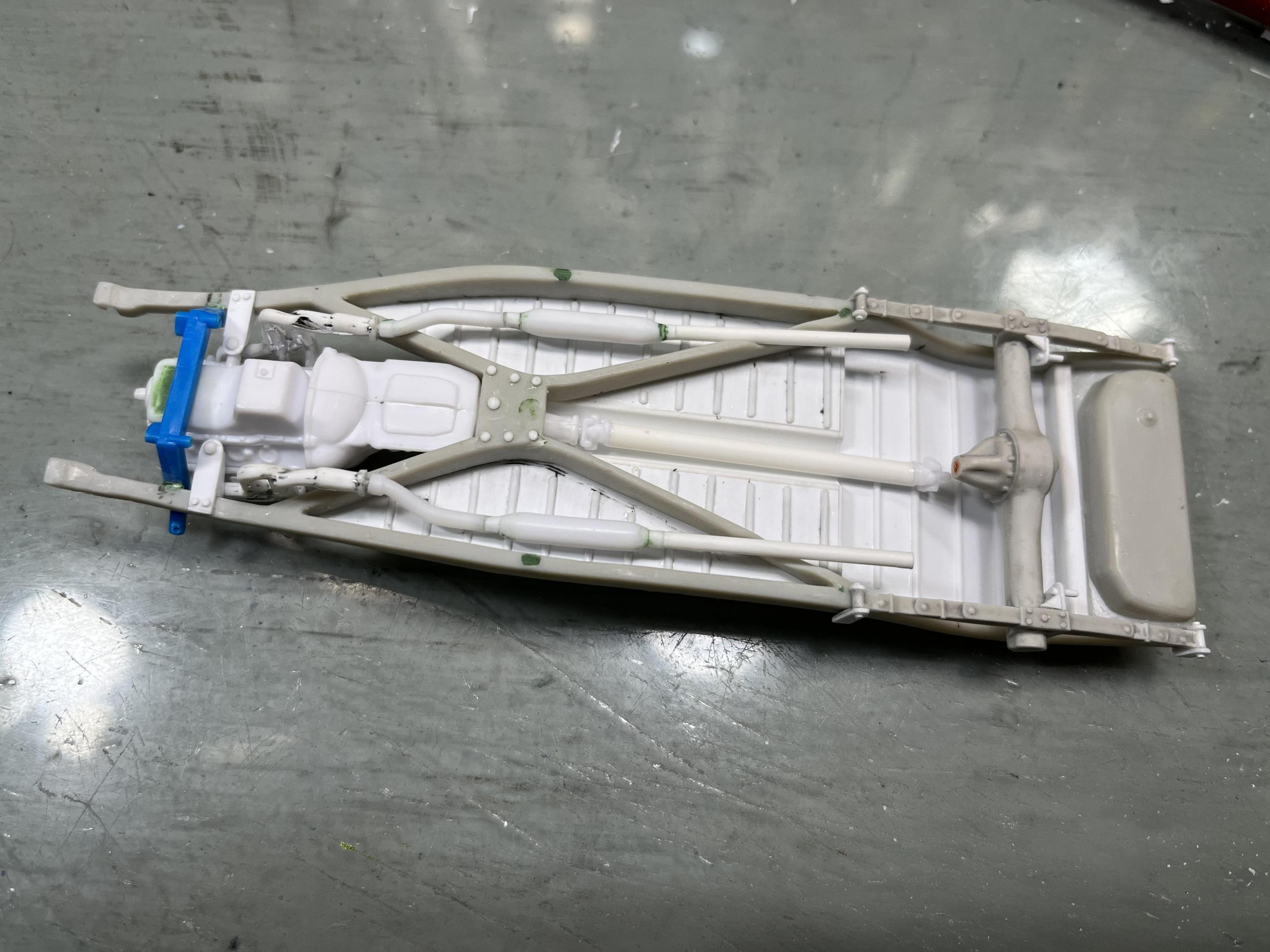

Works continue on the underside of the '36....
motor mounts installed and here fabbing up the exhaust... I had to take a slice out of the oil pan to fit it over the front crossmember...
Here the undercarriage is just about done. Front crossmember installed, exhaust routed (I still need to make mounts), driveshaft put together (universal joints from a Revell '32 kit, with tube extended using Evergreen round). Now attention turns to the interior for a few items to take care of, package tray needs some work and a steering column hanger needs to be made and attached to the dash..

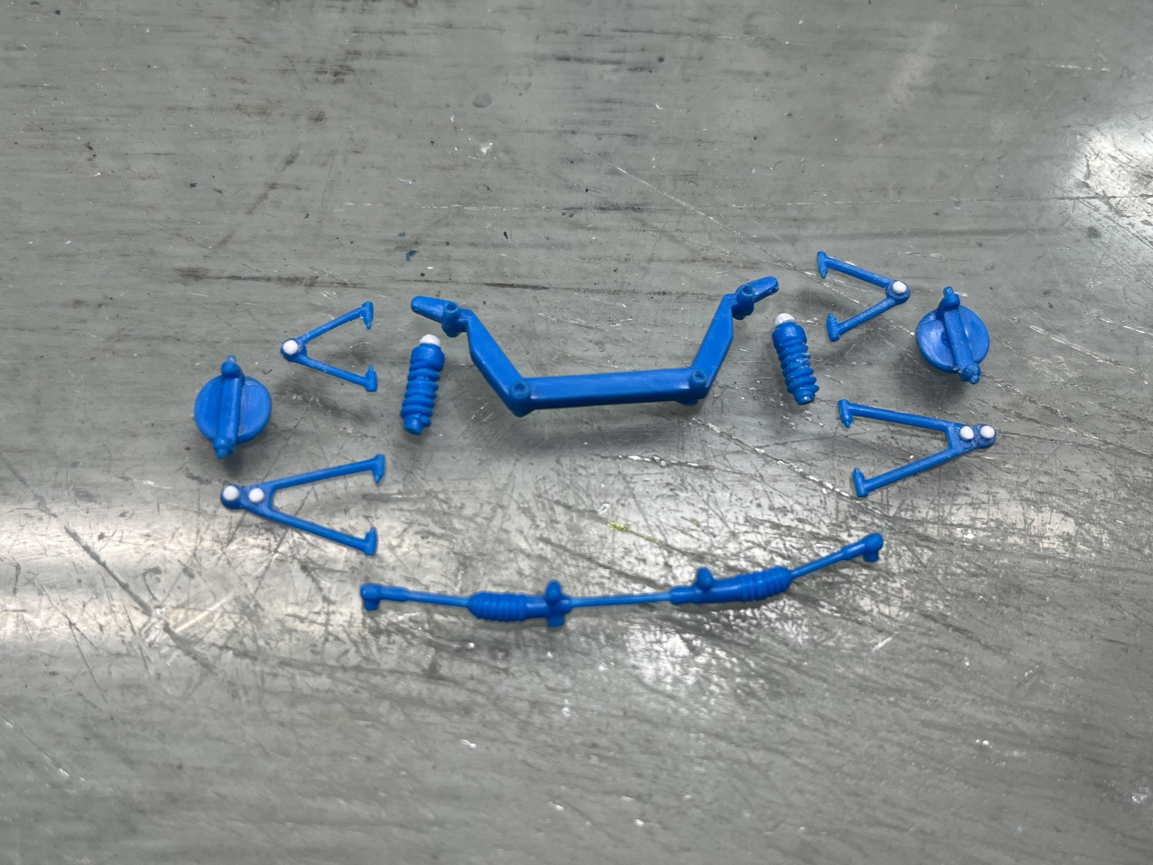

bnnnnbvb.thumb.jpg.d65e0f28fd29aec49161c14a0f15c7cd.jpgThe front suspension components were cleaned up with a few bolt details added...I'm getting dangerously close to throwing paint!

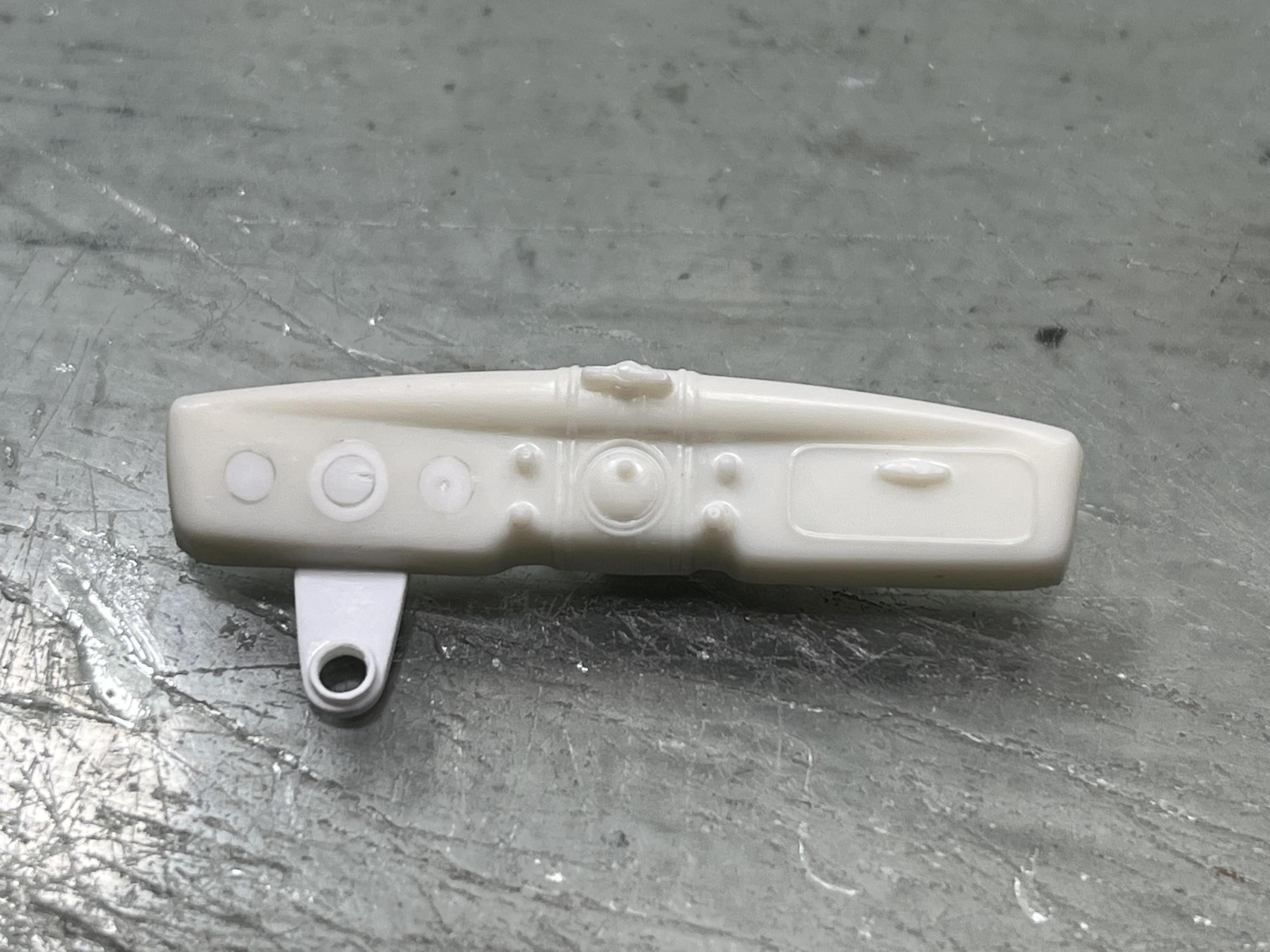

I fabbed up the steering column mount. The plan is to use some photo-etched gauges...

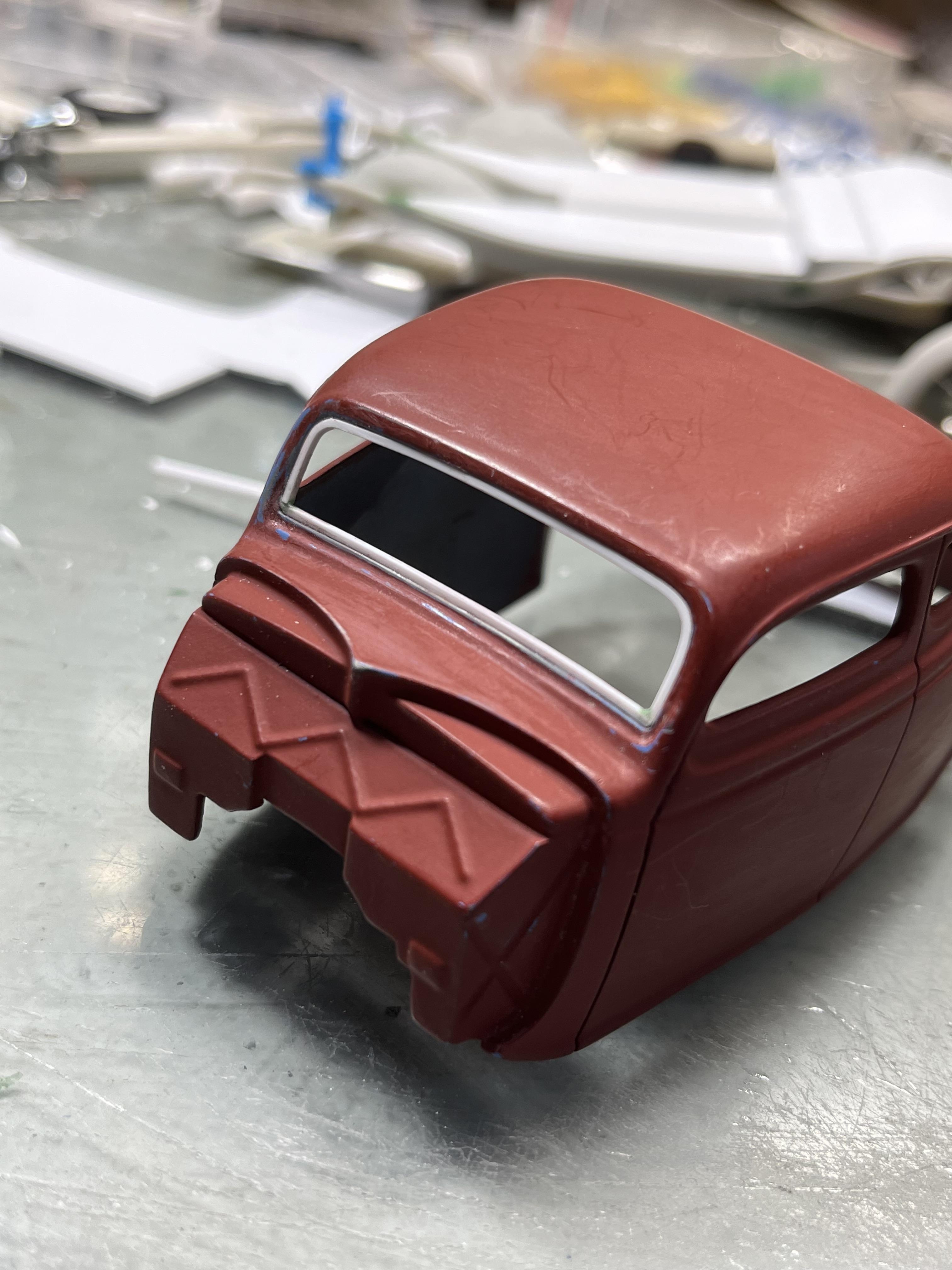

I added a windshield frame to the body...
It's off to the paint booth now... -RRR
