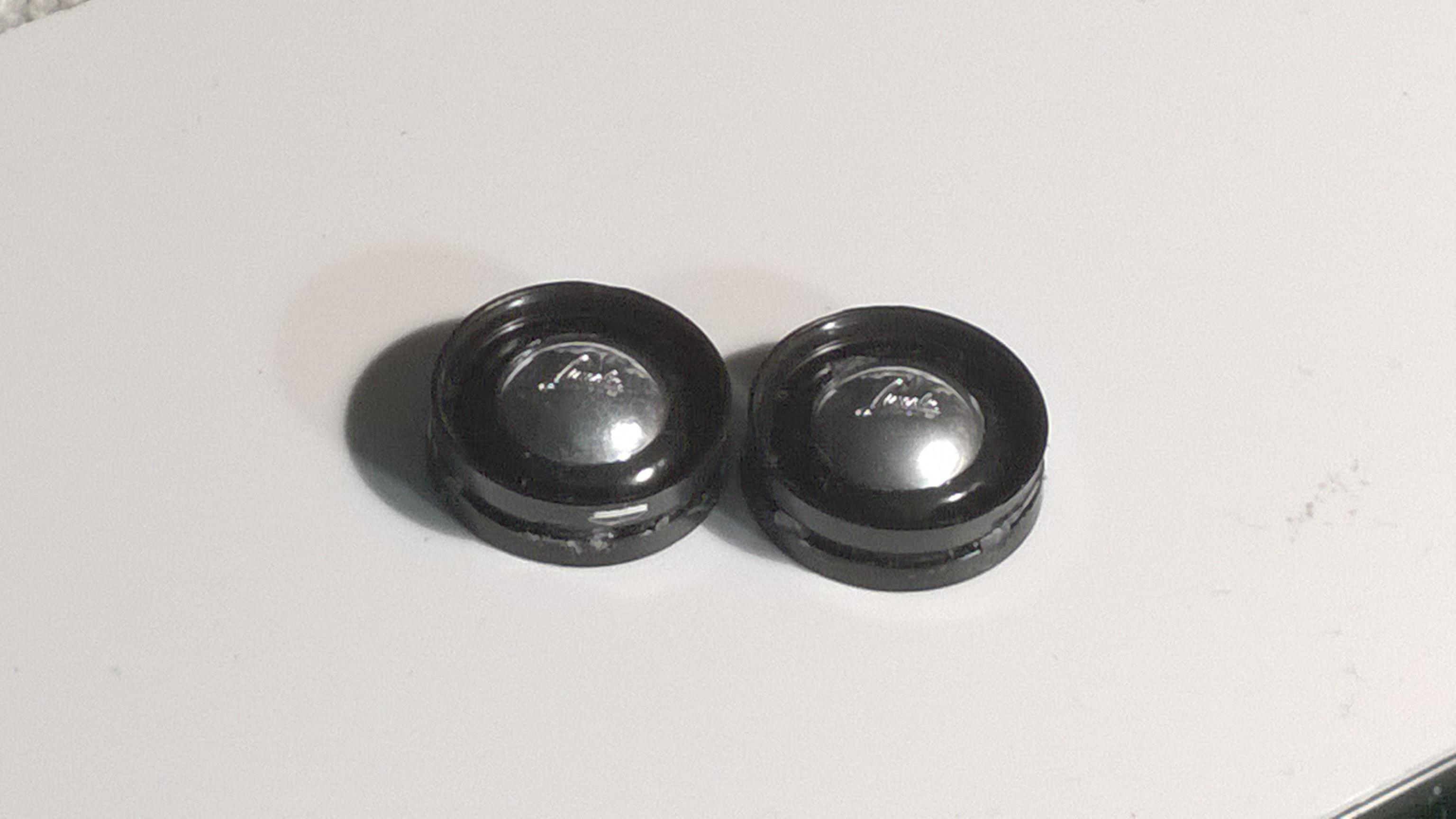

The same tires that are in the Monogram '41 Lincoln (4) are also in the Monogram SCOOL BUS (front 2):
I just found a pair of Monogram '41 Lincoln Rims & Hub Caps that I'll send you... just PM me your address.  I also have a couple of Revell '32 5ive Window rear steel wheel inserts that you can mate with the '41 rims.
Now, all you need are a couple of tires!  Any help out there? -KK

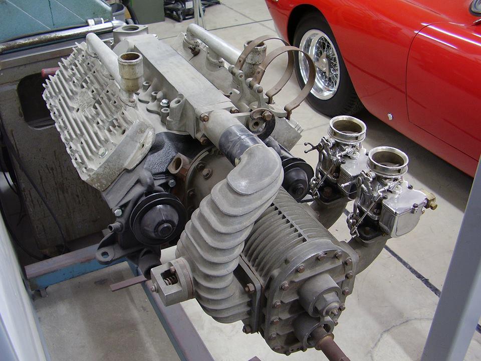

ps found this on the interweb and had to share it with you... it's a flathead 8ight, and full of ideas!  You see 'em?
10891706_10203403698759609_2934663009456481614_n.jpg.0afd63d6487a25cb42294b53eef00e29.jpg
I also recently saw this picture on the internet and immediately thought of you. That fluted connection from the blower to the intake is particularly intriguing, hope to see your take on that.

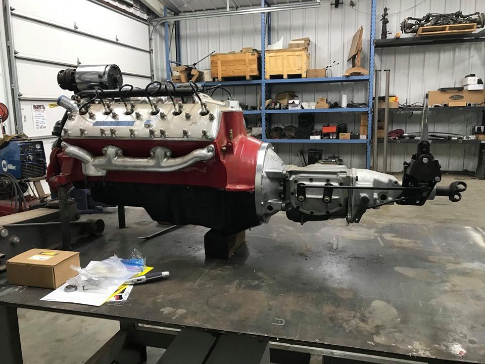

Remember the plan to bolt the V-12 to the firewall... here's an example of an adaptor created to add a late model standard transmission to the aft of the '41 Lincoln V-12:
Pulled the old flathead from the deuce sedan... the bellhousing will be used to adapt the TKO500 to the V-12 tail:

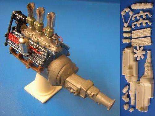

After lining out the areas that will need to be cleaned up on the stock Monogram '41 Lincoln block: exhaust headers and crossover pipe, manifold and transmission, decided to order the '41 Lincoln V-12 from The Parts Box:
A lot less work to get the V-12 block ready to go in the roadster! -KK
