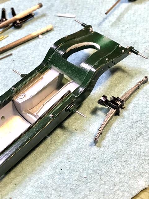

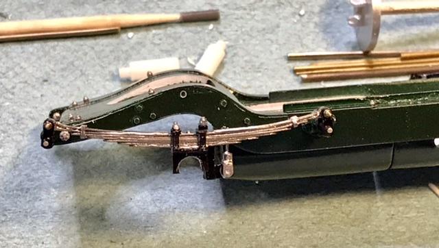

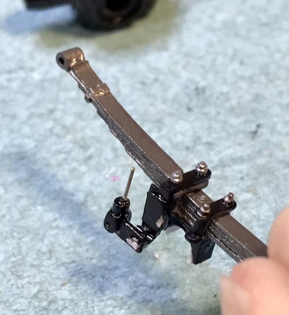

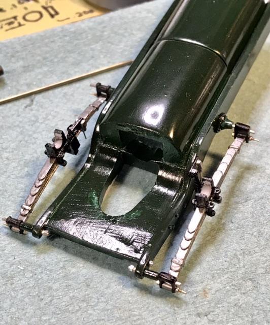

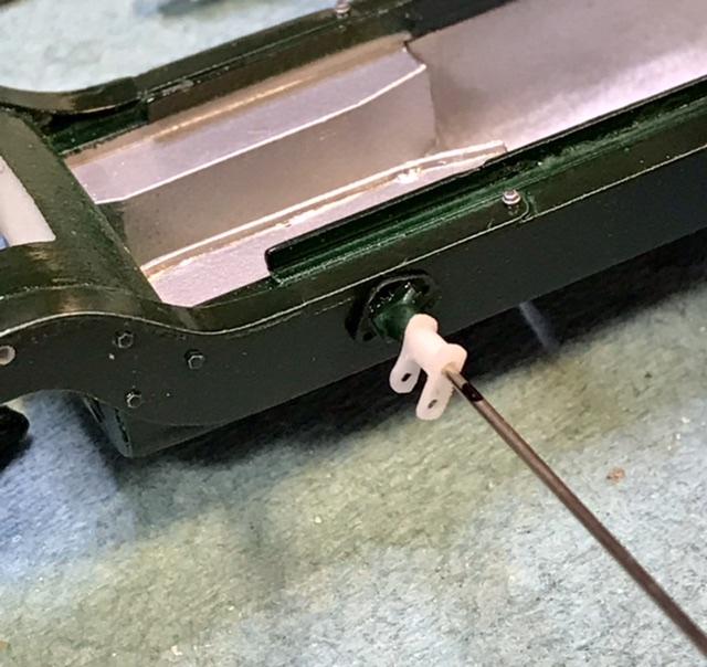

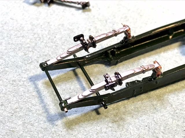

my next problem is making the bracket that serves as the pickup for the second friction shock for The rear susp ….    It runs past the axle without interfering with the path of the axle - its a real head scratcher … cant assemble the rear susp til ive figured this one out ….  Of you happen to go to the Amelia concourse this weekend and the Brumos Junior Eight is there …. You mite see a some fool lying on his back under the tail of the car - be sure to say hello …

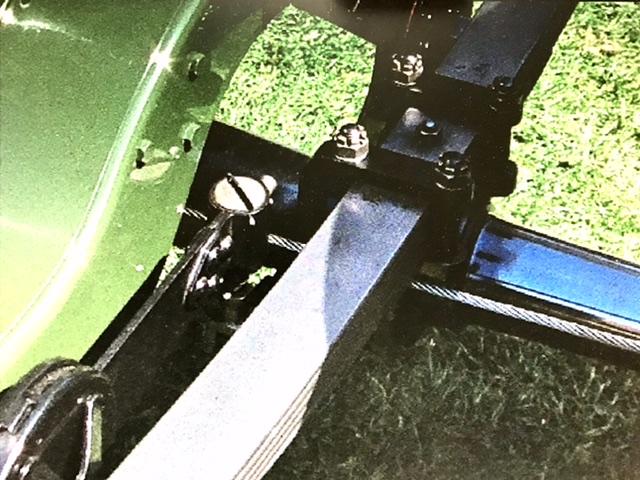

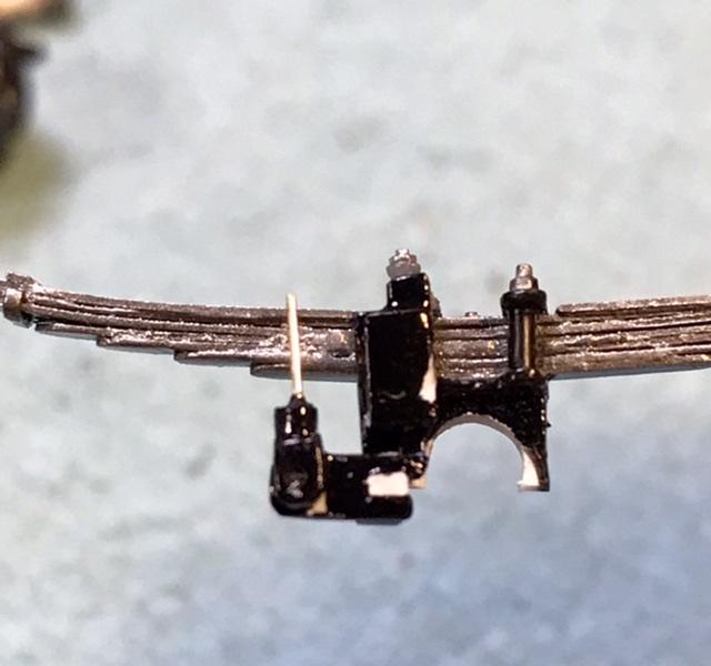

So i crawled put fr under the Boyle Special and drove home with some knowledge - and LOTS of pictures - the Boyle Special and the Junior Special are both “wide chassis” 122’s with supercharged 122 engines - although the suspension fittings differ slightly - i am satisfied that some assumptions that i made about the suspension on the Junior Special were correct - for one - the bracket that secures the friction shock to the leaf spring makes a “dogleg” away fr the path of the axle ….

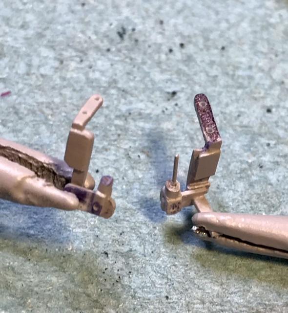

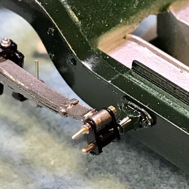

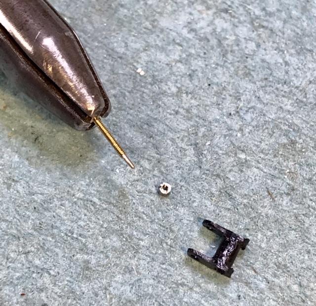

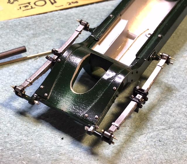

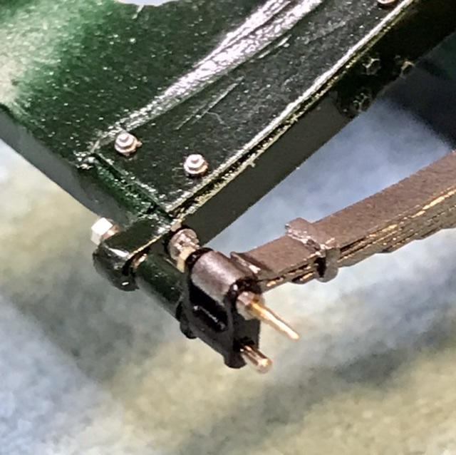

Making The last two shackles - 4 for the rear and two more for the front and glueing the posts to the frame - the springs will grasp Nickel silver posts …

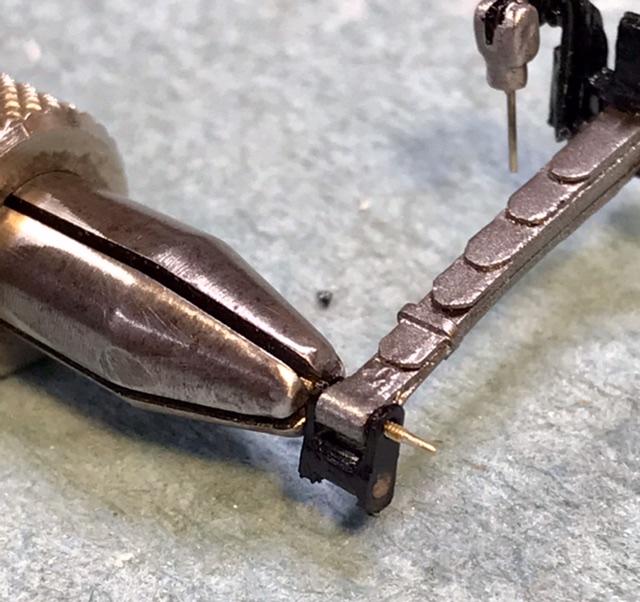

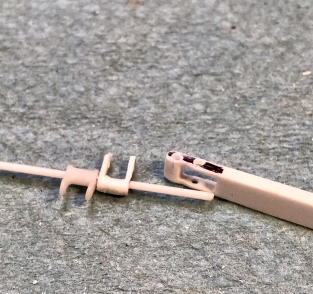

The shackle pins have grease fittings - so i got some .06 bolts and nuts fr Model Motorcars - they still sell much of the Scale Hardware line - i filed the threads from the ends of the 6 mm bolts - so the ends will poke out and sort of look like the grease fittings …

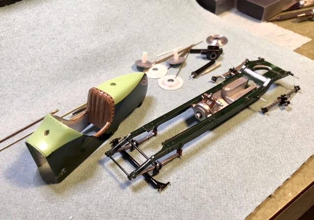

Exhaust pipe
hand brake
radiator cap
oil lines
fuel lines
brake lines
throttle line / housing
hood straps and stays
paint hood hinge and assemble hood
clear coat and apply decals
finish / correct appearance of seat leather
radiator  grill
tie rod and steering arm and fasteners
starter crank
cyl head details
carb intake horn
route coolant lines
correct paint flaws
finish steering wheel
finish \ attach windscreen
finish wheels and spats
lots of stuff …
dont see the finish line yet but i’m on the last lap …

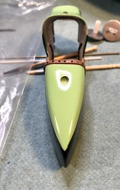

But, it's getting there. It's gorgeous, my friend!

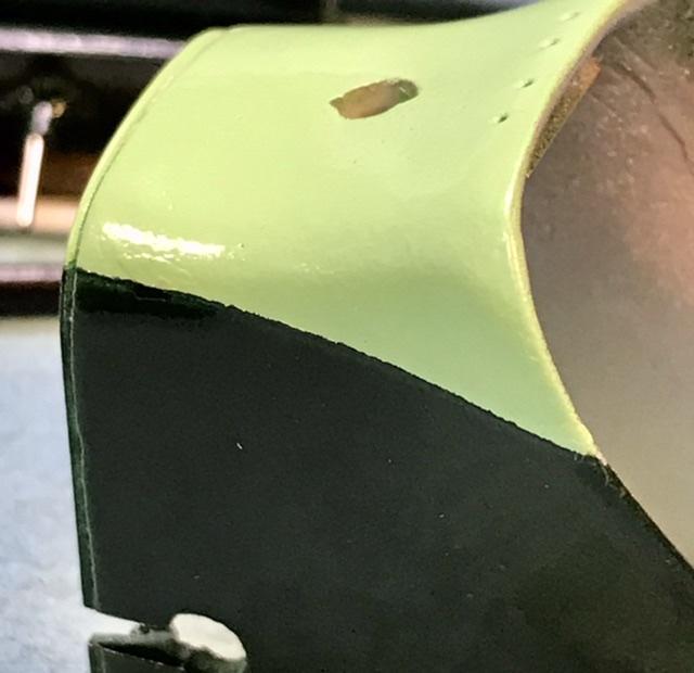

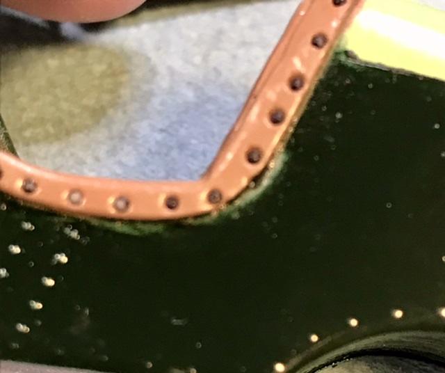

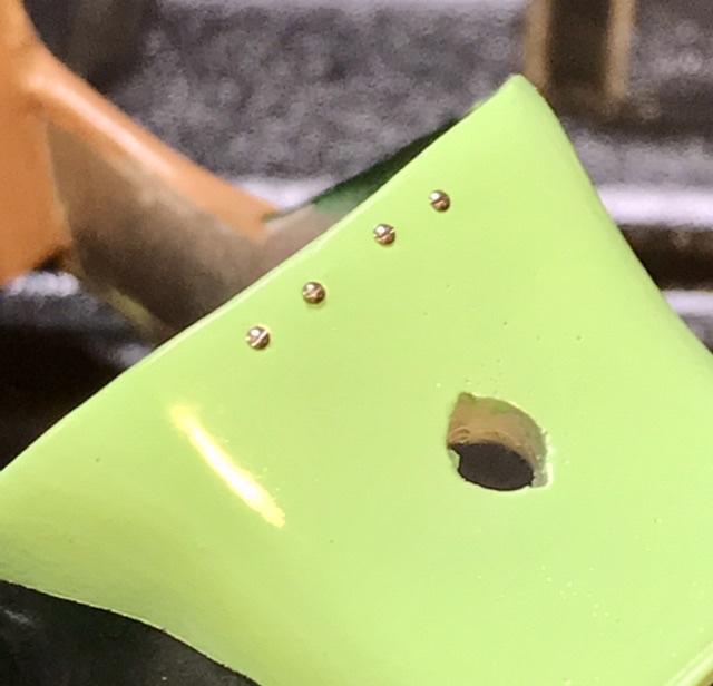

Gotta line up these screw slots  for the windscreen frame fasteners - the Amelia judges always check this …. Violators are flogged …
Yeah...don't screw up the screws....

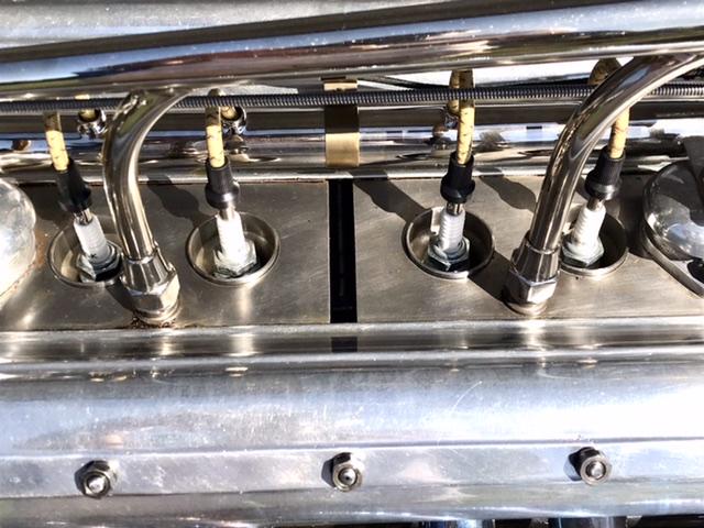

Miller indy cars used a variety of sp plug wire caps - the junior special used clips - i dont think i can make them in scale - so im gonna make the caps that were are on the restored Boyle Special …
