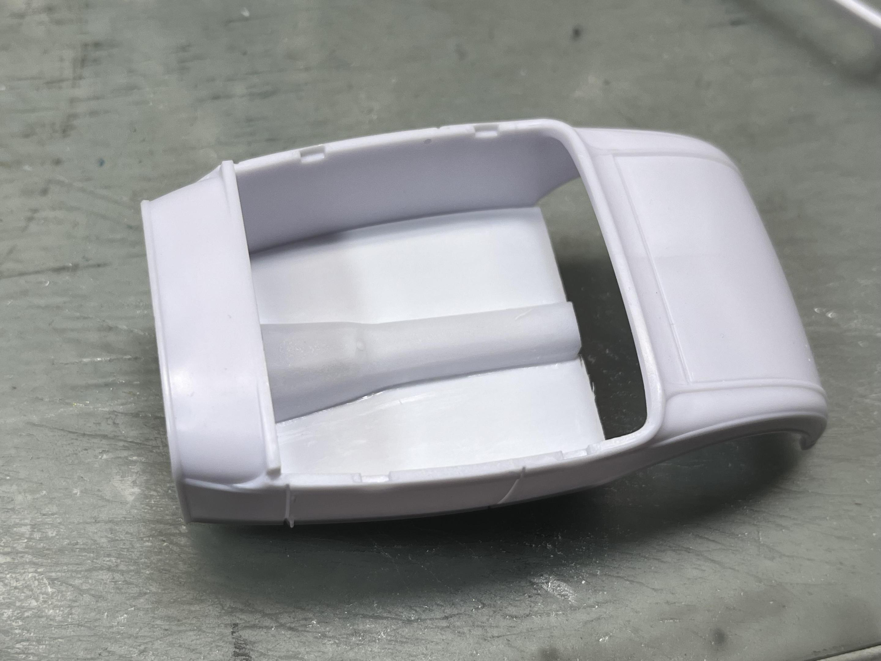

So this week I had a huge cleanup of my model room and found the "cloth" insert that I removed from my AMT 32 Custom Tudor showcar.
Now today I see this thread and there is the perfect use for that leftover roof centre.  Never, ever, throw anything away, that's my motto.

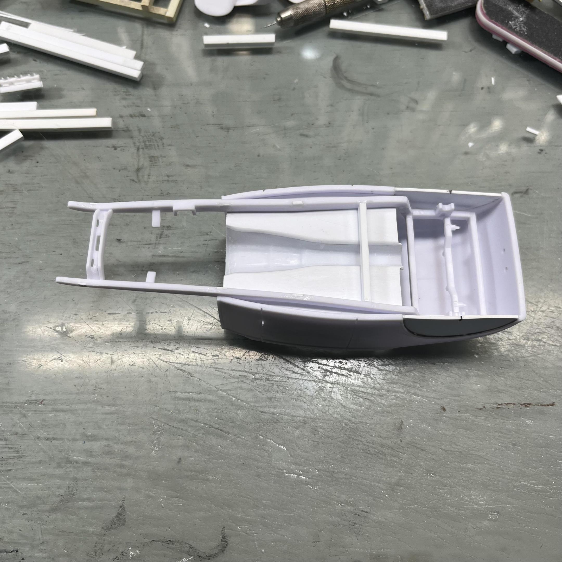

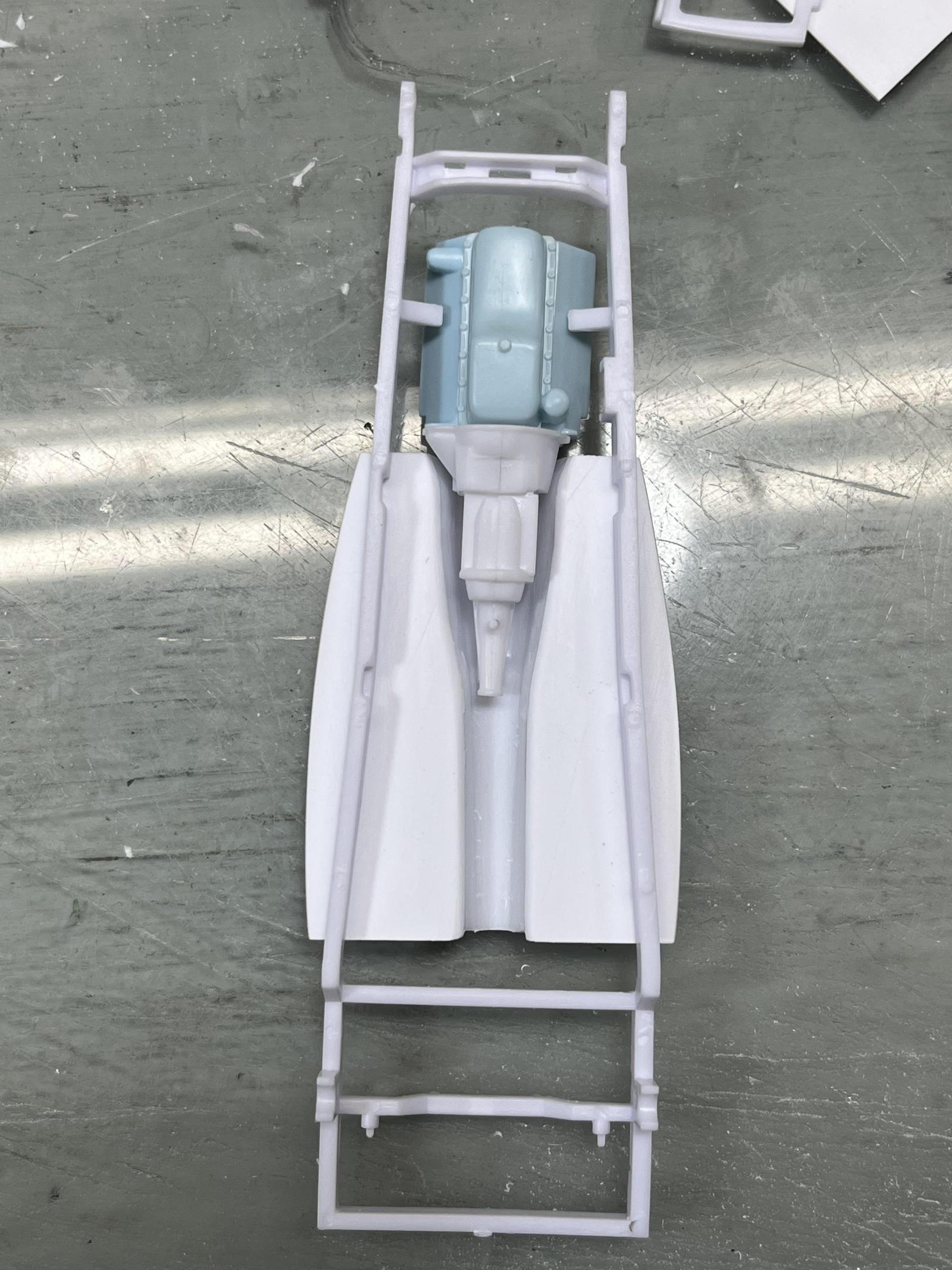

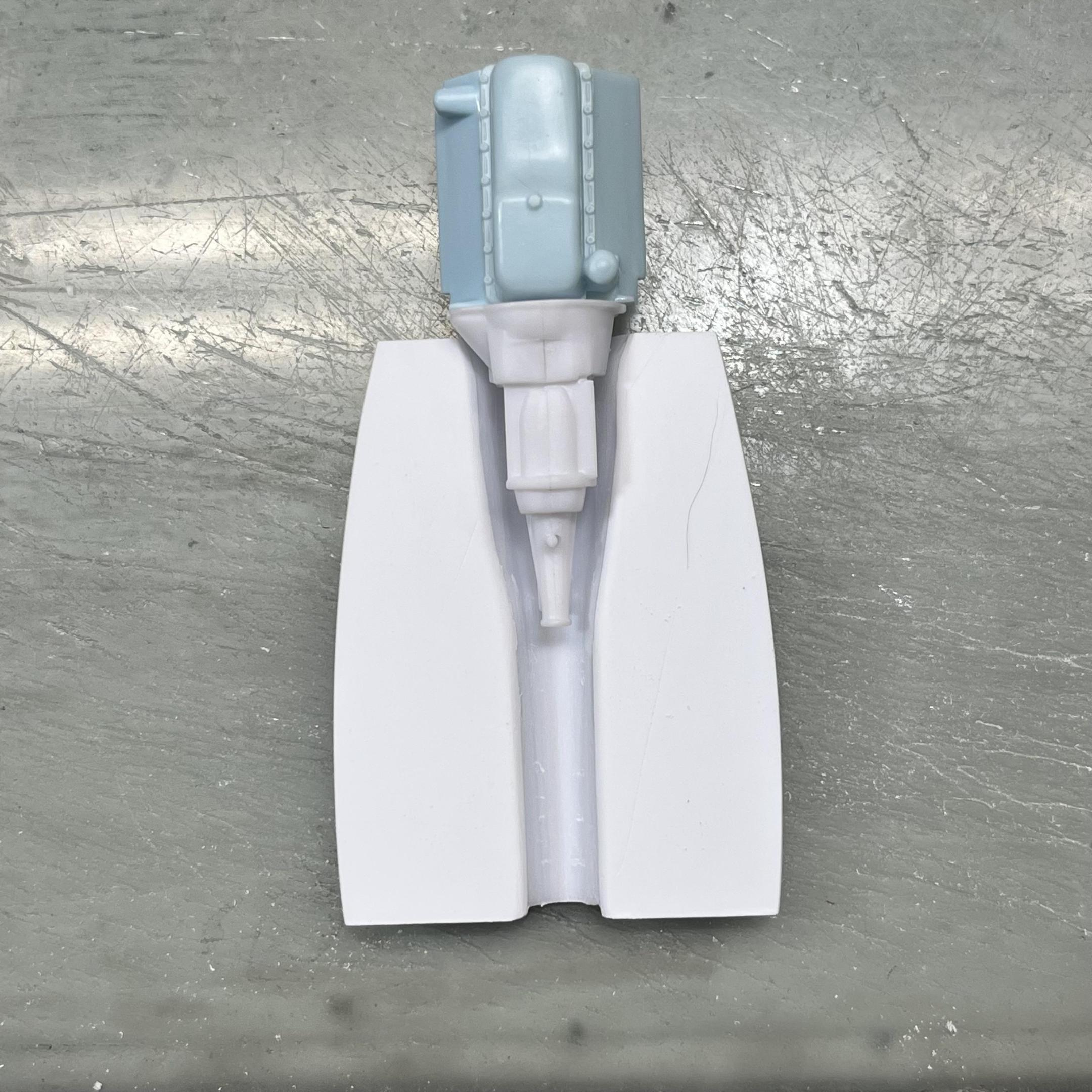

Work continues on the floorpan on the '30 coupe. I grabbed my trusty Dremel and spent some careful quality time grinding out the area under the trans/driveshaft tunnel. Then I followed that with some work filing and sanding. Now looks like this...9yv97tv8.thumb.jpg.4aa403637e09aada63c5c11d48037e27.jpg
Transmission fits like a glove, as it should as it's from the same Mustang kit as the tunnel!

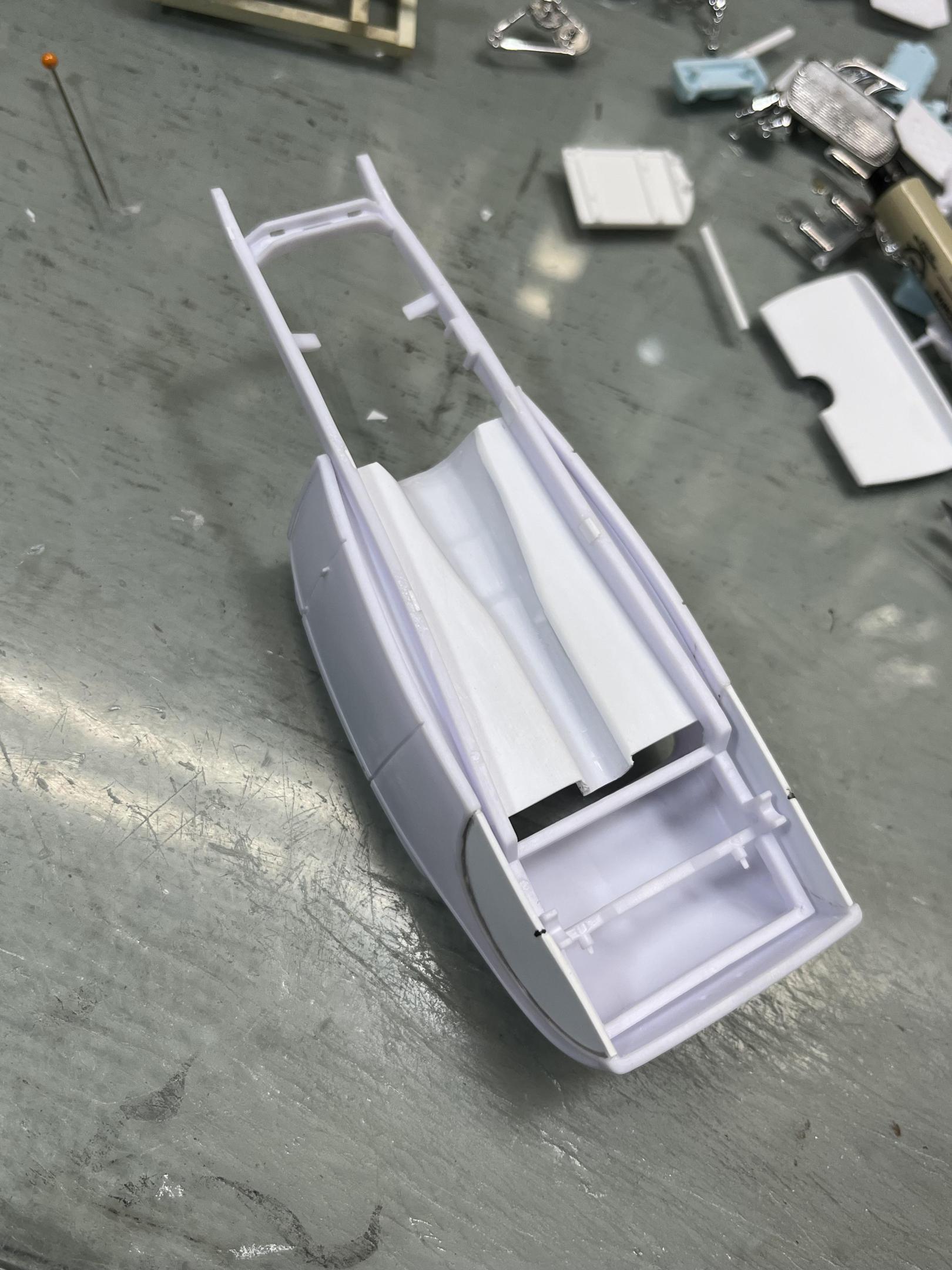

Dropping the frame over it, looks like this. (but this is getting ahead of ourselves a bit).
The floorpan nestles nicely in the body. The body will be channeled over the frame a skoshe, the amount depends on the height of the interior panels I plan to use (plus the depth of the floorpan). I will be starting to fab up the interior this weekend. Having a separate greenhouse makes working on the interior easier....
More later, thanks for following along.... -RRR

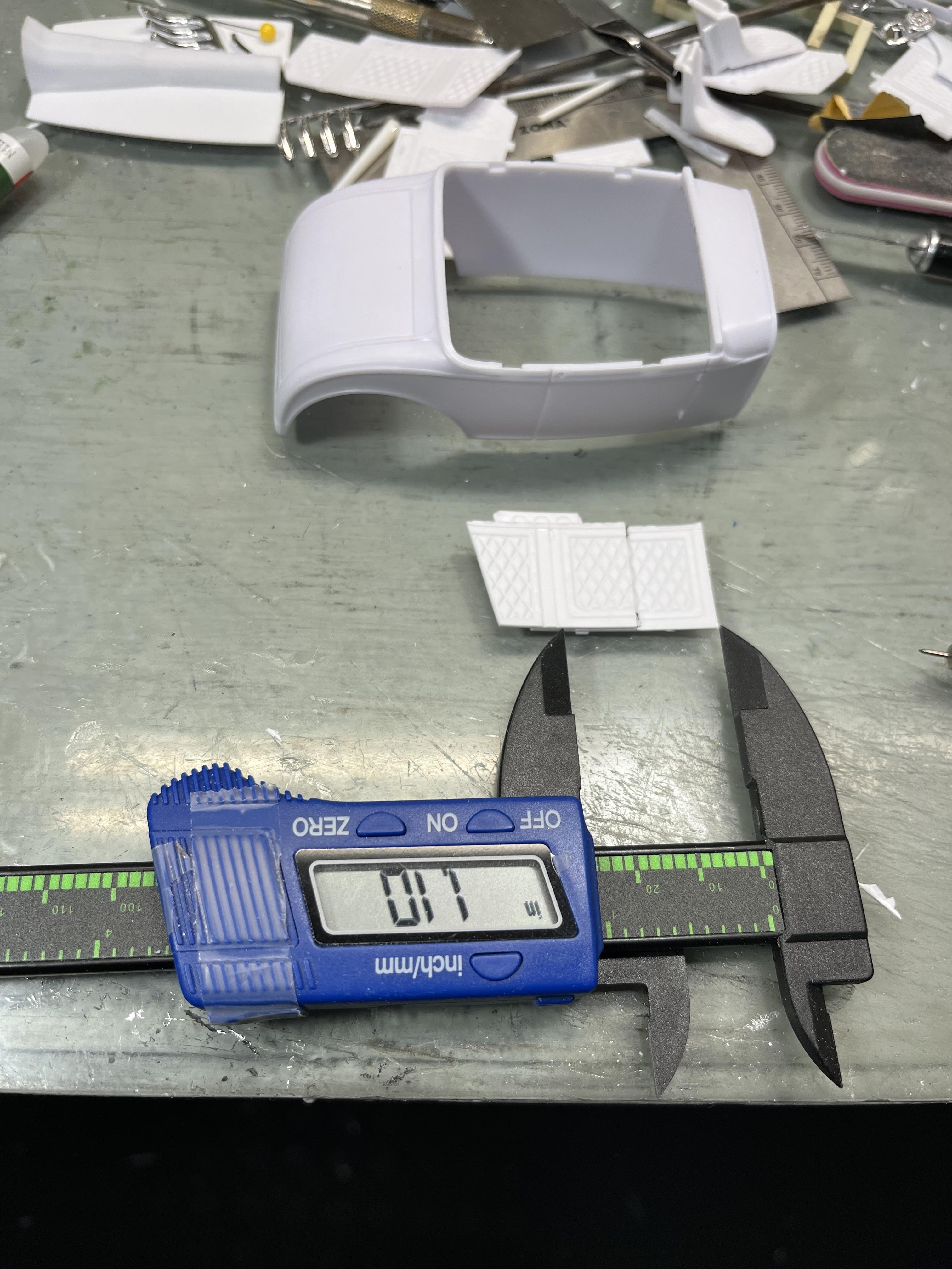

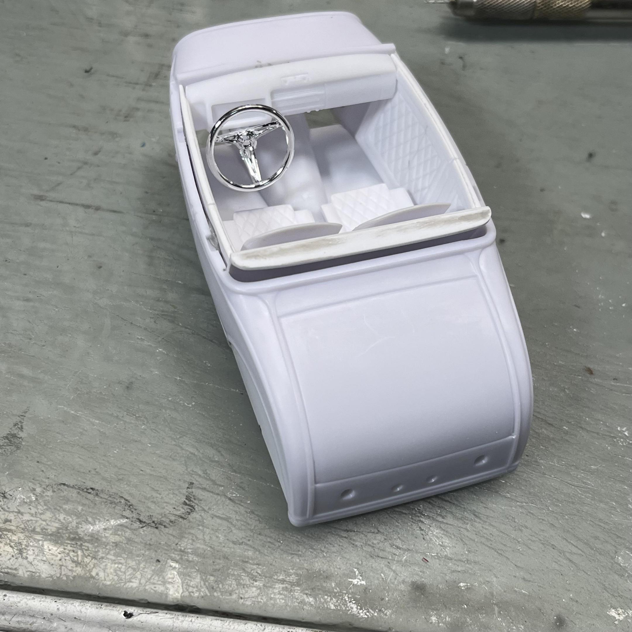

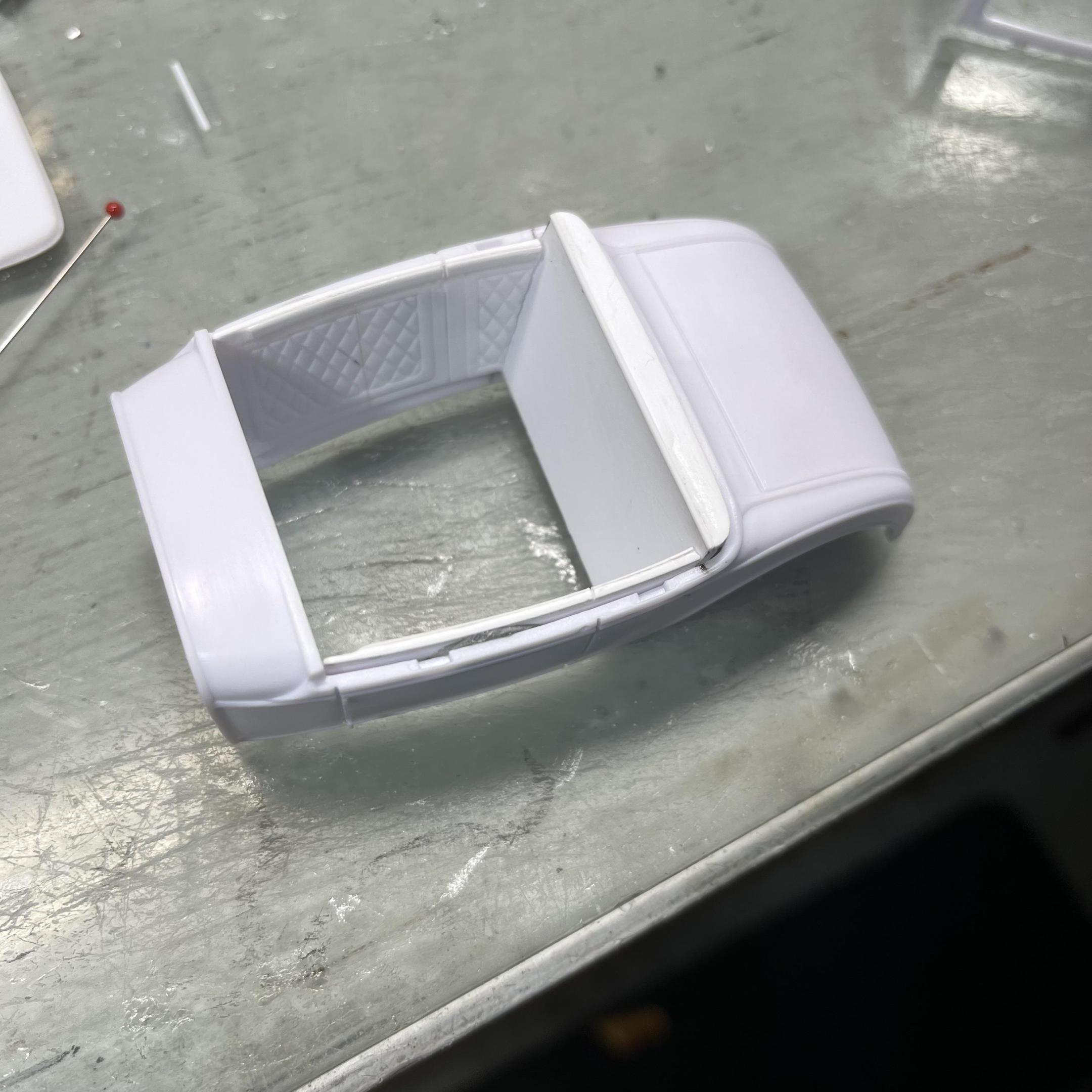

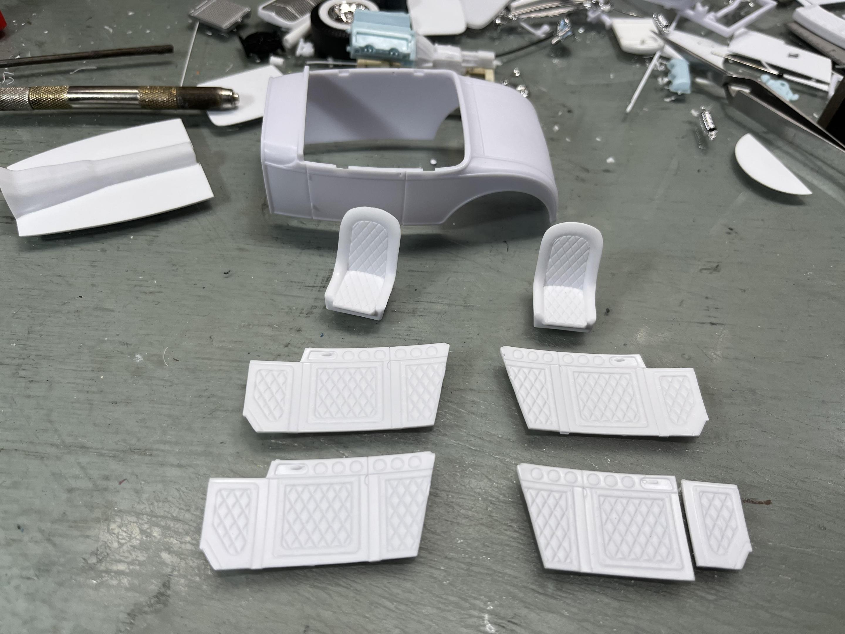

Moving on to the interior this weekend. I decided to use the Revell '32 roadster Rat Roaster interior pieces....

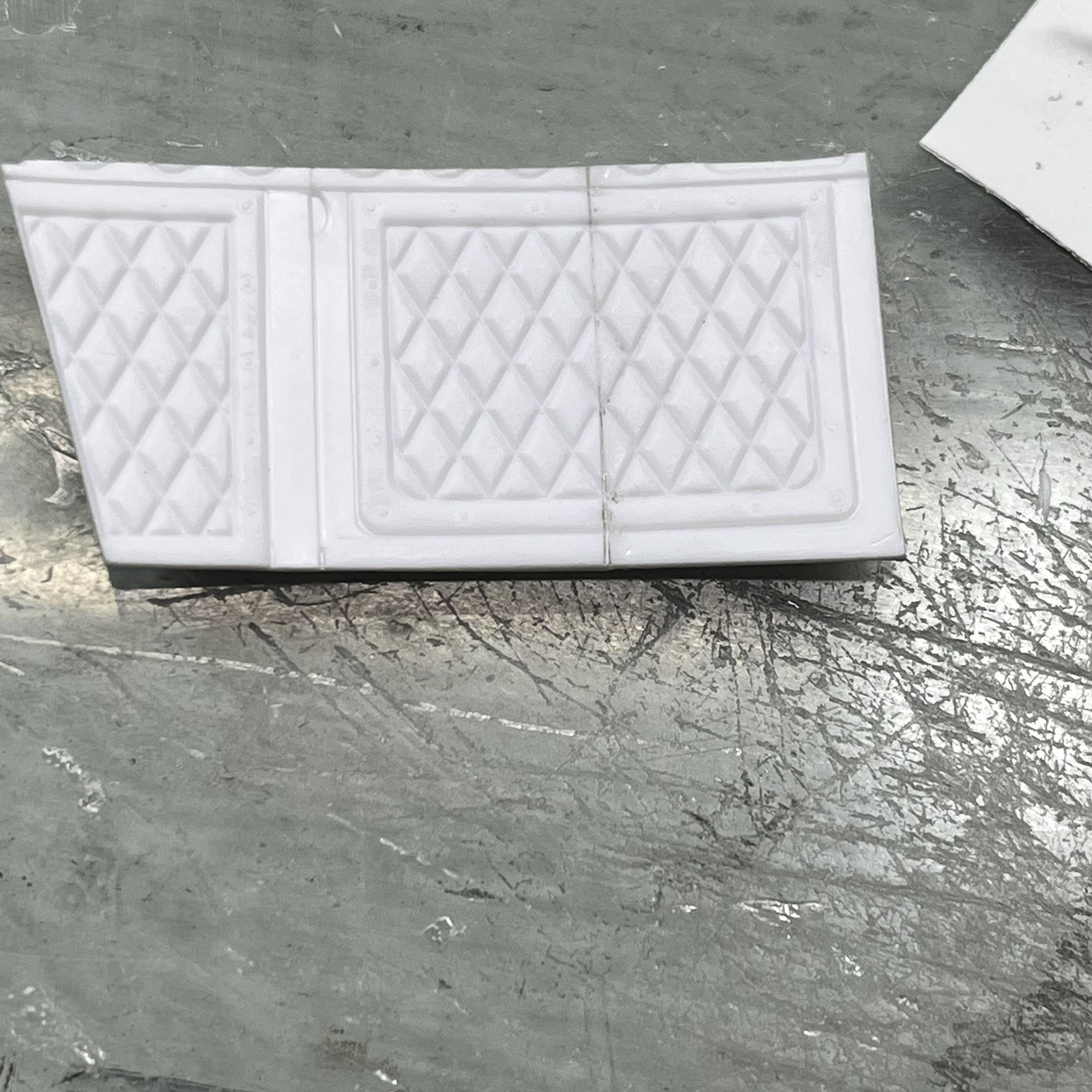

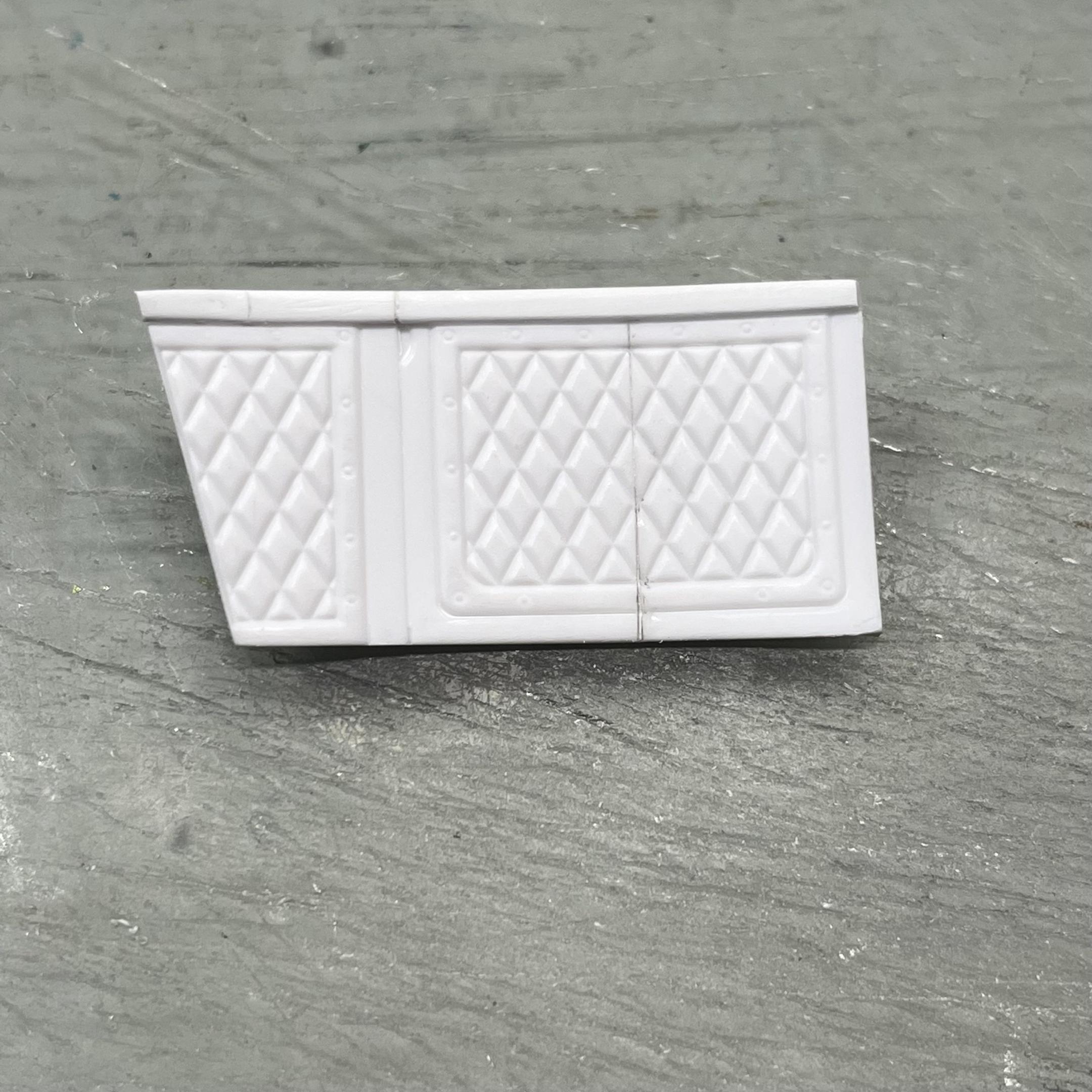

I had already cut the toe board off of one of the side panels. these will be replaced as separate pieces. Since the coupe doors is longer, I'm going to use two panels, cut them to the longer length and splice them together so the door lines match...
I already cut away most of the upper 'porthole' section on the panels as I won't be using that. I measured the door length on the body with my handy dandy calipers (thanks, KK) and transferred that to the inner panels to determine where my cuts will be made. As KK is fond of saying: "leave the line!!!"
After slicing and some careful sanding 'creeping up' on the pieces, I glued them together. There was a bit of a bow, so I inserted a slice of super thin plastic to take up the space. A skoshe of putty and some more careful sanding should bring this around. The open area is at the bottom, so it won't so very visible!

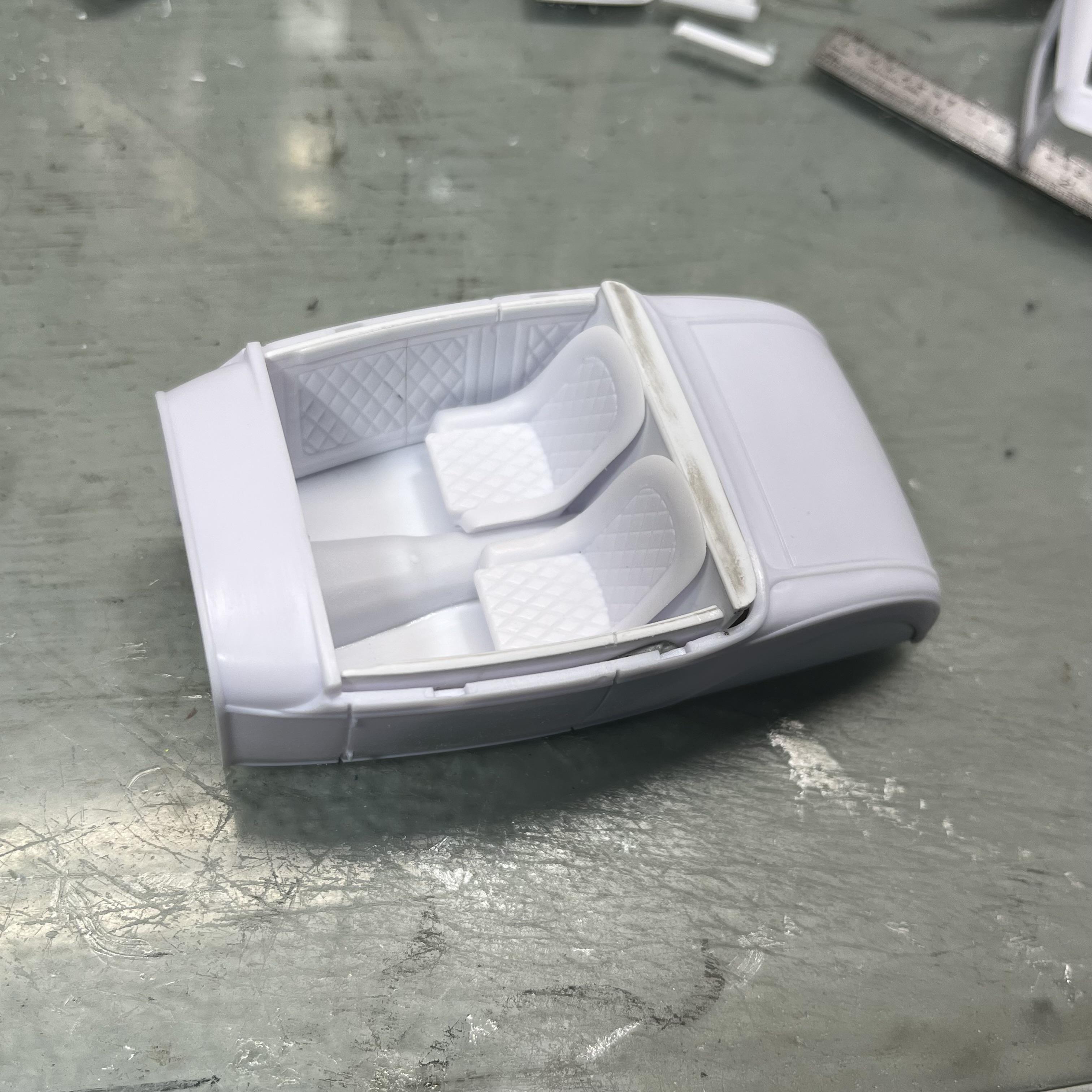

I added a strip across the top of the panel covering up what remained of the 'portholes', sanding down the edges and slicing an opening for the rear door. I'm going to use white as my accent color, so the plan is to paint the panels white, with the diamond pattern panels in green (to match the exterior color) with BMF for that band in between.
This is how it's going to look. The seats will sit further back once I fab up the back panel and package tray. I notched the bottom sides of each seat to go over the tunnel. The door panels hide the seam between the body and the greenhouse. On to the other side. Once these panels are in place, I will know how much of a channel I will have. Then I can determine how much of a 'Z' I will need in the rear frame rail to get the proper ride height.

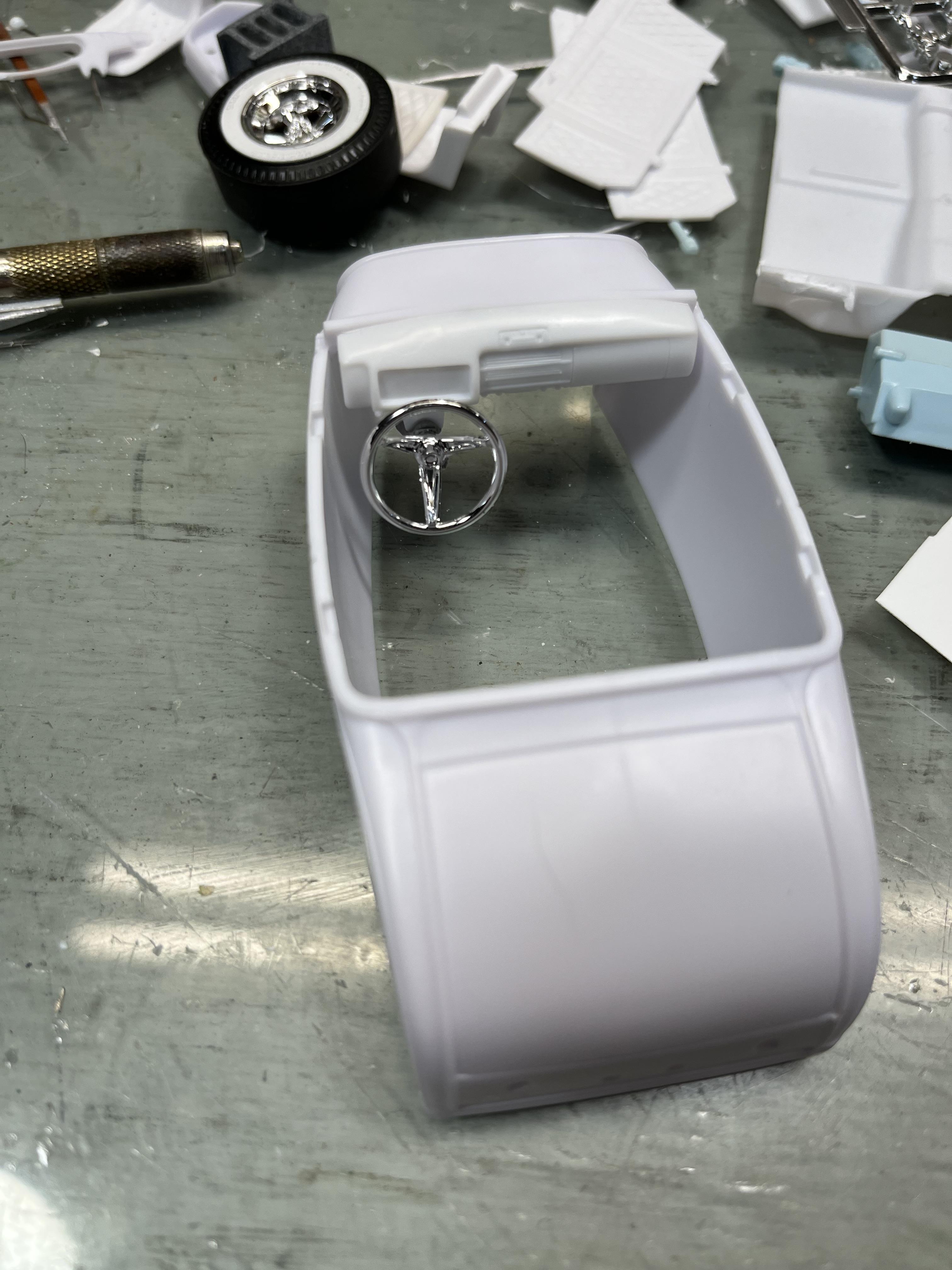

I'm going to use the '40 dash out of the Revell '32 5ive window coupe...sure, why not? I also found this steering wheel out of the parts box. I'm going for a '60s style almost 'show rod' look and I think this fits the theme. Most likely the dash will be in body color metalflake green....
Thanks for checking in...stay tuned for more fun and frivolity!!!  -RRR

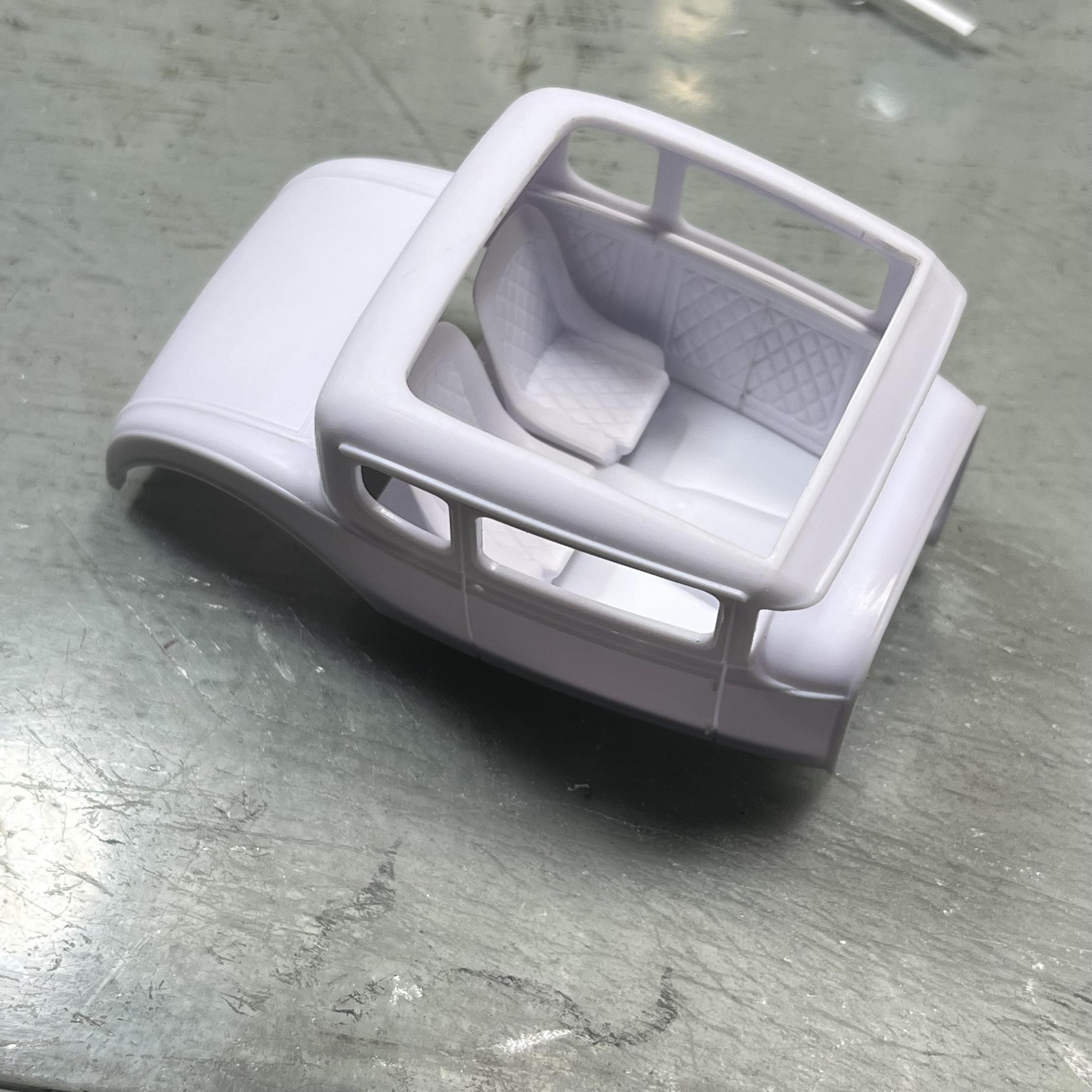

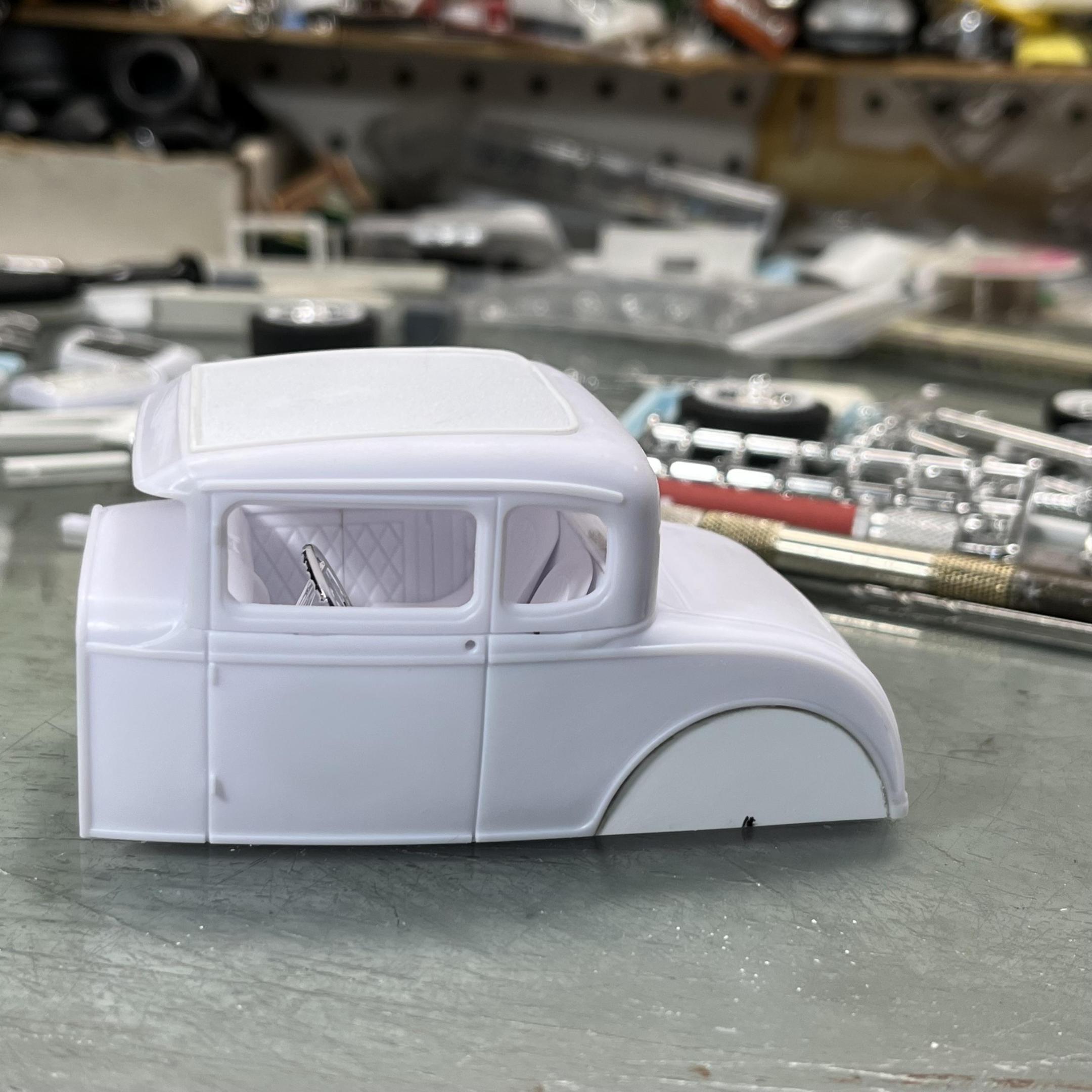

The interior has been pretty much dialed in. I made a rear wall/package tray unit and sliced off a bit on back end of the door panels to fit... ubuyyuuyhbh.thumb.jpg.e998b15863681dffcb8c1d4d02035bf3.jpg
I cut out tunnel notch at the base of the rear wall and got the dash snugged into place... iybuui.thumb.jpg.9754c8b89efc3ae8894b226a56e8a12a.jpg99uhuhh.thumb.jpg.8371a3877290d854cbb912650d9e192e.jpgouhoubyv7trd.thumb.jpg.32e67db9ae1711f6fb1a8678d4c825be.jpg
Next up, putting a 'Z' in the rear frame rails and support bracing...

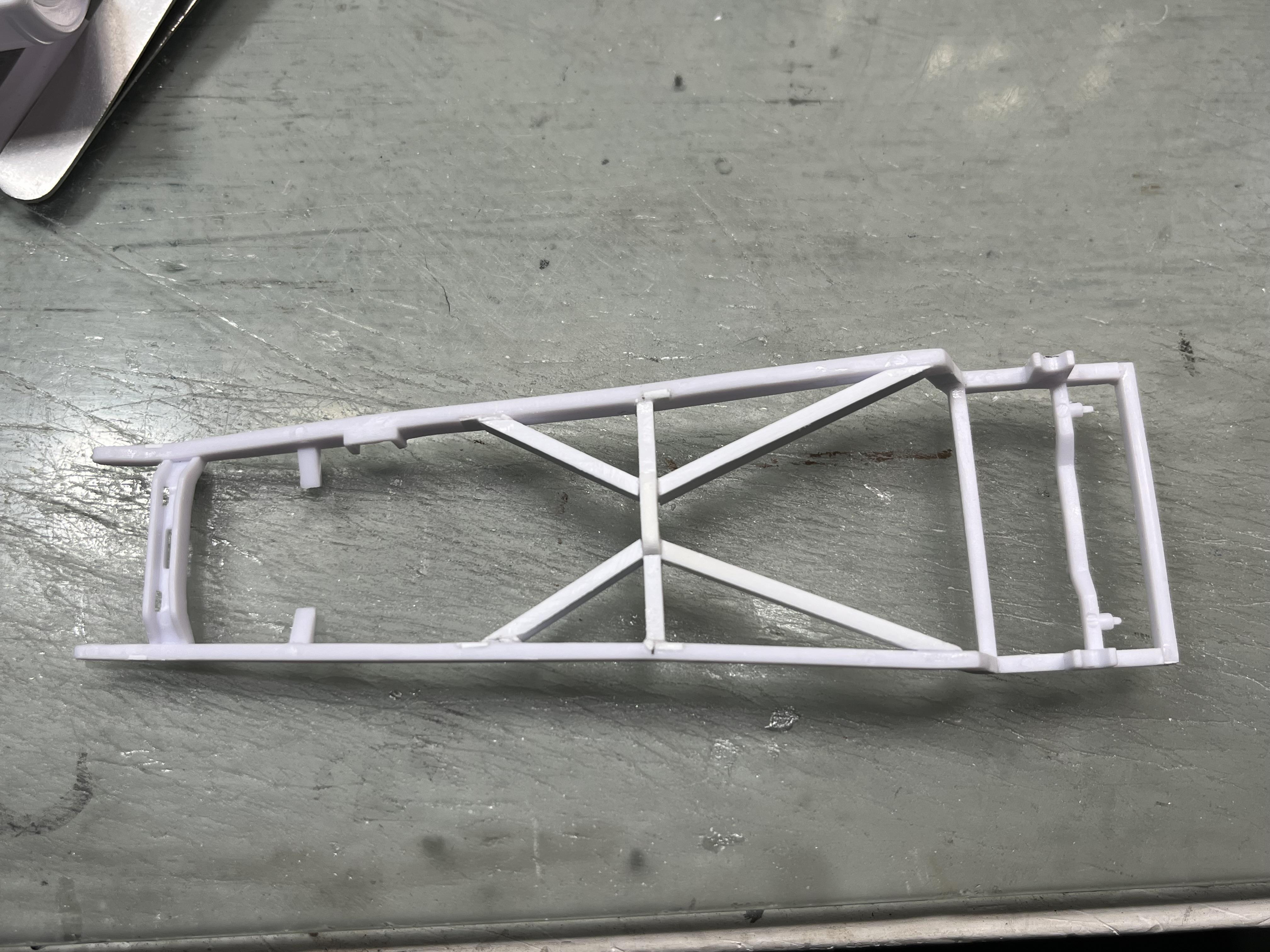

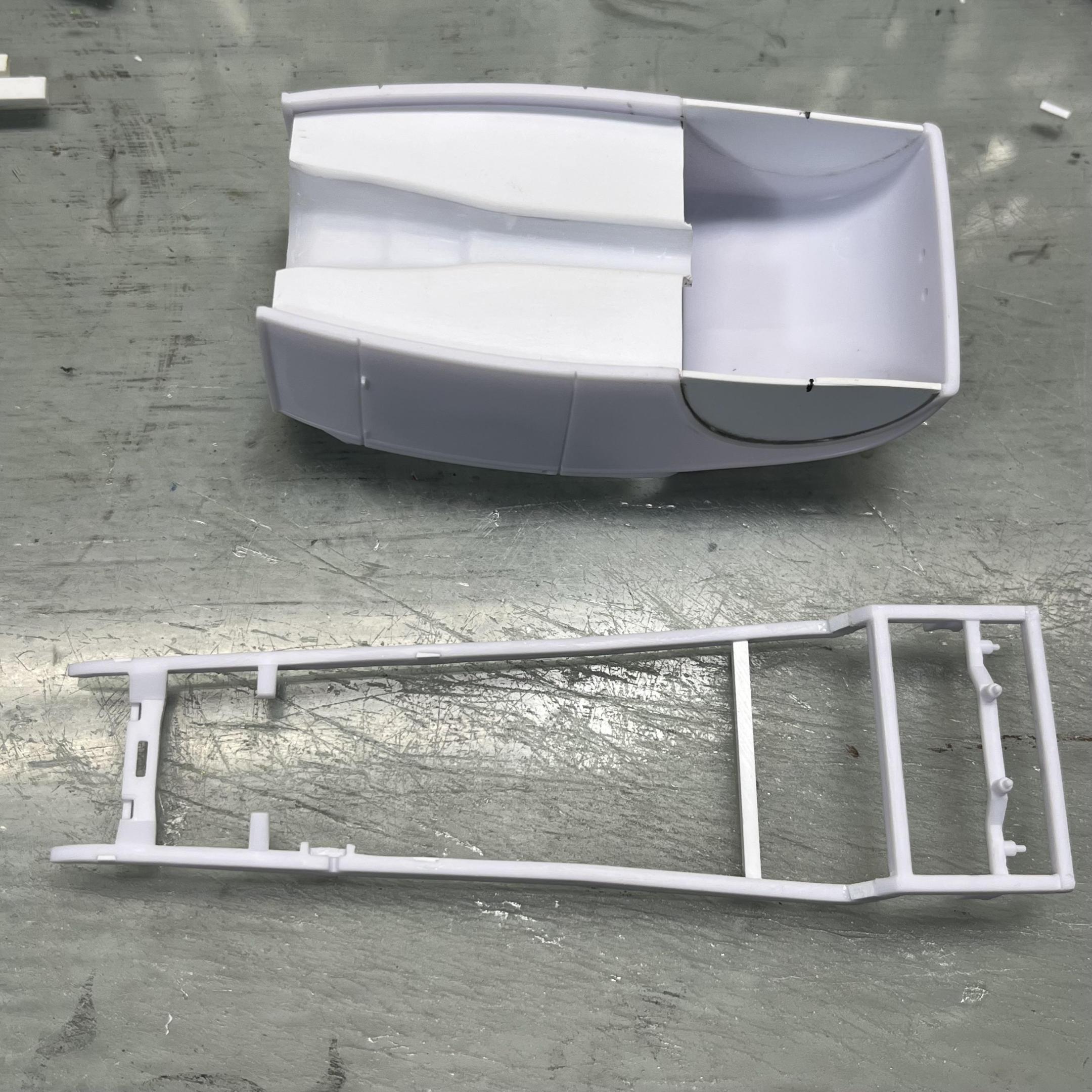

I haven't posted up too much lately. Now that I have the interior figured out, I can turn to the frame. The height and placement of the interior side panels (and thickness of the floorpan) determined how much the body would be channeled over the frame.
This is how much of channel, notice that the wheel wells have been filled in and the rear axle centerline has been marked....

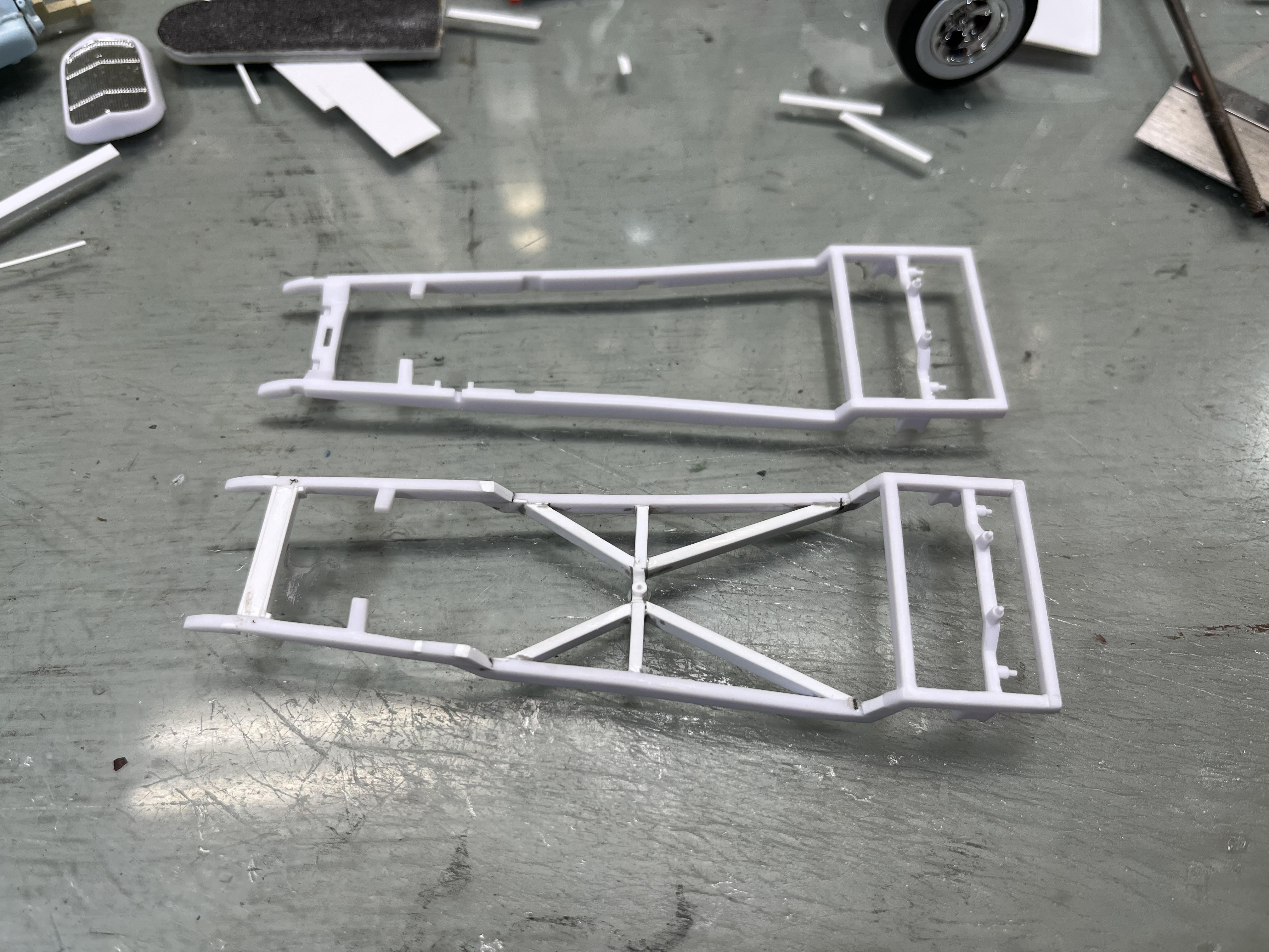

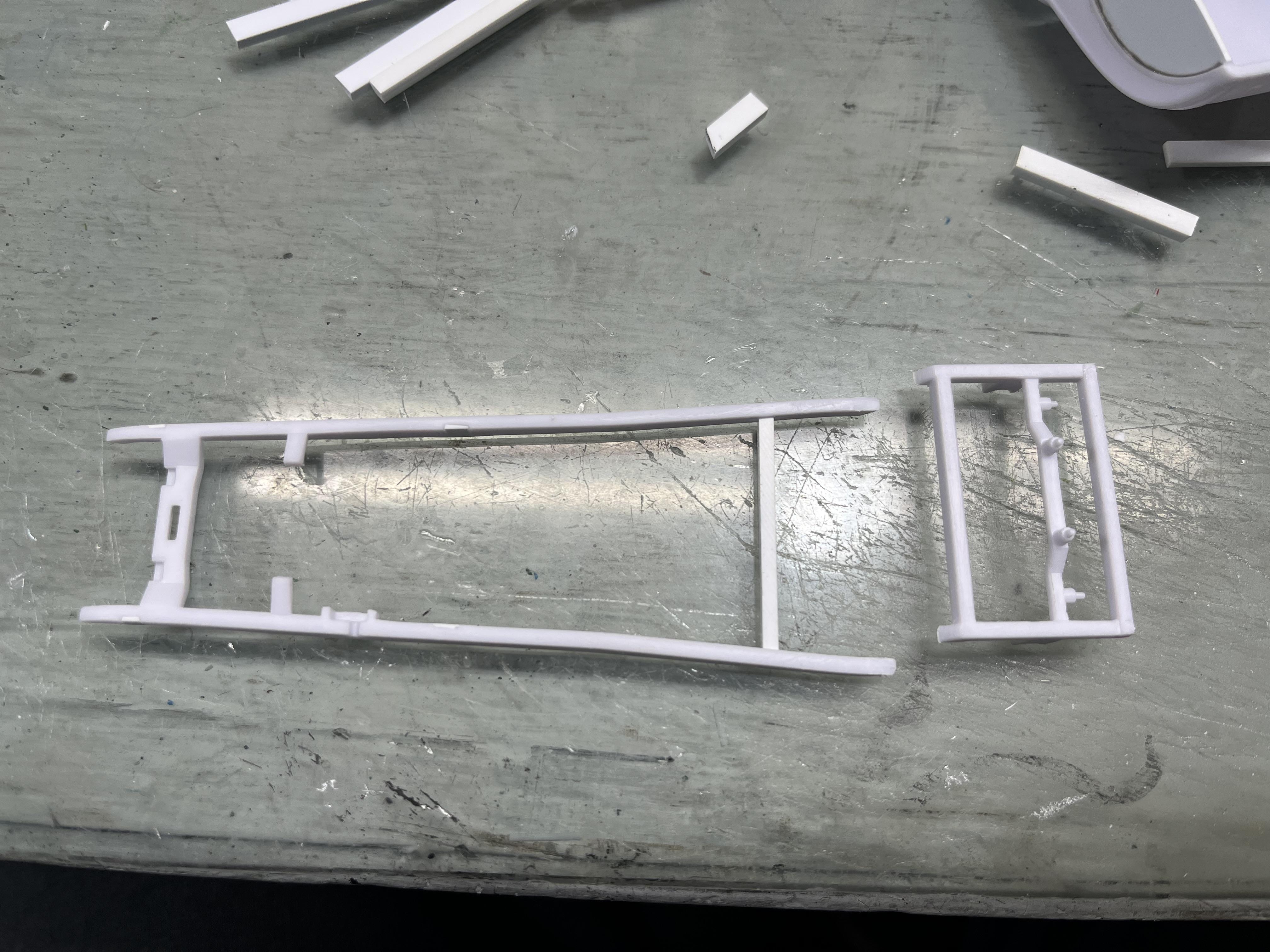

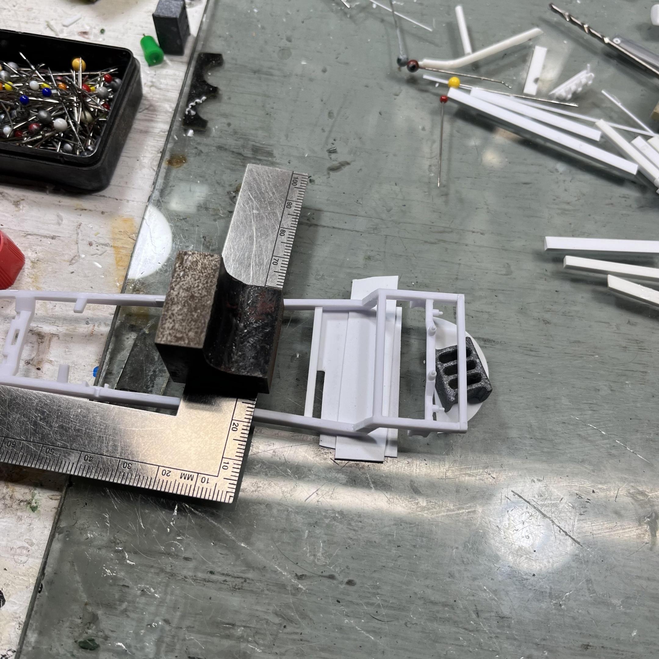

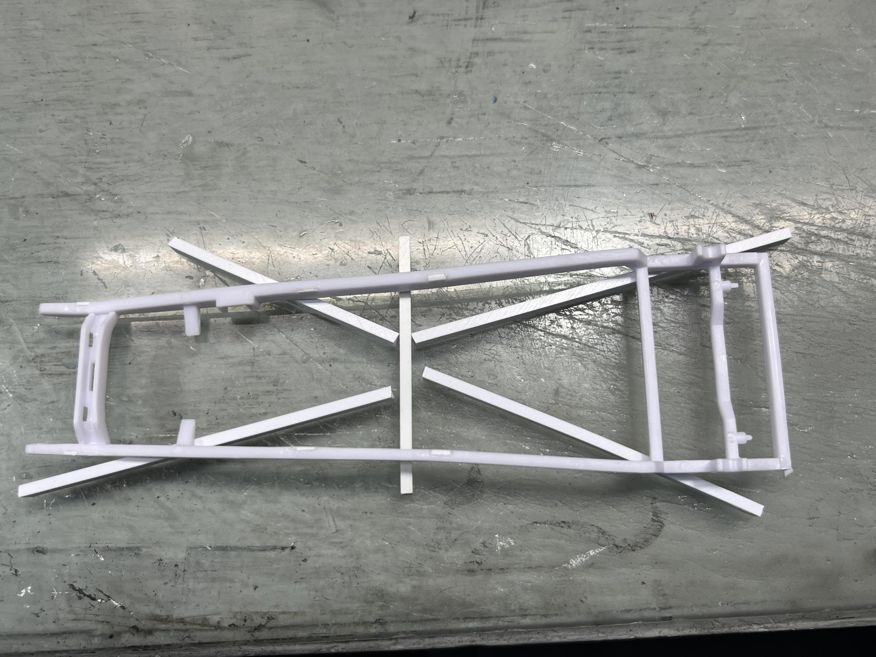

Next I took some length out of the frame behind the rear axle location. Since I'm going to Z the rear frame rails, the frame would have interfered with the inside of the trunk...
Frame Z is completed. Notice the temporary brace on the frame to keep the rails the right width while the frame is put back together......
88ggy9yg.thumb.jpg.d538f03650c4c2ae39b4267d67a07366.jpg-9ijjjpoi.thumb.jpg.372f72693979b7185e0e060c5d1a1391.jpg
I used some Evergreen rectangle to make the frame braces...
Here's a quick mockup of the body on the frame with the rear axle in place....

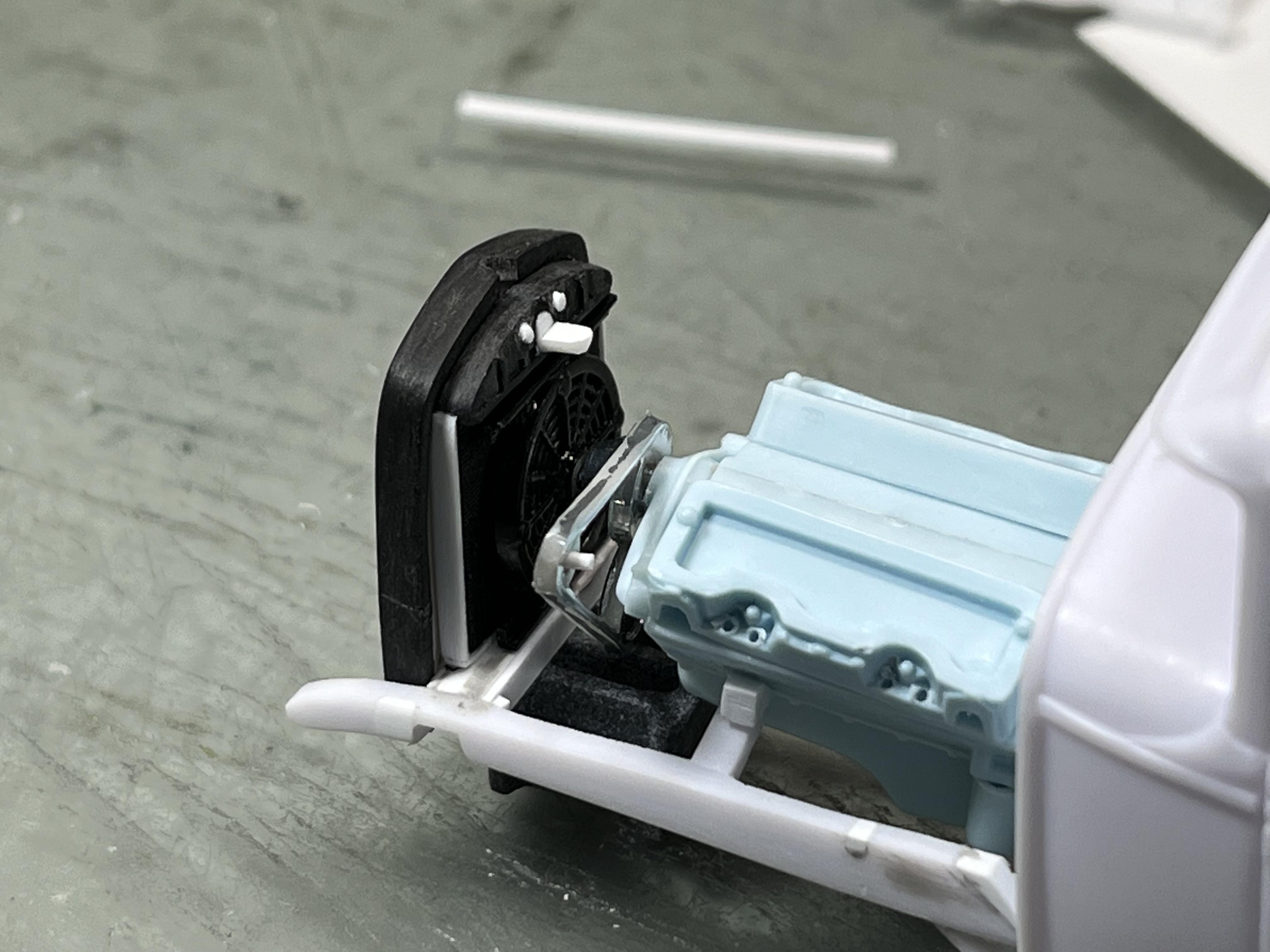

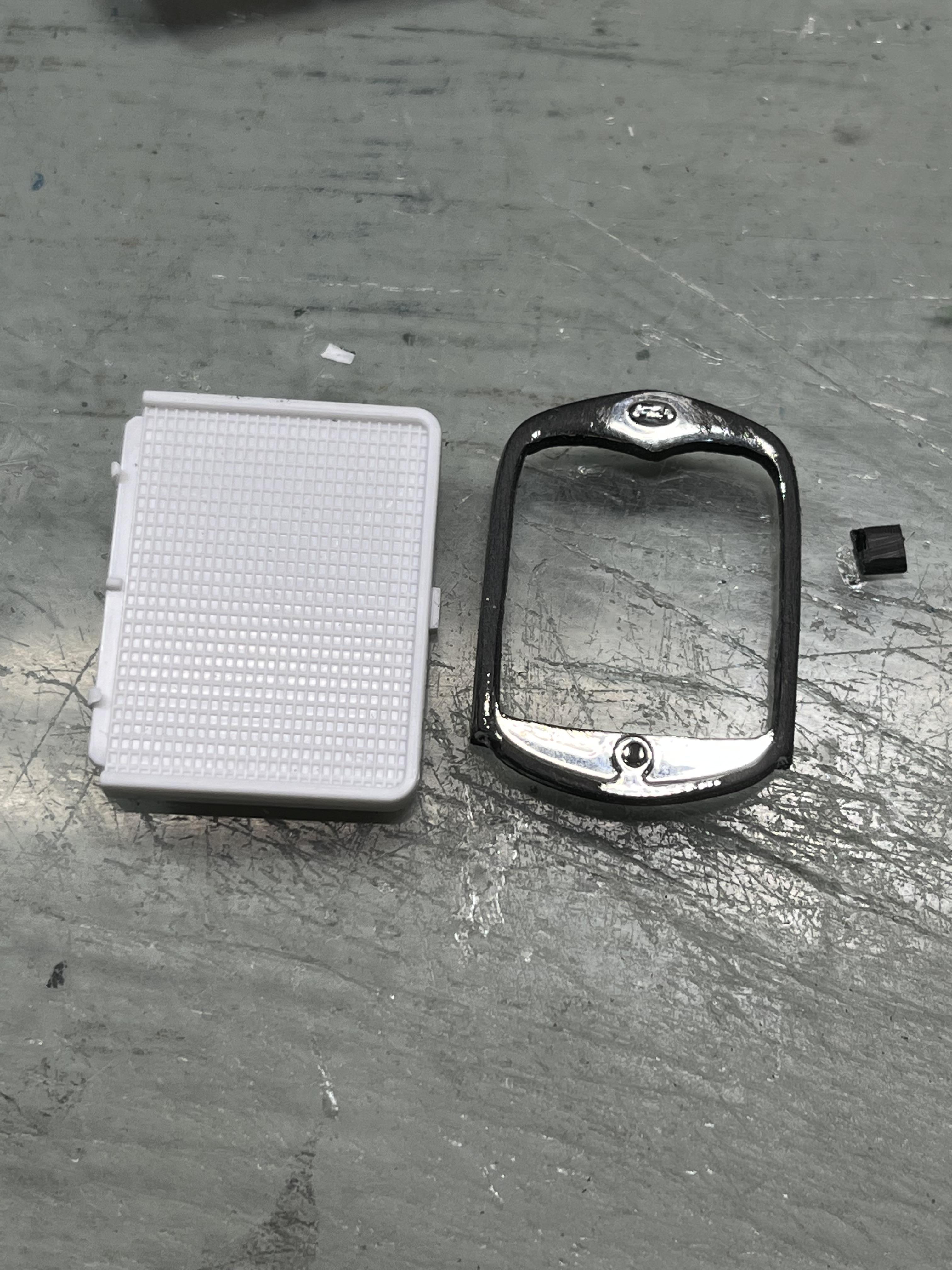

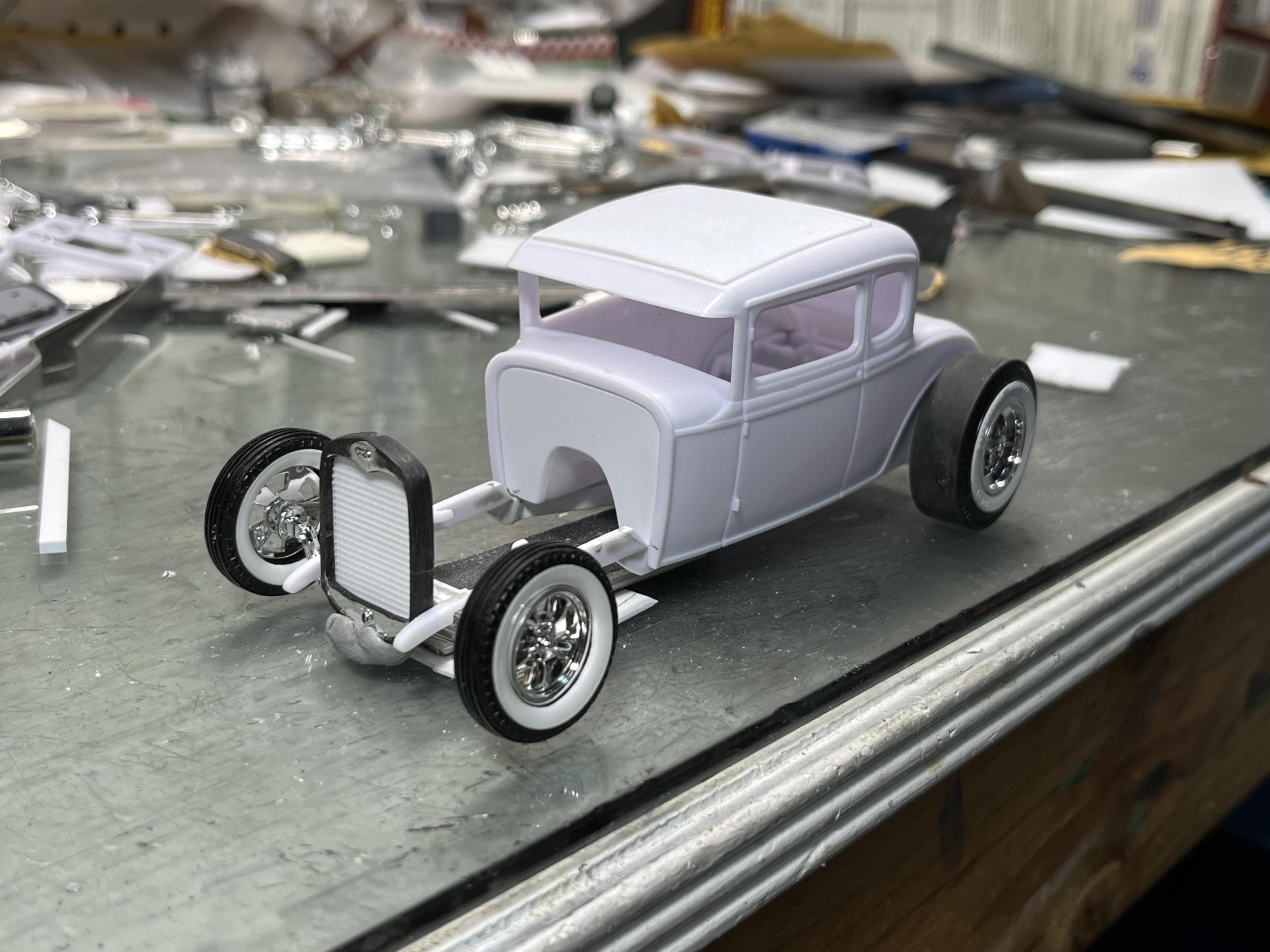

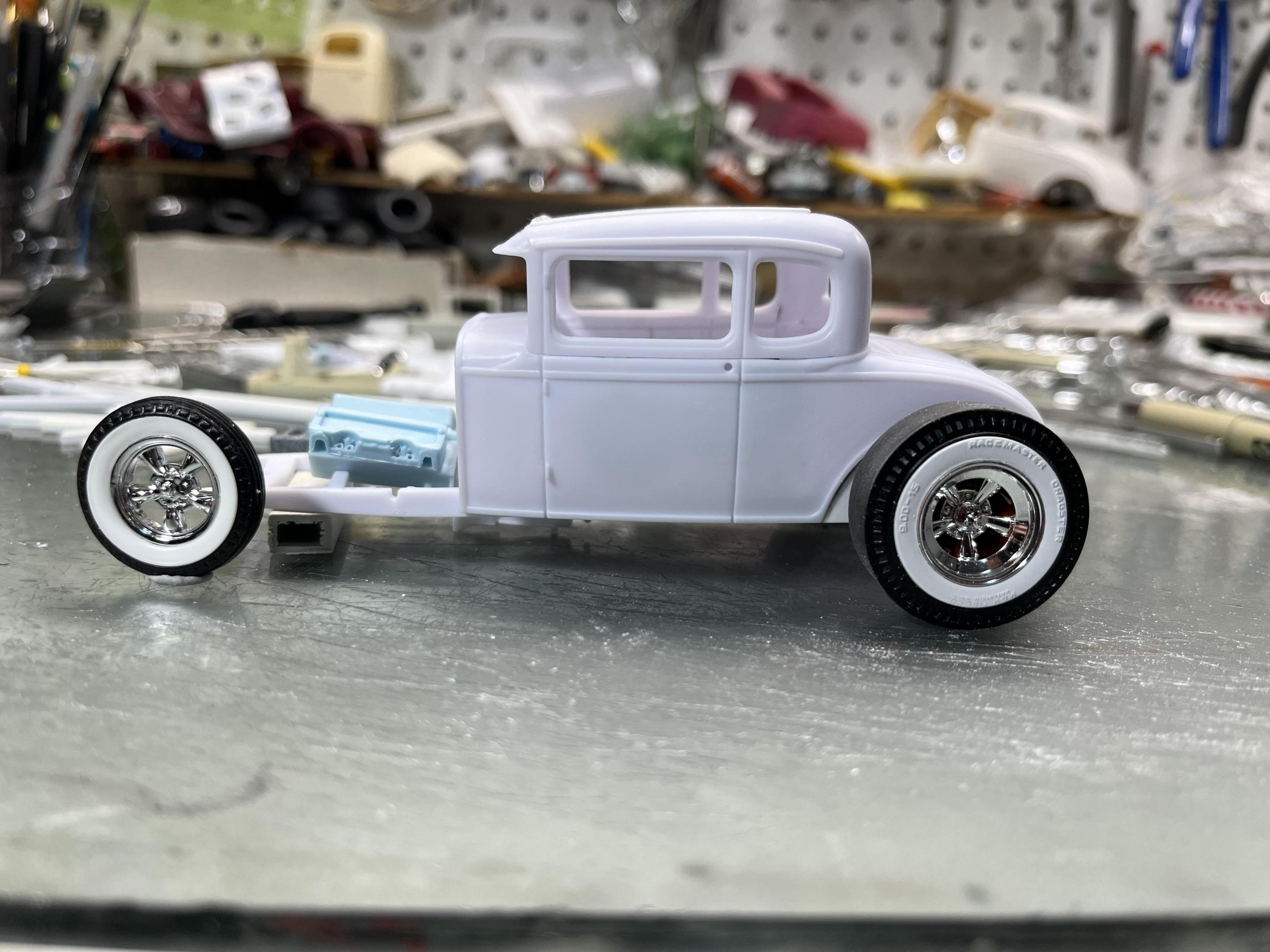

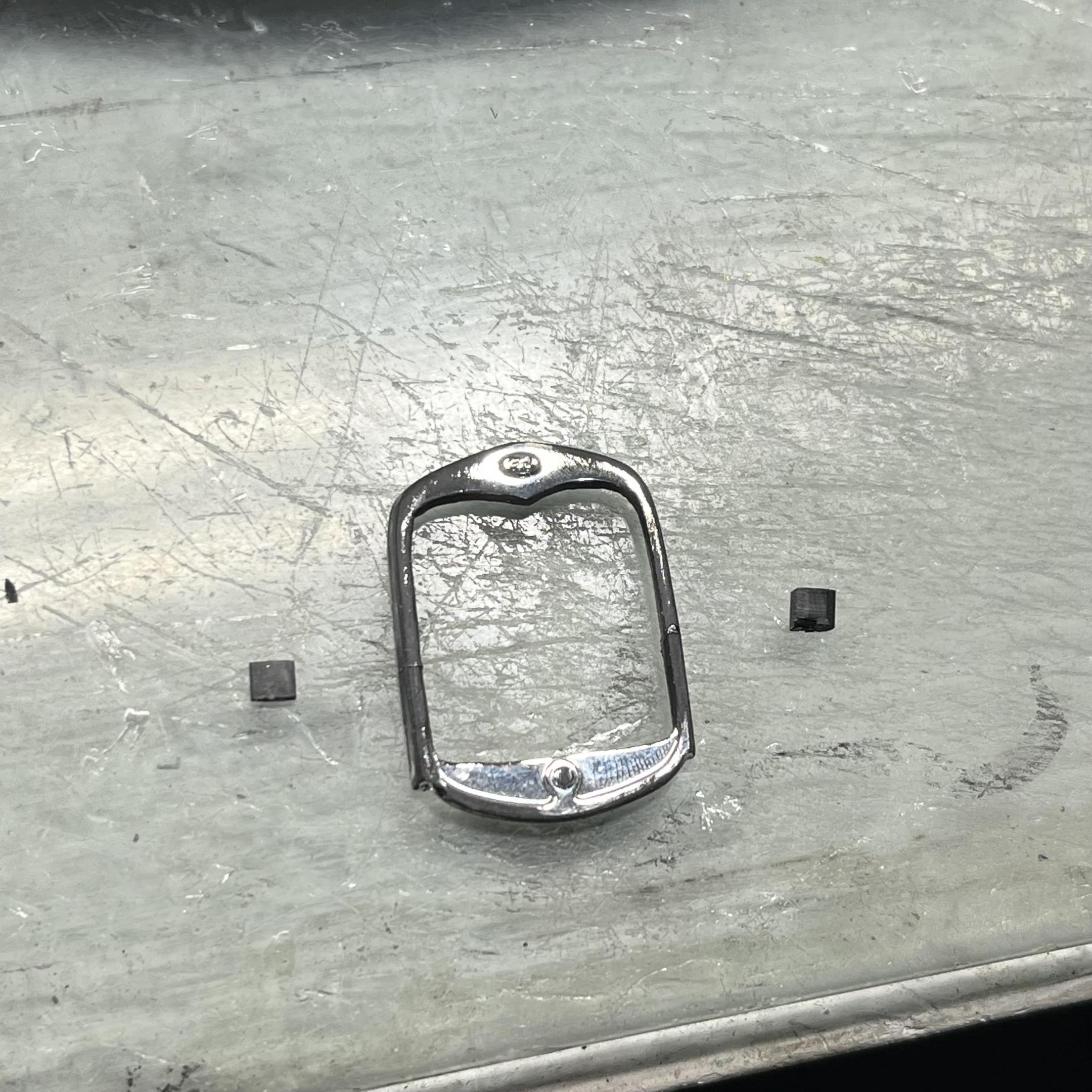

Now that I have the frame setup, final ride height could be determined. With the car this low, a stock height grille and shell was too tall. I really don't like the look of a grille taller than the cowl, it's just not proper. The solution was to chop a grille. A '32 grille would be the usual suspect, but I decided to keep it '30 and chop the '30 shell. To that end, I grabbed my trusty Dremel and carefully ground out the radiator from the shell, a little cleaning up with the X-Acto, files and sandpaper dialed it in...
The chop is subtle, an RCH less than 1/8th of an inch. I didn't want a squat grille such as the goofy looking American Graffiti coupe overdone grille shell chop (no offense to anyone, an iconic car...but that chopped down, dropped down grille?)...
The next order of business was to find a piece of radiator to fill in the opening. Not as easy as I figured. I finally found a big enough (and thin enough) radiator in the Revell '49 woody wagon (ya just never know where one will find the right part)...cut, cut, slice, slice, sand, sand some more, NOT TOO MUCH!!!
It's going to look about like this...the shell will be slightly notched over the crossmember and will a bit further back...
The engine side of the radiator with the fan is dropped in place. Obviously, it will be tightened up once it's all put together.
Next up are modifications to the intake and output side of the W motor...
