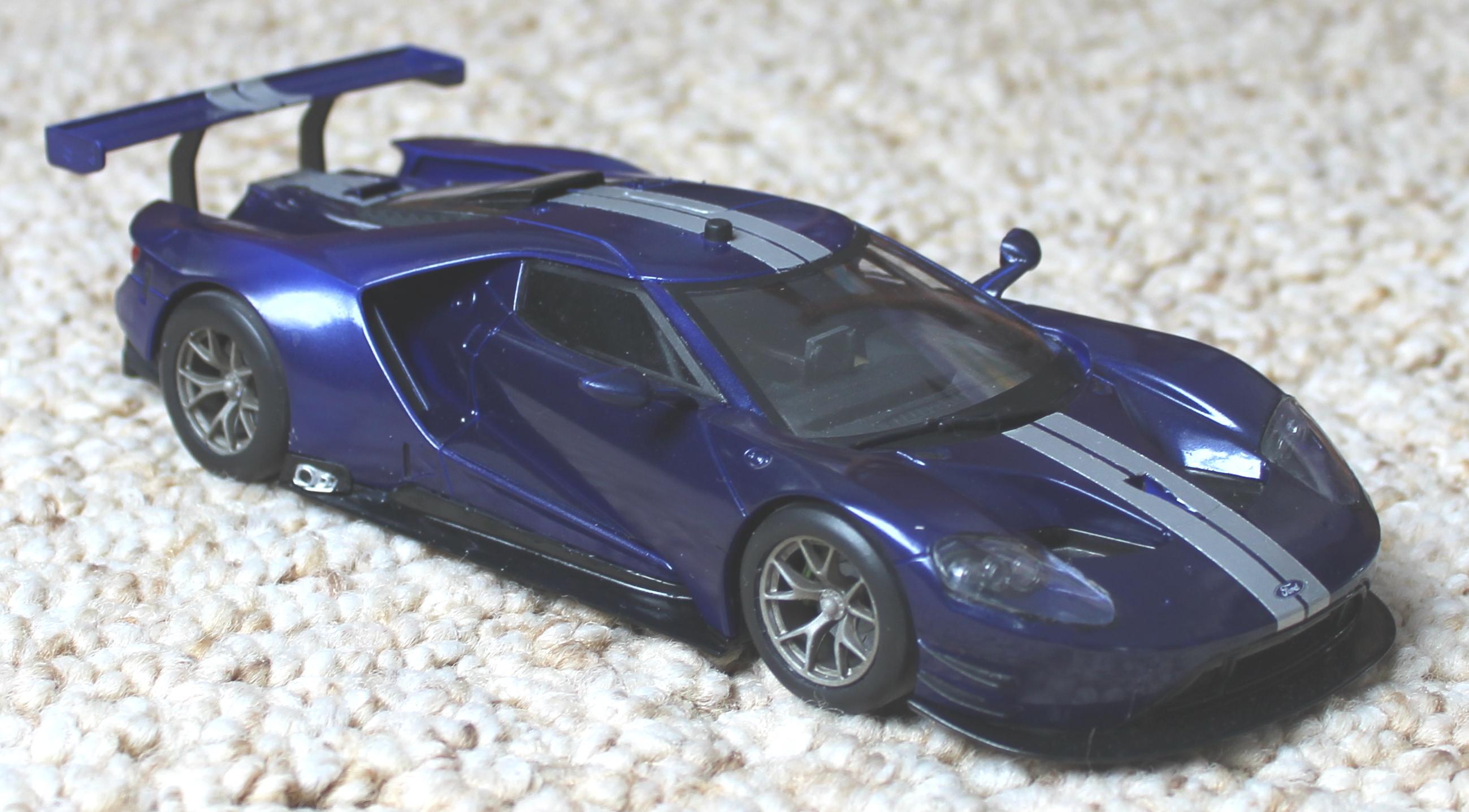

Good Evening,
Tried something a little easier after my previous build. Figured I'd give it a decent paint job and a little brush painting for detail. I stayed with blue for the body (decanted Tamiya TS-19 Metallic Blue) over grey primer and cleared with TS-13. The interior was painted semi-gloss black (Tamiya X-18) with factory option white accents (I did a sub-par job on this). The wheels were painted with AK Metallizer White Aluminum.
What I learned:
1. The parts seem to be a different type of plastic, perhaps a little softer.
2. The panel lines were quite wide and extra care had to be taken with the scriber not to make a jagged mess - fixed a couple of those with putty.
3. White glue does not self level - even thinned with water. The side mirrors are hollow so I thought I could fill them with glue and paint them afterwards. Fail.
4. I prefer TS-13 over X-22 as it dries much quicker and less prone to fingerprints.
Thanks for looking.

That actually turned out really nice!
Other than ride height, I don't think it needs anything changed at all.
Probably wouldn’t have been too difficult to lower this one. Really wanted the Tamiya kit but I heard it can be a tricky one to build.
Great looking GT, although a simple kit it turns out quite nice. I have the Tamiya kit and I will have to study more before I commit to building it. And I agree TS 13 is what I use 90% of the time, I also use Alclad gloss coat for some projects, it is a little trickier to apply though. Nice choice of color.

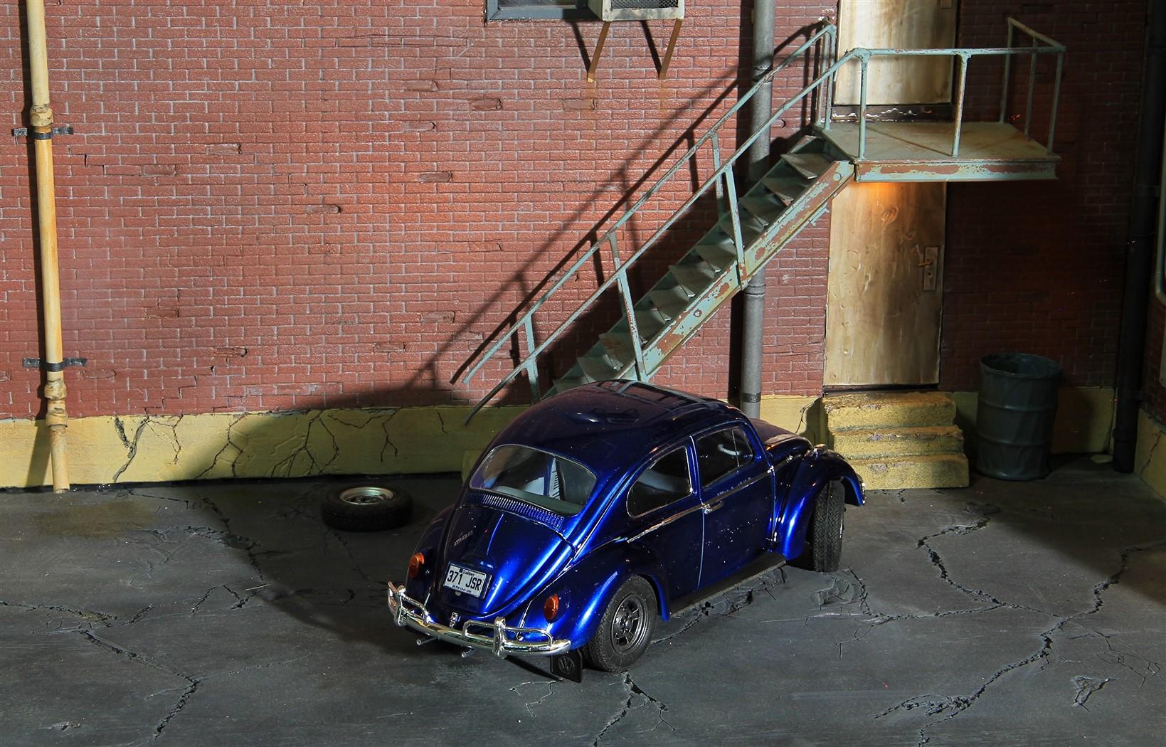

The base coat is straight forward. The color coats work best in light coats and 5 to 10 min between coats. The clear is a little bit more tricky at least it was for me. What works  best  for me  is to lay 3 light coats and wait 5 to 10 min in between. For heavier coats I wait overnight between each heavy coat but 2 to 3 hours should be fine. I you coat too early you risk getting orange peel  so I just leave plenty of time to let the underlying coat to cure (probably a little shrinking too ) . It polishes nicely after that but be prepared to have a dust magnet, I don’t know why but  this type pf paint attar acts dust like no other paint that I have used.
Here’s a bug that I recently did in cobalt blue. I hope you won’t mind showing it on your thread. As you can see even after cleaning it just taking the pictures brought some dust on it.

@happy grumpy Thanks for the detailed reply. I haven’t been airbrushIng that long and likely would have made a mess with my current process. I’m going to save your tips for when I build the kit.
Your Bug looks great and the set is awesome, too. ?
