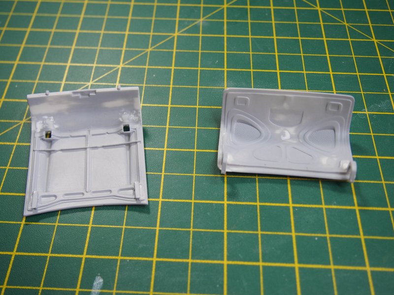

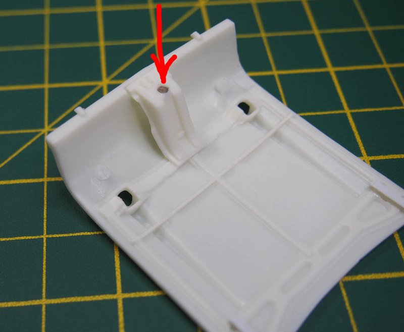

Just a small update on the '57. I've been getting the body ready for paint. In the pic below the red arrow points to a frame that I've scratch made. This will be behind the grille and barely be seen. It will allow me to attach a tiny magnet that will hold the hood shut.
Below, you can see the magnet in place. Once this area is painted satin black, I'm hoping the magnet will not show quite so much. The kit allows for the hood to be displayed in the open position with a pair of rather nice hinges. If you want to display with the hood shut then you have to leave the hinges out. I want to display the model with the option to do both, so rather than glue the hinges to the body, they are held in place with magnets. The idea is that I can remove the hinges, set them aside and close the hood. Then, if I want to display with the hood in the up position I can put the hinges on. I hope this works as I hope.
Under the hood I have fitted another magnet. This lines up with the one on the body. Yes - I did ensure the magnet was the right way round to attract and not repel.

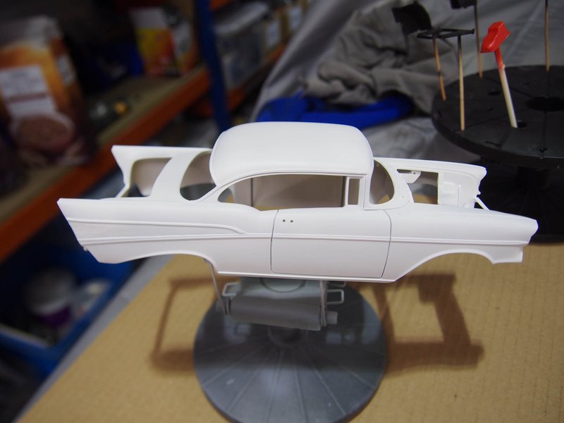

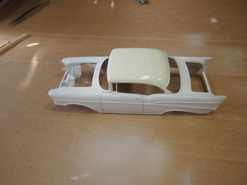

I've added some light grey Mr Hobby primer. I find this makes it easier to see imperfections in the body much easier than the white plastic.
I struggled a little with the front bulkhead (firewall). It didn't seem to fit right. Not sure if I did something wrong here. It's fixed with a little filler to take up the gap.
I had to make some minor tweaks to the opening panels so they fit flush, and now its ready for the proper primer - white this time.

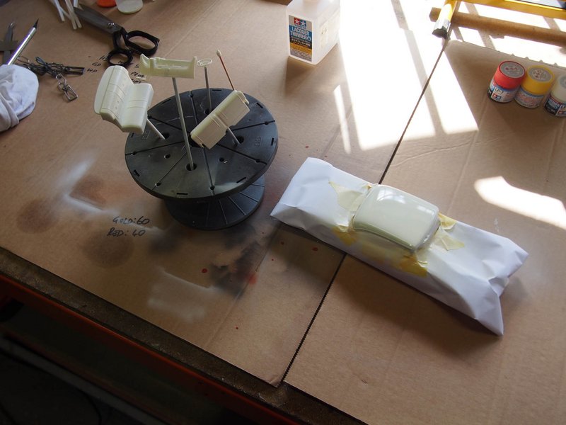

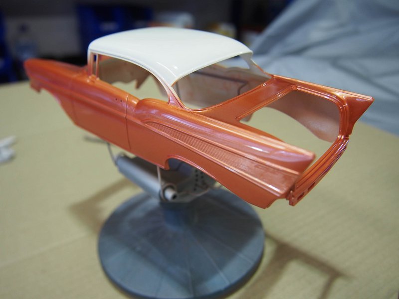

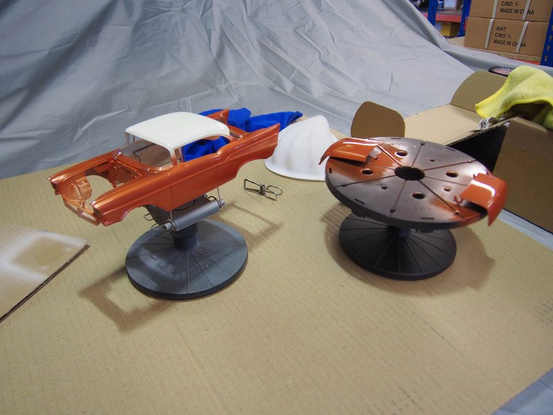

Finally - an update for you all. I do all my spray work at my workshop - not at home. Usually I'm working on 1:1 cars, with welding and grinding going on, so its a devil of a job to clear the workbench and make a dust free environment that's for good spray painting. Once the air-brush is out I usually do as much as I can over a few days.
A few imperfections on the underside of the panels taken care of.

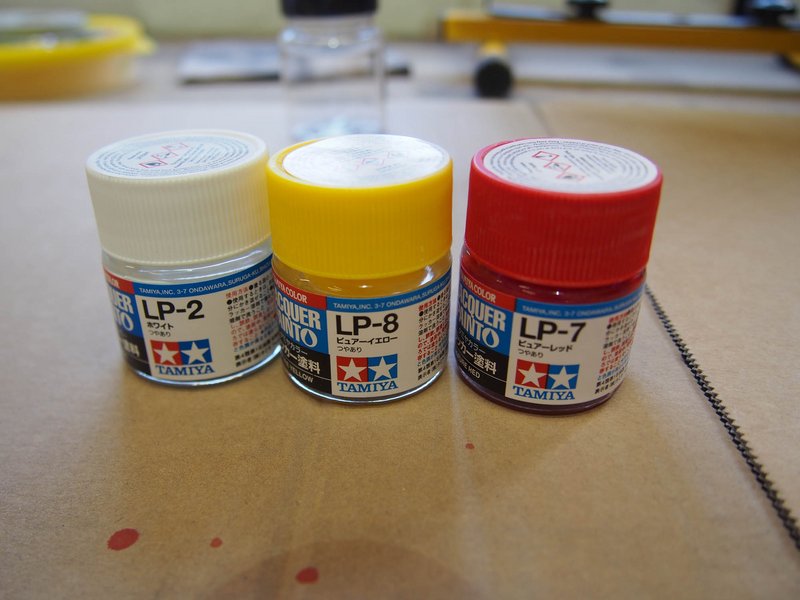

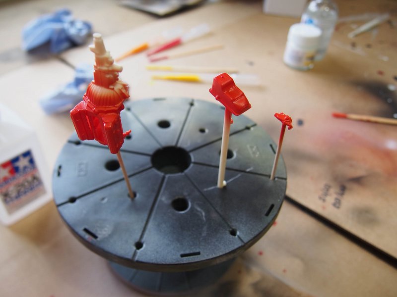

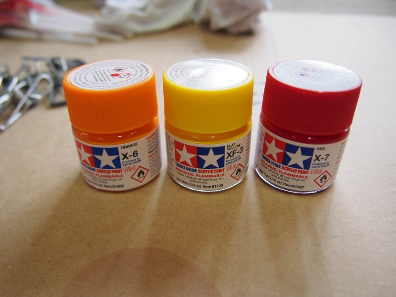

Using these three colours I mixed up a reasonable 'Chevy Orange' for the block and pan.
First I used a grey Mr Surfacer 1000 primer. Flattened off, and then white Mr Finishing surface primer 1500. I like this stuff as it goes on quite smooth and is more opaque than other white primers I've used.

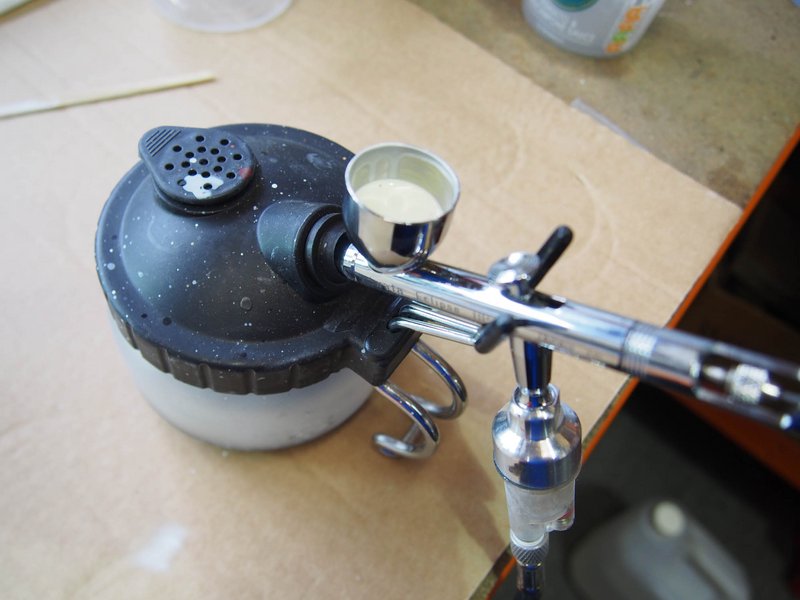

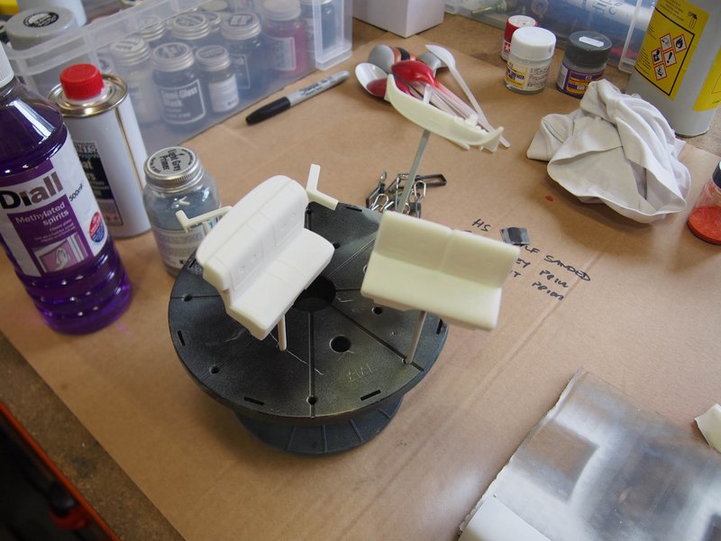

I used these three colours to mix up a creamy white. Mostly white, with a hint of red and yellow mixed in. I think the colour is called Adobe beige or maybe Imperial white? This is for the interior and the roof.
I'm just 'eyeballing' this - no science involved. I think it looks about right.

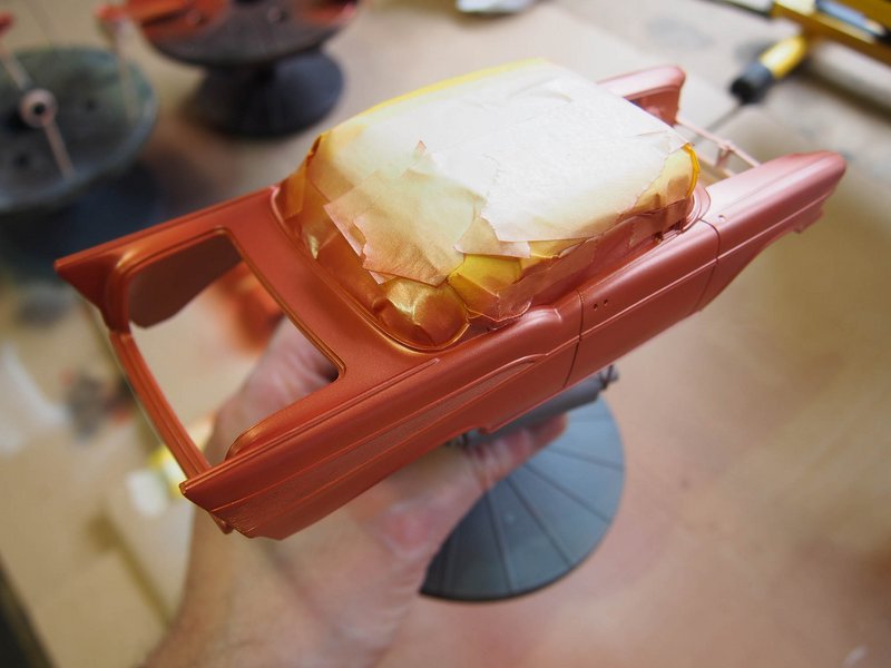

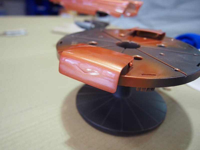

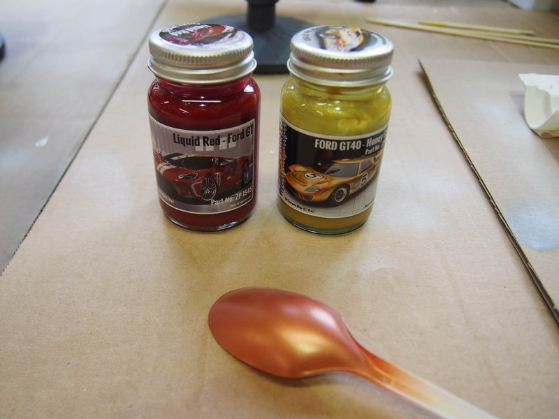

Time for the Sierra gold! As before, I'm just eyeballing. I'm using a mix of Zero's Liquid red, that will eventually be used on my Tamiya Ford GT, and the GT40 Honey Gold that I used on my ill-fated 68 Dodge Dart. Together, I'm hoping this makes a good Sierra Gold. The lighting in my photography and the digital screens do change colour perception a bit. I wish I could show in these pictures what I actually see.

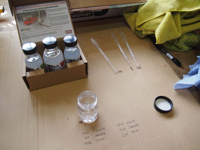

The trunk lid got a spec of dust in it so I had to sand that down and spray again the following day. Luckily the pot of paint I mixed was still OK as I would never achieve the exact same mix again. Spraying metallic terrifies me! Unlike a solid colour, you can't just sand out a dust spec without leaving a 'scratched' look to the metallic. I left the Gold finish for a few days and then mixed up my favourite clear - Zero Paint's Diamond 2K.
With the body painted Its always a sense of relief. I tell myself that all the hard work is done, and it will be plain sailing from here on. It won't!
I'll leave this a couple of weeks before polishing up the clear, and then the worst bit (for me) - Bare Metal Foil. I've not had much luck with that stuff in recent times, so this might be a job I put off for a while.
Thanks everyone for watching and your encouraging comments.

Great looking paint finish and the color looks correct to me. The Sierra Gold and Adobe Beige was one of the best color combinations that Chevrolet used for the '56 model year and beyond. White was often the secondary color as well. I enjoy watching your attention to the fine details and function of the hood, sorry, Bonnet, and the Boot.
  • Like 1

Looks to me like you nailed the color. Gonna be a beautiful 5-7.
  • Thanks 1
Those are some beautiful color combinations you came up with. And it looks like the paint laid down quite well for you.
