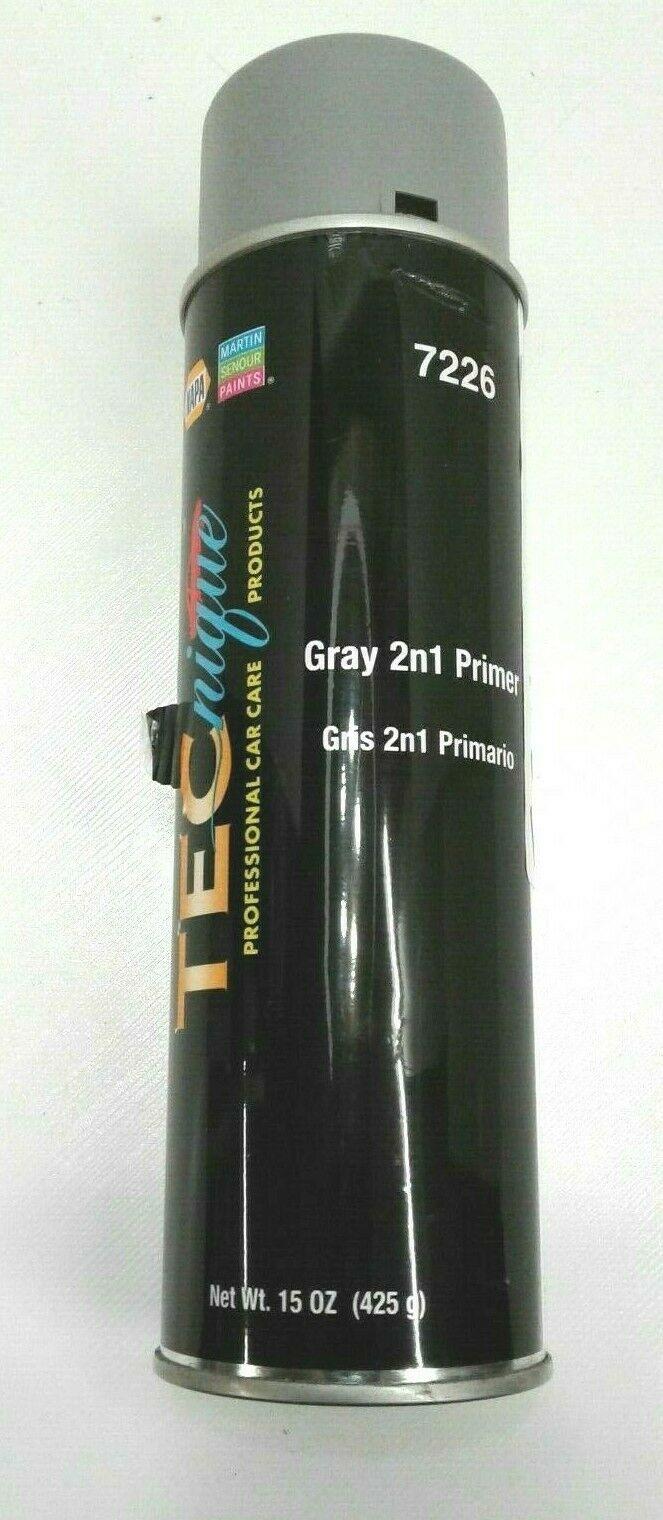

RSchnell Posted June 23, 2022 Posted June 23, 2022 If you have a NAPA Auto Parts near by- I've had good luck with their spray can primers. Huge 15oz can for $10-12. Sands nicely. I've sprayed 15-20 1/25 car bodies with the can I have and still have enough left for another 5-10. I've found this primer at Ollie's for $2.99 a can as well. I've also used Dupli-Color spray can primer with success. 1
