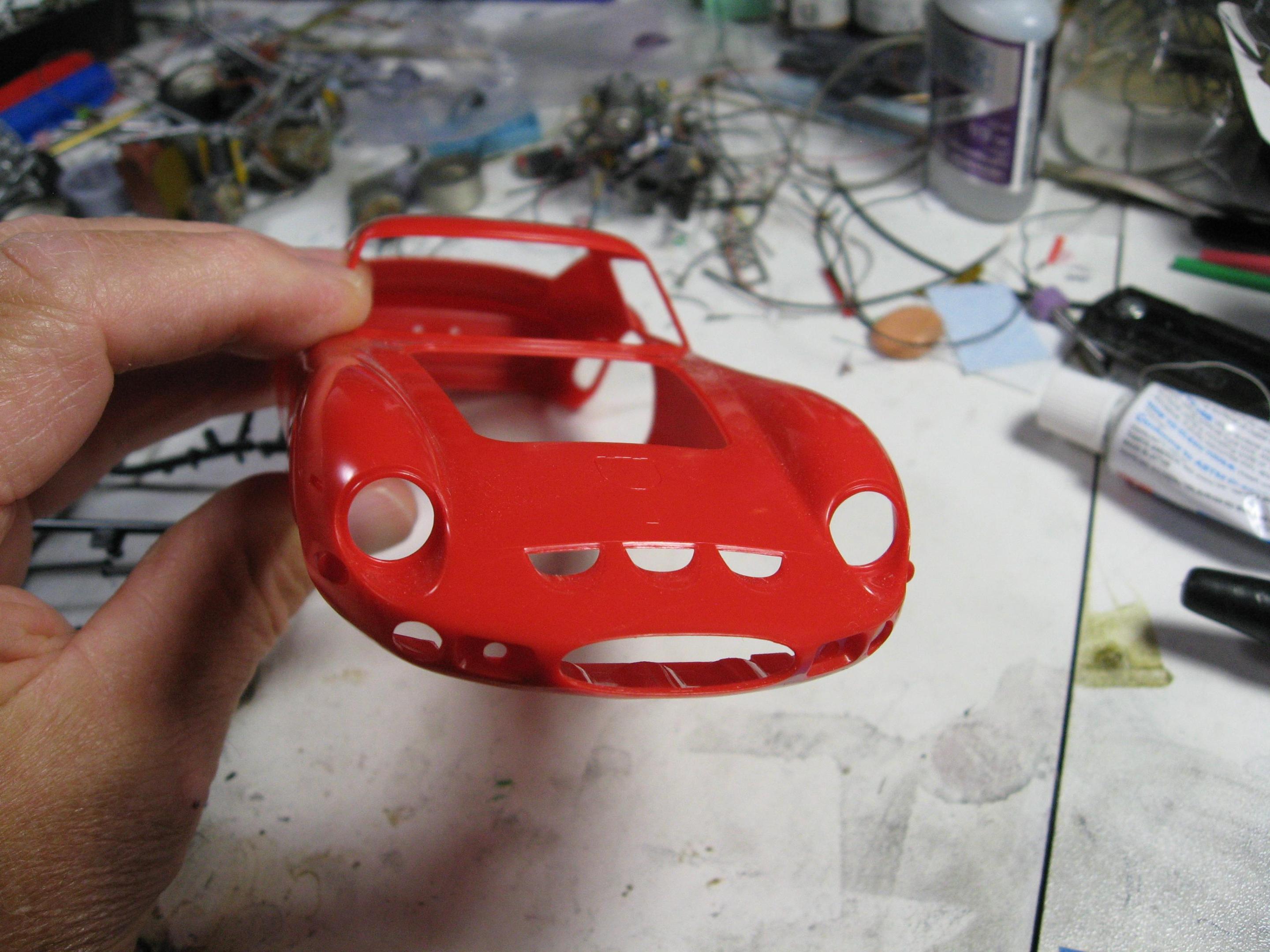

Ace-Garageguy Posted September 12, 2022 Posted September 12, 2022 On 8/27/2022 at 8:57 PM, absmiami said: Ace - I have a fetish for really cluttered work benches - please post a shot of yours before you clean it up … Expand

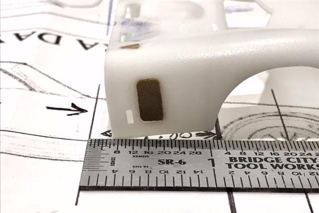

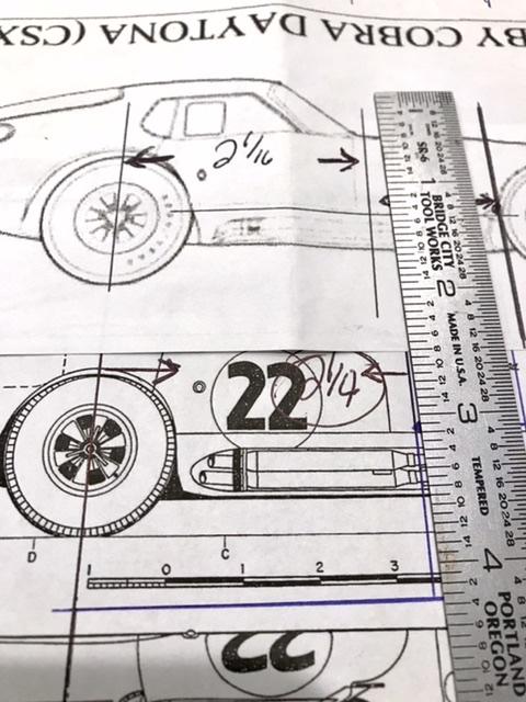

absmiami Posted September 12, 2022 Author Posted September 12, 2022 Here’s what went wrong the Bradford HRM Daytona body appears to have mastered based upon drawings published in 1964 in the English Model Cars magazine - these drawings were generally good - but the artist often did not have detailed measurments - so mistakes were made … the wheelbase was correct but the body measurments differ from those done by an architect who measured 2287 - since the body length is too long on the Model Cars drawings - the bonnett got short shifted to come up with the right wheelbase … 1

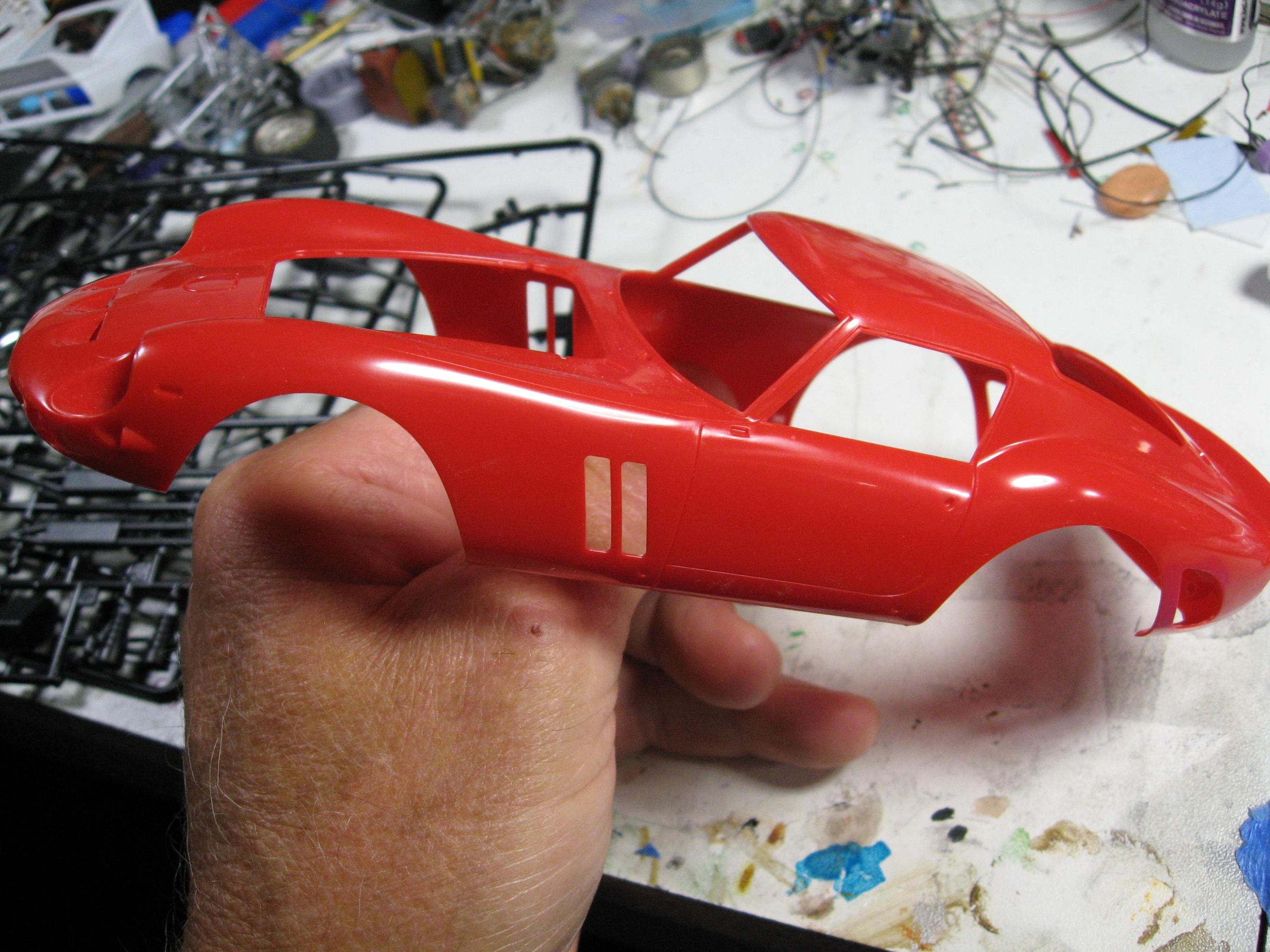

Ace-Garageguy Posted September 12, 2022 Posted September 12, 2022 (edited) On 8/27/2022 at 7:41 PM, absmiami said: Ace - 23 and 32 are yours - IF you post the kits - and The post includes some initial work - per my Cobra Daytona post … Expand Gloobomb Monogram 275P, to be race #23. This is going to be more work than I thought. Teardown complete except for sawing off the heavily glooed roll bar fairing and interior bits. Getting the wheels out of the tires without destroying anything was as close to brain surgery with a chainsaw and a hammer as I'm likely to get. The builder apparently used what remained of the tube after assembling everything else to make sure the wheels would hold together at 200MPH. Testors/Italeri 250 GTO, with Deeks wire wheel centers (which I may or may not use), to be race #32. Though I prefer the proportions of the Gunze GTO (the only other Ferrari GTO kit I haven't moved west yet), this one has the correct rear wheel arches and lips, and a slightly flatter nose that looks,to me, more like the Sebring #32 car...but it needs an additional gill on each front fender. Kit had been lightly started. Front lower pan sawed off, templating gills to add one forward. Roughly transferred initial drilling guide. Edited September 12, 2022 by Ace-Garageguy CLARITY
absmiami Posted September 12, 2022 Author Posted September 12, 2022 Therefore the bonnett behind the wheel well is about 3/16s short - which is why Ace and I need some renshape …. Now once this change is made I’ll probably lose the scale correct wheelbase - but the plus is that the engine comparent will look better - and the bonnett will look correct - its the best we can do until someone sits down at a computer and draws a correct Daytona for 3D printing [any takers?]

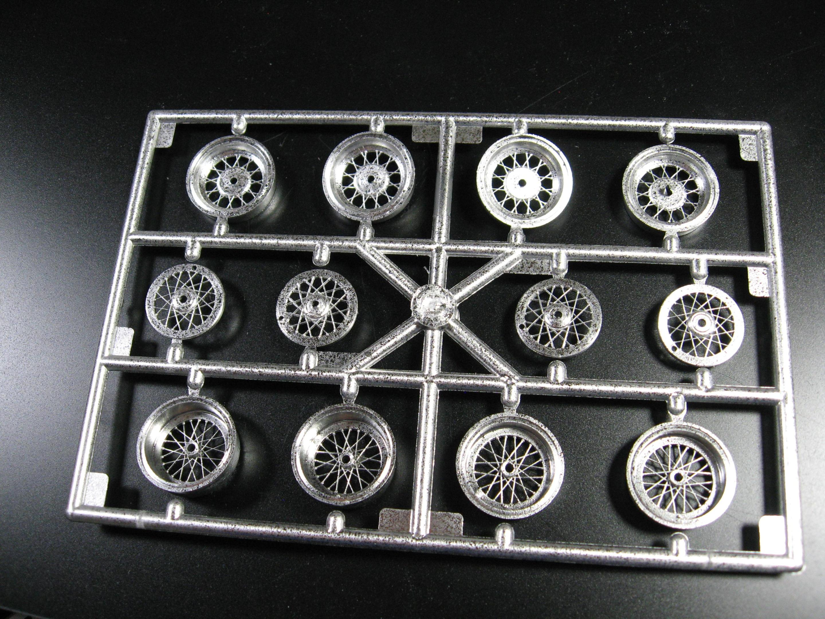

absmiami Posted September 12, 2022 Author Posted September 12, 2022 On 9/11/2022 at 10:10 PM, Randy D said: For wheels I will use the really nice ones from the Protar kit... For tires I will go with HRM's Dunlops. Before I go much further I need to consult with the Ferrari expert, Mr. Bradford. Randy Expand I had forgotten how good those Protar wheels were - years before 3D printing …

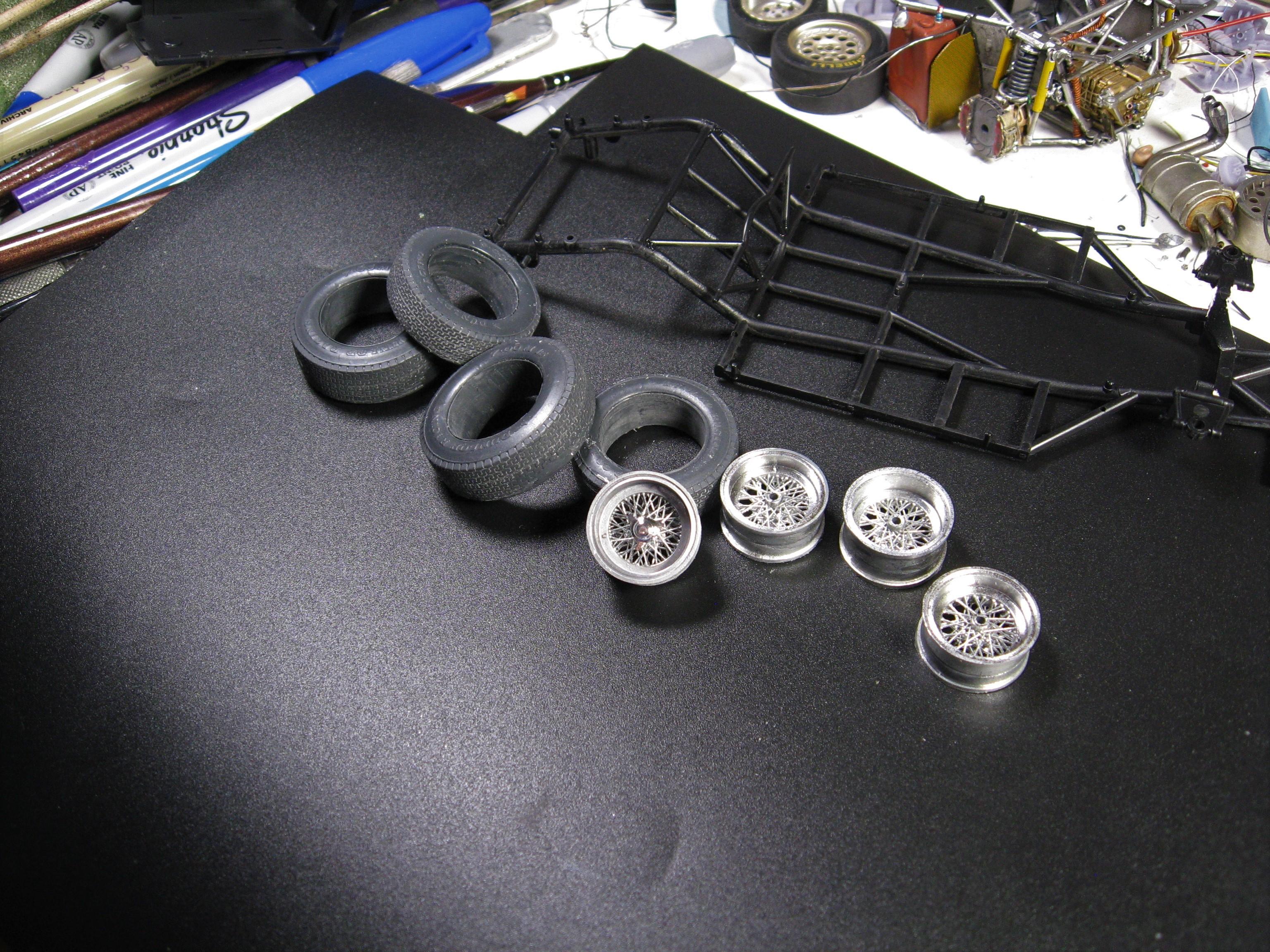

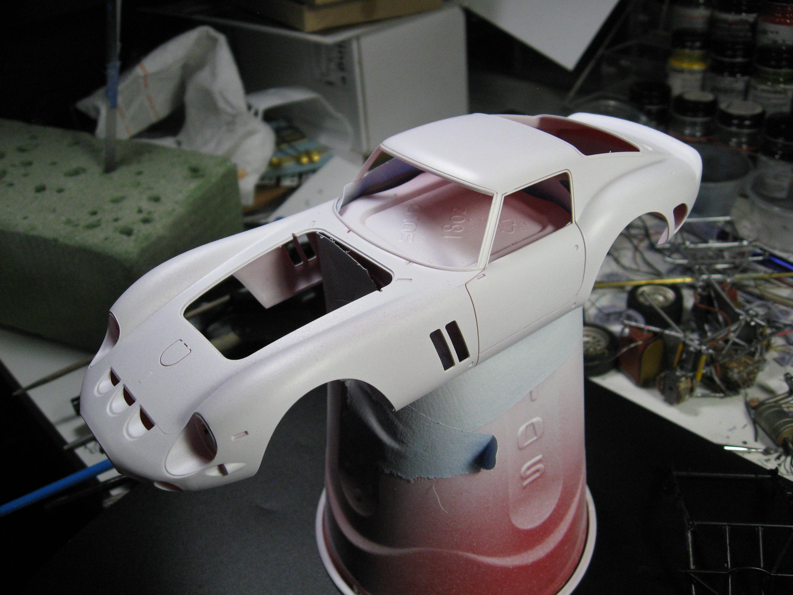

Randy D Posted September 16, 2022 Posted September 16, 2022 Nice surgery there Bill!!!! Like your attention to detail Andy:) Gary, looking forward to the Porsche build. That old kit really does have a bunch of parts!! Rex, Good choice there Sir. Misha, really cool choice! Do not see to many of these built. Some progress.... Squirted some primer on the body to see what I've got , looks pretty good.. Borrani's assembled, the one at an angle has been painted with a dull aluminum and added the chrome knockoff, looks like I will not be using the Dunlops, need to source some Goodyears... Question for our intrepid leader....okay to post photos from the William Jordan site? Randy 1

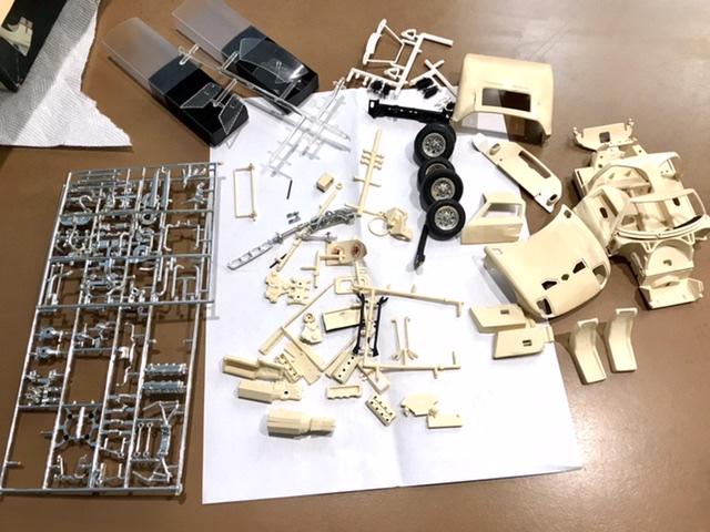

absmiami Posted September 17, 2022 Author Posted September 17, 2022 gather round , youngsters… this is the 1/25th scale Ford GT prototype kit - designed by the great Budd Anderson. with wire wheels - correct for 1964 - this is the car that graced the race program cover - and two were entered for the ‘64 race - they just weren’t quite ready - so I’m going to build the Number 9 program cover car - and i think Mr Chernosky will post one he’s built - but there’s a second entry to build - who’s in ??!

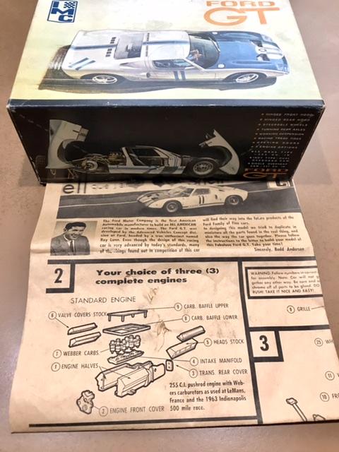

absmiami Posted September 17, 2022 Author Posted September 17, 2022 Box art … i had forgotten just how good this kit was - opening doors and very well engineered - with a fantastic chassis - Tamiya - 30 years later - couldn’t be bothered to engineer there sports car kits with opening doors - what’s up with that ?
absmiami Posted September 17, 2022 Author Posted September 17, 2022 One gripe - the engine is designed under-scale for ease of contruction and better fit - the difference is noticable -

absmiami Posted September 17, 2022 Author Posted September 17, 2022 Will need to source 1/25th wire wheels and Dunlop tires for this build - Randy - help me convince Bill C to make some …
vamach1 Posted September 17, 2022 Posted September 17, 2022 On 9/17/2022 at 3:25 AM, absmiami said: Will need to source 1/25th wire wheels and Dunlop tires for this build - Randy - help me convince Bill C to make some … Expand Do you need the kit wire wheels and Dunlop's? I should have a set.
absmiami Posted September 17, 2022 Author Posted September 17, 2022 My kit is complete - im jonesen for five 25th scale 3D printed wires …

Rich Chernosky Posted September 17, 2022 Posted September 17, 2022 On 9/17/2022 at 3:08 AM, absmiami said: gather round , youngsters… this is the 1/25th scale Ford GT prototype kit - designed by the great Budd Anderson. with wire wheels - correct for 1964 - this is the car that graced the race program cover - and two were entered for the ‘64 race - they just weren’t quite ready - so I’m going to build the Number 9 program cover car - and i think Mr Chernosky will post one he’s built - but there’s a second entry to build - who’s in ??! Expand Andy...I think have twice that many parts in my Ford GT junkyard. If you need something let me know. What are you going to do for an engine.. I looked and didn't find too much.
absmiami Posted September 17, 2022 Author Posted September 17, 2022 Probably just grow each kit part with some bits of Evergreen plastic - and I’ve got some 25th scale Webers in my parts box - the keys are to maintain the correct height and location of the rear axles and to make sire that the exhausts are clear of the suspension trailing arms - also deepen the crank case and open the chassis base plate for the bottom of the engine - see Mr. Ditton’s GT40 build ..
