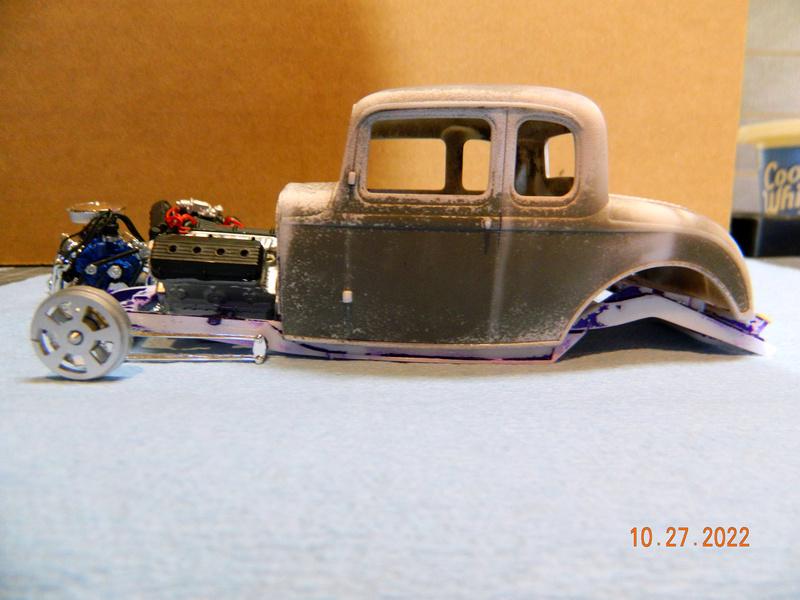

bluestringer Posted October 27, 2022 Posted October 27, 2022 I built this about 7 or 8 months ago. It was dropped then kicked and of course a lot of parts fell off. I just threw it back in the box, I never liked the way it came out anyway. So I am going to get out of my comfort zone and do something different with it. I'm in the process of stripping the paint now, I have Z'd the rear of the frame following Ace-Garageguy's tutorial in the tips section. I have also trimmed the spring perch on the front to get the front a little lower. I have three engine choices, the original Ford I first built, a 4.6 Liter from a 97 Mustang GT and a Hemi. Since I like Hemi's that is my first choice. Haven't looked at my wheel and tire choices yet, or what color I'm going with. This is something I'm going to try and work on while doing other builds, so may be a long time project or may end up not finished at all. Right now I'm working on a VW Beetle for my wife. 2
Zippi Posted October 27, 2022 Posted October 27, 2022 Nice James. Rebuilds are always nice when you take them in another direction.
customline Posted October 27, 2022 Posted October 27, 2022 (edited) Yup. Go with the old Hemi. Get some wide whites and tri-5 Bel Air hub caps. Channel it all the way down and paint it metalflake emerald green. Don't fill the roof, paint the insert white. Leave the exposed hinges. Von Dutch style Pinstriping, for sure......and lose the four link. Sorry, couldn't help it. ? Edited October 27, 2022 by customline Additional text
Bullybeef Posted October 27, 2022 Posted October 27, 2022 (edited) Any way you build it, a revell 32 is a great kit. I have another 5 window in the wings, just waiting for some special parts Edited October 27, 2022 by Bullybeef Spellin
Dragline Posted October 27, 2022 Posted October 27, 2022 Il be watching thisl resurrections are always a favorite.

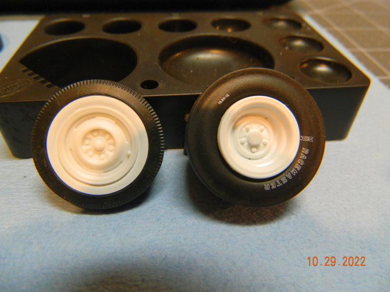

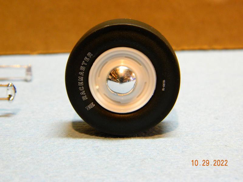

bluestringer Posted October 29, 2022 Author Posted October 29, 2022 I've always like baby moons, so digging further in the parts box I came up with this. I think this is the way I'm going. I'll paint the rims body color which I have not decided on yet. I don't know if you would call this West coast style or East coast style, but moon caps were popular here in South Georgia in the 60's. The front tires are from the Revell 66 Fleetside kit. Not sure where the Racemaster slicks are from. 1
Andrew McD Posted October 30, 2022 Posted October 30, 2022 (edited) A hemi and baby moons, a nice little slice of paradise no matter what color. This one looks like fun! Edited October 30, 2022 by Andrew McD
Chevy II Posted October 30, 2022 Posted October 30, 2022 Where did the wheels come from? Where did the deep dish rear one come from?
bluestringer Posted October 31, 2022 Author Posted October 31, 2022 21 hours ago, Andrew McD said: A hemi and baby moons, a nice little slice of paradise no matter what color. This one looks like fun! Thanks. 16 hours ago, Chevy II said: Where did the wheels come from? Where did the deep dish rear one come from? I'm not sure. I was looking through my parts box and found them, but don't remember what kit they are from.

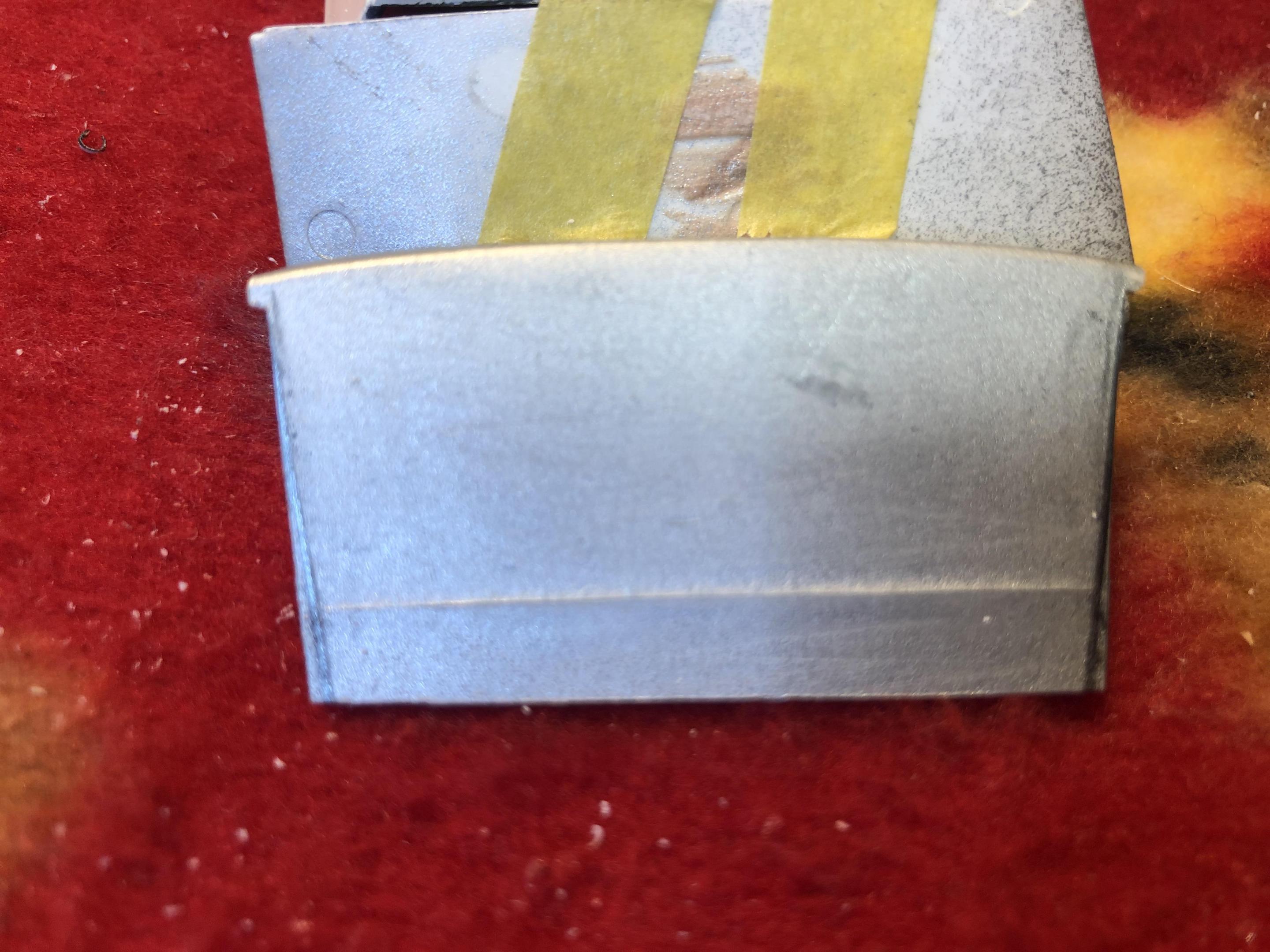

bill-e-boy Posted November 6, 2022 Posted November 6, 2022 Kepp up the good work. Kit bashing is challenging work but, in the end rewarding too. I recently channeled a 32 coupe. The interior sides had about 5mm cut from the bottoms. The rear wall was sectioned the same amount, but the shape was too wide at the bottom. The pix show the wedge shapes removed from the sides of the back panel form the interior side to line up with the rear wall. you can see the faint line where the rear wall has been sectioned. There are most probably a number of ways to section the interior but this is what I did
