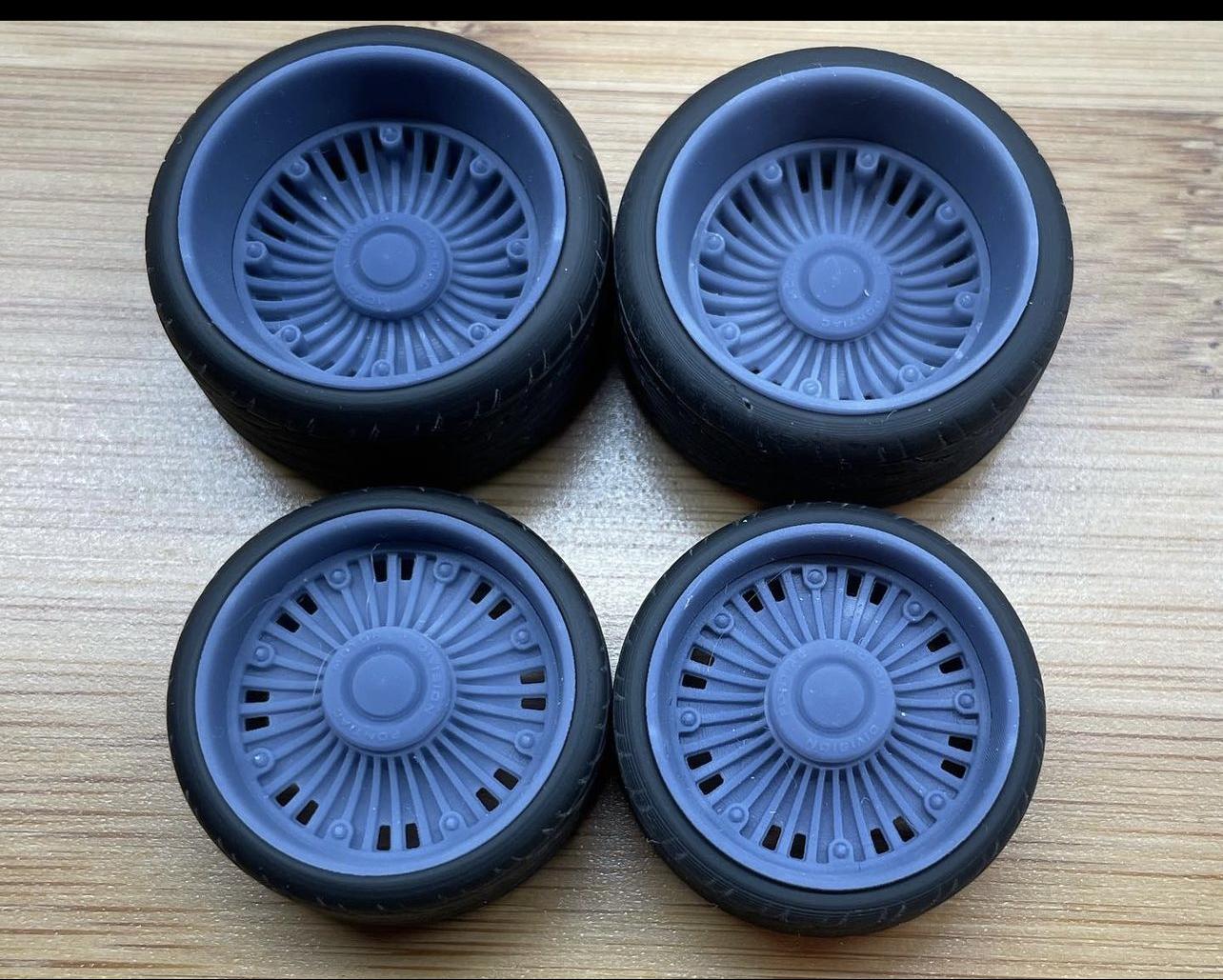

catpack68 Posted October 28, 2022 Posted October 28, 2022 (edited) Looking forward to seeing more progress on it.Zforcemodelworx printed these sets a few months that would look good on it.Not sure if he will print them again. Edited October 28, 2022 by catpack68 1

Bills72sj Posted October 28, 2022 Author Posted October 28, 2022 12 hours ago, catpack68 said: Looking forward to seeing more progress on it.Zforcemodelworx printed these sets a few months that would look good on it.Not sure if he will print them again. Those look pretty cool but the rears look a little too concave. I like the lettering on the center caps.

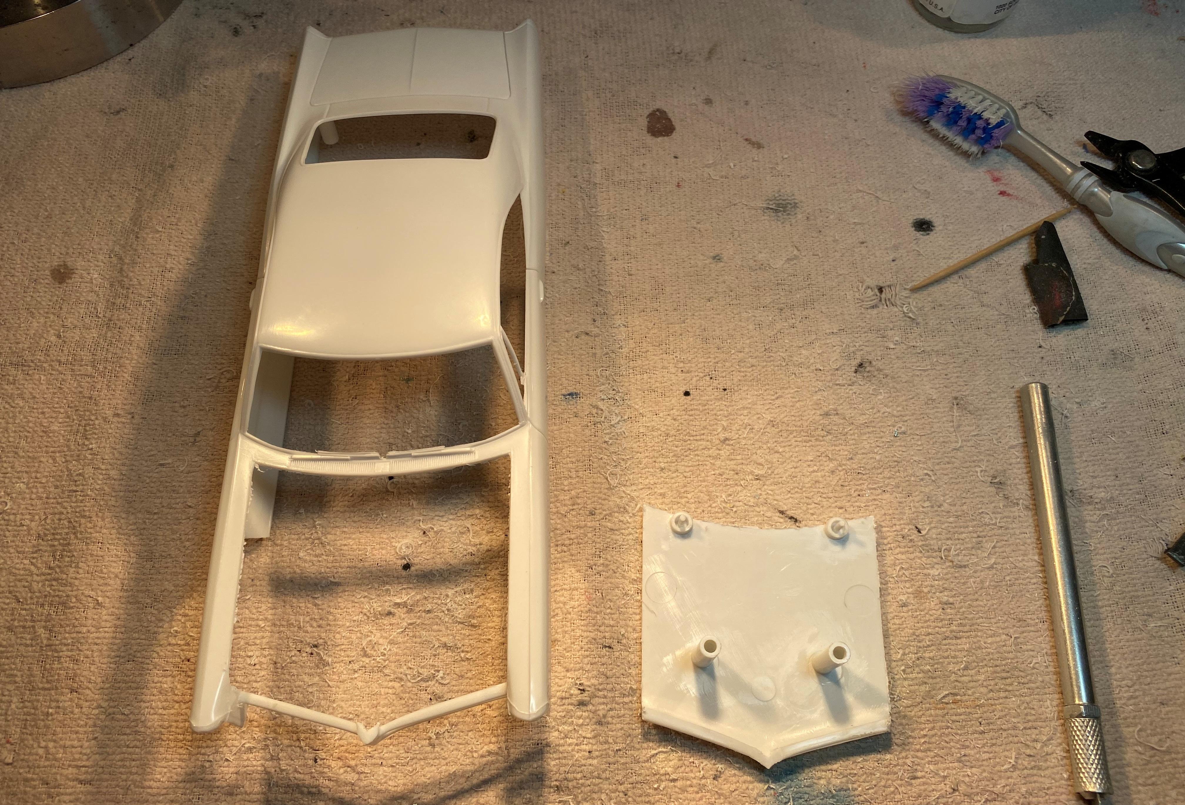

Bills72sj Posted October 30, 2022 Author Posted October 30, 2022 Made some progress last evening and today: All four bodies deflashed and sharp edges rounded a bit. Deeply scribed all the doors and trunk lids. Increased the definition of all the window trim. Removed the tiny molding seams at the base of the C-pillars. My new Tamiya Plastic Scriber II tool made an off line gouge on the 3rd stroke. I set it aside and went back to my #11 blade with just a smidgeon of the tip missing. Cut out the hood from the Hasewaga 66 Bonneville. It came out flawless. Both Bonnevilles will get fender skirts. The 2+2 will not. I am on the fence about the Grand Prix. Any thoughts?
