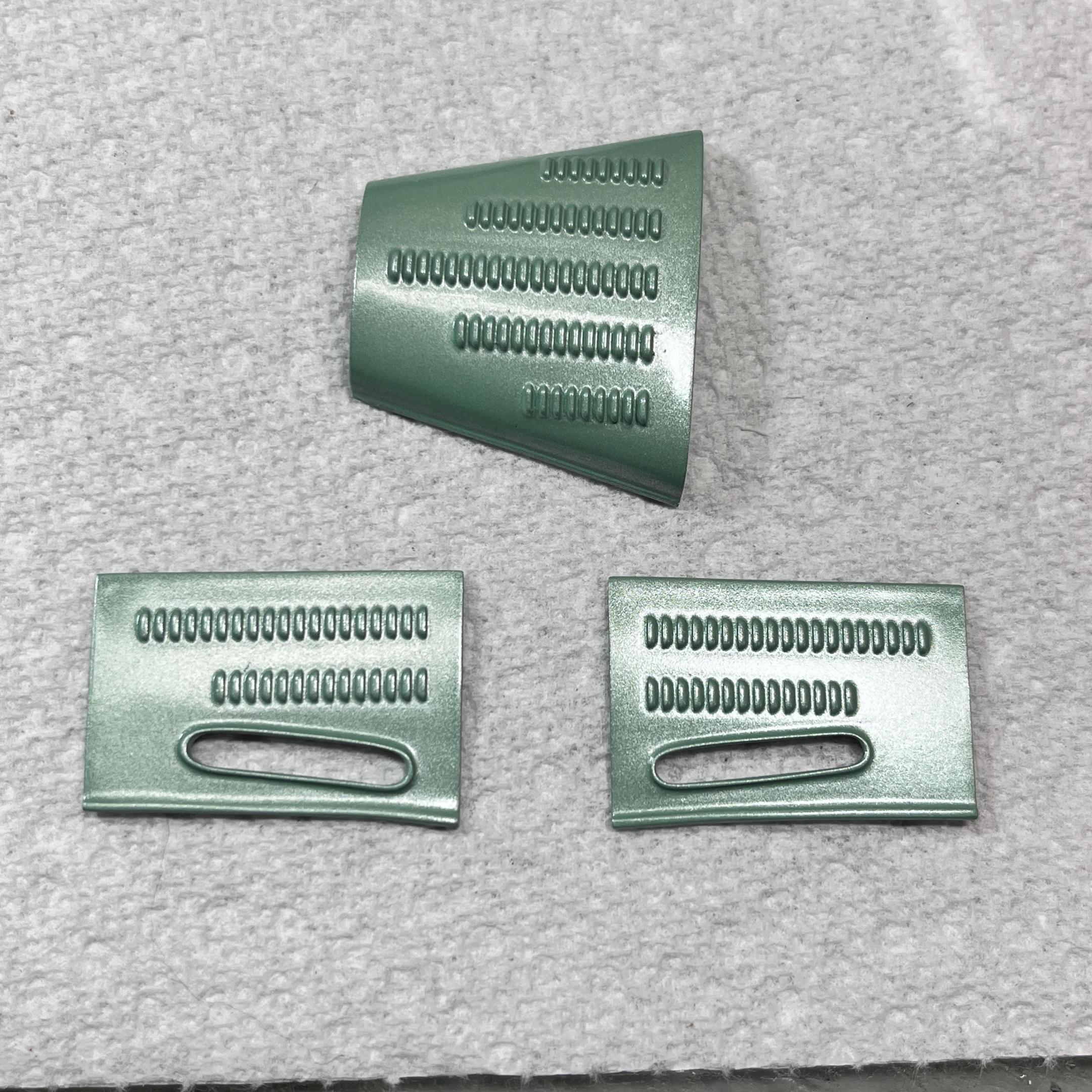

Plowboy Posted November 14, 2022 Posted November 14, 2022 Nice work Rodney! What's the plan on the hood sides and headers when it comes time for final assembly? Will the hood sides be glued permanent and the headers installed afterwards? I wanted to do this on a build. But, couldn't come up with a plan that I was comfortable with attempting.
Rocking Rodney Rat Posted November 14, 2022 Author Posted November 14, 2022 On 11/14/2022 at 4:11 PM, NOBLNG said: Beautiful! Is the top portion of the hood going to be removable? How are you painting the body with the headers sticking through the hood?? Expand Yeah, that's all TBD..... I guess I could score some lines down both sides of the header openings to make it look like the hood sides are removeable. I will actually install the headers through the openings once the hoods are on... -RRR
Rocking Rodney Rat Posted November 14, 2022 Author Posted November 14, 2022 On 11/14/2022 at 4:20 PM, Plowboy said: Nice work Rodney! What's the plan on the hood sides and headers when it comes time for final assembly? Will the hood sides be glued permanent and the headers installed afterwards? I wanted to do this on a build. But, couldn't come up with a plan that I was comfortable with attempting. Expand Yeah. I will fit the headers through the openings once the hoods are on.... -RRR

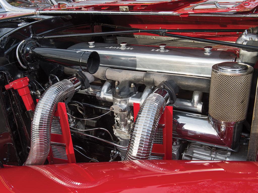

NOBLNG Posted November 14, 2022 Posted November 14, 2022 On 11/14/2022 at 4:43 PM, Rocking Rodney Rat said: Yeah. I will fit the headers through the openings once the hoods are on.... -RRR Expand You could possibly do something similar to a Mercedes 540k?
Plowboy Posted November 14, 2022 Posted November 14, 2022 My issue was that I wanted to wire the engine and saw no way of installing the headers with the wires on the engine. I guess I could've cut the flanges away from the headers. But, it would've still been a tricky procedure for me to pull off. I know this will have a killer look to it once it's together!
Rocking Rodney Rat Posted November 14, 2022 Author Posted November 14, 2022 On 11/14/2022 at 4:56 PM, Plowboy said: My issue was that I wanted to wire the engine and saw no way of installing the headers with the wires on the engine. I guess I could've cut the flanges away from the headers. But, it would've still been a tricky procedure for me to pull off. I know this will have a killer look to it once it's together! Expand I'm going to run wires from down below the headers.....
Plowboy Posted November 14, 2022 Posted November 14, 2022 Ah, OK. I never thought of wiring like the factory did! That's the perfect solution! In my mind, I always think of routing the wires up and over the headers. I've done them that way on a couple of Y block Fords. I should have thought of that!
Rocking Rodney Rat Posted November 14, 2022 Author Posted November 14, 2022 (edited) On 11/14/2022 at 8:34 PM, Plowboy said: Ah, OK. I never thought of wiring like the factory did! That's the perfect solution! In my mind, I always think of routing the wires up and over the headers. I've done them that way on a couple of Y block Fords. I should have thought of that! Expand The perfect solution, indeed, I do believe! -RRR Edited November 14, 2022 by Rocking Rodney Rat

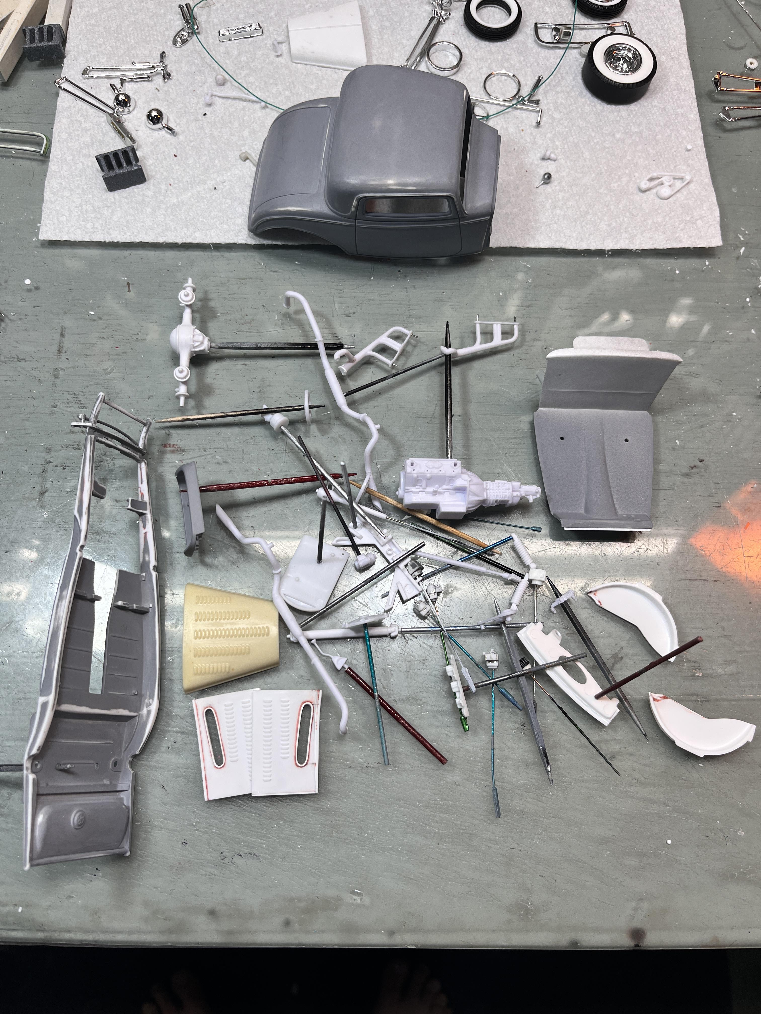

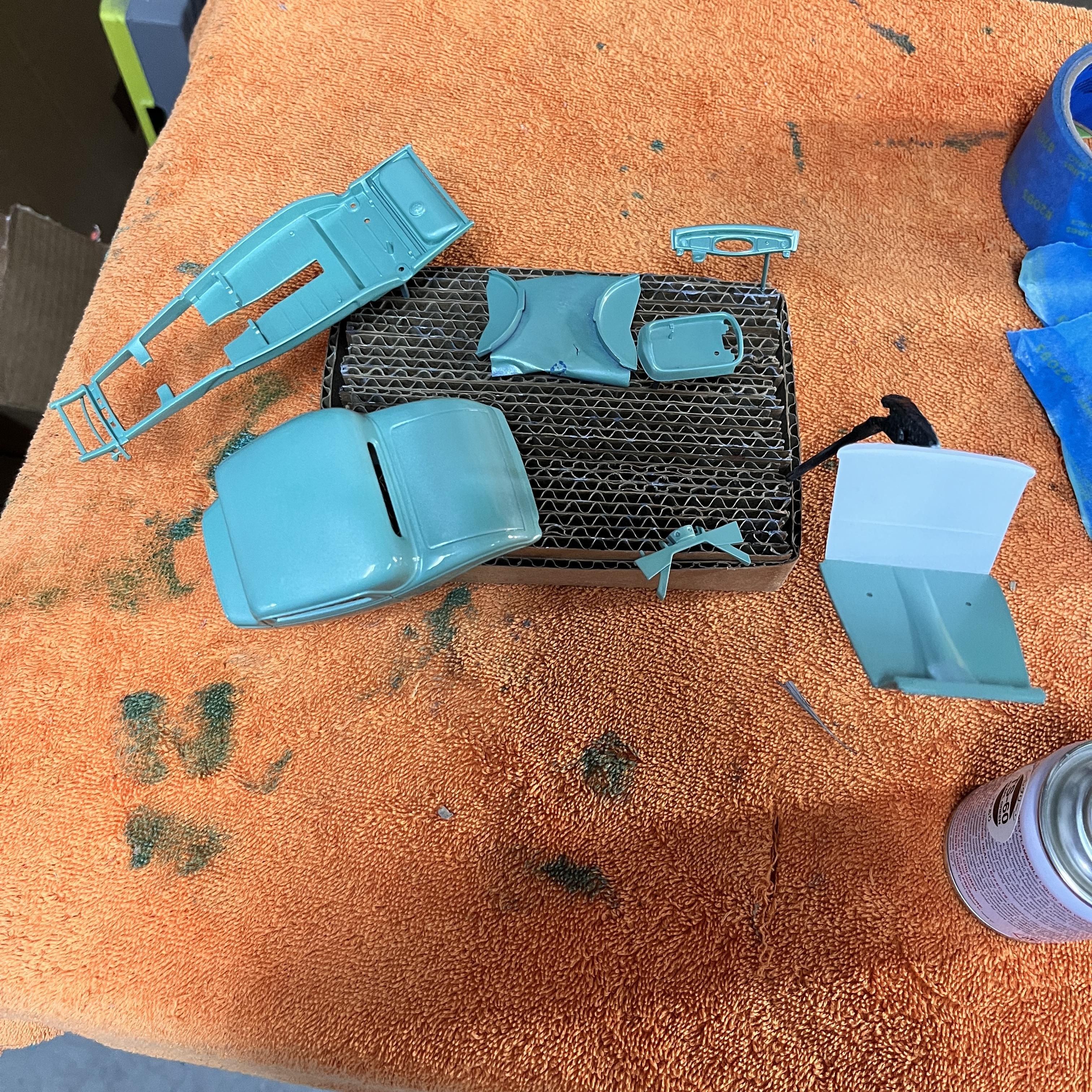

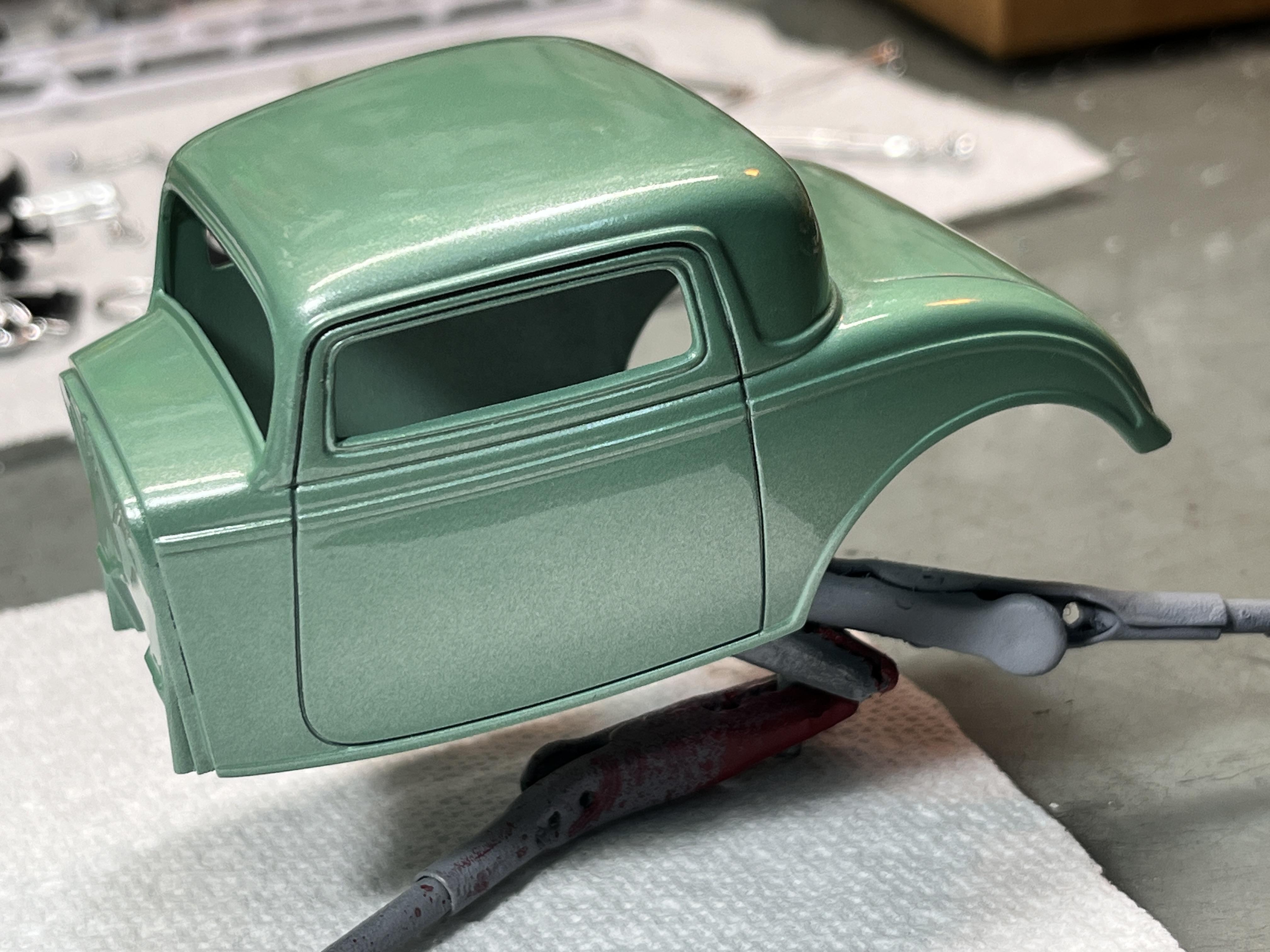

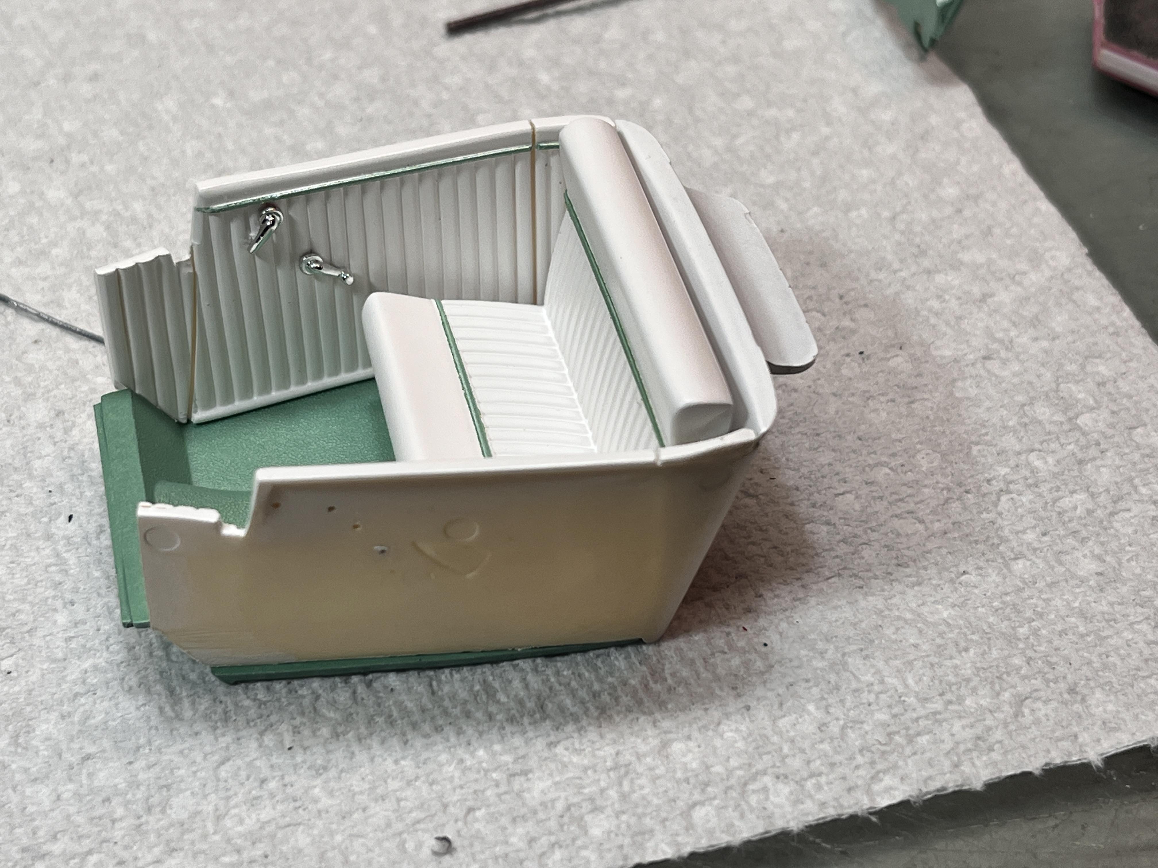

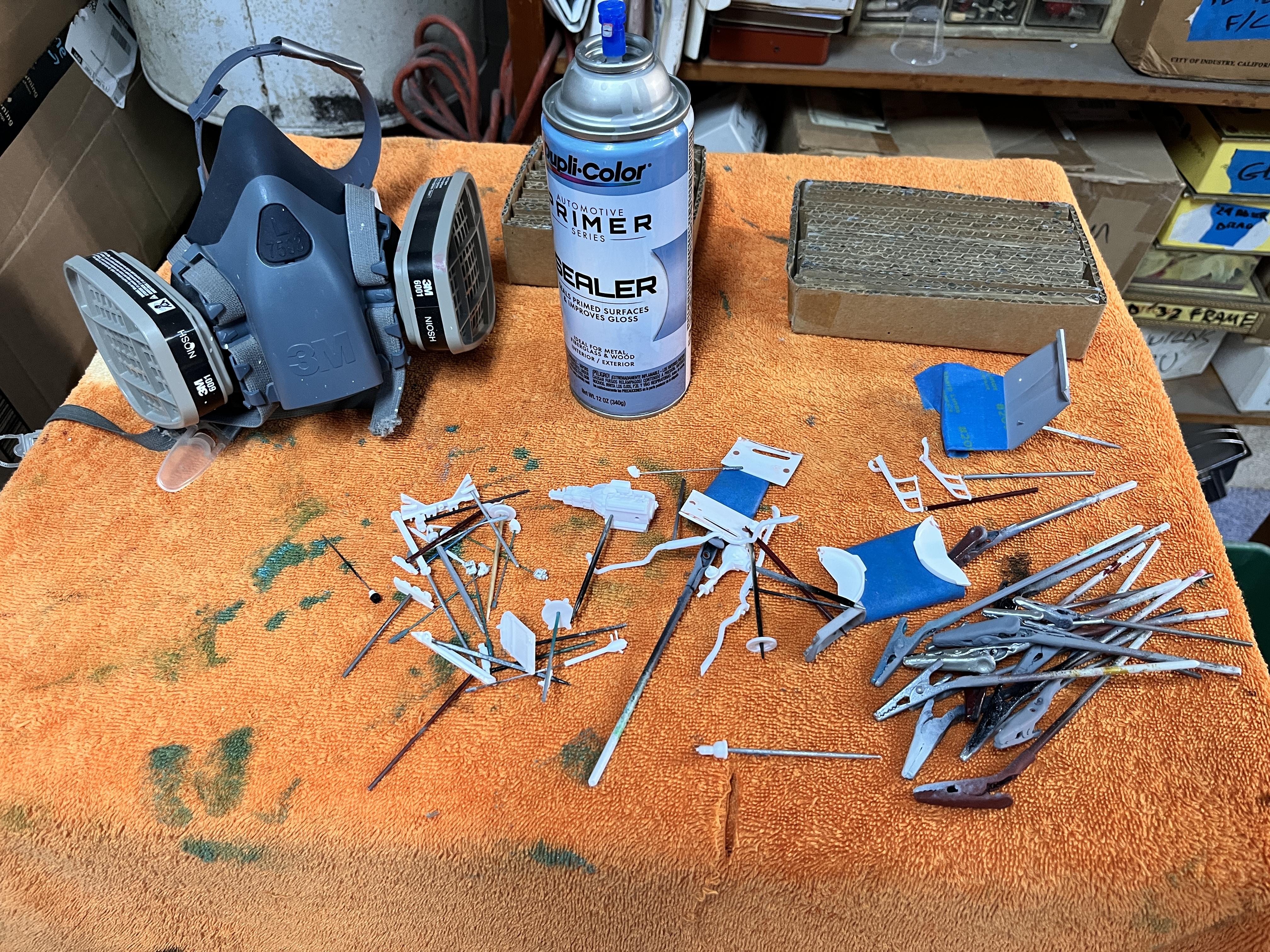

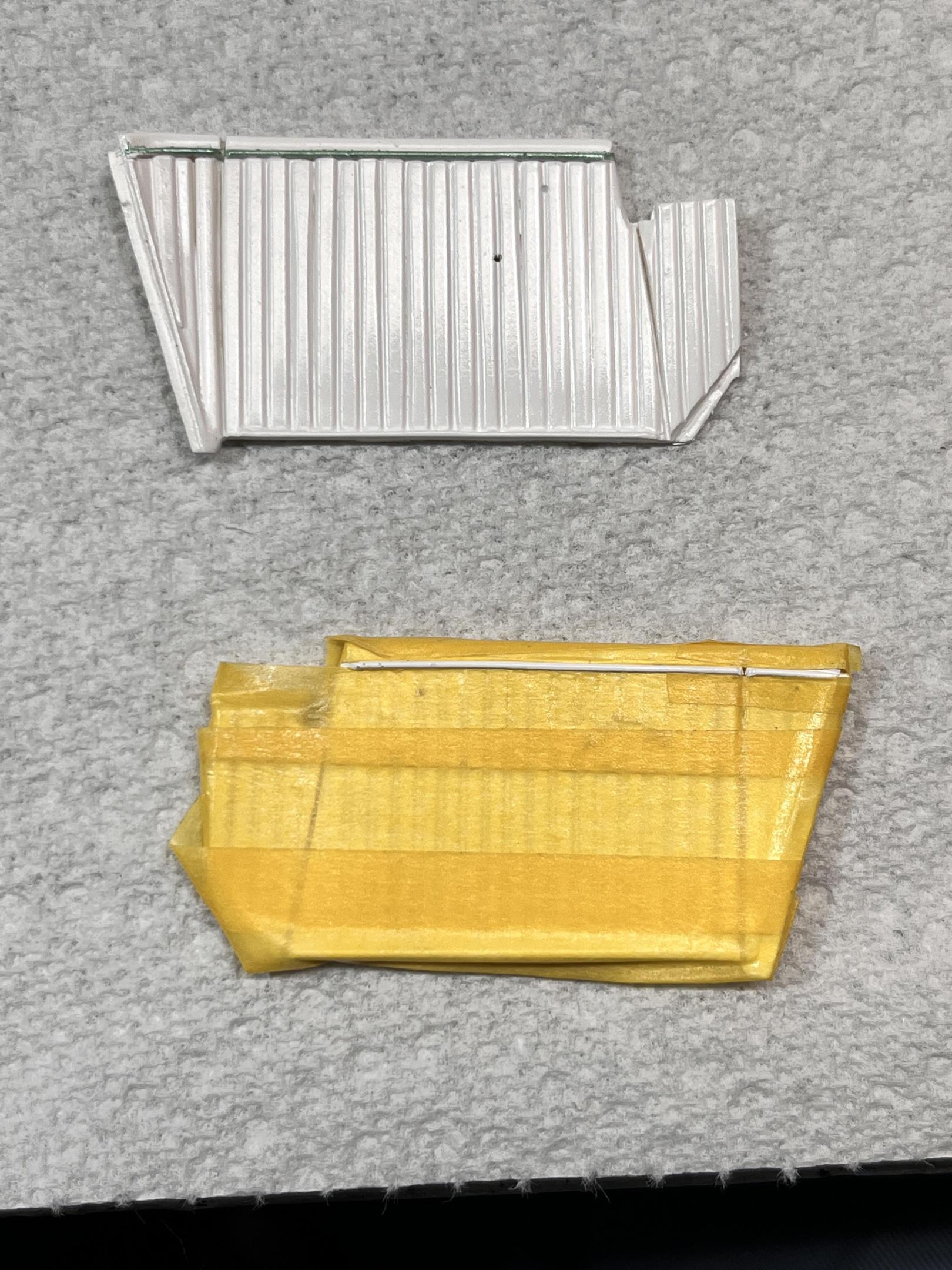

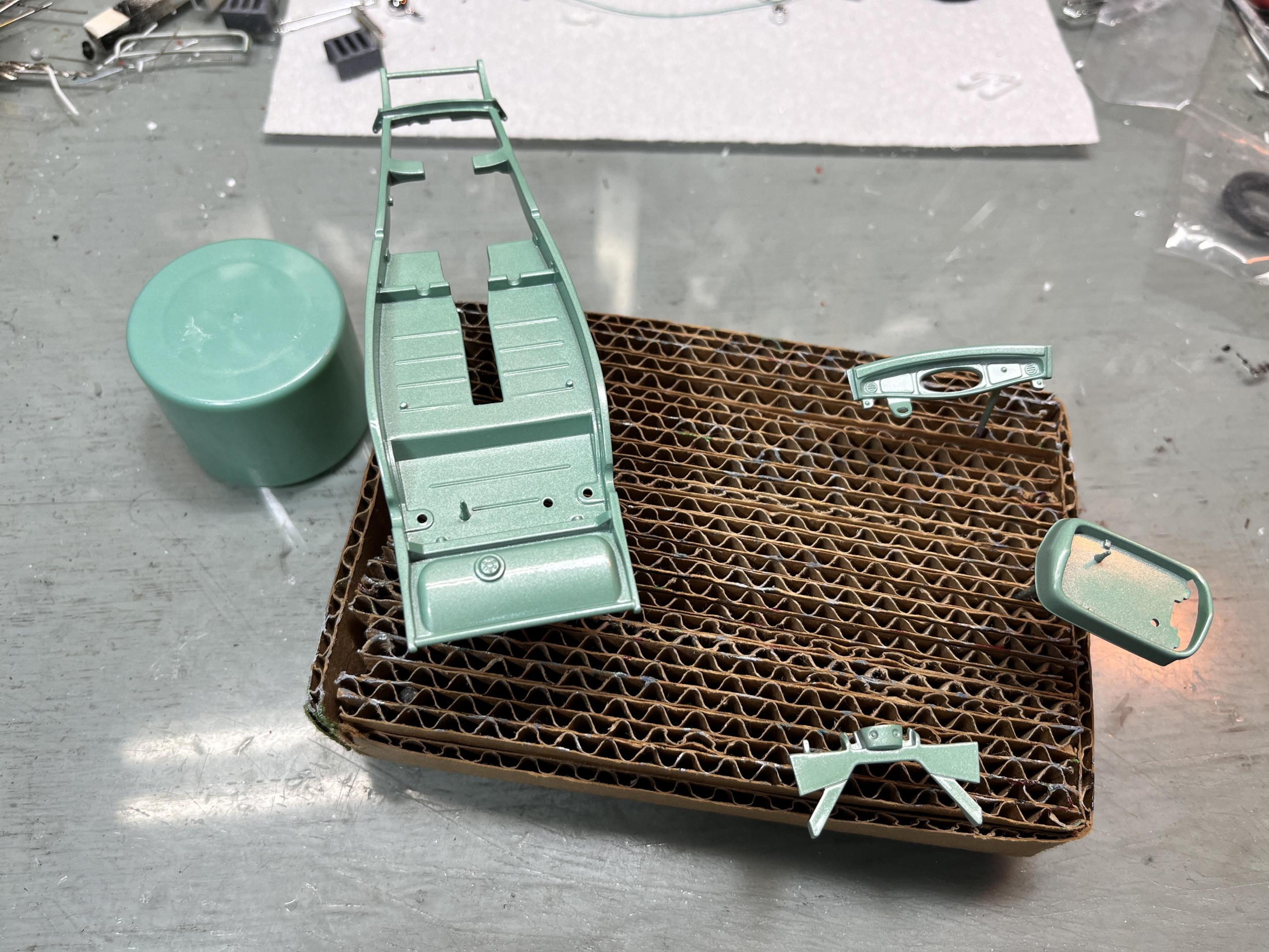

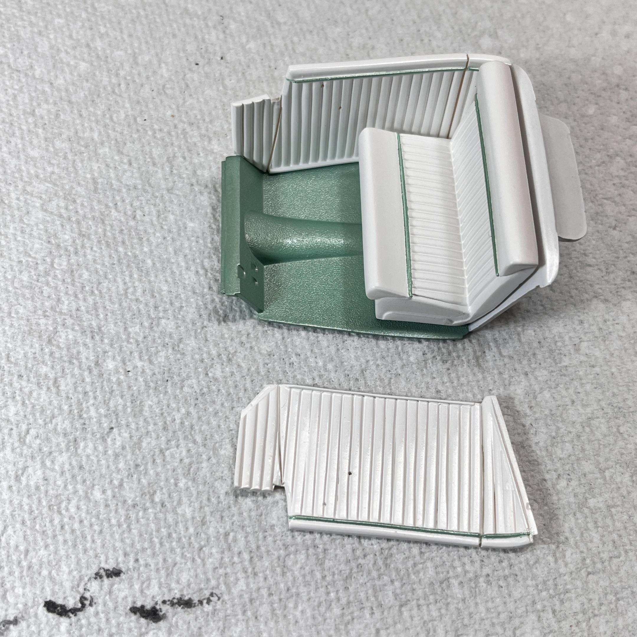

Rocking Rodney Rat Posted November 27, 2022 Author Posted November 27, 2022 I have been slowly working on the coupe. I'm down to the 'yak shaving' part of the build. AKA: the 'fiddly bits'..... parts have been washed and dried, holding sticks have been attached.... --------------------------- Ready to throw some primer.... ------------------------------- The color is Tamiya TS-60 Pearl Green with one coat of clear. MinWax polyurethane shot through the trusty Paasche.... The louvered hood is a resin item cast by Jason Lookabill. --------------------------------- The interior is a resin set, by RMCM? Origin lost to the ages... Piping taped off and shot body color. Door handles and window cranks were aftermarket chrome plated years ago (most likely by Chrome-Tech).... I'm hoping to get this wrapped up sooner than later.... Next appearance 'under glass'... -RRR 4
Joe Nunes Posted November 27, 2022 Posted November 27, 2022 Very nice and a great color choice on this build. ?? Joe
Plowboy Posted November 27, 2022 Posted November 27, 2022 That Tamiya Pearl Green is a nice looking color. I have a couple of models painted with it.
bobthehobbyguy Posted November 27, 2022 Posted November 27, 2022 Great color choice. Coming along nicely.
TransAmMike Posted November 27, 2022 Posted November 27, 2022 Impressive work Rodney, prrrr-ty color!!
Zippi Posted November 28, 2022 Posted November 28, 2022 I agree....the color choices look great. Love that green.
Calb56 Posted November 29, 2022 Posted November 29, 2022 On 11/27/2022 at 1:42 PM, Rocking Rodney Rat said: I have been slowly working on the coupe. I'm down to the 'yak shaving' part of the build. AKA: the 'fiddly bits'..... parts have been washed and dried, holding sticks have been attached.... --------------------------- Ready to throw some primer.... ------------------------------- The color is Tamiya TS-60 Pearl Green with one coat of clear. MinWax polyurethane shot through the trusty Paasche.... The louvered hood is a resin item cast by Jason Lookabill. --------------------------------- The interior is a resin set, by RMCM? Origin lost to the ages... Piping taped off and shot body color. Door handles and window cranks were aftermarket chrome plated years ago (most likely by Chrome-Tech).... I'm hoping to get this wrapped up sooner than later.... Next appearance 'under glass'... -RRR Expand The interior definitely looks like RMoM. Great seeing Jason's hood. I have two of his hoods... your paint looks great!
Rocking Rodney Rat Posted November 29, 2022 Author Posted November 29, 2022 On 11/29/2022 at 11:11 AM, Calb56 said: The interior definitely looks like RMoM. Great seeing Jason's hood. I have two of his hoods... your paint looks great! Expand Thanks for your compliments on the paint. Yes, the interior is almost certainly from Norm at Reps & Mins of MD, It had been sitting in a box for about 25 (?) years. I bought several of the hoods Jason cast. Very nice items. He is looking at casting a louvered hood for the recently released Revell '32 roadster. The hood on that kit is slightly wider than the other Revell '32 hoods at the cowl. -RRR

Mr. Metallic Posted December 2, 2022 Posted December 2, 2022 On 11/29/2022 at 1:10 PM, Rocking Rodney Rat said: He is looking at casting a louvered hood for the recently released Revell '32 roadster. The hood on that kit is slightly wider than the other Revell '32 hoods at the cowl. -RRR Expand Yeah, about 1mm, or one scale inch. It's made a resin master I'm working on a bit more complicated than I anticipated. The pearl green is looking great!
