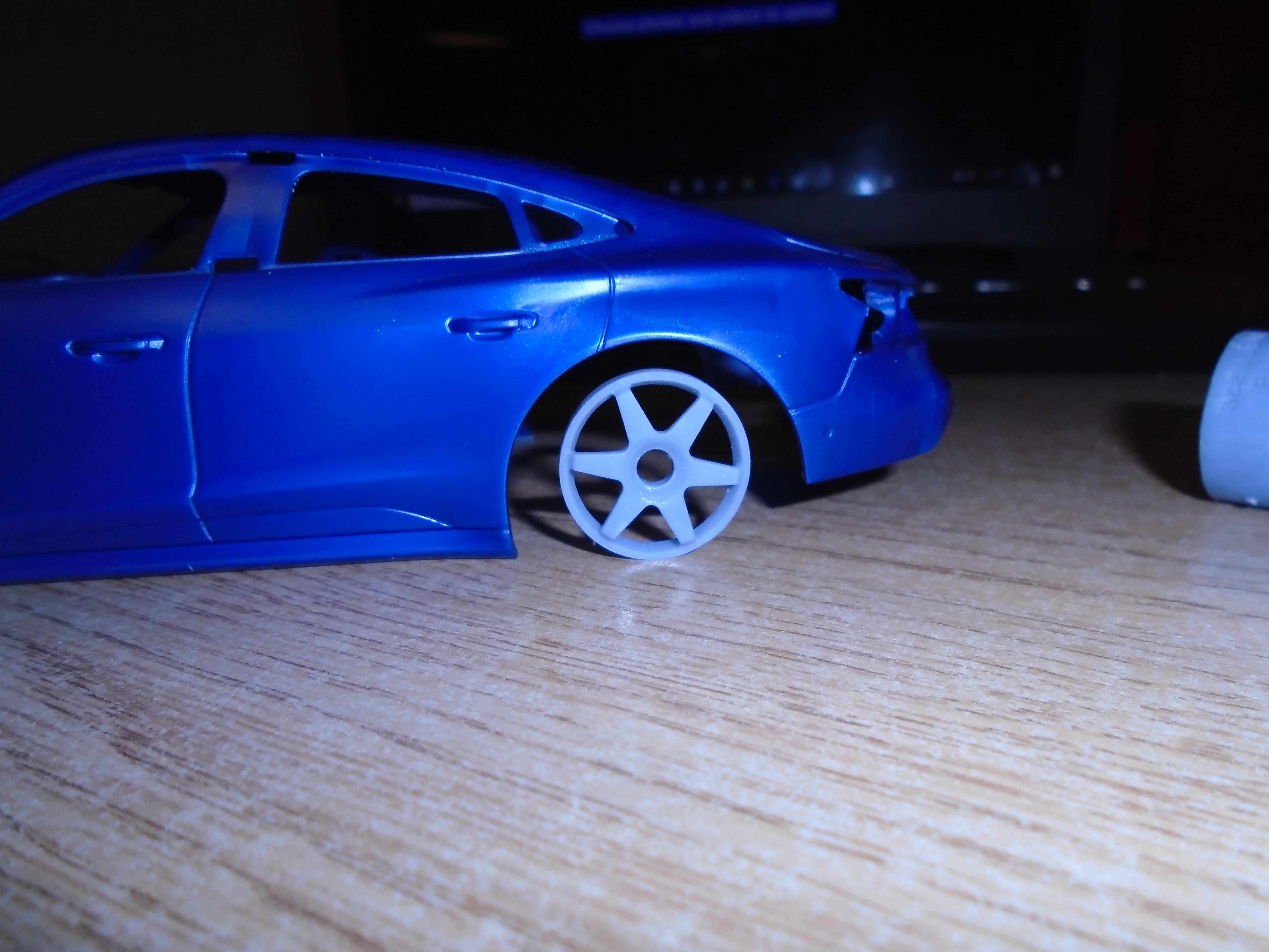

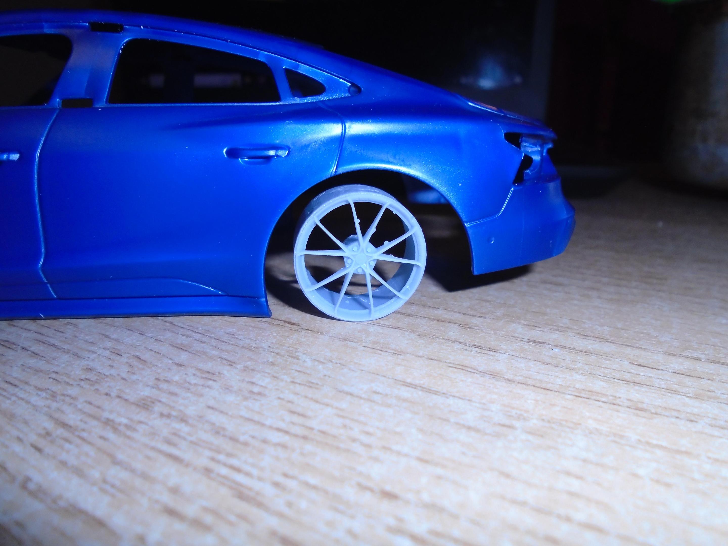

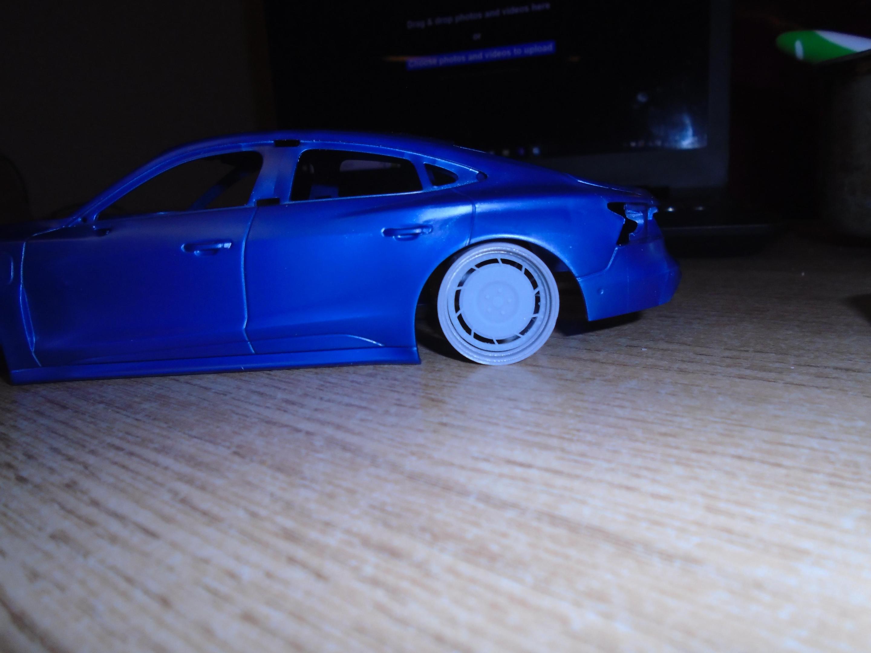

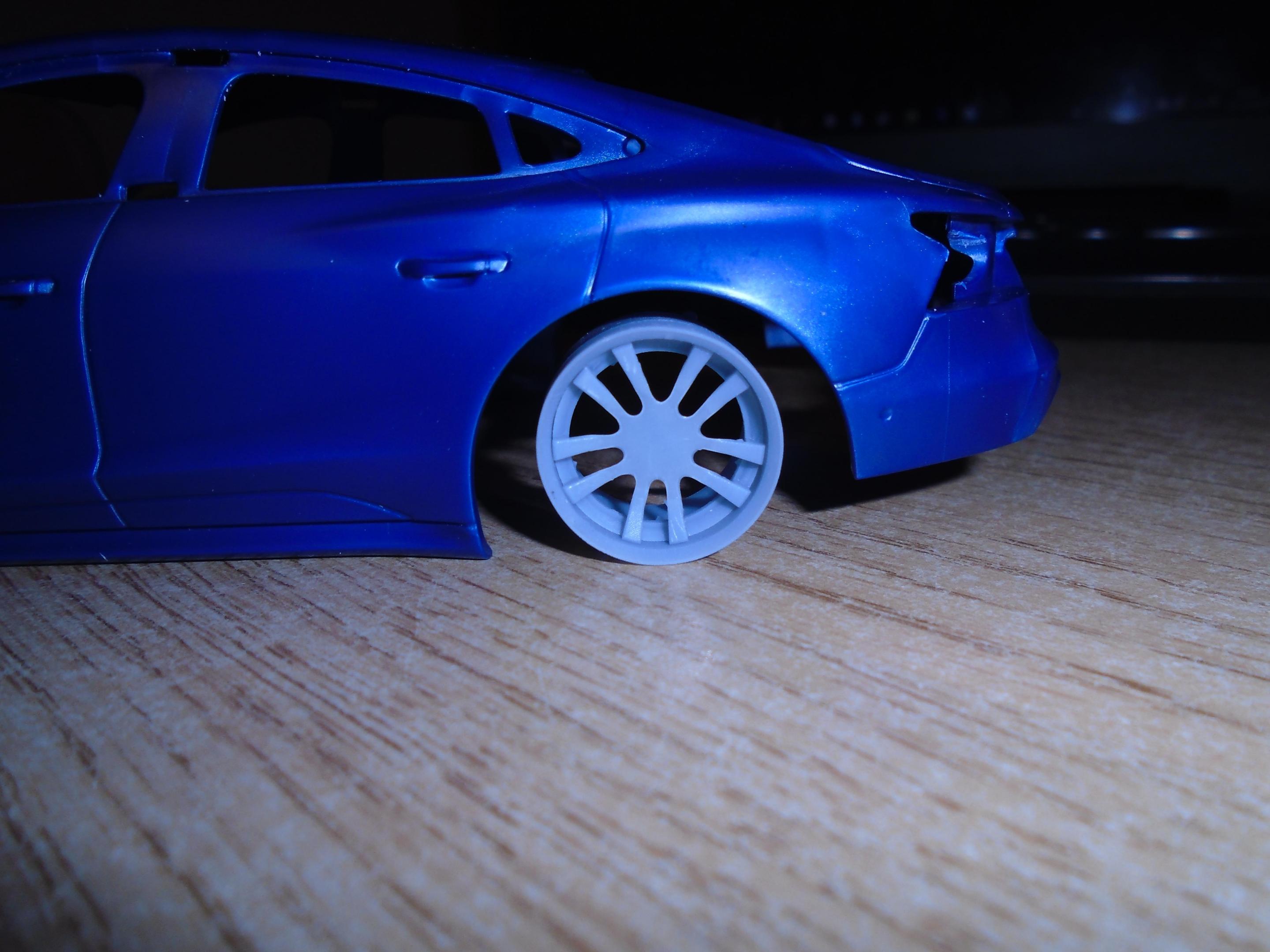

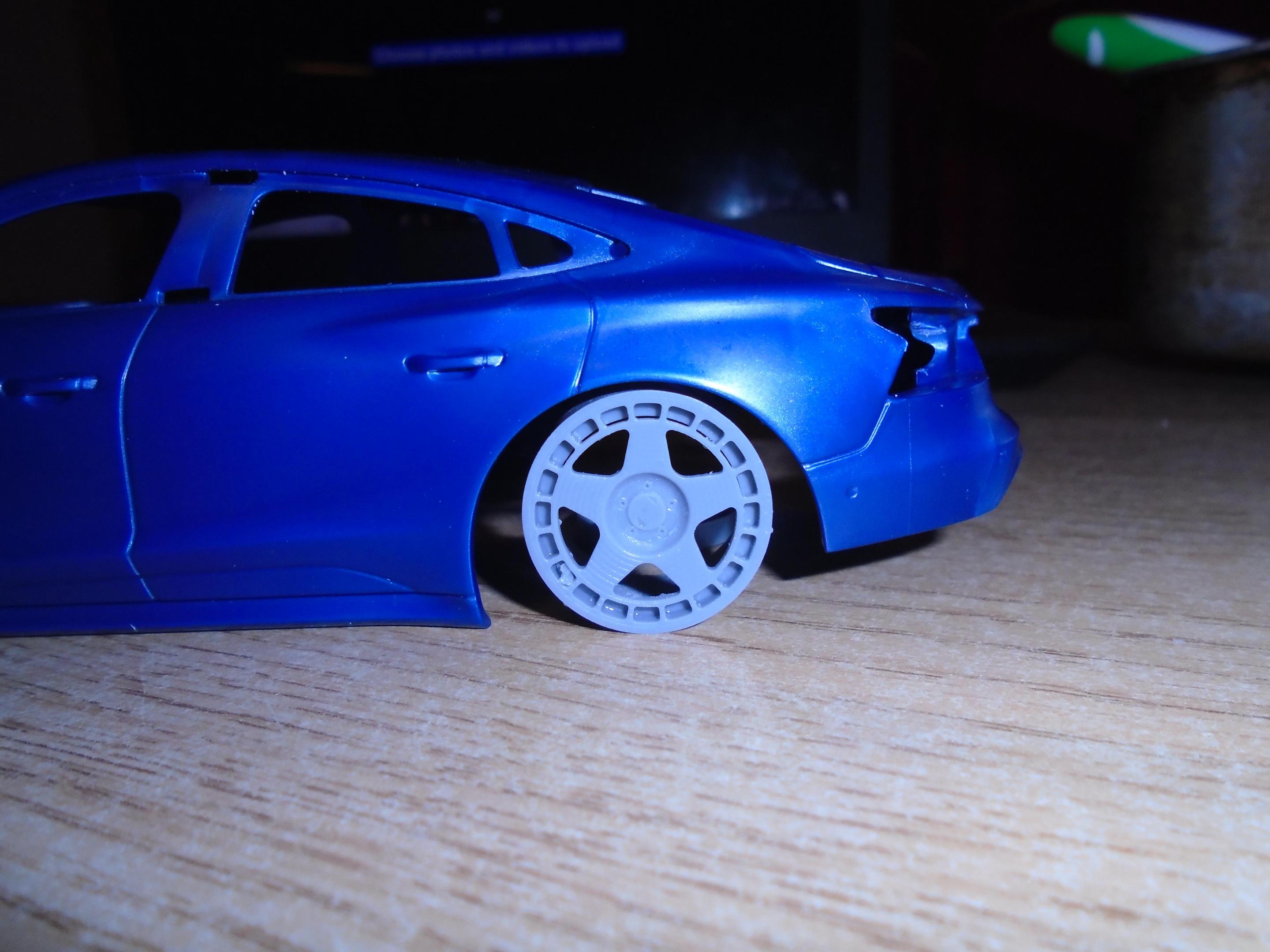

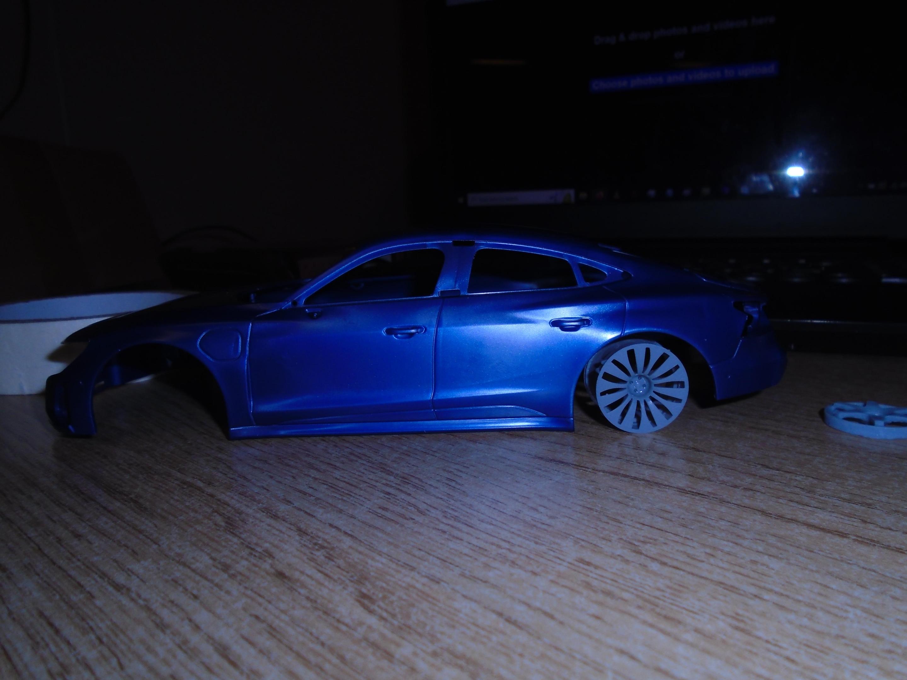

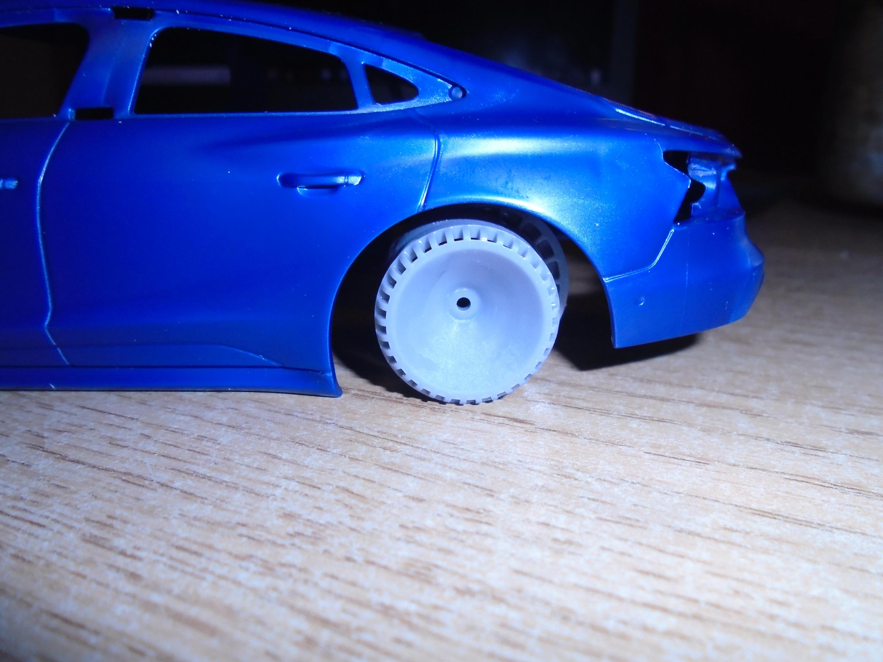

stitchdup Posted December 15, 2022 Share Posted December 15, 2022 (edited) This weeks work project since its too cold to paint and i aint opening the window to use the booth so another project it is. This is the new revell kit but since my background is in the vw scene i just cant leave it stock so i've printed a steering wheels and seats for the interior and a few choices for rims but i'm having difficulty choosing between them. 22" corvette 20" sensi 22" 1552 tarmacs rotiform aerodiscs (resized and recontoured) 20" porsche 911 22" audi a8 s-line rotiform sixers Edited January 7, 2023 by stitchdup Quote Link to comment Share on other sites More sharing options...
JollySipper Posted December 15, 2022 Share Posted December 15, 2022 I would go with the Audi s-line wheels......... 2 Quote Link to comment Share on other sites More sharing options...

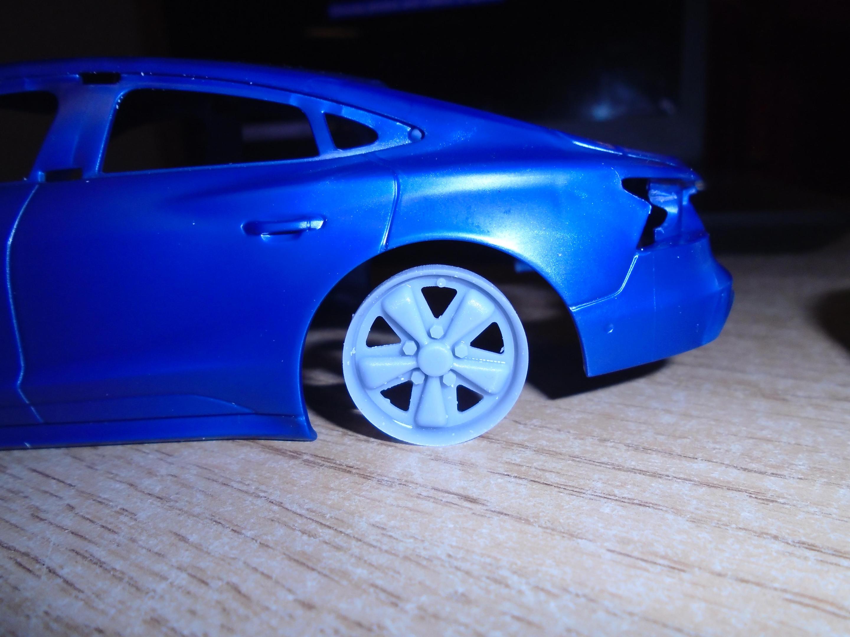

stitchdup Posted December 15, 2022 Author Share Posted December 15, 2022 one more 22" fuchs 1 Quote Link to comment Share on other sites More sharing options...
Joe Handley Posted December 15, 2022 Share Posted December 15, 2022 2 hours ago, JollySipper said: I would go with the Audi s-line wheels......... yup, those or the 20” Sensi, they both just seem to fit the EV heritage of the car better to me. Quote Link to comment Share on other sites More sharing options...
iamsuperdan Posted December 15, 2022 Share Posted December 15, 2022 My vote is for the Corvette sawblades. Or the turbofans. Quote Link to comment Share on other sites More sharing options...

WGaree Posted December 16, 2022 Share Posted December 16, 2022 the s-lines Quote Link to comment Share on other sites More sharing options...
Mattilacken Posted December 27, 2022 Share Posted December 27, 2022 Nice! I think I like the 1552s best on that one! The Fuchs we where discussing. Are they printed in two pieces so you can set the offset? Quote Link to comment Share on other sites More sharing options...
Slotto Posted December 27, 2022 Share Posted December 27, 2022 I agree with Super Dan. Corvette wheels for sure Quote Link to comment Share on other sites More sharing options...
stitchdup Posted January 7, 2023 Author Share Posted January 7, 2023 On 12/27/2022 at 12:05 AM, Mattilacken said: Nice! I think I like the 1552s best on that one! The Fuchs we where discussing. Are they printed in two pieces so you can set the offset? they are faces like amt rims but i can fit them to any barrel size 1 Quote Link to comment Share on other sites More sharing options...

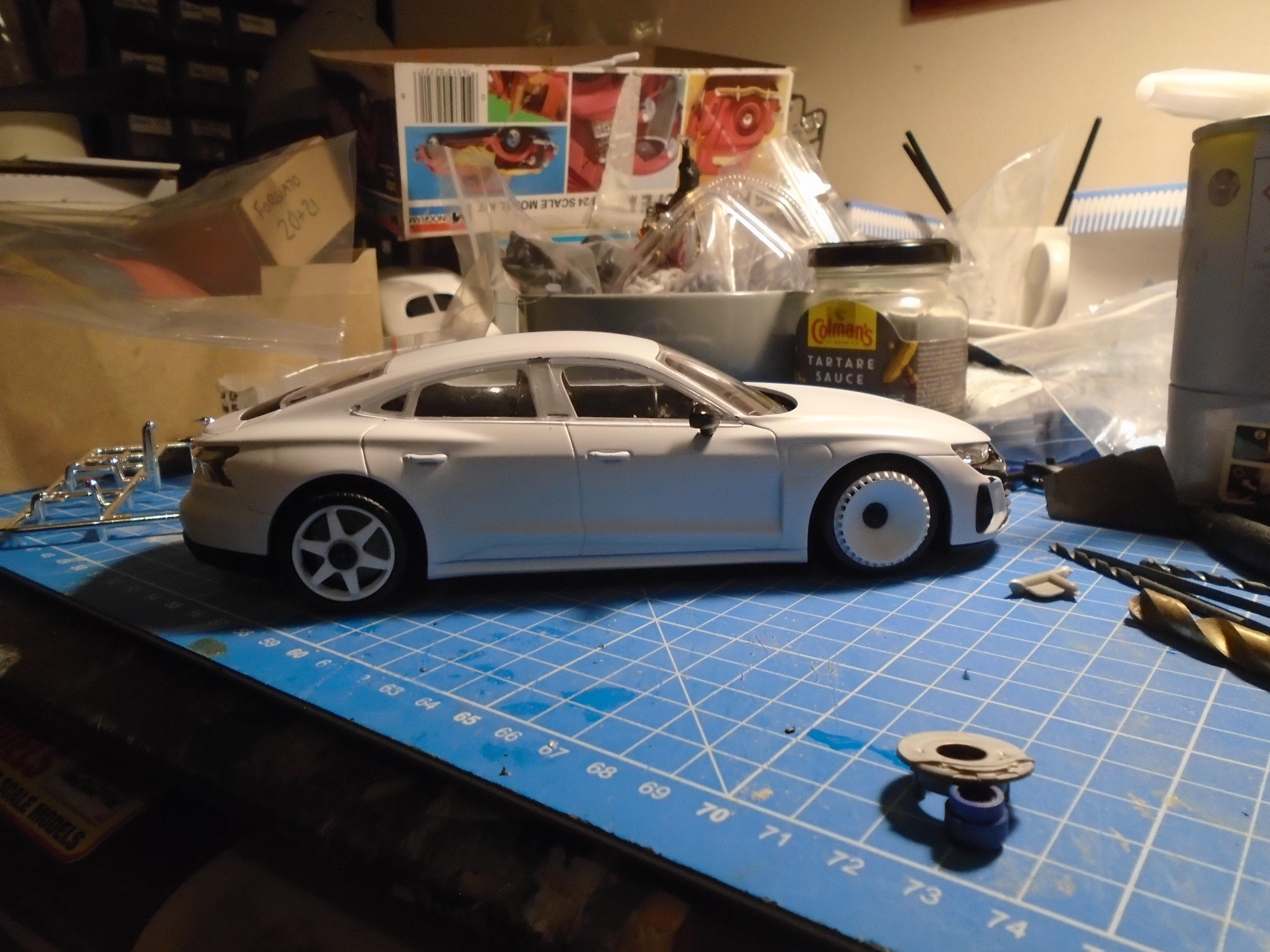

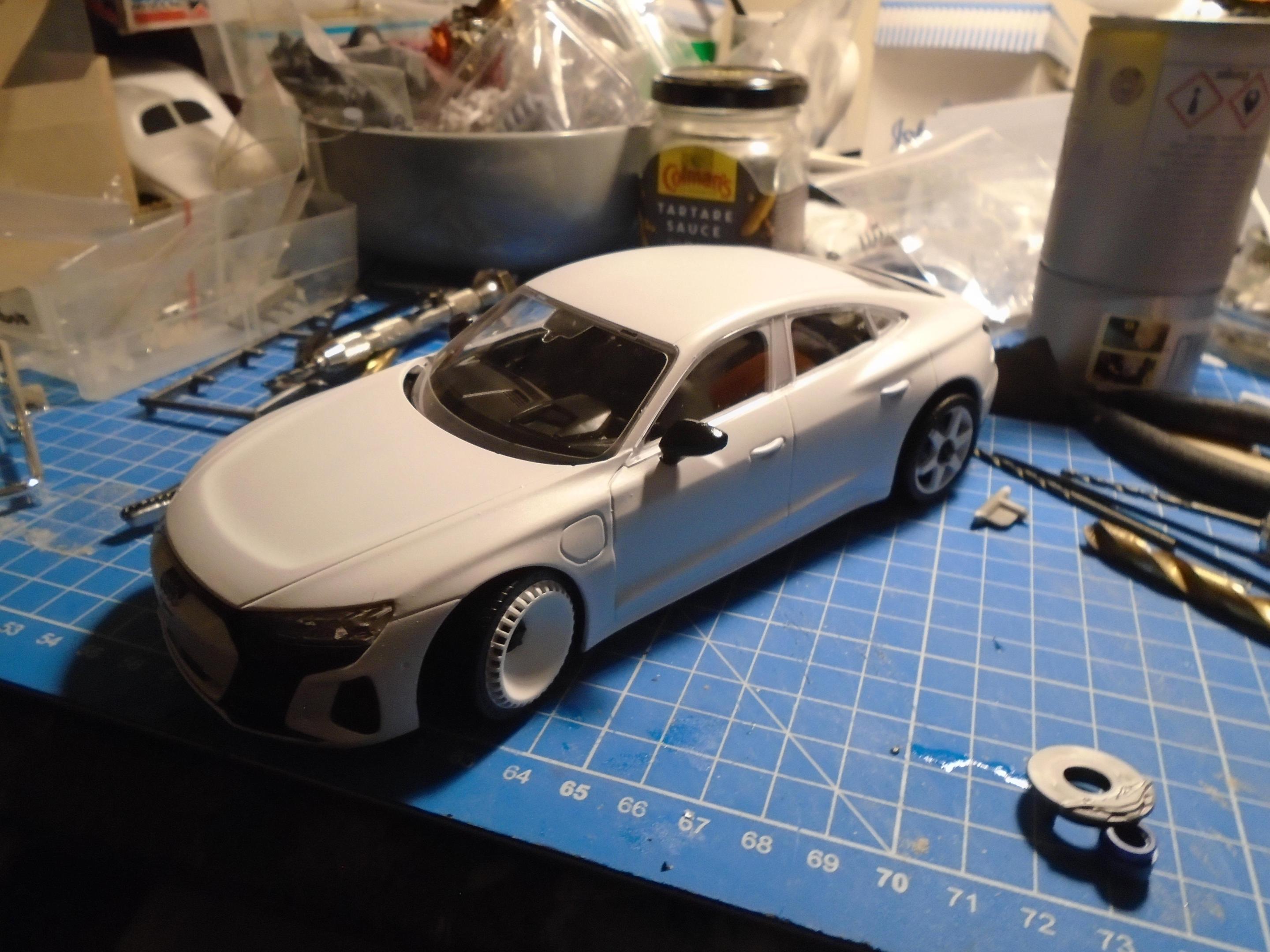

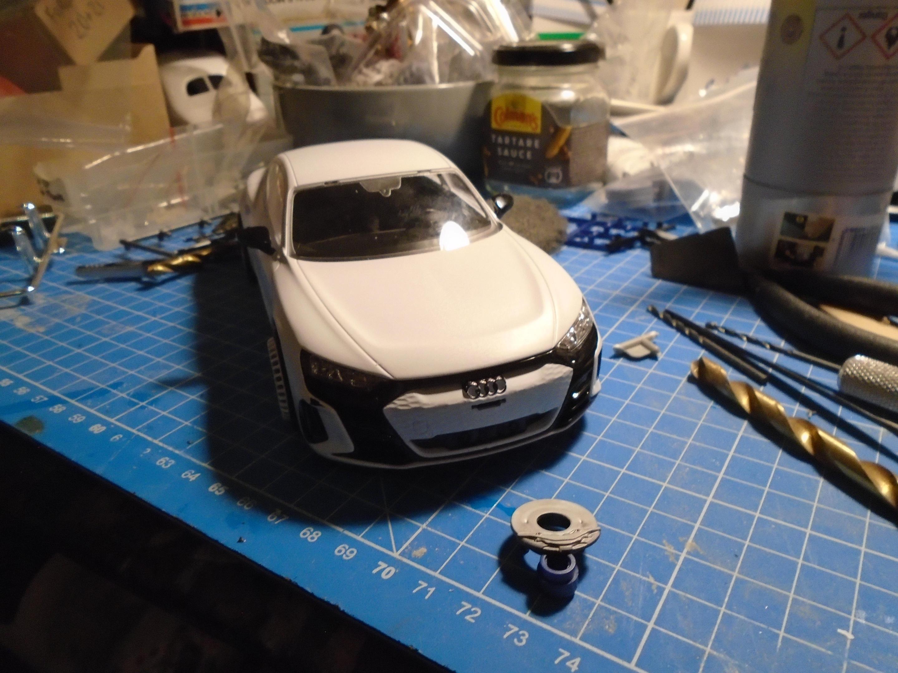

stitchdup Posted January 7, 2023 Author Share Posted January 7, 2023 Well this has turned into a tribute build to Ken Block. It would have been finished today but i ran out of black paint for the window surrounds and have no clear red apart from brush stuff so both of those are ordered. The glass is just placed in for the pics at the moment. If you are building one of these you will need to make sure every trace of the sprue attachments are gone or the glass wont fit. The passenger side glass also needs the centre bottom attachment trimmed as its a little off, and I'd recommend gluing the glass anyway as the front and rear attachments are too short to hold the glass in. And the rear interior attachments are very out of place so that bit will need glued but it still works if you just remove the nubs from the bck of the interior tub. I didn't bother painting the interior on this one as its already all black and looks decent, besides there little point going to the trouble of painting black plastic to look like black plastic. I did paint the exterior plastics black as they are gloss on Ken's audi. Hopefully the post aint on strike before my paint arrives so i can get this finished. Apart from the wheels and paint this is box stock 2 Quote Link to comment Share on other sites More sharing options...
Jhedir6 Posted January 7, 2023 Share Posted January 7, 2023 Looking good. This is what I'm going to be doing as well with my Etron. I like the wheel choice you went with. There are several different pics floating around with different wheel sets. I was going to do this too, but there's a nice set of 3D wheels with Ken's 43 on them now available that I'm going to be using on my Etron. Looking forward to seeing you're finished result. 1 Quote Link to comment Share on other sites More sharing options...
stitchdup Posted January 7, 2023 Author Share Posted January 7, 2023 2 minutes ago, Jhedir6 said: Looking good. This is what I'm going to be doing as well with my Etron. I like the wheel choice you went with. There are several different pics floating around with different wheel sets. I was going to do this too, but there's a nice set of 3D wheels with Ken's 43 on them now available that I'm going to be using on my Etron. Looking forward to seeing you're finished result. it wasn't my original plan but i had printed the wheels already and it just seemed fitting this week. The next one (i bought a full case of them cos there just not enough audi kits) will be porsche macadamia brown pearl with an orange interior on big gt3 rims and absolutely slammed on the floor. i found a steering wheel to match the wheels too. Quote Link to comment Share on other sites More sharing options...

PatW Posted April 11, 2023 Share Posted April 11, 2023 (edited) To me as the Audi is an electric car the 1552's are more aero than the rest. I've seen the Ken Block car but I can't see why the front and rear wheels are different! Edited April 11, 2023 by PatW Quote Link to comment Share on other sites More sharing options...
stitchdup Posted April 11, 2023 Author Share Posted April 11, 2023 1 hour ago, PatW said: To me as the Audi is an electric car the 1552's are more aero than the rest. I've seen the Ken Block car but I can't see why the front and rear wheels are different! the aero wheels on the front in racing are used to help cool the brakes and is normally a cover that fits over another wheel. the holes around the edge suck cold air into the brakes and if you flip an aoro disc around to look at the back side it looks just like a bbs wheel without the holes. The different wheels are just a fashion thing now though since brakes are so mush better. i think Ken was trying to make the e-tron have some style link to the s1 that did pikes peak with Walter Rohrl driving with the different wheels. I think the sierra cosworth kit has a pair for the front wheels included in the kit i have. Personally I would have used a bbs wheel on the rear but since i started this around the time of Kens accident I went for what he had. I have 5 more of these kits to play with so there will be some other wheel combos done later Quote Link to comment Share on other sites More sharing options...
