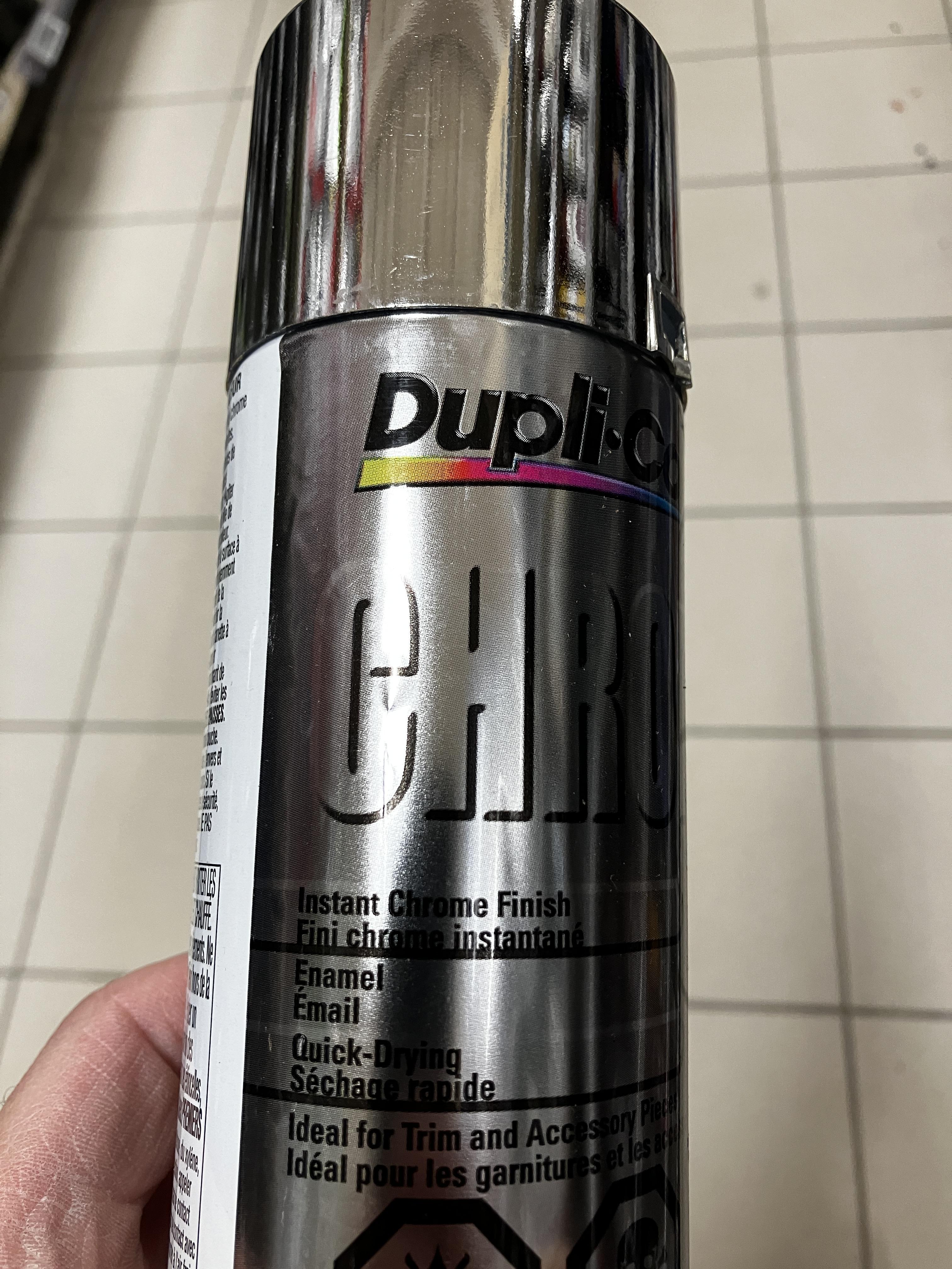

bobss396 Posted March 29 Share Posted March 29 I gave Spaz Stix a go some years back, it would have to be covered with a clear or else it will not withstand any handling. I think it is made to be used on the inside of RC car bodies that are clear. Al Clad too, I tried it a few times but don't drag out the airbrush too often. I have been using Duplicolor Chrome spray cans and I'm happy-ish with it. I have used it on gasser grilles and bumpers mostly and on '62 Ford bumpers. Quote Link to comment Share on other sites More sharing options...
NOBLNG Posted March 29 Share Posted March 29 (edited) 27 minutes ago, bobss396 said: I have been using Duplicolor Chrome spray cans and I'm happy-ish with it. I have used it on gasser grilles and bumpers mostly and on '62 Ford bumpers. Is this the stuff? Any pics of it? Edited March 29 by NOBLNG Quote Link to comment Share on other sites More sharing options...
bobss396 Posted March 30 Share Posted March 30 23 hours ago, NOBLNG said: Is this the stuff? Any pics of it? That is it, I will post something when I get a chance. It looks pretty decent, IMO. I'd like to try the new Revell one. Quote Link to comment Share on other sites More sharing options...

Big_John Posted April 20 Share Posted April 20 Regarding the Duplicolor "chrome" paint. I bought a can of Duplicolor for the reflective surface on some tail light housings for one of my old Chryslers. Worked great for that and I had most of the can left, so I tried it on a 3D printed Chrysler 300 Hurst I've been building. It looked OK, still kind of polished aluminum rather than chrome looking, but good enough for this build. Here was the problem.... I superglued the front bumper in place and because the hood was up in the middle slightly, I put a little thick superglue between the bumper and grille and squeezed it down with my fingers... And then I hit it with some kicker... And it immediately ruined the chrome paint on the top of the bumper. So... The plan is to mask it and touch it up. I want to try to decant some from the spray can and use my airbrush as I can control it better, but I'm thinking it might be too thick to spray. The can has a wide pattern spray that was OK with my real tail light housings, but it's a bit much for the model bumper. Quote Link to comment Share on other sites More sharing options...
