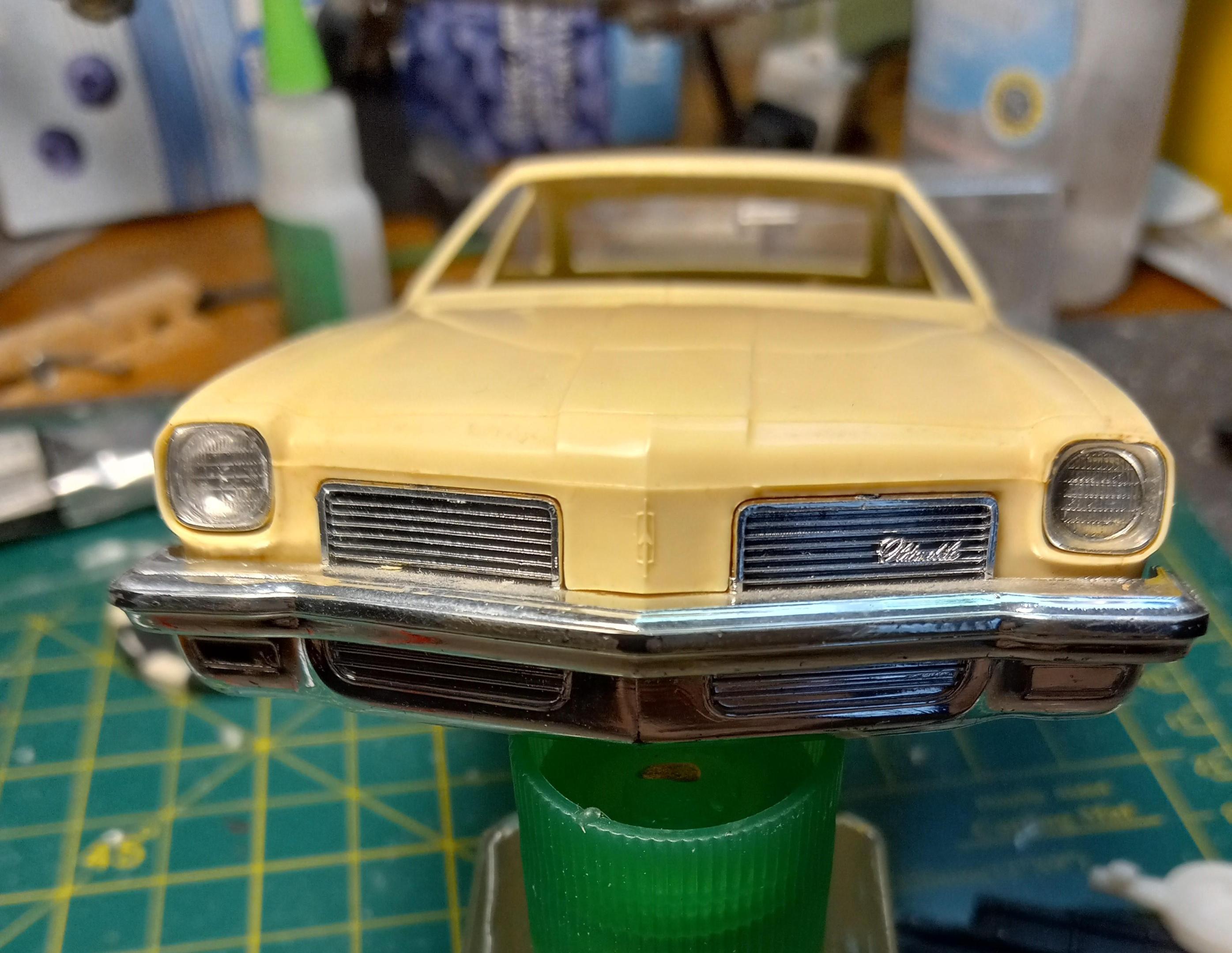

carl63_99 Posted March 20, 2023 Share Posted March 20, 2023 I've seen too many very nice models that the builder did nothing to address the chromed headlights. This oversight takes away from the presented model and kills the realistic look modelers go for. The following how-to shows just how easy it is to make more realistic headlights than the ones presented in old kits and promos. You will need a drill bit or Dremel round head, BMF or chrome paint, white glue and clear lenses from your parts bin. For this demo, which took me all of 15 minutes start to finish, I used the headlights from the AMT 1971 Camaro. 1) Using an appropriately sized drill bit or dremel grinder tool, smooth off the light so it is concave. 2) Bare metal foil or chrome paint the inside of the newly-created headlight bucket. 3) Insert the new lens, be sure to line it up correctly. Apply white glue to secure lense. 4 Quote Link to comment Share on other sites More sharing options...
