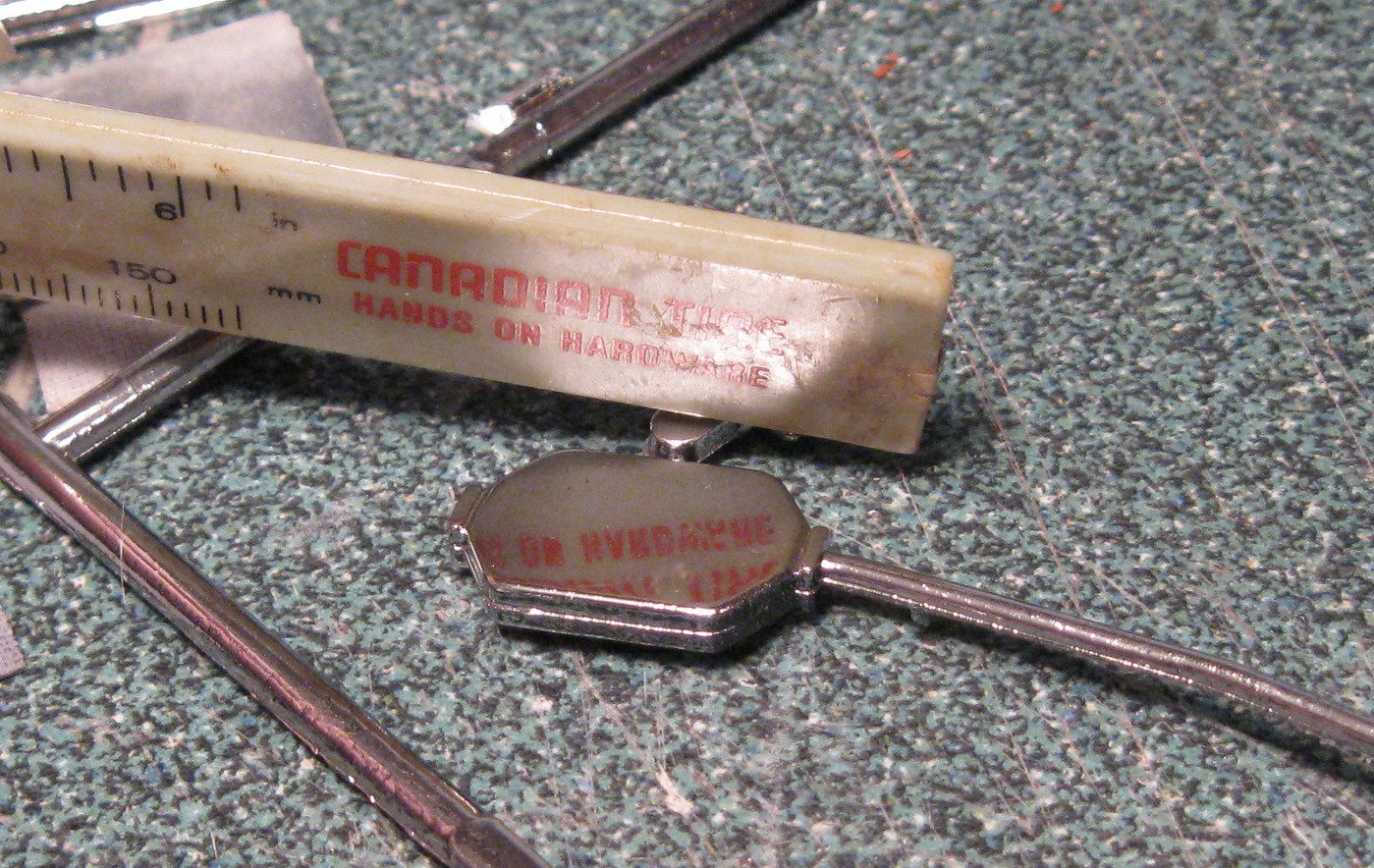

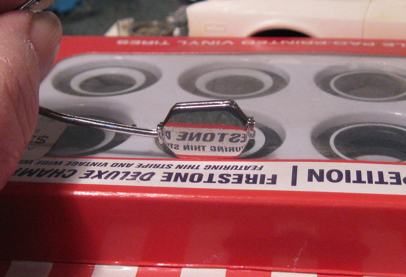

Can-Con Posted May 20, 2023 Posted May 20, 2023 Got some this morning and tested it out on a couple parts I had laying around. No real prep, just made sure they were clean and dust free as possible and sprayed right from the can. This has only been drying for about 6 hours and is already pretty durable. I think it will be as safe to handle as any other model paint after it's dried longer. Here's an old resin bumper I cast years ago. ,, and sitting on a chrome tree for comparison. A Jo-Han 442 front bumper that had poor chrome. Just pulled it off the car, cleaned it up a bit with a toothbrush and a bit of water to get the dust off and sprayed strait from the can, as the rest of the stuff in these pics,, , , , and here's the kicker,, an old MPC Cragar sprayed on the right compared to a brand new wheel on the left,, So, while not 100% as shiny as kit plating, it's almost there. Some probably will prefer this over kit plating. Certainly better then most chrome sprays and super easy, just spray it on.I will be using this in the future for probably anything I need chromed. 13 4
Matt T. Posted May 21, 2023 Posted May 21, 2023 Thanks Steve. I think it looks better than the kit chrome in your photos! 1
espo Posted May 21, 2023 Posted May 21, 2023 The finish looks a little more realistic compared to the "kit chrome". 3
Can-Con Posted May 21, 2023 Author Posted May 21, 2023 30 minutes ago, thatz4u said: may be better with a black paint coating first... I doubt it would make a difference Al. This stuff it pretty opaque and goes on pretty thick and evaporates down unlike Alclad and a few others that need a basecoat and go on in mist coats. But I think I'll dig out something molded in black and shoot it later to see if there's a difference.
