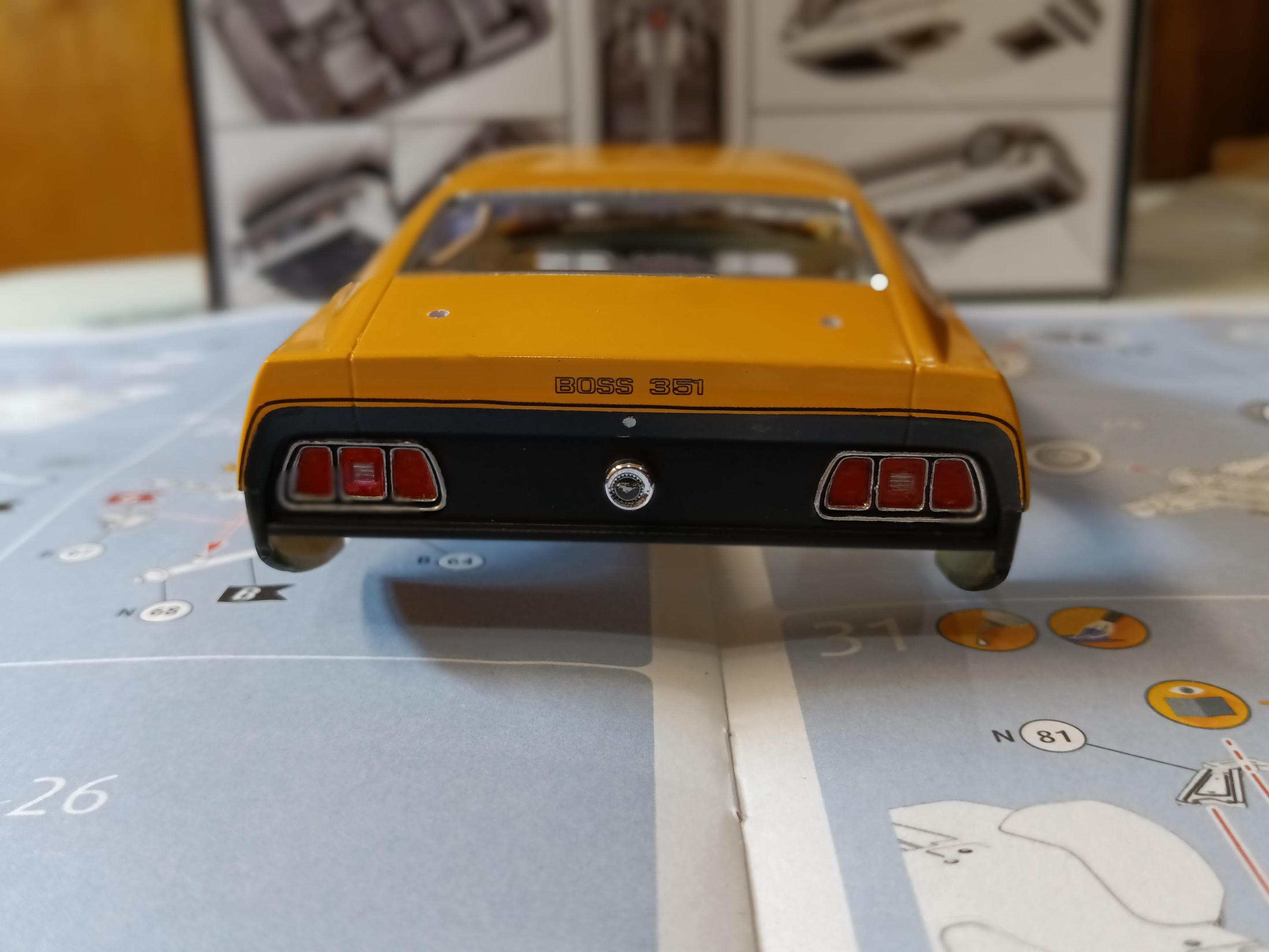

tim boyd Posted August 27, 2023 Posted August 27, 2023 On 8/21/2023 at 8:22 PM, vamach1 said: Great job and attention to detail on the grille and tail light panel. The kit has some very small decals and I wonder how many will really adhere (e.g. on the horse in the grille and gas cap). Rex...I too was concerned about this, but with MicroSet and MicroSol, they all worked perfectly....TB 1

baycolony Posted August 28, 2023 Author Posted August 28, 2023 Thanks Tim! FYI, I just noticed and read your article on FSM regarding this build and I have to say it was pretty comparable to what I envisioned and am encountering before reading it. the other issue, which you also mentioned, is the black surround on the hood. I have already painted it Matte Black and applied the decal whilst trying to blend in the correct sheen and I don't know that I am satisfied yet. That being said. I may elect to clear coat everything, mask around the whole black area and recoat. We will see, but I should have more on this later in the build. Bob, I don't recall how much they were since I had purchased them a while back for a future build. If you check their website I would imagine they are still for sale.

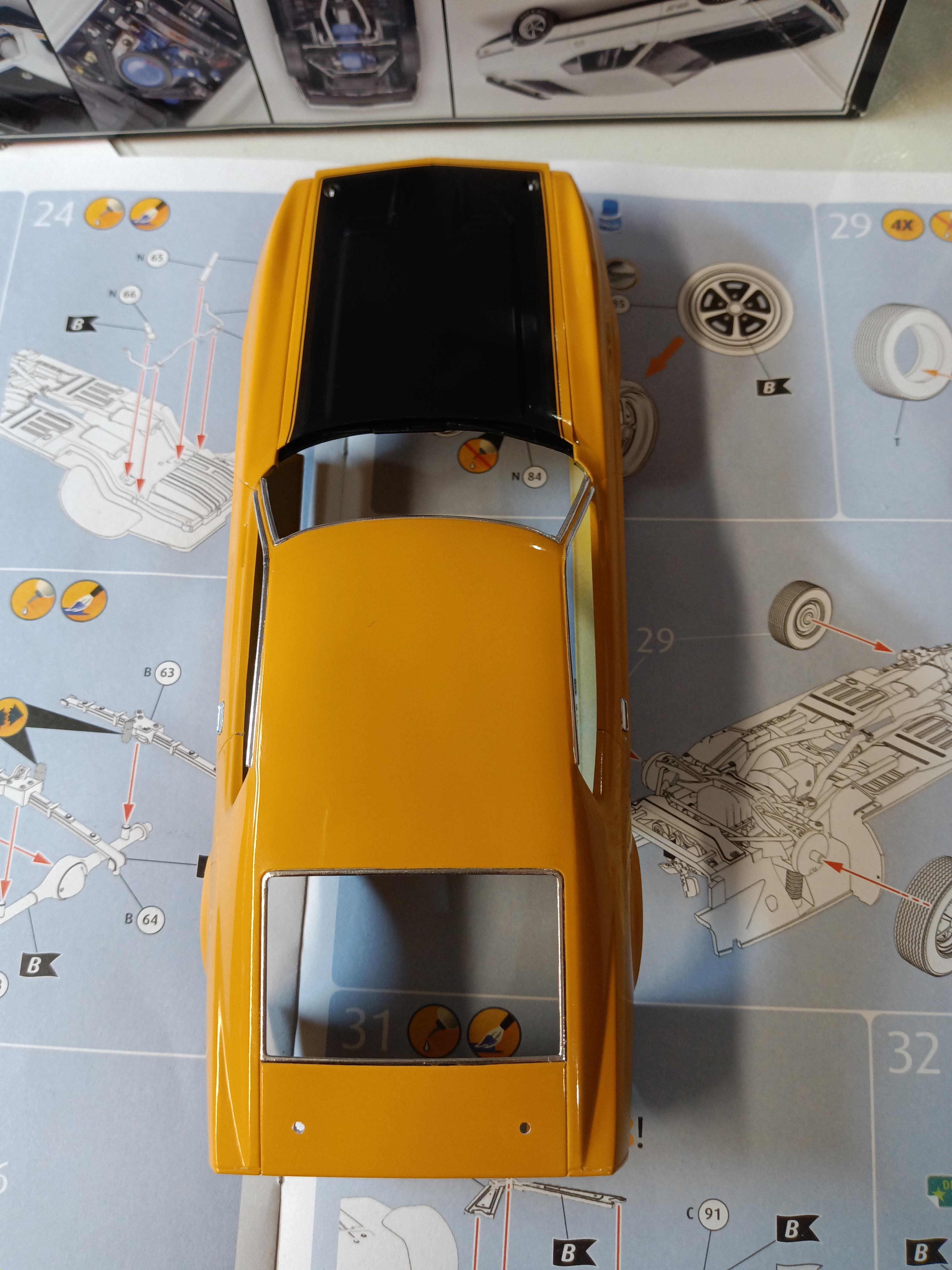

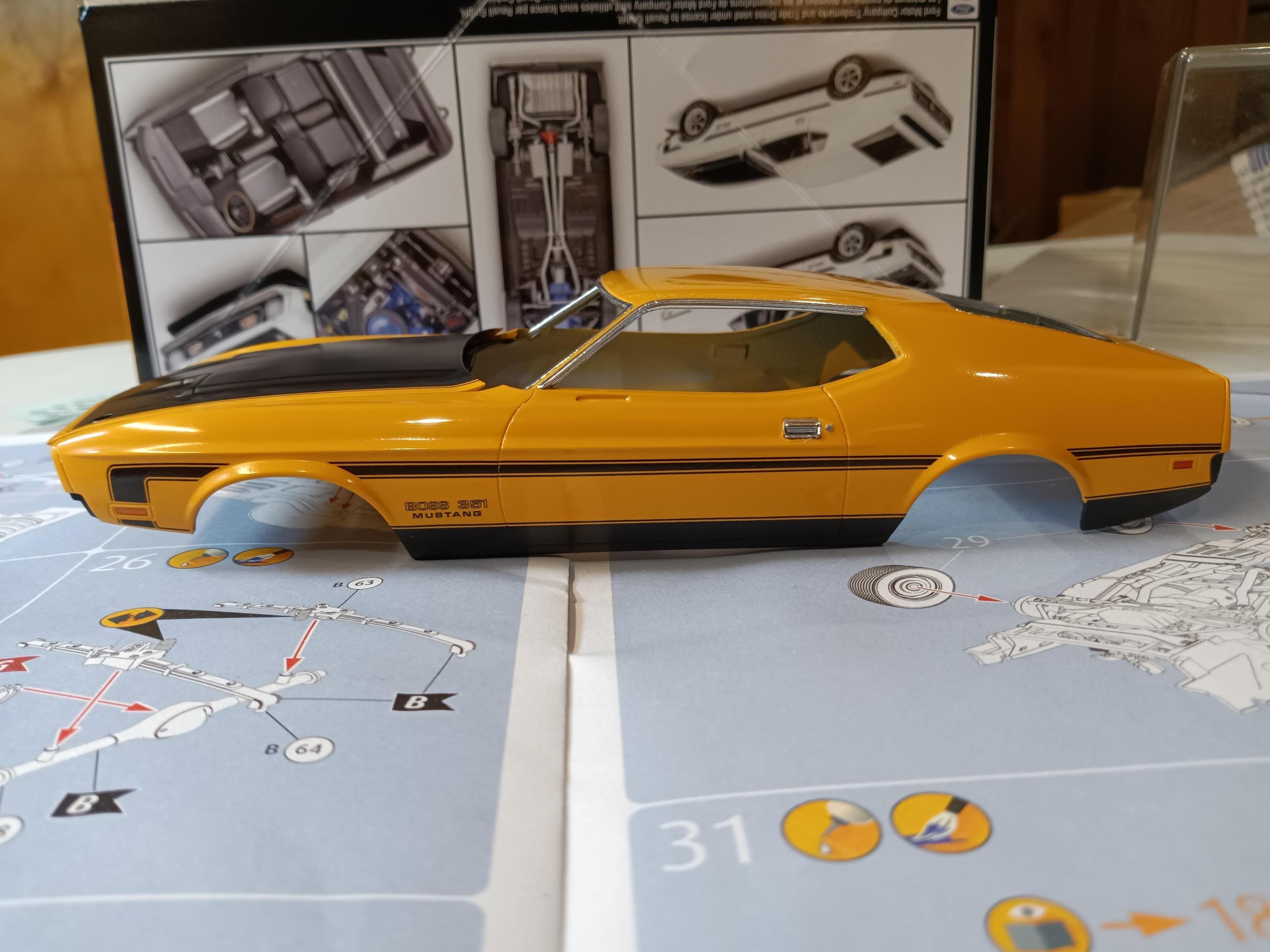

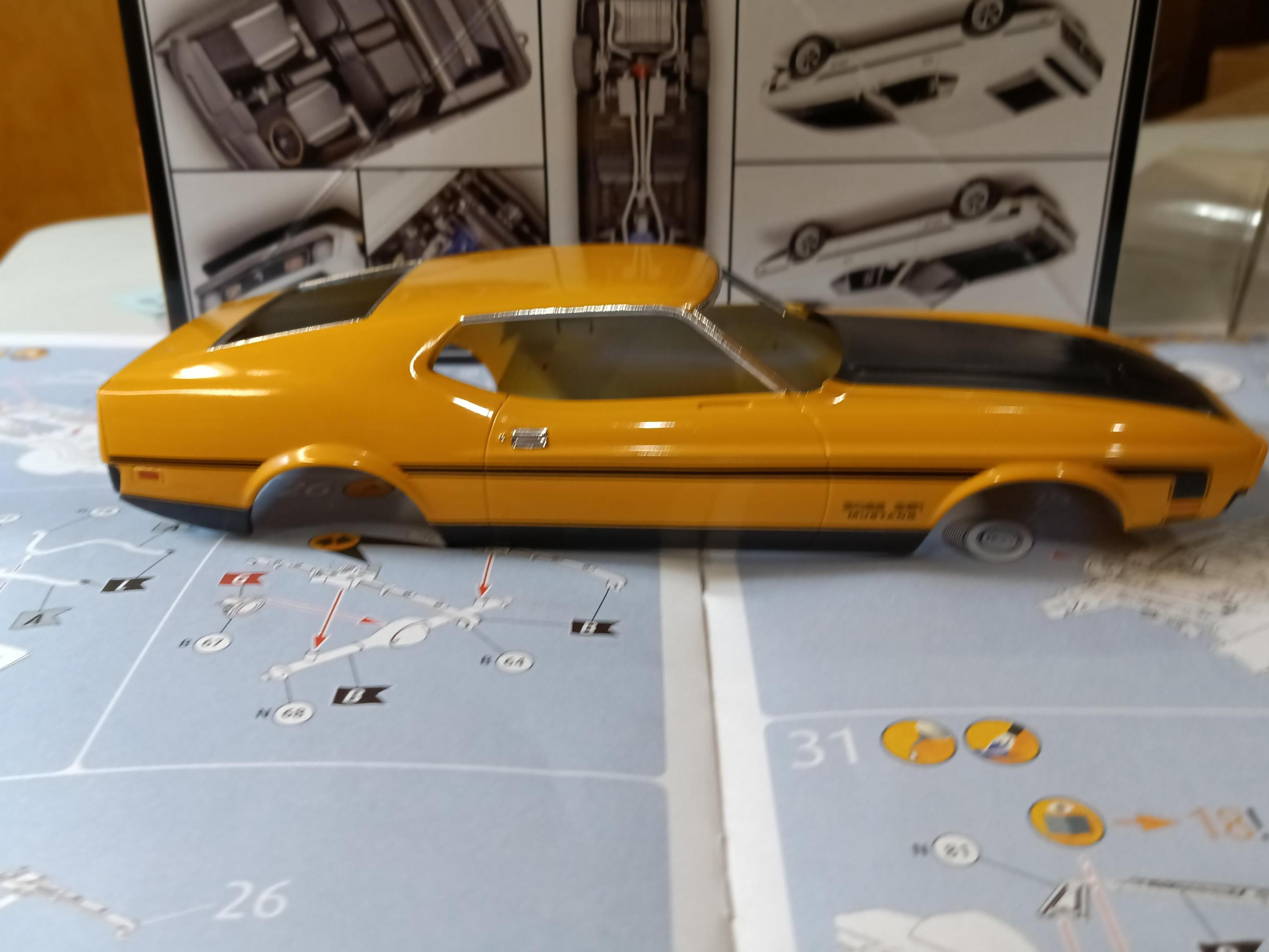

baycolony Posted August 29, 2023 Author Posted August 29, 2023 (edited) This next update shows some progress with the body and the wheels. I have added the decals to the body and used bare metal foil for the chrome trim. For the lower blacked out sections I painted the black as shown previously but only added the pinstripe portion of each section from the decals. The hood decal was also added and appeared glossier than the satin black that i painted on the hood. After sanding down the ridge that was formed after painting the black, I hand painted some Vallejo satin clear over the black decal section to try to blend the sheens. It isn't really noticeable at a glance, so I may be satisfied with this. Also, I have finished the Fireball wheels with Alcad Polished aluminum over a black gloss base. I then used a black wash to darken the lettering and rings. I also added small valve stems. To install the wheels, I had to shave down the back to allow them to fit into the tires. The tires were also sanded down to depict wear. BTW, I didn't use the Shabo dry tranfers because they didn't perform well after being stored so long, so I used the kit decals which performed perfectly. One note for those building this kit: If you notice the holes in the trunk that were drilled for the rear spoiler, take note that one has to drill them at an angle or widen the lower part of the hole on the inside or the spoiler supports, which are angled in opposition to the trunk, or they will not fit flush. Edited August 29, 2023 by baycolony 8
Bainford Posted August 29, 2023 Posted August 29, 2023 Sharp looking Mustang, Gil. Coming along very nicely.

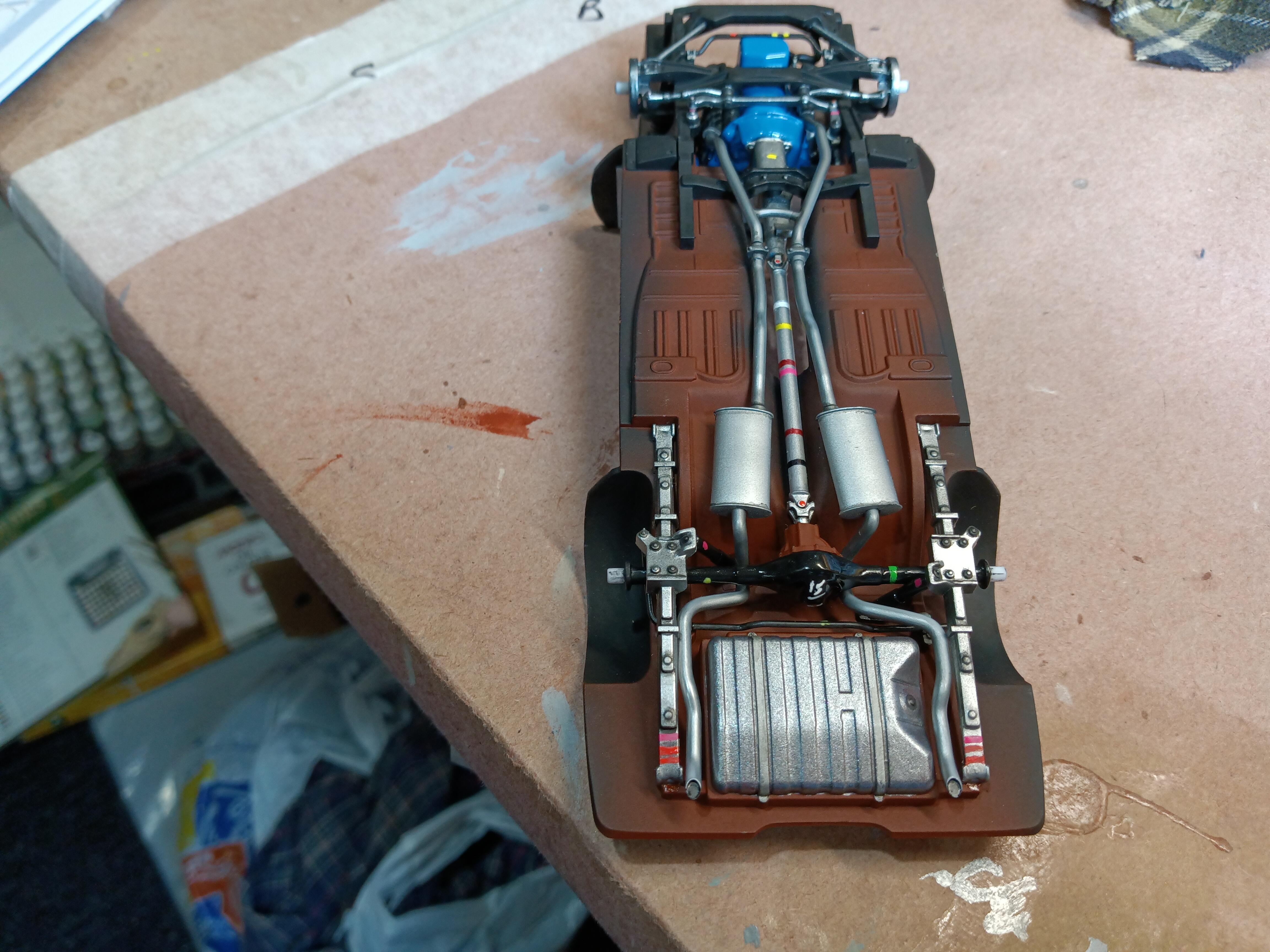

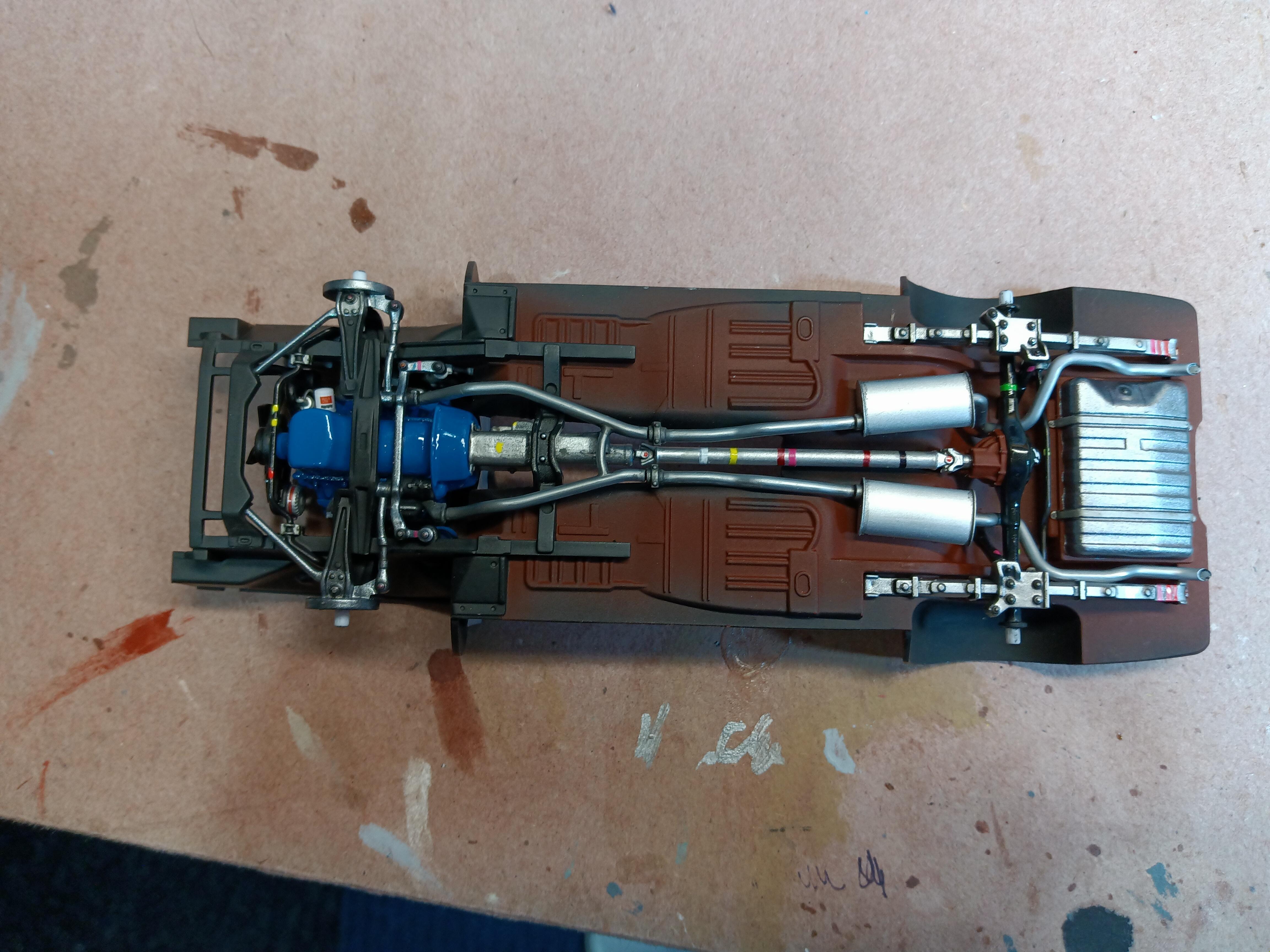

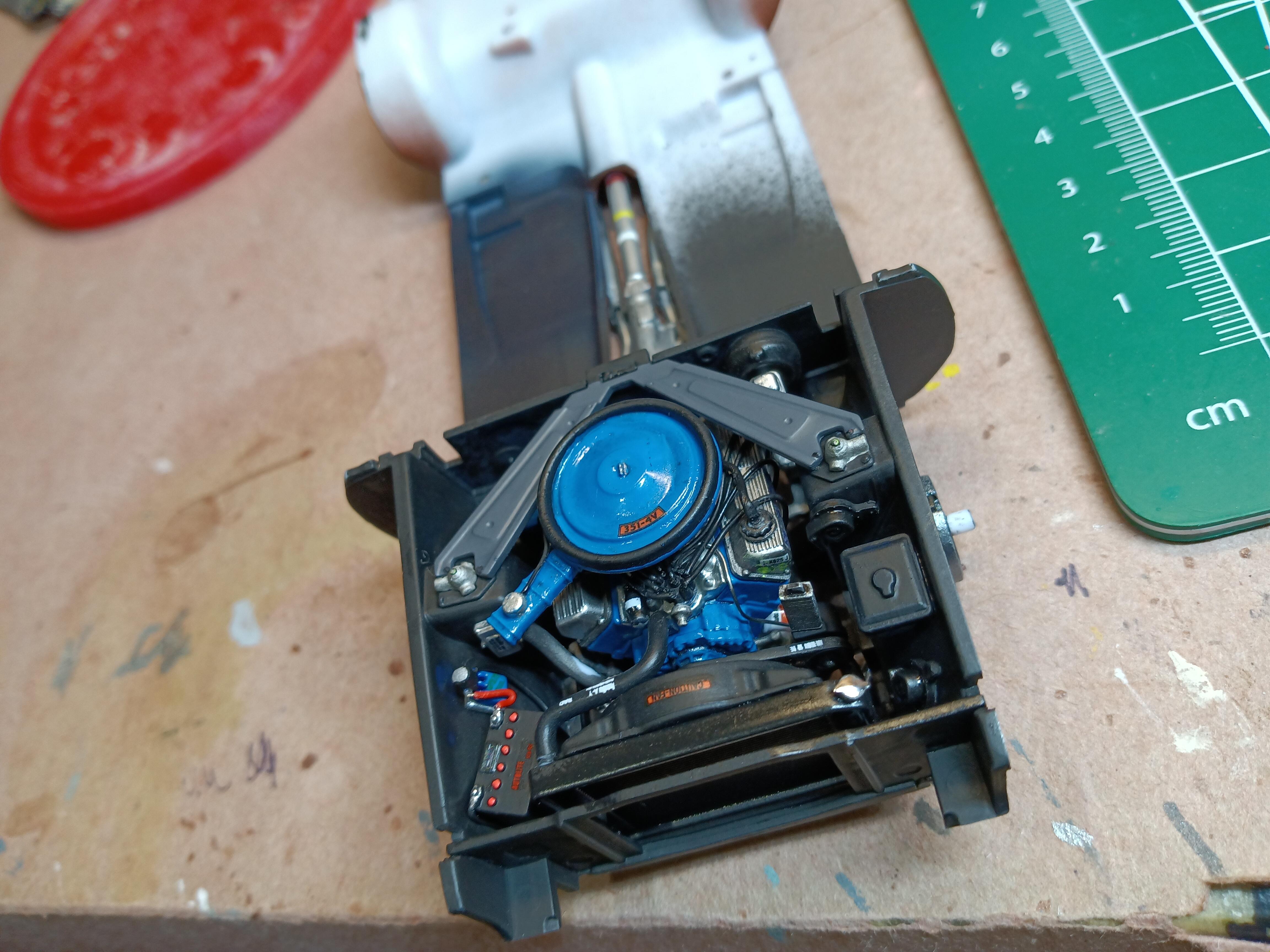

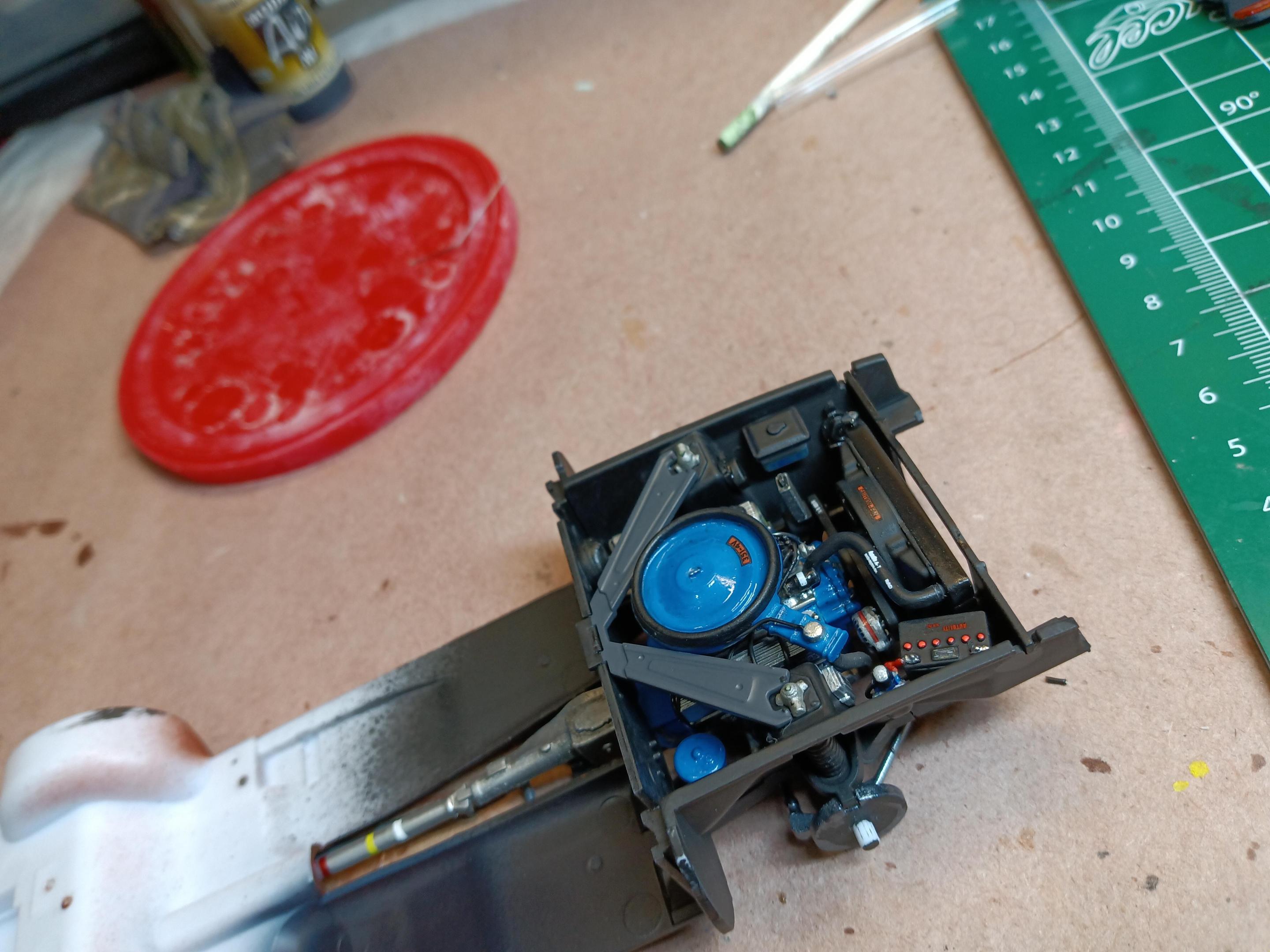

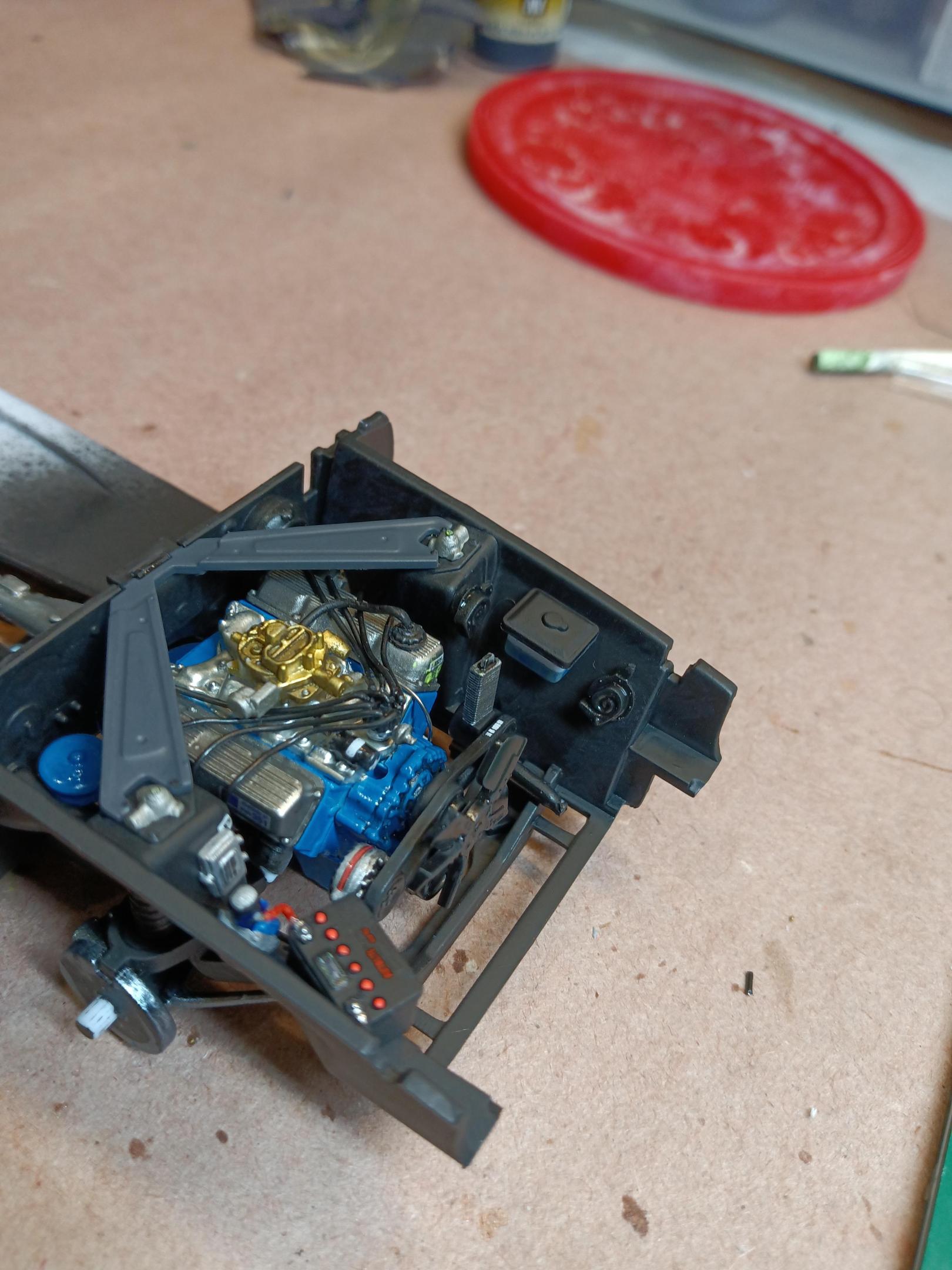

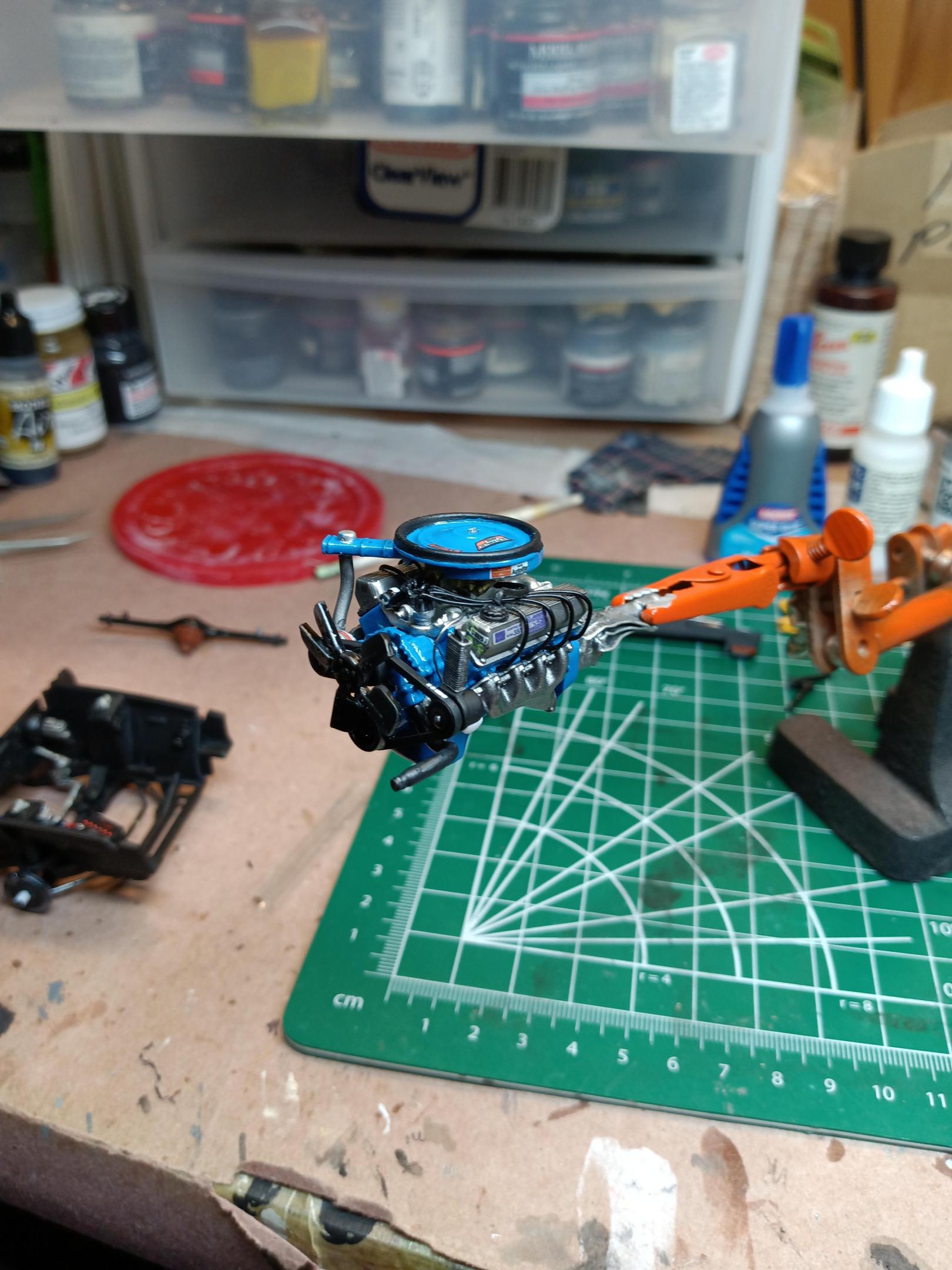

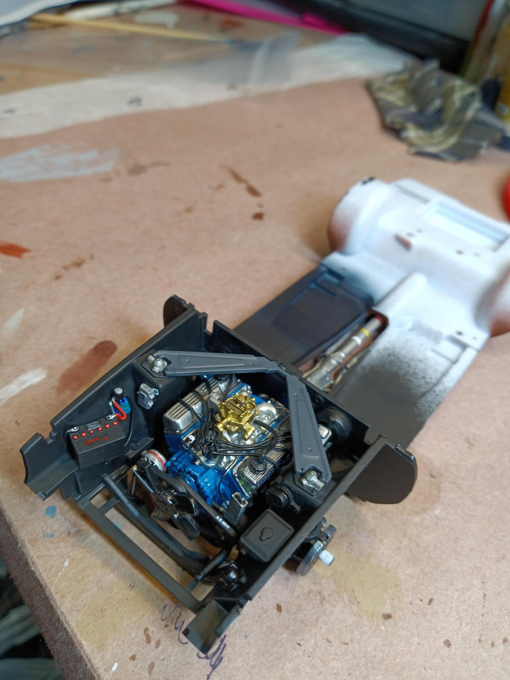

baycolony Posted September 24, 2023 Author Posted September 24, 2023 I finally got the drive train and chassis finished. I was very impressed with the level of detail and fit of the parts, especially the suspension parts which sometimes can be problematic with final stance if they are not positioned perfectly. These seem rock solid. For the engine I have added some plug wires, a PVC hose, fuel line, and battery cables to the battery and solenoid. The callout for intake manifold color in the instructions (blue) is obviously wrong, and should be aluminum. The Carburetor is one of the best OOB I have ever seen and is a shame it won't be visible with the air cleaner assembly attached. I painted the chassis with red oxide primer and black over spray. The suspension and drive train components were decorated with factory paint inspection markings. 10
vamach1 Posted September 24, 2023 Posted September 24, 2023 Amazing attention to detail high lighting the potential for going above and beyond adding the wiring, vacuum hoses, pvc hose, and battery cable. Looking forward to the interior and your completed build. The “stock” wheels and trim ring and hub caps are a nice touch too.
RocketFoot Posted September 24, 2023 Posted September 24, 2023 Looks great!! I am getting more and more excited to start my build but first, I am doing a practice run on the AMT kit.
dino246gt Posted September 25, 2023 Posted September 25, 2023 WOW! That looks amazing, Revell? Man they've really stepped it up, or is it just YOU! It does look fantastic though, thanks to your skills, very cool!
baycolony Posted September 26, 2023 Author Posted September 26, 2023 Thanks!, and Dino, a little of both...Revell supplied a really top notch kit to work some magic 1

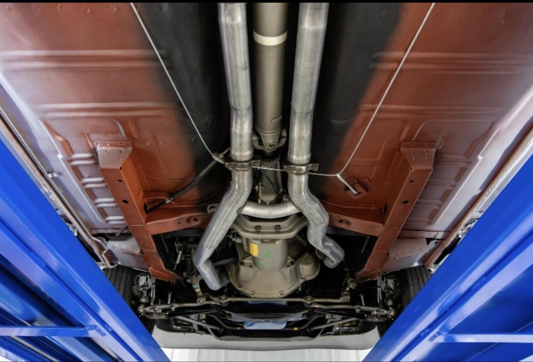

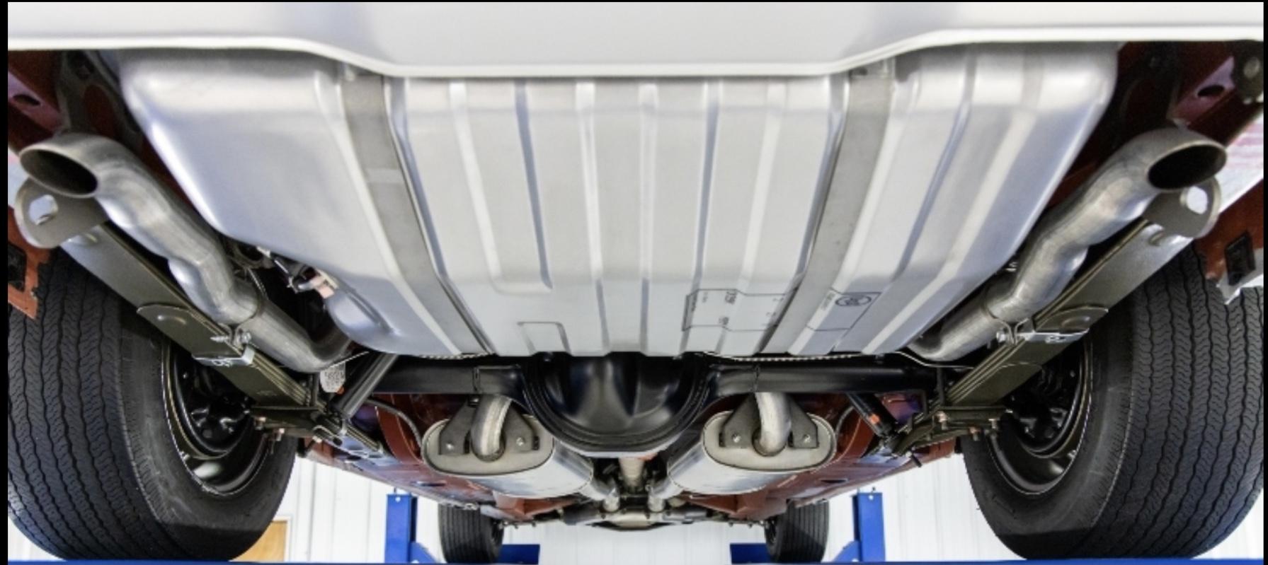

vamach1 Posted September 26, 2023 Posted September 26, 2023 I found a few pictures up the underside of a 8 time MCA gold winning Boss 351. Pretty to look at but a shame it will probably not see any miles on the road. 3 1

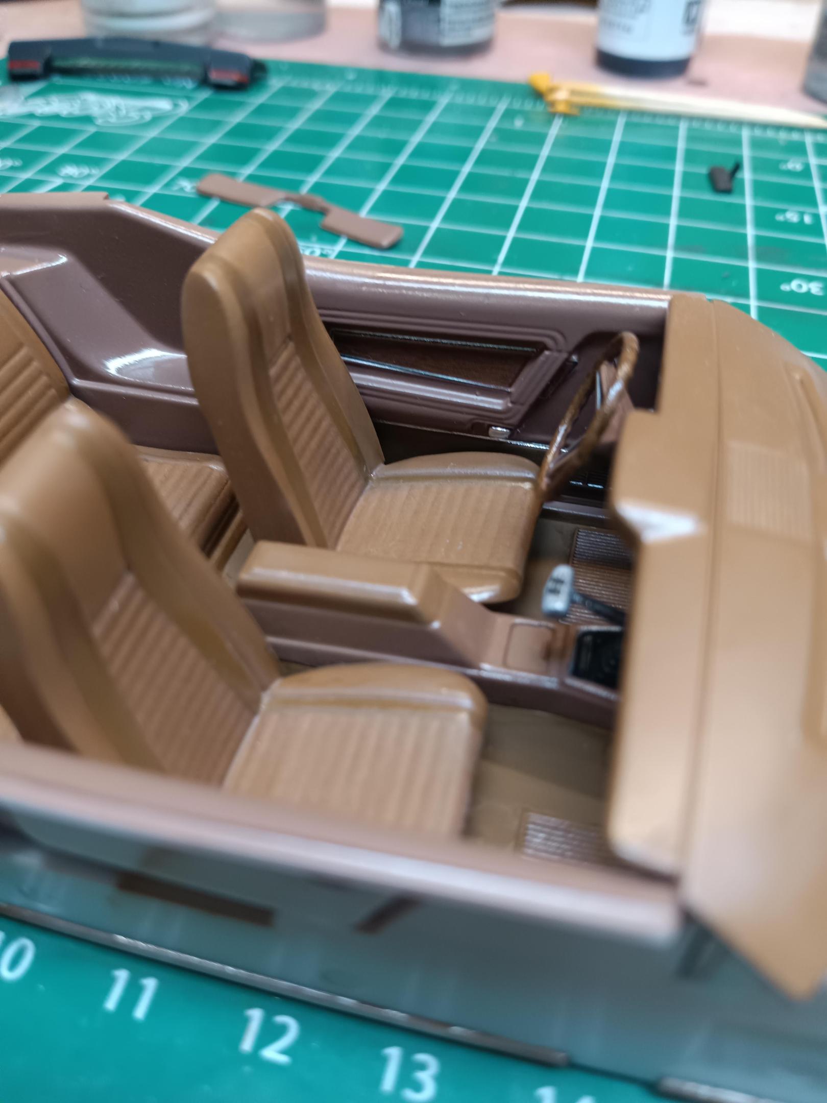

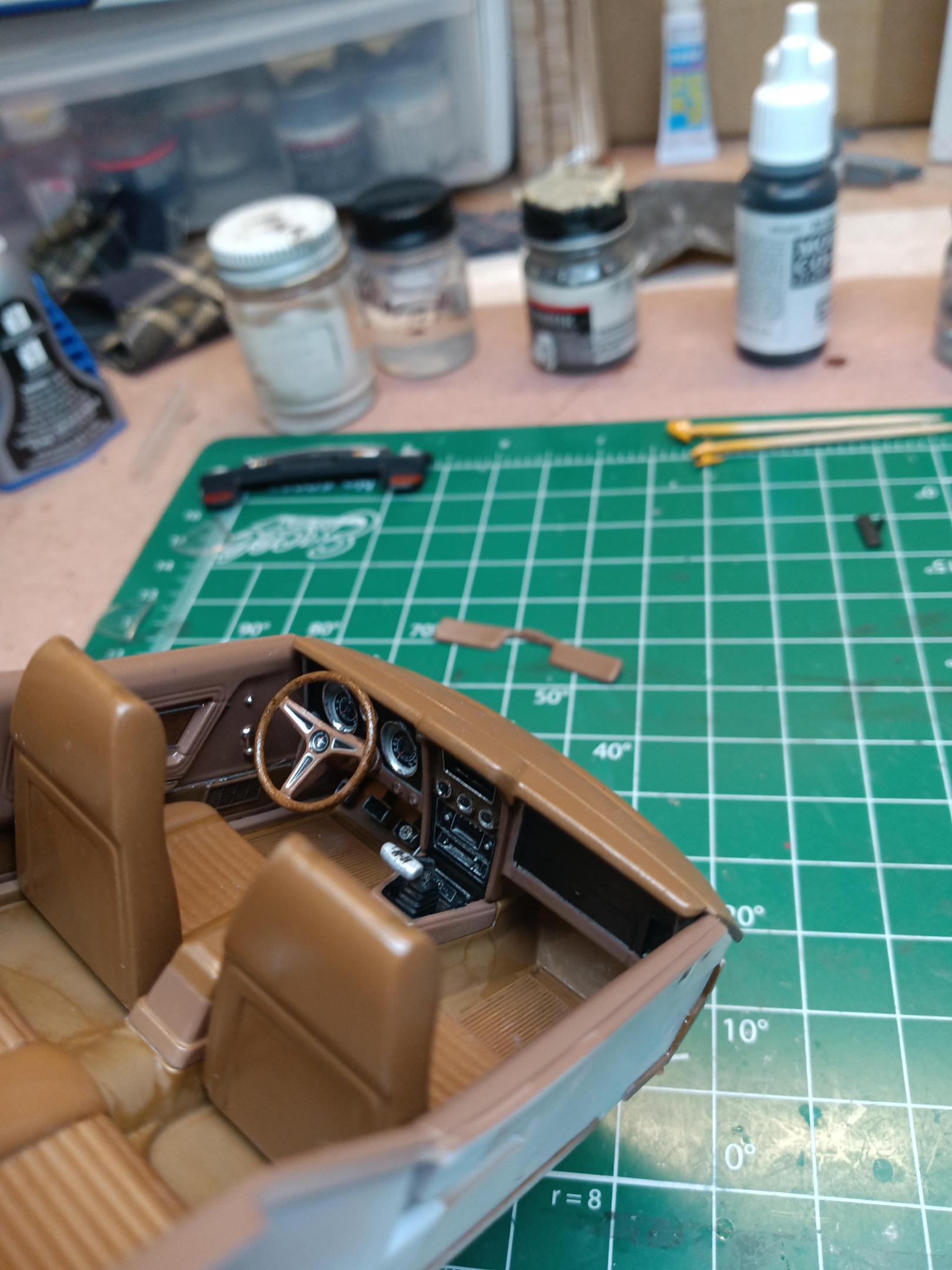

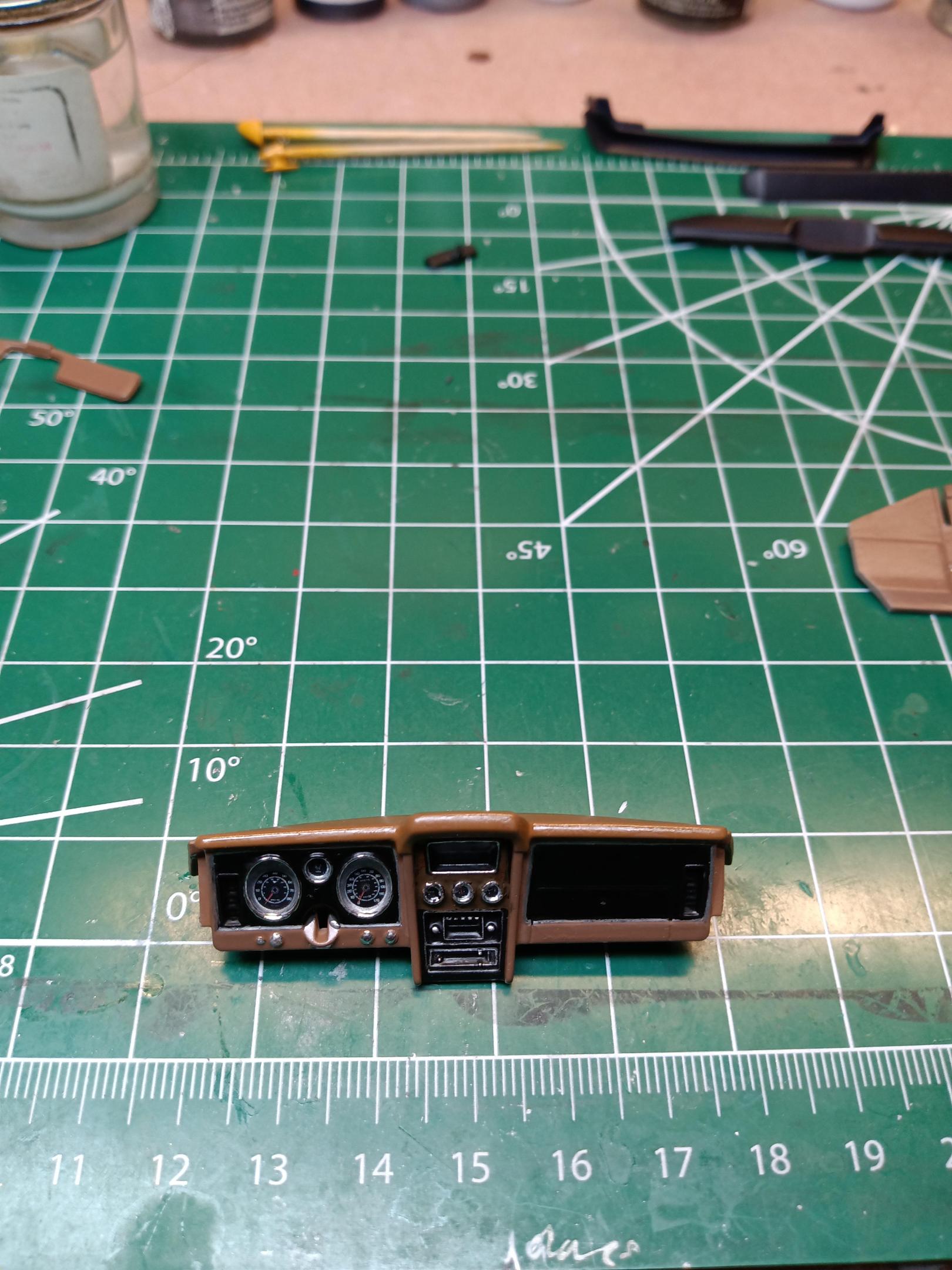

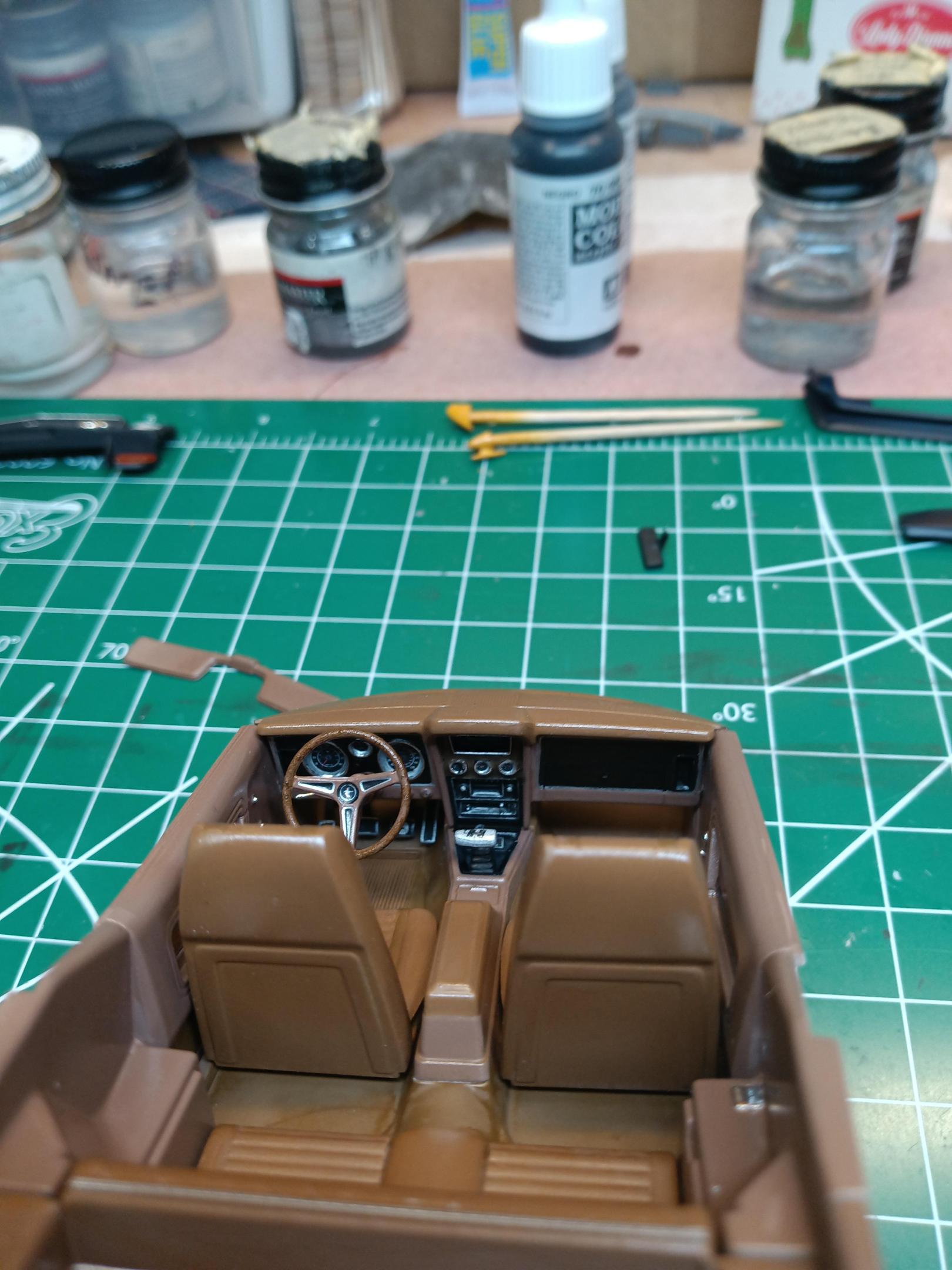

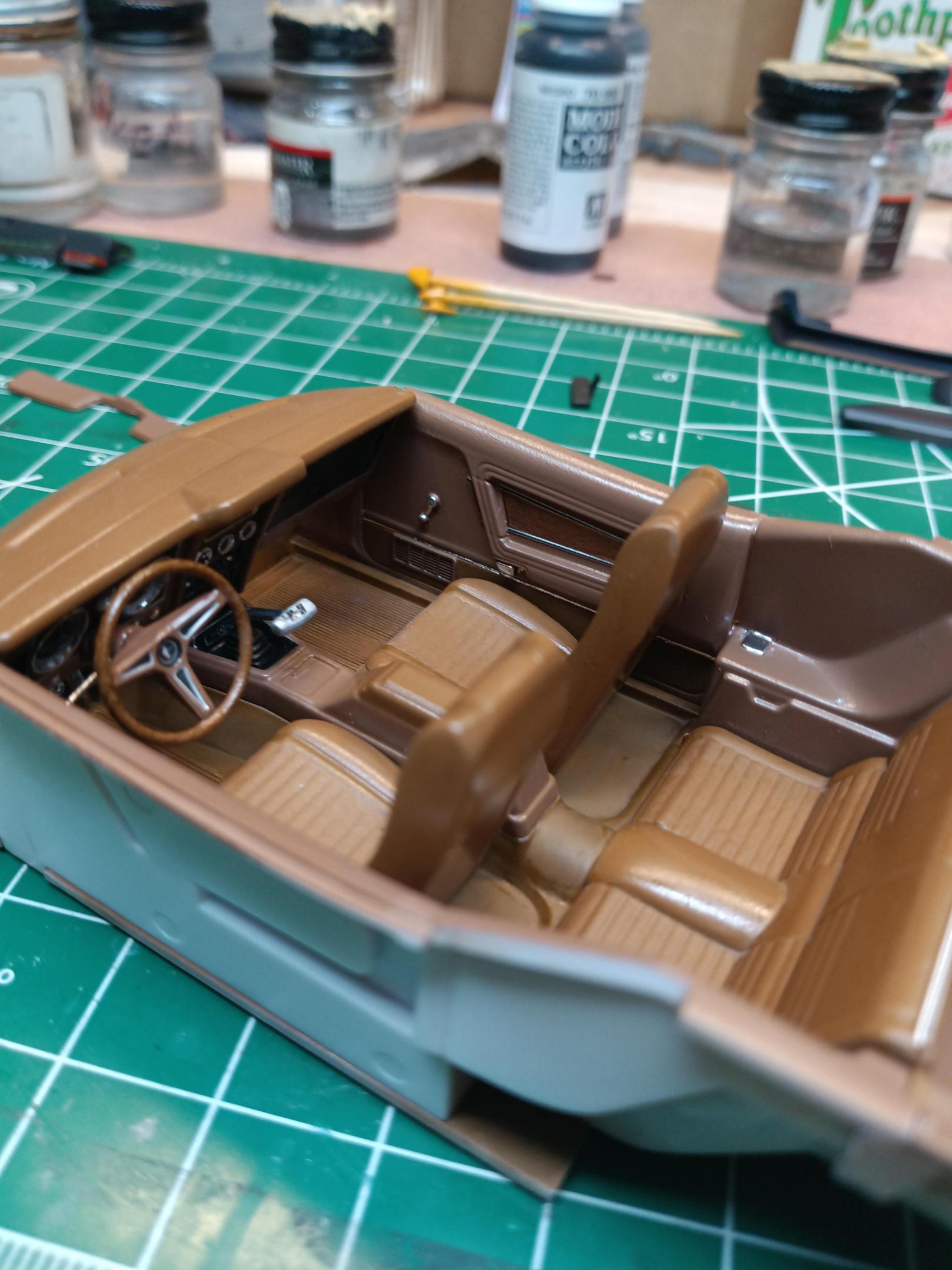

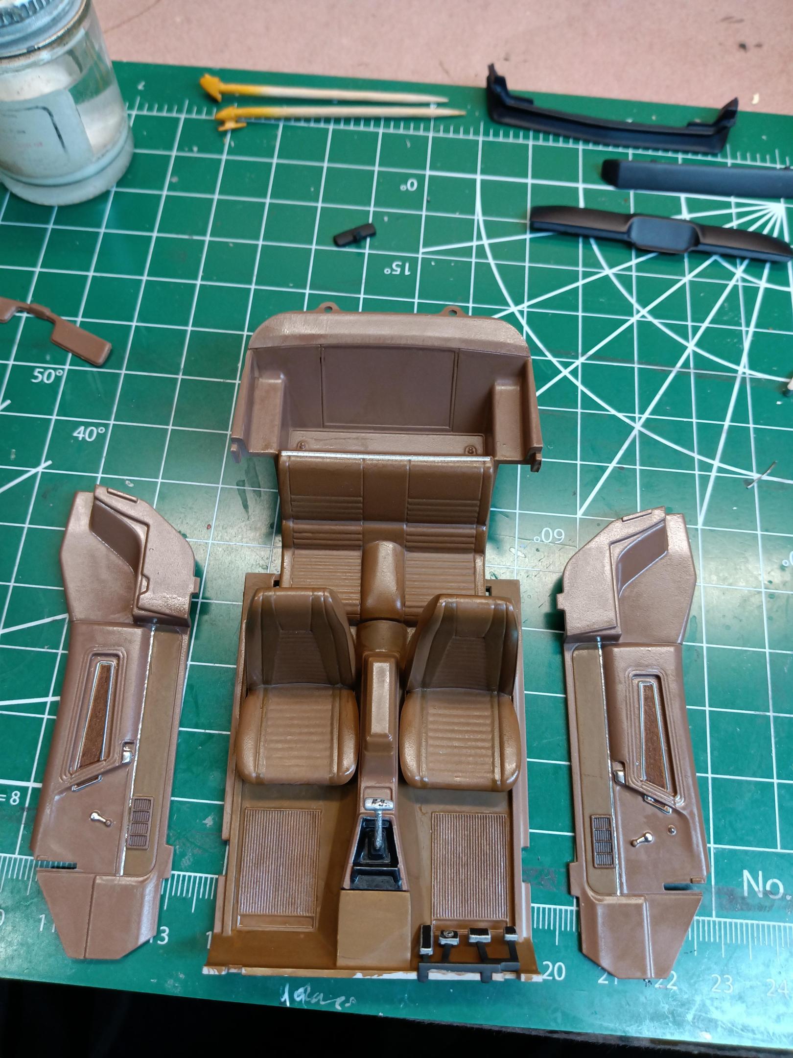

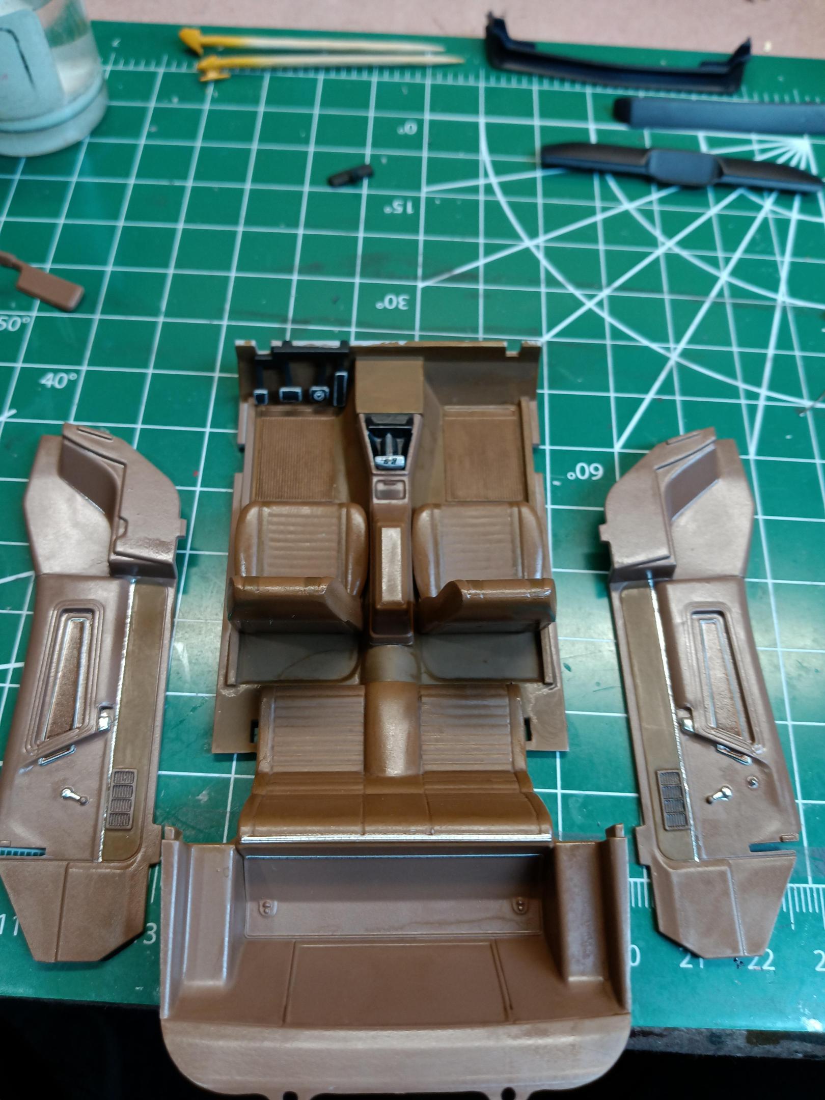

baycolony Posted October 5, 2023 Author Posted October 5, 2023 So as promised, I completed the interior in "Ginger." I used some Vallejo Military colors to get the right tones as I noticed that reference pics showed varying subtle color differences. This interior also brought with it the challenge of a multicolored dashboard. This required a lot of detail painting. I also replaced the directional lever with a piece of brass rod. One note: The wood grain decal surrounding the middle instrument cluster fits very poorly and i ended up supplementing it with matching paint. It may be easier to just paint the area. If you choose to use the decal you need to cut out the openings for the 3 gauges prior to applying. I am nearing the end. I hope you enjoy the pics. 5 1
Justin Porter Posted October 5, 2023 Posted October 5, 2023 That looks fantastic. It may sound odd, but the bit I'm most impressed by is how fully three dimensional the door pulls look!
RocketFoot Posted October 5, 2023 Posted October 5, 2023 I used to have a 72 Coupe with Ginger interior and yours is spot on! Nice job!
Rattlecan Dan Posted October 5, 2023 Posted October 5, 2023 Your meticulous attention to detail is beautiful. Doing a gorgeous job.

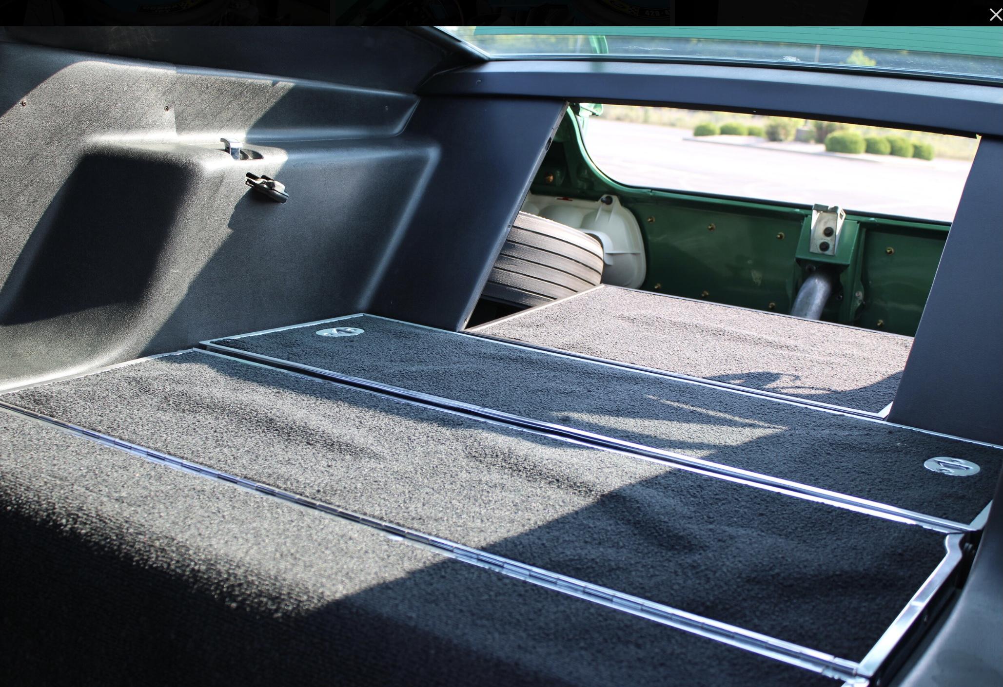

vamach1 Posted October 5, 2023 Posted October 5, 2023 Looking fantastic. I have the fold down seat option in my 72 Mach1. Here’s some pictures of the rear seat of another sportsroof I found online that shows the fold down seat area with the chrome latch parts.
mustang1989 Posted October 5, 2023 Posted October 5, 2023 The vinyl seat coverings and door trim looks extremely convincing and the details are very eye catching. You're doing some good work in here Gil.
