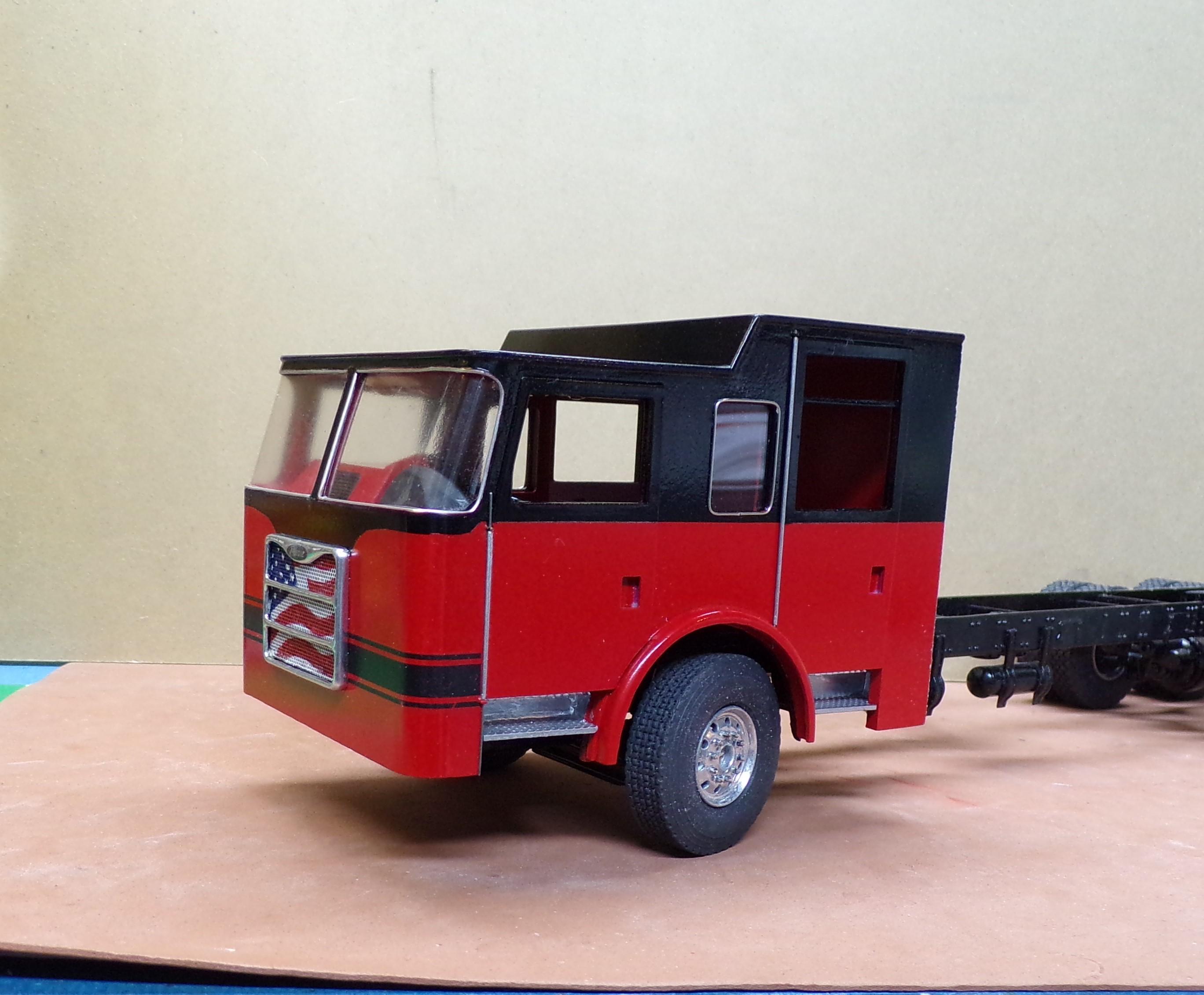

Got the elves back to work with a little coaxing but I'm still not happy with some of their stuff.  The windshield pieces still bug me as to why I can't seem to get a clear vacu form of it.  It has to be the buck not being perfectly smooth as it always tends to be a bit cloudy.  The pieces are in place but are removable so I may try again.

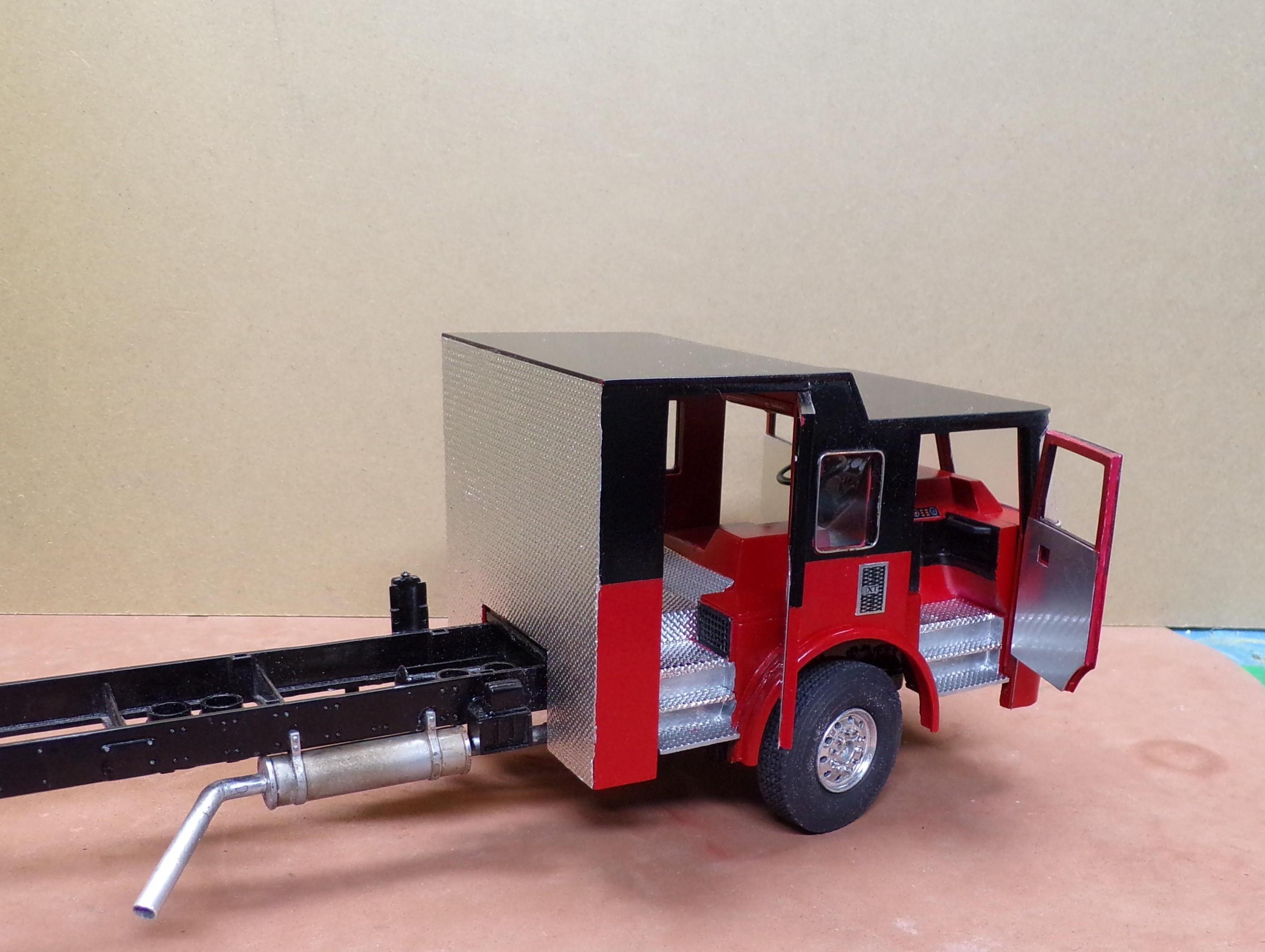

Interior continues to come along.  The doors are nearly done and only need the latches and the new glass sections.  Then I can snip off the excess pins in the hinges.
Each inside door panel is aluminum.  It will get a latch and grab handle before being completed.
The right side has a ventilation panel that was made with a piece of sheet aluminum and a decal to represent the openings.  The real one is a series of arrow cutouts and the letters XT.  This cab is the "Arrow" that Pierce put out a short while ago.  It's no longer being made as they have moved on to other designations.

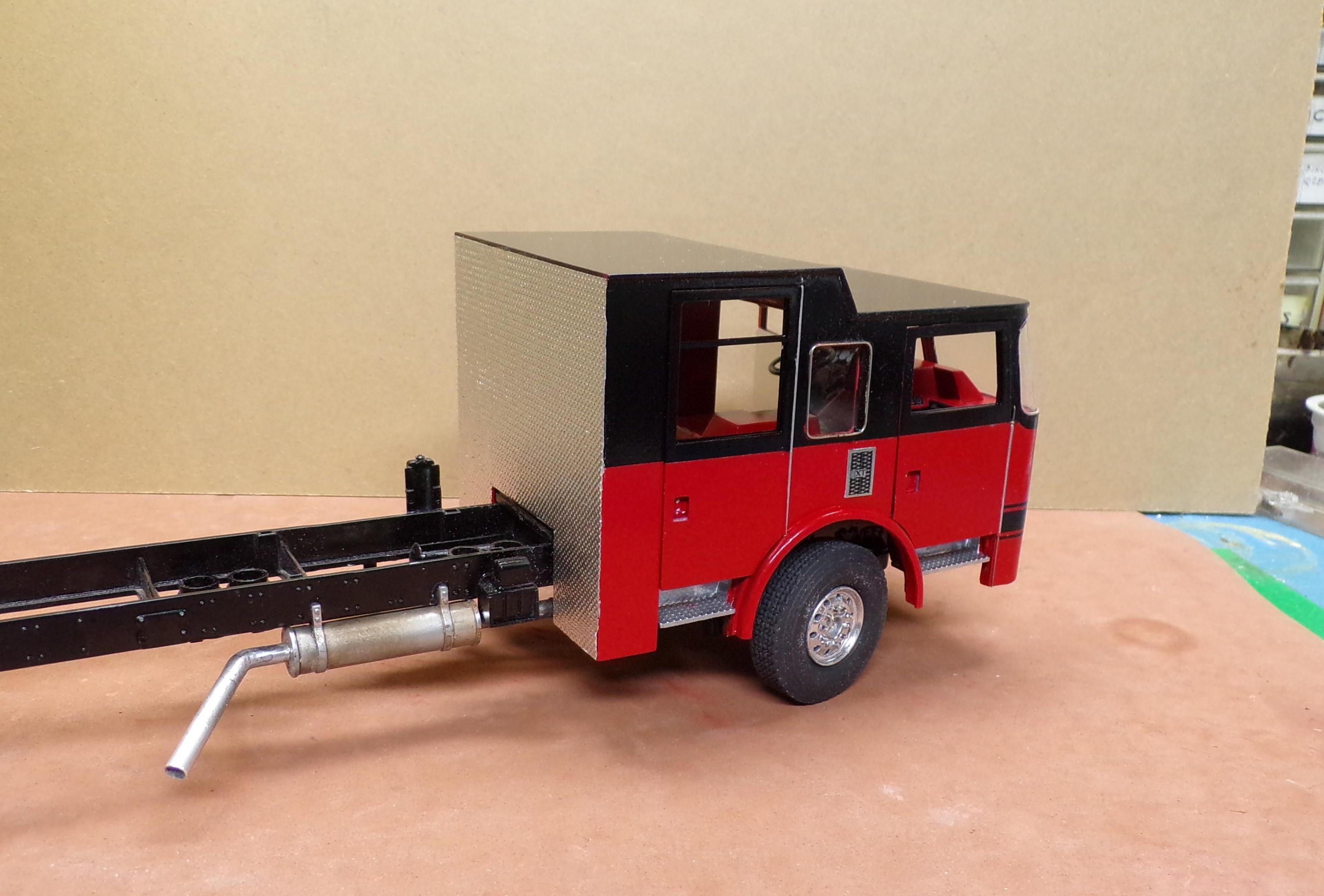

One more project to complete the steps on each side.  But the interior needs to be set in place first.  Also the wheel well surrounds need to be chromed up.  The back cab diamond plate panel is now dressed in embossed aluminum foil that was set with 2 part epoxy.

Nice detailing on the vent, and the muffler mounts too. It all looks so good in living colour, with contrasting chrome trim. Just realized how long this chassis is gonna be in these pics!
It's loooong for sure!  Solved the windshield problem and got the chrome grill surround and headlight bezels done.  Casting the lenses now so that I can get them mounted.  I spent some time today correcting problems including the removal of the grill to reposition it more centered.  Took off the striping also.  There is an additional detail that needs to be added to the right side.  One step forward, two back for a while now but things are looking better.  Guess the elves finally got enough sleep to get them thinking straight again!?
