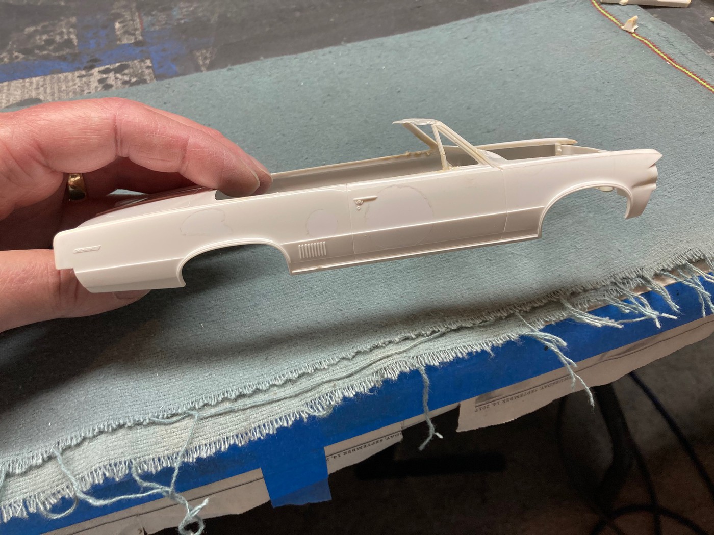

StevenGuthmiller Posted November 11, 2023 Posted November 11, 2023 (edited) Well, I've decided that I'm going to continue on with the final installment of my 1964 Poncho trio. The '64 Grand Prix and Bonneville are now in the history books, so all that I have left to do, (Short of an original AMT '64 GTO presenting itself) is this somewhat derelict AMT '64 Lemans convertible. I began working on converting an old X-EL 1959 Desoto Fireflite 4 door hard top into a convertible a few weeks ago, but I'm just not feeling it at this time. It was going to be a very involved project that would need a completely scratch built interior, and it was having a hard time keeping my attention, so I thought it might be better to move on to something a little less involved. Not that this project will be a simple one, as it's still going to be a full detail build with all of the usual goodies, but it will be a little less ominous undertaking than the Desoto. So, in any event, I picked up this kind of abused '64 Lemans at an antique shop many years ago for $12.00. It was missing the hood and tail light lenses, but I was able to replace those via Modelhaus before they closed up shop. Interestingly, as I'm not a big fan of working with resin, and I'm not particularly convinced of it's long term viability, on a whim, I went on eBay last night just to check on the odd chance that there might be an original hood available. Lo and behold, there was a pristine original hood that someone was selling for $20.00, so I snapped it up! At least now, short of the tail light lenses, the entire model will be styrene. The hood should arrive within a week or two. There is some minor damage to this kit, including a mild windshield frame crush, consisting of damaged and missing vent posts, and a crack in the center of the windshield header, but those are easy fixes. A little more of an issue is some of the interior glue rash. The previous builder had of course glued on the seat belts to the front bucket seats, causing some relatively minor damage to the upholstery pattern. These shouldn't be extremely difficult to repair. More daunting is the fact that he had also glued custom parts to the center console, completely destroying the fluted panels. Unless I can find some suitable material to replace those panels with, the entire console might have to go. Not that I have any aversion to console delete 4 speeds. We'll cross that path later. So in conclusion, I believe that one of the '65-'67 Chevelle chassis will be a good fit, or even more so, if the wheel base is correct, either the AMT '66, or the Lindberg '67 442 should be the ticket. I'll have to do more research on the engine to make an informed decision, but at this point it appears that a 6 cylinder, a 326 2bbl, or a 326 4bbl were the only options for the '64 Lemans, and if that's the case, finding a suitable Pontiac small block is likely to be all but impossible. In that case, I'll have to find out what the appearance differences were between the 326 and 389, and either do some parts swapping between them, or try to do some upgrading of the original engine. So, here's what I'm starting with. New chrome some time back and a new hood on the way. The tentative decision on color at this point is correct '64 Pontiac "Singapore Gold" from scale finishes. I'll have to do some research and thinking about it, but my initial thought off the top of my head is a dark red, or white and red interior. Either that, or some combination of gold and white, or just gold. Steve Edited November 11, 2023 by StevenGuthmiller 4

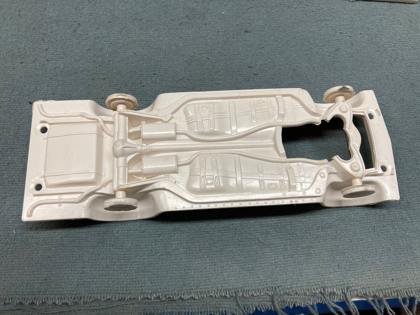

StevenGuthmiller Posted November 12, 2023 Author Posted November 12, 2023 19 minutes ago, kelson said: This should a interesting build,i have a couple of these in my stash,i thought the polar lights 64'GTO would make a better chassis donor,i'll be taking notes. My assumption was that the Polar Lights GTO had either a rudimentary “snap kit” type chassis, or was a copy of the old Monogram 1/24th scale kit. Regardless, it looks like either of the Oldsmobiles, or even more likely, the Revell ‘66 GTO chassis looks to be a very good option. Steve

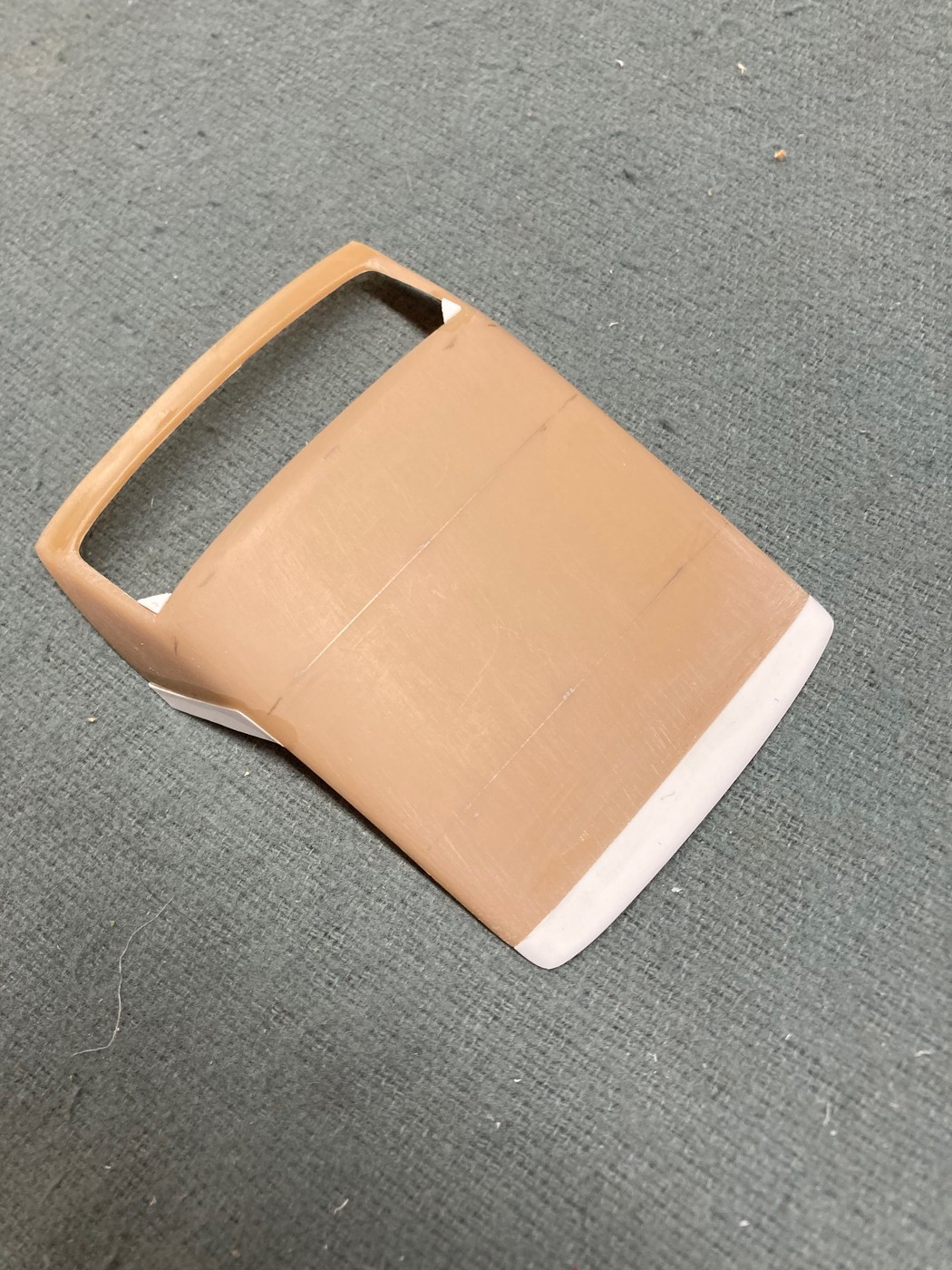

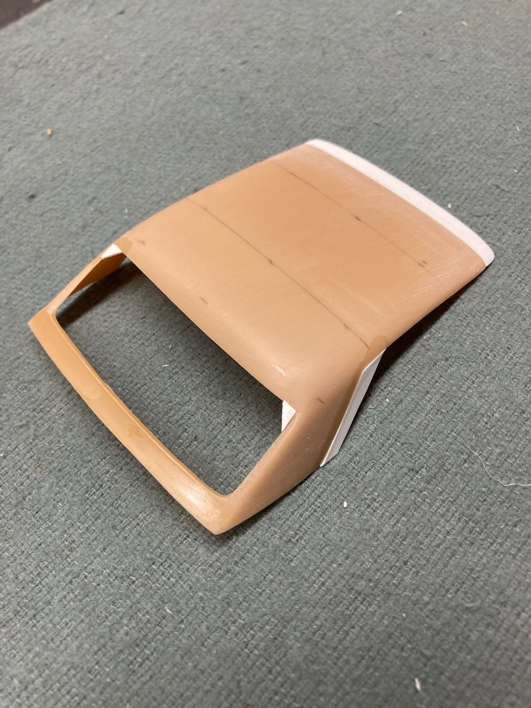

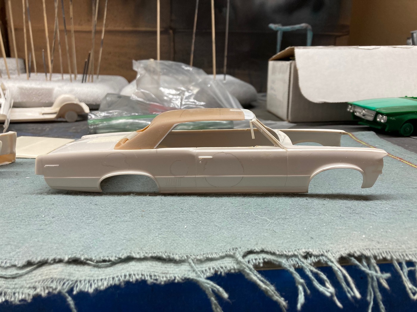

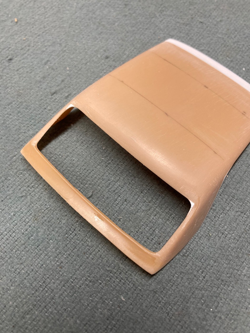

StevenGuthmiller Posted November 25, 2023 Author Posted November 25, 2023 (edited) "Bucky", (Keith Buckner) was so kind as to donate a hard top from the AMT '65 GTO kit for me to try to convert into a convertible up top for this project. Mega thanks Keith!! So, I began work on it today. First order of business was to sand the ridge along the corners of the top to ease, or round the corners, and to remove all of the trim. Then I did a little filing and sanding around the top and side of the rear window opening to try to reshape it a bit. Next came the "fillers". The top will be moved back slightly, so a filler panel was added to the front of the top. Then some fillers were added to the top corners of the rear window opening and the side window openings to round them to more closely resemble a convertible top. Once all of this work is completed, I will begin adding the top bows, followed by the top seams, and finally the welting around the perimeter and rear window opening. A lot of work I suppose, but this is the kind of stuff that I really love doing! Steve Edited November 25, 2023 by StevenGuthmiller 2
