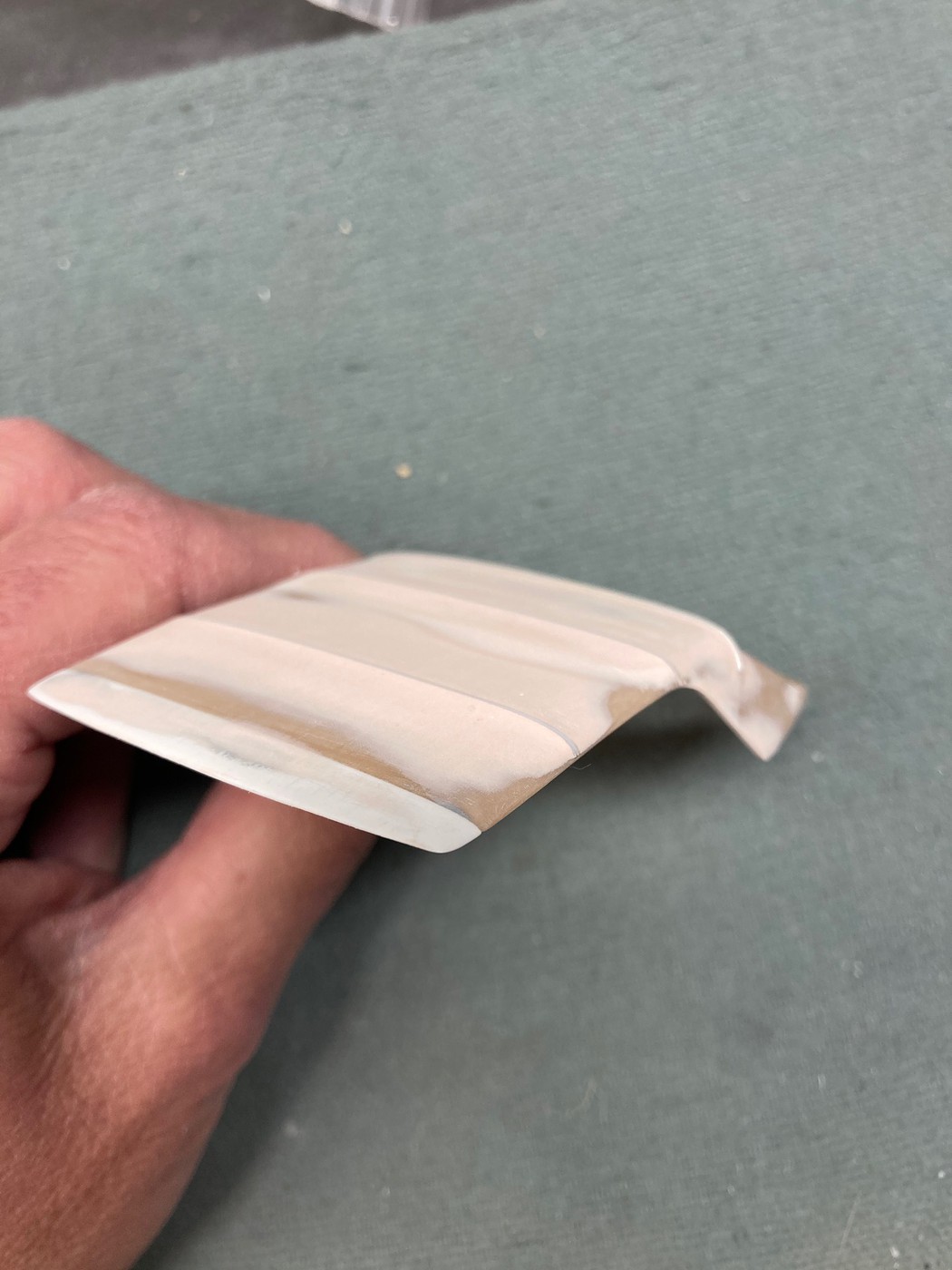

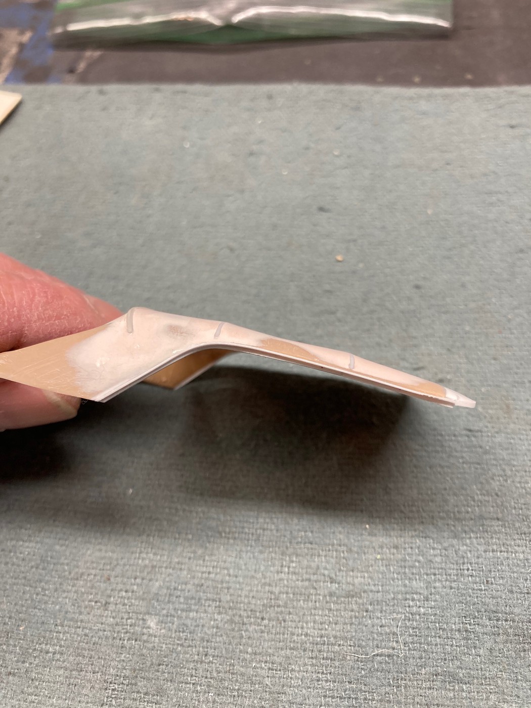

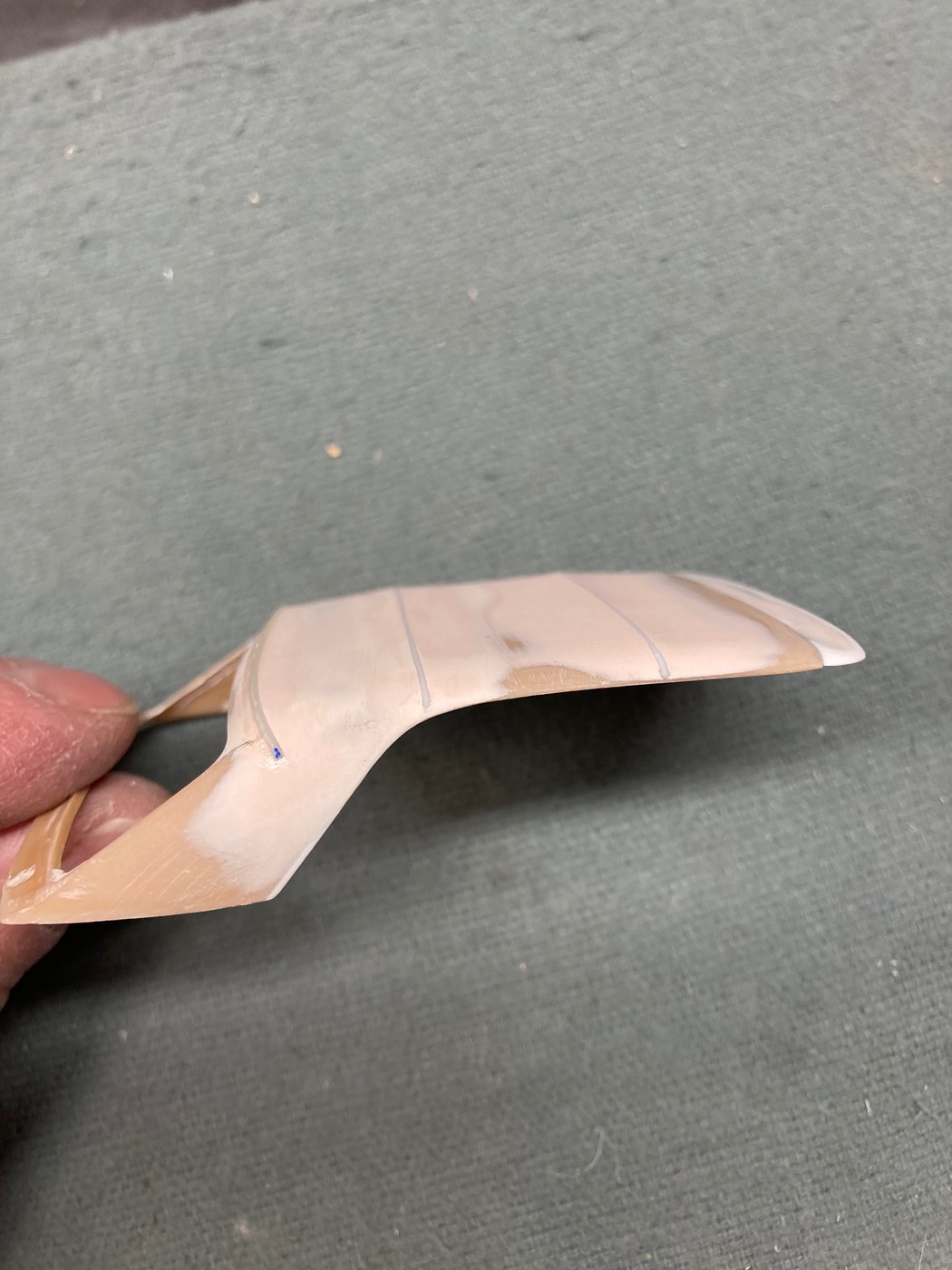

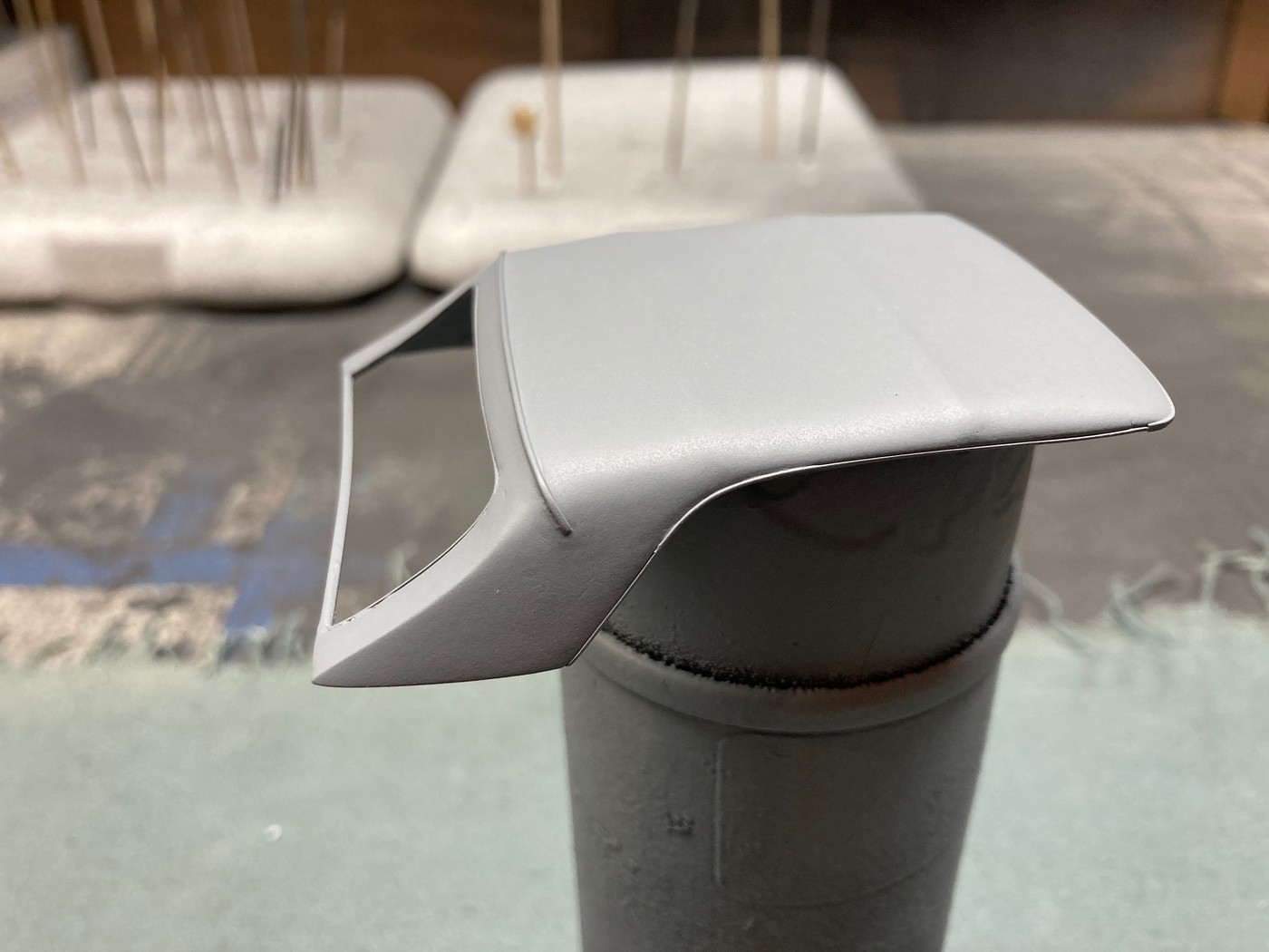

StevenGuthmiller Posted December 2, 2023 Author Posted December 2, 2023 A little more progress on the convertible up top. Added the top bows, filled with glazing putty and sanded. Also added the "beading" along the rear bow ahead of the rear window opening. I will still be adding the piping, or beading around the window openings, and then removing the portion of the top below the rear window before I prime to see what I've really got so far. Looks a little like a mess at the moment, but the shapes are looking fairly good as far as I can tell. Steve 6

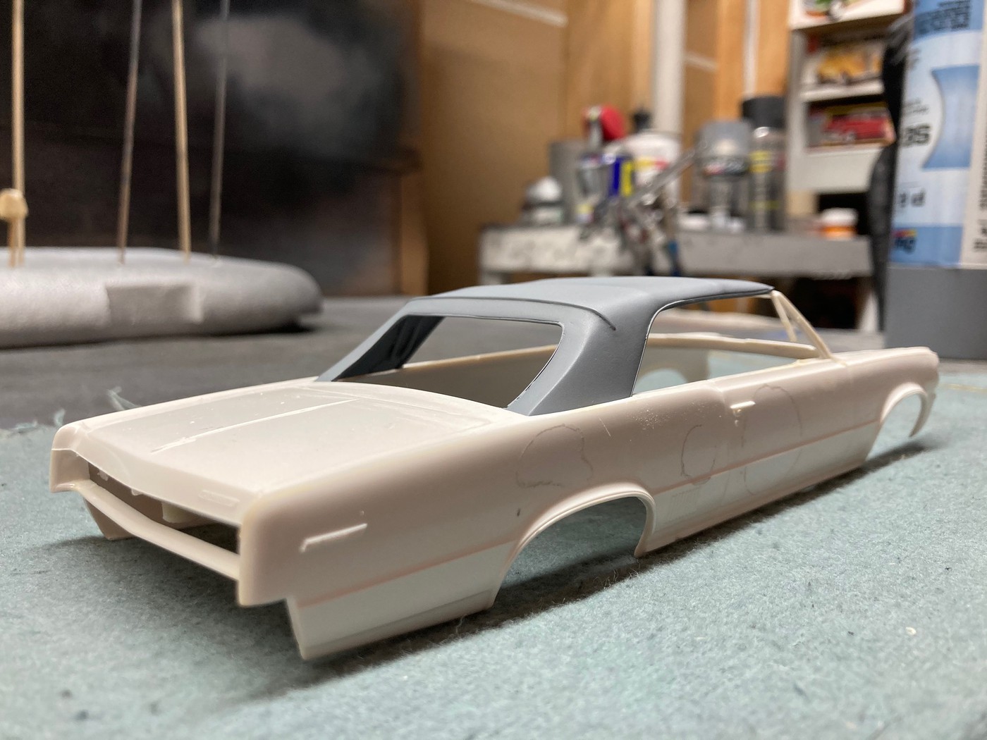

StevenGuthmiller Posted December 2, 2023 Author Posted December 2, 2023 1 hour ago, Nazz said: The top looks to be coming along nicely. Great work Steve ! Jerry 1 hour ago, NOBLNG said: Very crafty way of making that look like stretched fabric!?? Thanks guys! Began some of the piping and side window seals this afternoon. It's beginning to take shape! Steve 6

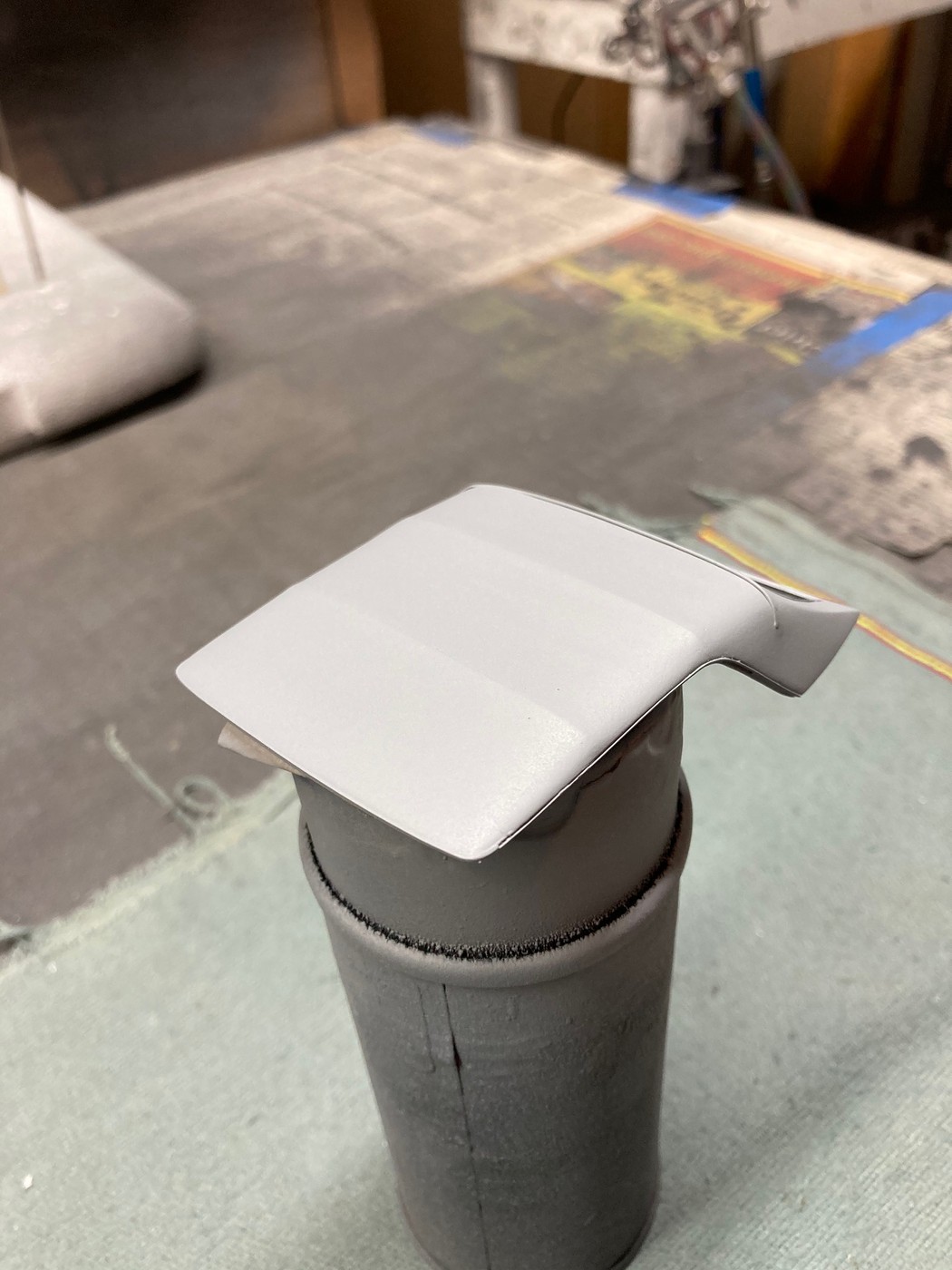

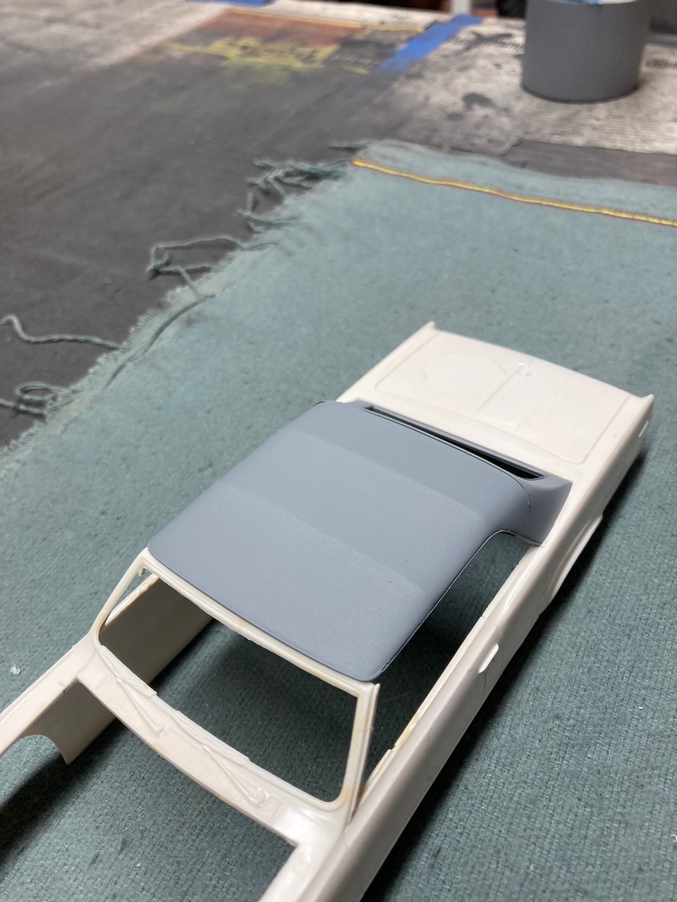

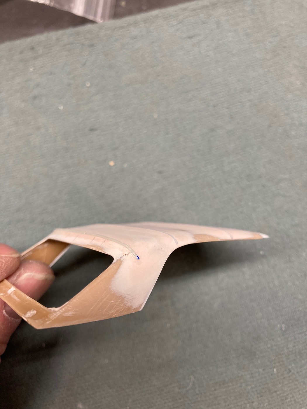

StevenGuthmiller Posted December 7, 2023 Author Posted December 7, 2023 Thanks everyone! Getting closer on the top, and beginning to open up the body so that the top sits down inside rather than just resting on top. I narrowed the rear glass by adding some fill panels to the sides, and then added a thin piece of shaped plastic to the bottom of the rear window opening. This will give me something to attach the rear window to, and insure that it will retain it's concave shape when the top is not in place. Once fitment is exactly where I want it, I'll begin adding the boot snap trim and finish up the piping and seals around the window opening. Steve 3

StevenGuthmiller Posted December 14, 2023 Author Posted December 14, 2023 Just for giggles, I decided to add some rudimentary top mechanism detail to the inside of the rag top. Steve 4

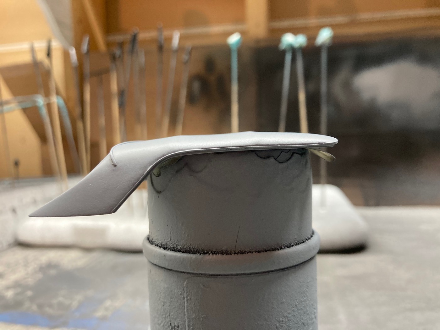

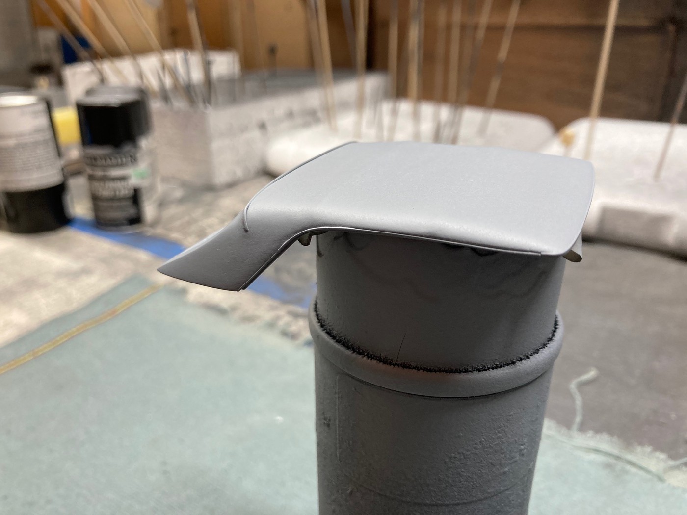

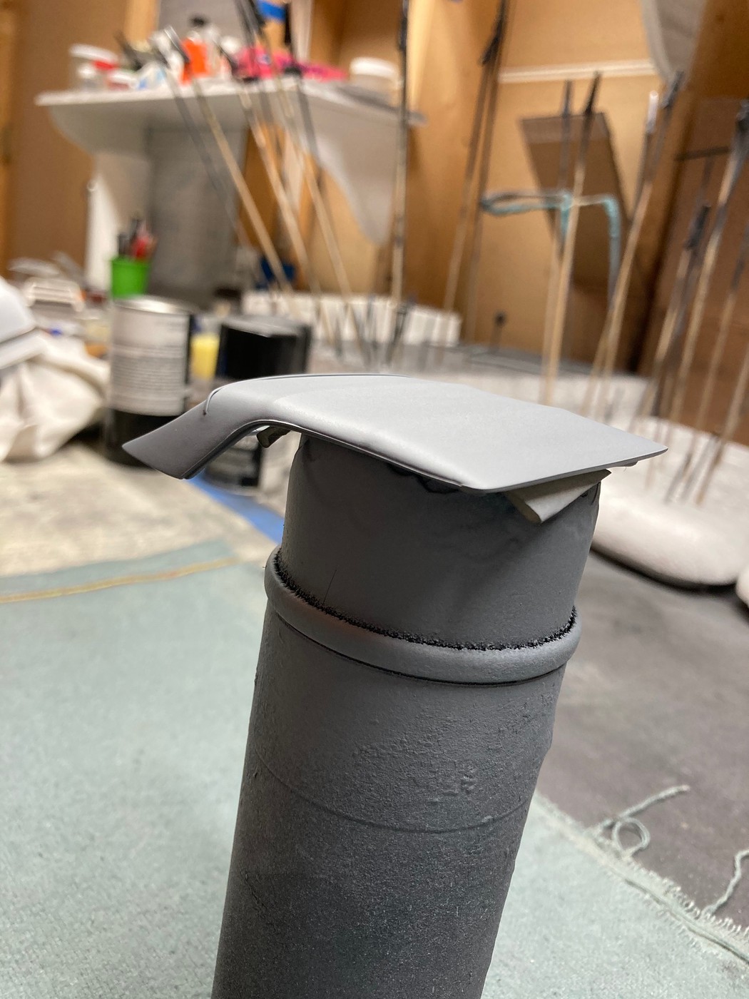

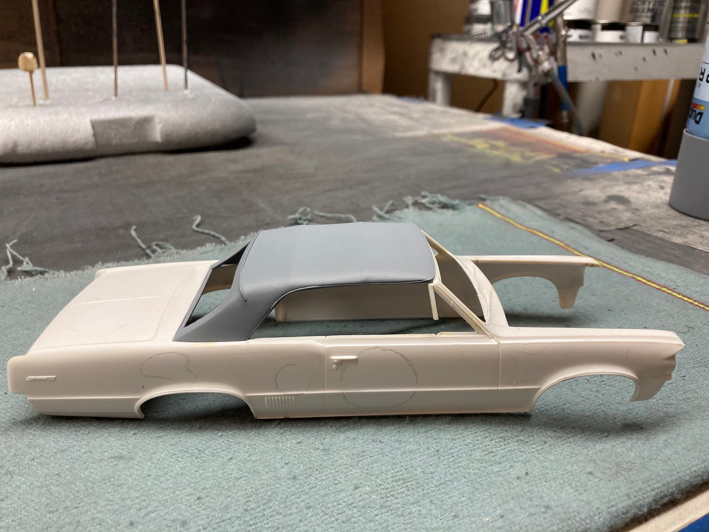

StevenGuthmiller Posted December 15, 2023 Author Posted December 15, 2023 33 minutes ago, Bucky said: So, now ya gotta open up the trunk and install the pump and hoses for that great looking mechanism!! Always something to look forward to with one of your builds! I think I'll pass. Did get some primer on it tonight! I have to say, I think it exceeded my expectations. Probably still a little sanding and tweaking here and there, and then a couple of coats of primer/filler down the center to create the seams, but I'm quite happy with it! Steve 5
