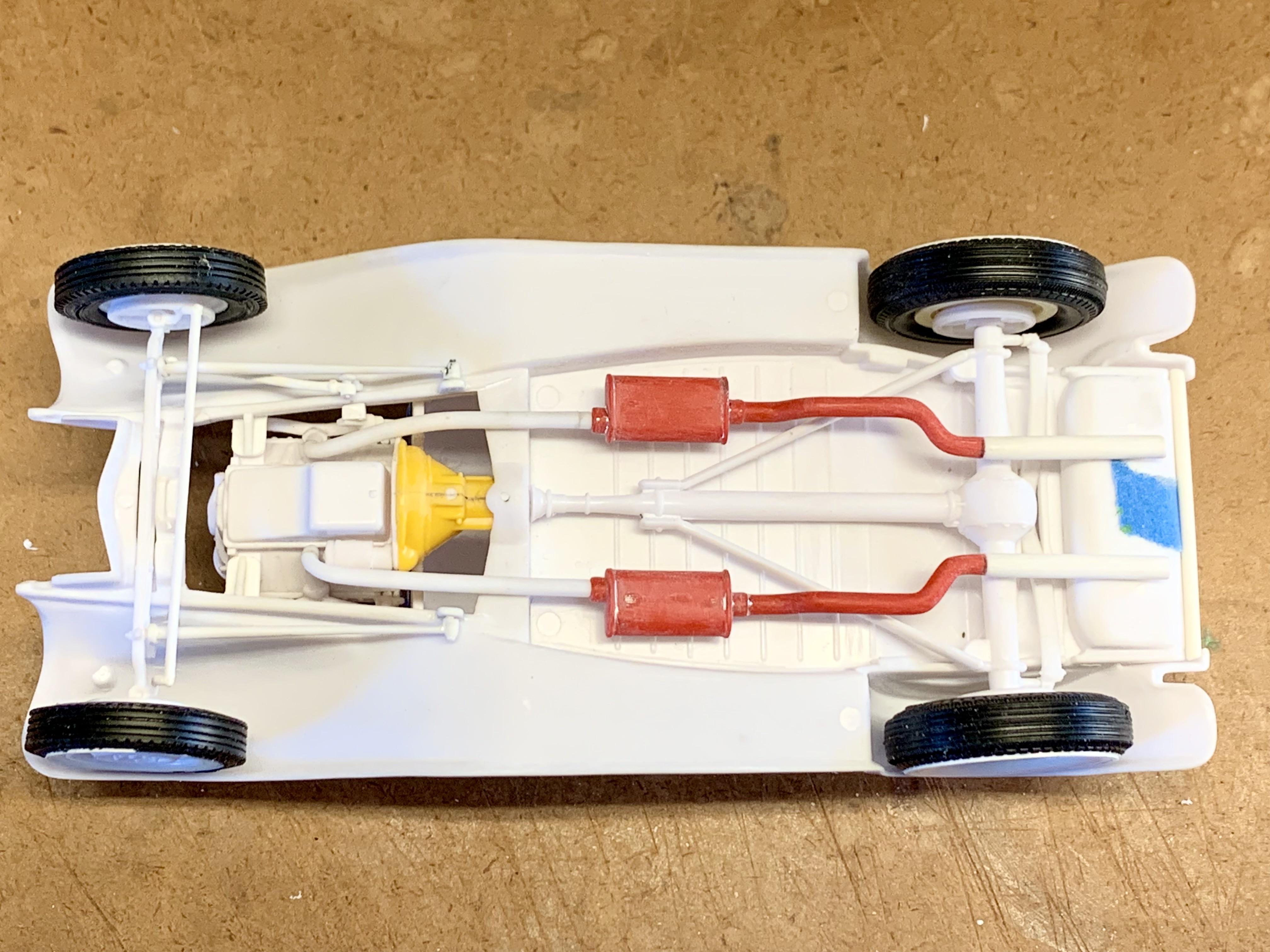

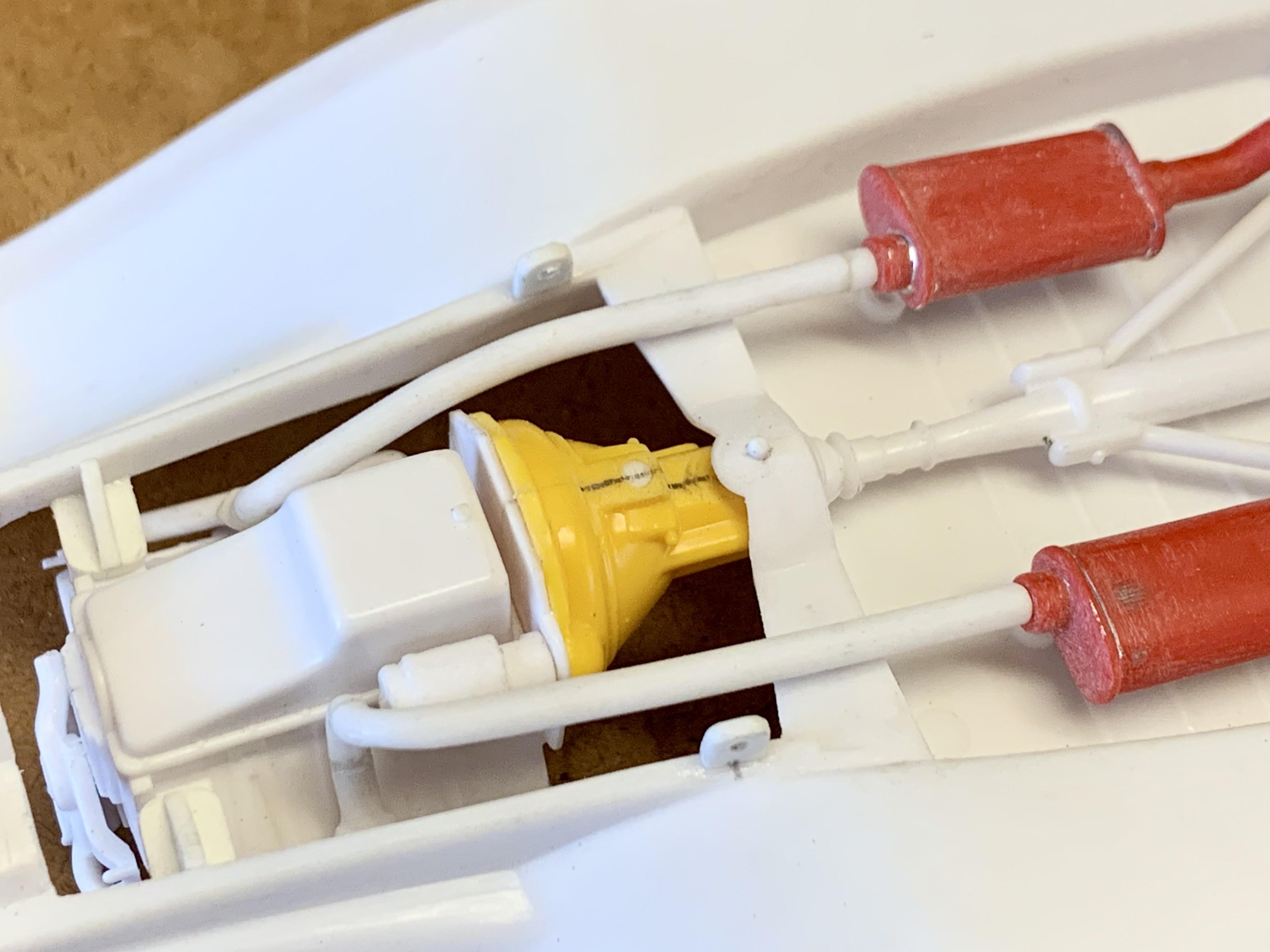

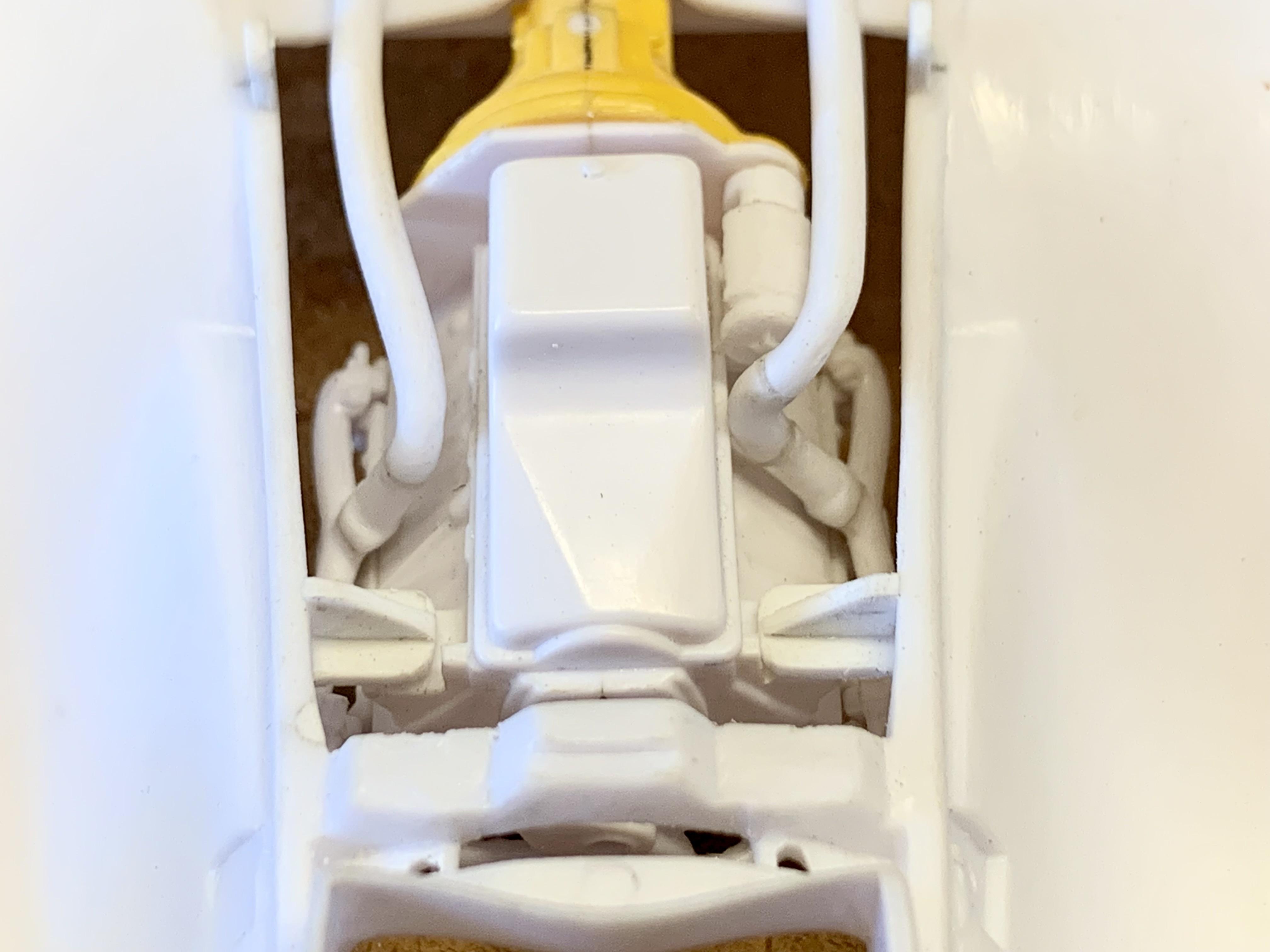

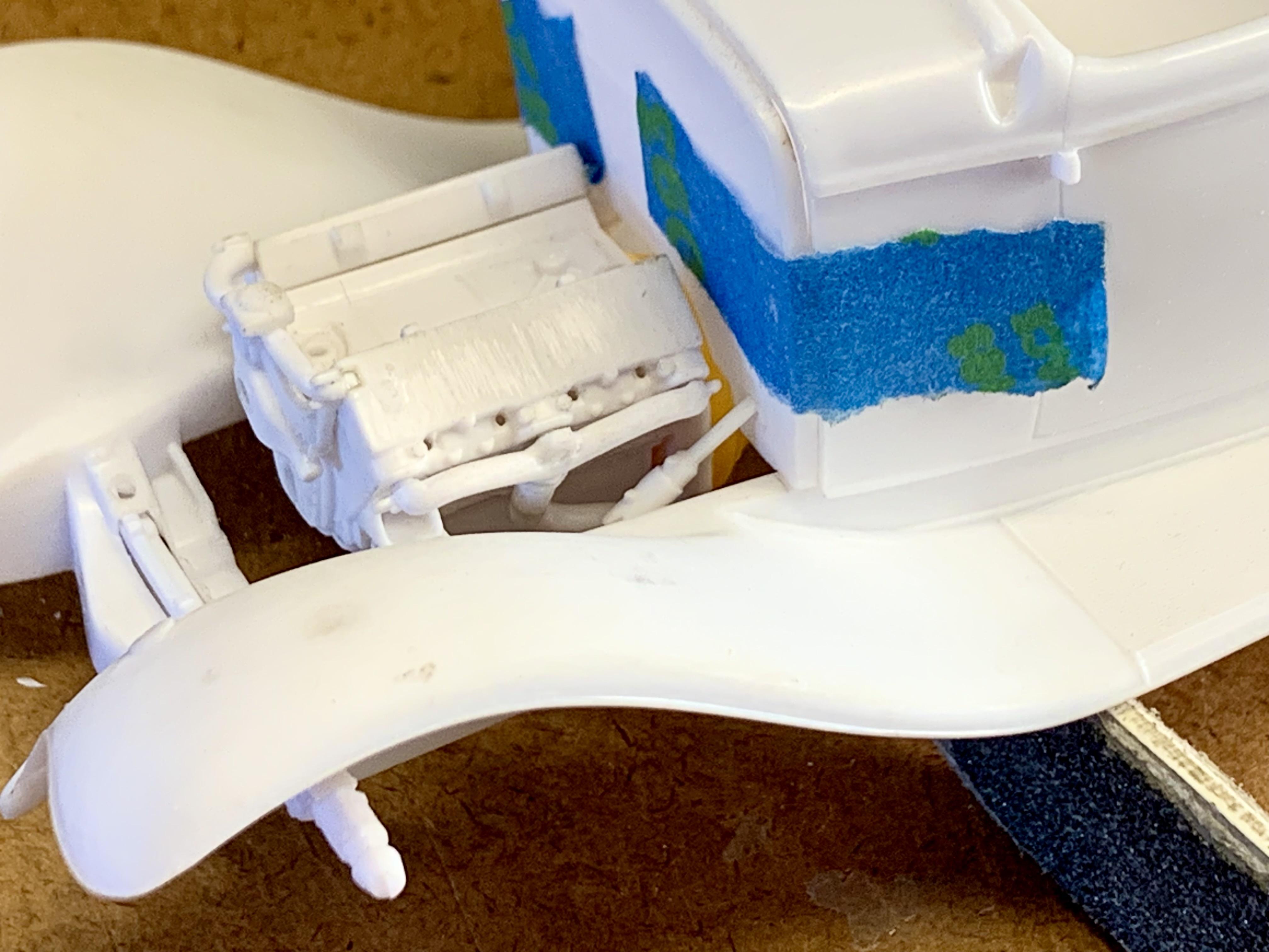

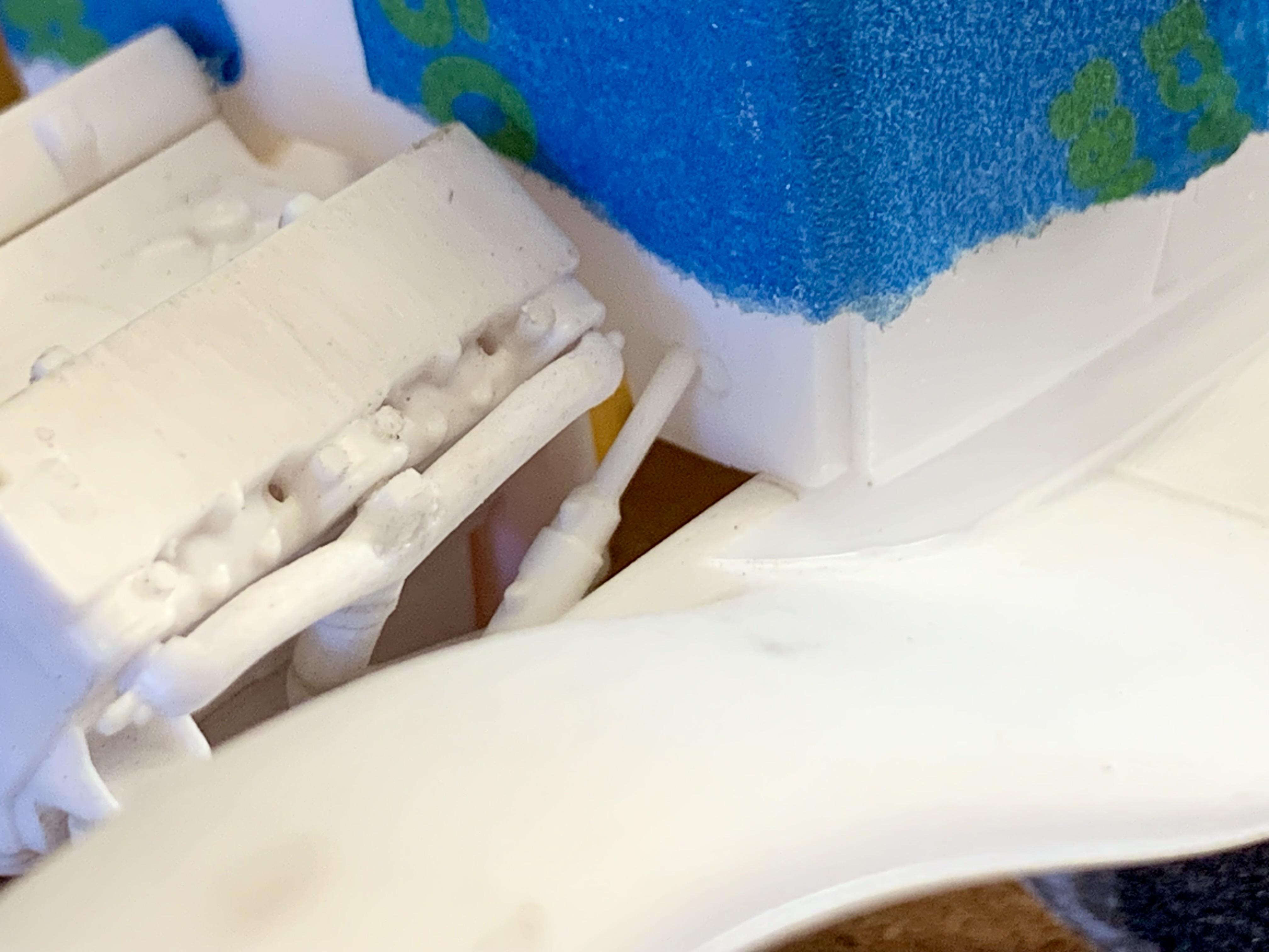

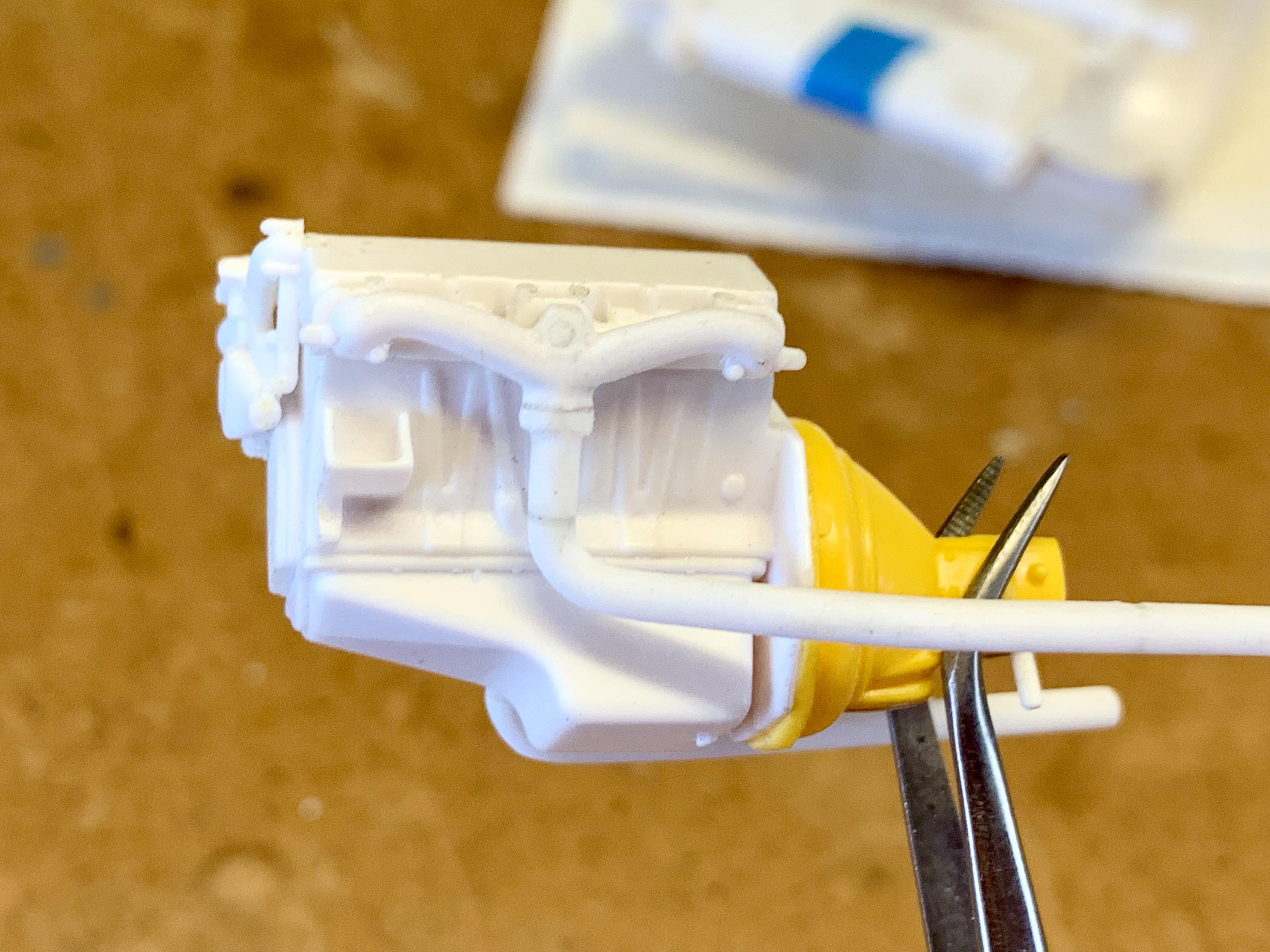

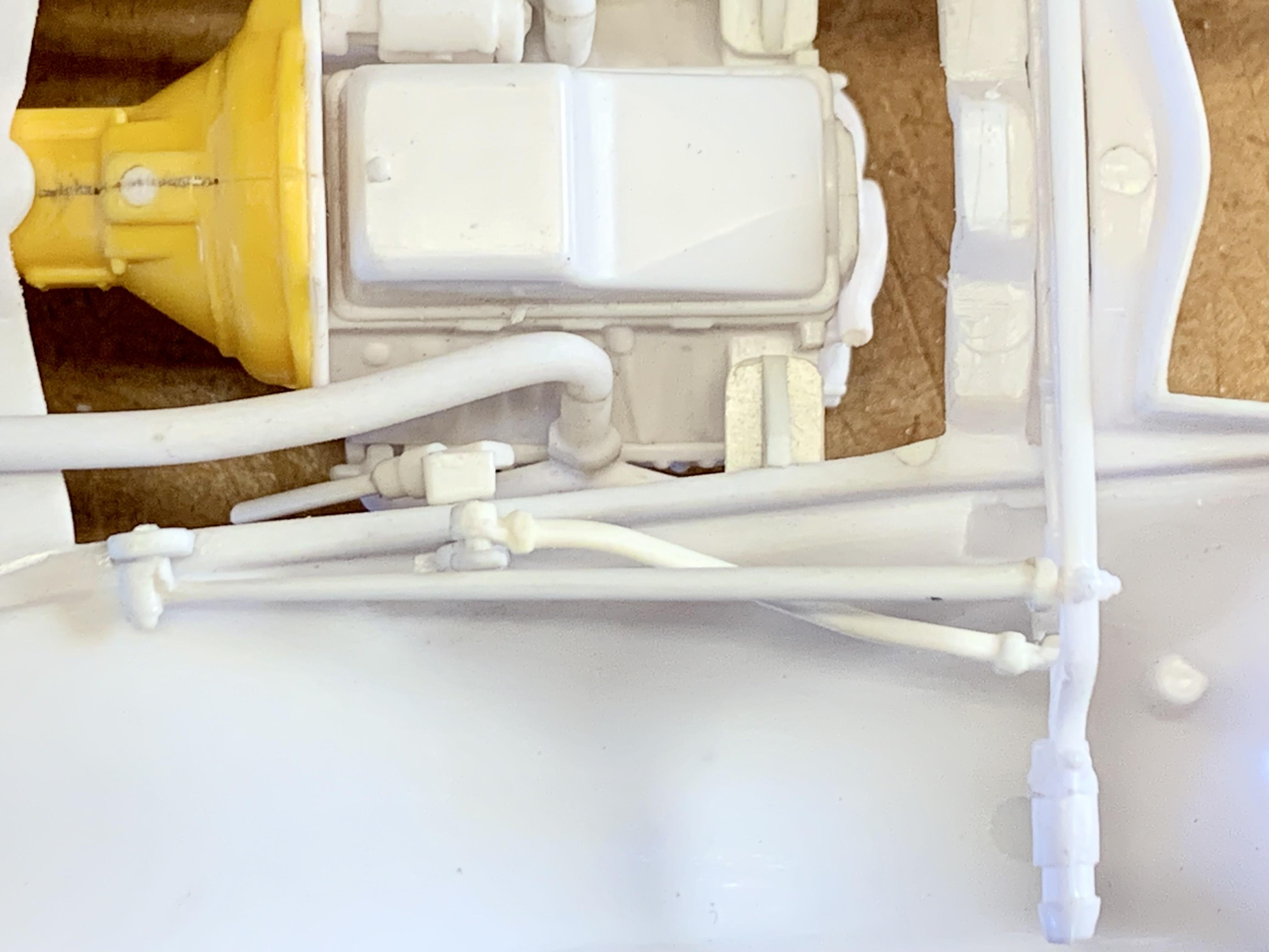

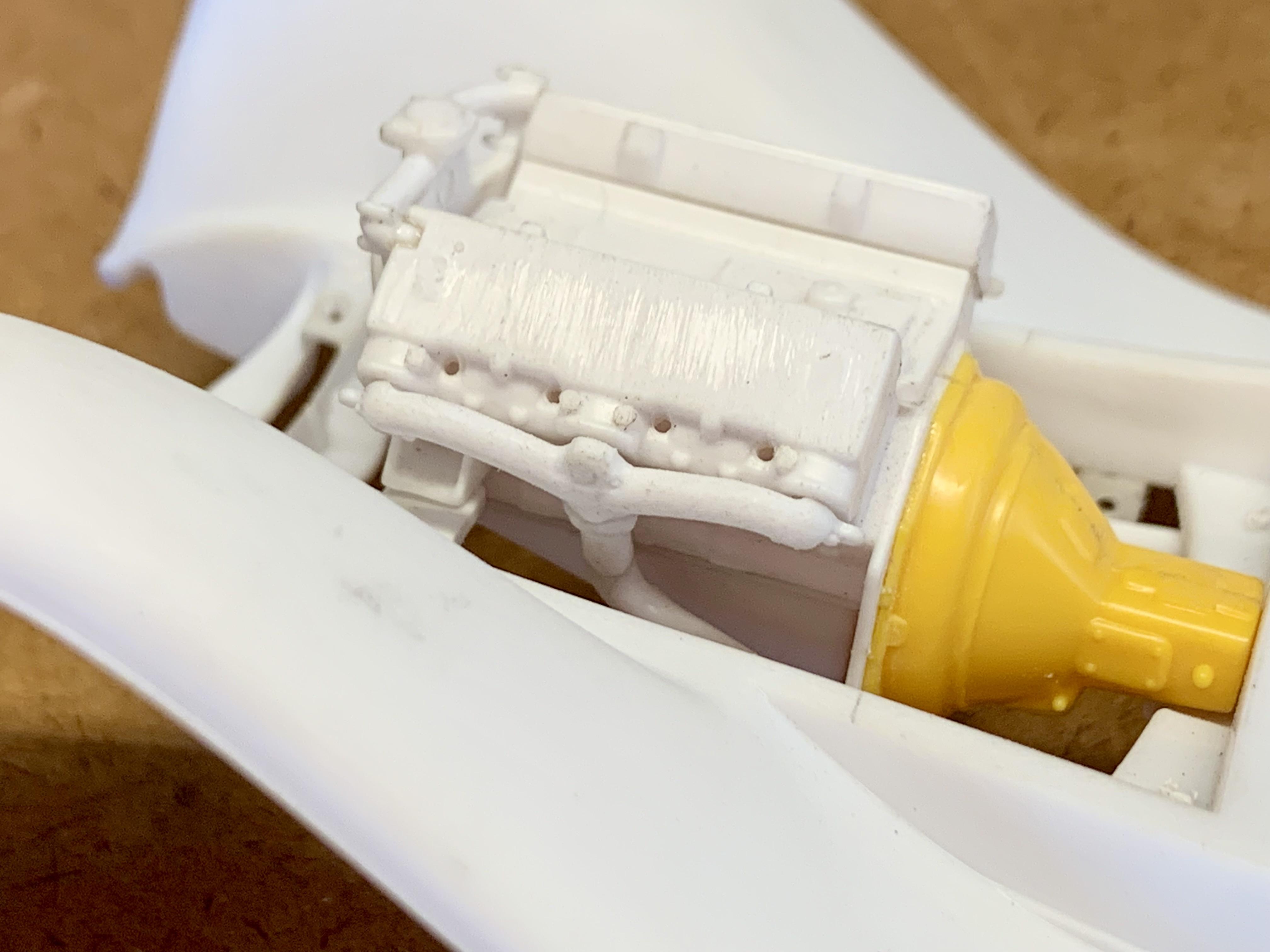

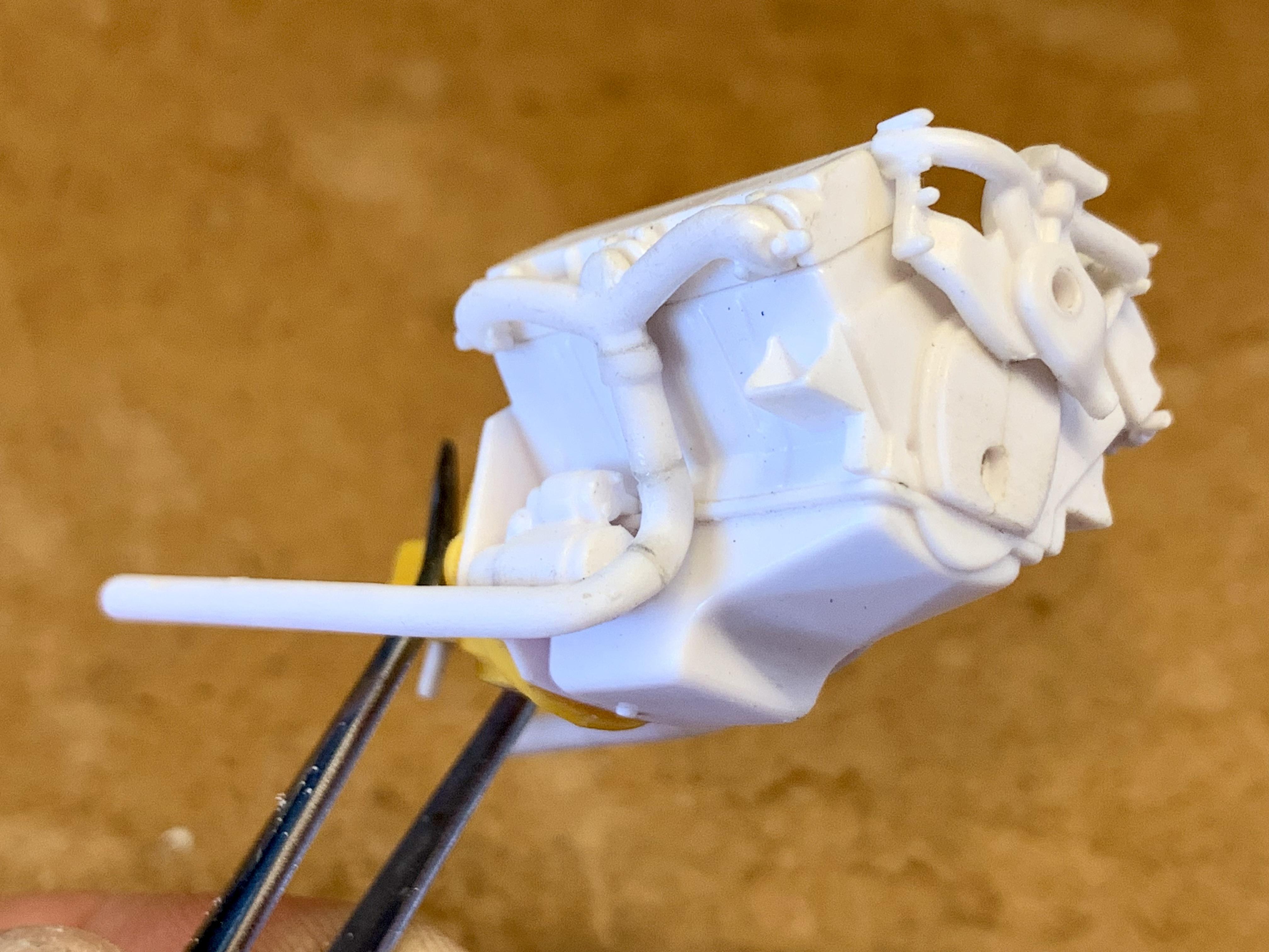

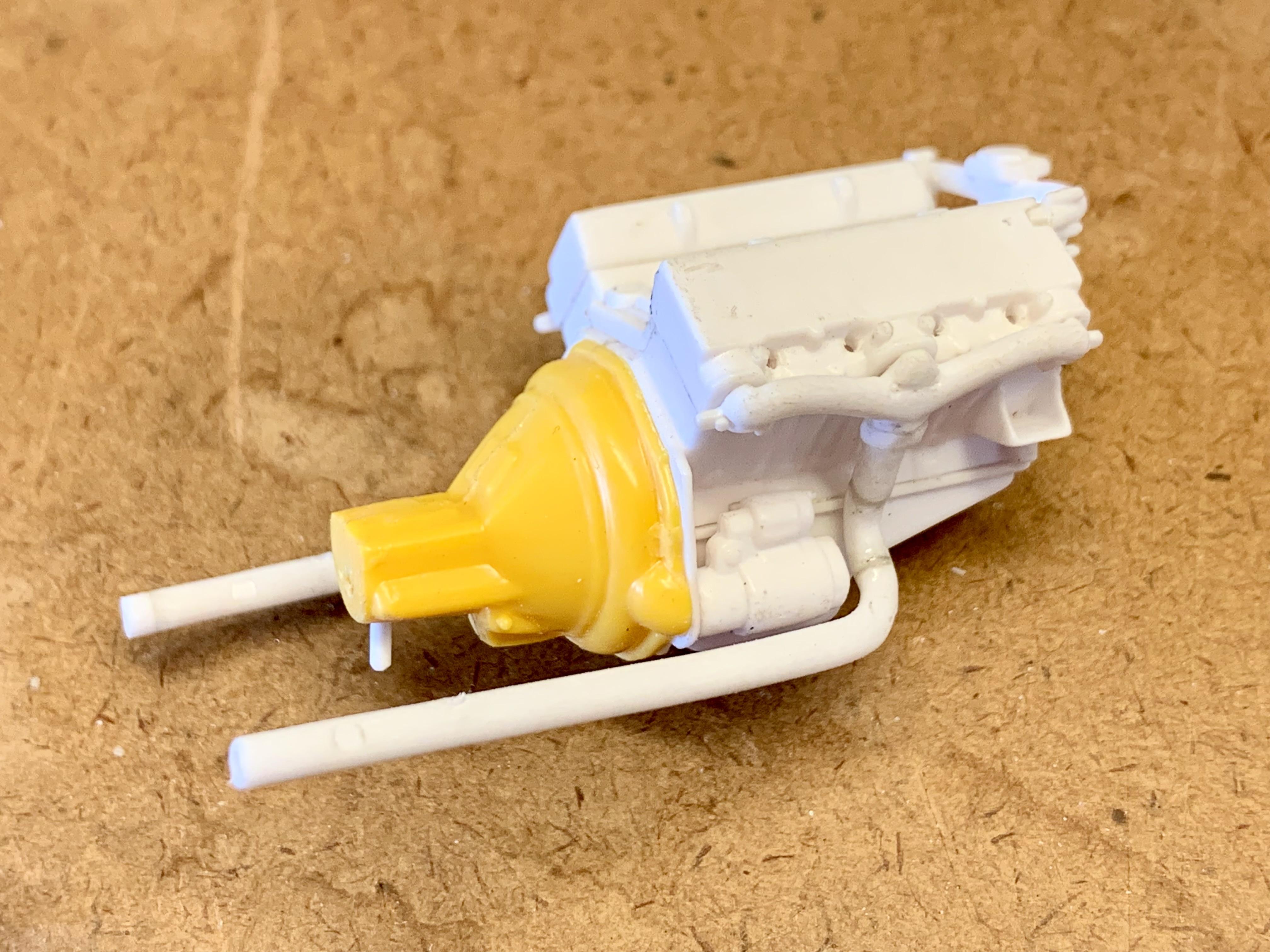

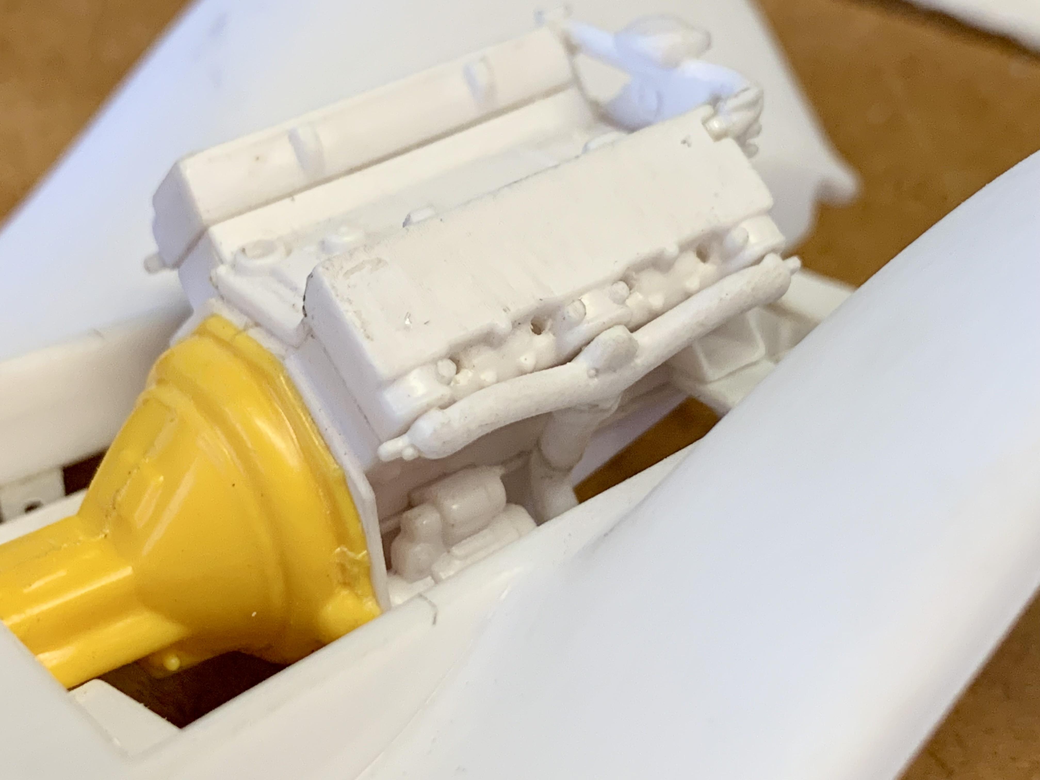

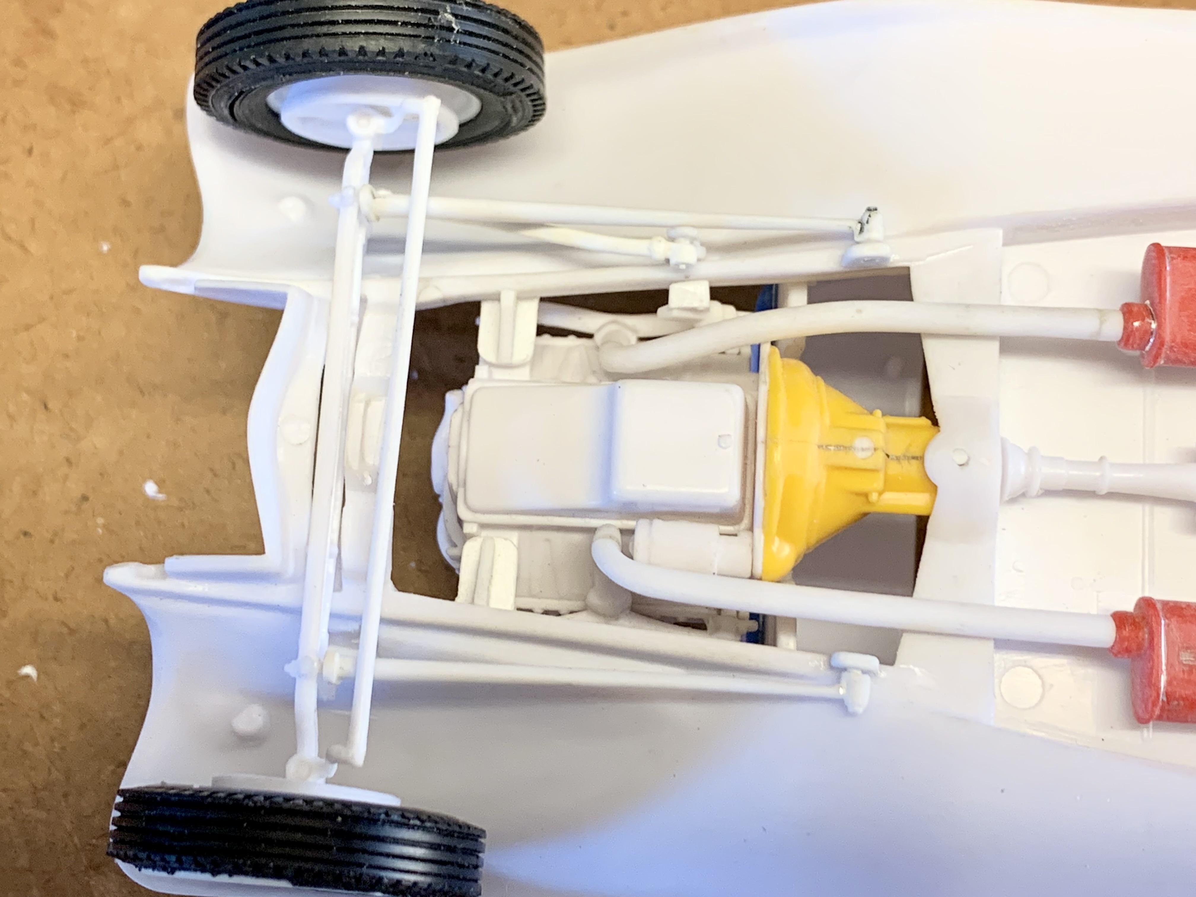

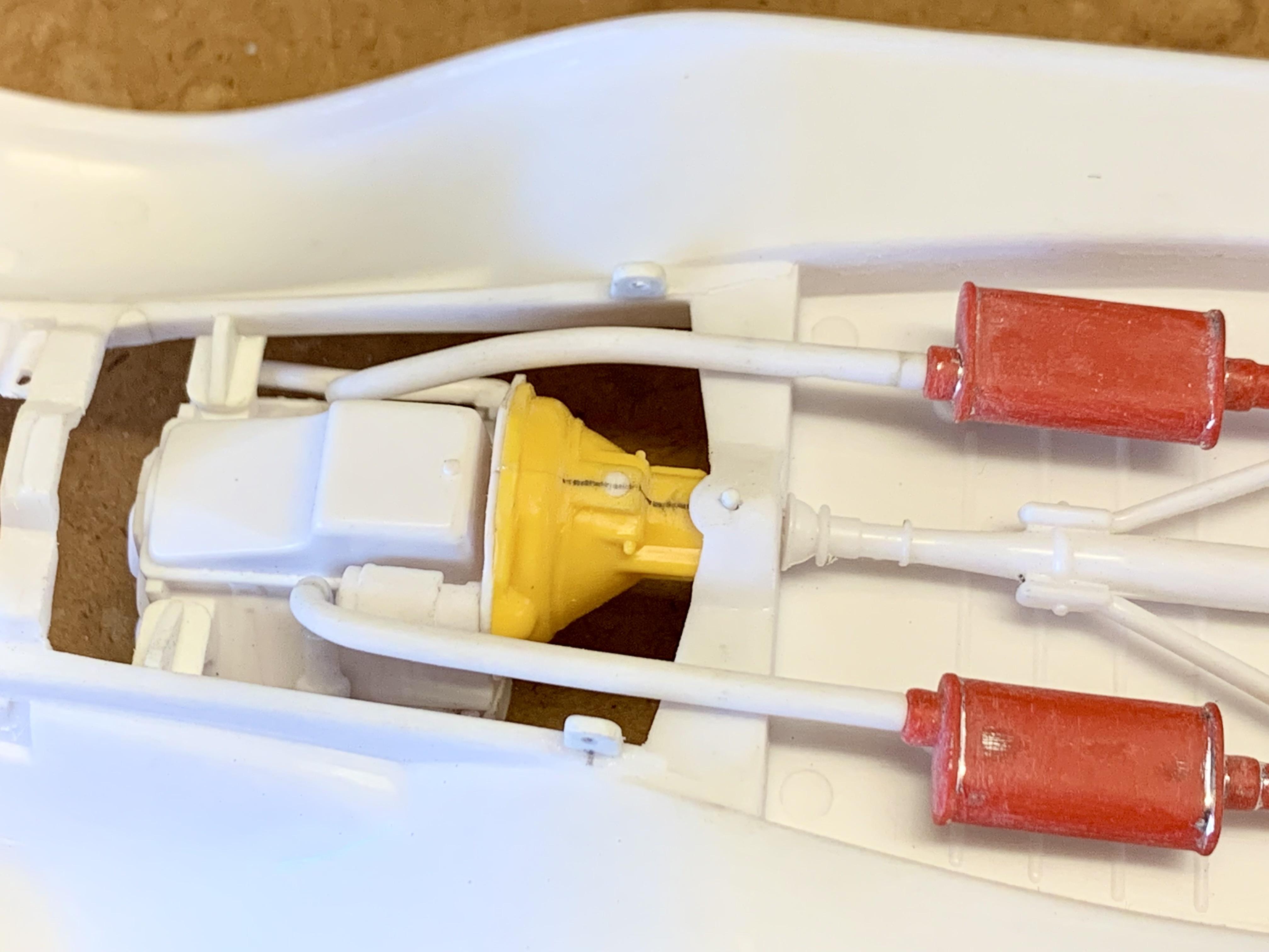

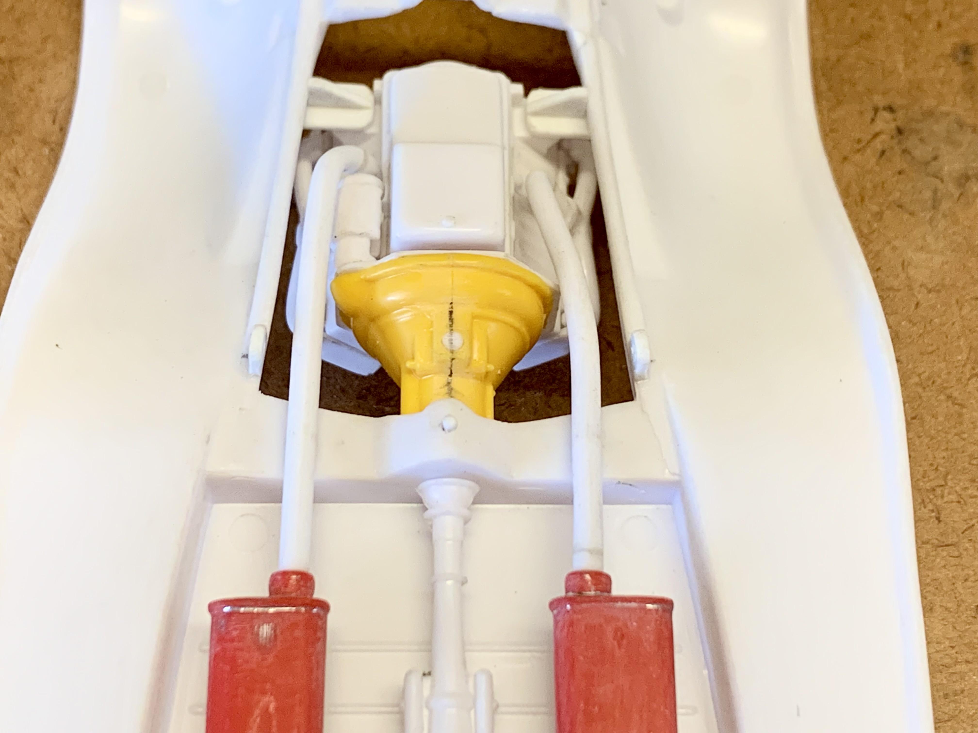

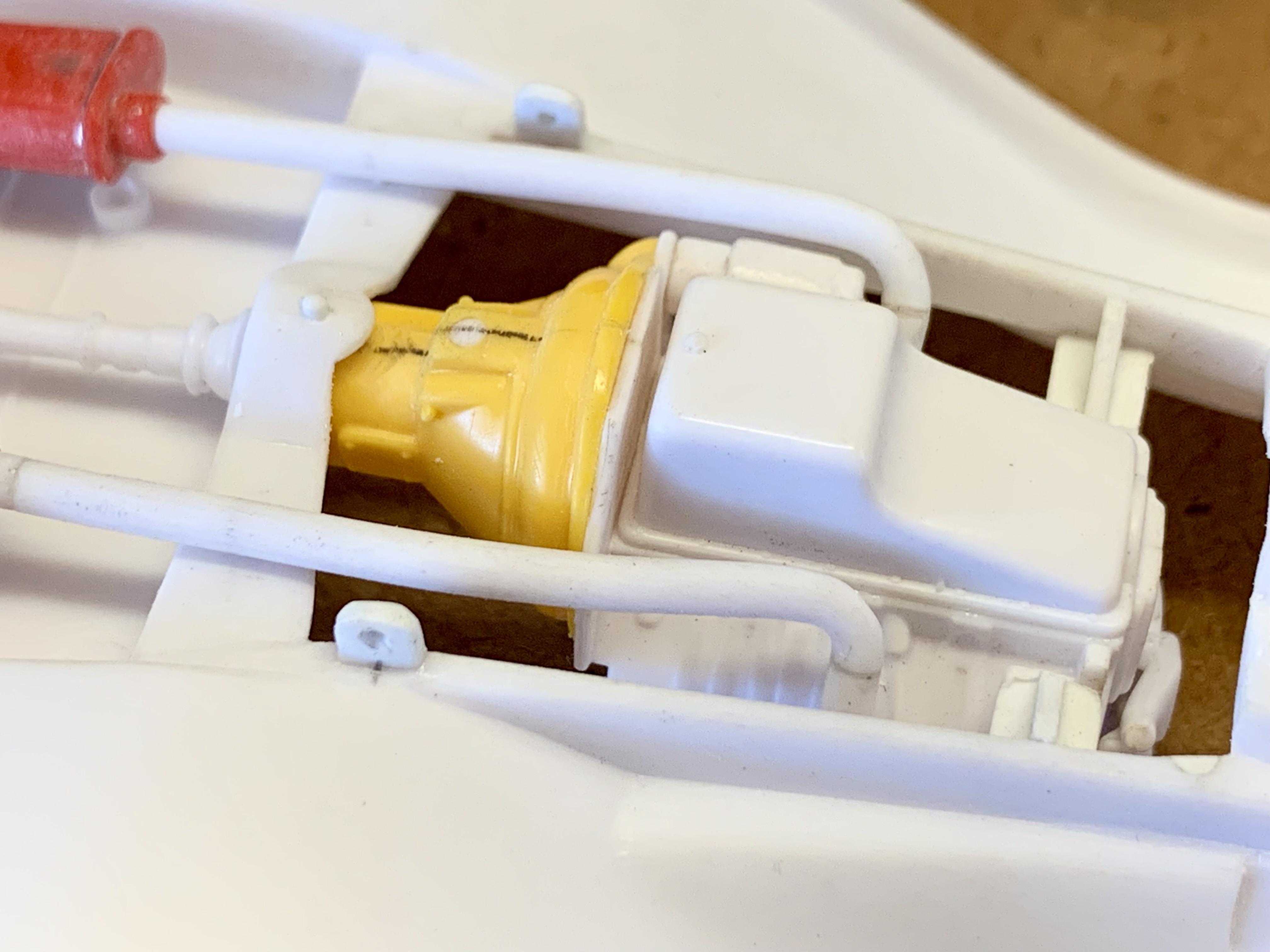

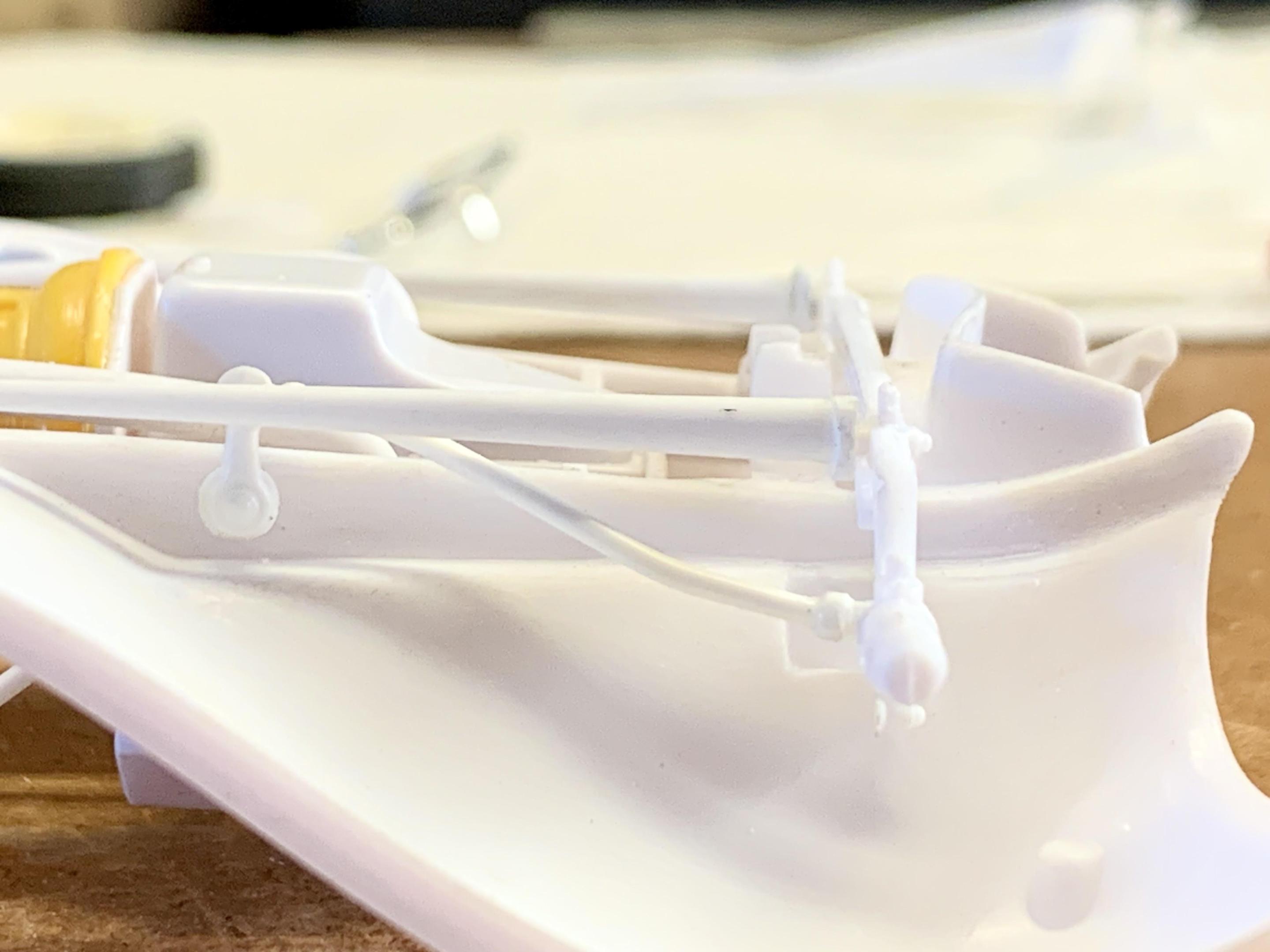

Finally, an update to report! Nothing more I can do with my 32 Sedan while I finish painting the body and exterior parts so I pulled the Monogram Roadster out.

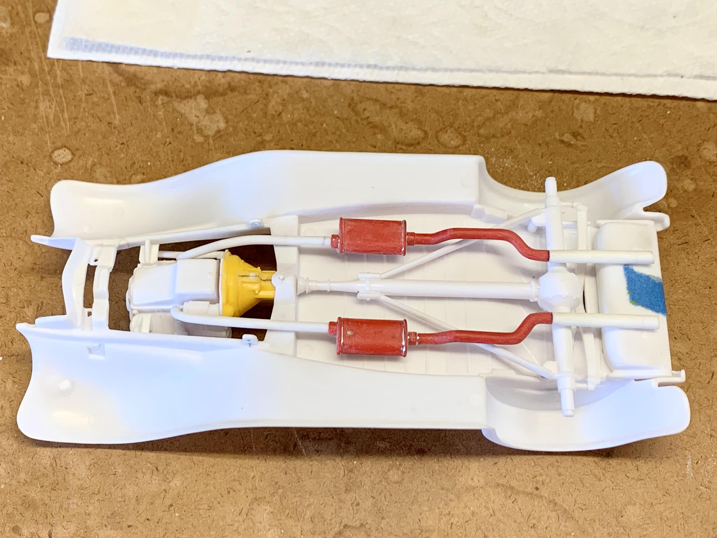

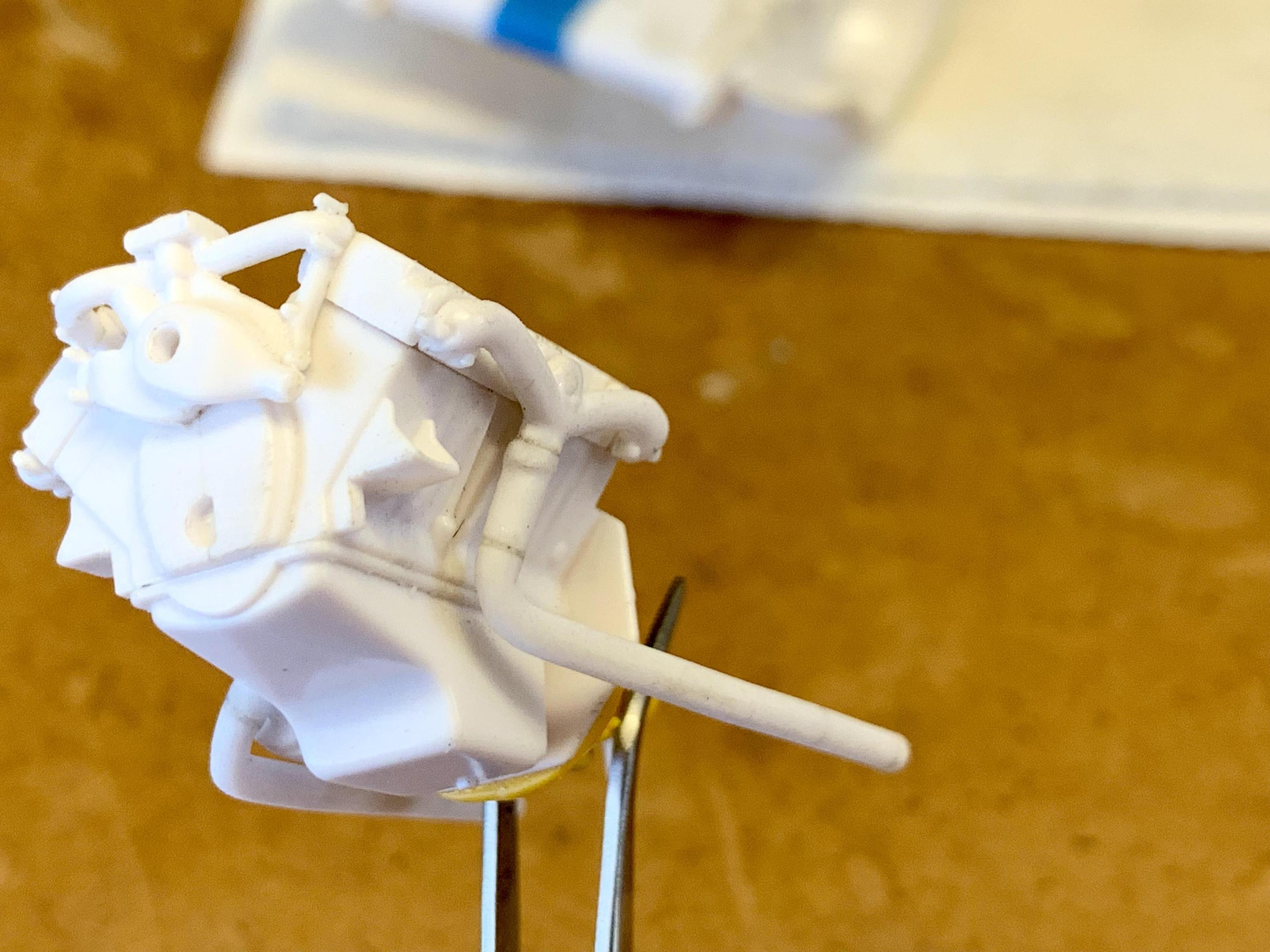

Where I had left off it was in need of new forward exhaust “pipes” made to connect the Cadillac engine to the existing mufflers and tailpipes. I grabbed a pair of passenger side exhaust manifolds from a pair of Revell 49 Mercury’s (same source as the engine), made them so they pin to the engine and then pieced together sections of pipe made from the previous forward pipes from the cast-off Chevy. Their shape was manipulated with careful bending to sweep back to the mufflers and I put some discrete pins in the tops of the pipes that go into the bottom of the transmission cross member to hold them tucked up and in proper alignment. Initially, I was considering changing the mufflers to glass packs but decided not to further complicate the matter.

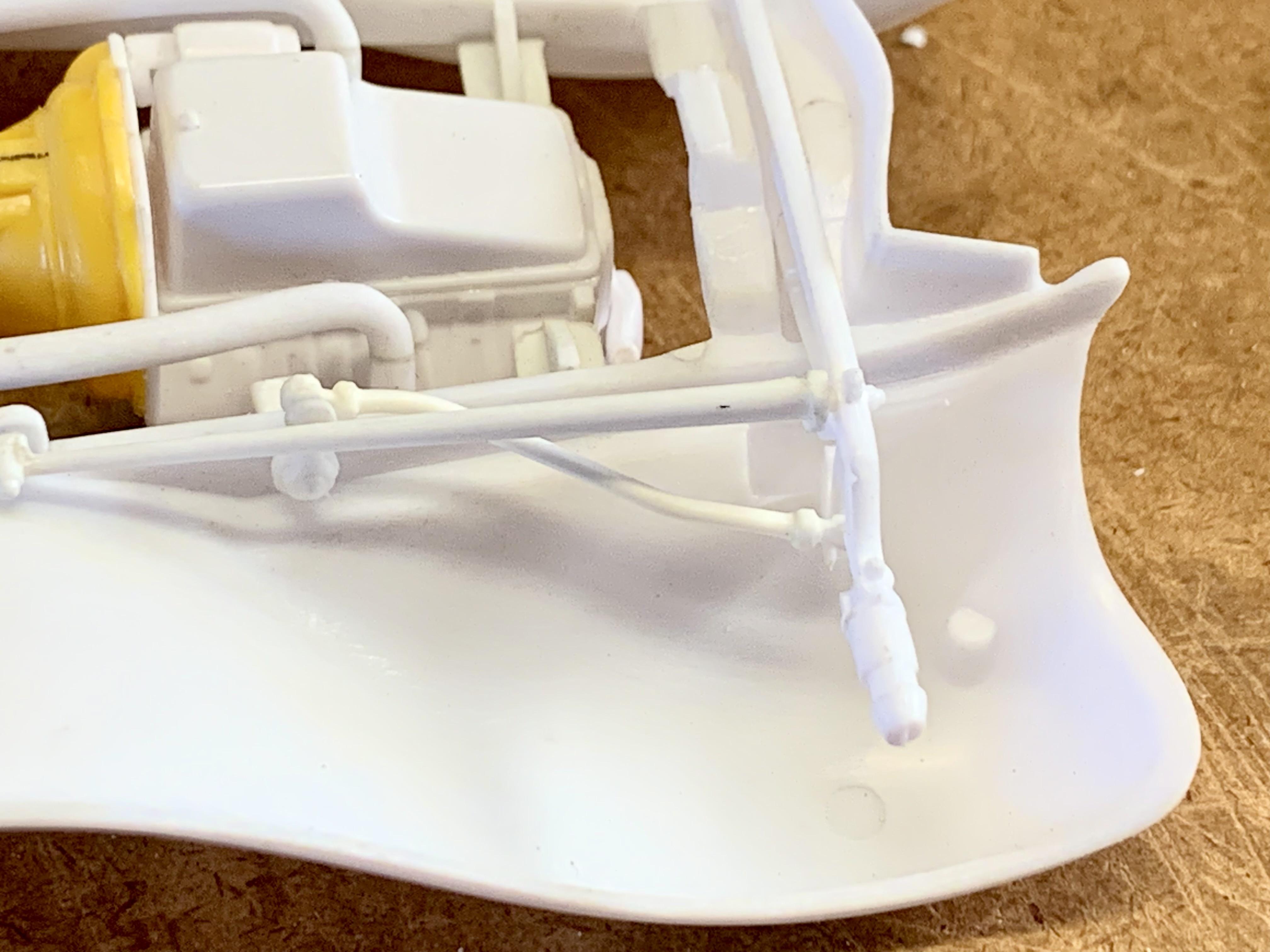

With the exhaust crossed off the list I mocked up the whole chassis to assess what else needed to be done. This kit never had a steering gear box and the instructions have you glue the end of the drag link to the frame which is totally inaccurate. Just as in the full scale world, split wishbones can cause a conflict with side steering but after some trial and error I found a solution. I grabbed the gear box and drag link piece from the modern Revell Model A hot rod kits. The link rod was cut off leaving just the pitman arm. An .040” hole was drilled through the side of the frame, an .040” rod inserted into the arm to pass through the frame and an .040” hole drilled into the box to mount on the other end of the rod, sandwiching the frame. From there I trimmed away the steering arms from a tie rod from the Revell 32 kit series, shortened the rod and carefully shaped it to jog around the wishbone and pinned it to the inside of the pitman arm. On the top side a hole was drilled at an angle through the firewall (second times the charm!) for the steering box shaft to disappear into. With that the car has a functional looking steering.
  • Like 10
Nice seeing this one back on the bench Dennis.
Excellent work with the custom exhaust! Just like the muffler shops of old used to do back when they would still bend pipe.
The steering link looks great too. That's one problem with roadsters and T-Buckets, you can see everything!

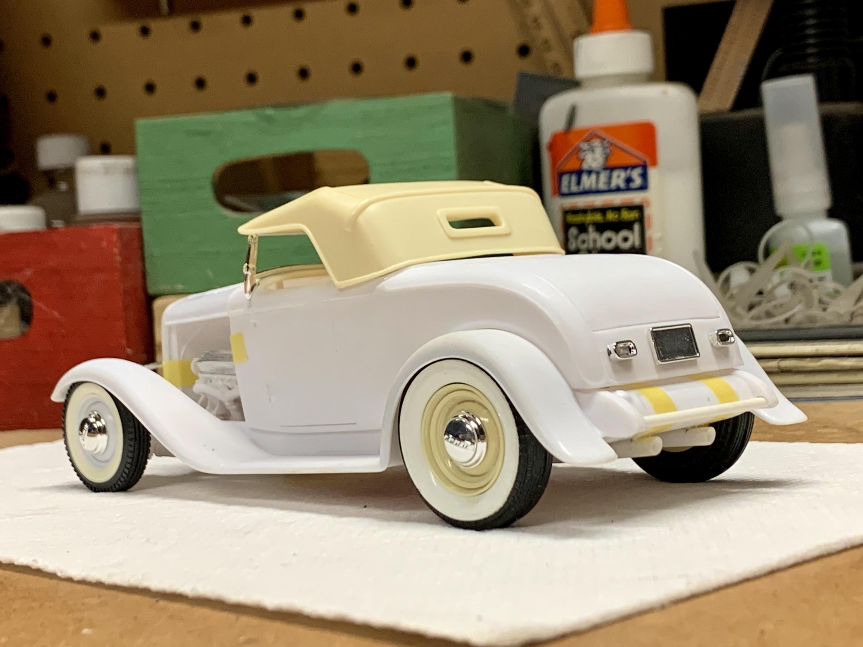

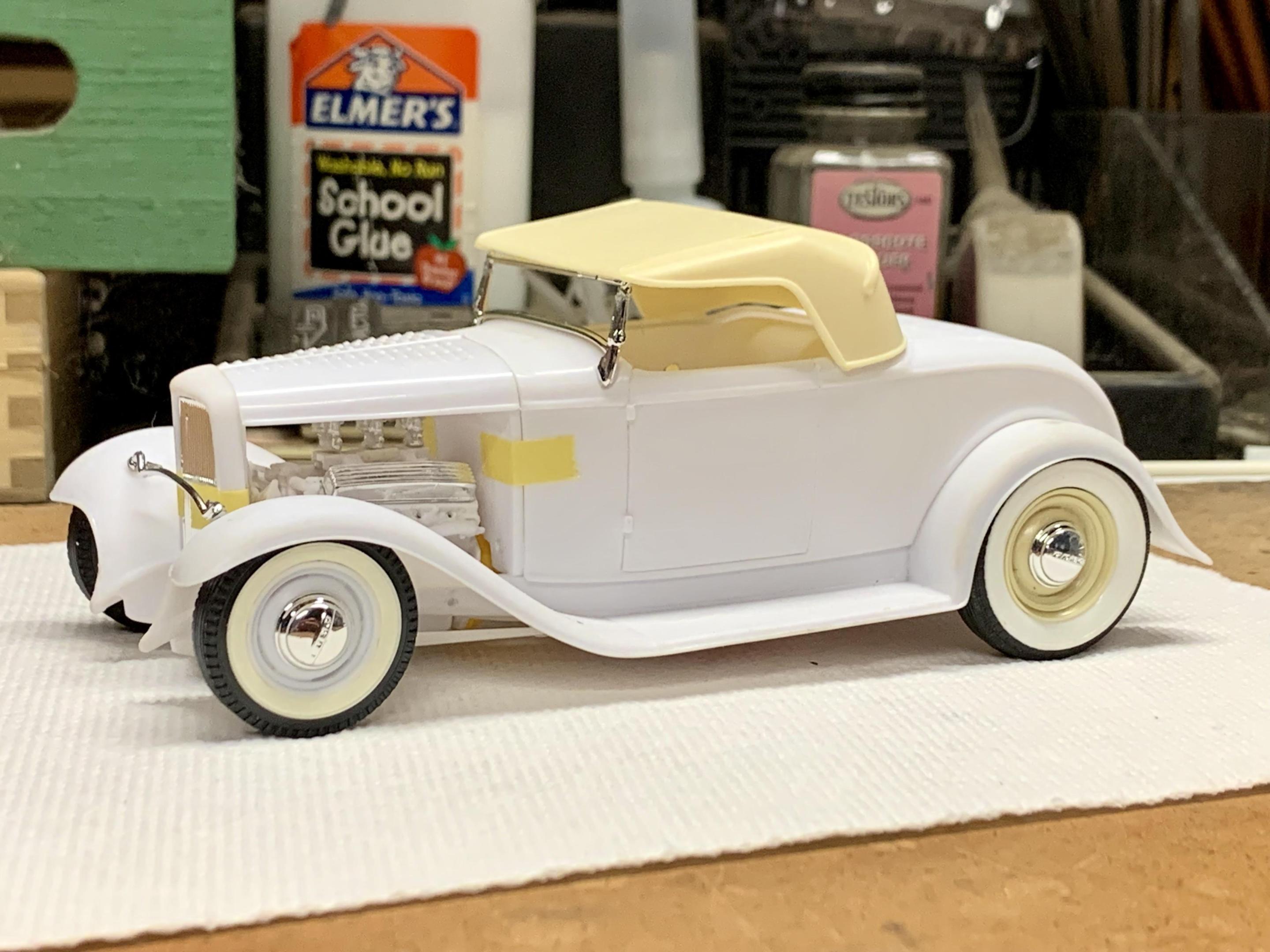

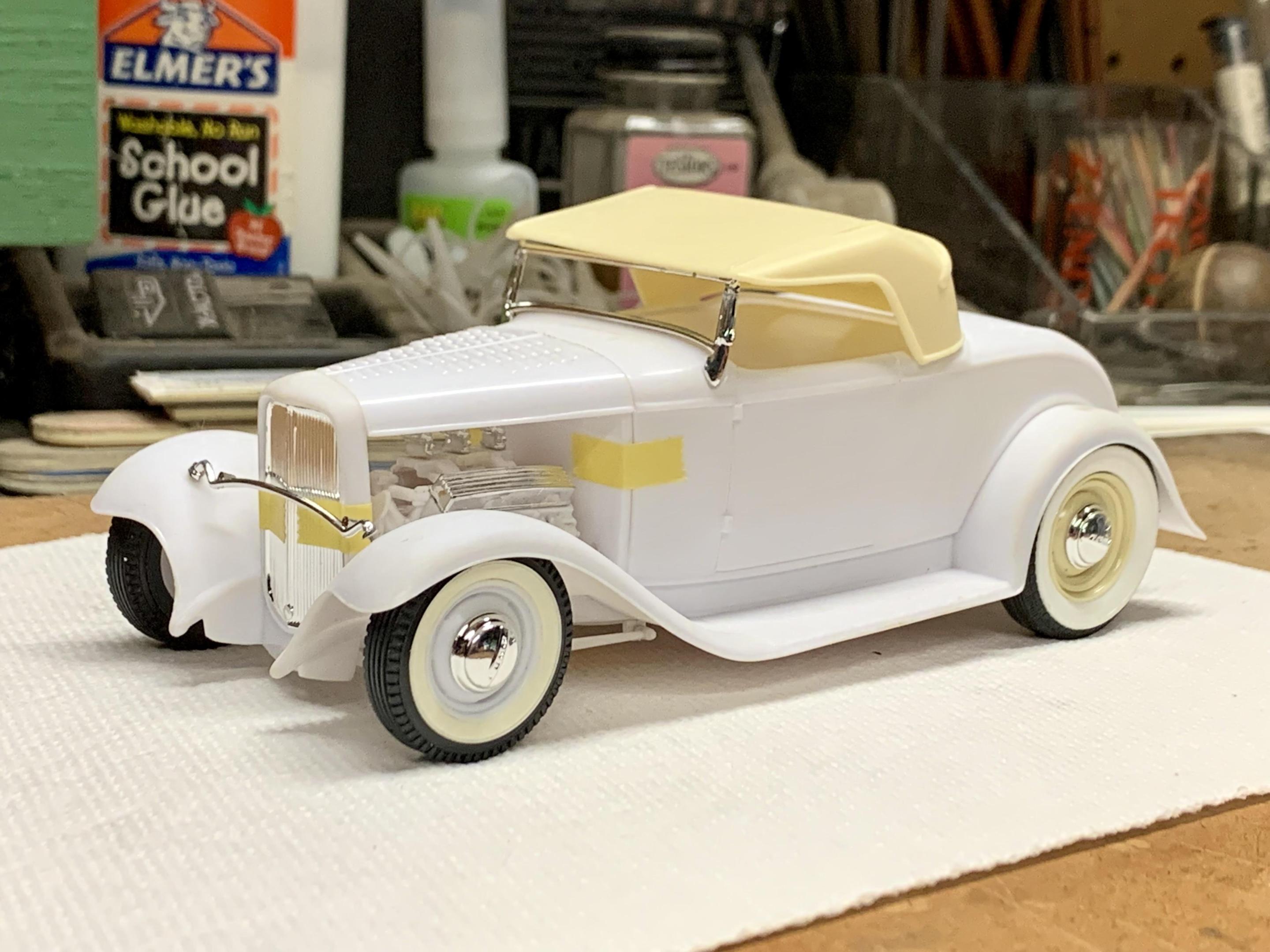

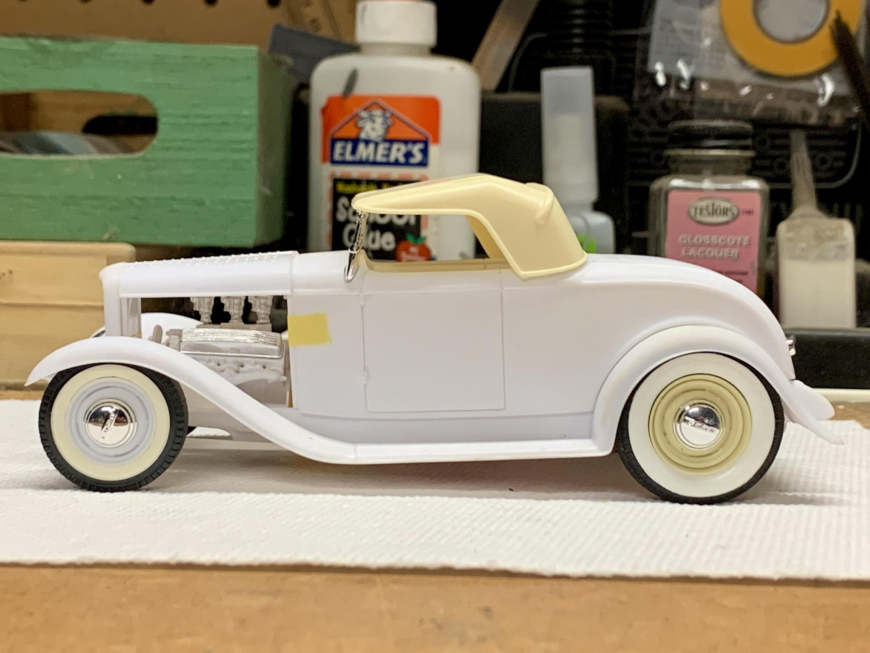

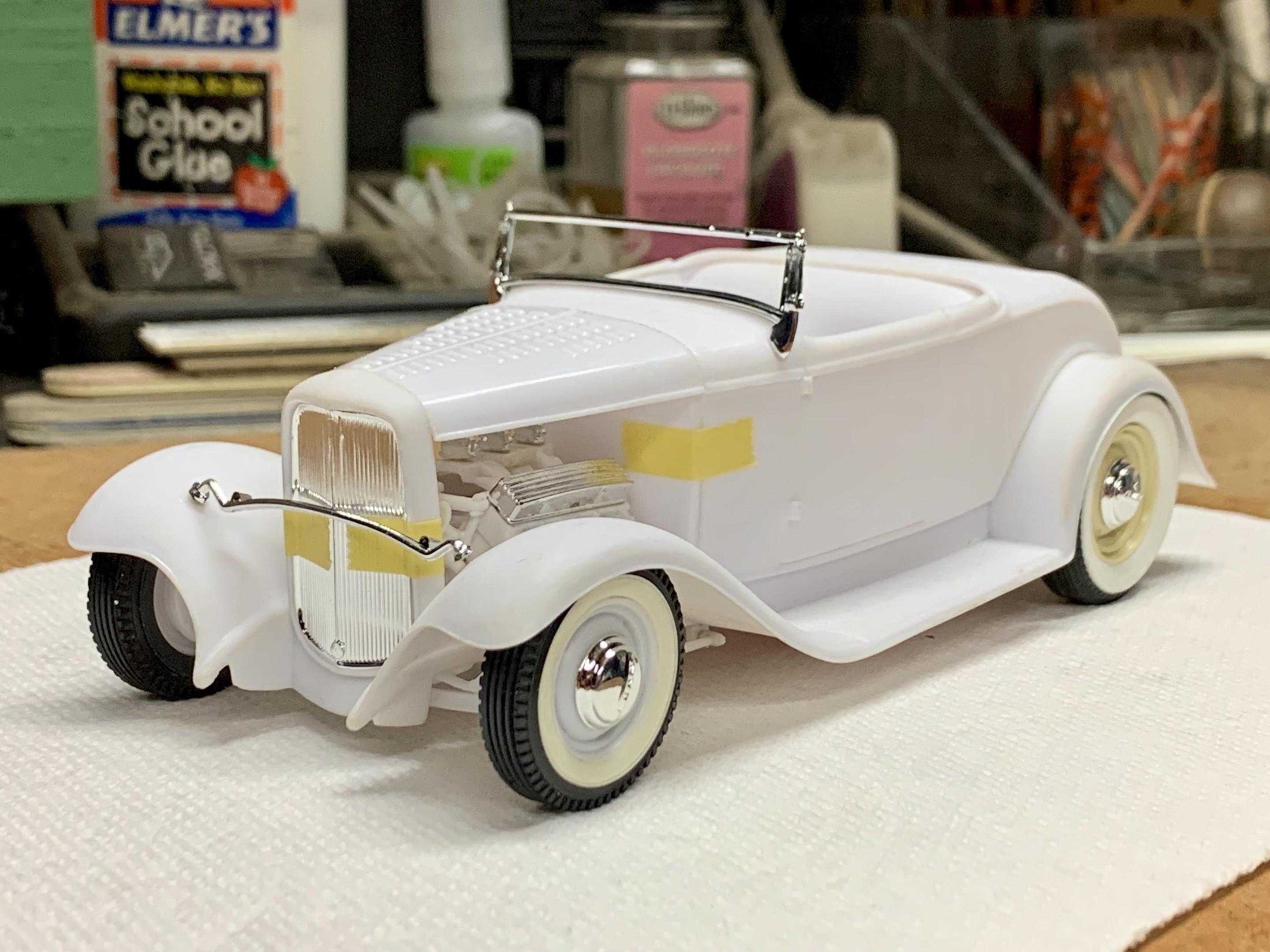

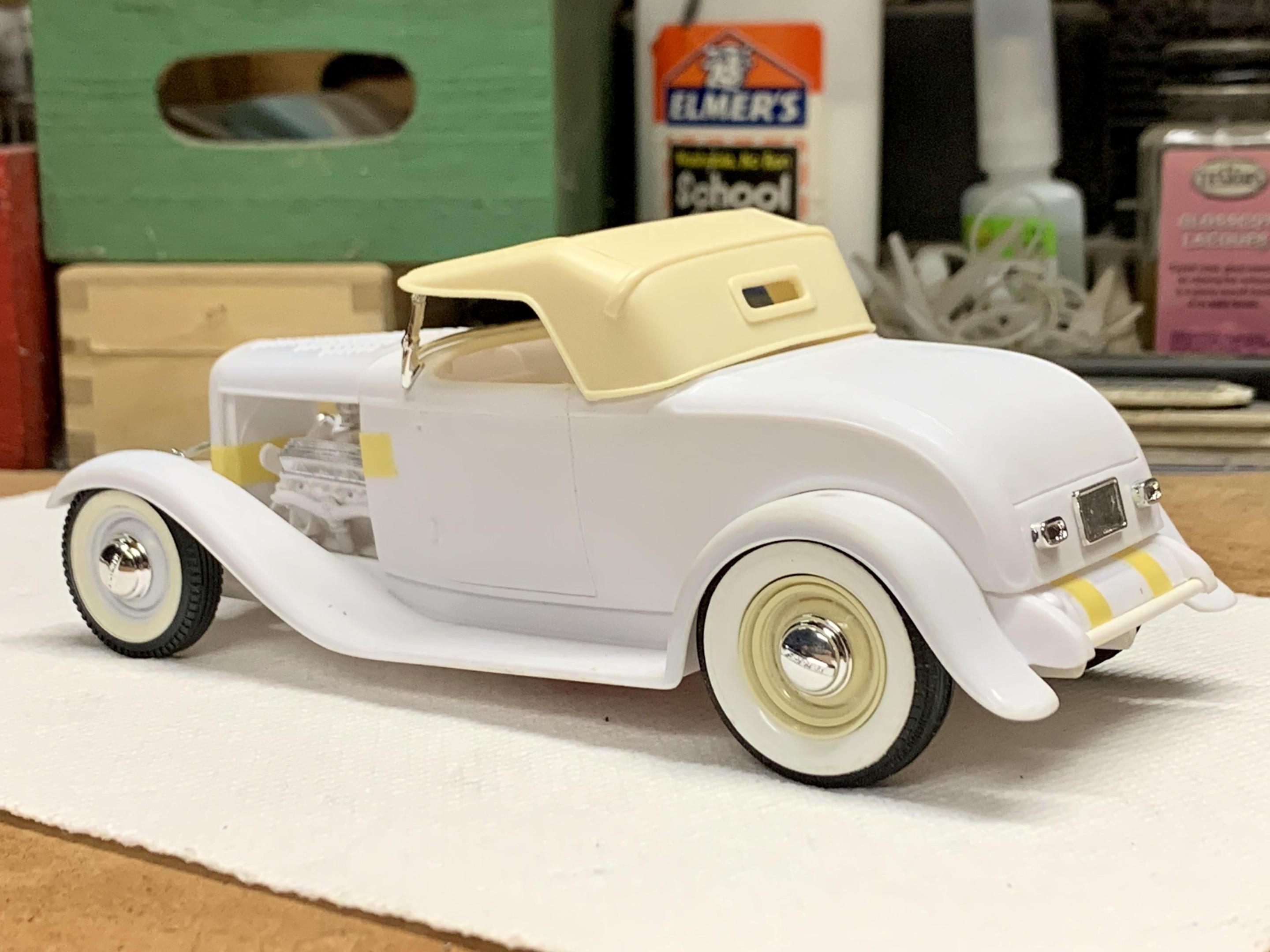

Another good day at the bench has this project just about ready for paint. Just a few things left to address.

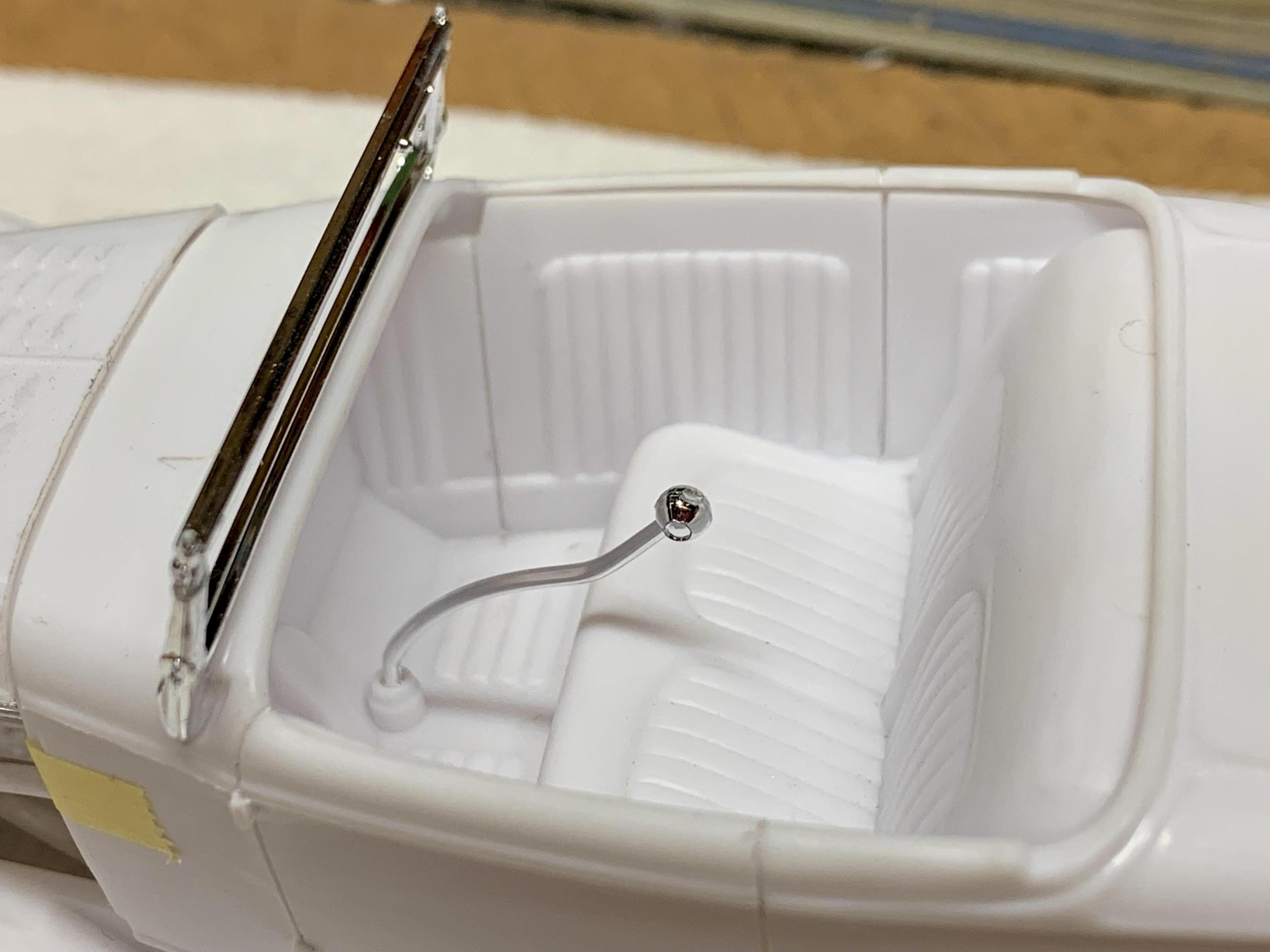

One problem most interior “tubs” share is the lack of door panel lines so I scribed them. A detail that goes a long way.

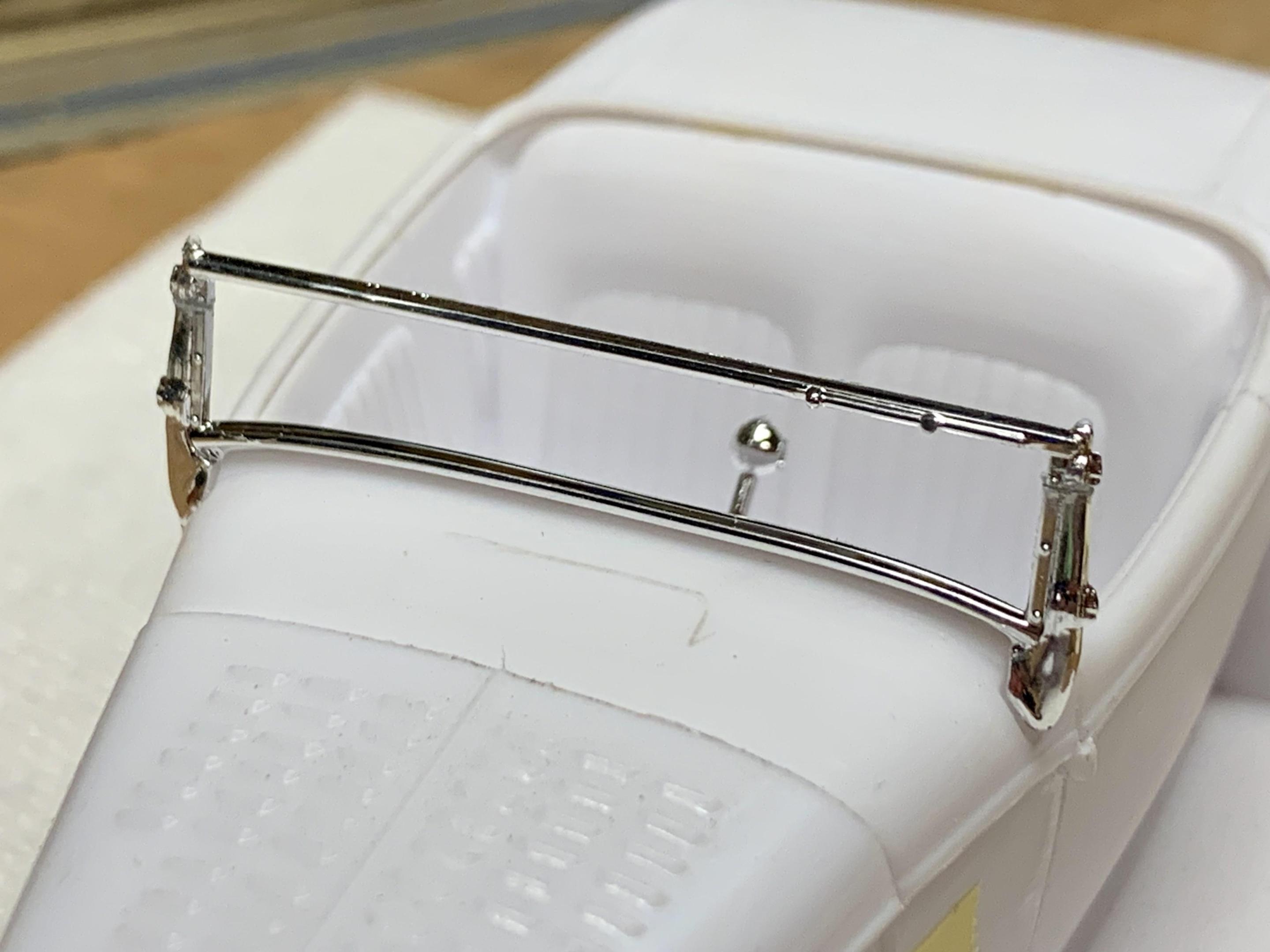

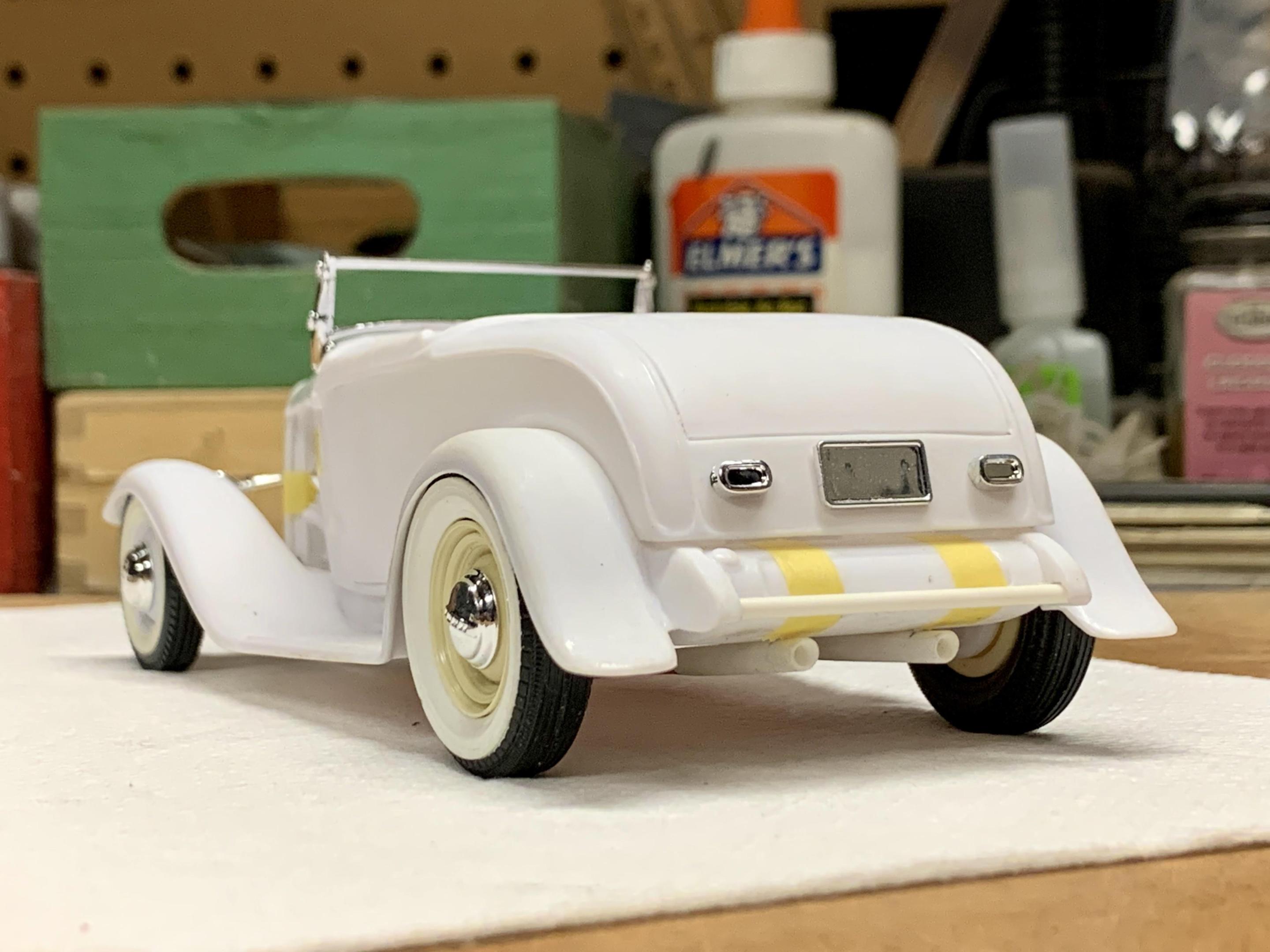

I just couldn’t get happy with the fit of the Revell 1:25 windshield and decided to revert back to the kit piece and chopped it 1/8” (4 scale inches) to match the Revell version. This meant starting with a fresh body as I had trimmed on the first one to try and fit the windshield. After block sanding the wavy cowl top the cowl vent lines half disappeared so I filled the rest with super glue for a vent delete.
The fresh body got its door handles shaved and the same license plate bracket and taillights added. From there the body was block sanded and the door and trunk panel lines scribed as they are very shallow out of the mold and may have gotten lost under paint.
I also couldn’t warm up to the headlights and dropped bar from Revell’s most recent ‘30 Woody. I didn’t like the hard V peak in the center of the bar and I’m generally not a fan of BIG stock headlights on hot rods. I filled the kit mounting holes and fit the dropped bar from a Revell 32 which looks better and will allow me to use the small headlights from the 32 kits.
That’s the last bare plastic mock up. I’m pretty sure I’ve picked a paint scheme so stay tuned. ?
  • Like 10
