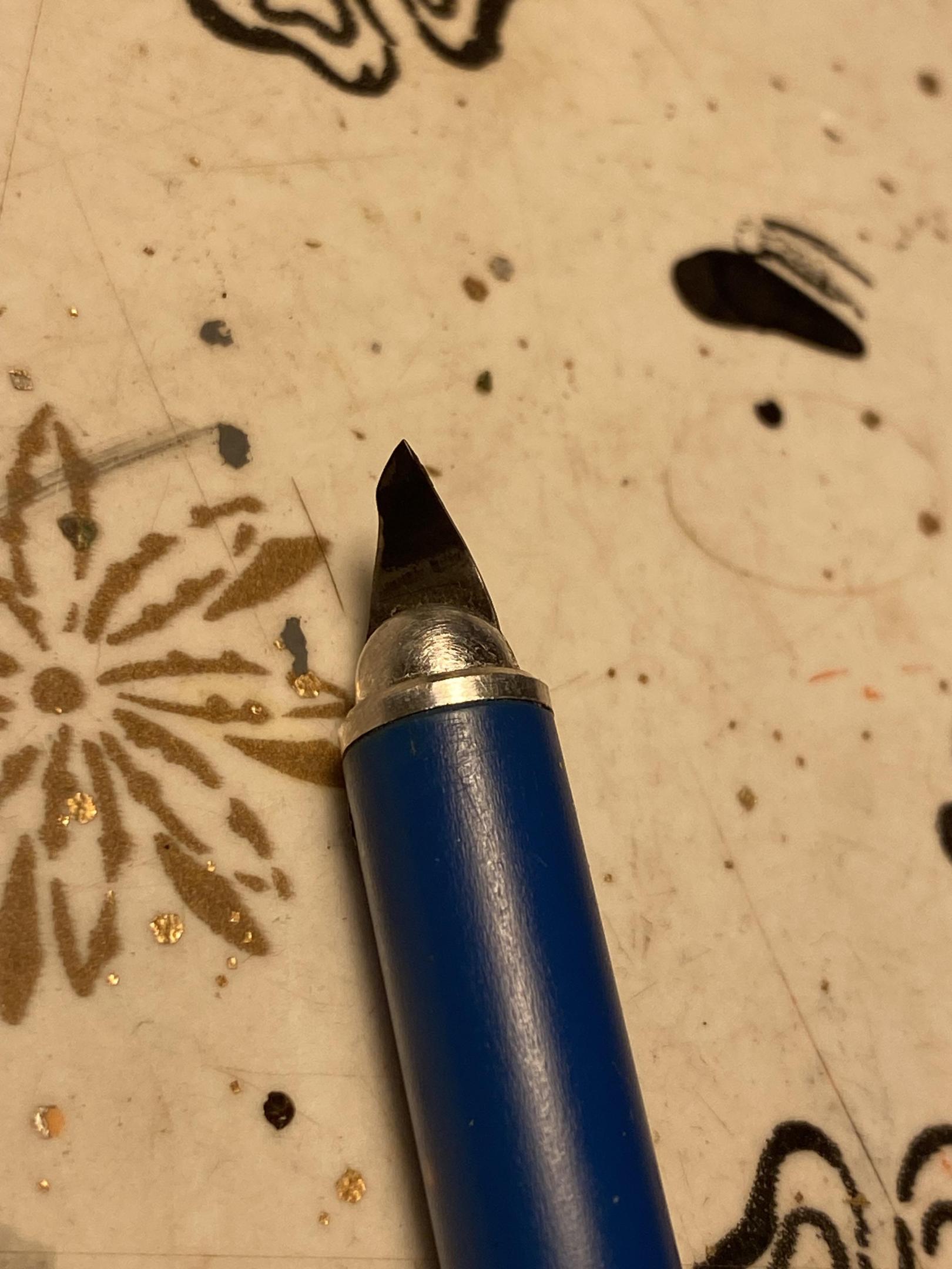

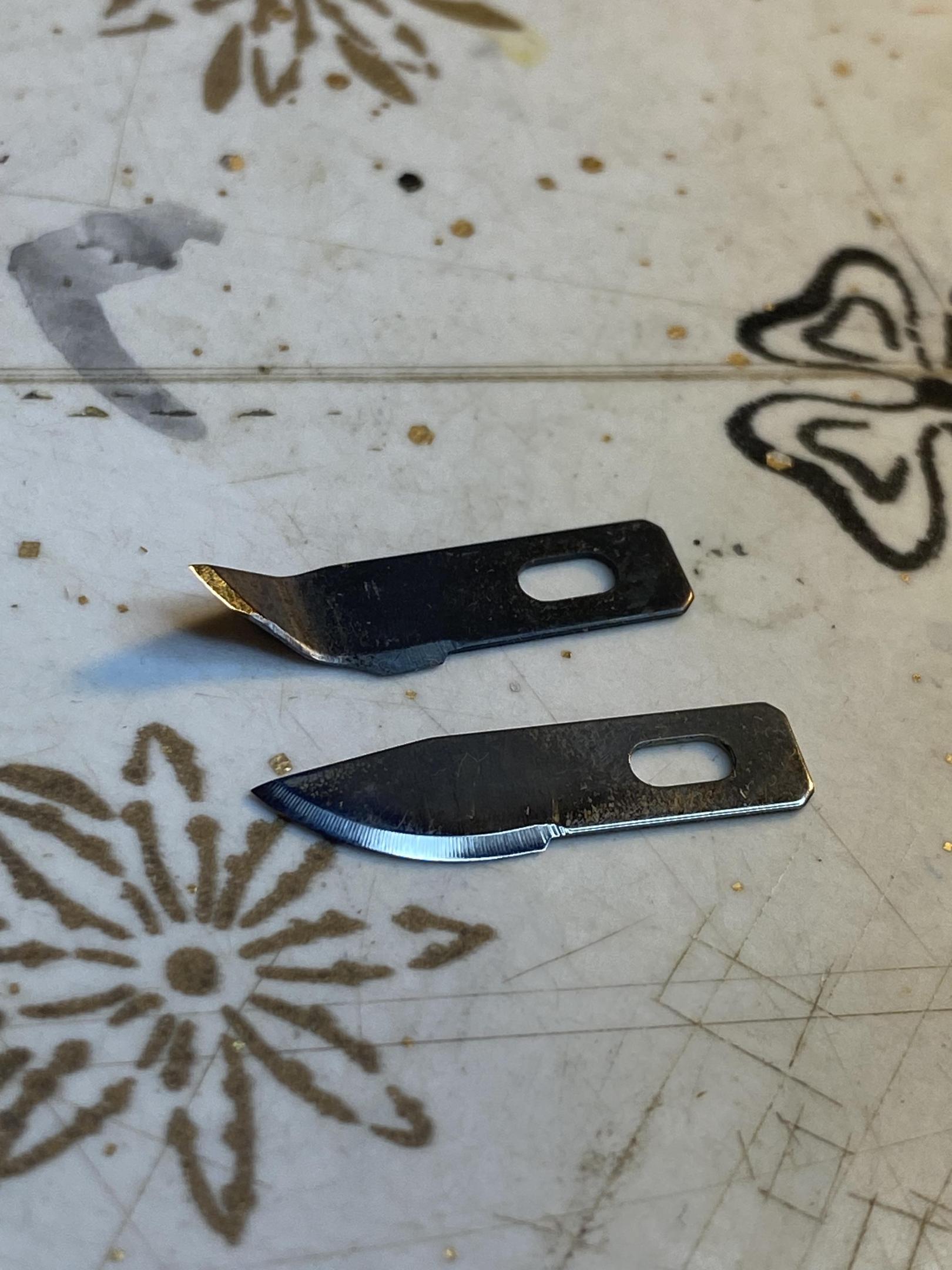

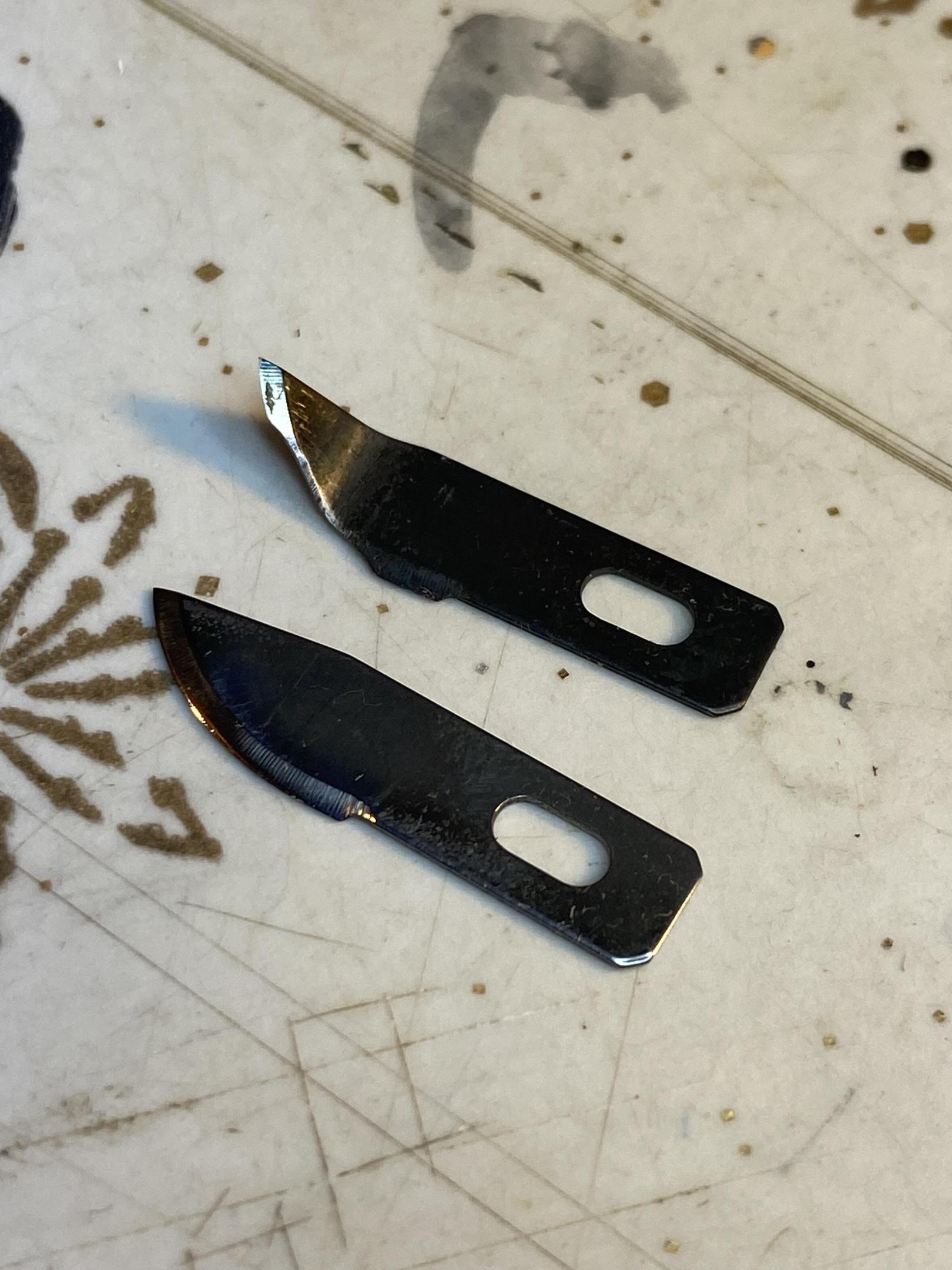

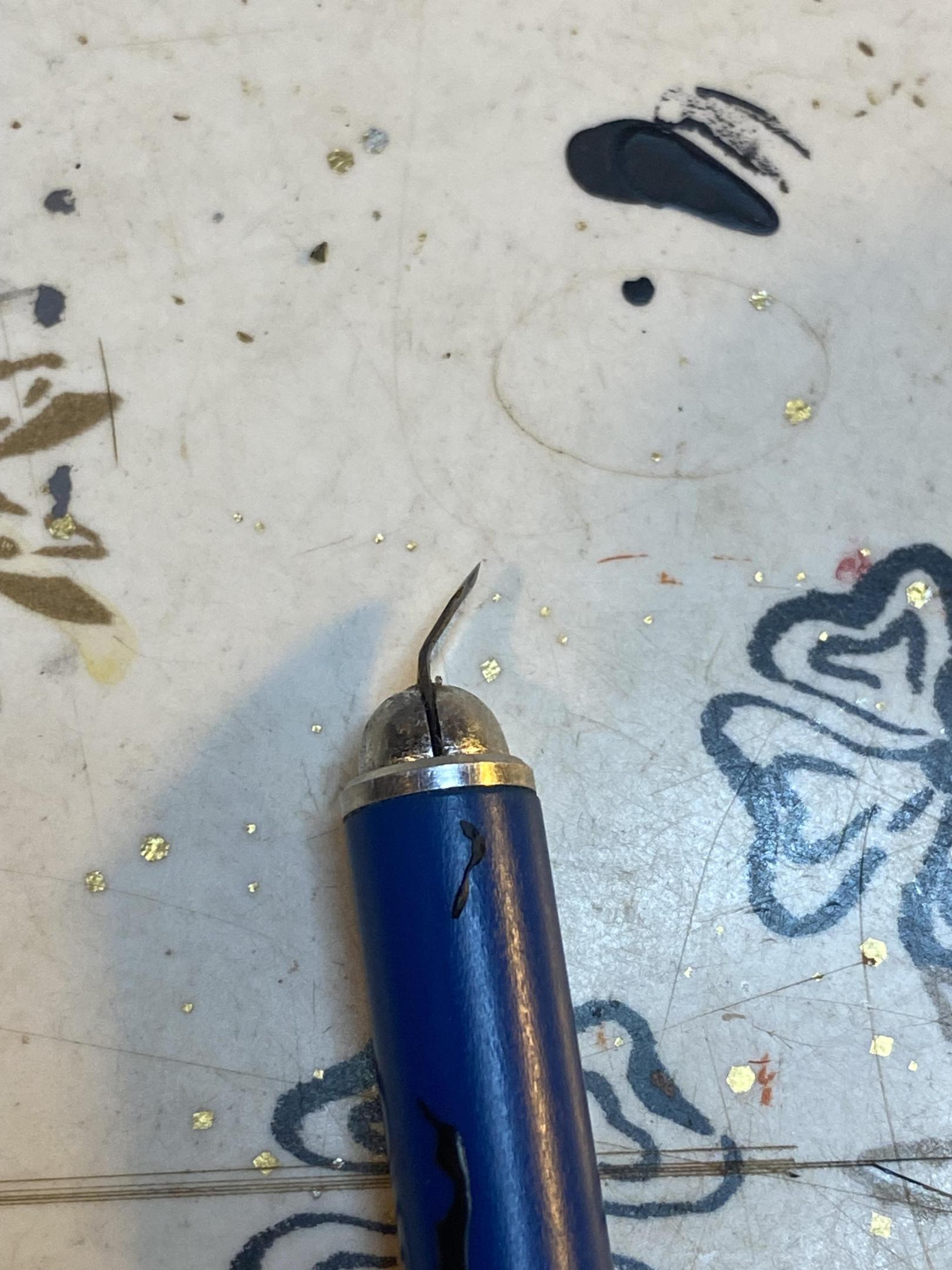

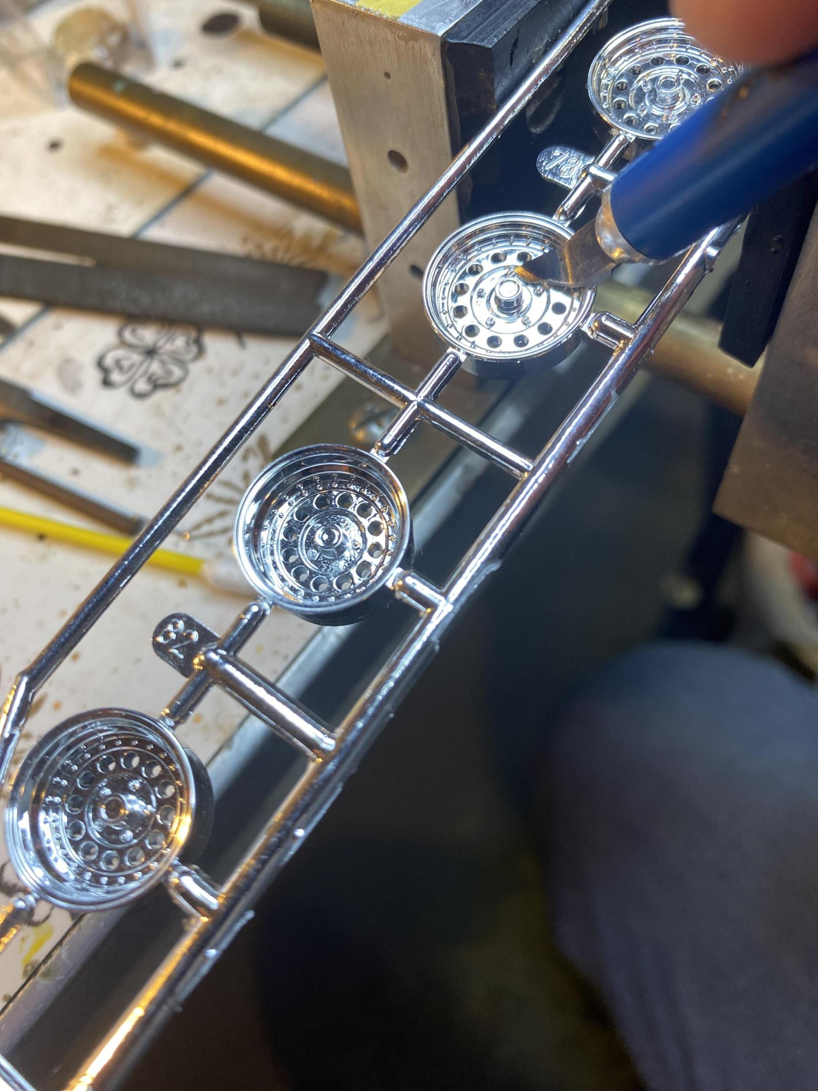

Bainford Posted May 18, 2024 Posted May 18, 2024 Sometimes when the lug nut is not too closely shrouded, a blade can be modified to do the trick. I took an Excell rounded blade and clamped the pointed end in a vice, heated it with a pen torch, and bent the blade at an angle. Then I ground away the cutting edge to make the blade less bulky and provide clearance, leaving just about 3/32" of cutting edge at the tip. This allows me to get the blade down into the wheel while keeping the cutting edge level with the surface on which the lug nut is molded. Be sure to clamp the cutting end of the blade in the vice when heating so the jaws can sink the heat and prevent the blade from losing its temper ( no one wants a blade with a bad temper ?). This modified blade has since been extremely handy around the bench, perfect for many hard to access trimming and scraping jobs. 2
