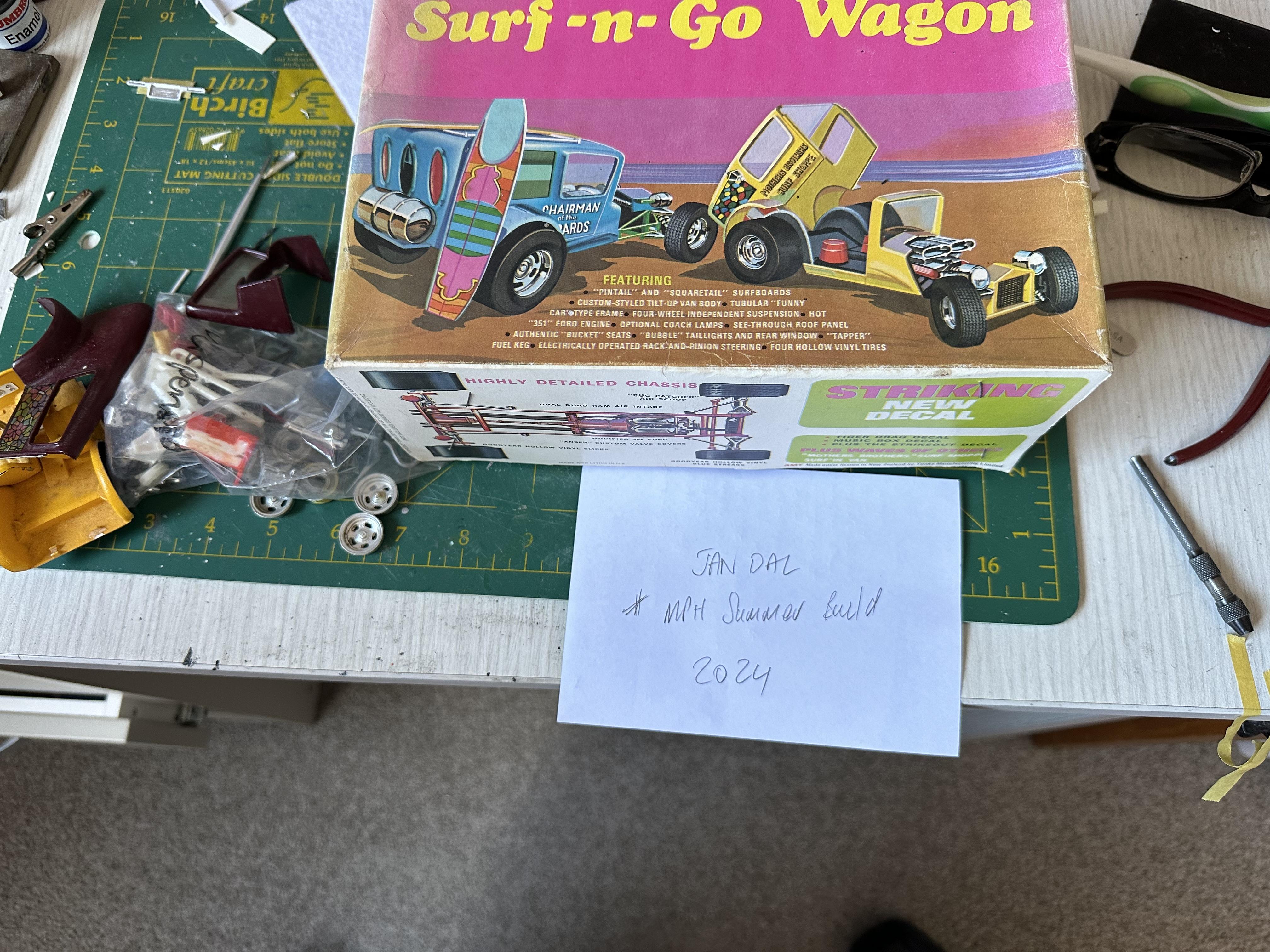

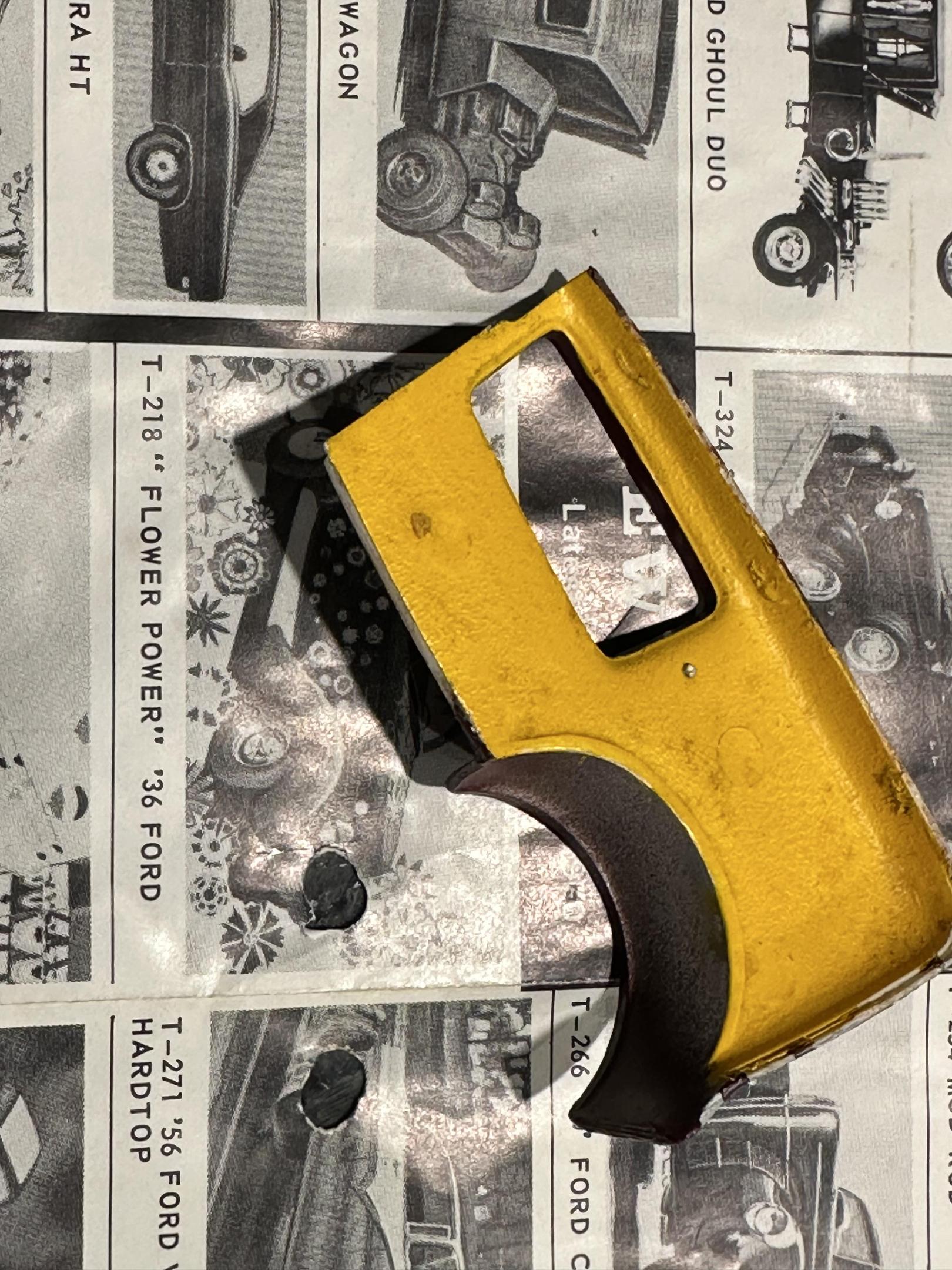

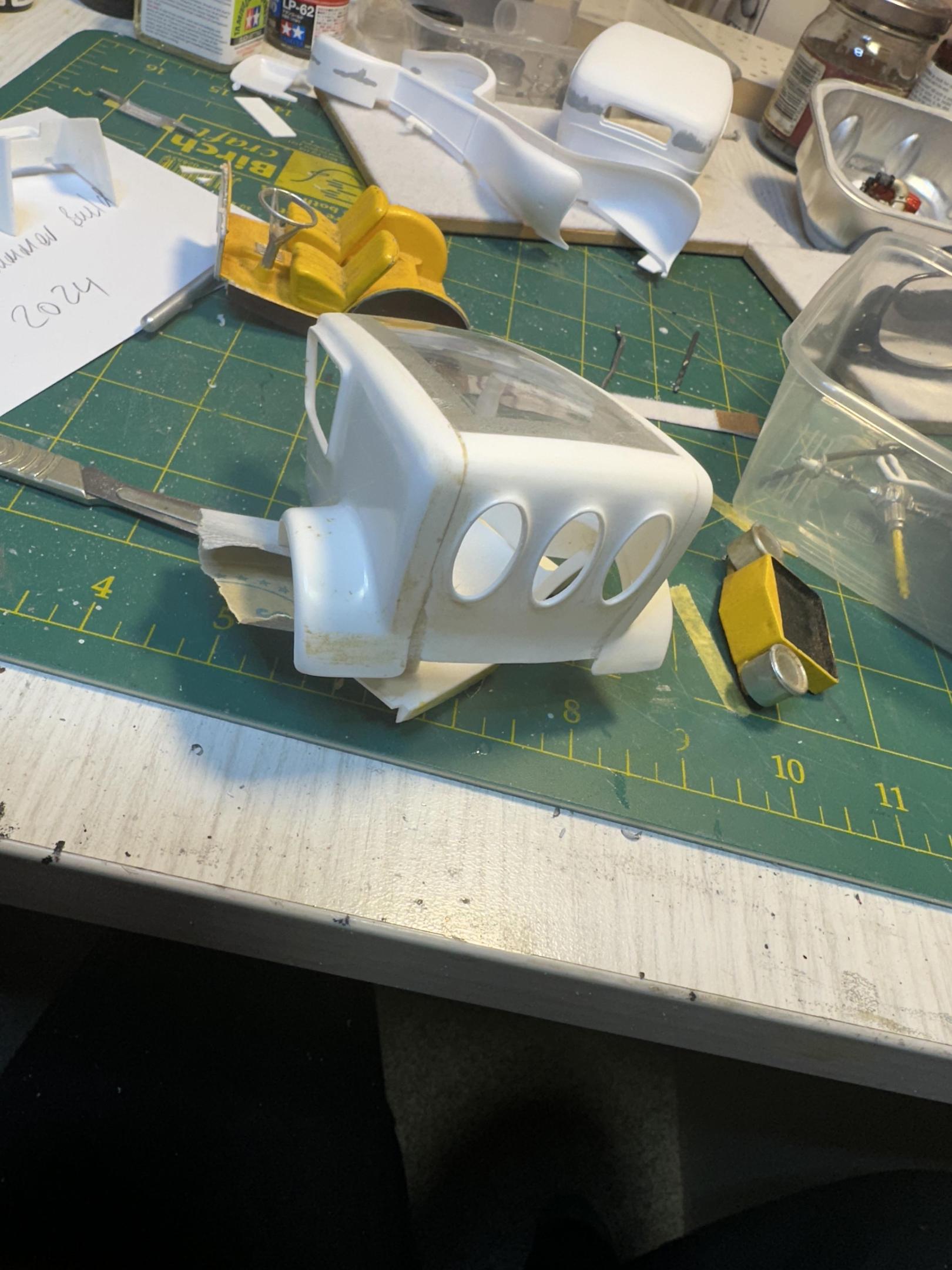

The local FB group has a summer build going on so I thought I would play along. I have this incomplete AMT Surf-n-Go in the stash. I remember building this kit as a teenager way back when. The kit is what we refer to as NZAMT. AMT leased out the moulds to a local plastics company here in New Zealand in the late 60's and early 70's as we had at the time very restrictive import rules. If the manufactured item was seen to have some NZ input then that was OK. At the time our roads were teeming with English and Australian cars and they all had some amount of local content. American cars were few and far between. Luckily pre WWII there was less import restrictions and there were a number of American cars imported in that period. Hot Rodders delight
Any on opening the box I found that there was no motor but all of the body and chassis parts are there. The motor dress up parts were there too. It had been started and is a bit of a glue bomb. The chassis had been painted and the paint (poorly) stripped off. The body had been poorly glued together as well. A search through my parts boxes netted some bits from 2 other builds and a SBF from a 32

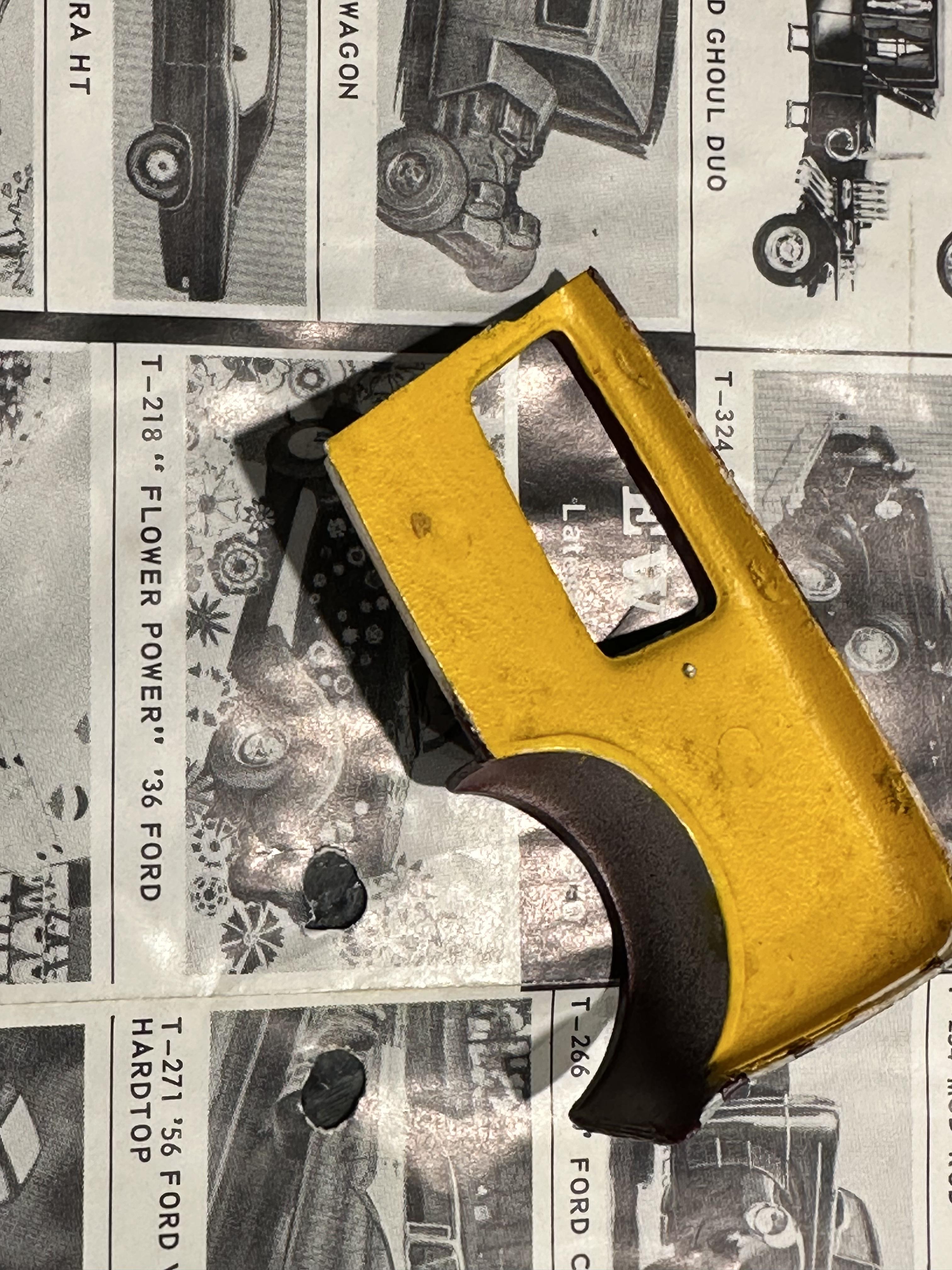

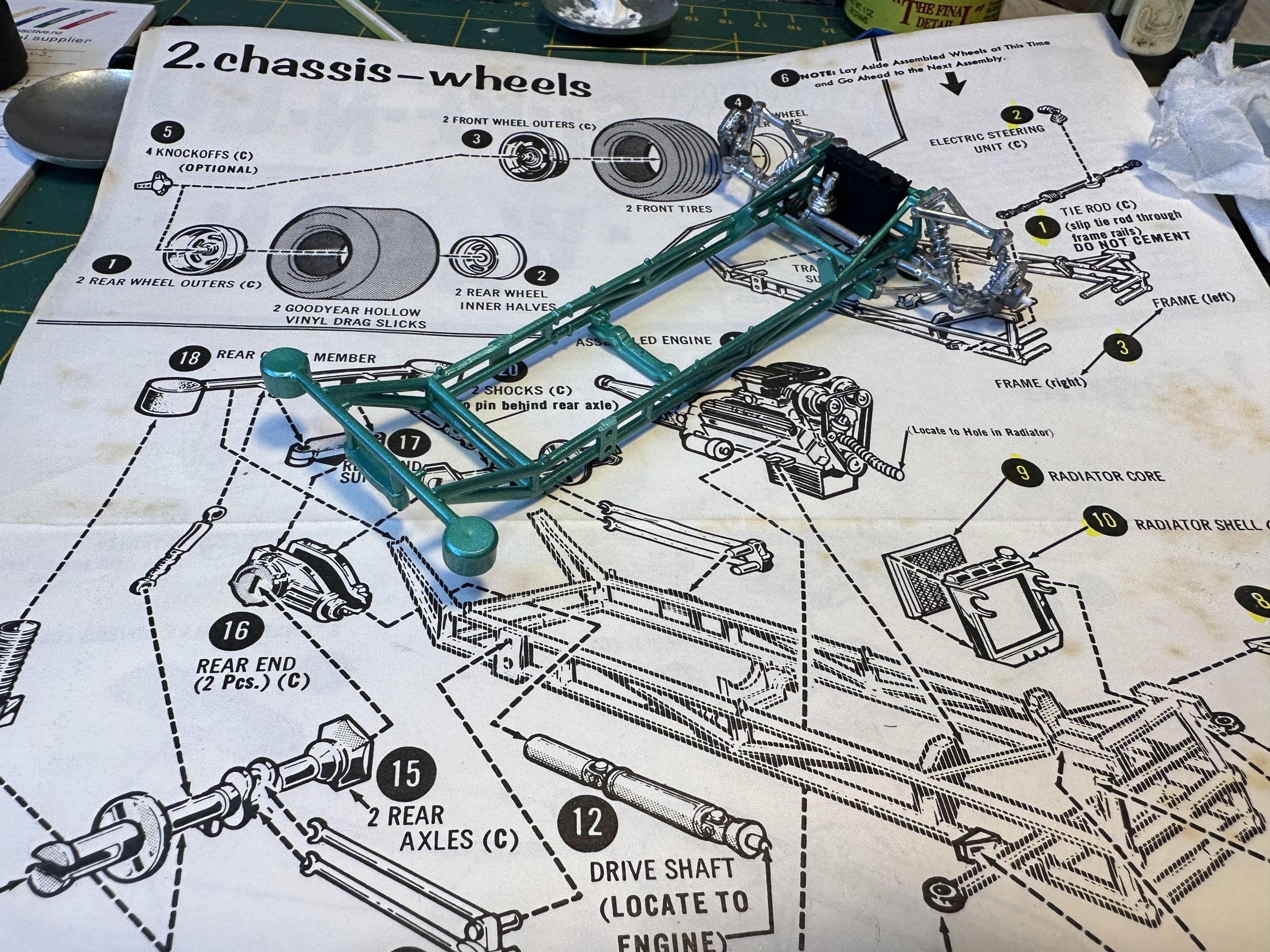

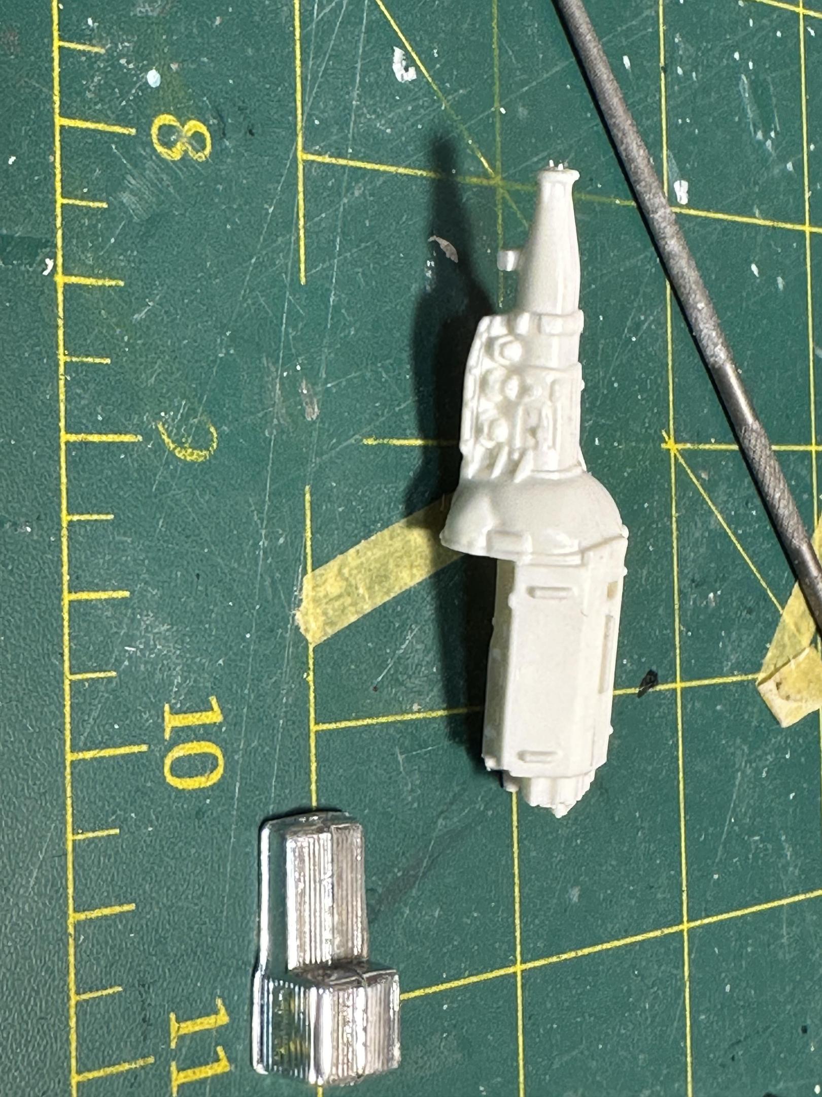

Did some work over the weekend. Body got some primer laid down and now in the body shop for more work. The chassis was previously painted and then stripped so some effort went into the clean up and now is in the paint shop along with the motor. Paint is Testor metallic green in the little square jars. Ancient paint for an ancient model

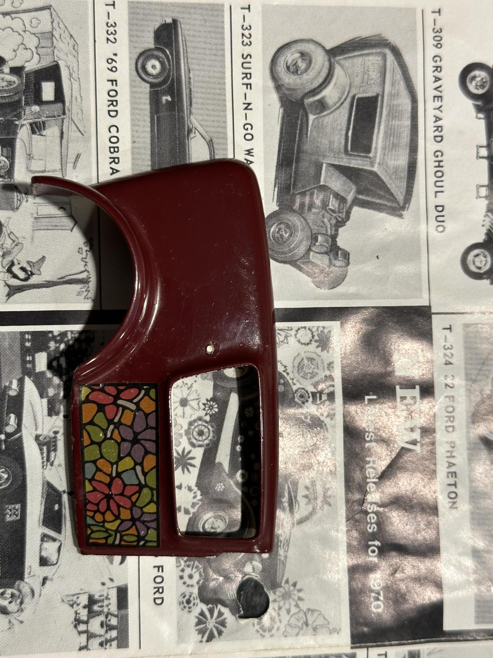

I dug out the NZAMT catalogue for 1970. These were available towards the end of 1969 as I assembled the 32 Phaeton instead of studying for our big High School exams - what was then known as School "C".  AMT kits were being "Made under Licence" Tonka Manufacturing. Was there a tie between AMT and Tonka at the time - did AMT make the plastic parts for Tonka. IIRC there was a little jar of paint inside every box. It was shite - you could not brush paint it easily. It was like a lacquer paint - most probably the same formula as AMT rattle cans
The following is the box art. The top is repeated on the side and both ends are the same

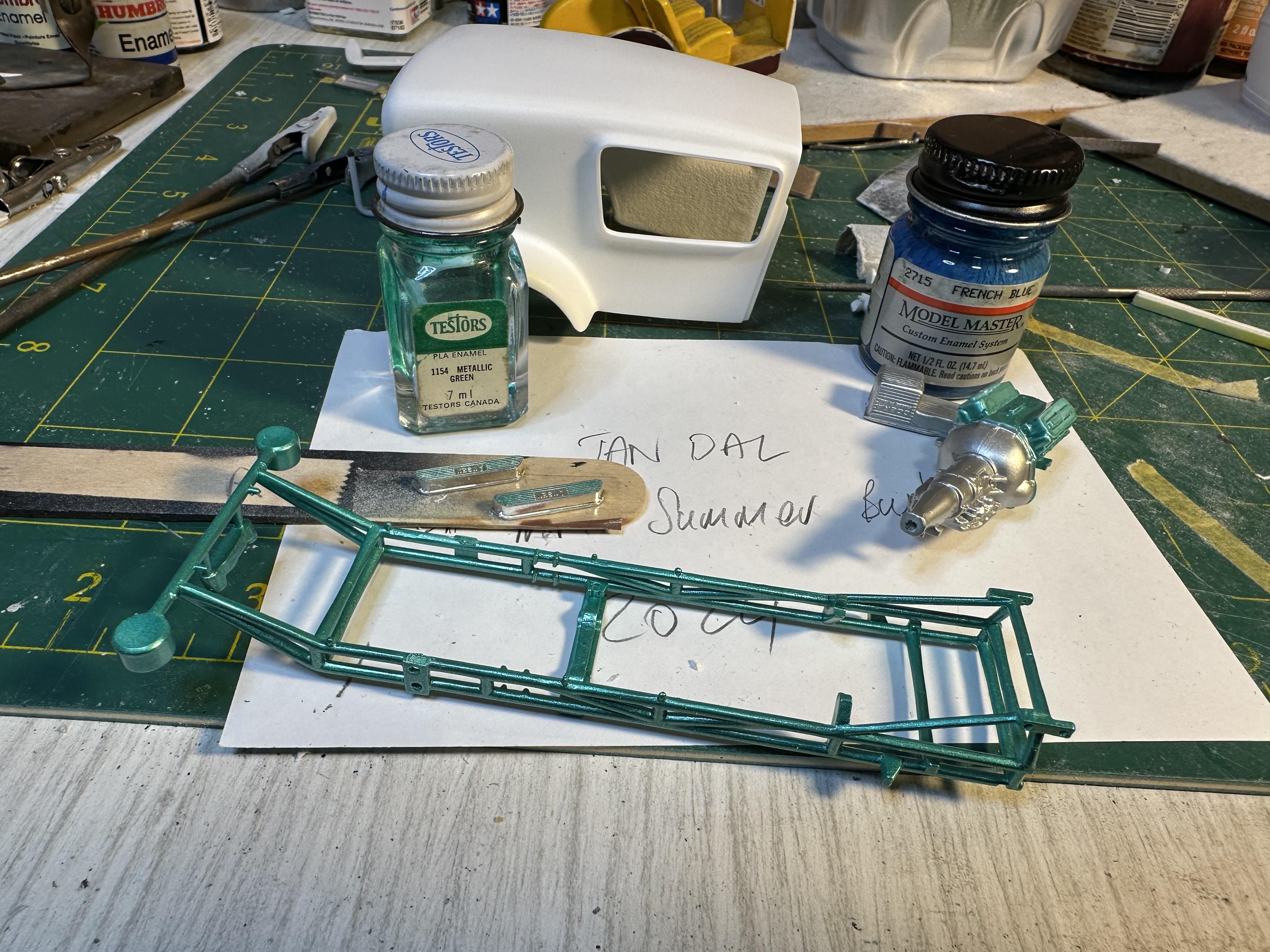

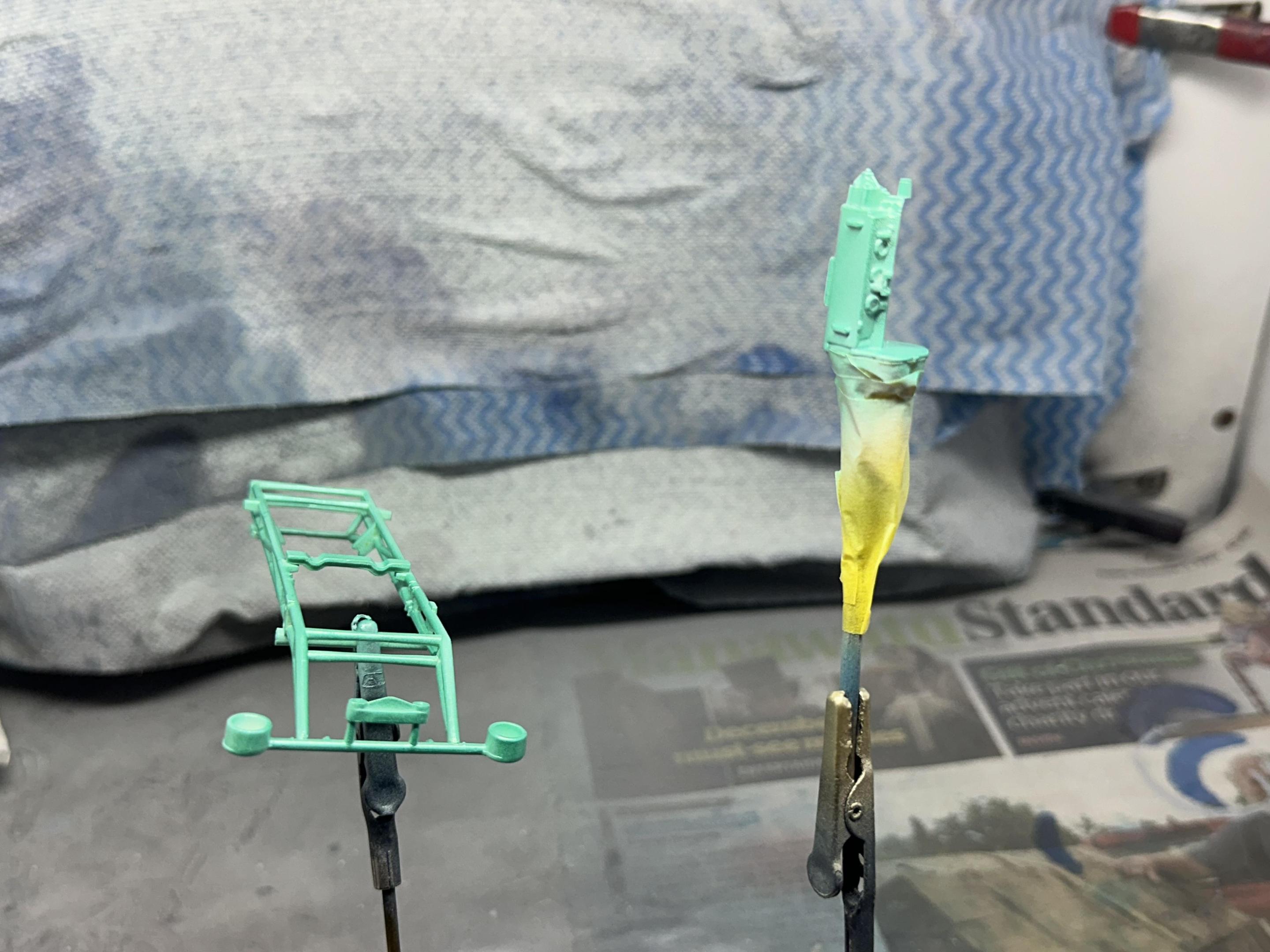

A vintage kit deserves vintage paint. Used Testors small square jar metallic green for the chassis and motor. All good

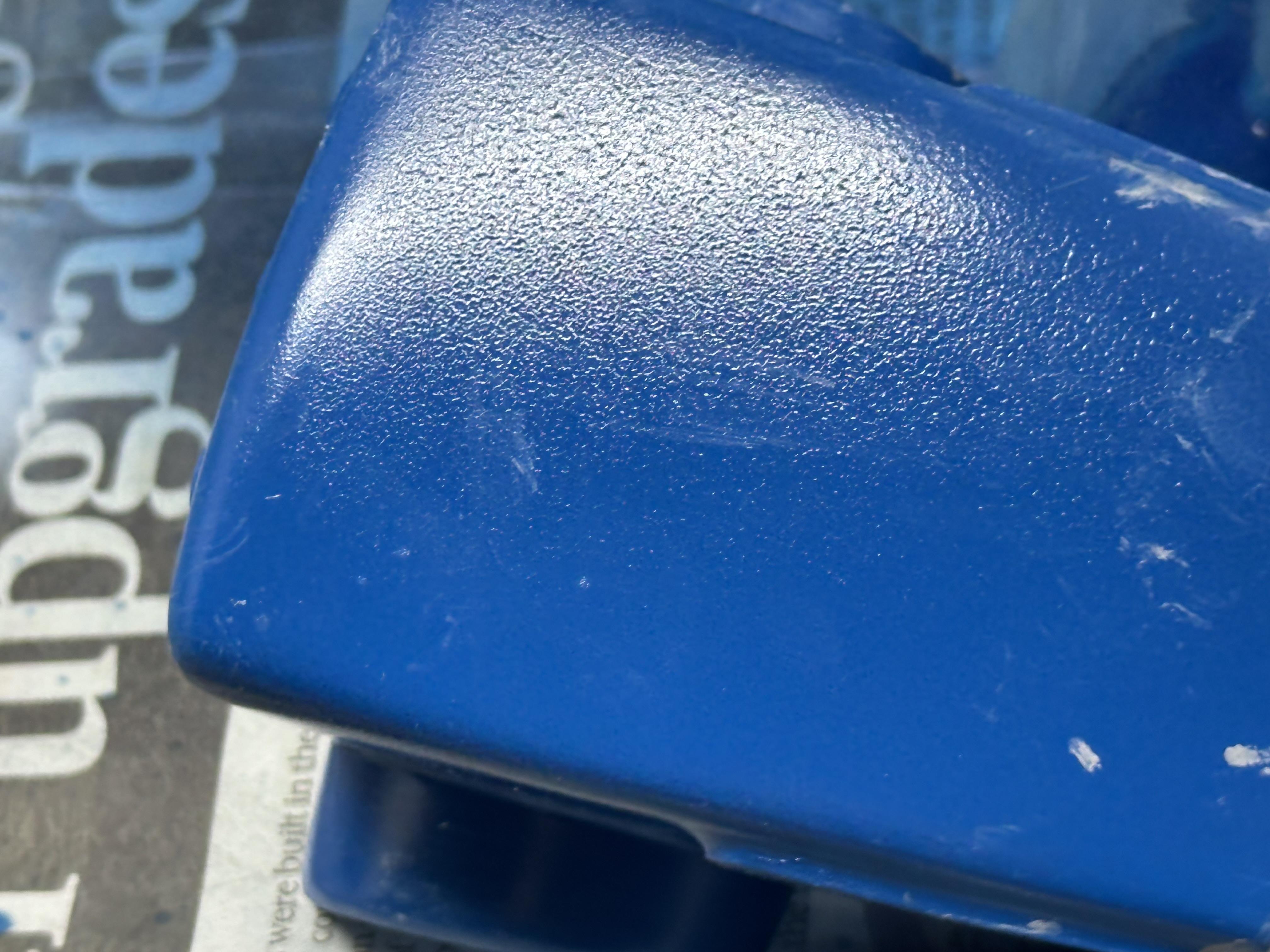

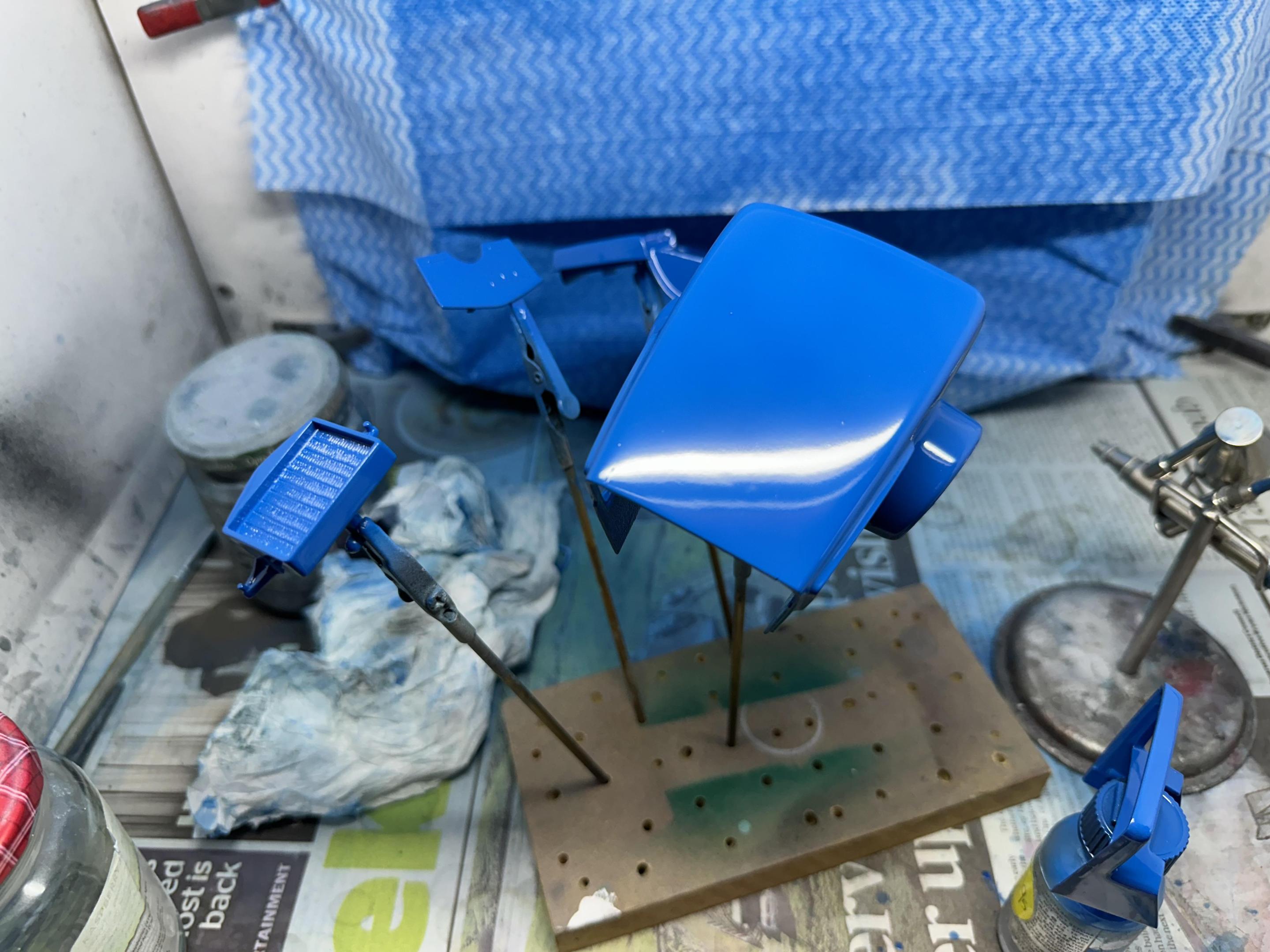

Intention is to use Testors French Blue for the body as per the box art. First lots of prep with filling and priming. The clear top insert was glue damaged so I thought I would just paint it all body colour. To prep the body all of the vinyl like engraving was smoothed off and the rest of the body prepped with sink holes filled and all sanded. First primer was with SMS primer. Man this stuff has coarse finish but sands back nicely. More prep and a final prime with Tamiya primer. I use the square bottles thinned down to shoot though the air brush. Final sand and ready for colour
Mixed up the Testors with some lacquer thinners and shot a few coats. Some greeblies got in there so sanded back with 1500 and shot some more colour. Well it aint pretty.
This is the worst - the top of the body. Some other areas have been affected too. Very disappointed.
It looks like a paint reaction between the hot primers and the enamel paint or the use of too hot thinners in the paint reacting with the freshly sanded colour coats from the earlier session. Not too sure what from here. I will try to sand back and let it sit to gas out and have another go. All else fails into the tank it goes. Should know better

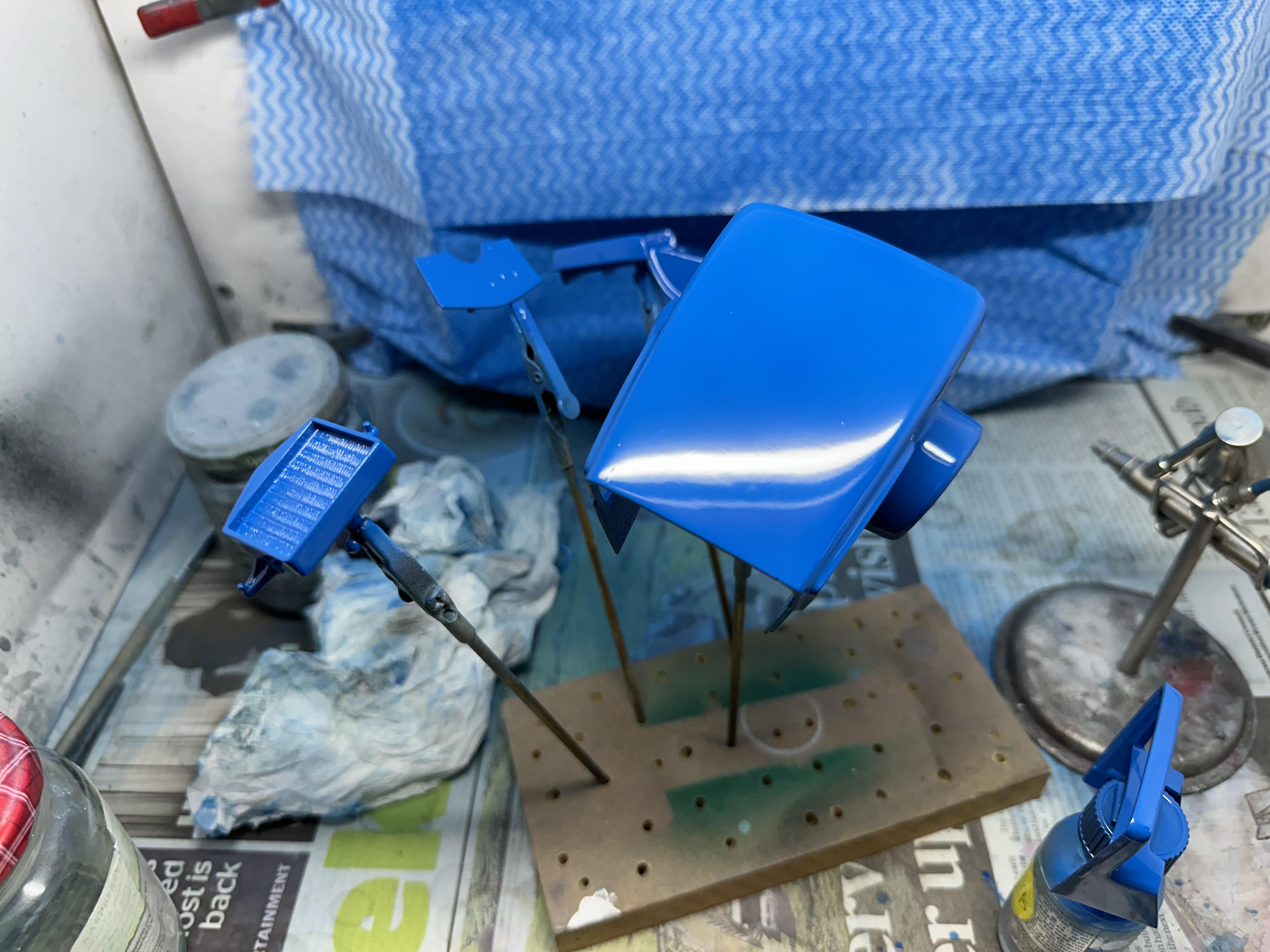

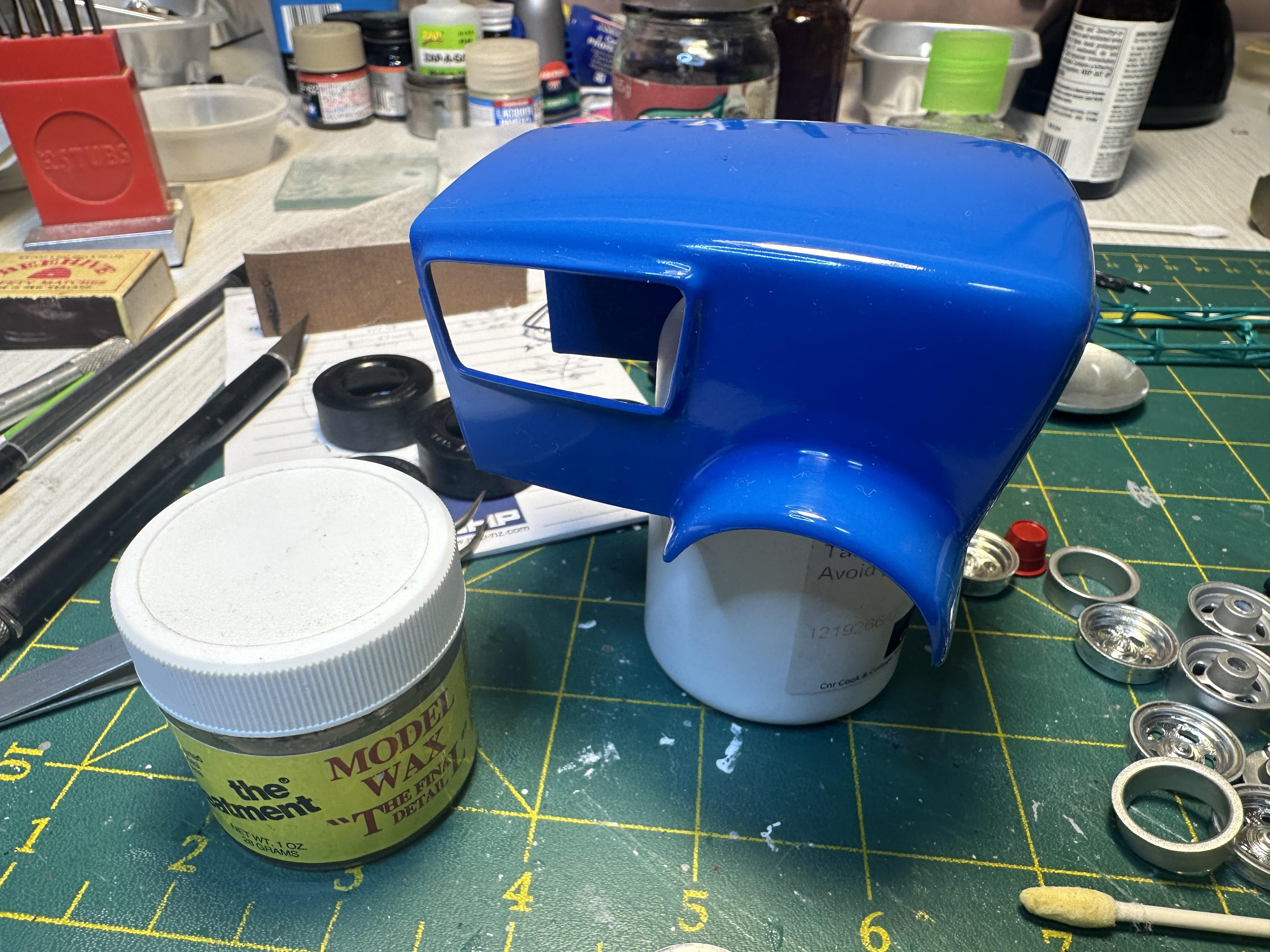

Sanded body down and mixed up a new batch of paint using a brand new bottle from my stash. Last one of this colour. This time thinned with Testors air brush thinners. laid down 4 flash coats and one heavy coat and it is looking good except for a couple of boogers on the roof. Will sand those back and recoat but happy with way things are looking

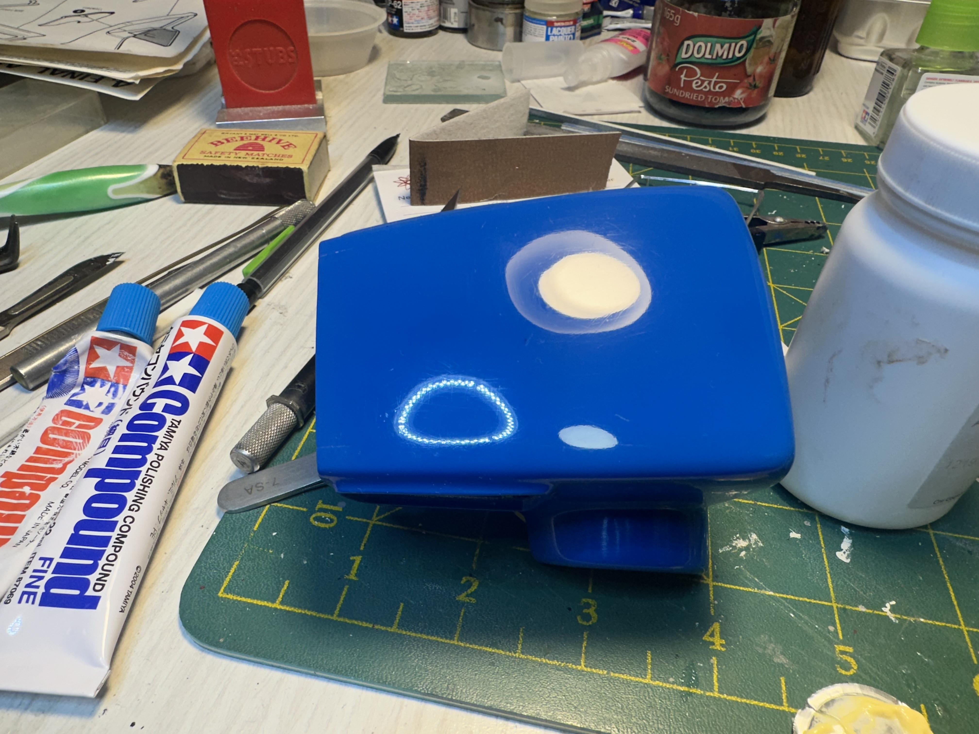

Got 2K clear on the body and it has been colour sanded to 12k grit and I have the body rubbed out and polished

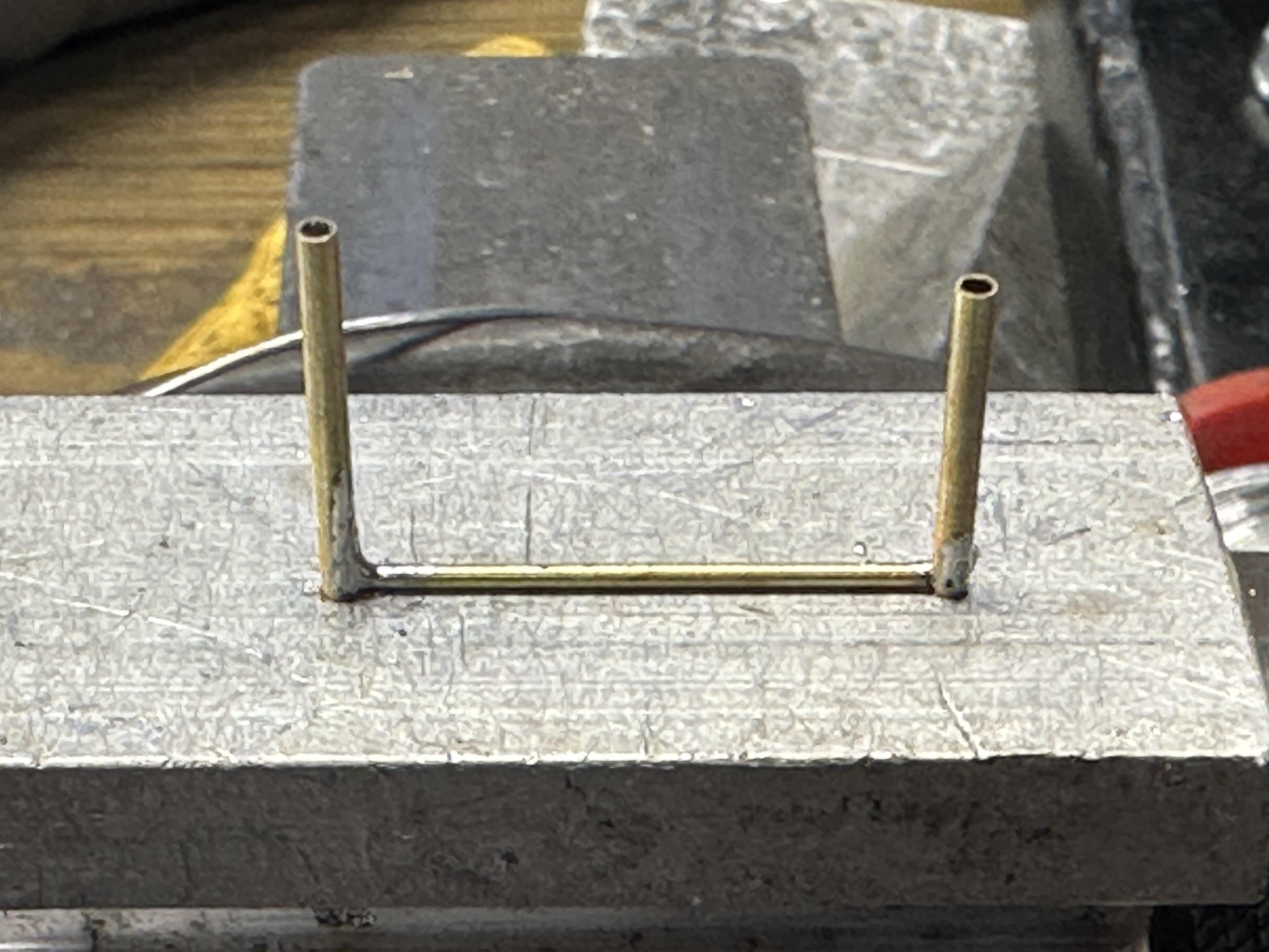

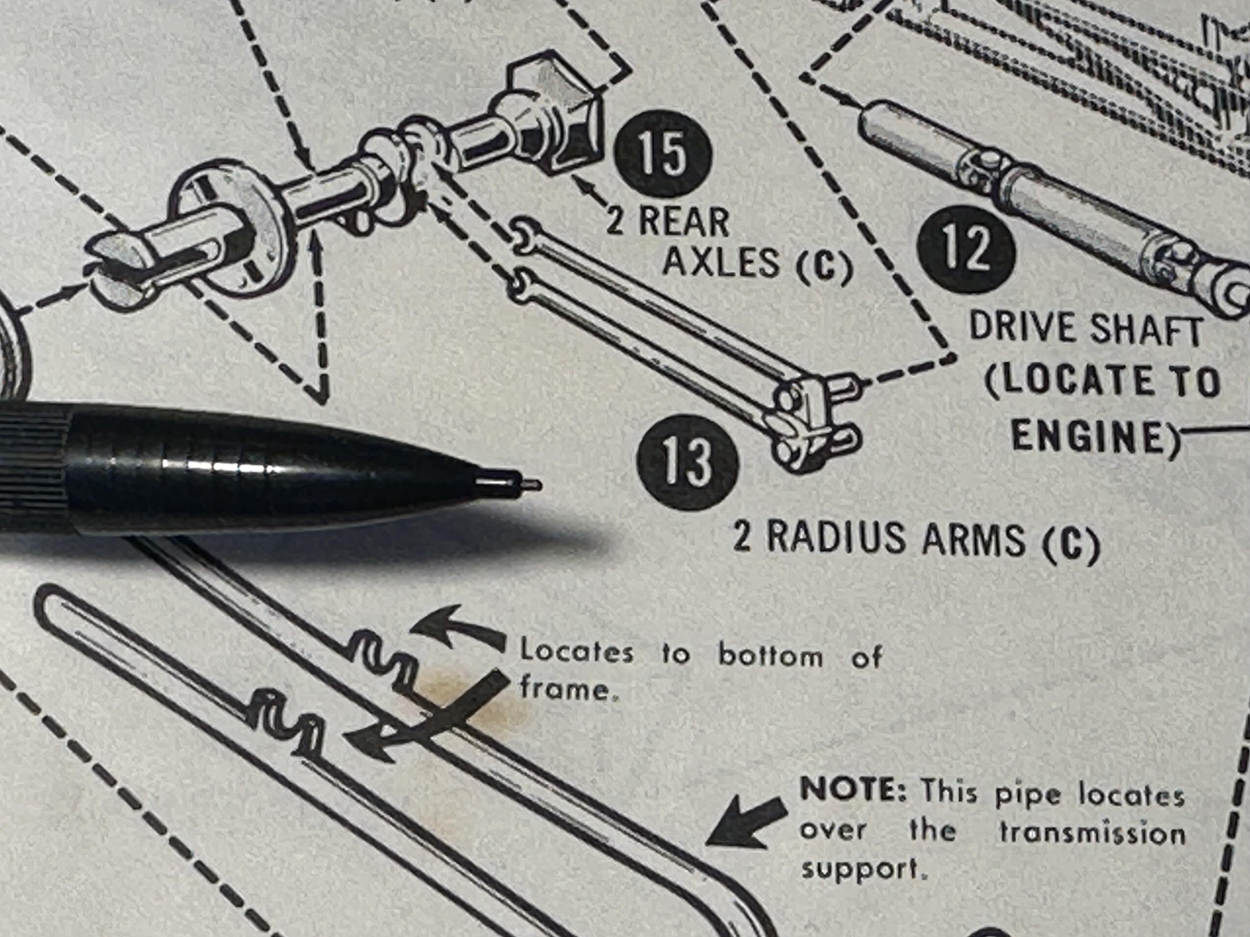

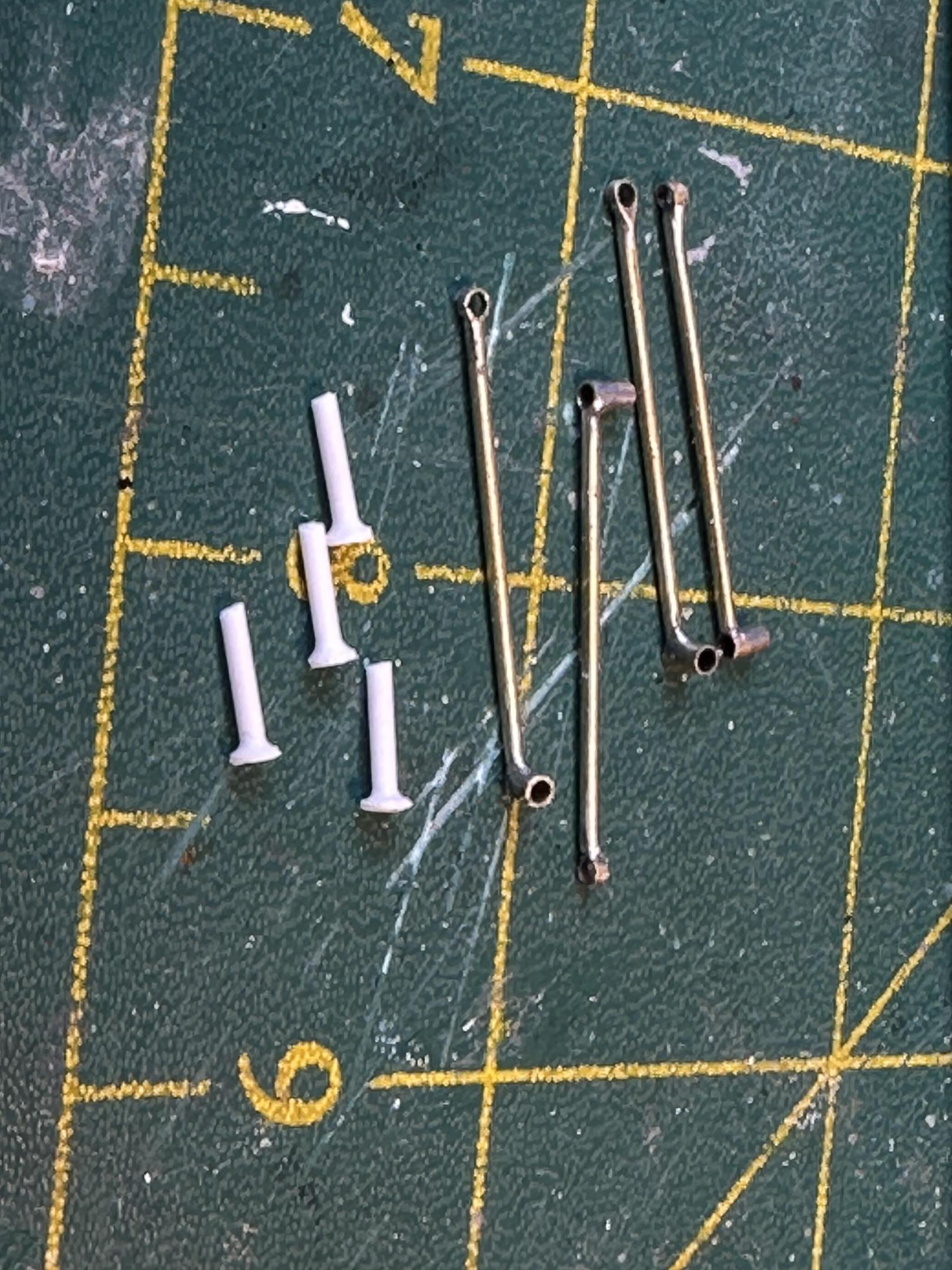

When I was doing a head count of all the chassis chrome I found the rear radius rod missing from the box. So much for thinking it was complete. Any way I found where a set was used - I have this and two other parts cars in my parts bins and there none there either. So I made some up from brass rod and tube. I made a jig so that I could solder them together. Also made some pins by heating the end of a styrene rod to give me a mushroom head that I chucked in the Dremel to clean up
This is where a set of radius rods ended up but is a way good of a build to go steeling them - and they have been modified

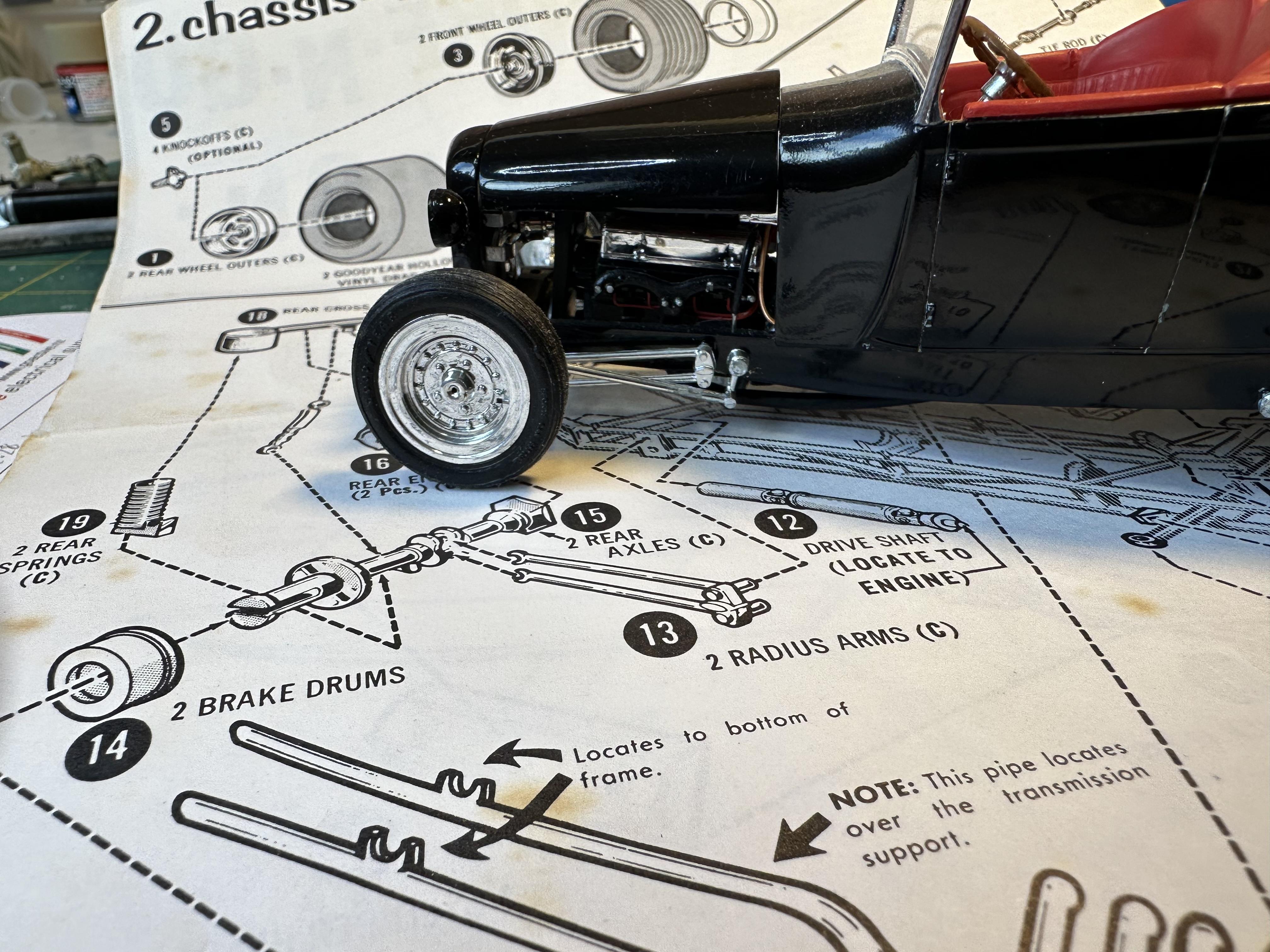

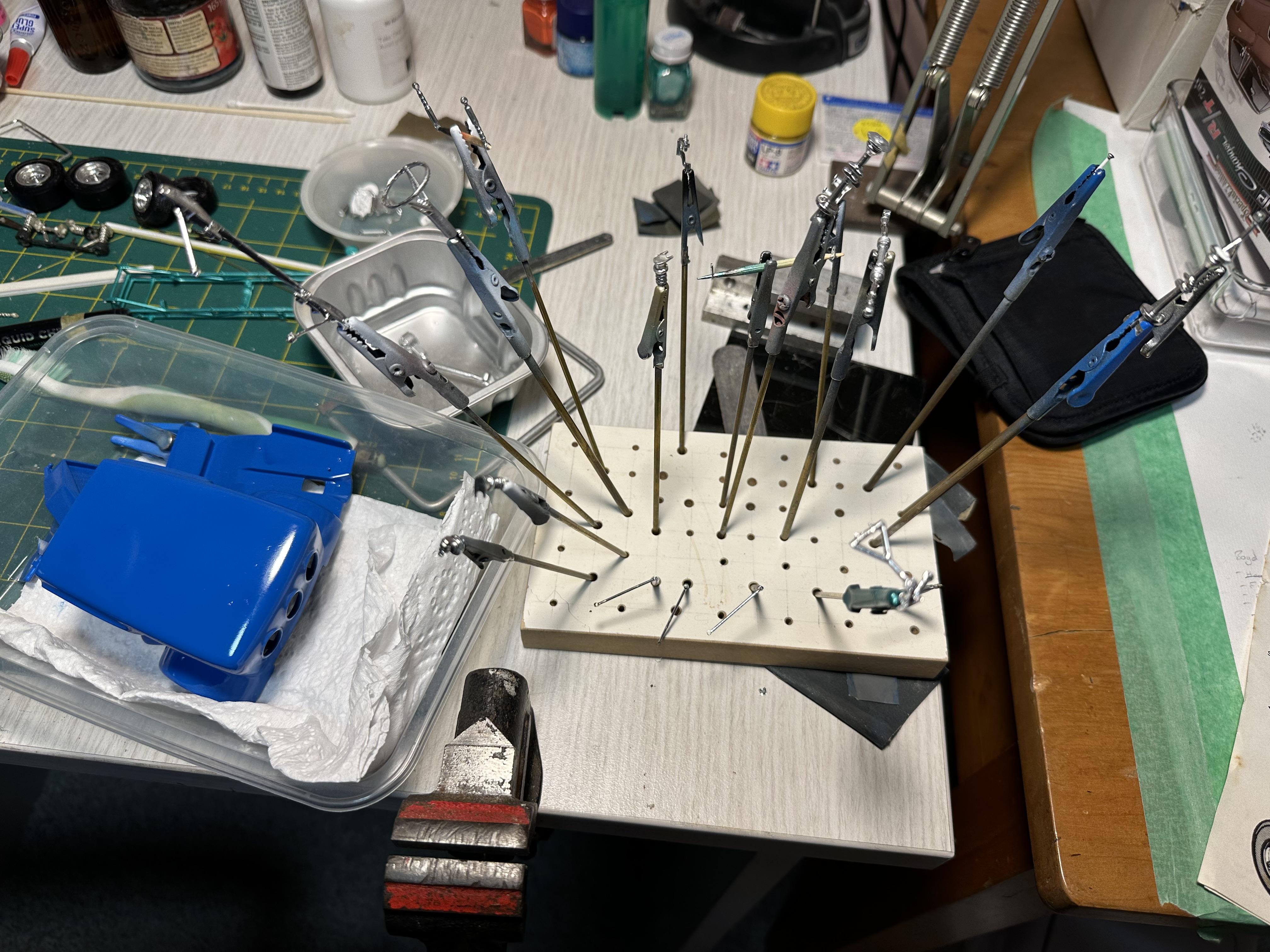

I have been progressing the build but it has been a battle. Crucial bits missing saw me dumpster diving the parts bin - some bits I found some I didn't. I have found bits for two more of these kits but not one complete model out of three. Oh darn

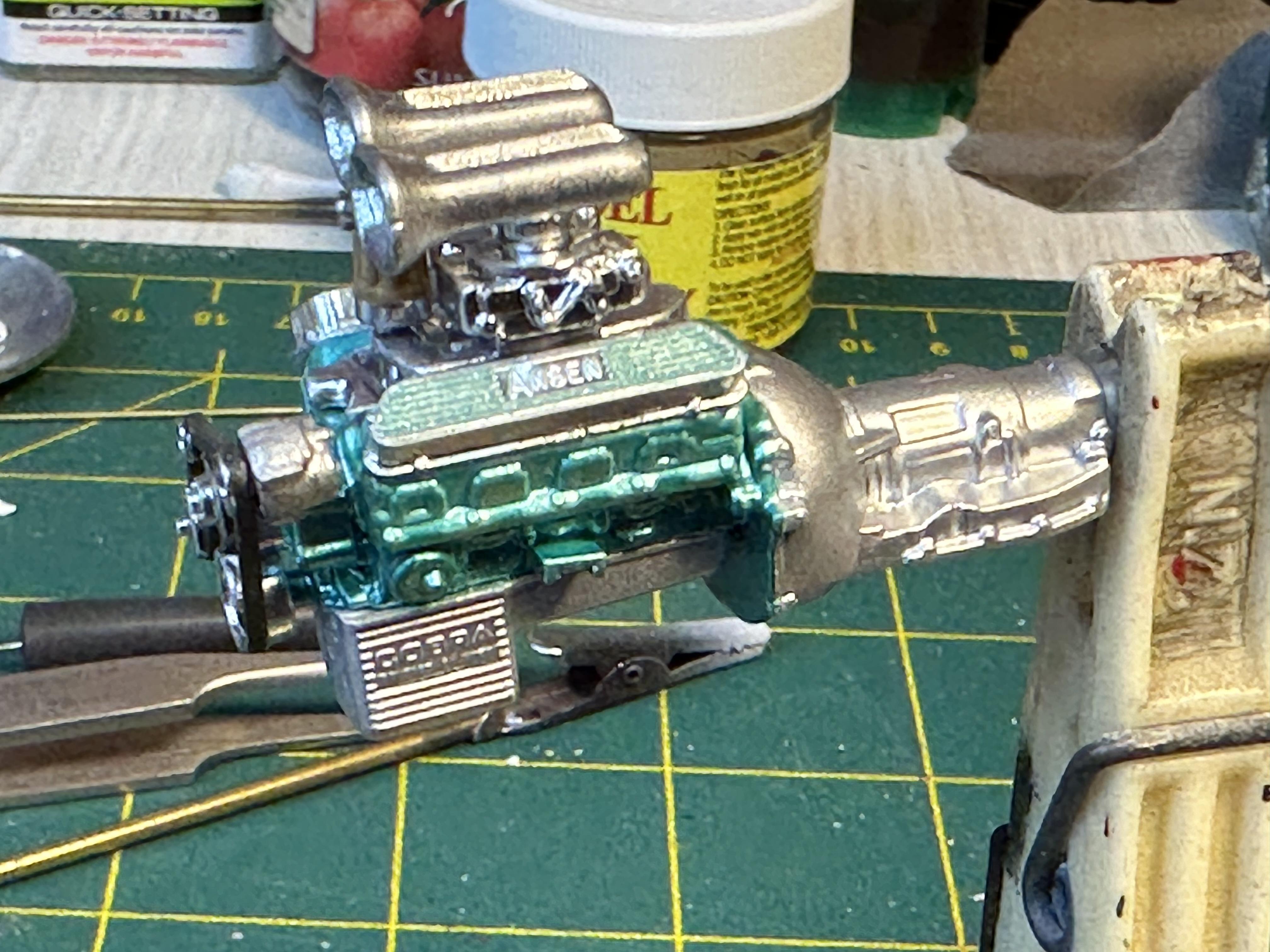

Got the motor together which is a plus
And the front end assembled onto the frameimage.thumb.jpeg.a5927fcada6077fda9439388e9b80ffc.jpeg

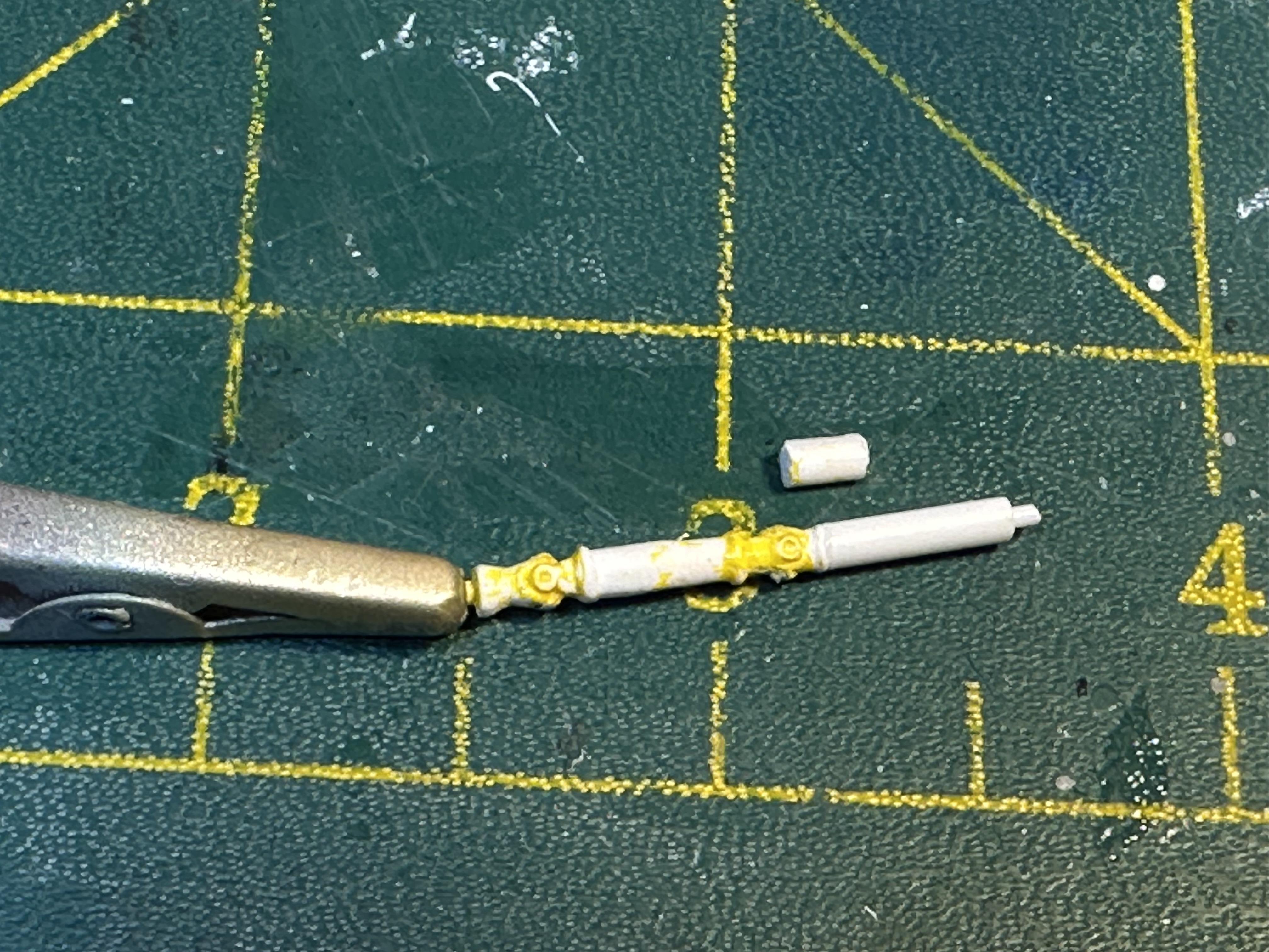

Next up drive shaft - guess what - had to go looking and I found one from one of the parts kits. Yahhoo. It was a bit short as the Revell 32 SBF that I used must be a bit shorter - easy enough to make longer after a clean up - you can see the bit I cut off above the lengthend shaft
 Assembly for the rear end is now in WIP
