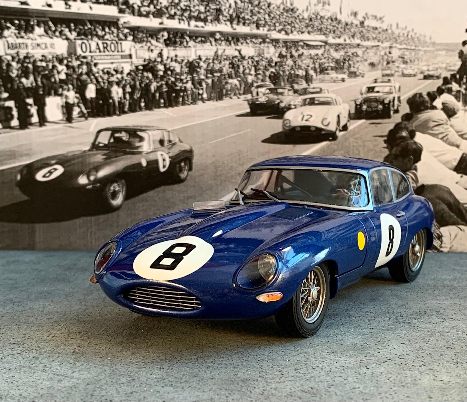

Posting a couple of photos for reference & discussion
  • Like 5

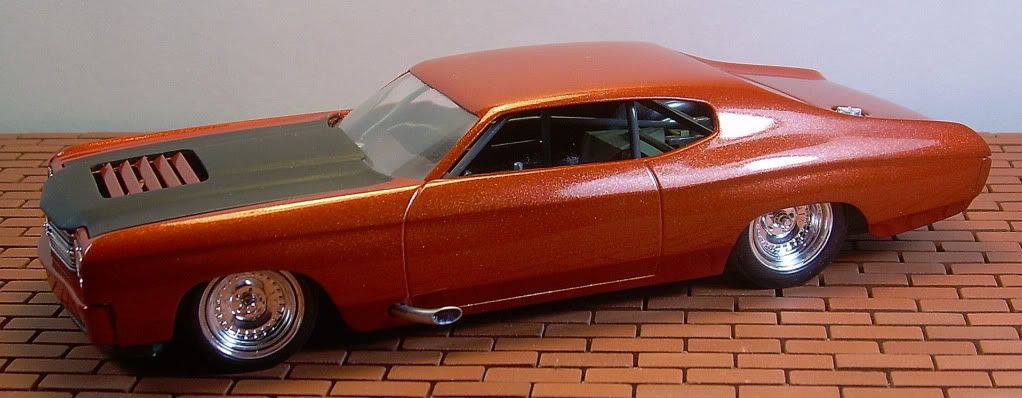

You don't have to buy the latest-greatest high-buck digital SLR to take professional looking shots suitable for publishing to the web.
The photos below were taken with an "obsolete" 4-megapixel Nikon that can be purchased used for $15-$50.
It features 3X optical zoom and a macro setting.
I bought one new many years ago and it's still going strong.
I bought a used one for a dedicated shop camera 5 years ago and it still works fine too.
I use a very capable Nikon photo editing suite (which was a free download) on my laptop.
EDIT: Good lighting, a tripod, and some care with composition are also required.
