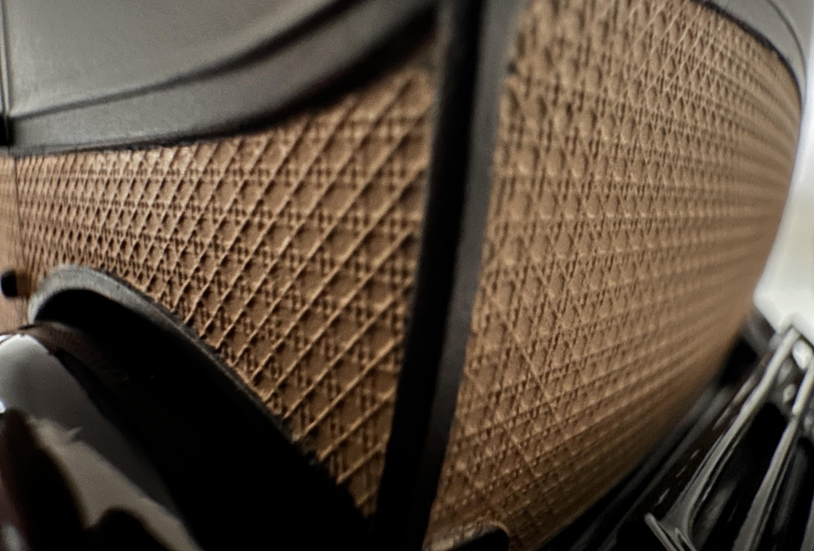

The cabriolet was built in 2023. The Sport Phaeton and Town Brougham were finished just this week. The most challenging part in the building process was probably attaching the Town Brougham´s interior into the body, it was a very tight fit. Otherwise parts fit quite well. Painting the Town Brougham required lots of masking because of three different colors.

Those are superb. Beautiful builds of genuinely classic kits. Having done just the one (the Cabriolet), I know how much work goes into getting a single one completed (and I hear you on the brittle plastic...). never mind the full set of three! On the other hand, they are superb kits, designed and engineered by people who really cared about these cars, so they fully do justice to the prototypes. Your color choices and detailing are outstanding, and that rear-compartment picture of the Town Brougham is to die for. Does the wicker lacquer body treatment on the Brougham come as decals, or have you done that yourself? Looks fabulous, whatever...

Absolutely beautiful. I have the Brougham in the stash, I've been trying for years to figure out how I want to tackle the wicker work. The Jo-han classics are a level above!

The wicker / cane treatment is actually molded in the body. I posted a question about the subject here before starting building. I thought of making it look a little more three-dimensional by applying brown panelliner but that didn´t work out quite well so I opted for just a clean look instead. For the same reason I didn´t gloss coat the black and dark red body parts, wet sanding and buffing them would´ve been quite a chore. Semi matt was easier to get a clean look.

Thanks and looking forward to see your solution. I posted a link to discussion about the cane work above, maybe they will help!
