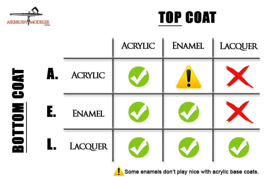

Bainford Posted 20 hours ago Posted 20 hours ago (edited) 7 hours ago, butterdogg08 said: I found a decent number of paints, mostly from Revell and Testors, but would Testors primer be good? I would avoid the Testors primer. I swore off the stuff 25 years ago when I discovered Tamiya. It doesn't lay down as smooth and doesn't sand as nicely as Tamiya. It may also be enamel, which means you can't put lacquer over top of it. Tamiya and Mr Color are lacquer, and you can paint any type of paint over it. I highly recommend Tamiya or Mr Color (Gunze Sangyo) primers as a far superior product to Testors. Also, I noticed earlier that it was suggested you ditch the Tamiya masking tape in favour of cheaper regular household masking tape or painters tape. In my personal opinion, regular hardware-store masking tape is a bit bulky and difficult for paint work, and doesn't burnish into panel lines and deep contours as nicely as a hobby specific masking tape. It has its uses, but I find the expense of Hobby masking tapes to be well worth it for paint work. I keep Tamiya 6 mm and 18 mm tape on the bench and use it constantly for many purposes, less than 20% of which have anything to do with painting. Just don't leave it stuck to a painted model surface for more than a day, as it may mark the surface. Edited 19 hours ago by Bainford 1

DJMar Posted 16 hours ago Posted 16 hours ago 3 hours ago, Bainford said: I would avoid the Testors primer. I swore off the stuff 25 years ago when I discovered Tamiya. It doesn't lay down as smooth and doesn't sand as nicely as Tamiya. It may also be enamel, which means you can't put lacquer over top of it. Tamiya and Mr Color are lacquer, and you can paint any type of paint over it. I highly recommend Tamiya or Mr Color (Gunze Sangyo) primers as a far superior product to Testors. Agreed. Enamel primer is fine for enamel color coats, but the Testors spray definitely leaves noticeable surface texture. Will the Testors primer work if you're planning enamel color coats? Sure. If that's all you have access to, then use it. It will probably take some extra dry time and and a bit of sanding to get rid of the texture, but it's not the end of the world, especially for your first model. If you can get your hands on Tamiya FSP or any Mr. Color primer, it's certainly the way to go. Personally, I would use Duplicolor primer over the Testors stuff, but that's just me. 3 hours ago, Bainford said: Also, I noticed earlier that it was suggested you ditch the Tamiya masking tape in favour of cheaper regular household masking tape or painters tape. In my personal opinion, regular hardware-store masking tape is a bit bulky and difficult for paint work, and doesn't burnish into panel lines and deep contours as nicely as a hobby specific masking tape. It has its uses, but I find the expense of Hobby masking tapes to be well worth it for paint work. I keep Tamiya 6 mm and 18 mm tape on the bench and use it constantly for many purposes, less than 20% of which have anything to do with painting. Just don't leave it stuck to a painted model surface for more than a day, as it may mark the surface. As I said in my previous posts, this is just my opinion. IME, Tamiya tape has a nasty habit of marking up Tamiya TS sprays when used over the top of it. Doesn't matter if it's on there for 1/2 hour or a full day, I've consistently gotten ghosting in paint jobs when using it. That's one reason why I don't recommend it. Maybe it works for y'all, but my experience with it has not been good. Another, much more germane reason is that the OP is a brand new modeler trying out their first kit. I'm pretty sure that there won't be any complicated masking coming down the pike, at least just yet. Painter's tape, even low tack versions, will work just fine for masking off interiors, engine bays, windshield tint strips and other small areas, or holding parts for painting, or helping to line up decals...you know, what we use masking tape for 90% of the time when building a model. Would I suggest painter's tape for laying out a multicolor, flake & candy paint job? Of course not, there are much better products to handle that. But that's not what we're talking about here.
