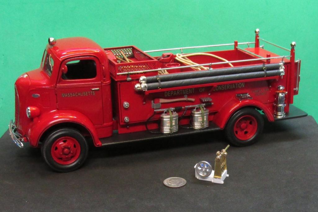

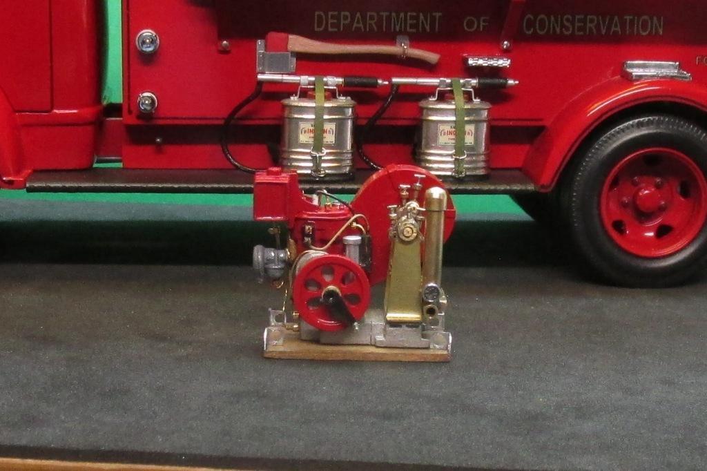

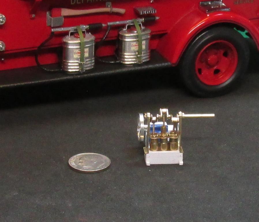

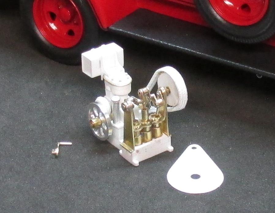

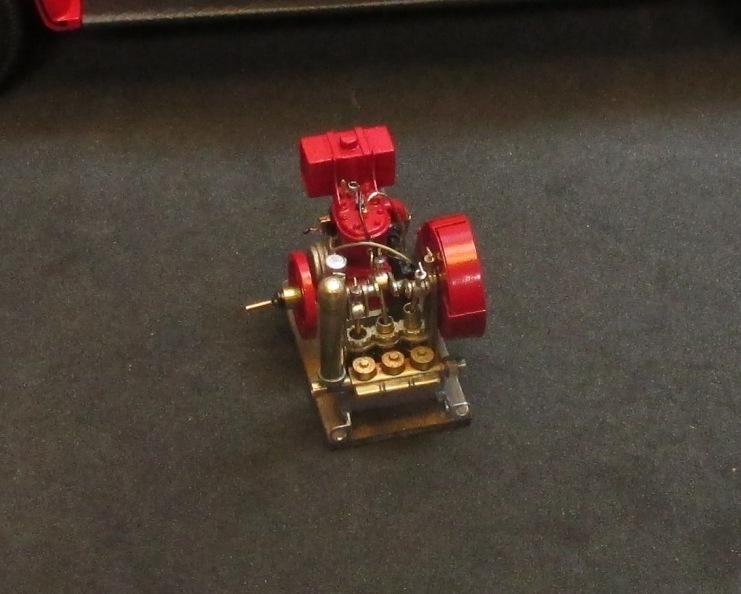

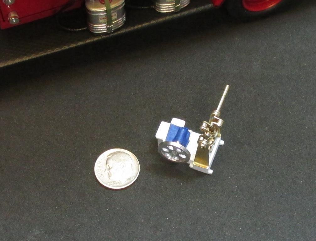

Chariots of Fire Posted September 10, 2016 Posted September 10, 2016 (edited) Hmm.! Never knew this particular part of the forum existed! Anyway here is one small piece of scratchbuilding I did for a 1938 Ford fire truck. It is a Fitzhenry-Guptil pump done in 1/25 scale. Made mostly of brass and plastic with some odds and ends here and there for wiring, etc. The flywheel is made of turned aluminum and is connected to a shaft that turns a small gear at the back. The large and small gear are connected by means of a piece of 1/8" sewing elastic that was superglued together and stretched over the gears. It turns the crank shaft and the 3 pistons go up and down. Edited September 10, 2016 by Chariots of Fire

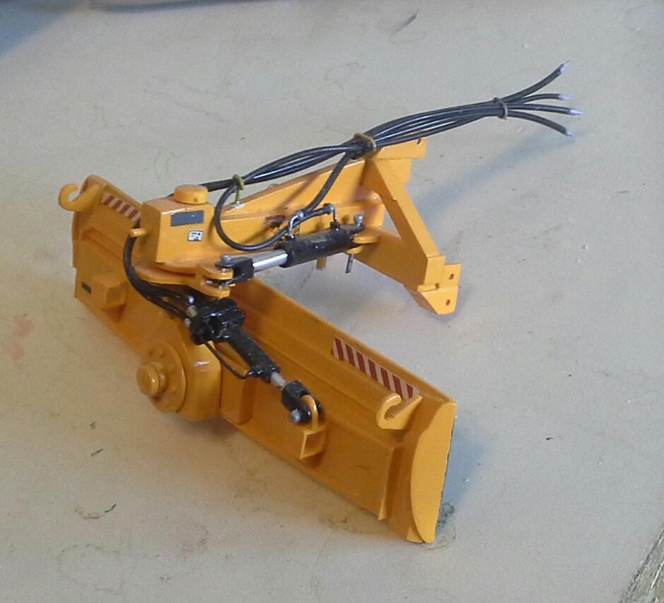

Nova-ss Posted September 11, 2016 Posted September 11, 2016 I love scratch building.here is one for my IH 1466 tractor..its a rear scraper blade.I made everything except the k&s aluminum tubing and the vinyl tubing and a few brass wire and pins.I hope ya enjoy....Chris

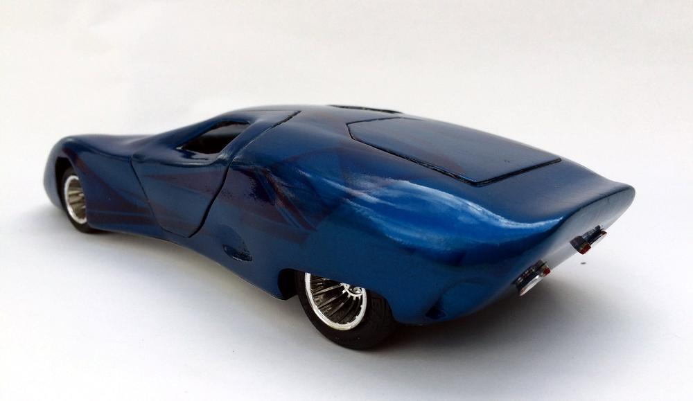

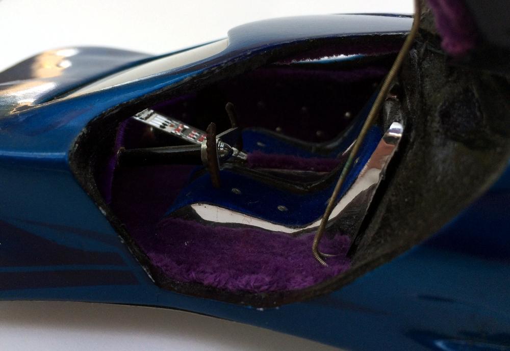

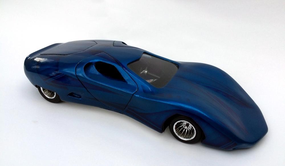

RestoModGuy Posted September 12, 2016 Posted September 12, 2016 Just found this thread re-newed posting. Wow. I'm blown away by the talent of what I see here. My share to scratch built is a complete model I designed first on paper for a highschool design class and as my Senior final project built a model, I was 16-17 years old. This is it as I built this from sheet plastic, Plastic-wood filler and Squadron green putty. The only "kit" parts are the engine from an old F1 model and some interior pieces and wheel and tires. Airbrushed with silver base, red graphics and shot transparent blue over all to acheive a wild 80's concept car paint job.

misterNNL Posted September 15, 2016 Posted September 15, 2016 For 16-17 year old, that is nothing short of amazing!Very beautiful!Thanks for sharing your talent with us.

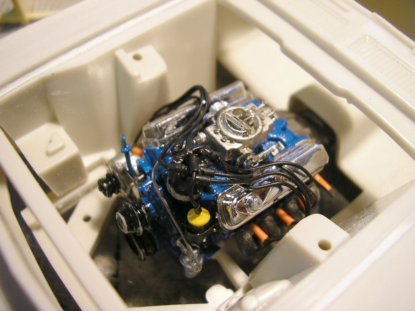

MrObsessive Posted September 17, 2016 Posted September 17, 2016 Had I known (not sure they were available then) I would have gotten this detailed carburetor from Fireball Modelworks. It's a very detailed, practically scratchbuilt carb to go on AMT's '67 Mustang kit's engine as the one in that kit was nothing more (to my eyes) than a plastic block. In fact, I probably could have started out with just a plastic block and no one would have been the wiser! Here are a few pics to show the sequence of what was done.............. If you click here and start with pic #53, that's pretty much the start of the carb buildup in the Mustang WIP, and I have text with some of the pics as to what was done.

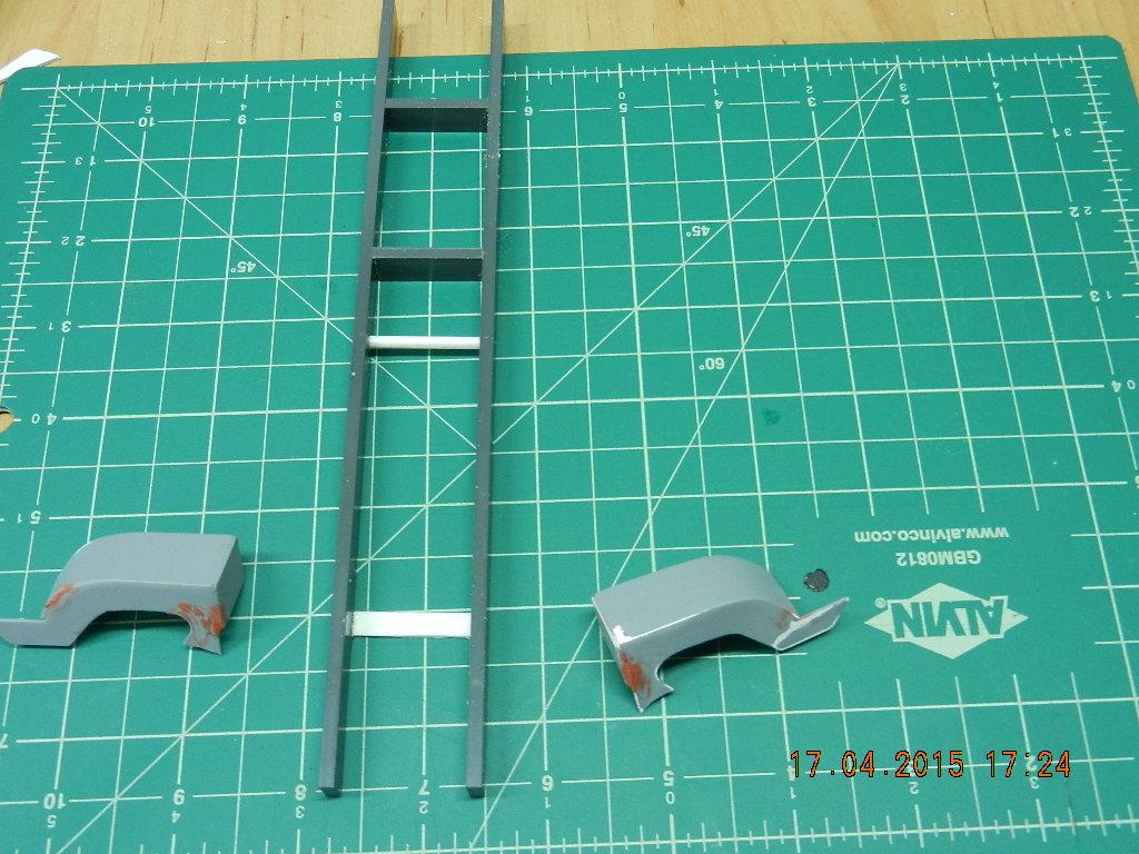

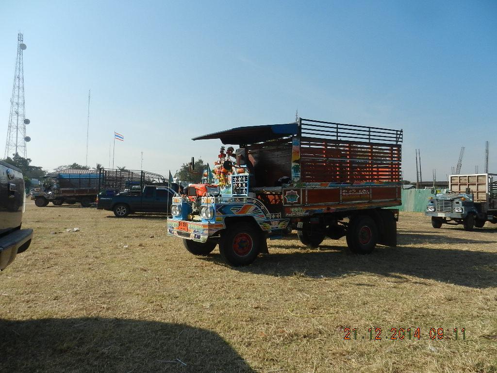

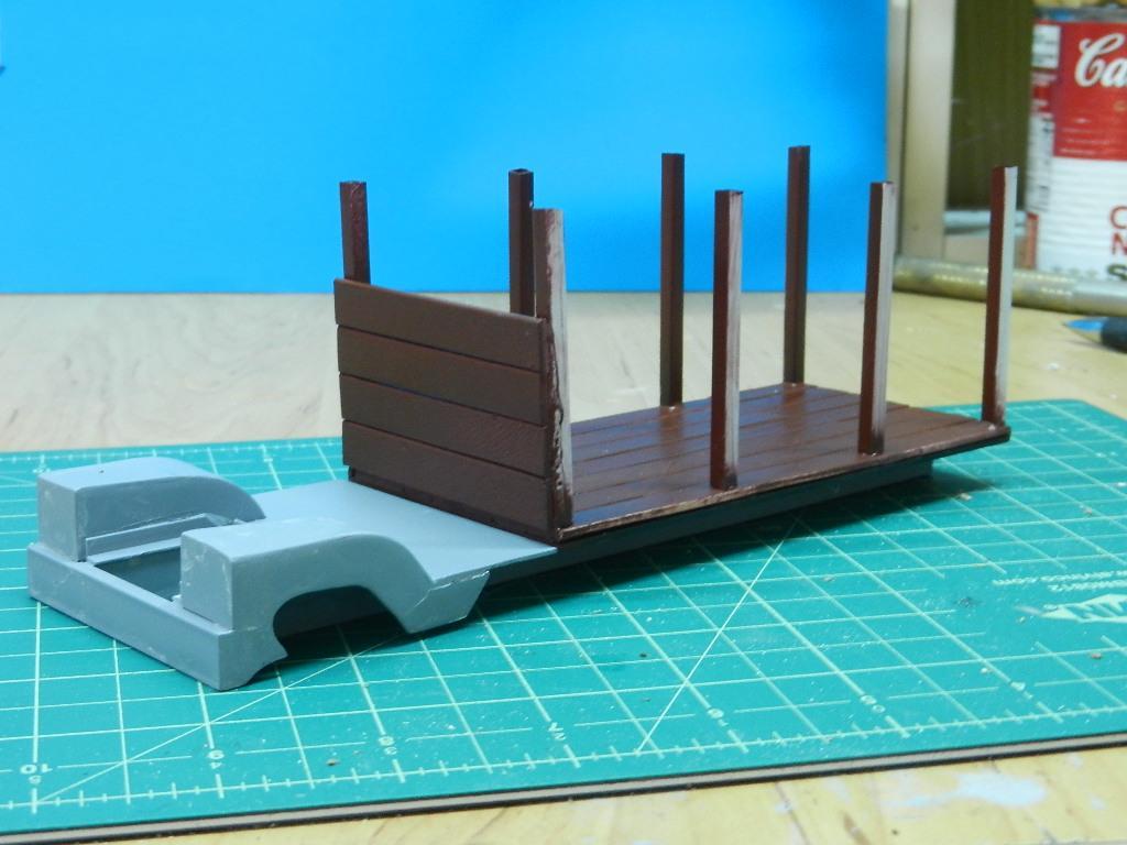

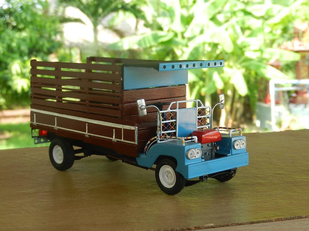

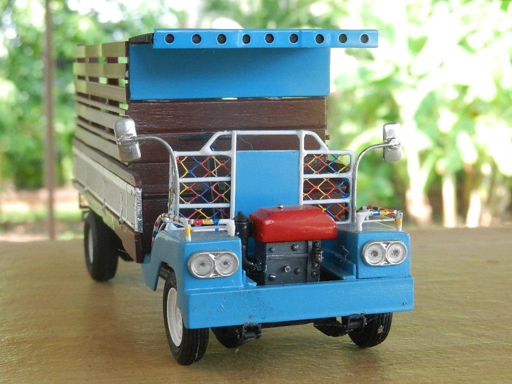

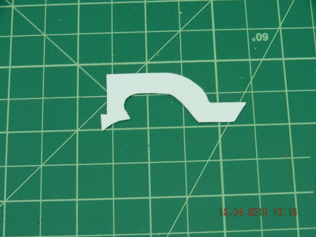

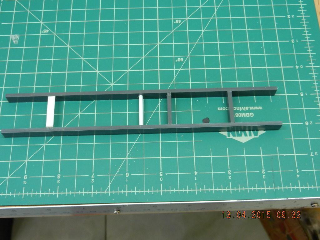

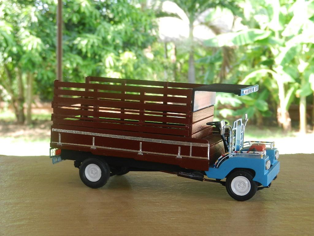

Olderisbetter Posted September 18, 2016 Posted September 18, 2016 This is my biggest scratch project yet. It is a model of what's know as an Esaan Farm Truck here in Thailand where I retired. (I'm American) The engine is a one cylinder diesel with a crank start, producing 12-15 HP depending on the model. They make 1/2T. 3/4T and 1T models. My replica is scratch built except for the rear axle, tires/wheel, steering wheel/shaft, mirrors and headlights. The engine is scratchbuilt also. I used sheet styrene and Popsicle sticks along with balsawood and other materials. .The first pic is of a real truck. I went to a factory that makes these to study them. They are made in small mom & Pop factories with maybe 5-10 employees. They all look basically the same but are not exactly alike. They cost about $3000 brand new.
Olderisbetter Posted September 19, 2016 Posted September 19, 2016 Forgot to mention, the last pic is ad art.

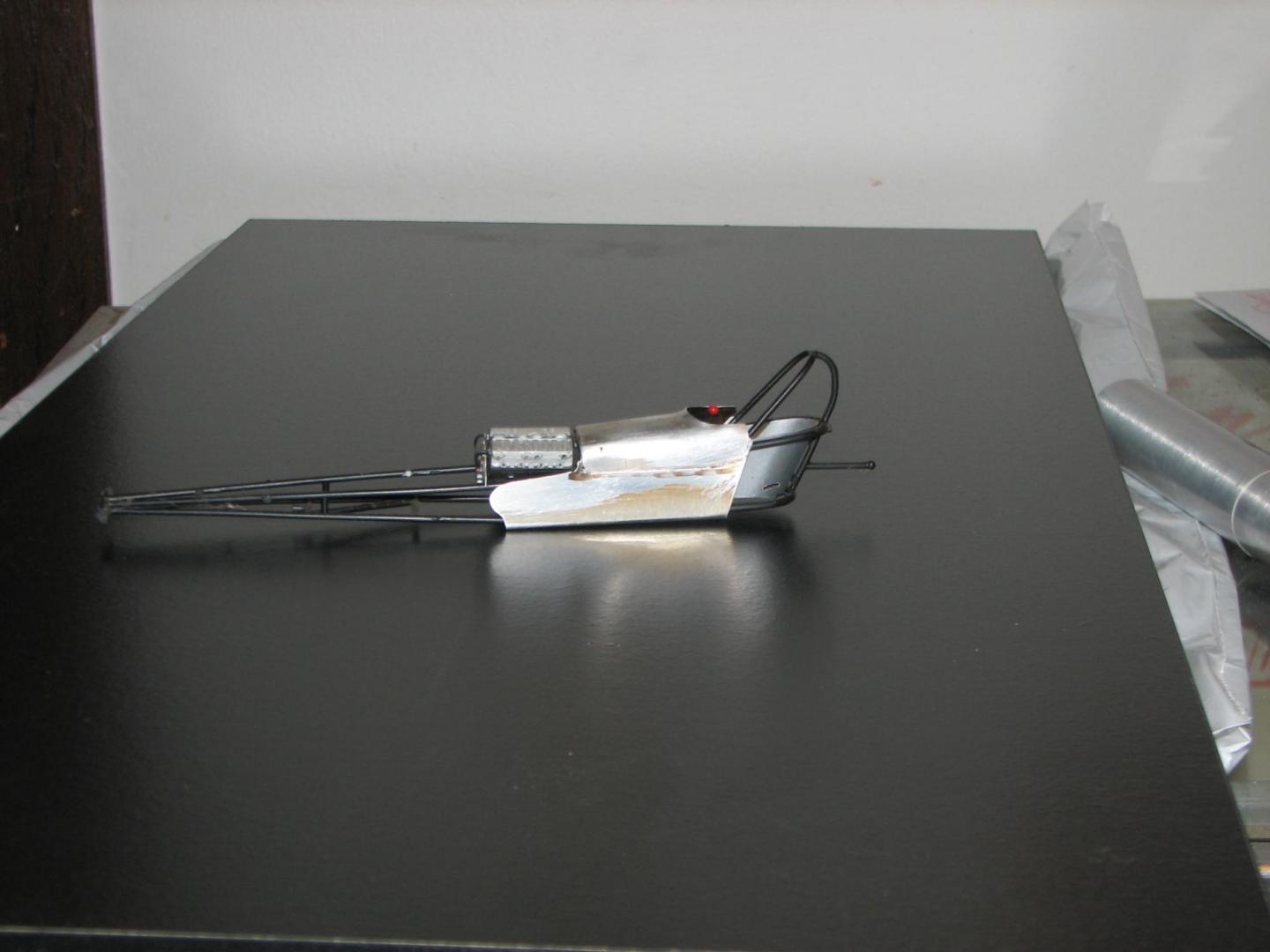

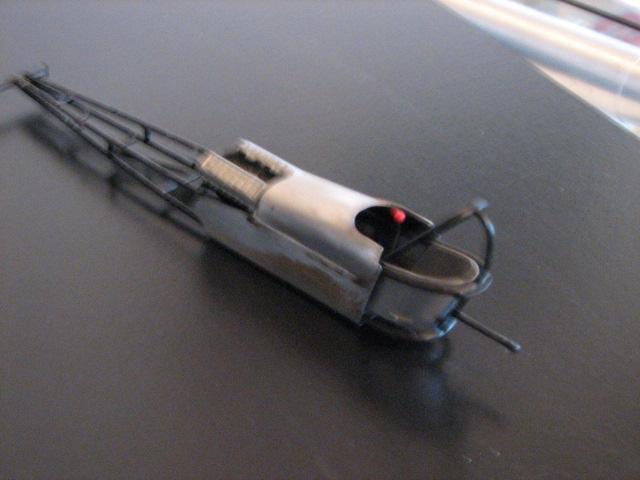

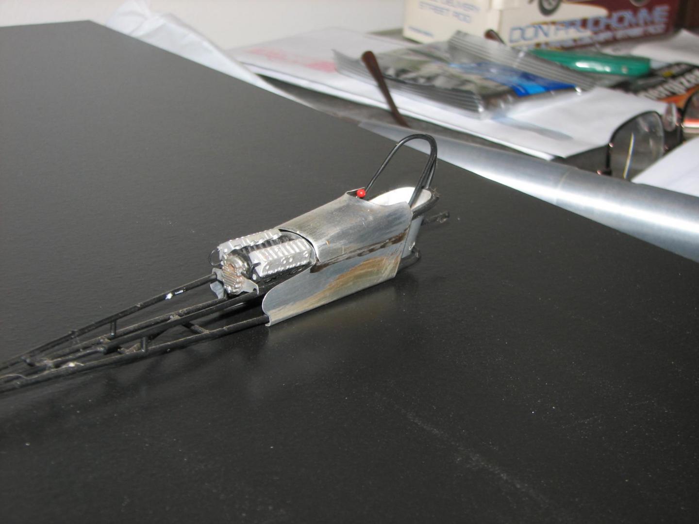

Straightliner59 Posted September 19, 2016 Posted September 19, 2016 (edited) I scratchbuilt the body for this Junior Fueler from .005" aluminum flashing, just like Tom Hanna described it in a way old issue of Hot Rod Magazine. It's a lot of fun to push myself to try new techniques, and gives me a great deal of satisfaction when I (kind of) pull it off! Edited September 19, 2016 by Straightliner59

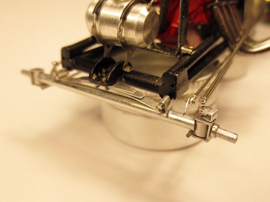

gasser59 Posted October 4, 2016 Posted October 4, 2016 Here's a completely scratch-built steering made from aluminum tubing, aluminum sheet, stainless steel tubing and Scale Hardware nuts and bolts. Its shown here upside down. This went on my 1/125th scale Walt's Puffer Too.
gasser59 Posted October 4, 2016 Posted October 4, 2016 Here it is from the top. Made the leaf springs from aluminum printing plate.
