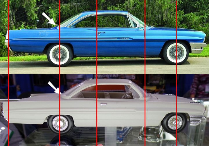

Harry P. Posted October 5, 2014 Posted October 5, 2014 Don't mean to beat a dead horse here, but I thought I'd do a quick visual comparison. I lined up the cars by the wheelbase. A few things immediately jump out to my eye. The rear overhang is way too long, and the photos bear this out. Yes I know, the camera lens can distort, blah, blah, blah... but the camera lens wouldn't put extra length between the center of the rear wheel and the end of the fender panel: Another thing that to me at least is very obvious is the point where the bottom of the rear glass meets the body (white arrows). On the real car this happens behind the center of the rear wheel, on the model it happens in front of the center of the rear wheel. That shorter roof on the model makes the rear end look even longer... and it's already too long to begin with. The rear of the doors line up exactly, but the front of the door is too far forward. Small things? Being nit-picky? Don't think so. The fact is, even small things can make a model look odd. You may not know exactly why the model seems off to you just by looking at it alone, but comparing it to the real thing like this makes the differences obvious.
Bob Ellis Posted October 5, 2014 Posted October 5, 2014 I can't tell for sure, but it appears the camera is lying a bit. One shot is taken far away and the other taken at a foot or less making one more skewed from the other. The model could be correct, yet by optical illusion, looks incorrect. I can't believe the model is off 8 scale inches, when a lot of work was done measuring it.
unclescott58 Posted October 5, 2014 Posted October 5, 2014 The angle of the real car and model car are not photographed exactly the same, Harry. I think we're being a little quick on making judgements on the body using this photograph. Scott
jbwelda Posted October 5, 2014 Posted October 5, 2014 there is no way any angle is going to make that rear window appear to terminate after the centerline of the rear wheel instead of before it as it appears to in that comparison. I would think all this would be valuable input to check out really closely at this stage instead of after it has been committed to production. jb
lysleder Posted October 5, 2014 Posted October 5, 2014 (edited) there is no way any angle is going to Sure is! (respectfully) I can find reason to believe that the test shot body is longitudinally correct in the area of the bottom edge of the rear window. On the other hand, since the pictures are out and Moebius is listening, - Is the sheetmetal coming up to the rear window doing so at the right angle, and the right curvature? That is, the panel between the trunk and rear window seem to my eye to have a somewhat gentler "sweep" on the 1:1 car than the plastic body. Then again, it is hard for me to tell for sure, but maybe Dave can confirm wether or not something is off there. Edited October 5, 2014 by lysleder
Vince Nemanic Posted October 5, 2014 Posted October 5, 2014 Boy, that body really IS messed up! If you look at the test shot in Harry's composite, it is clear that the passenger's side is too long and the driver's side is way too short. The driver's rear is way ahead of the of the blue car's and the driver's front is behind that of the blue car. Perhaps the blue car was shot with a normal lens and the model was shot with a wide angle. This would mean that Mr. Metzger is correct and that we should top griping. Based on past kits, I'm guessing that the body is fine and that we should have some faith in Dave and Moebius. He has said that he will try to get the wheels and the kick up fixed- to me, this shows good faith that is worthy of our respect.

Danno Posted October 5, 2014 Posted October 5, 2014 Not only all of that, but the test shot is gray! It's clear from the comparison pictures that the 1:1 is blue! Moebius can't even get the color right! Sheeesh! Boy, that body really IS messed up! If you look at the test shot in Harry's composite, it is clear that the passenger's side is too long and the driver's side is way too short. The driver's rear is way ahead of the of the blue car's and the driver's front is behind that of the blue car. Perhaps the blue car was shot with a normal lens and the model was shot with a wide angle. This would mean that Mr. Metzger is correct and that we should top griping. Based on past kits, I'm guessing that the body is fine and that we should have some faith in Dave and Moebius. He has said that he will try to get the wheels and the kick up fixed- to me, this shows good faith that is worthy of our respect. I'm with Vince.

unclescott58 Posted October 5, 2014 Posted October 5, 2014 I'm with Danno and Vince on this one. By the way, cameras can and do lie. That's part of the reason why there are professional photographers. It's their job to get the truth, or enhance the lies. Again, I think some are being way to quick in judging this model on this photograph. And Dave seems to agree with the problems in the belt line and wheels, and is looking into it. Since he reads these posts I'm sure he's going to take a closer look at the model to make sure it's right before we get our hands on it. Look at the Moebius kits they given us so far. They're great. I'm sure this one will be too. Scott
MrObsessive Posted October 5, 2014 Posted October 5, 2014 Scott, I agree with you to a point...........the comparison that Harry made has some validity. That the rear end is that waaay off to my eyes is bothersome. I had pointed it out before most noticed it, and I didn't mean for it to turn into a big kerfuffle. I had also noticed that the aperture of the rear window wasn't quite up to snuff either, but withheld saying anything. Maybe that's a fault of mine-------my Mom always said that I was "too observant" as a kid, and things like this jump out at me particularly when cars like this were virtually everywhere once upon a time. But! As you said, let's wait and see what the final product is once the kit comes out. And yes, Moebius's models have been top notch as of late, and it's a proven fact that they DO listen.
tim boyd Posted October 5, 2014 Posted October 5, 2014 Don't mean to beat a dead horse here, but I thought I'd do a quick visual comparison. I lined up the cars by the wheelbase. A few things immediately jump out to my eye. The rear overhang is way too long, and the photos bear this out. Yes I know, the camera lens can distort, blah, blah, blah... but the camera lens wouldn't put extra length between the center of the rear wheel and the end of the fender panel: Another thing that to me at least is very obvious is the point where the bottom of the rear glass meets the body (white arrows). On the real car this happens behind the center of the rear wheel, on the model it happens in front of the center of the rear wheel. That shorter roof on the model makes the rear end look even longer... and it's already too long to begin with. The rear of the doors line up exactly, but the front of the door is too far forward. Small things? Being nit-picky? Don't think so. The fact is, even small things can make a model look odd. You may not know exactly why the model seems off to you just by looking at it alone, but comparing it to the real thing like this makes the differences obvious. Harry...I'm nowhere the expert on graphics and photography that you are, and interesting comparison. But it's a bit apples and oranges as the lense configurations appear to be entirely different. Note the distance between the rear fender closest to the camera and farthest from the camera in each picture. See how in the 1:1 scale pix, that visual distance between the rear edge of the near and far fender is less than half what it is in the Moebius test shot photo? My observation is that this camera lense configuration is lending itself to the visual observation that the Moebius quarters are too long. Not to say your observations are entirely wrong, though. The only way to do a fully correct comparison is to use the same Camera, same lense, same photography angle, and same distance away from the object (relative to scale) to photograph both the 1.1 and 1/25th scale cars. Preferably with the model also painted, foiled and assembled. Looks like we'll have to wait until we get a sample in hand to do that. I think we also need to give a heavy weight to Dave's observations that the overall length and wb of the model are correct, as he's the only one who has the actual model in hand. Best regards...TIM
Harry P. Posted October 5, 2014 Posted October 5, 2014 I realize that the two photos are not a direct, exact comparison; they were shot with different lenses, etc., etc. I get that. I took plenty of photography classes in school. But there's no way I'm going to be convinced that the rear overhang on the model is correct. I can see that it's too long without any reference photo to compare it to. It just doesn't look "right." There are two possibilities: either the model is correct or it's not. If it is correct, then all is well, and I'm wrong. If it's not correct, then NOW is the time for Moebius to recheck and make sure it's right. And that's why Dave is posting about this kit. because Moebius cares, and they do make an effort to "get it right." Seing as that's the case, no time like now to discuss possible issues. We've already established that the wheels are wrong. Maybe we've also caught some body proportion issues before the kit hits the shelves. And isn't that a good thing?
Harry P. Posted October 5, 2014 Posted October 5, 2014 Here's another side-by-side with a different shot of the real car. As you can see, I have again lined up the cars by wheelbase. Note that the wheel openings match almost perfectly, and they are shaped correctly, so no problem there. Front overhang looks right on target. But again, you can see that the rear end of the model looks quite a bit too long, and I see that same discrepancy where the lower edge of the rear glass meets the body. That happens behind the center of the rear wheel on the real car, but ahead of the center of the rear wheel on the model. Not trying to be a jerk here,,, just trying to present visual evidence to back up some of the opinions that have been posted.
