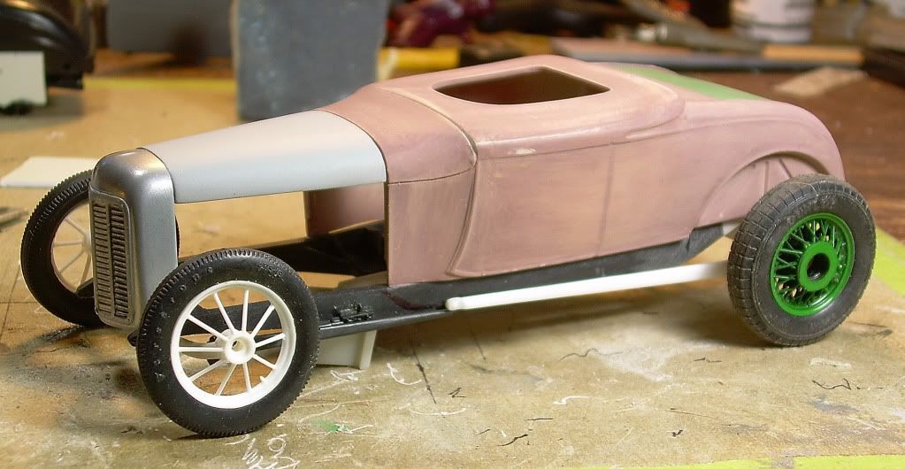

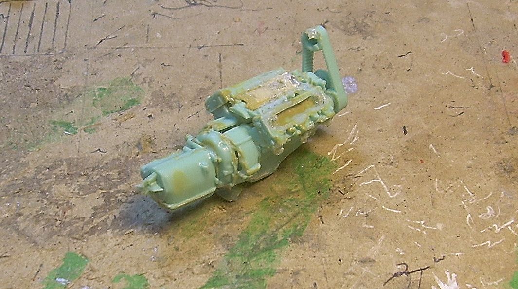

Ace-Garageguy Posted December 26, 2014 Author Posted December 26, 2014 that looks like that be a fun build so far moc up looks cool Thank you, sir. So far, it's the most fun I've had in a long time, and it's moving along pretty quickly. I've zeed the frame at this point (prior to stripping the paint) and have been able to remove the body shell from the fenders with minimal damage. Some fitting let me determine about where the rear axle height will have to be relative to the body shell... ...and allowed me to tack the nose in place to match the first mockup. I'll be adapting a LaSalle gearbox to the Ardun, using an adapter salvaged from this glue-coated mess from a SWC Willys kit. This is the mocked-up Ardun / LaSalle combo that I'll need to get the engine bay sized correctly.

Ace-Garageguy Posted December 26, 2014 Author Posted December 26, 2014 The mocked-up Ardun and the semi-fitted center pan allowed me to fit the engine in the chassis, and make sure Lefty could actually drive the thing. Lefty keeps my hot-rod and race-car builds honest. He's an old 1/24 figure, so he would be a pretty big guy in 1/25. If he can fit in the car, most regular humans could. With that much figured out, I can see how much of a chunk of the louvered sections I'll need to do the forward pans. Though I have a straight axle in the mockup, I'll be using a dropped tube unit from a Revell '32 Ford. Dropped tube axles were in use on track cars of the period, though not yet commonly seen on street rods. 4-links were also in use on more advanced track cars (I had thought I'd seen a 4-link front setup on track car in a 1957 movie, and my research turned up photos as far back as '47) but again, they weren't common on the street (until Pete and Jake's). Some careful measuring gave me the amount of drop I'd need on the suicide-style front-axle mount (above the top of the frame rails). The zeed frame, stripped, some of the klugely crossmember stuff removed, and new rough-cut outside rails to reinforce old breaks, the zee, and just to clean it up some...
Ace-Garageguy Posted December 26, 2014 Author Posted December 26, 2014 Fitting the Ardun also let me verify that the nose (from a 1/24 Monogram Indy Kurtis) would be just the right width to allow the sides of the hood to cover the heads without blisters. The hood will be continued from the nose section all the way to the rear of the original cowl. It's mocked up here with strip styrene, and will be glassed, filled and used as a plug for a final mold of the part. The lower front louvered section of the bellypan is also almost completely fitted here (as to length), and the frame sides have been trimmed, matched, had more cleanup done. New tubular crossmembers have been fitted, nice and square, to replace the originals. 1
