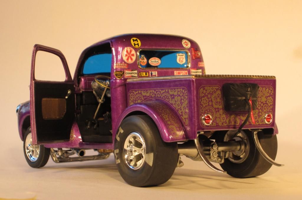

I bought this a while ago, but I've only just got around to building it.
I liked the look of the lace decals, even though the lace is a tad out-of-scale. Gold and purple always go well together, so I used purple candy over a silver base.
The horrible kit wheels were replaced with some from a Polar Lights funny car.

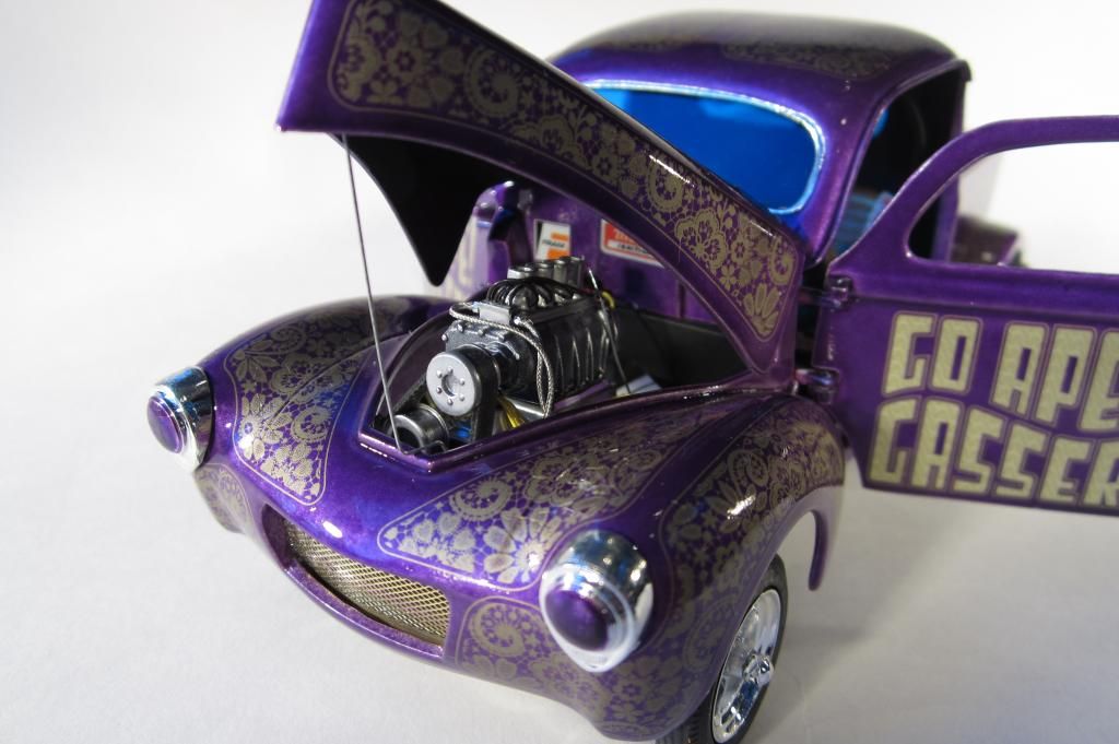

Now, I've heard it said that this kit has one of the worst Ford SOHC engines in 1/25, so I decided to pep it up a bit.
I added resin pulley wheels, intake, oil filter and gear linkage.
I also added a Mallory ignition module and rear disc brakes.
The engine had no magneto, so I made one that looks kinda like a Vertex.
A Detail Master 5-point harness and a fire extinguisher were added to the interior.
I had to lift the pickup bed a bit to stop the rear arches rubbing the tyres.
A note to anyone who plans to build this kit...The front axle is set too far back. The rear edges of the tyres would foul on the bodywork.
I know some guys re-position the leaf springs, but I'd already painted the chassis and installed the axle before I realized my error.
Luckily, I'd only fixed the front axle on with CA glue, so it came apart easily and I was able to fit it in a better position with epoxy.
The kit decals were dead tricky. They seemed to stick fast, on contact with the paint.
I managed to get them all on, but it was a sweaty hour.

It was a bit fiddly at times and I wonder if I should've used the other front axle in the kit.
It had working steering and wasn't dropped like the chrome one I used. It would've given a more nosebleed stance.
The door hinges took some adjustment and wire pins, to get them working properly.
Yes Dave, the decals on the front fenders were quite difficult. Once they made contact with the paint, they didn't want to move.
I had to lift them off with a fine wet paintbrush and try again. And again.
It was a tense moment, but they lay down fairly well with a bit of Microsol.
