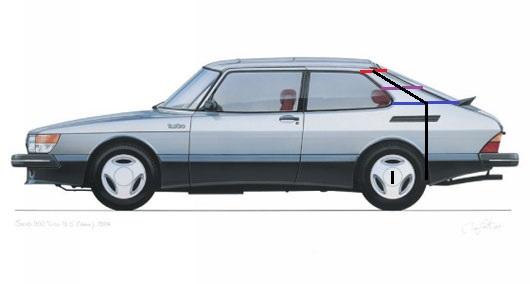

Bills72sj Posted December 25, 2019 Share Posted December 25, 2019 I would take LESS out from in front of the rear wheels. The visual centerline of the C-pillar should intersect with the center of the wheel. Have you ever noticed SAABs from the 80's look weird? That is why. Quote Link to comment Share on other sites More sharing options...
DonW Posted December 30, 2019 Share Posted December 30, 2019 (edited) 'I would take LESS out from in front of the rear wheels. The visual centerline of the C-pillar should intersect with the center of the wheel. Have you ever noticed SAABs from the 80's look weird? That is why.' I don't understand what you mean, Bill. A drawing would help! To me it looks fine. Edited December 30, 2019 by DonW more info. Quote Link to comment Share on other sites More sharing options...

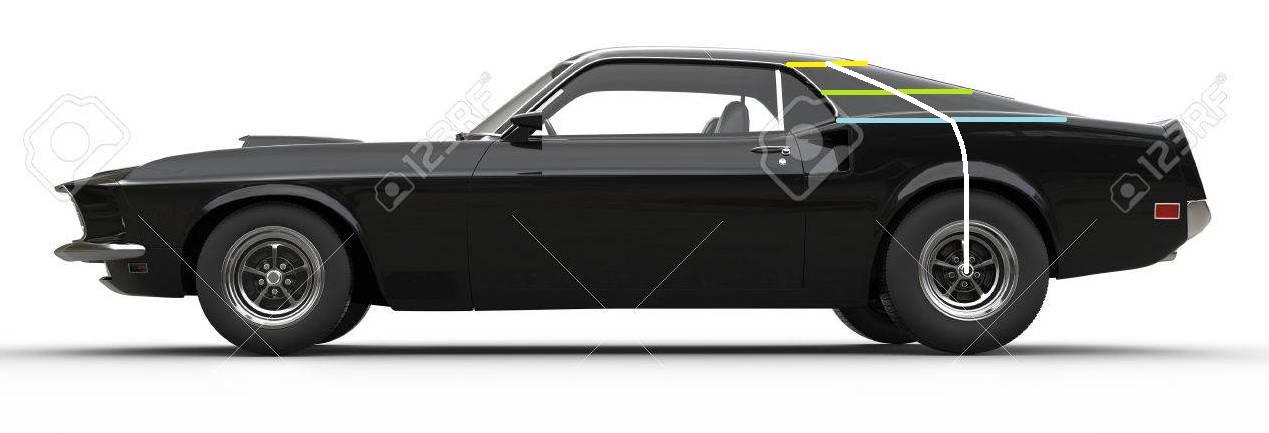

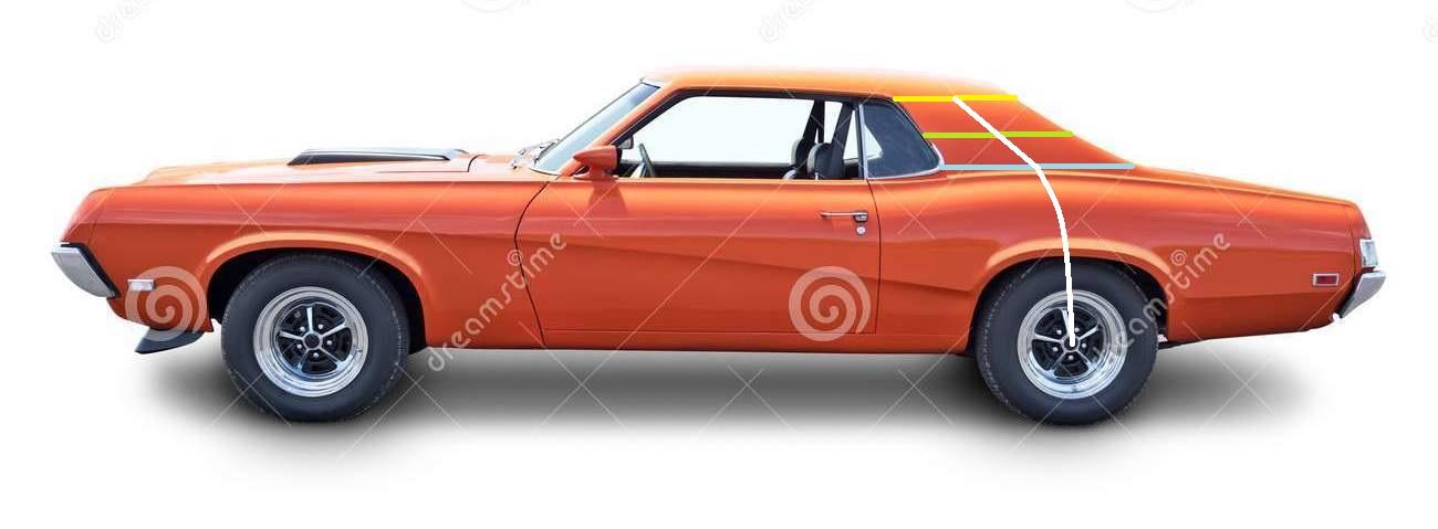

Bills72sj Posted December 31, 2019 Share Posted December 31, 2019 Notice centerline of C-pillars hits the top of the quarterpanel at or forward of the centerline of the rear axle. The Saab C-pillar centerline hits the top of the panel way behind the axle centerline. When you shorten the wheelbase on your galaxie, be cognizant of this relationship. Quote Link to comment Share on other sites More sharing options...
Ace-Garageguy Posted December 31, 2019 Share Posted December 31, 2019 12 hours ago, Bills72sj said: Notice centerline of C-pillars hits the top of the quarterpanel at or forward of the centerline of the rear axle. The Saab C-pillar centerline hits the top of the panel way behind the axle centerline. When you shorten the wheelbase on your galaxie, be cognizant of this relationship. Be cognizant of the fact that if the C-pillar on the very well proportioned restyling exercise presented here was as wide horizontally as those referenced, the visual center of mass would be where the leading edge of it is in the exercise...precisely where you want it to be. Also be cognizant of the fact that the intersection of the lower rear line of the sail panel and the horizontal element of the quarter panel on all your examples of "correct" is directly over the rear edge of the tire...precisely where it is on the exercise. Further, be cognizant of the fact that the proportions of the Saab and the exercise bear no resemblance to each other whatsoever. Quote Link to comment Share on other sites More sharing options...

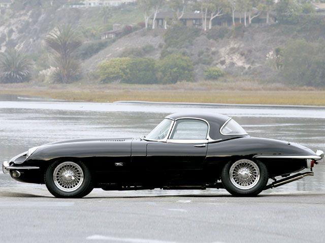

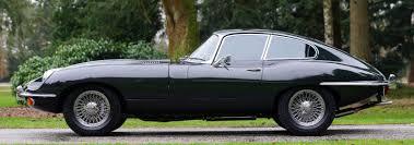

DonW Posted January 1, 2020 Share Posted January 1, 2020 Thanks both for the clarifications. To my mind the upshot is that the exercise looks good. And clearly Malcolm Sayer and Bill Heynes had it completely wrong, as did Enzo Ferrari when he described their Jaguar E-Type as "the most beautiful car ever made". ? Quote Link to comment Share on other sites More sharing options...
Ace-Garageguy Posted January 1, 2020 Share Posted January 1, 2020 1 hour ago, DonW said: Thanks both for the clarifications. To my mind the upshot is that the exercise looks good. And clearly Malcolm Sayer and Bill Heynes had it completely wrong, as did Enzo Ferrari when he described their Jaguar E-Type as "the most beautiful car ever made". ? I agree with you completely, sir. The Ford exercise looks better than just about any restyle I've ever seen. The lines of the original are nice, but Mike's condensation of what's already good makes a striking improvement. Kinda like cooking a sauce down to intensify the flavor. His restyle shrinks a wallowing boat down to a nicely tossable package, but retains a distinctly American feel. I can envision that body built in composite materials, over Corvette C5 chassis and running gear to give it handling and performance to match its looks...but maybe with vintage Ford 5.0 pushrod or even Coyote power. Quote Link to comment Share on other sites More sharing options...

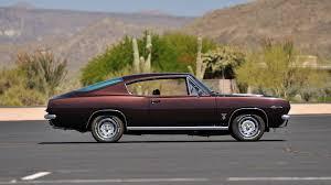

DPNM Posted January 1, 2020 Share Posted January 1, 2020 Just my opinion but I don't think the E-Type shown above is a good comparison to the Galaxie. The Jag, for lack of how to term it, is more of a fastback, similar to the Mustang listed above. As a "fixed head (or drop head) coupe" it looks to be in the ball park. The Barracudas are another example. Quote Link to comment Share on other sites More sharing options...
