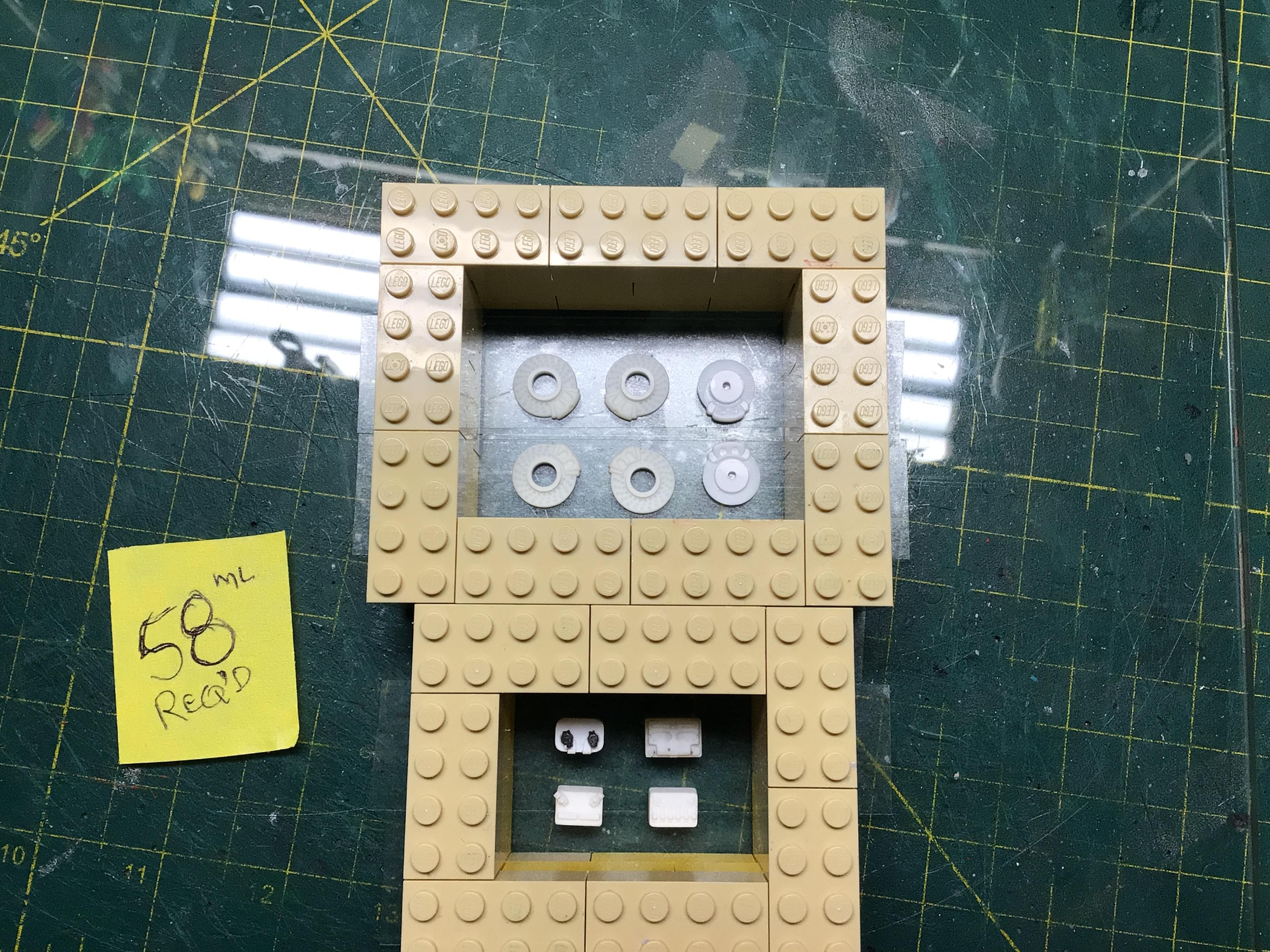

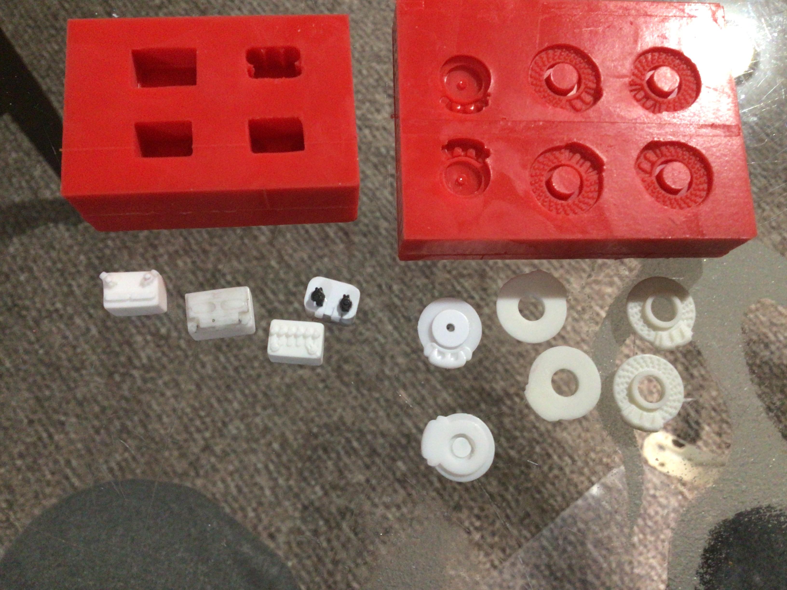

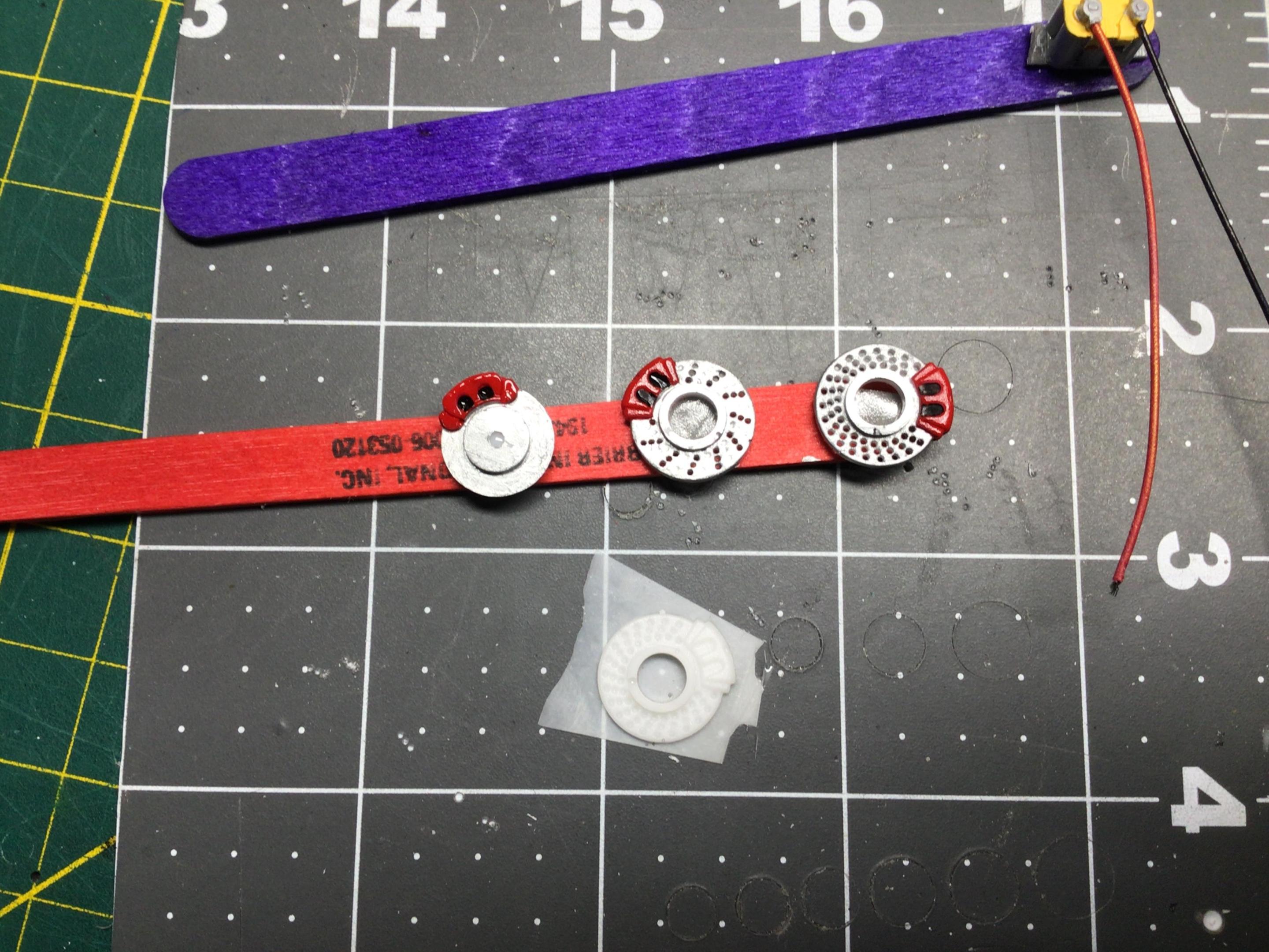

NOBLNG Posted February 2 Share Posted February 2 It has been a day of starts and stops for me. Starts because I made a mold of three different batteries that I sanded the tapered sides vertical. One of them I added larger terminals and I also scratch built an Optima. Stops because I made a mold of two different sizes of disc brake rotors and calipers. Now to make some casts!🙂 4 Quote Link to comment Share on other sites More sharing options...

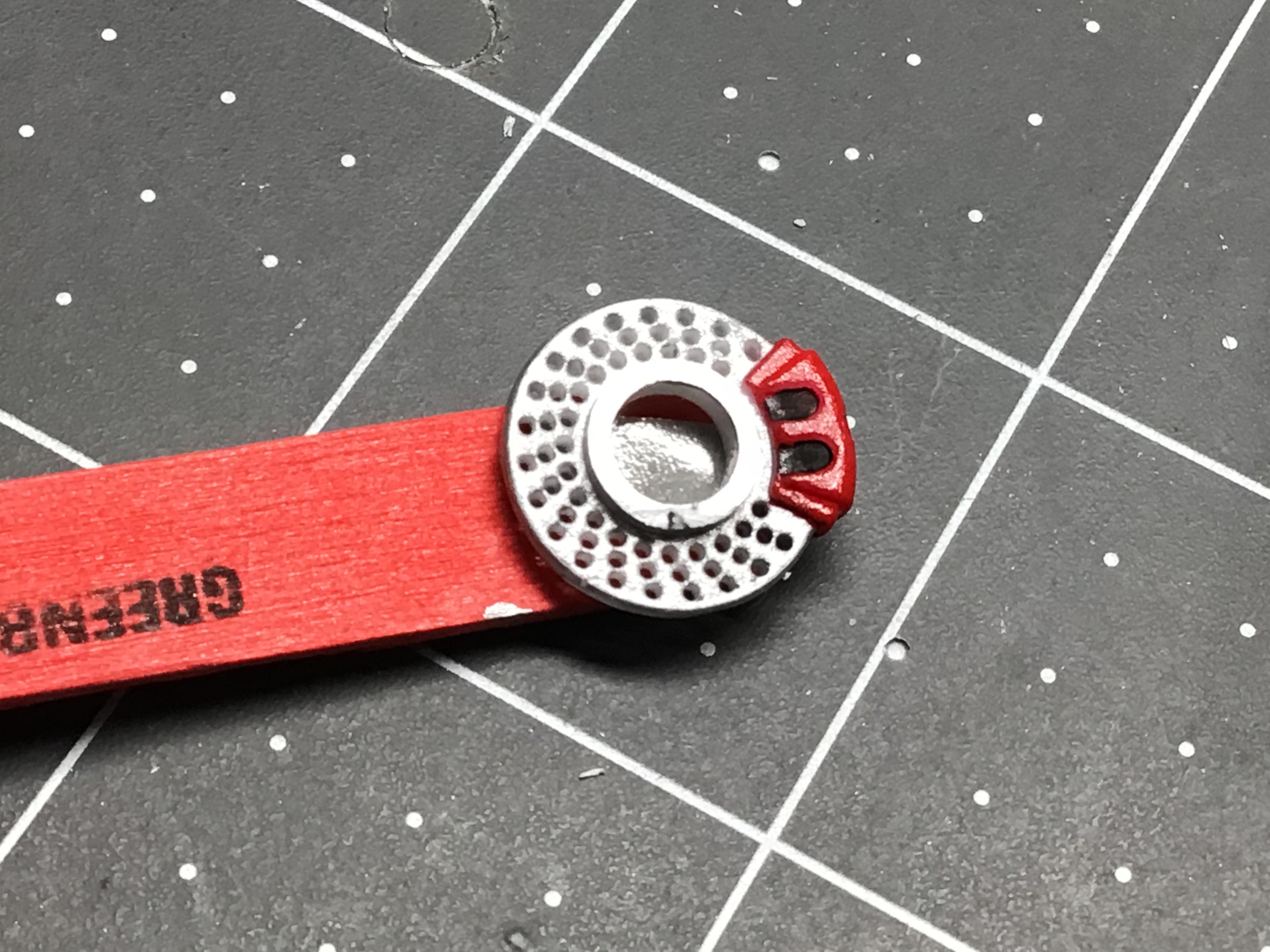

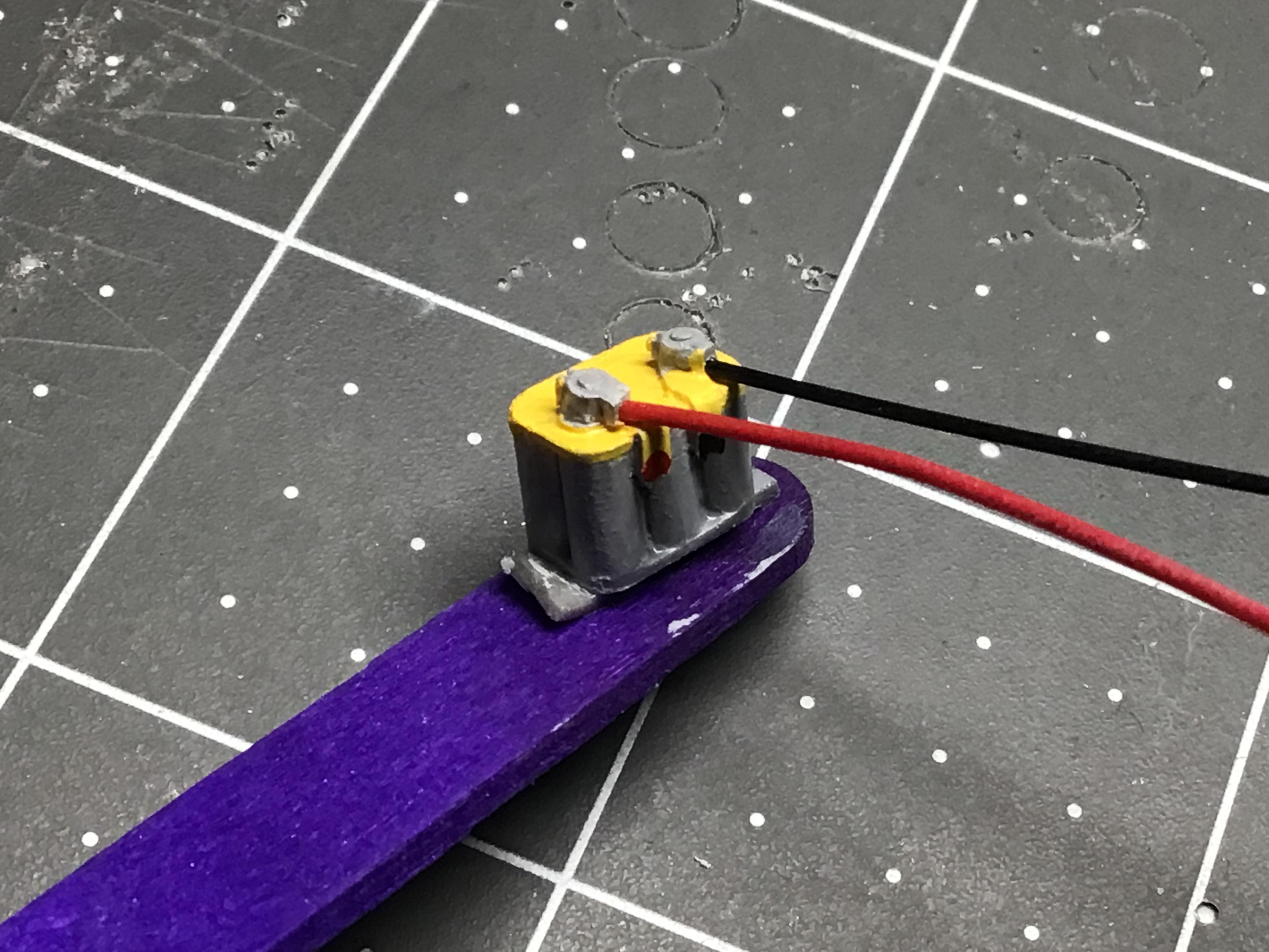

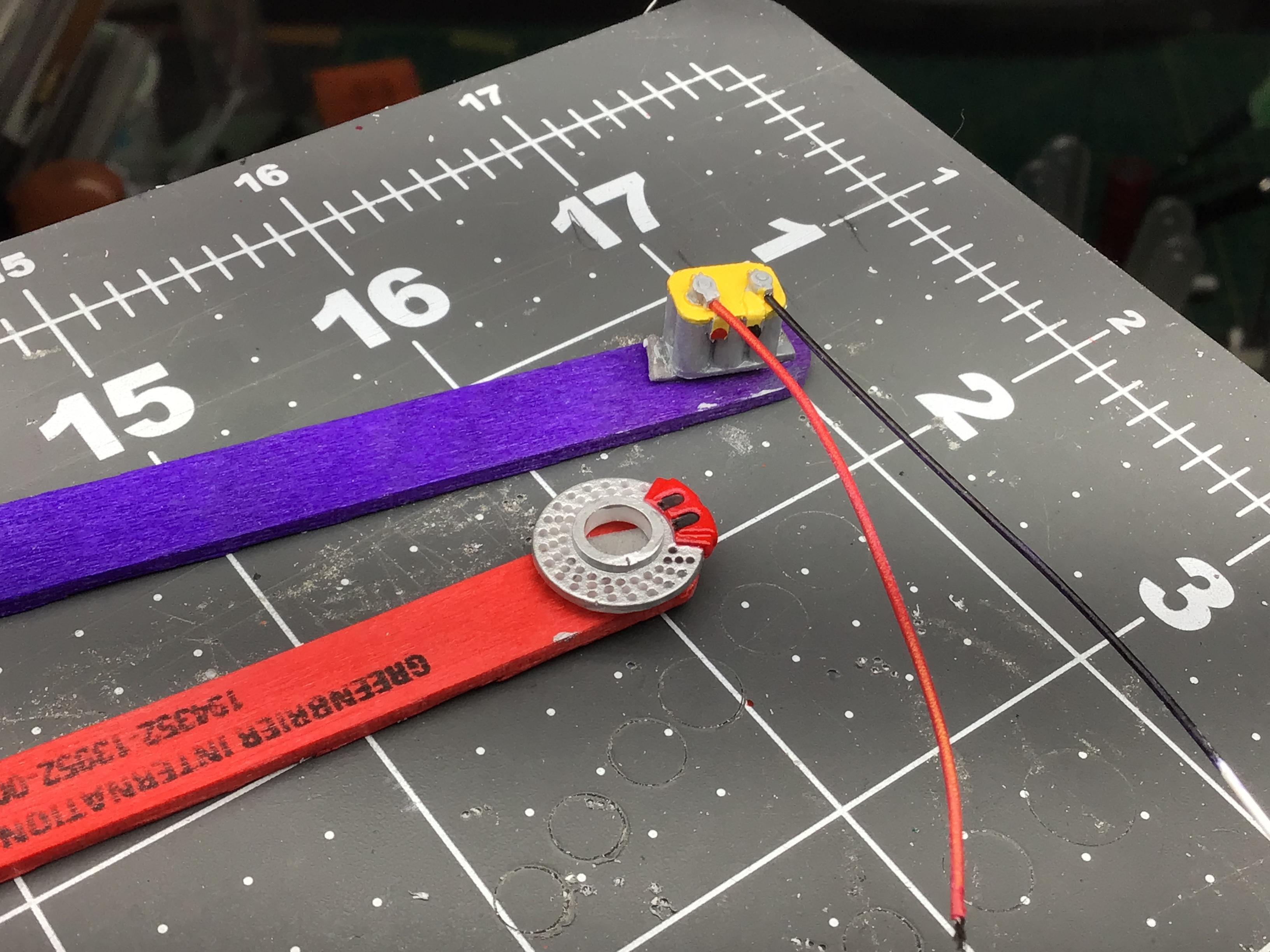

NOBLNG Posted February 3 Share Posted February 3 (edited) A few minutes work drilling out the rotors, a bit of paint, and they look better than my aluminum washers and styrene bits. The battery is a tad rough at a real closeup, but the terminals are large enough to be drilled for a .033” cable. I think they look better with every second set of holes drilled.🤔 Edited February 3 by NOBLNG 2 Quote Link to comment Share on other sites More sharing options...

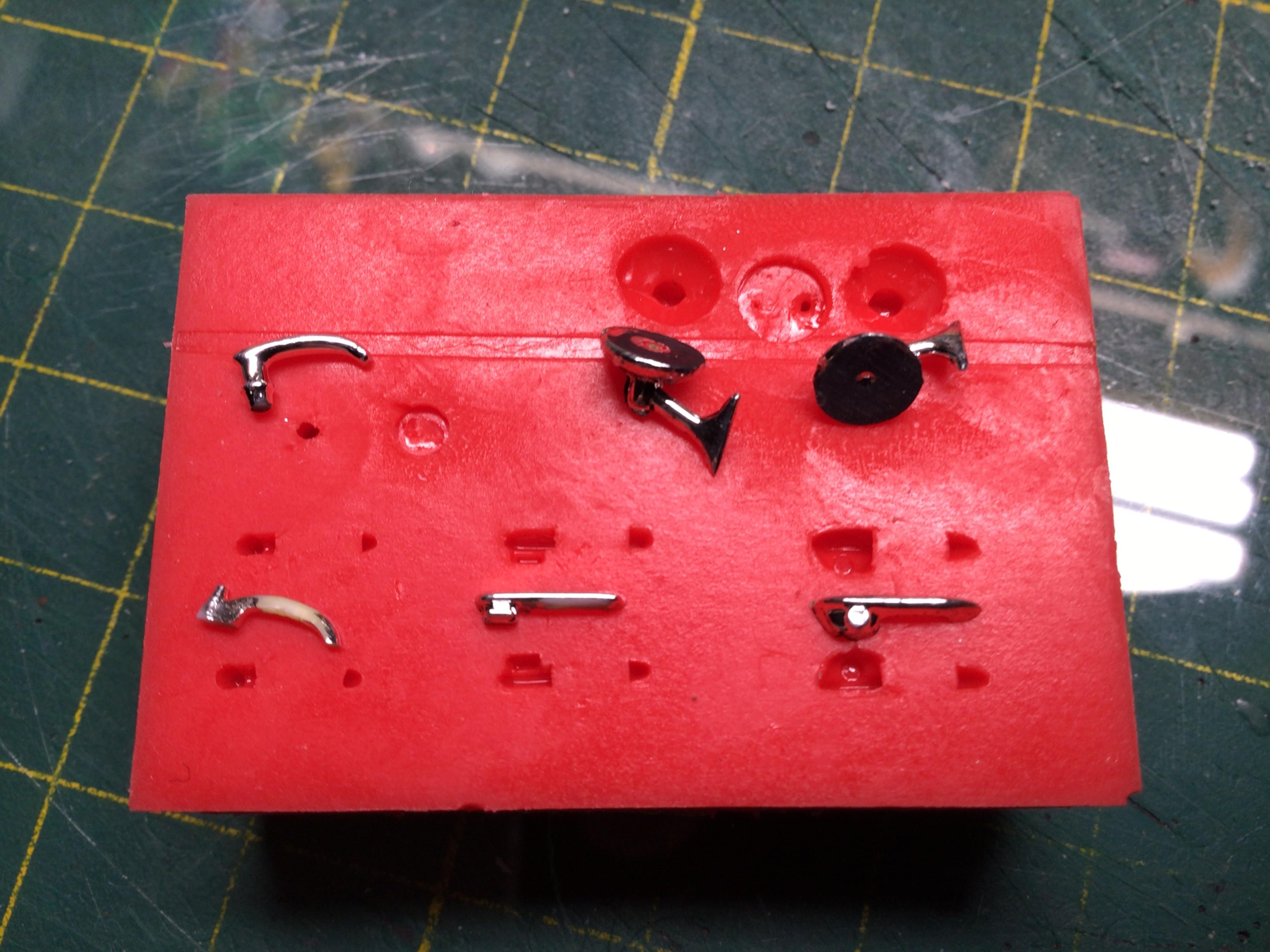

NOBLNG Posted February 4 Share Posted February 4 I made another mold today of some different door handles and a couple side mirrors. 2 Quote Link to comment Share on other sites More sharing options...

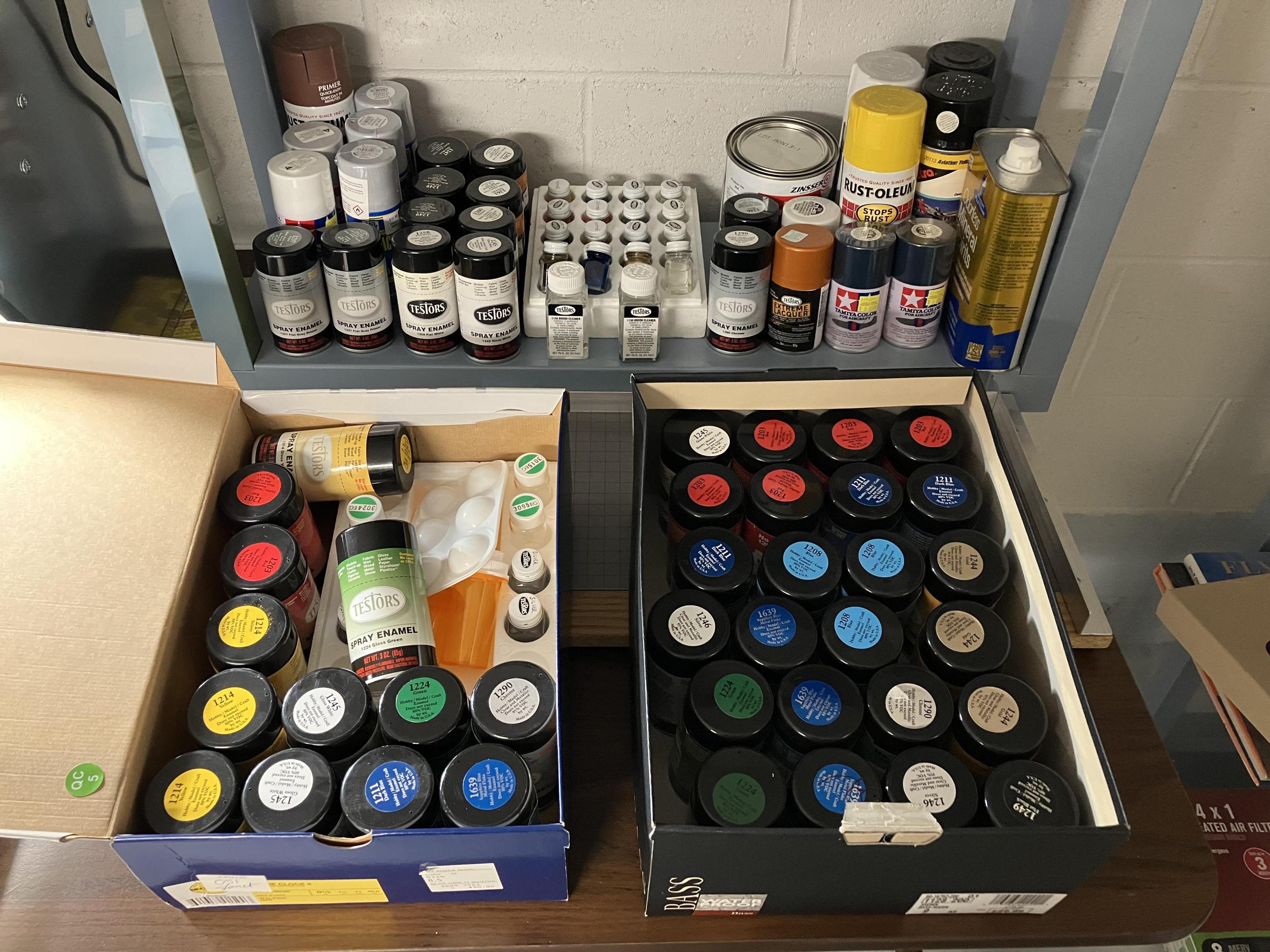

Joe Nunes Posted February 5 Share Posted February 5 Yesterday evening I thought I would go through some storage boxes to see what I could find by way of model paint. Was surprised at the quantity of various types of Testors spray paint in plenty of colors along with some cans of primer. Also came across a number of small Testors paint jars in various colors and plenty of Testors thinner. I like an enamel finish on a model so with the paint find and my dehydrator I will see how it goes. I am also going to look for a single coffee cup/warming plate combination item to use in the shop as a dedicated spray can warmer; can put water in the cup, turn the unit on and keep the spray can warm between coats of paint. At least that’s the plan for now…😄 Quote Link to comment Share on other sites More sharing options...
Modlbldr Posted February 5 Share Posted February 5 5 hours ago, Joe Nunes said: Yesterday evening I thought I would go through some storage boxes to see what I could find by way of model paint. Was surprised at the quantity of various types of Testors spray paint in plenty of colors along with some cans of primer. Also came across a number of small Testors paint jars in various colors and plenty of Testors thinner. I like an enamel finish on a model so with the paint find and my dehydrator I will see how it goes. I am also going to look for a single coffee cup/warming plate combination item to use in the shop as a dedicated spray can warmer; can put water in the cup, turn the unit on and keep the spray can warm between coats of paint. At least that’s the plan for now…😄 Nice paint selection! Sounds like a good idea with the paint warmer. I use my cup warmwr to put a dish of water on for applying decals. It keeps the water from getting cold and the decals seperate faster. Later- 1 1 Quote Link to comment Share on other sites More sharing options...

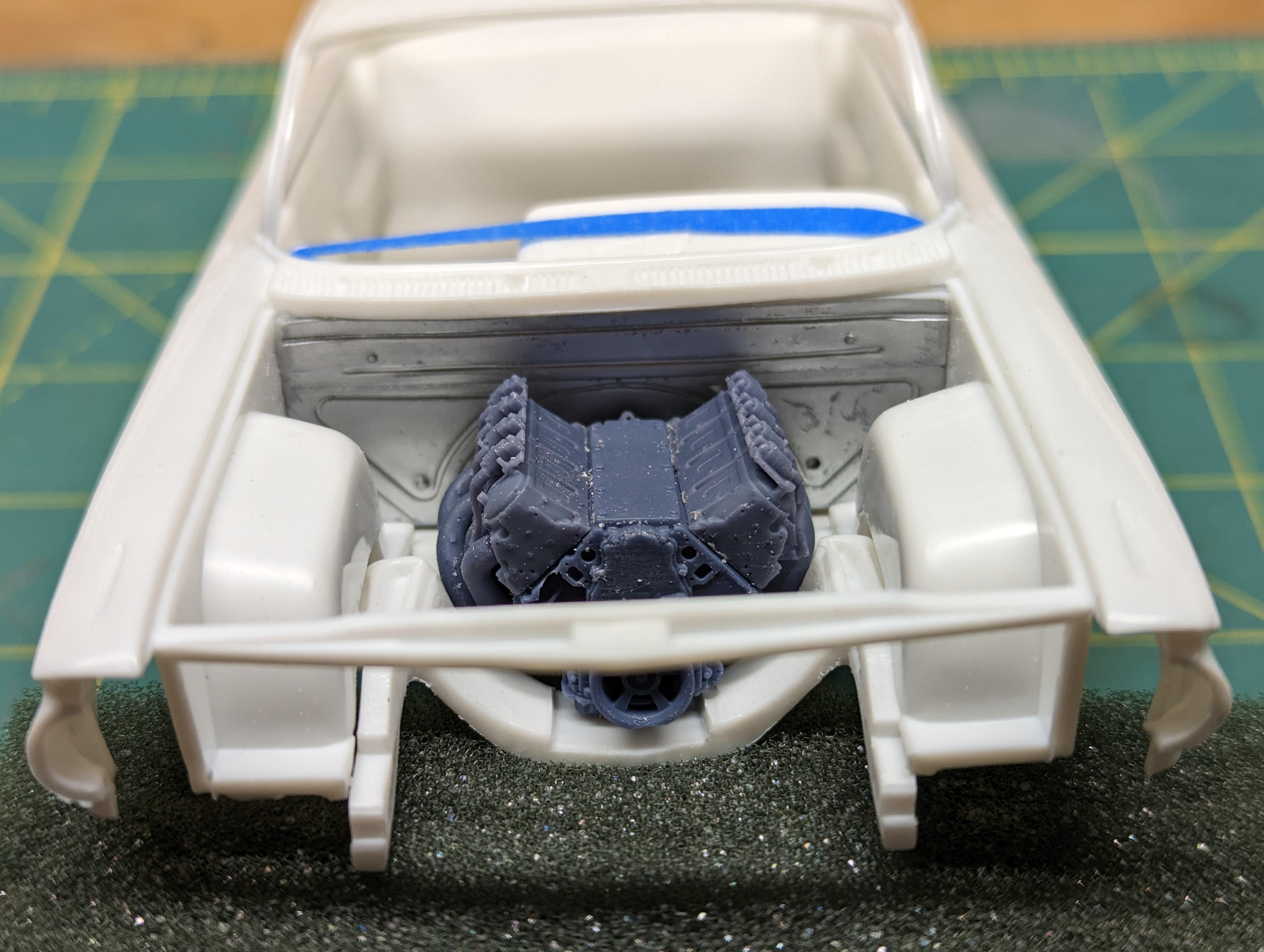

dragstk Posted March 4 Share Posted March 4 Ive started a AMT 61 Chevy Impala long term project (Long for me anyway) Got the firewall fitted today. Its actually out of one of the older Monogram Pro Stock kits Thats a Texas 3D custom engine in front of it 1 Quote Link to comment Share on other sites More sharing options...

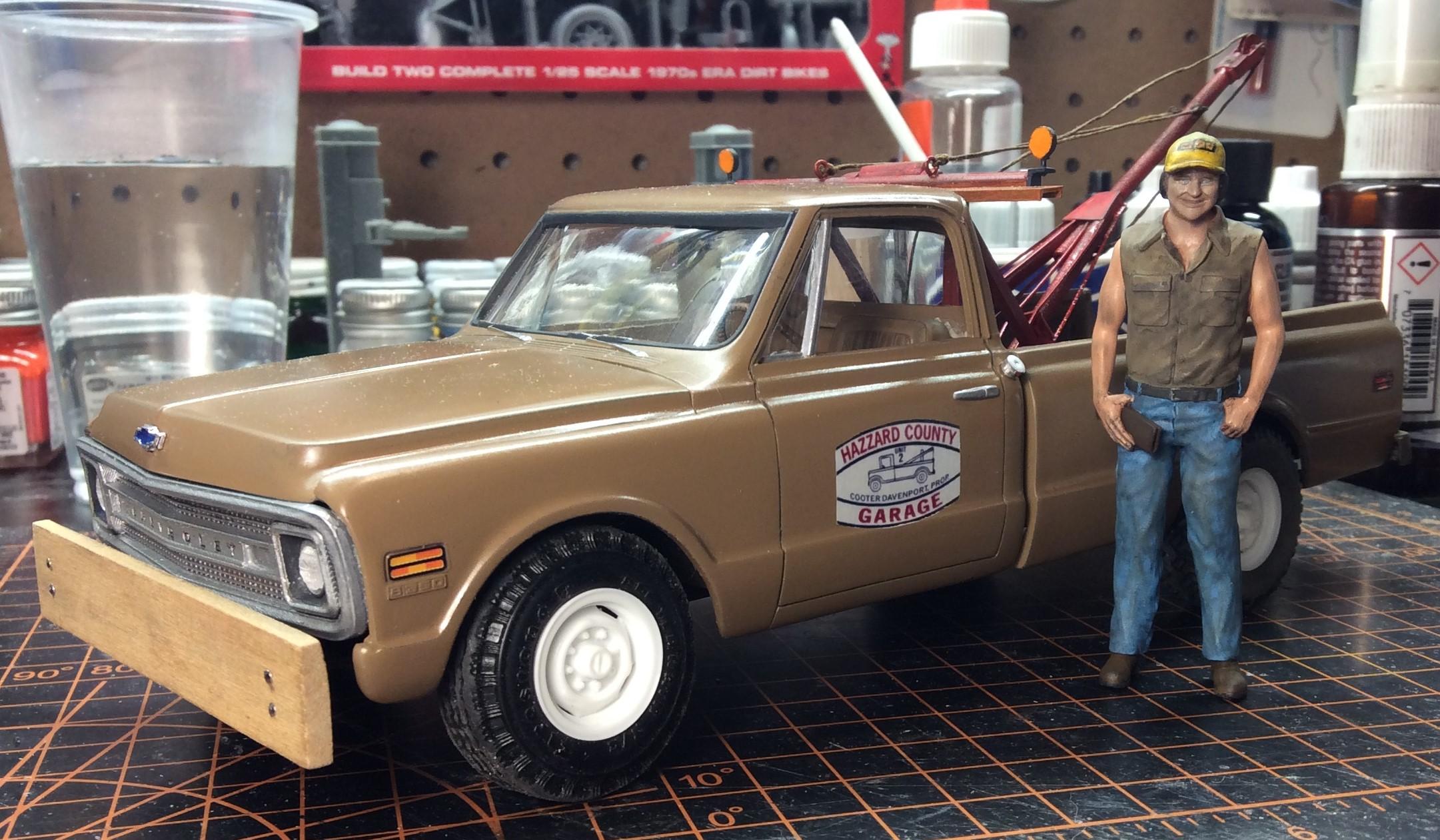

mchook Posted March 15 Share Posted March 15 I'm almost finished with Cooter's wrecker. I painted the figure today. Quote Link to comment Share on other sites More sharing options...

espo Posted March 15 Share Posted March 15 14 hours ago, mchook said: I'm almost finished with Cooter's wrecker. I painted the figure today. The truck model looks great, and I think I just saw Cooter smile. 1 Quote Link to comment Share on other sites More sharing options...
CabDriver Posted March 17 Share Posted March 17 On 3/15/2023 at 10:14 AM, espo said: The truck model looks great, and I think I just saw Cooter smile. Agreed! I love that color (on that truck anyway…) 1 Quote Link to comment Share on other sites More sharing options...

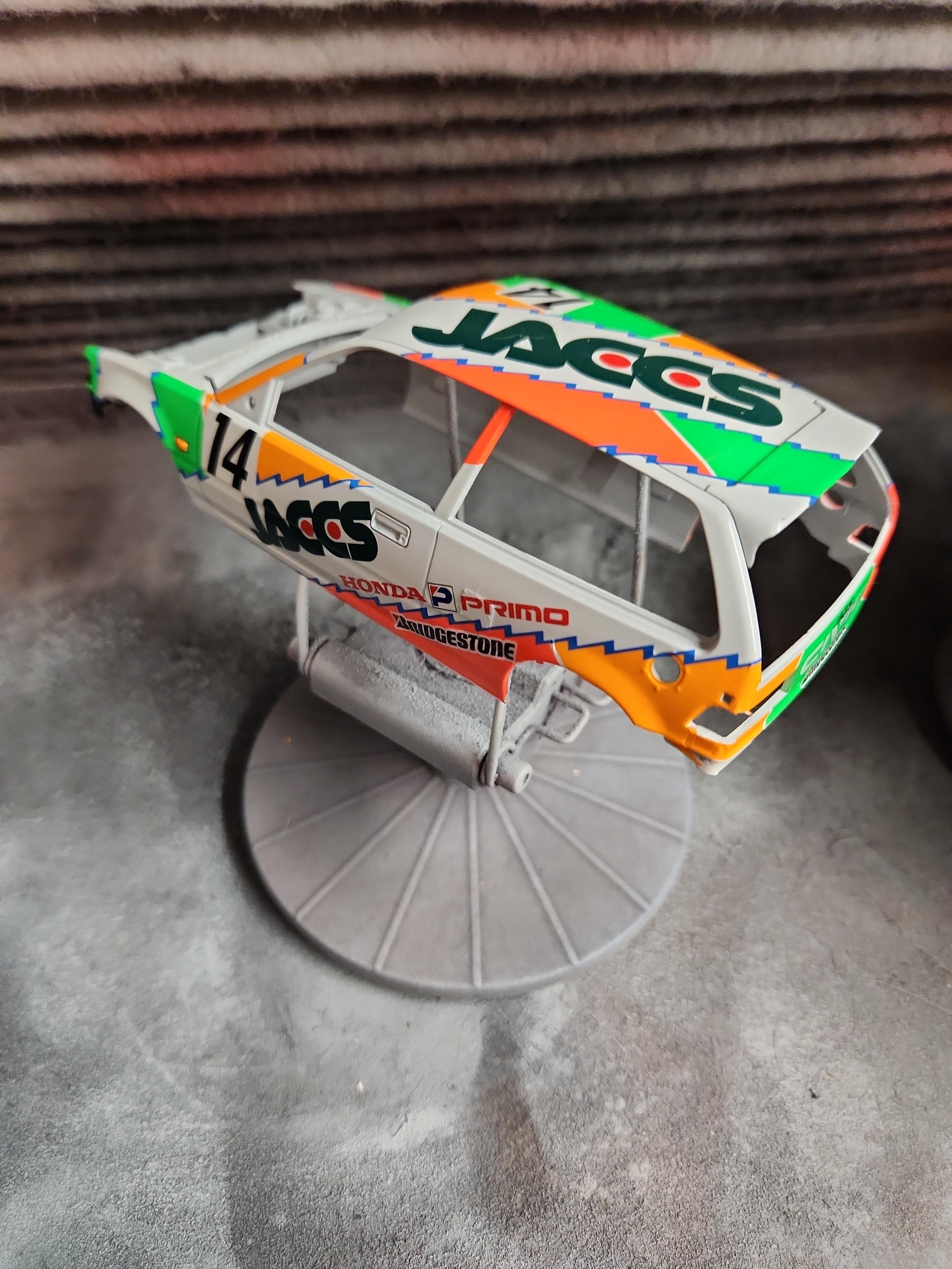

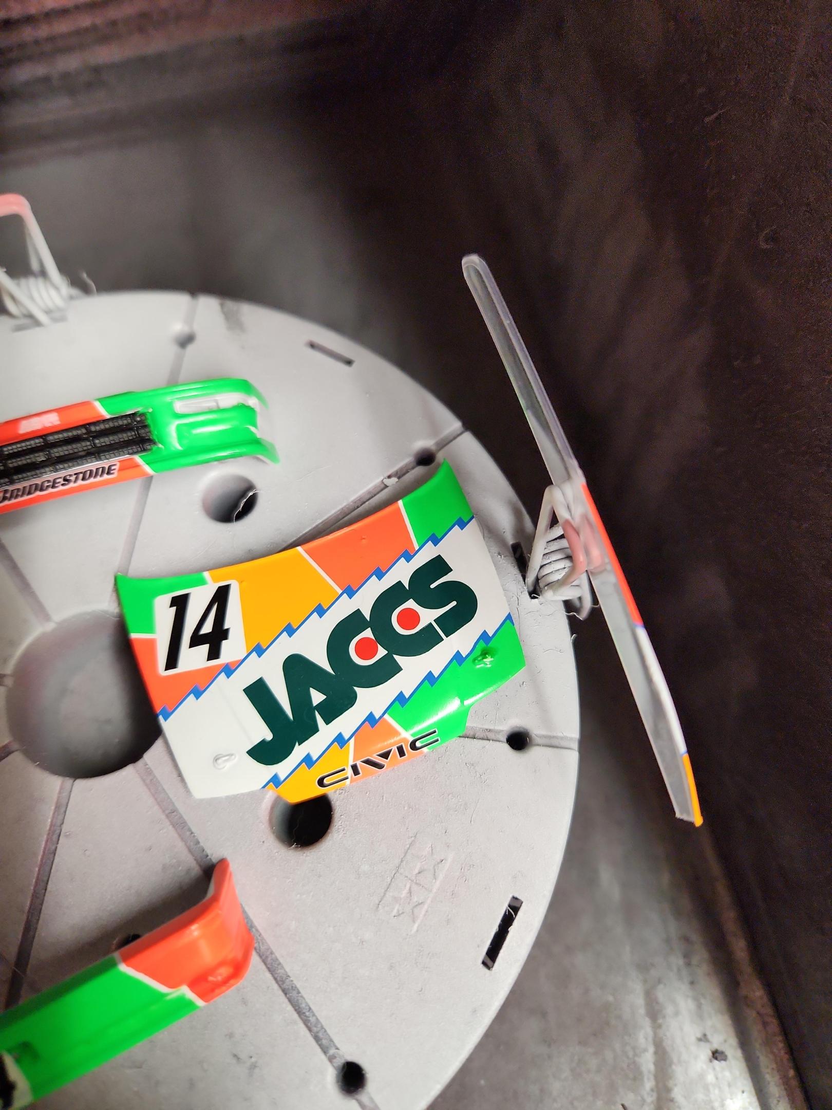

hgbben Posted March 30 Share Posted March 30 Decals, decals, and more decals. This is the most involved decaled kit I've ever attempted. Quote Link to comment Share on other sites More sharing options...
PatW Posted March 31 Share Posted March 31 7 hours ago, hgbben said: Decals, decals, and more decals. This is the most involved decaled kit I've ever attempted. It looks superb! My sort of kit, covered in decals! Quote Link to comment Share on other sites More sharing options...
