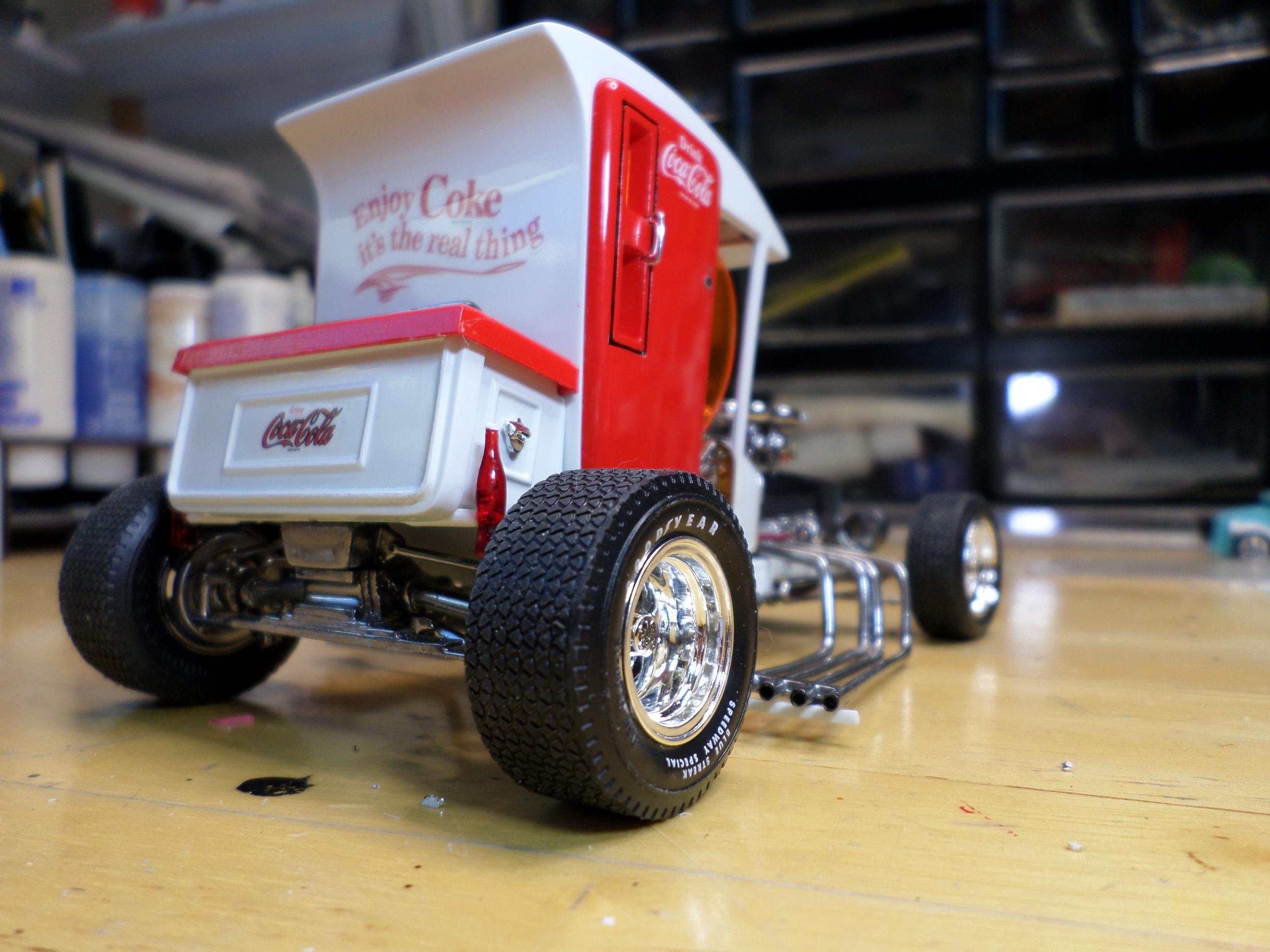

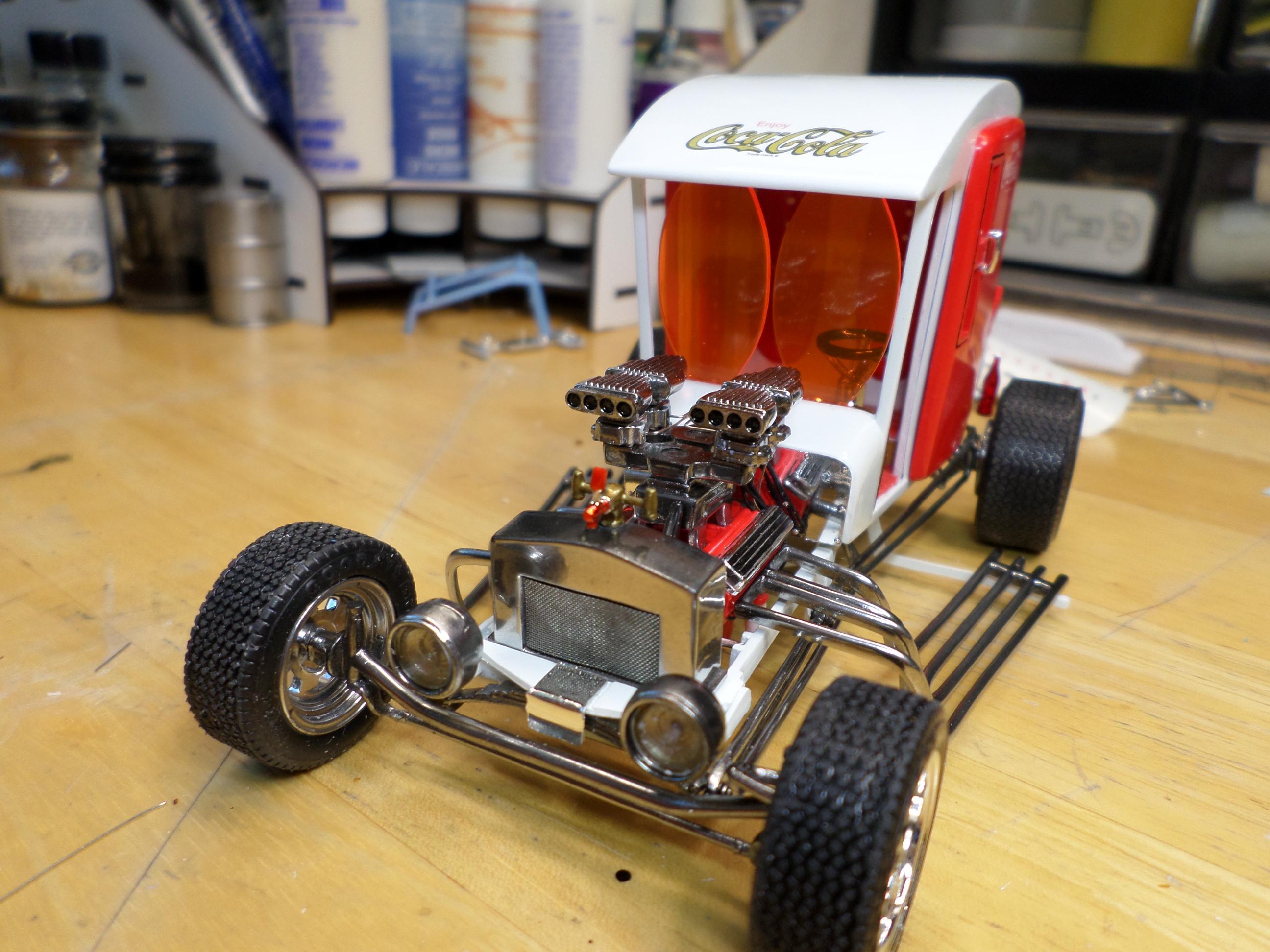

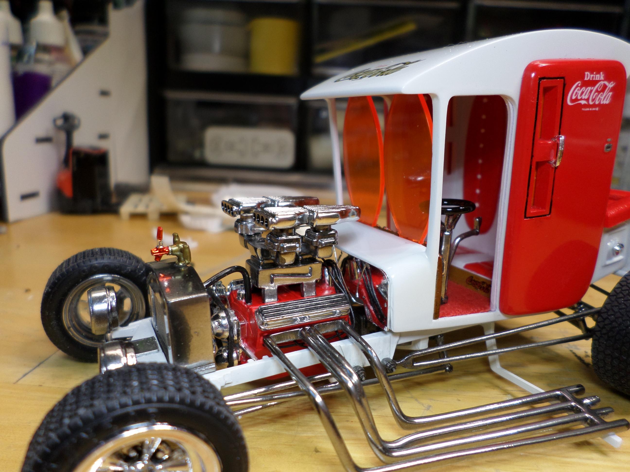

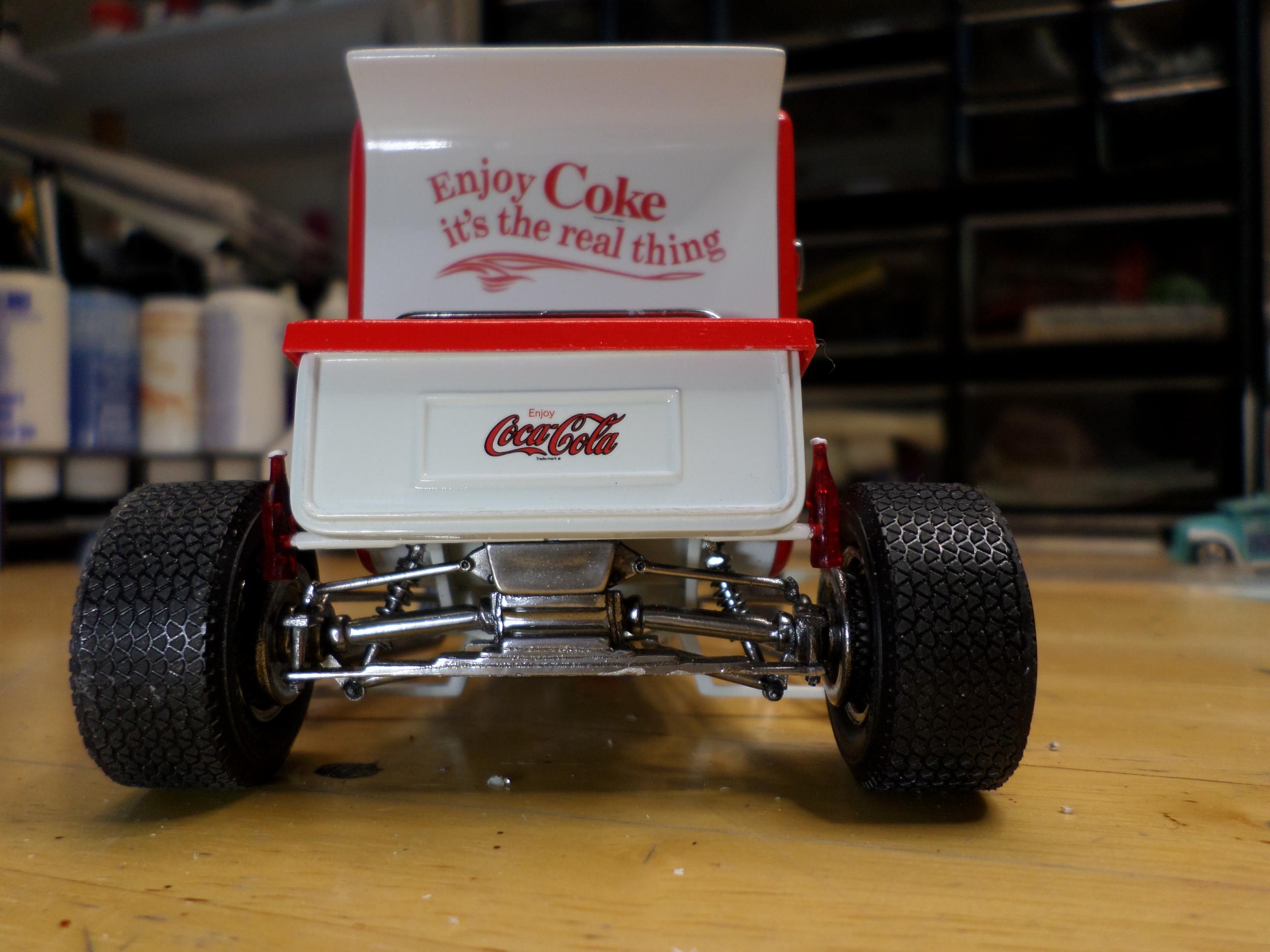

This is a VERY fiddly kit, with rough chrome including some warping, and not all of it turned out like I planned, but overall I am happy with it and I'm going to call this one done!
For those interested in the build process, here is a link to the Fotki page.

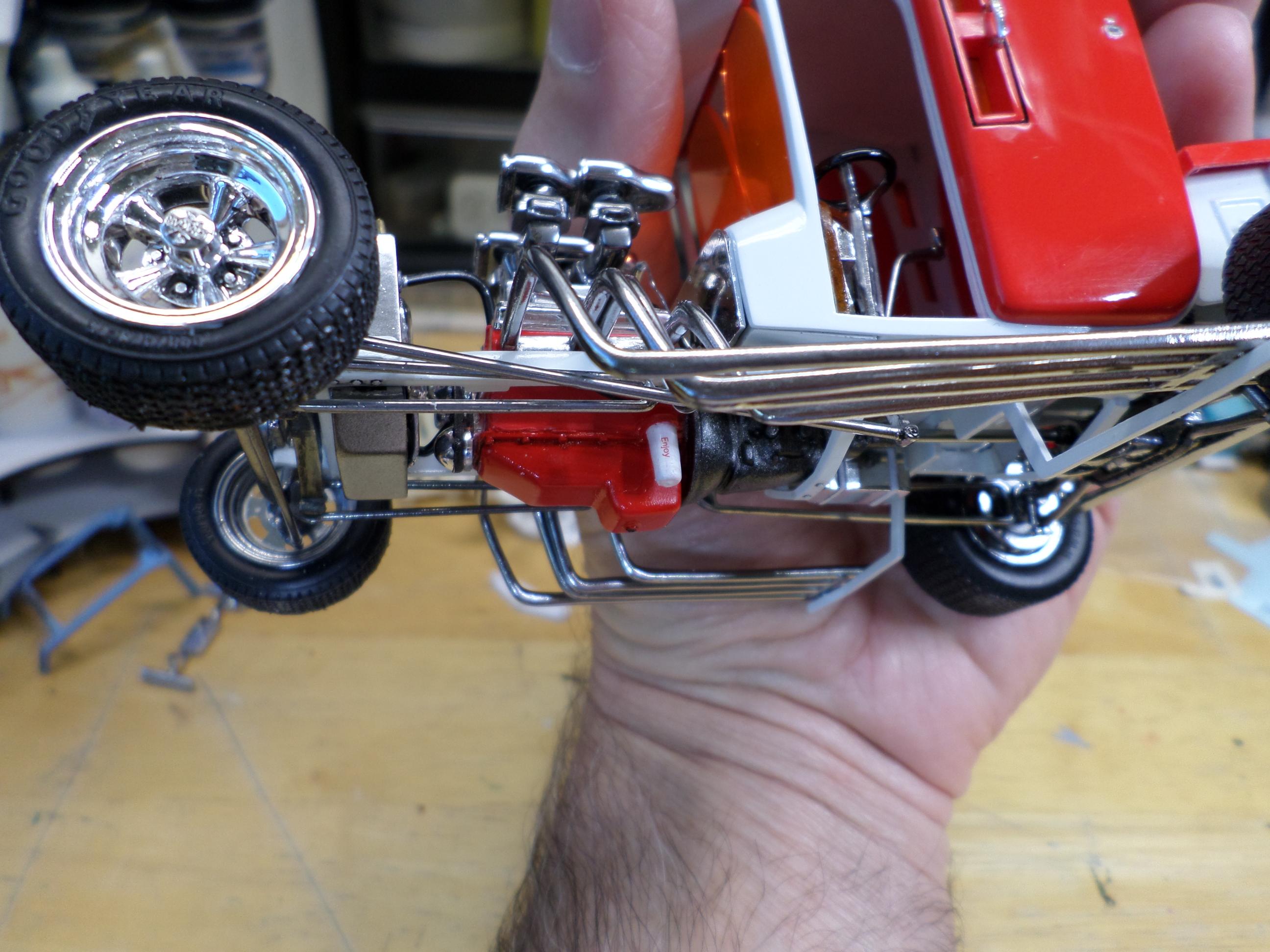

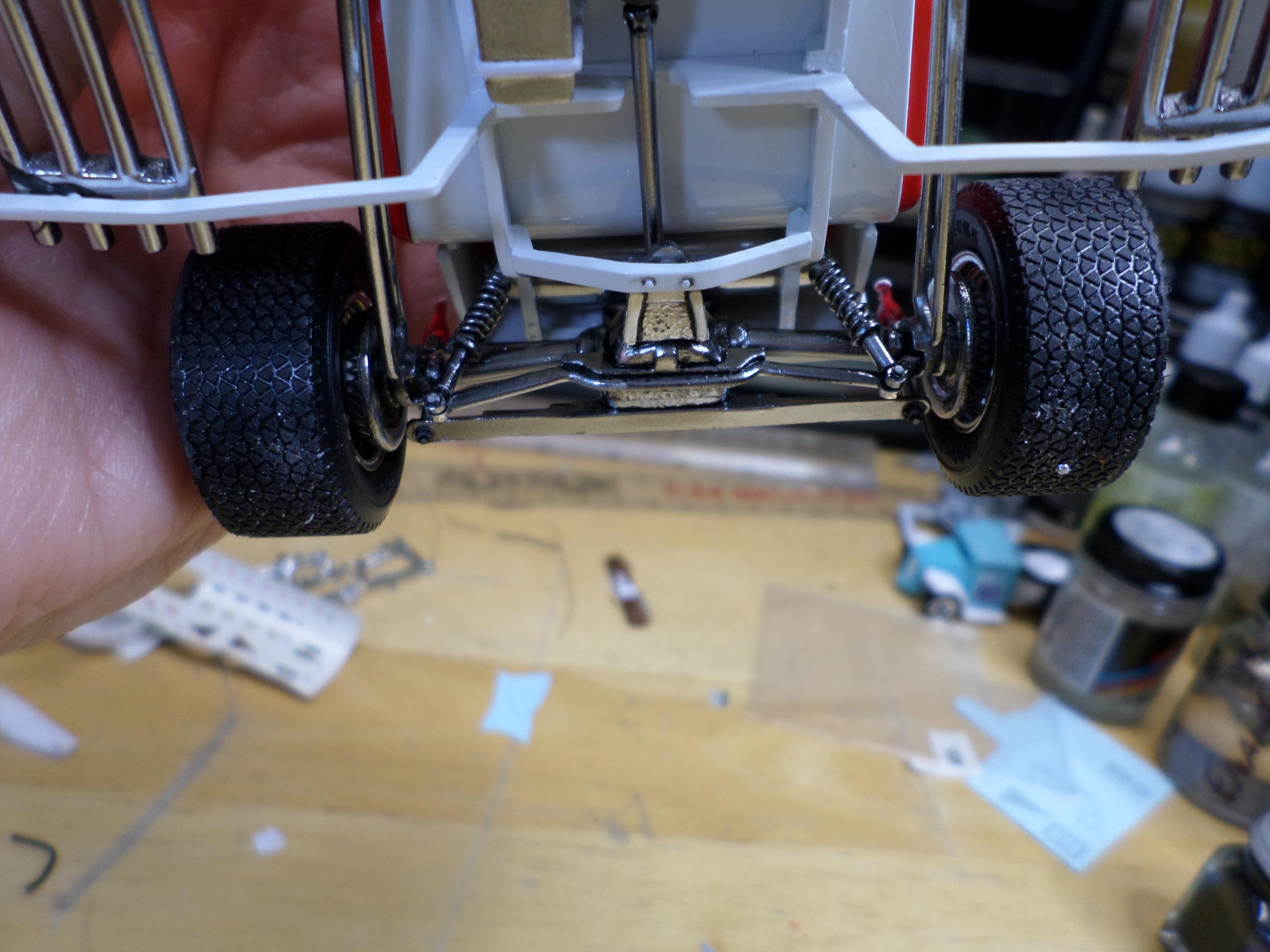

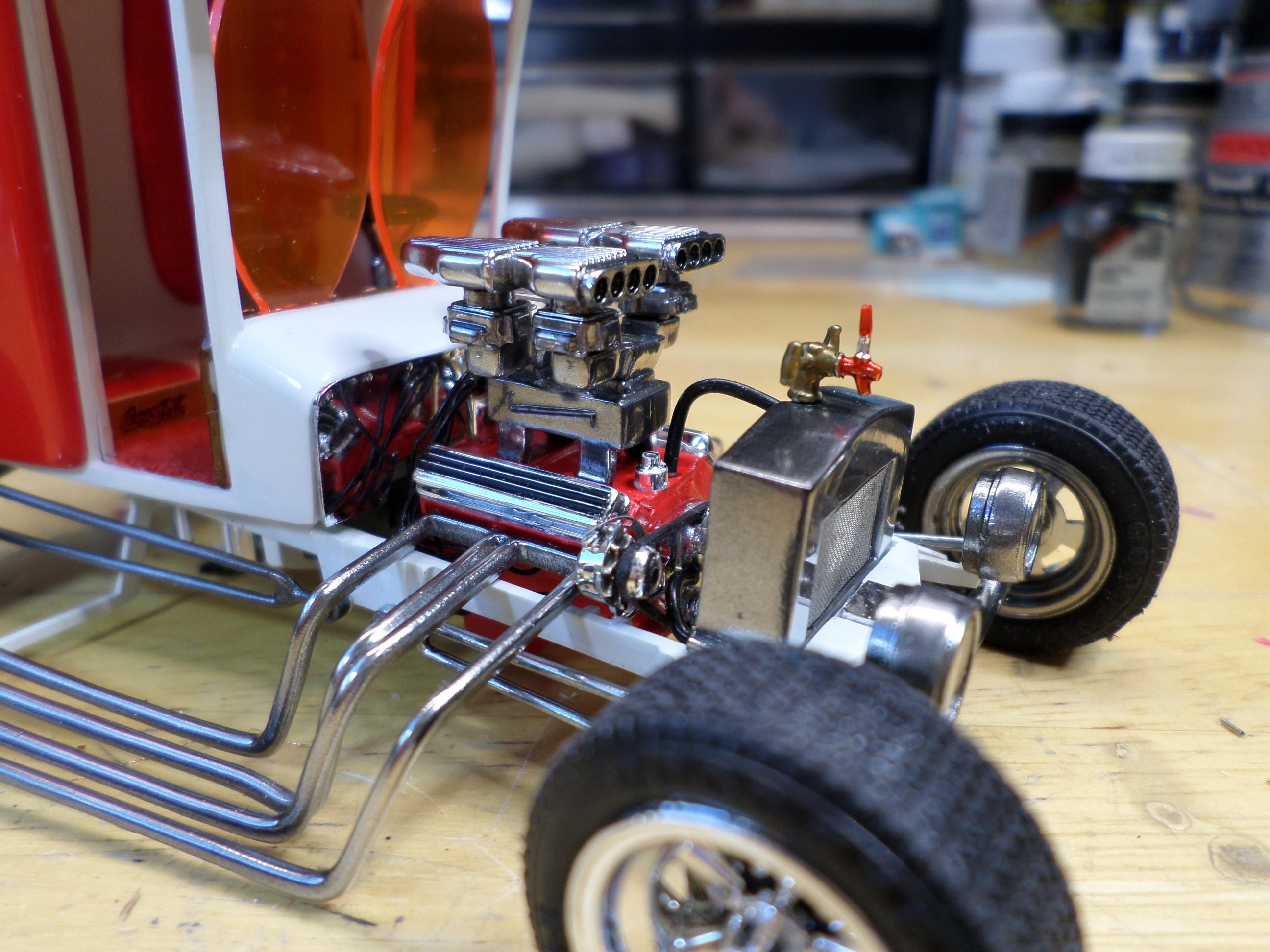

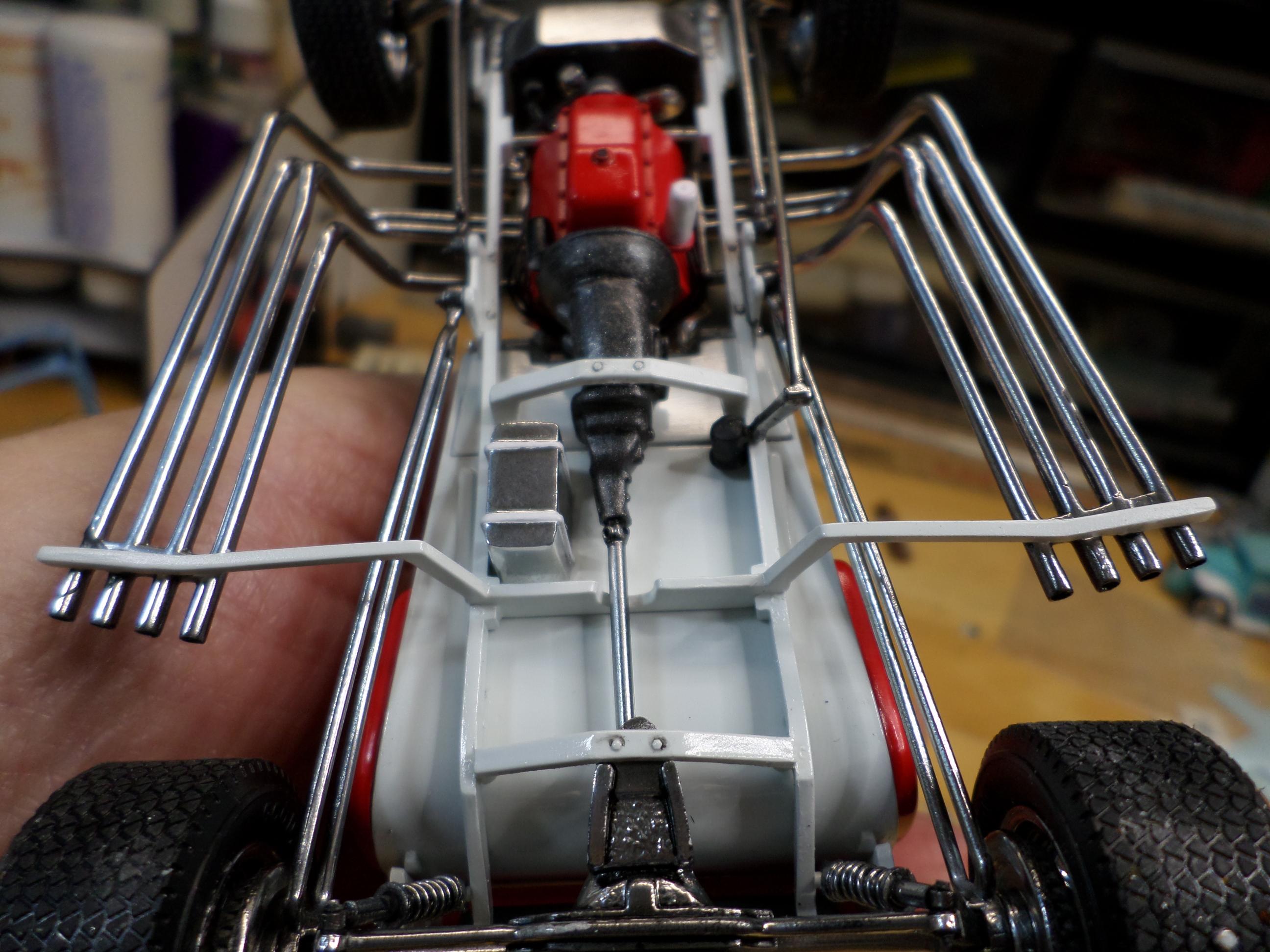

I ended up stripping nearly all chrome trim to clean the seams, the vast majoiry was re-shot with Spaztix chrome (except rims and a few small bits), lots of nut/bolt head detail added, new driveshaft from aluminum, alternator relocated to correct location with bracket added, carpet, fuel line and plug wires ran, exhaust tips drilled out, scratch built coil/over shocks, radiator grill replaced with fine mesh and the radiator rebuilt from photo etch,  little filaments added to headlights etc. The kit does contain some really nice parts that would lend themselves well to additional kit bashing, like fantastic rims, Z'd frame etc.
