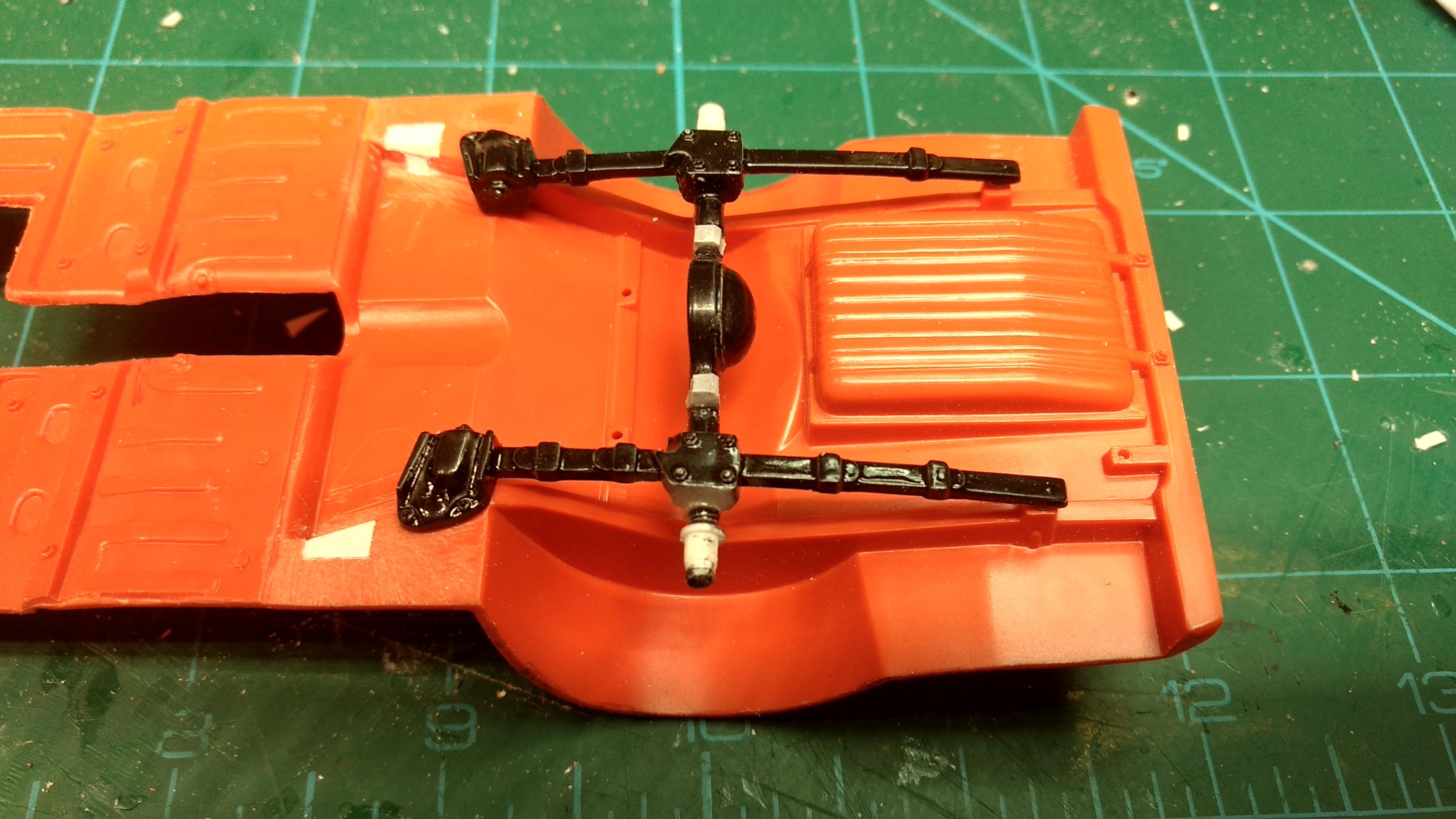

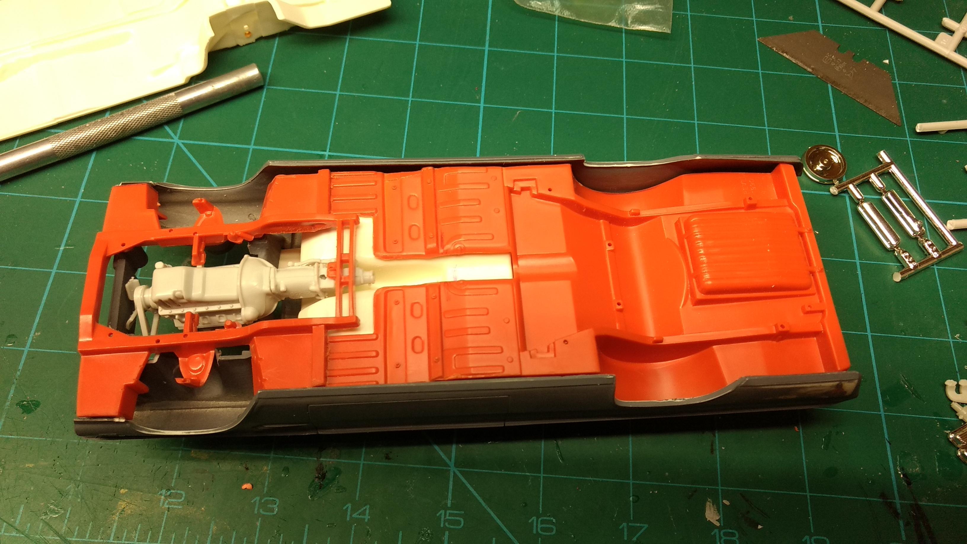

Since I should be finishing my Raptor on Monday and, hopefully, my 63 Tempest later in the week I figured I'd start a thread on this. The first pic is my idea of what I'd like it to look like.

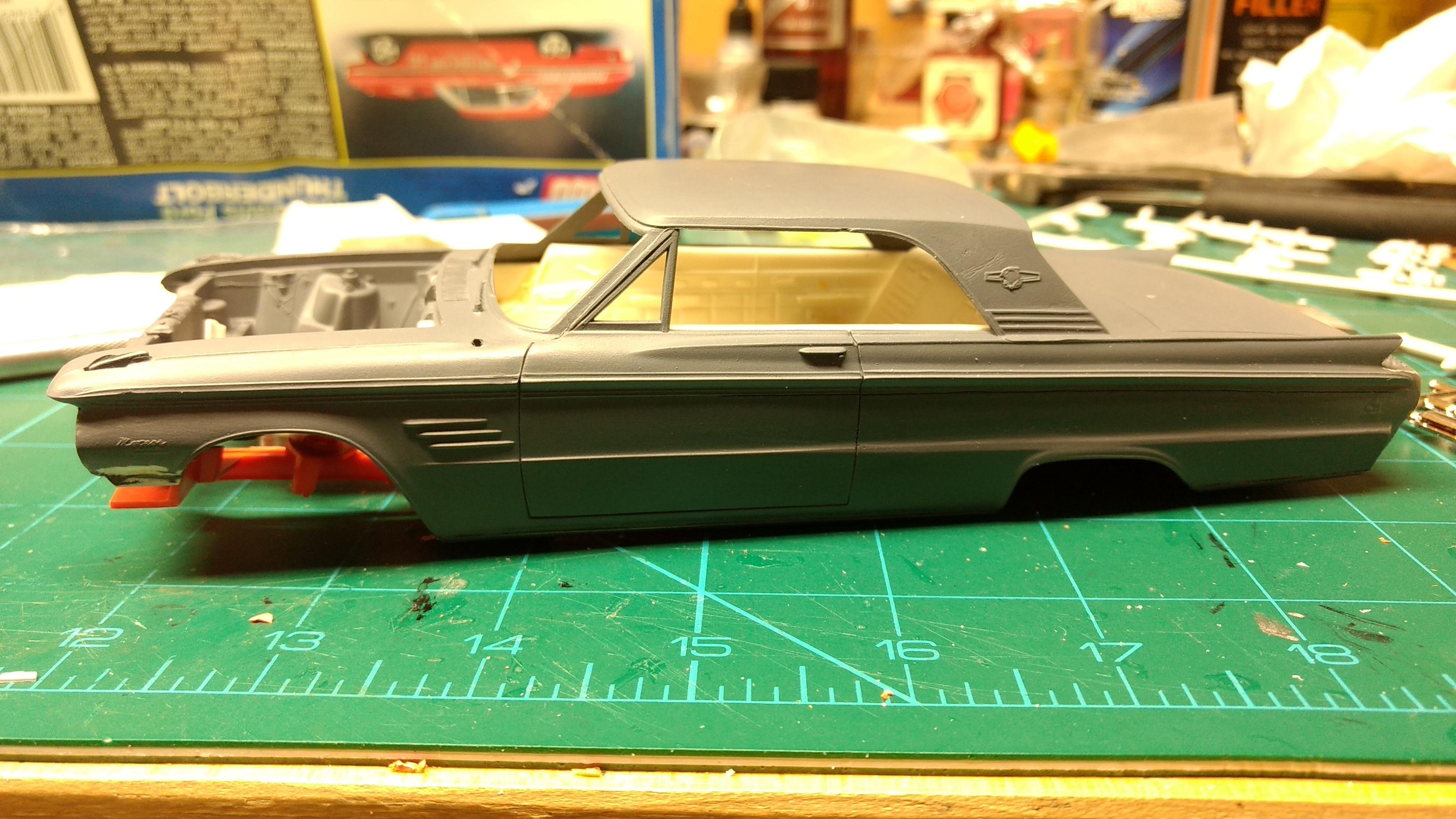

I do most of my building during breaks and lunch at work and this one has been my project to pick away on at home. I got the body cleaned up relatively well. I still would like to fix some of the trim on the driver's side but doubt that I wouldn't mess it up more in the process. I'll probably leave it alone.

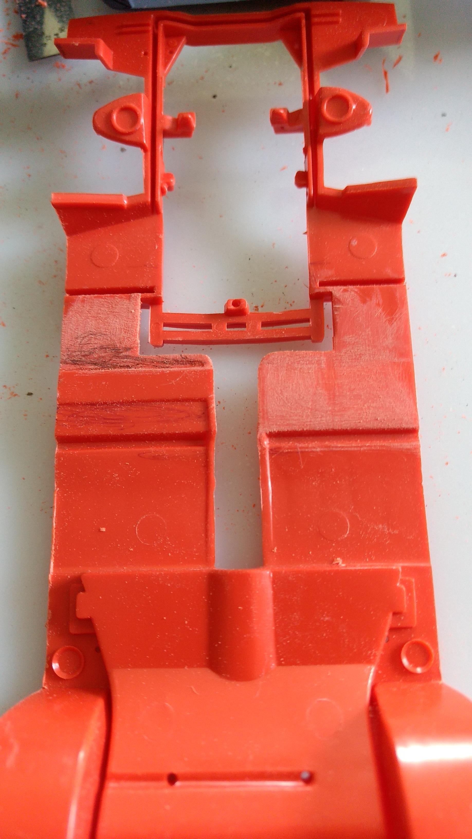

I narrowed the chassis  pan from the T-bolt kit and sanded a bit of the pan thickness to get it to sit up in the body correctly.
I am using a donated Hi-po 289 out of the Mustang GT350 kit. Everything looks like it should play nice with the old kit.
Stay tuned for more progress soon.
Later-

Very cool subject Tom!  The chassis pan fits perfectly and it will be a rare bird when completed!

The chassis from the Thunderbolt is perfect for this as the 1962-65 Fairlanes and the 1962-63 Meteor shares the basic platform and is the only Ford/Mercury cars who do so, so they are closely related.
Many may think the Falcon/Mustang platform works but it's kind of close but it's definately not the same as the Fairlane/Meteor platform is slightly larger and differs in several places...I used to own a 1964 Fairlane and guess how I know this. :rolleyes:
I will for sure follow this build.
One thing if you are going to do a street car, the leafs and brackets are right but take off the traction bars as they are racing only and maybe change the rear end to an 8 inch as I belive it was standard on the Meteor and Fairlane, I don't know if the 9 inch was on the option list even for the 289 HP 4-speed cars.

Hakan- thanks for the input. I will remove the traction bars but doubt that I'll go to the effort to change the rear end.

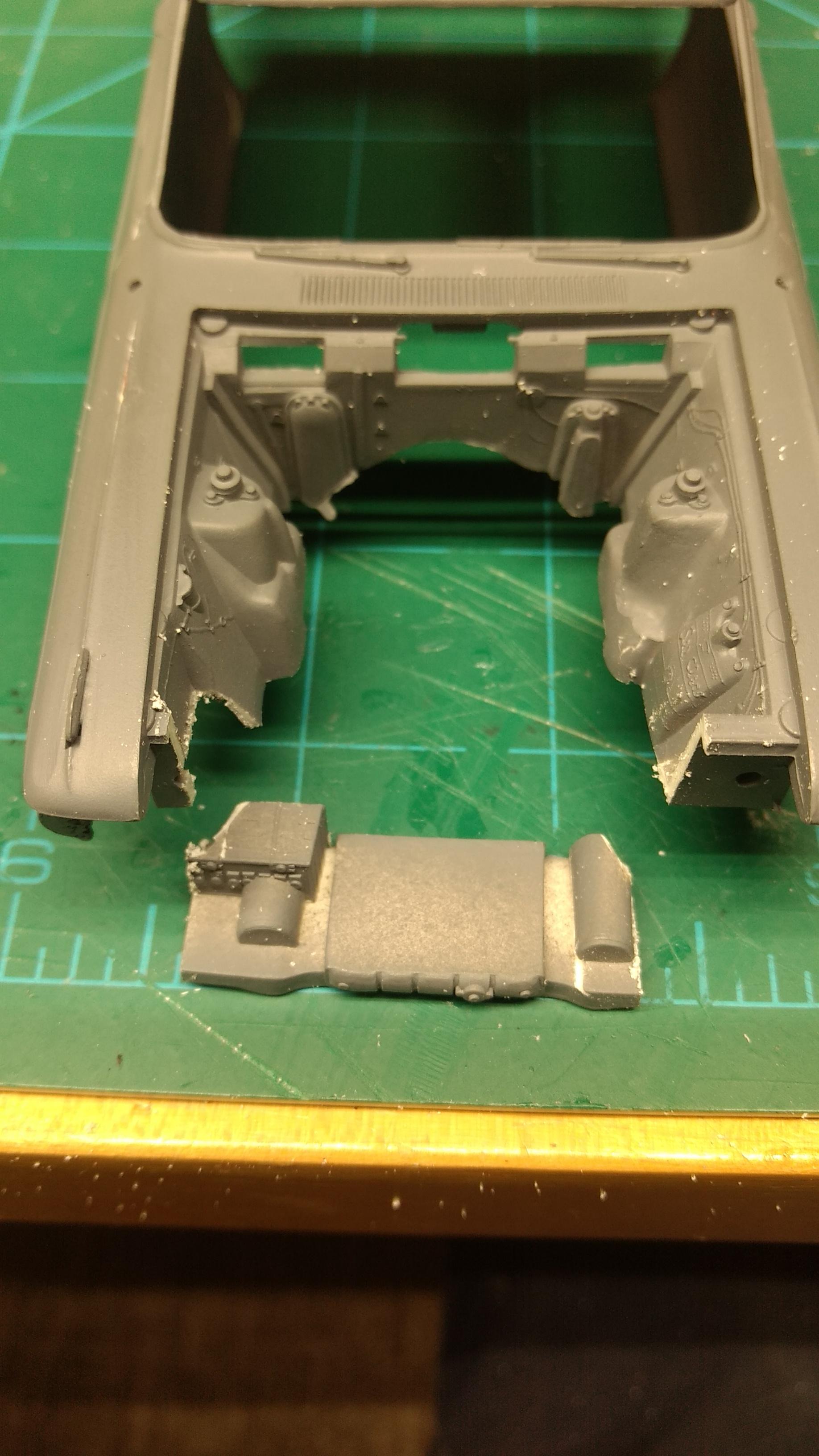

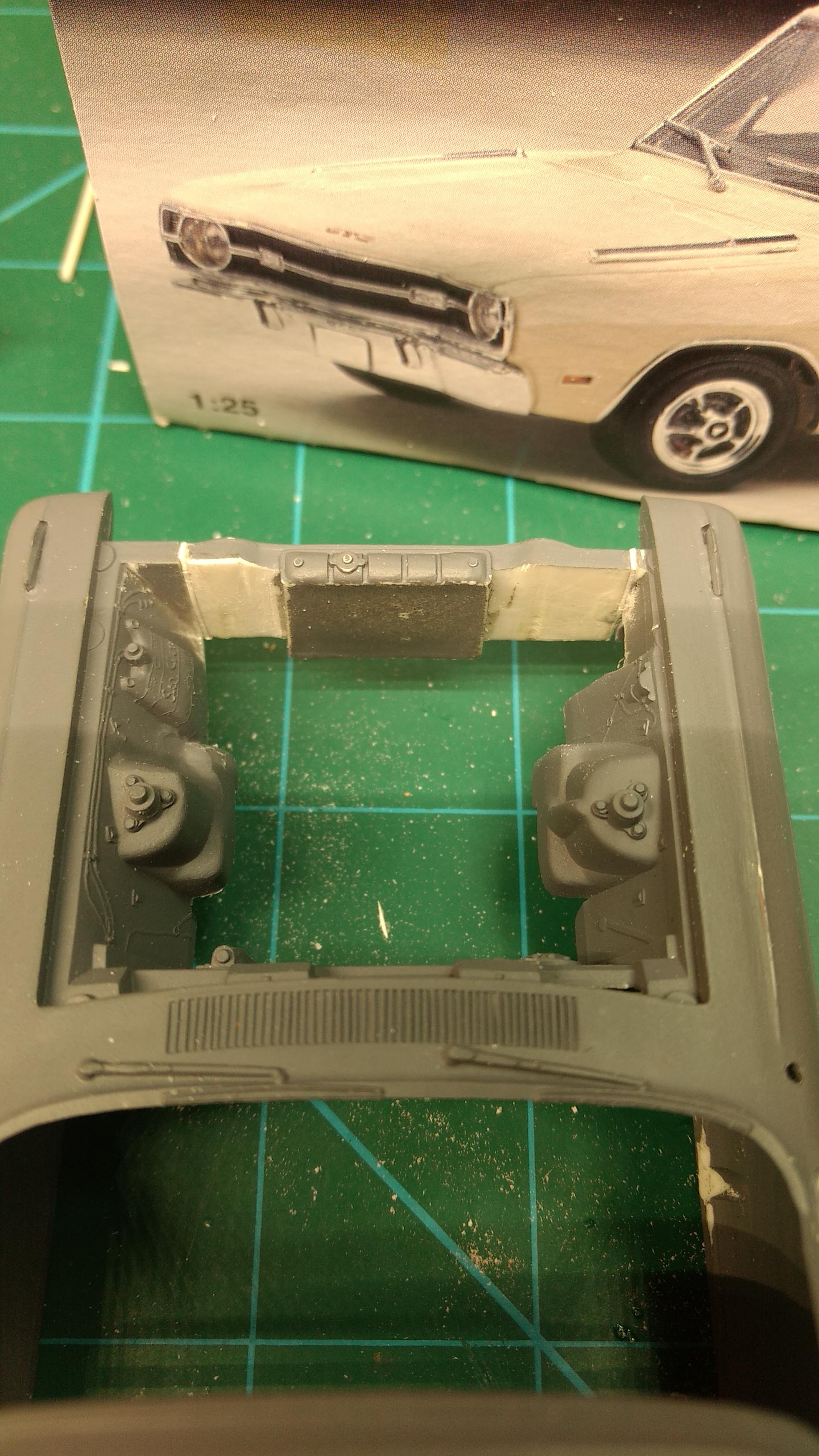

Al- I noticed the radiator wall and old screw mounts last night. I am thinking of cutting it out and replace with the radiator and wall from the T-bolt or ? for more detail. I need to be careful though because there isn't much room between the existing parts and the engine fan.

May I have another input there.
The radiator from the Thunderbolt is not correct as the Thunderbolts used a cross flow big block radiator from a Galaxie to cool the 427 FE High Riser engine, the small block Fairlanes used the same radiator as the small block Mustangs.

So, a radiator and wall from a standard Mustang should work?

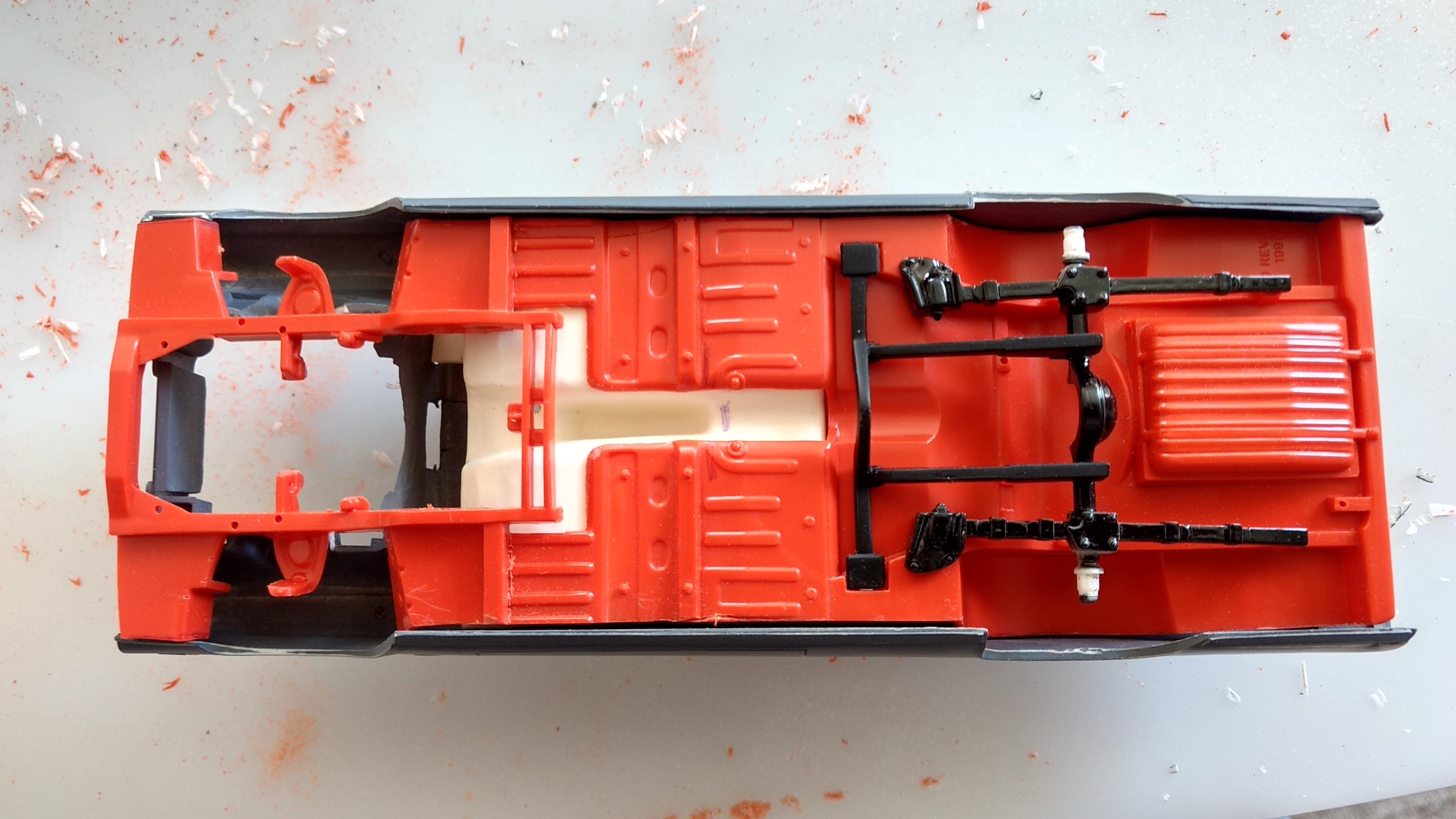

Working on this again tonight. Just some quick progress shots. Proof of life shots, you might say.
Hakan-
 thanks for all of the input. I appreciate it. I decided to not use the traction bars but I'm keeping the Tbolt rear end for simplicity sake.
Al-
 after looking at the radiator wall and radiator I decided to cut out the offending screw bosses. I found that the easiest way to clean it up was to cut out the wall and battery, perform the surgery and reinstall the wall and radiator. I will need to find a new battery to replace the molded in one.

Tom, nice solution for the rad. issue, keep up the good work..

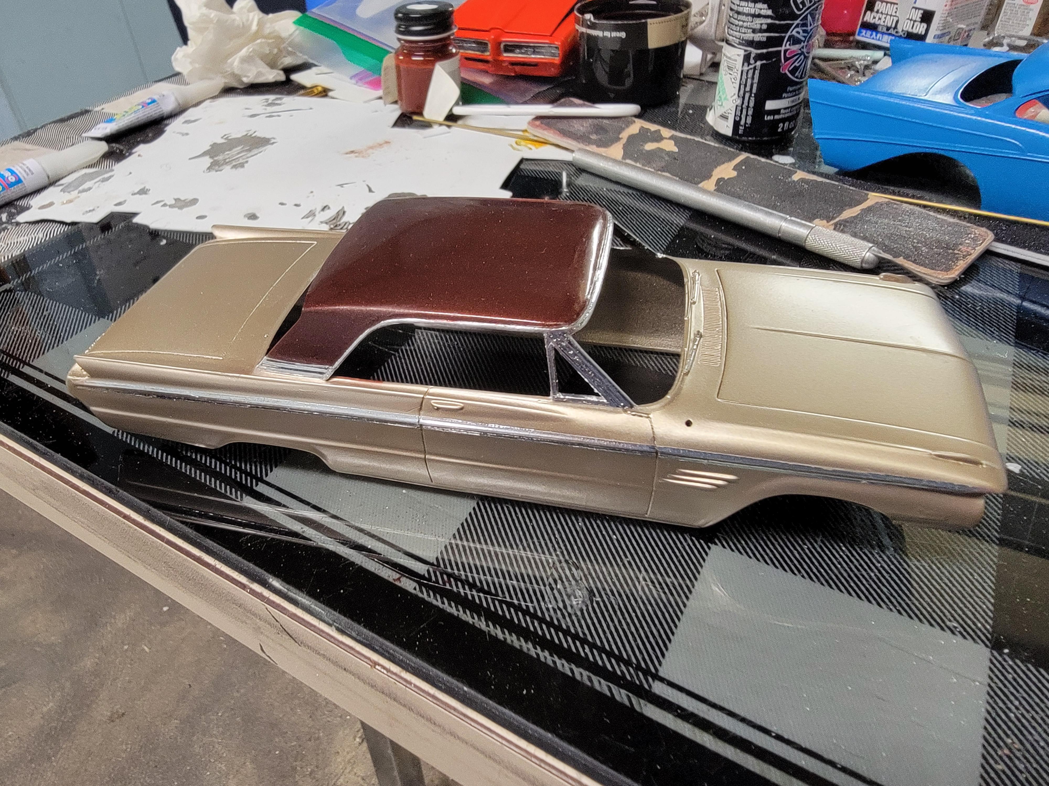

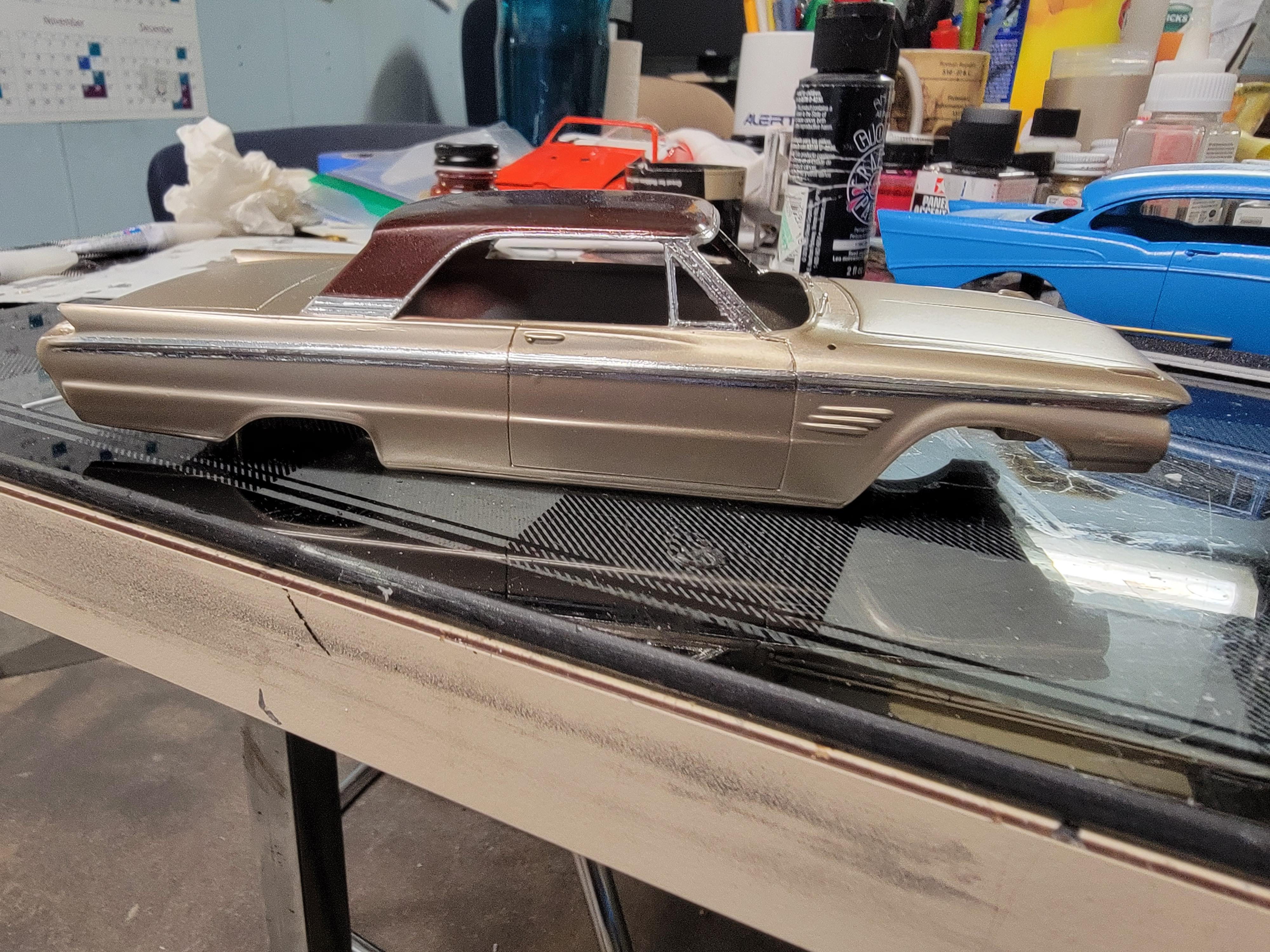

So, obviously I have not updated this in a while. AL (Thatz4u) asked about this one this morning and I had to dig to find the link. I have been working on it between other builds. I'm at the BMF stage on the body but still have the interior and chassis to do. Slow progress.
This one took a bit of a turn with the colors but the build will be a hot rod style.
