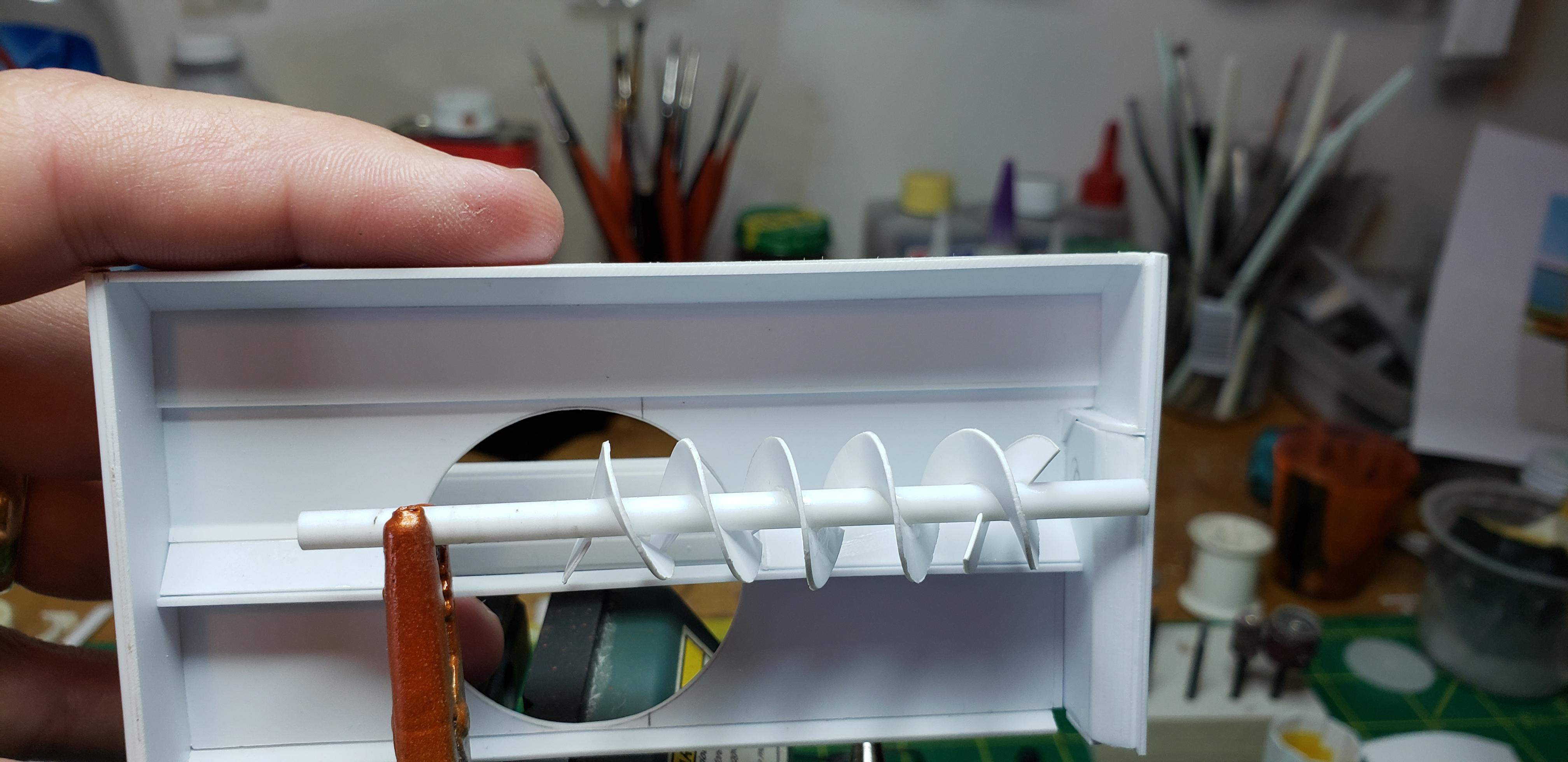

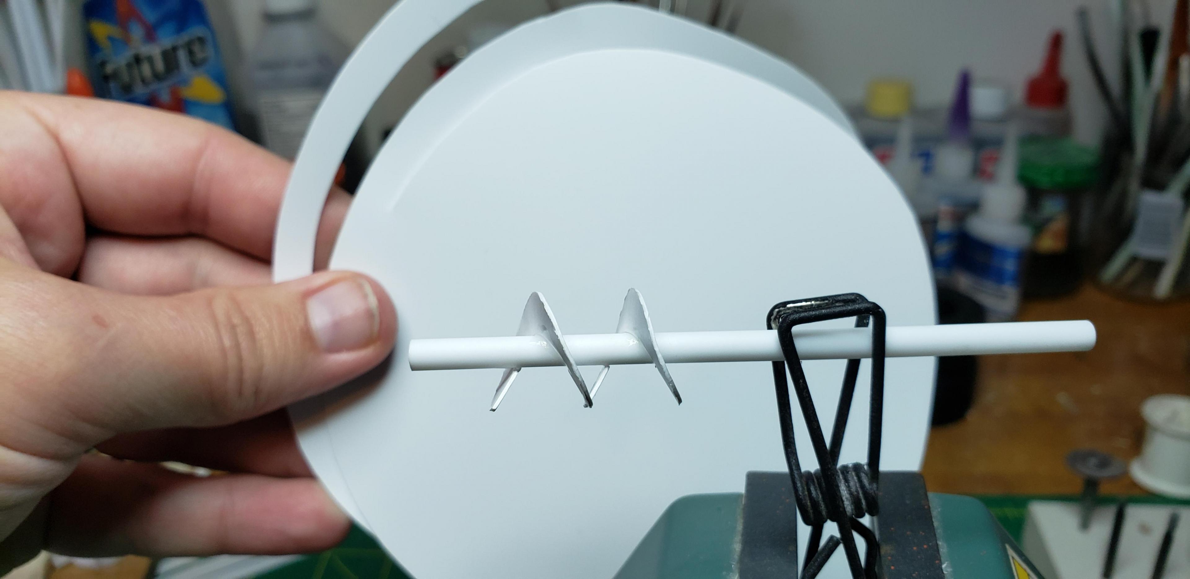

After many tries wrapping an auger,  a tech at work made a suggestion that seemed worth trying. I was using a punch size similar to drive shaft diameter.  He suggested going up a few sizes to allow blades to rotate more...I owe him a cold beer
Now to flip the blade pitch and make the other side and start the bottom auger . I ended up gluing them like a W or M depending way it spins, creating a drift buster ..really makes the machine look more rugged now just glue repeat 20201126_100656.thumb.jpg.58eec57738aa20a873a3da1917843c16.jpg

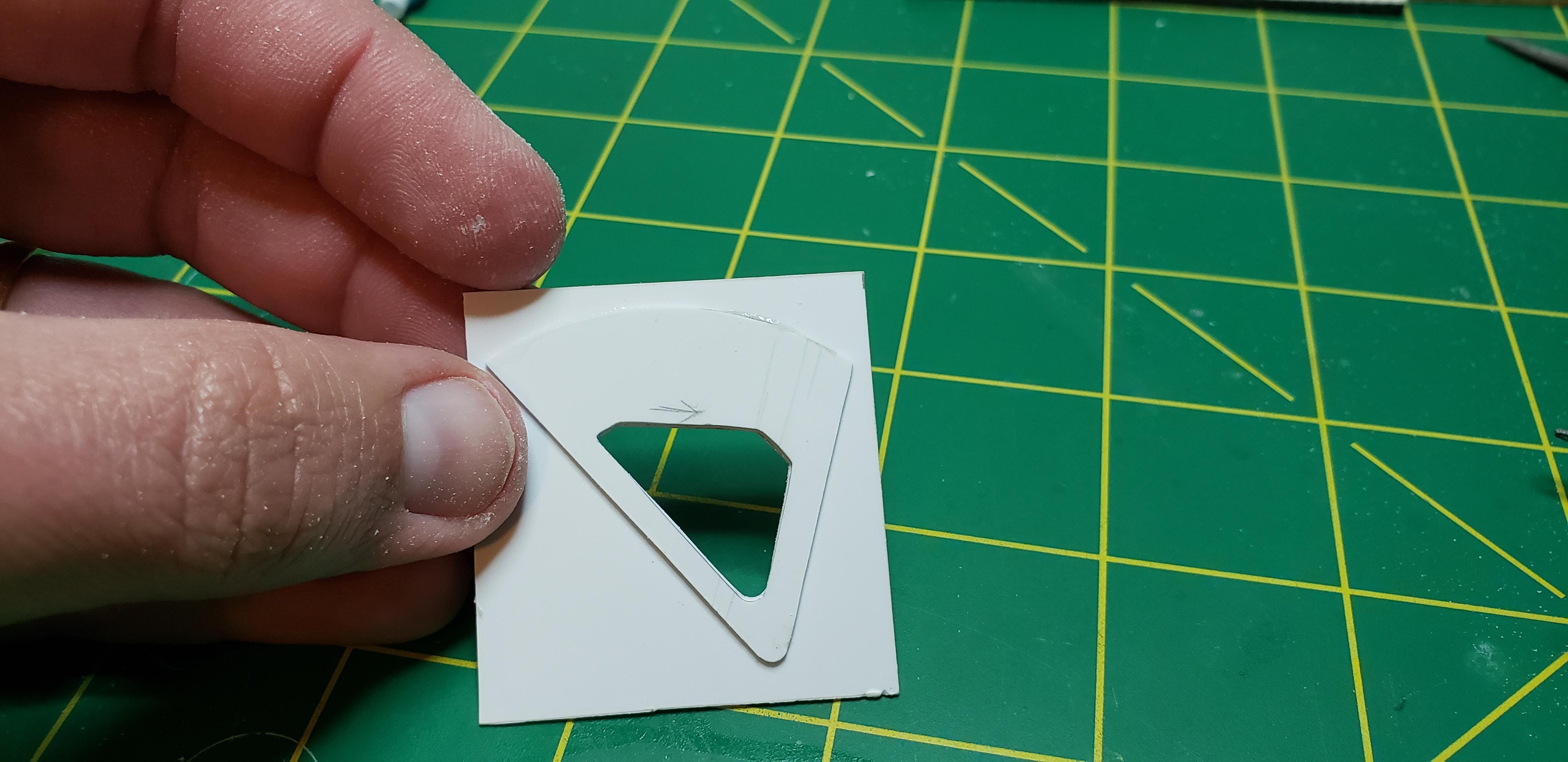

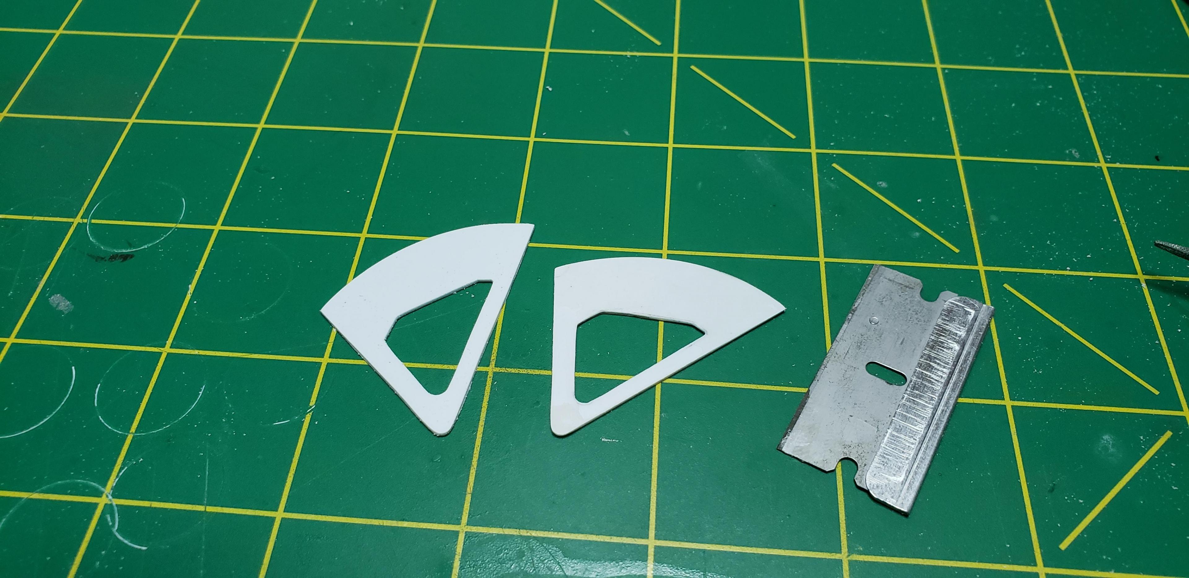

Tiny update , I've been working on the discharge chutes that send all that pummeled snow airborne, or loaded into trucks to get hauled away. Theres 2 sections that are hydraulically extended by driver , so I started w the lower one. I drew about 8 patterns before committing plastic..sanding /filing away the excess then laminating onto spare sheet bits ending up w a pair of sides . Triangles and circles lol20201129_112143.thumb.jpg.5327a4ed07cb9f410e412ca0e3511006.jpg

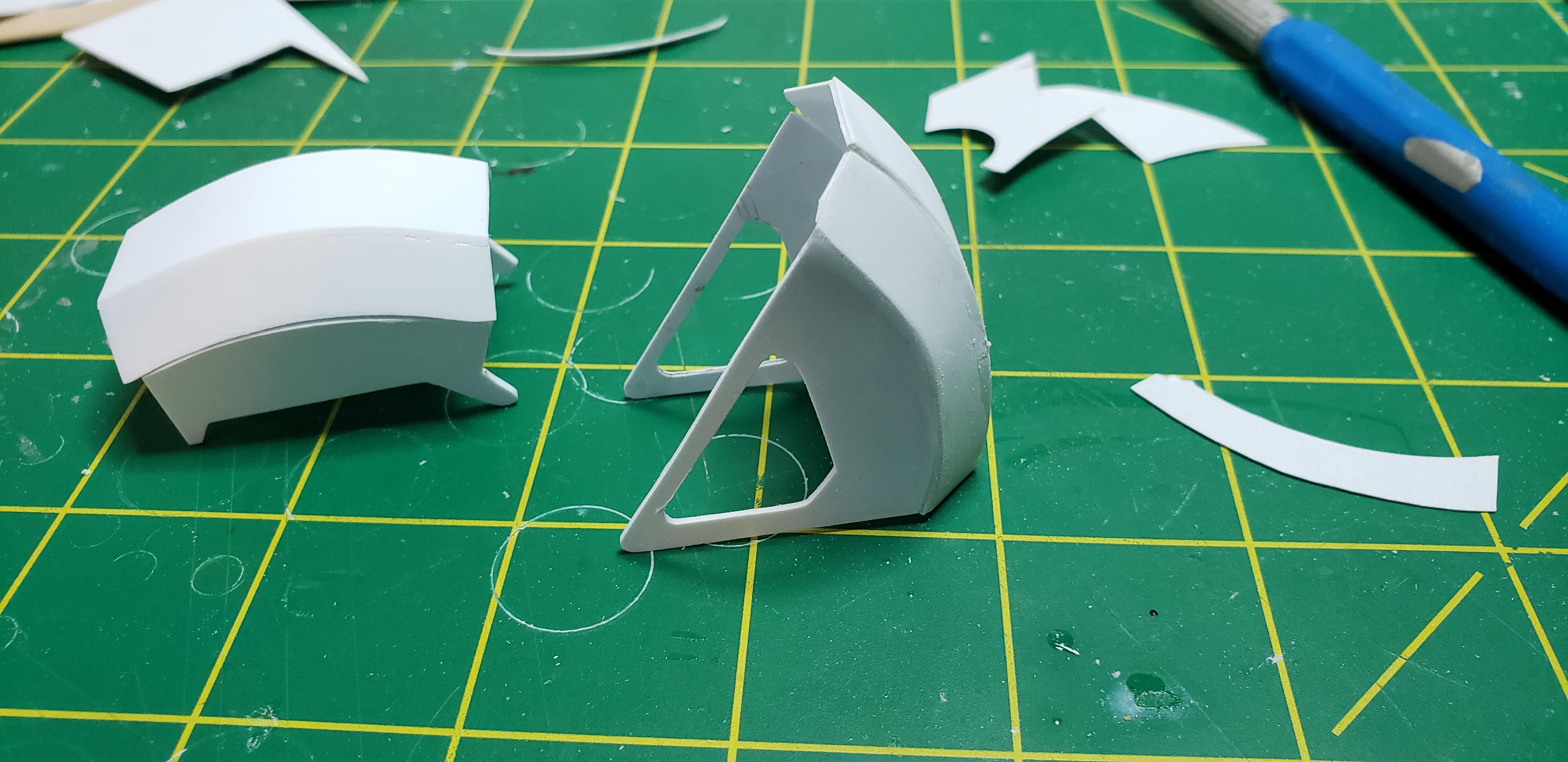

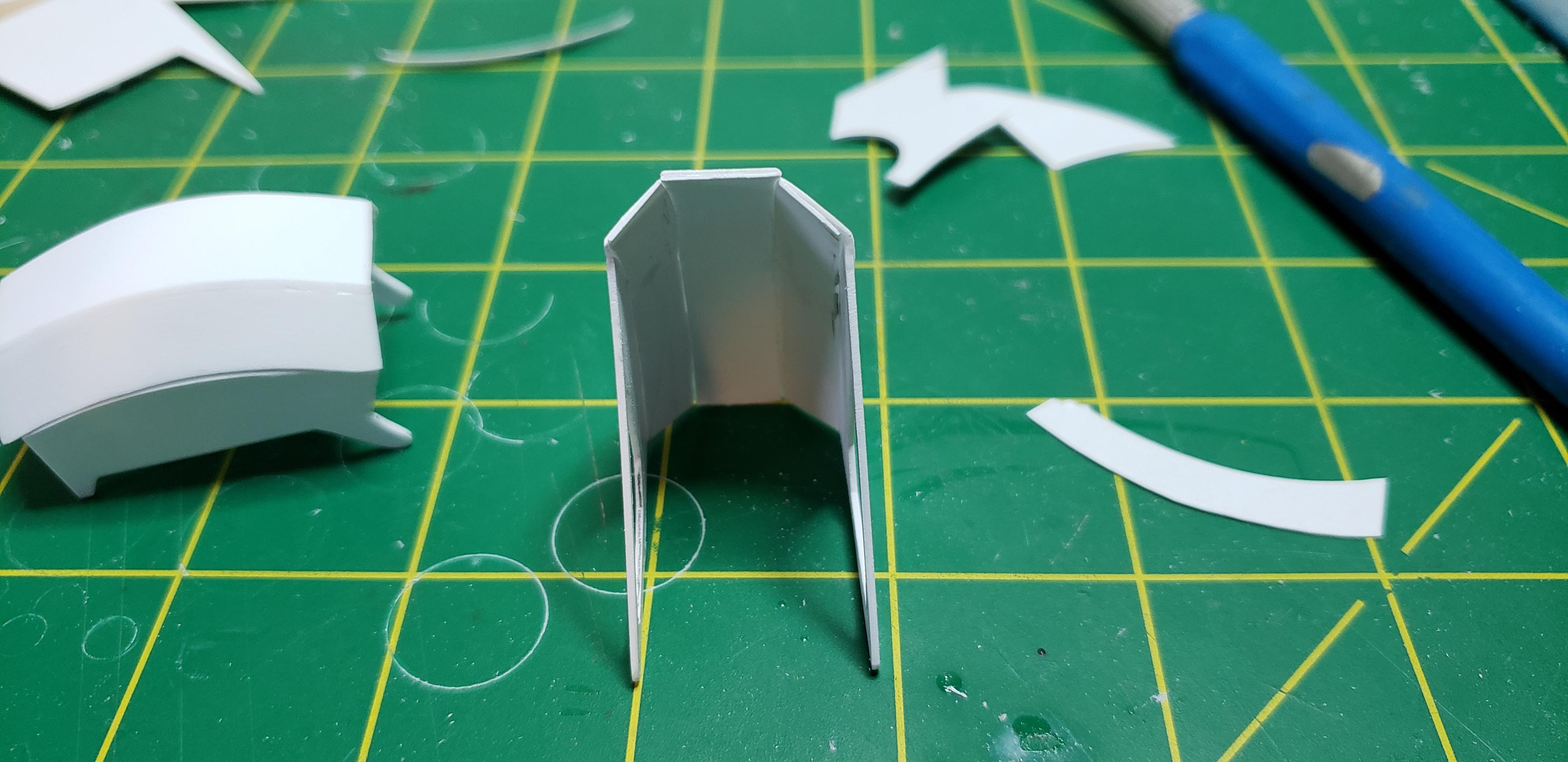

Adding more curved strips along the sides and top finally produced a chute . I realized if I bevel the edges the parts fit tighter....I tend to ignore the obvious lol
20201201_134407.thumb.jpg.5418e9606506f11ed1fe6c7b3e932b8f.jpg20201201_134402.thumb.jpg.fa3c68b293842c1e84ecba547ebf6369.jpg
The outside chute was built similar,  and will cover the first or be displayed deployed..haven't decided.

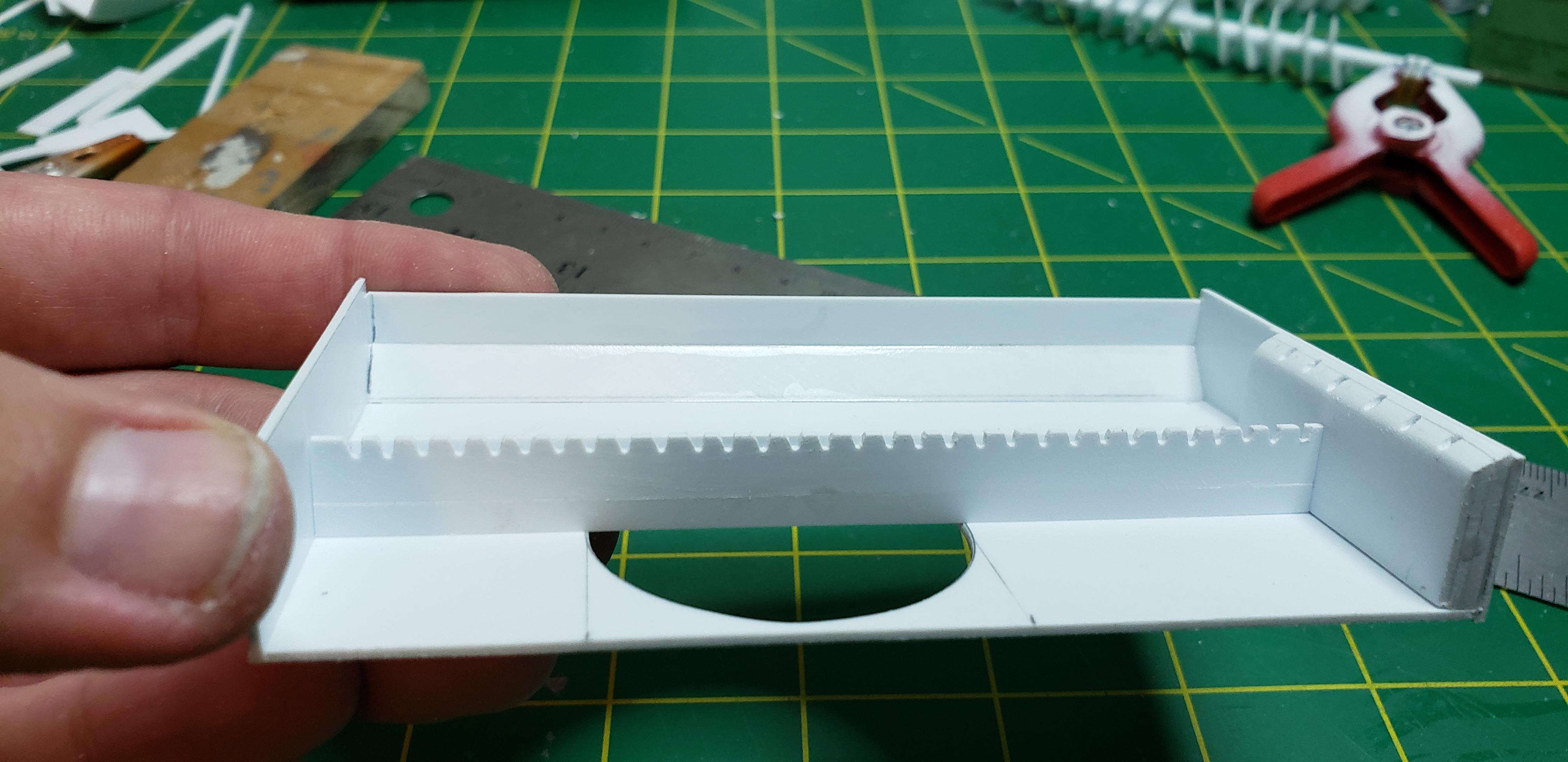

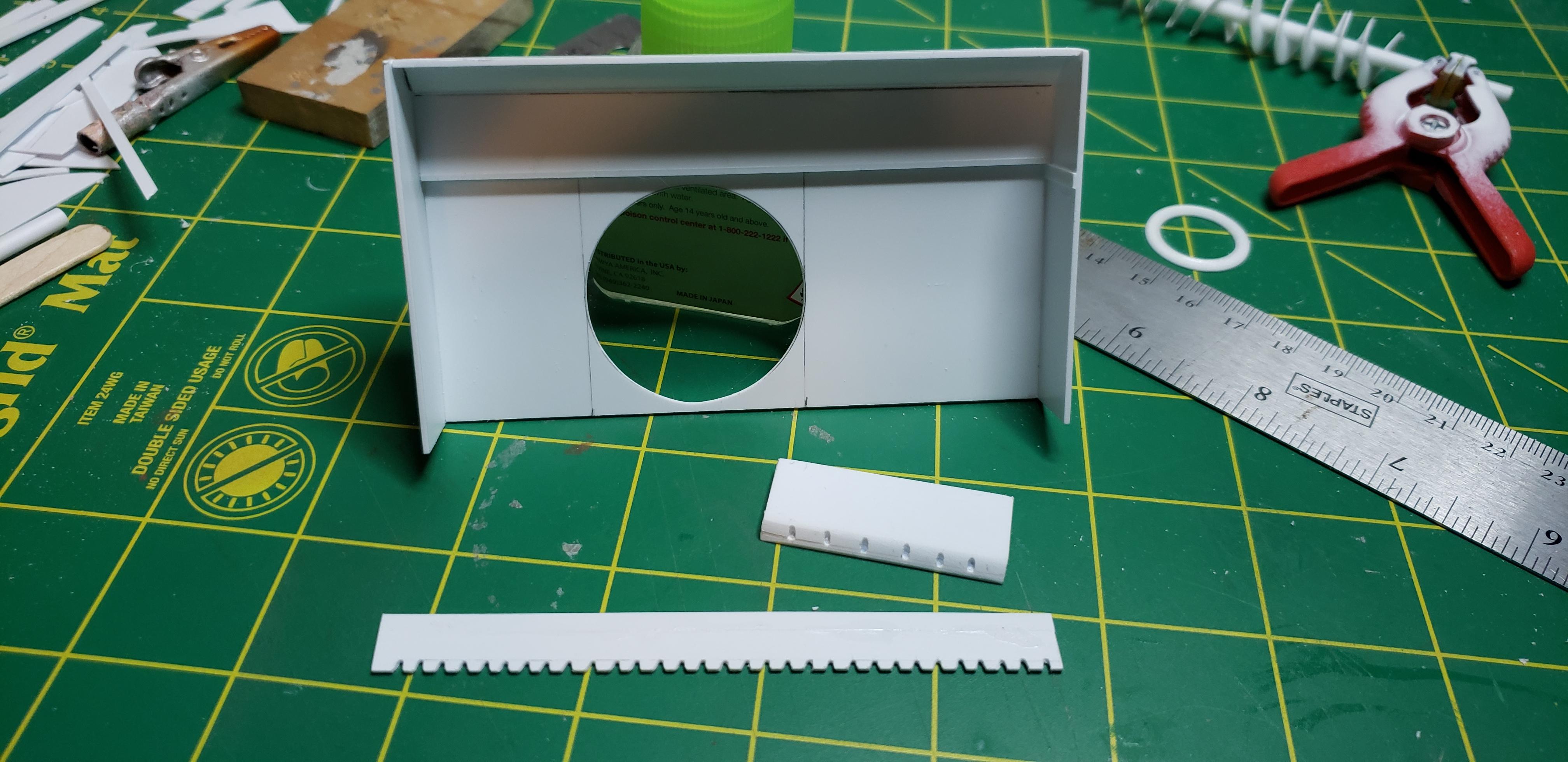

Another object i absolutely wanted to add was the sawtooth drift breaker inside the bank head. Laying out strip then marking out close enough gaps i cut grooves w the wheel of death w a this cut wheel then flossed w sandpaper 20201128_170025.thumb.jpg.53c48138239e766265799f6415cb360f.jpg
Yes...thats another bank head underway..my buddy plow chaser wanted one for a build , its like a Sicard assembly line !!!  Best part is learning different ways of making multiple parts w different details

Nice work on this. It looks like you’ve got those auger flights figured out. Scratch building, although frustrating at times, is also very rewarding...and a great way to while away the hours. ? Carry on!
Edited by NOBLNG
Link to post
Great work on the auger, looking at the photo's you posted I can see how difficult it would have been to work out how to fabricate it, looks like you nailed it though, great scratch building on this complicated project, really enjoying watching this build.
