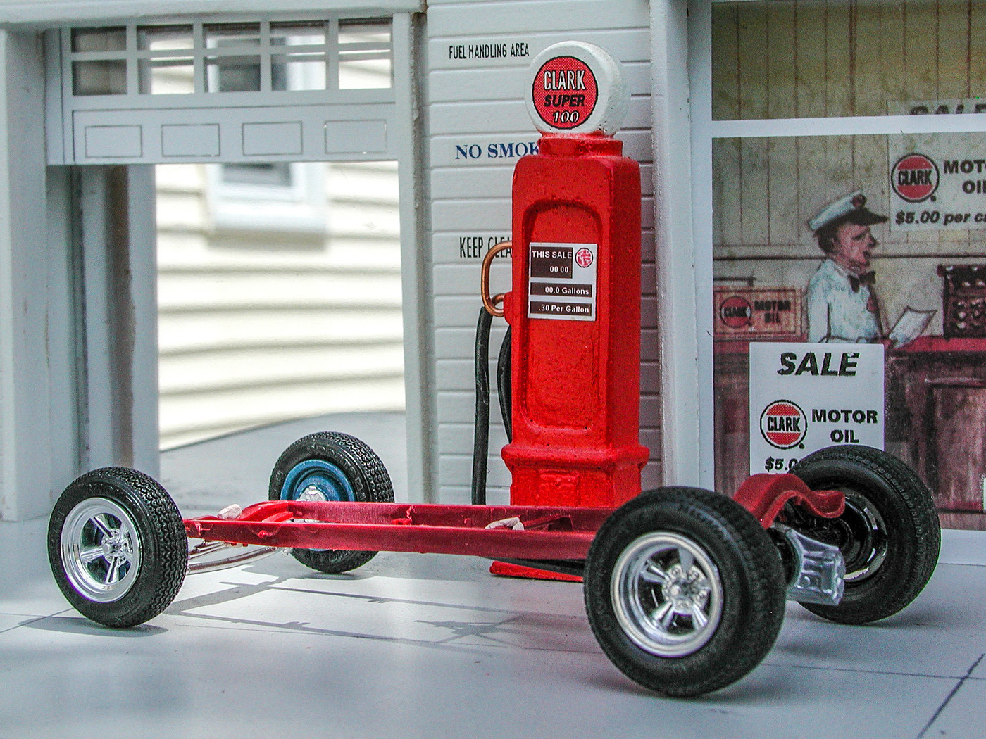

I stepped the frame, and cut out the stock center section from the rear axle, and added a Halibrand Quick Change from the 25 T kit. The front axle from a Revell 32 Ford brings up the front, and the body got doused with some Dusty Rose Pearl. And that is as far as it got for a very long time.
P6180040 rt
P6180041 rt

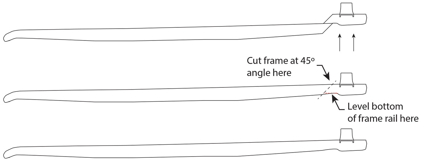

I traced this out in Adobe Illustrator over a photo of a stock frame to show how to step the frame. (A little confession - I used two frames on mine.)
Frame Rails Kick
P6180037

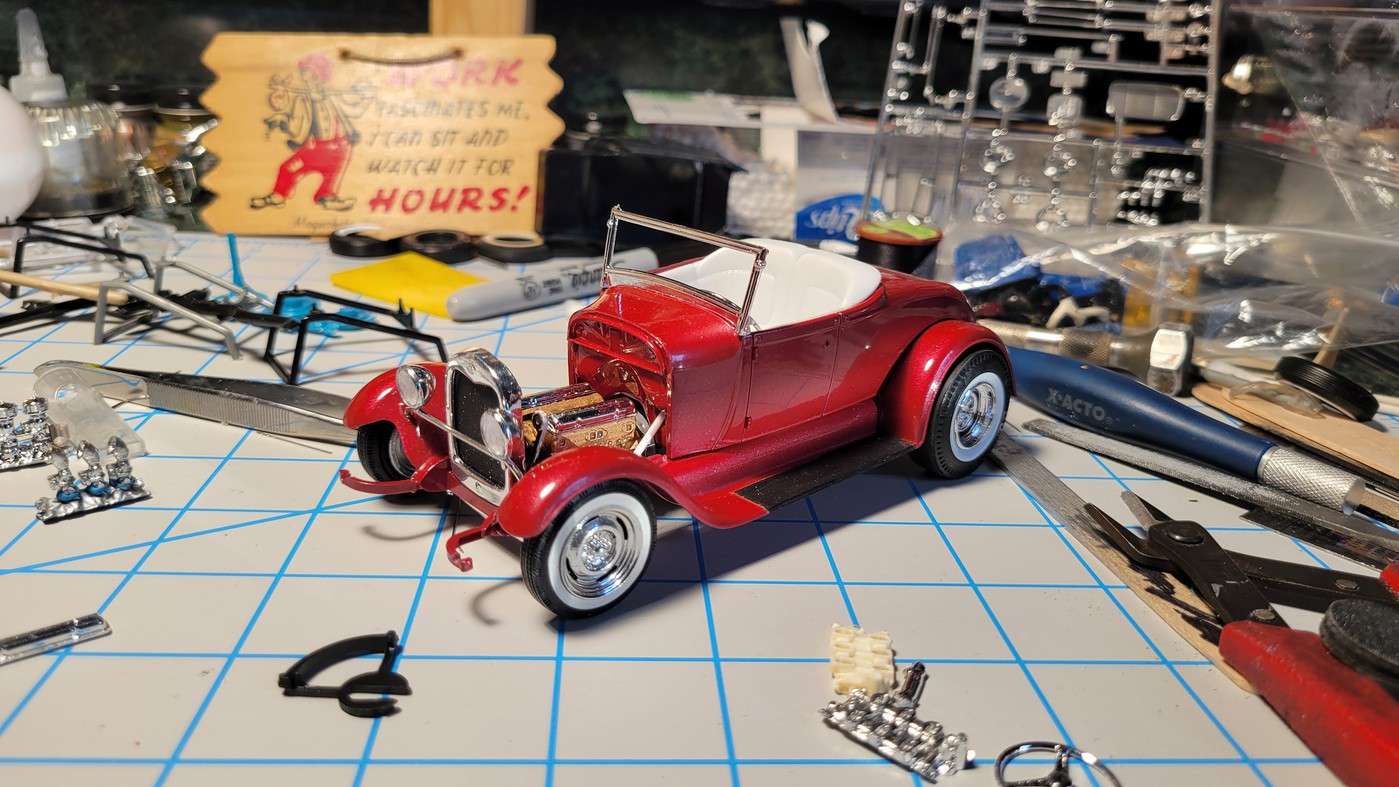

Here's where we take a break, but I will leave you with a teaser photo -  a now painted chassis mockup with the assembled and painted Tweedy Pie 283 Chevy engine.
20210331 172328

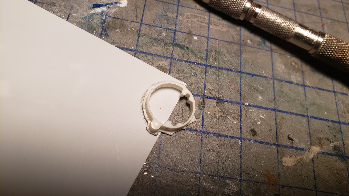

OK, I'm going to pick up where I left off yesterday. As I mentioned earlier, Jim Keeler's work with Revell has an almost a jewel-like quality, but occasionally there are a few flies in the ointment. As you can see from this extra Tweedy Pie engine, there is no front cover for the bellhousing. So...
20210225 210629

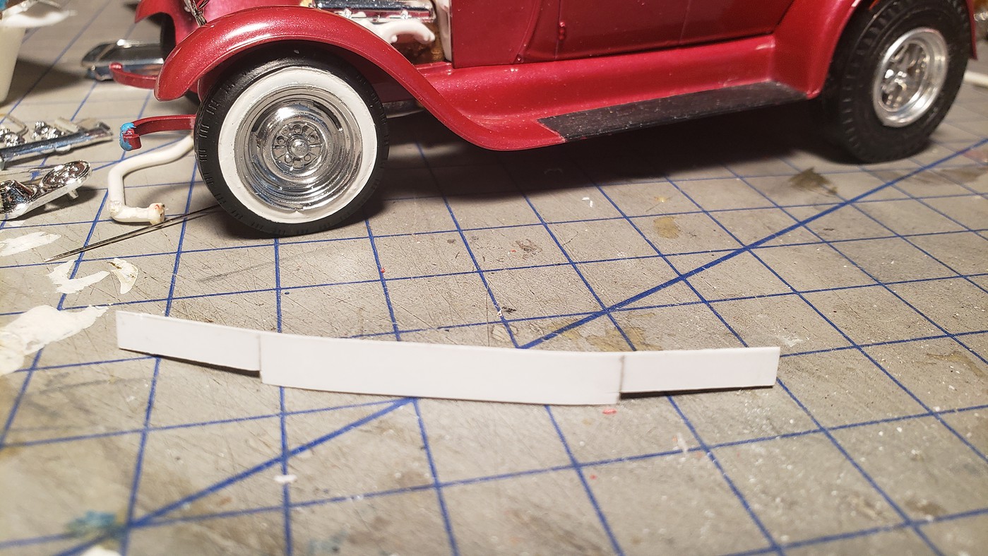

I traced around the bellhousing adaptor on some thin sheet plastic.
20210225 205417
20210225 205422
20210225 210104
When I finished it, I shot it with a coat of Testors Chrome. I'll show you a photo of it finished, later.

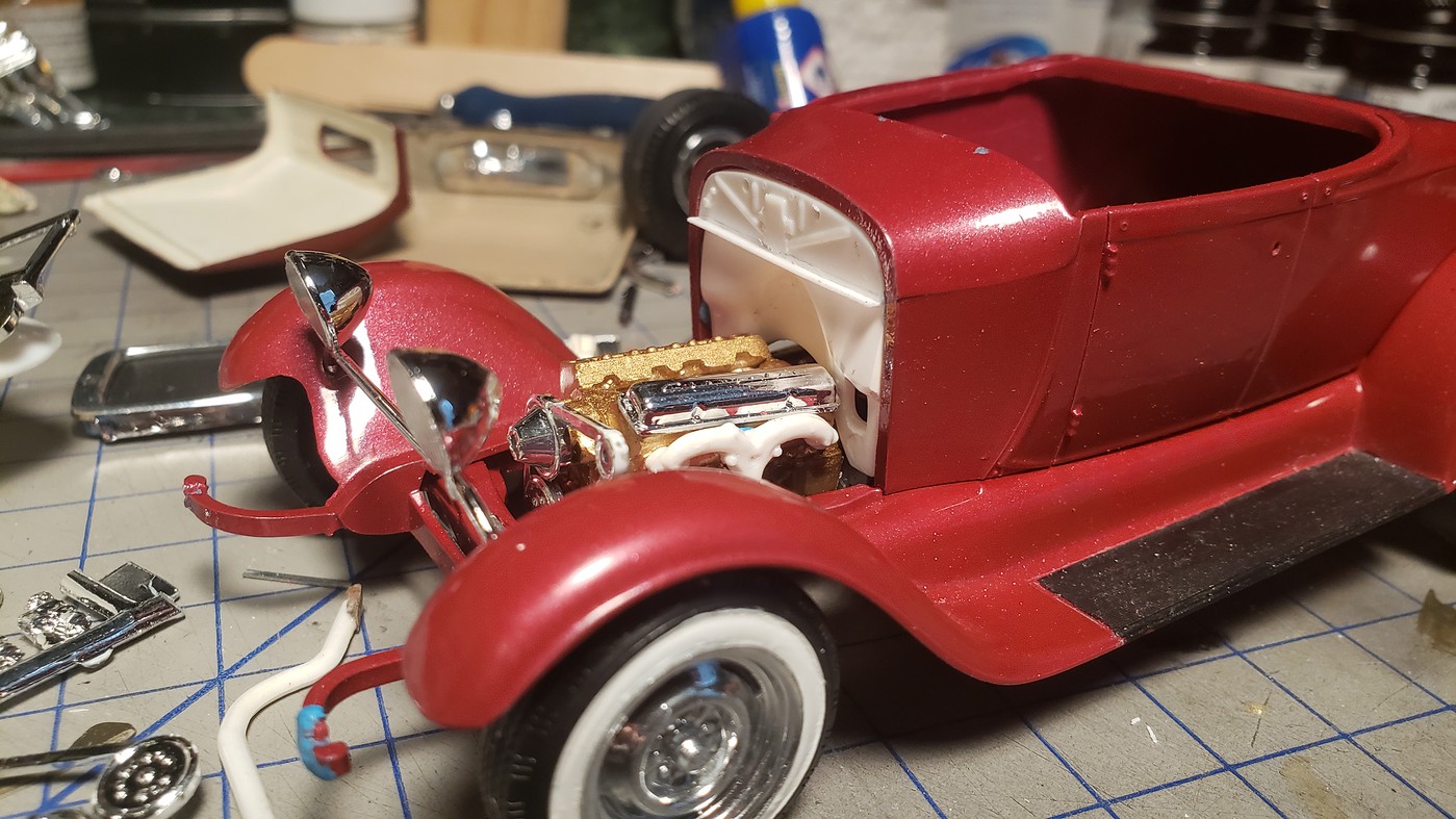

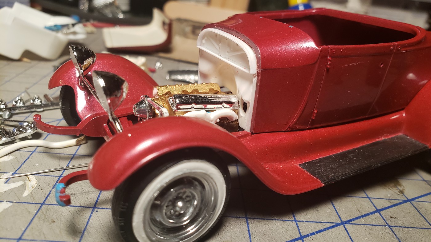

Next, I turned my attention to the firewall. When AMT redid the Model A for the "A Venger" version in the mid 70s, they shortened the stock steering column and eliminated the hole in the firewall for it to pass through, presumably to accommodate the Red Ram Hemi. So I switched to an earlier issue firewall, which I ground down quite a bit for clearance.  You can also see that I set the firewall back flush with the cowl, and added a lip where the upper cowl/gas tank bolts down. Then I made a flange for the perimeter.
20210309 171356
20210309 171401
Here you can see this finished lip, and how I ground down the firewall.
20210309 194712
This is pretty close to correct for a Model A, but ultimately, I ended up having to set the firewall back a little further into the body. The stock hood will not fit with this setup unless the underside is ground for clearance, but the hood isn't part of the plan anymore. This is a hot rod after all.

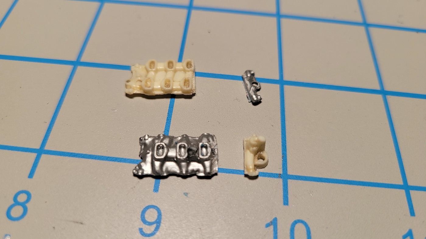

Next up, I had to do something with the intake manifold. As you can see (and sorry the manifolds are 180 from each other) the thermostat housing for the tripower is in the center of the intake, which is completely correct for a stock 2 or 4 barrel manifold, but not ideal for a tripower. So....
20210511 194305
20210513 201248
20210513 201644
Here is the finished Intake and firewall, along with a preview of the engine mocked up.  Again, many thanks to Larry Moore for the tri-power intake. I masked around the perimeter of the cowl and shot the firewall in place on the body. The kit radiator support rods are way too bulky, so I made my own from guitar string. If you go to a music store and ask nicely, you can generally score some used ones for free.
20210516 181048
Here is where I will break off until next time.

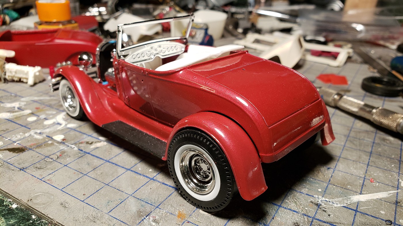

Here is a comparison between the modified interior (left), with the unmodified interior tub on the right. Note that I have begun scribing the door lines, and have cut out the floor, to facilitate laying down some honest to God corduroy for carpet. (I think I mentioned this was going to be old school!)
Because the seats sit a little above the top of the body, it was necessary to fill in the back portion of the seat.
I used Milliput putty for this. It was also the first time I worked with the stuff, and of course, I used waaaay too much.
I still have some finessing to do, but the fit is much better now. Also visible is the black covered insert on the dash, and the wood-grained steering wheel.
