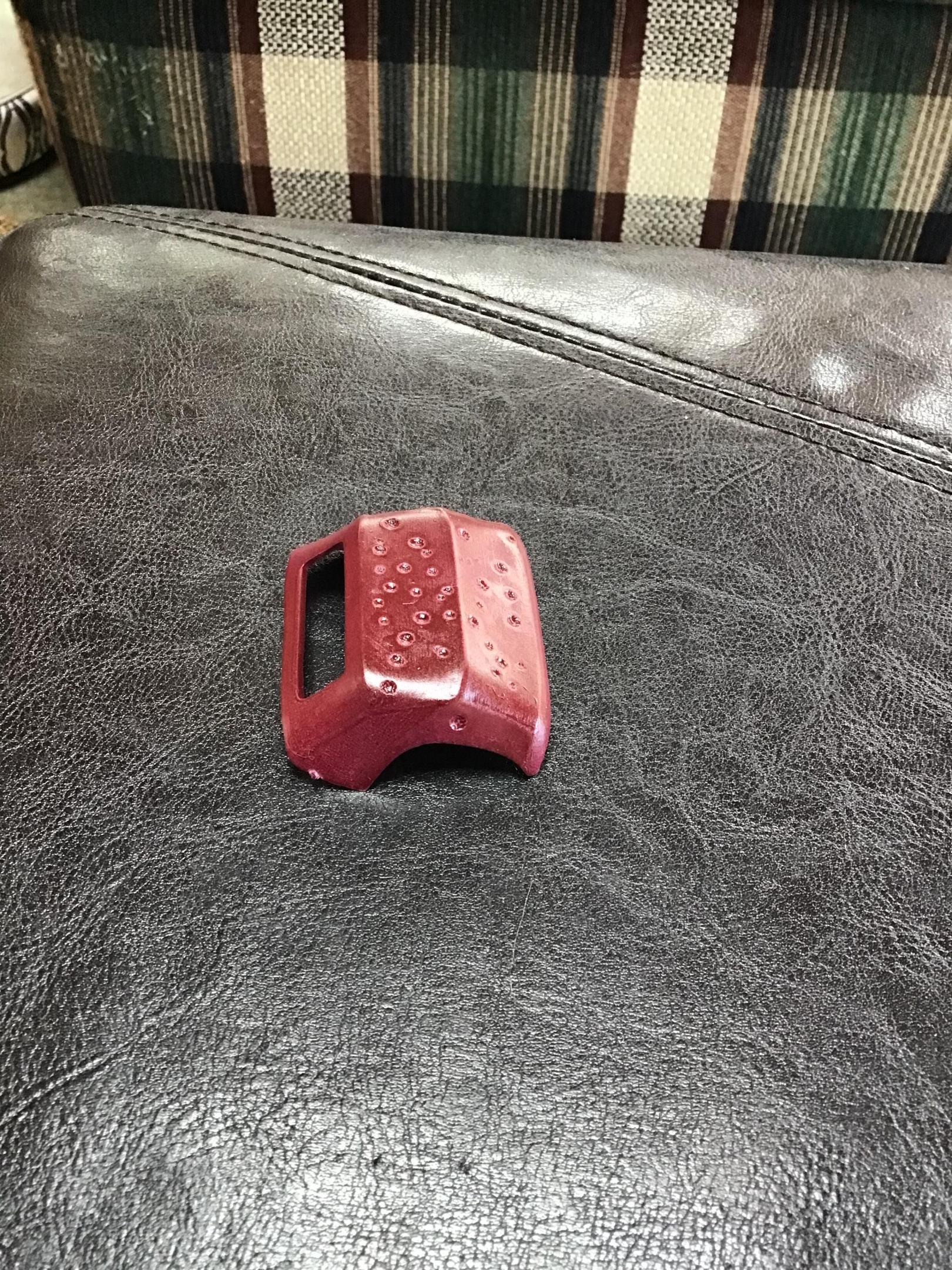

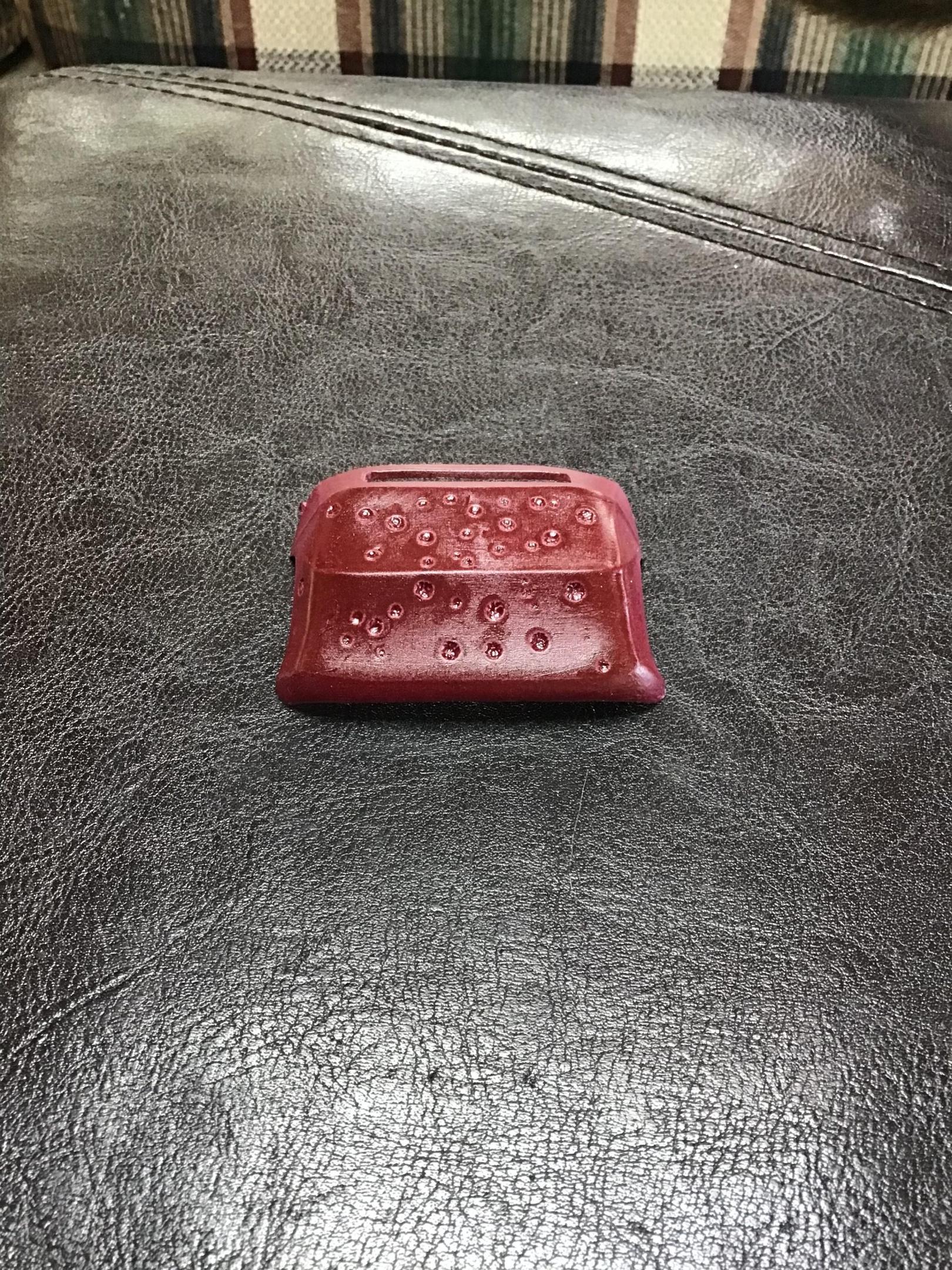

Thanks guys for all the replies.  A lot of good ideas here and something to experiment with.   I tried a bit myself this afternoon on a scrap body and a sizeable punch that had the end ground off sorta round.  Wish I had a set of roll pin punches.  Anyway the bigger "dents" were made with that long punch just hitting it by hand, the smaller dents were made with a center punch.  I taped a piece of cardboard under the roof panel to soften the blow a bit and hopefully not crack the panel.  To me, something looks a bit off.  Like it doesn't "stretch" the panel like it does on a piece of steel.    I'm gonna have to employ some of these ideas on here and see what I can come up with.    The build I'm doing is an AMT 57 Ford,  the one with the blue/yellow FLASHBACK drag car on the boxtop.  I want to try my hand at weathering,  a long forgotten  racer that was put out behind the shop and left to the elements.    Thanks again for all the ideas guys, I knew I could count on all of you.  I just hope I have the talent to pull off what I am envisioning?IMG_7783r.jpg.4215e2049c71c2289a1c560b2272a482.jpg

Ah, you man a soldering gun (not a pencil type iron). I have not used one of those for over 40 years.  Problem with melting the dimples (using any sort of a hot tip) is that it will leave raised edges.  Yes, they can be sanded, but then the dimples sill still have steep edge. Hail damage dimples have gently curving edges.
I think what Doug did looks pretty convincing (but the dimples would need to be all closer to the same size (not large in one area, and small in other places). Doug was probably just experimenting, but if made more uniform size, they would looks realistic to me.
It will take some sanding to smooth the Moon crater rims.  Divide the roof into 5ths, the second 5th looks the best.
Yep, I was experimenting.  The marks on rear half were done with the punch the body is leaning on, smaller dings were made with a center punch.  Will try a few more techniques over the weekend if I have a chance.

Doug, just going by the photos (since I can't see the model in-person), this looked like the best representation of hail strikes.
