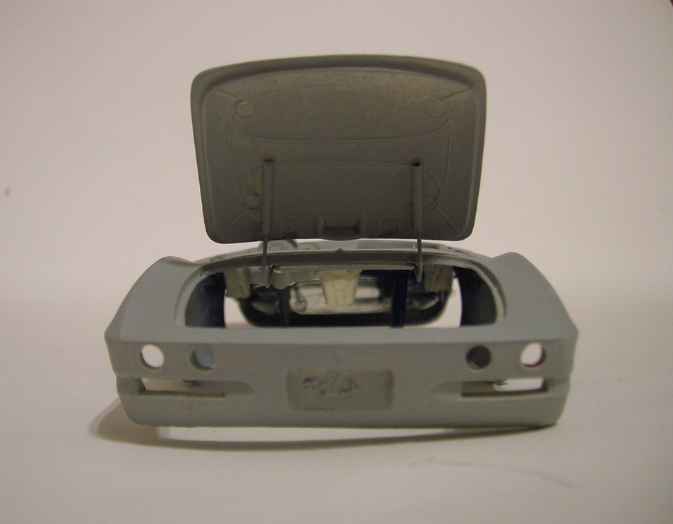

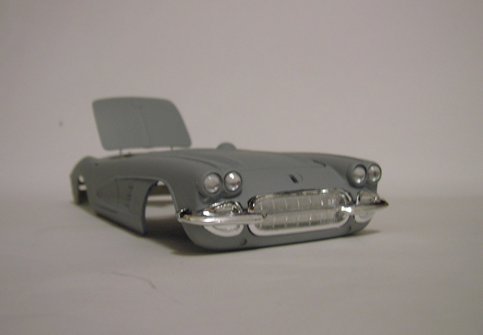

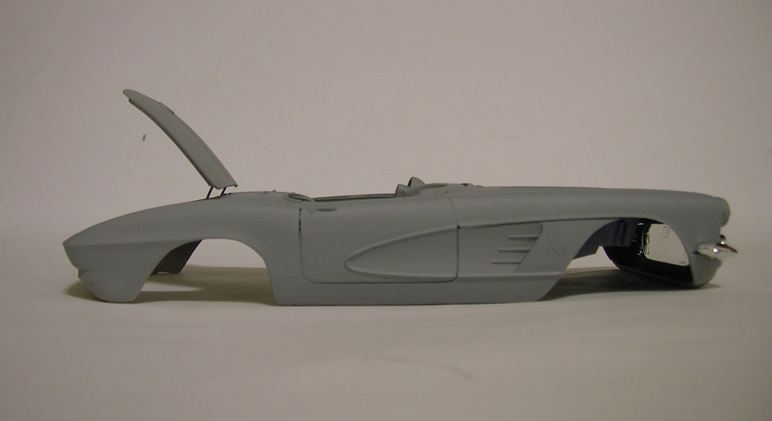

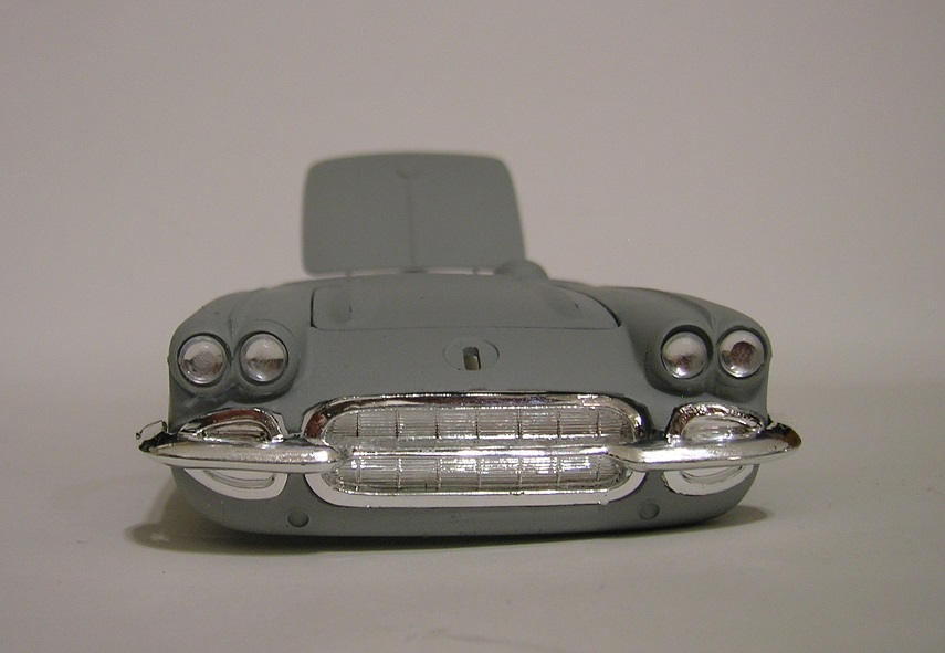

Finally got some primer on this '61 Corvette. Just a couple places to touch up the body work. These head lights are more to size than the later issues of the AMT '62 Corvette. The headlights are some that I bought from JoAnn Fabrics and shaped and polished smooth.

Dave, the thought crossed me, should the conversion have started with the new Revell '62 Corvette and the old Revell '59/'60 Corvette? If I made another, I would proceed that way. But I will finish this one since it is about done.
Ironically, the Revell '60 Corvette is really a '59, despite what the bumper says. AMT called their '60 a '59, so Revell called their '59 a '60. Confusing as that is, the Skip's Fiesta is the '80s issue of the '70s version I used. The seat patterns are the key. But I swapped the '59 seats for the '62 seats and it looks like you did too Dave. I fit the whole AMT '62 bumper, grille and valance to the Revell. I found it to be easier with less filing. I had to add some Evergreen Styrene as the AMT valance was too short along the side. I find it interesting the chrome headlight bezels molded in clear plastic even with the Skip's issue. I rough sanded the whole bottom of the AMT interior tub to seat onto the Revell frame that also serves as a interior floor. It is a little bit of more filing to get the AMT interior sides/doors to fit as they were a little wide. I could only use the real portion of the rear trunk floor from the original kit trunk. My biggest challenge was the issue of the wide Revell rear axle and narrow rear wheel well of the AMT Revell combo. This is a result of Revell designing a kit to use very narrow tires. Unless you have the original Revell 1959 kit with the narrow plastic tires, you have to be creative. My solution was to narrow the axle. I made new plastic axle locators with Evergreen. If I had to do it all over again, I would have replaced the rear axle and not modify the Revell one. I used steel piano wire to hinge the trunk lid. I left the plastic Revell hood hinge as is. I was getting tired re-engineering everything.
