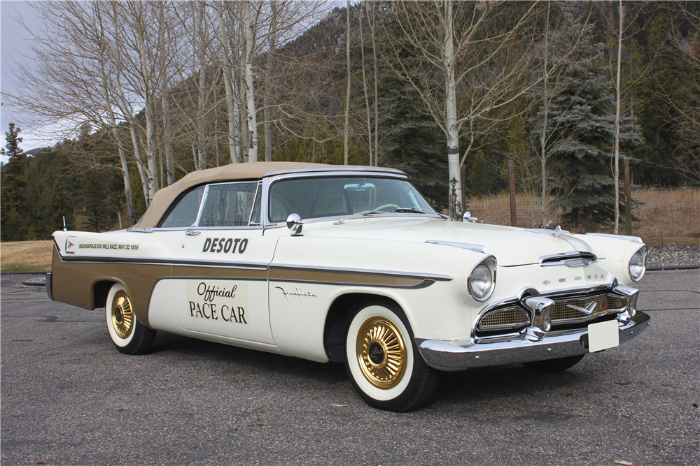

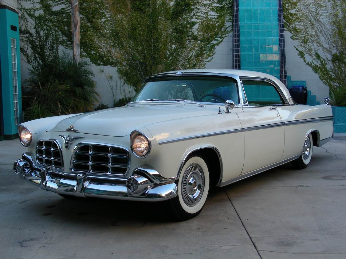

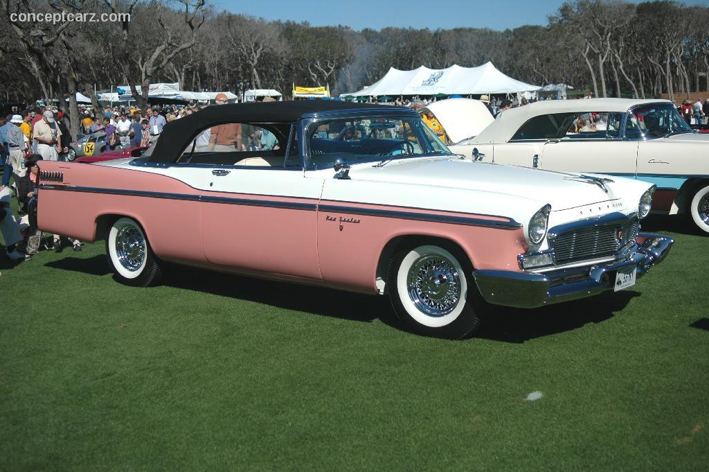

It wouldn't be too difficult of a leap for Moebius to modify the '56 Chrysler 300 tooling to do this one. Modify the body tooling, new bumpers & grille, a few added interior parts & viola! instant '56 Desoto! They could do this one & then take off the top, add a few gold plated parts & some decals, and you would have a pace car version! They're always looking for ways to stretch tooling. This seems like a no-brainer to me. Steve Then, you could take it one step further & bring us a '56 Chrysler New Yorker, & then maybe finish up with an Imperial. Lots of potential with these toolings. Steve -
