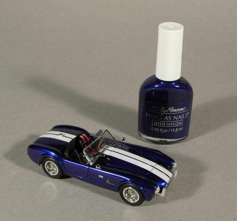

  15. While I do use an airbrush, I do not sand, polish, or wax my models. This one was painted with Tamiya Fine White primer, and few coats of nail polish. Stripes are painted using AccuPaint (model railroad paint similar to Tru-Color paint), and there are few coats of Testors Wet Look clear. All airbrushed with a Badger 200 airbrush. I have spot sanded/polished boogers on few of my models, but that is rare. Never the entire body.
