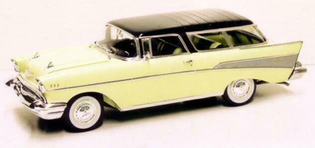

Resin bodies for the Revell 57 Nomad
SfanGoch replied to junkyardjeff's topic in General Automotive Talk (Trucks and Cars)
MCW Finishes produces a resin '57 Nomad. The only issue is that it requires the '57 Chevy Bel Air Two-Door Sedan 2'n1 (85-4251) as a donor. I can't say if it will work with the old Nomad chassis. -
Hendrix Manufacturing is defunct, Mike. Were you looking through this list Hendrix Price List or looking at Hendrix Resin Kits Gallery Steve Kohler of Star Models Has Hendrix resin products (not the complete line, though) listed in his index: Star Models Cross-reference both lists to see which are available.
