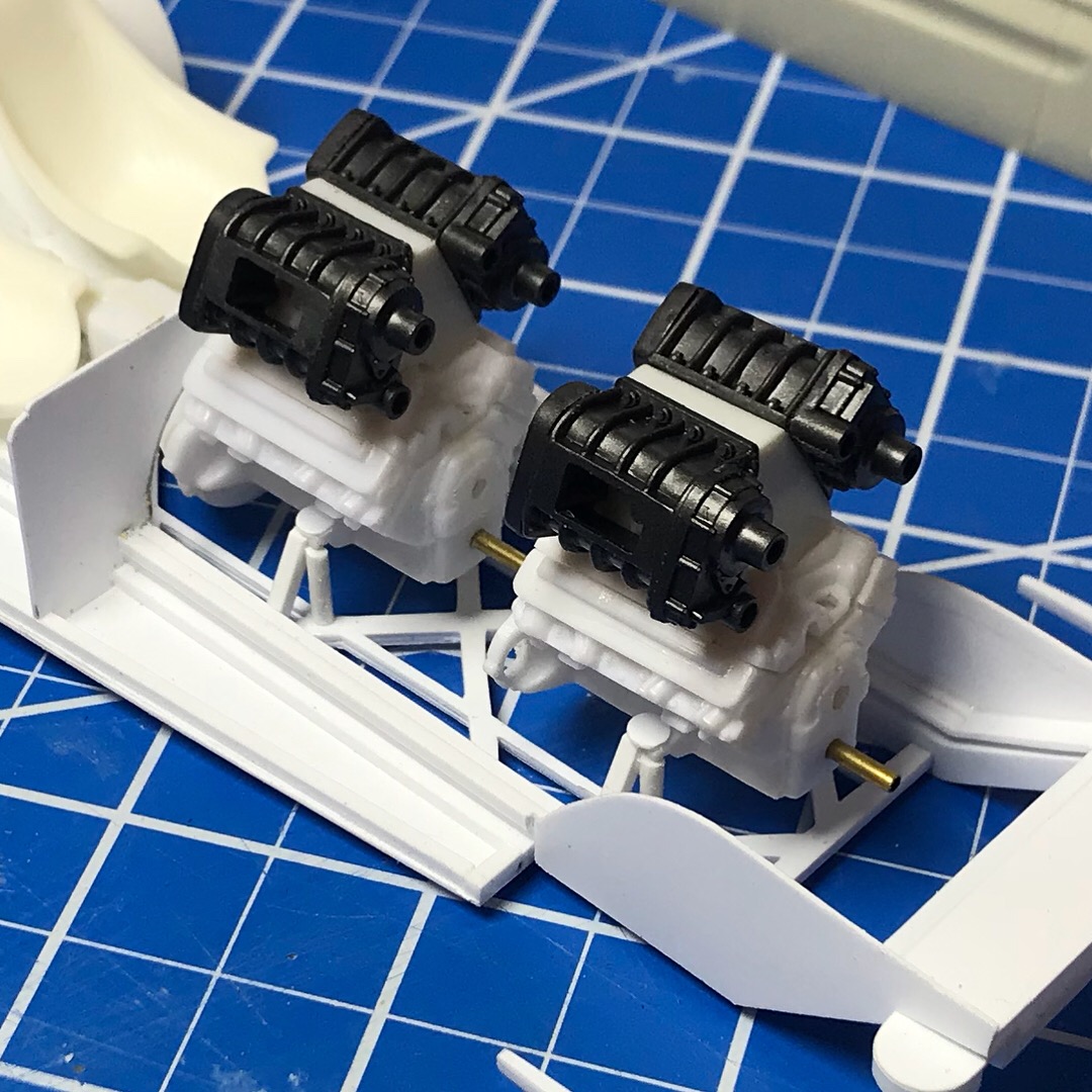

Thanks guys!!! Making little steps of progress here and there.... Thanks to Mr. Dave Battista I have all the blowers I need! Posable steering check. Grille narrowed: Starting to work out the interior tub and engine compartment panels: Exploded View and a Mockup: -

Thanks guys!!! this one is quite a large amount of fun... I was thinking about it... but im just going to have the bubble top open up instead... these blowers are going to stick way out and keep that from working. Hopefully i can get this bad boy done in time.... the interior tub is the next major hurdle. Here is a couple shots of the one double blower setup.... its going to be pretty wild.. haha.. Im using the flywheel from a scenes unlimited clutch park Ive had laying around, just to sprinkle in some extra detail. -
