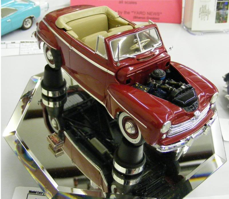

As a minor favor....I celebrated my 75th birthday last week, so I don't exactly consider myself a "kid" or, in your terms, an "expert"; perhaps a better choice of words might be in order. All that aside, avail yourself of the prep and polishing advice listed above. Rattle cans work! This is a 48 Ford done with Ace Hardware enamel right out of the can

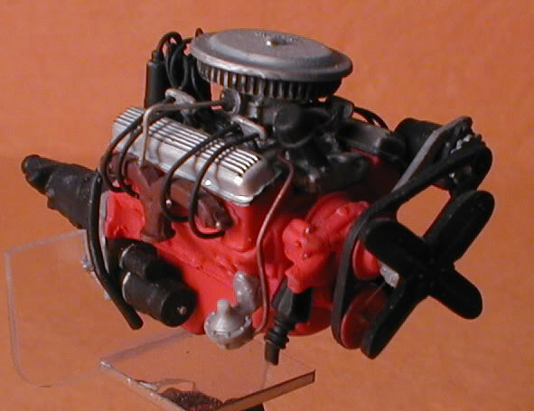

I lean towards a flat or satin finish. This is the 327 I had in my daily driver '55 2-dr post way back when. -

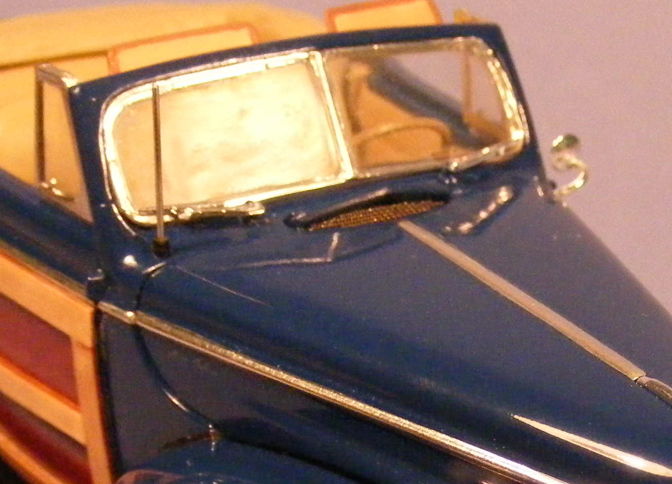

Soak the thread in white glue, such as Elmer's. Apply to the desired area...if you smudge a little, clean up with windex after the glue dries. I'd suggest a clear coat afterwards...Elmer's on a painted surface is not a very strong glue bond. I used black thread to install the fender welting (front and rear) on this '40 Ford convert. -

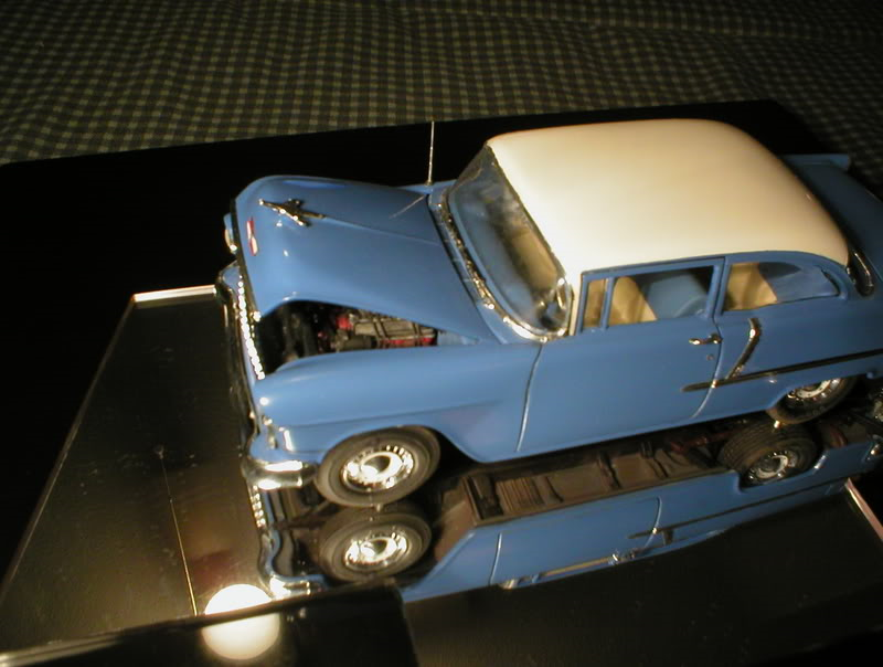

Nice work on that '55...reminds me of the days when I had a 2-dr post 55 Chevy with a 327 in it. It appears the blue Maverick is right-hand steering. -
