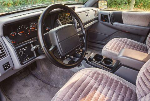

I have two questions related to my 1/20 Lindberg ZJ project, one of the wheels and the other is the decals for the badging. The wheel is probably a bigger issue since the kit wheels look nothing like the wheels my ZJ had. The first pic is what mine had on it while the second is the wheel design that came with both the glue and snap kits (as well as the XJ Cherokee I used to own, oddly enough). I’m thinking that I may be able to use my Cricut machine to cut out the shapes out of sheet styrene and stack them to make that design turn either make all 4 that way or make 1 and cast it in Alumilite to get the 4 I would need. The other problem is badging, the Limited’s had their Jeep, Grand Cherokee, and 4x4 badges gold plated instead of chromed and since these kits were only sold the Limited, that’s the only type of decal that was in the kits. I’d there a way to use a program like the Testors decal maker to take a scan or pic of these decals then change them over to a more silver finish? The rest of the decals aren’t a problem as I intend to paint the strips in the bumpers and side molding black vs gold and only really need the instrument cluster decal for the interior out of the rest of those. IIRC, mine also has a red and white or silver pin stripes running just below the upper character line instead of the two parallel gold stripes, but I may be able to use gel pens for those. Any suggestions on the above would be appreciated!
Ok, finished off the interior, all in Testors semigloss black enamel. I may take some Valero semigloss varnish to use on the areas that would be grey plastics to give them a little gloss, but that will be for another day. I’m very grateful to have access to images on the internet for these since I have no idea where the pictures I took of mine went over the last 24 years……..
