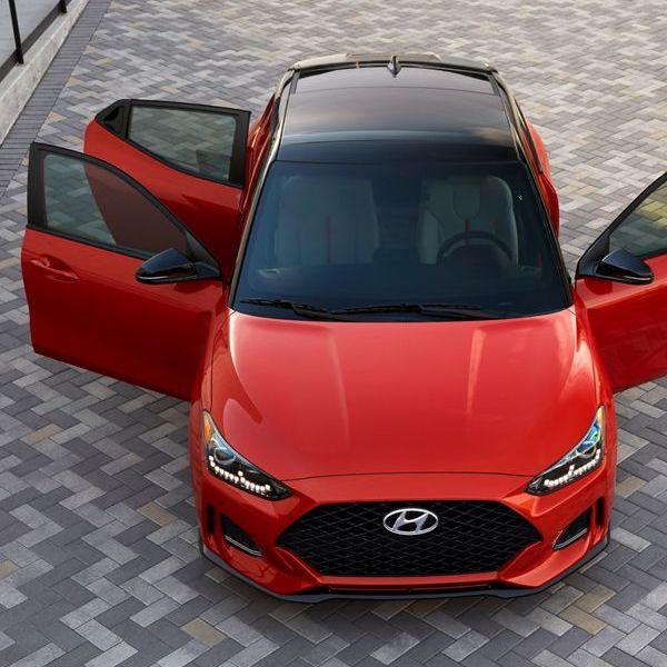

Now that I think of it, would it be a 4dr like a sedan or a wagon, or a 3dr like a Hyundai Veloster?! The Pacers had the longer single door on the passenger side to get back seat passengers to get in and out of the car on the curb side, where the Veloster has 2 passenger side doors and 1 driver side! -
