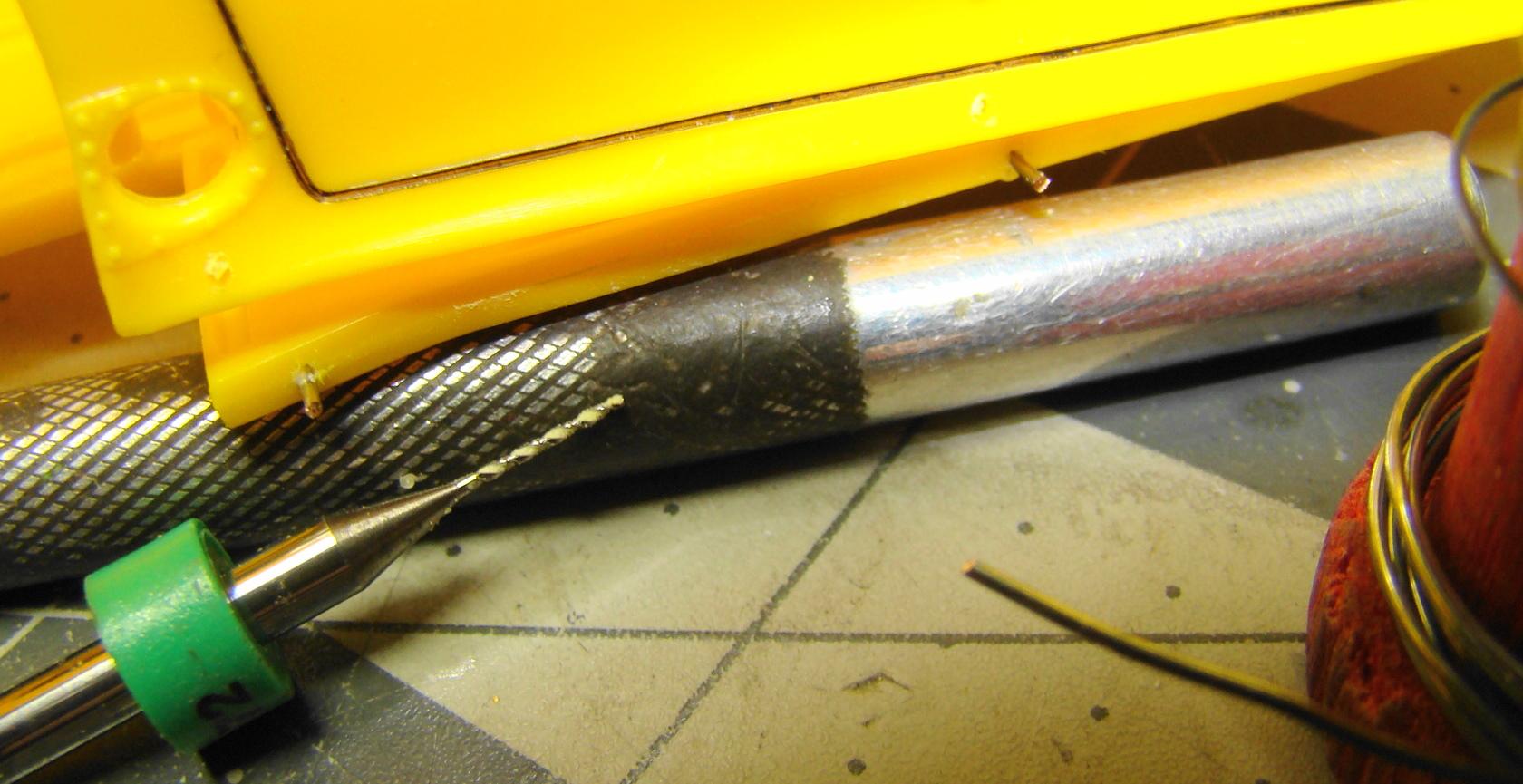

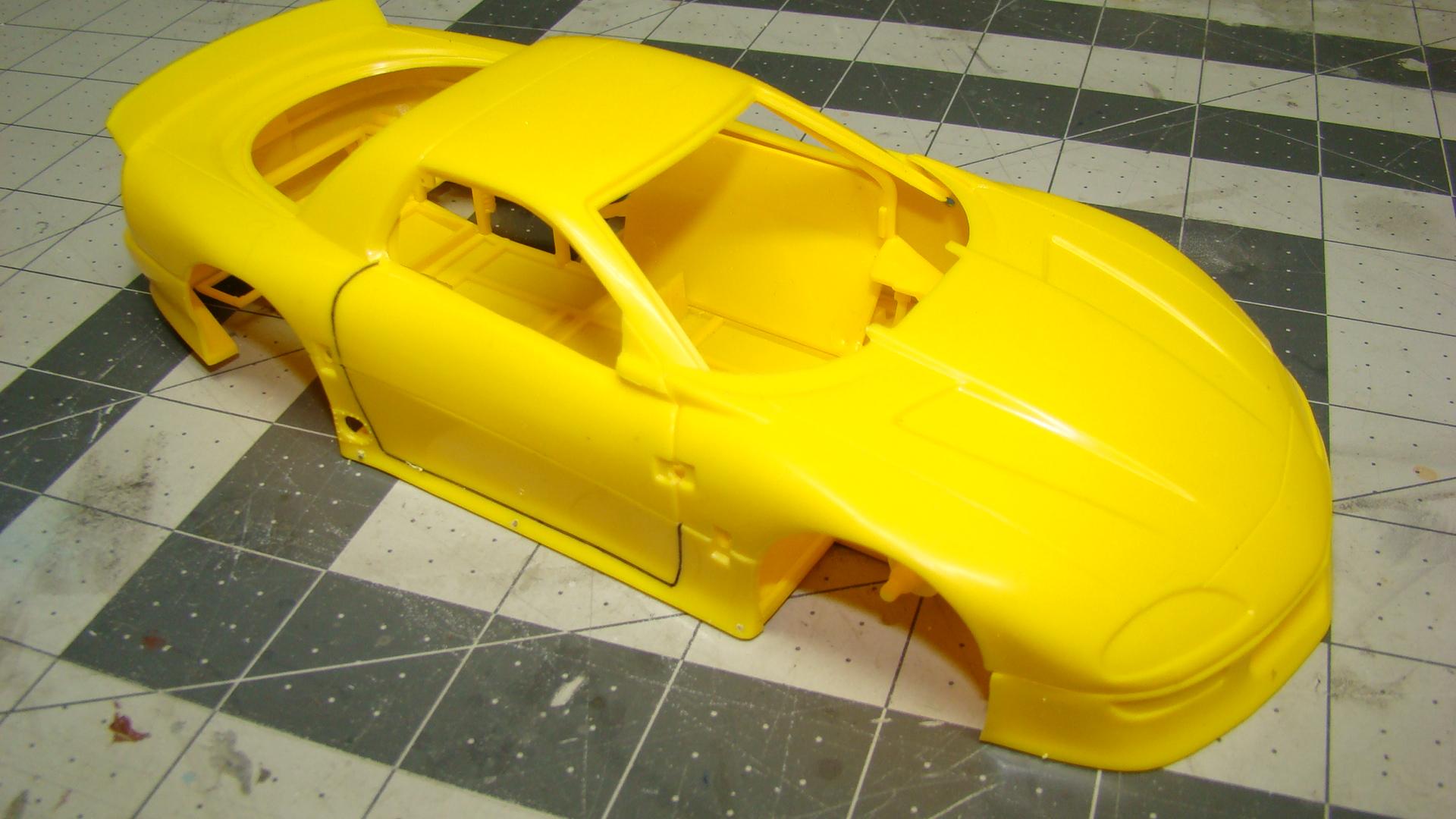

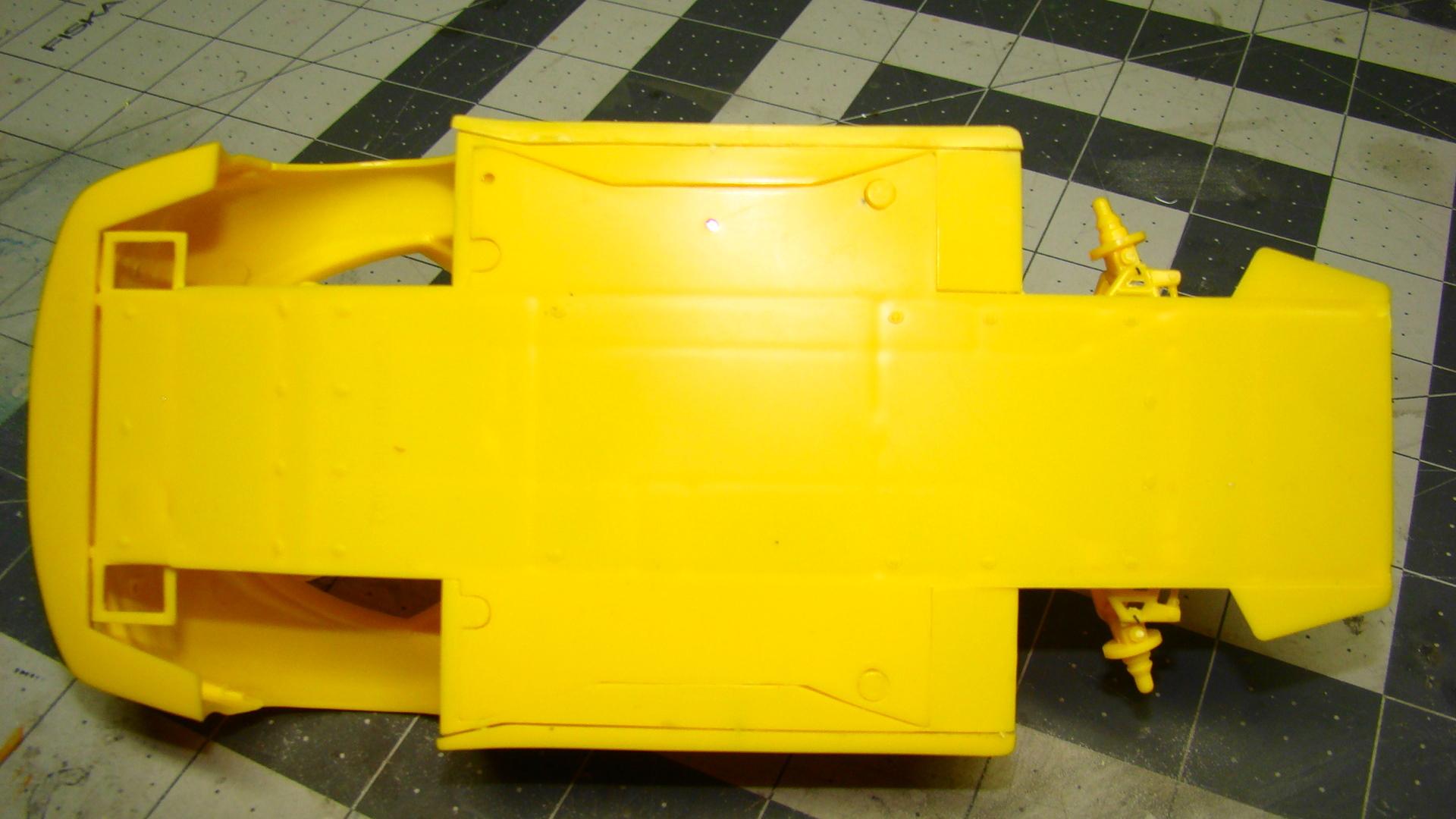

  1. Anton, dug out my Rain-X Camaro and took some pictures. Didn't realize how much I had done on this. Chassis and basic roll bars were glued together. this allows the body pieces to be fitted. On this build I used a .70mm drill and some .65mm wire. The wires were glued into the chassis and cut shorter. The body on mine fits very well and i will be able to slip it over these pins. On the Sunoco I used a .45mm wire which was softer and easier to bend. I converted my sizes to metric for you. I captioned the pictures for you to get a better idea. Overall body fit on mine was excellent. Youi can barely see the three small holes I drilled. Close up of the pins inserted and the drill and wire i used. Body sits just above the chassis. This part of the body will be covered in black decals and these holes will not show. And it will make the assembly much better as i will not have to glue the body on. Bottom veiw of my chassis with the side plates glued on and body slipped over the pins. Also note the steering...also drilled and pinned. Hope all this helps. You are an excellent modeler. I am sure you can get your existing body to fit.
