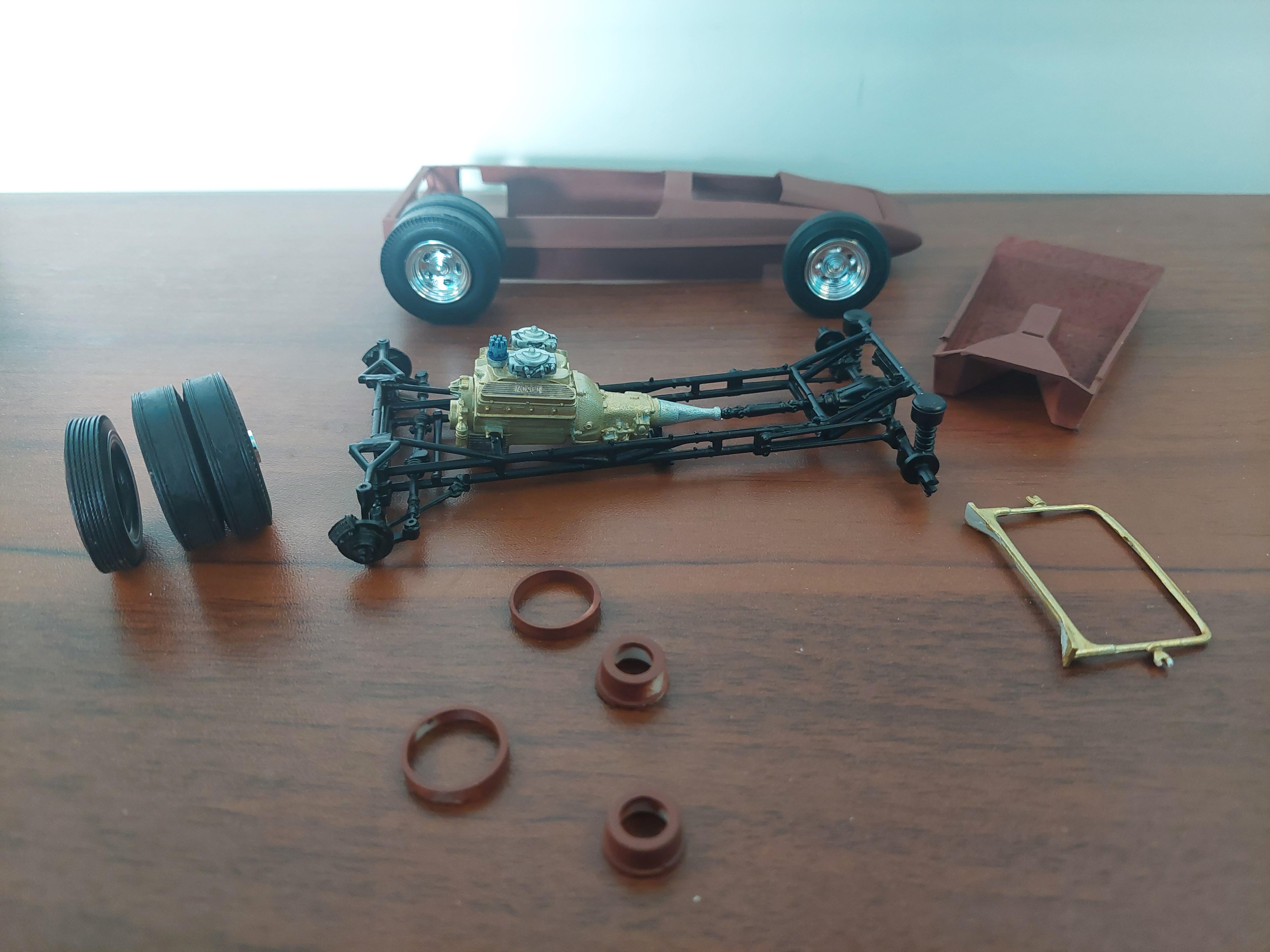

Pretty much every old show rod I've pulled apart was an ordeal, this one was no different. It was almost beyond saving as all the bright parts were full of glue also. Being its one of the rarer show rods I soaked the entire model in Castrol super clean and in these pictures is what I have to work with. The chassis looks to be tough area. The body can be repaired and it will still be some sort of show rod, but its not going to be the PaddyWagon.

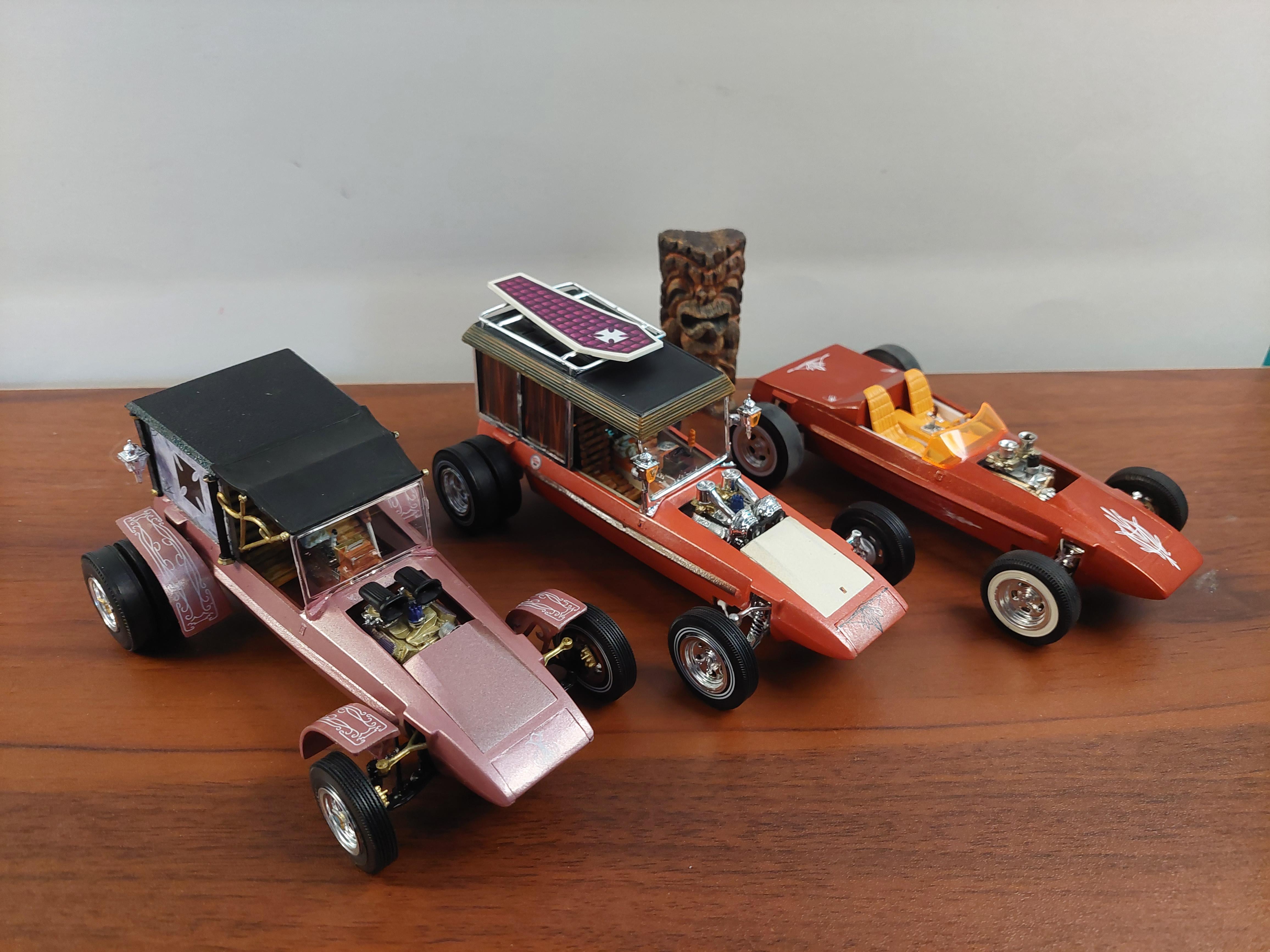

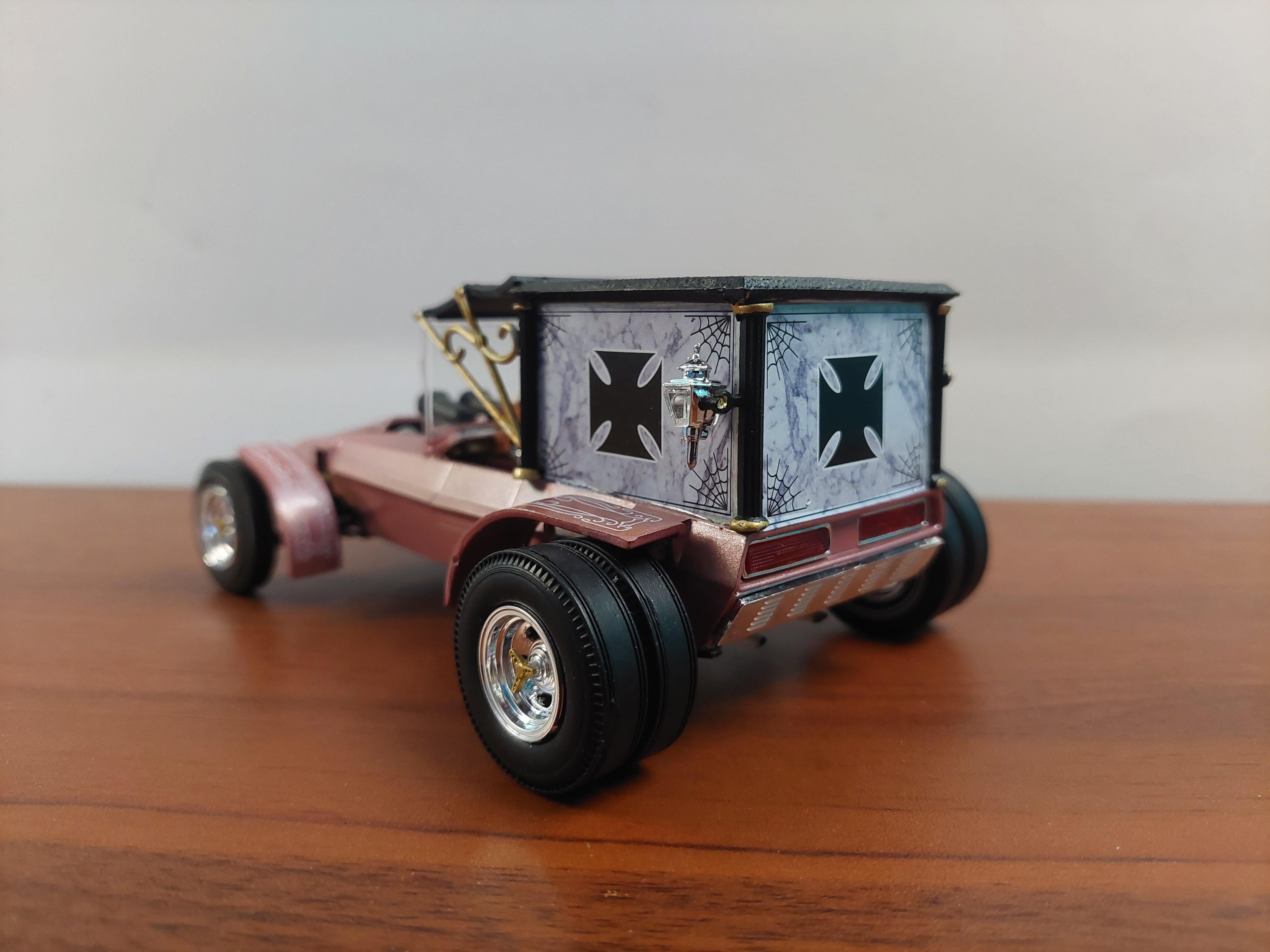

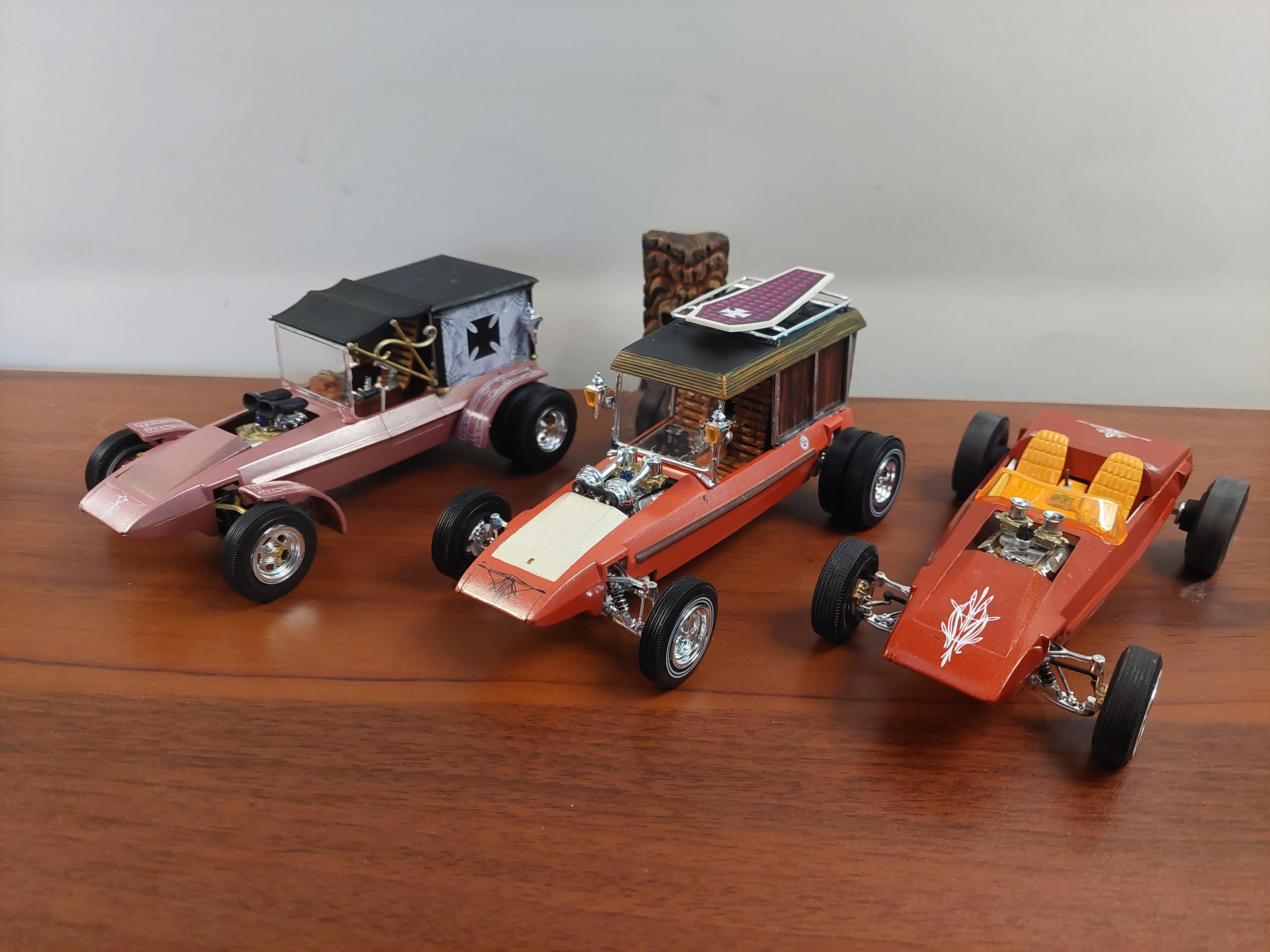

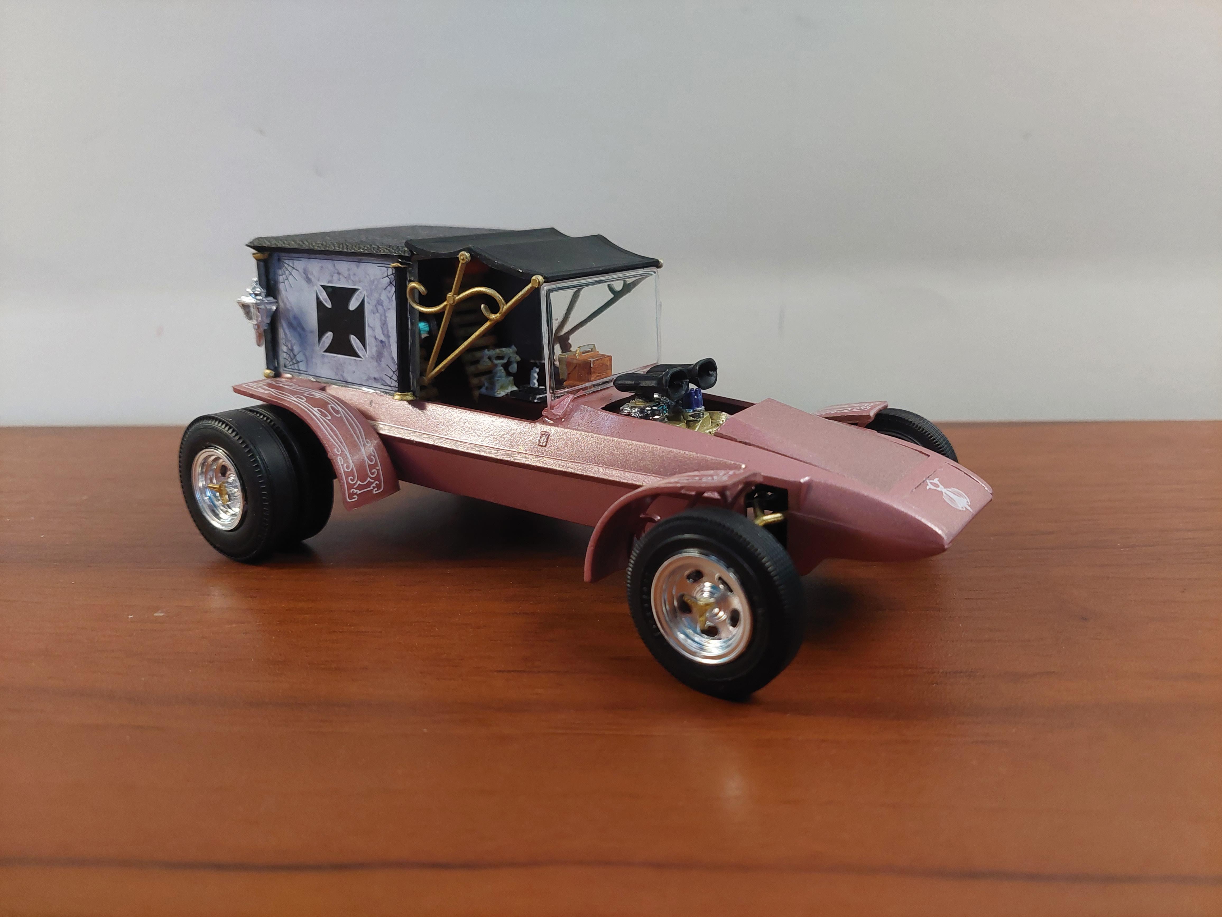

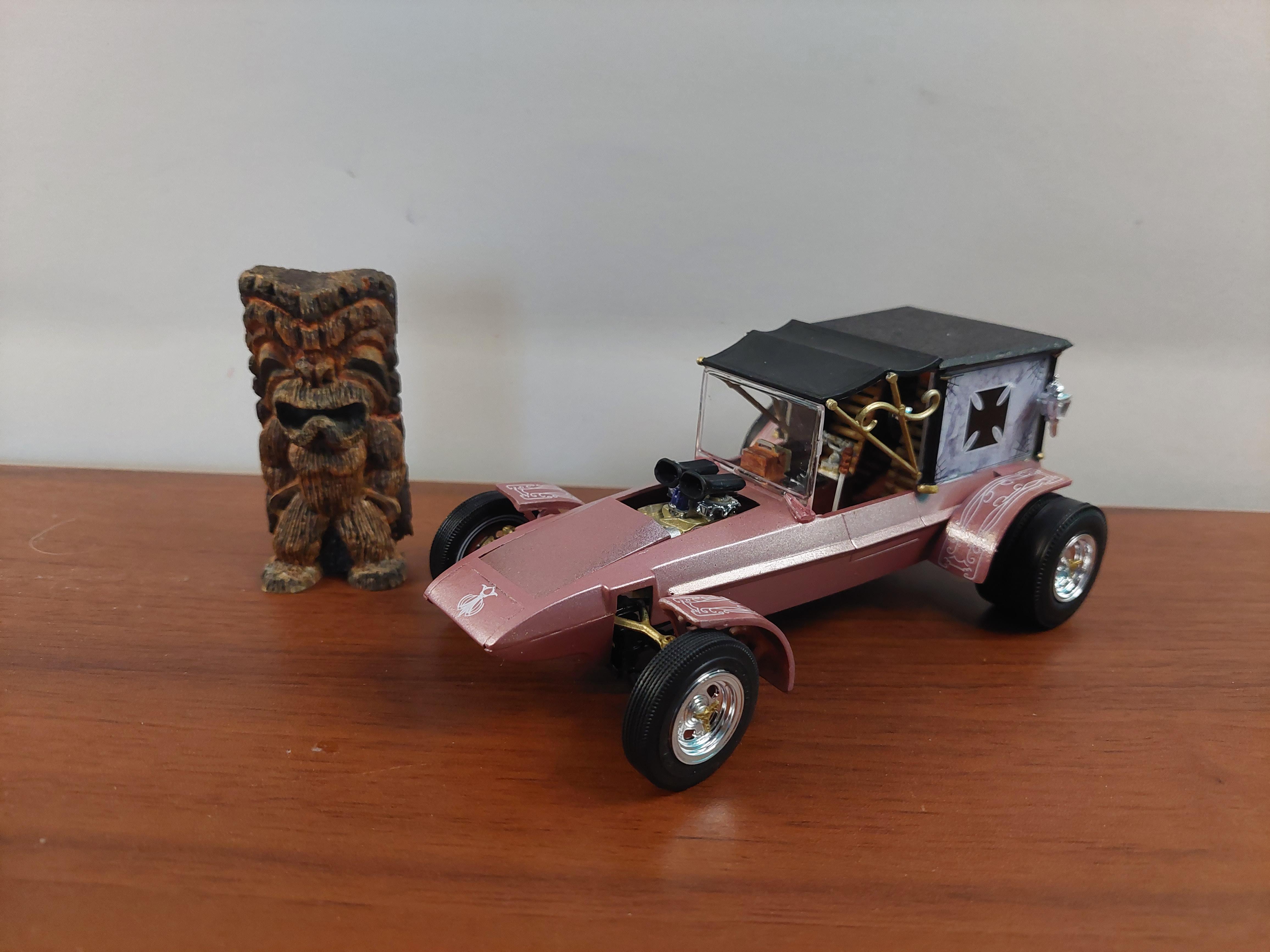

Completed the 3rd build from the SurfWoody kit "The Surf Hearse". I think this kit looks better without fenders. SurfWoody SurfHearse SurfRoadster Tough trio to build
Only progress is paint, but they say 3rd times a charm and as much as I like the SurfWoody kit Im glad the 3rd one is the last one. This version will have fenders.

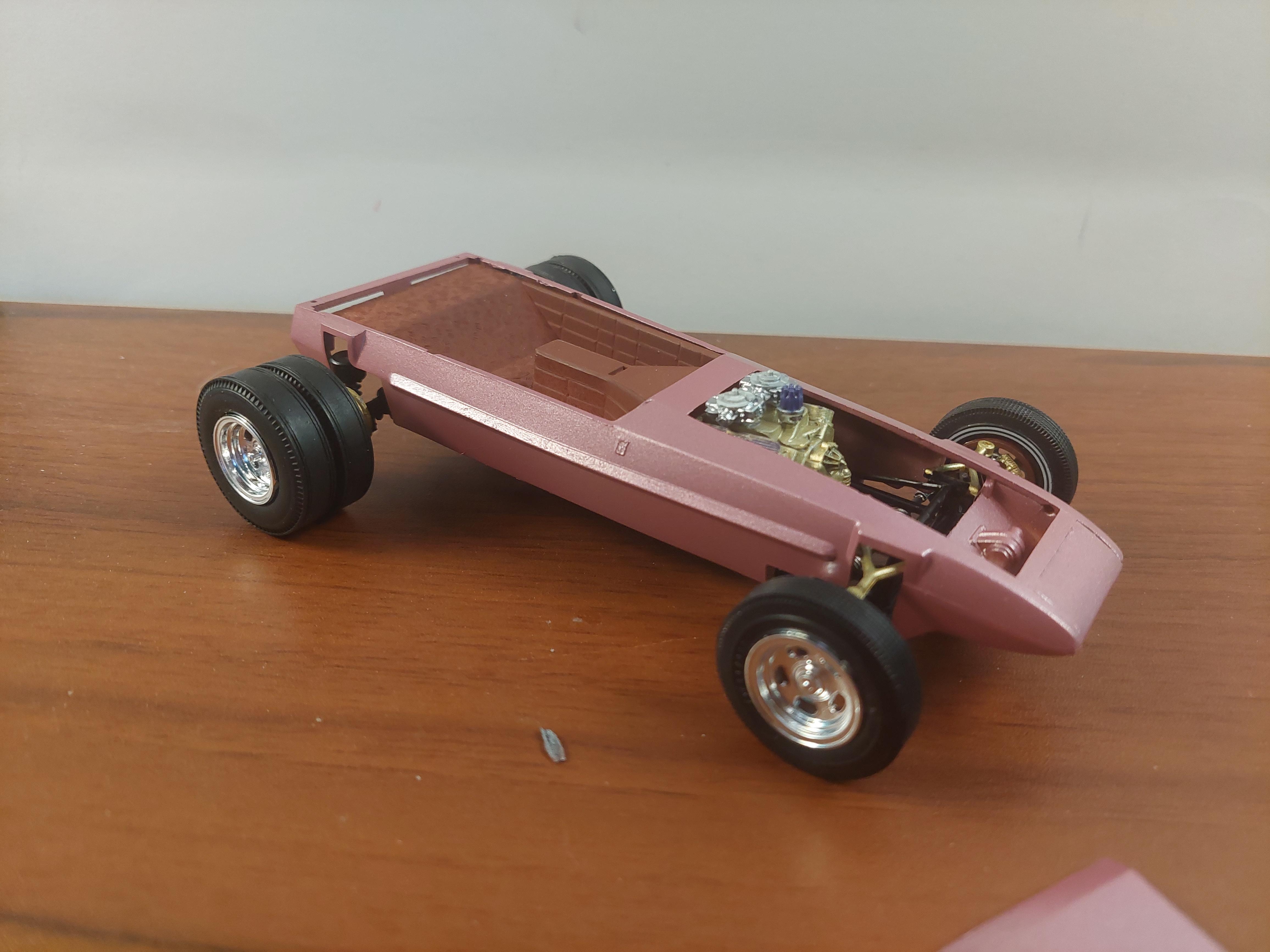

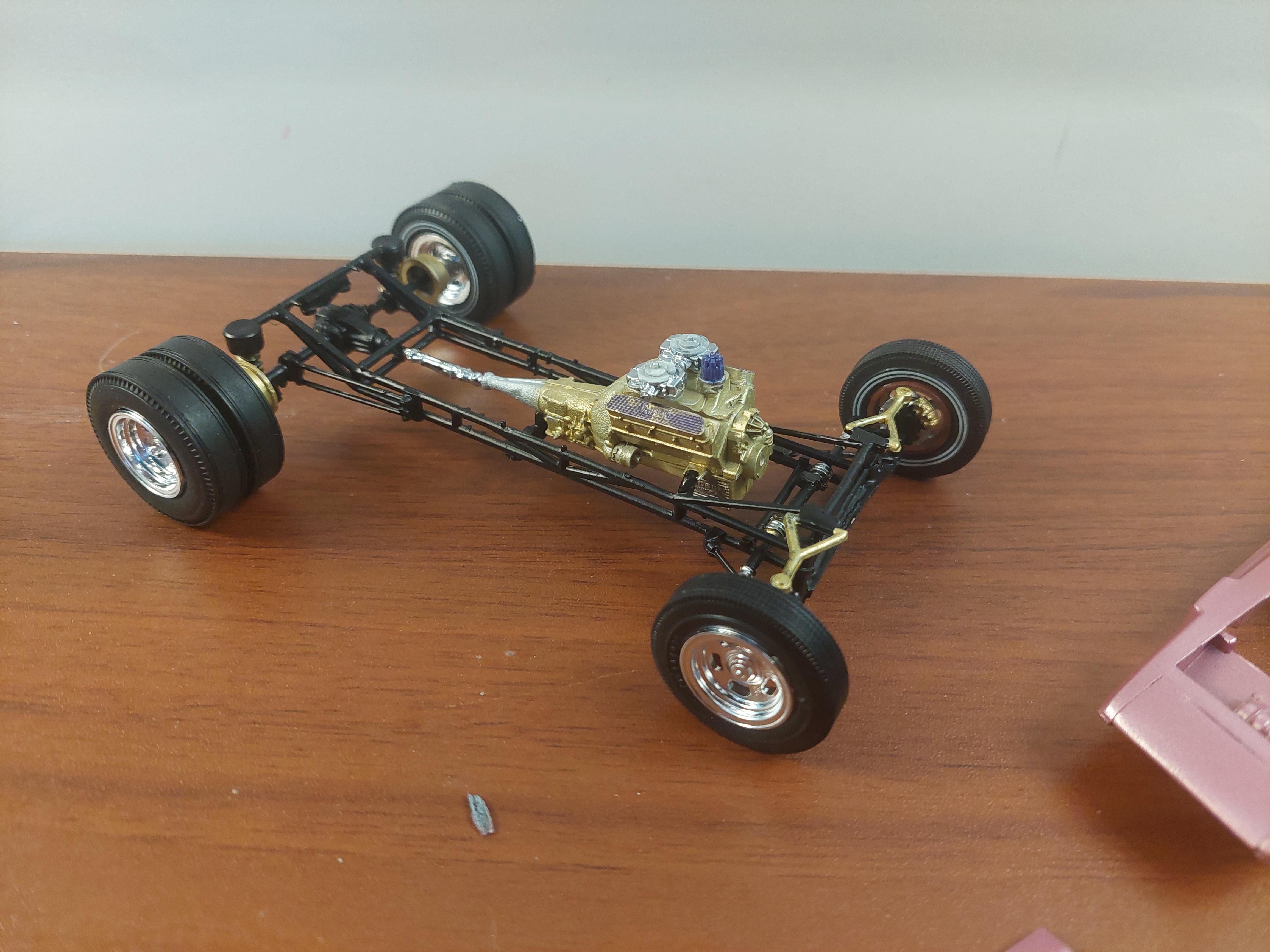

After building the Roadster and Surf Woody versions, I said never again. But then I built the Silhouette and after that nightmare I figure building the Surf Hearse may not be all that bad. First thing was to remove 80% of the chrome to paint and detail the chassis black and gold. By removing all that chrome that finicky chassis went together a little better and a little more solid. Body color will be purple and black and gold.
MThings I changed: The interior floor needed to be cut out as it had 2 humps for the bucket seats. Added an older seat , harness and rollbar. Front axle blocks to raise up the front to even, it hung really low in front . Lop off running boards. Engine was left out of box except for the big intake scoop, I used 2 velocity cones. Front tires along with wheels were changed along with rear slicks. Grille is from the AMT 53 as is the bumper. Paint is silver fade into light red and cut up Silhouette decals and part box.
