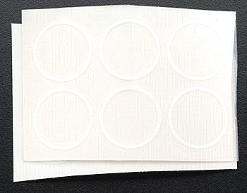

  13. I think model round up sells decals for tires but think there just good year and maybe eagle. I have some of these whitewalls wide vinyl transfers for tires too. Everyone else has great suggestions.
