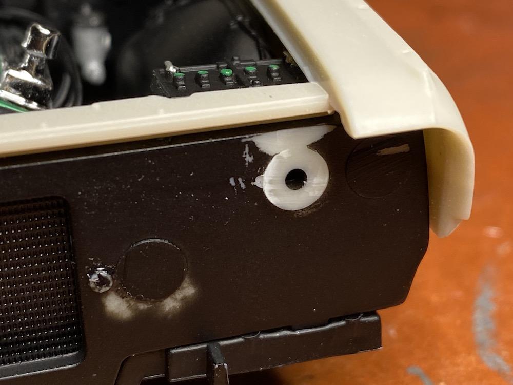

  12. David and Bob, you're so right about the radiator support/grille interference. When I said the front bumper fit well, that was before I had the body on the chassis! Here's some pics detailing what's needed to remedy the situation. Dremel off those cylindrical bosses on the radiator support and carve/sand them flush. There are pins on the grille/bumper assembly that are supposed to fit in these, but it was impossible to get it to work as designed. Then, slice off those pins and carve away on the back side of the grilles. Most material needs to come off the outboard ends, near the inner headlight buckets. You have to take quite a bit off! Rear bumper fits very nice with pins into the body. Too bad the sprue attaches to the highly visible top side of the bumper... ?

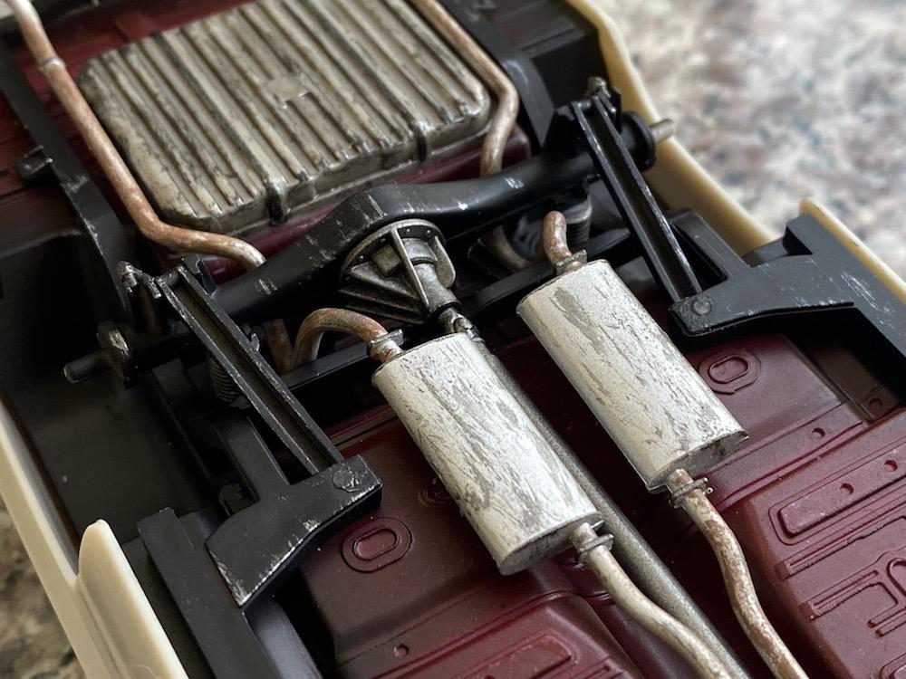

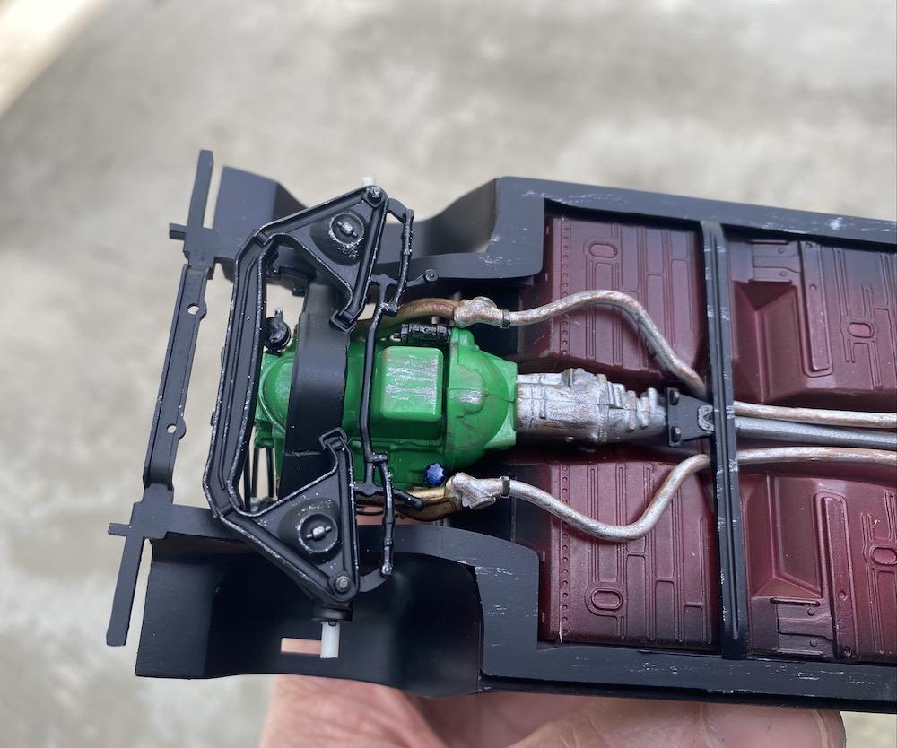

  16. Chassis is done! it went together pretty quick, as I prepped/painted most parts during breaks in putting the interior together. I like how it turned out overall, but gas tank is too heavy handed with the weathering. I think I need to paint it a darker shade initially and then I don't have to "dirty it up" as much to make it look right. Exhaust was the most fiddly part, as usual. Instructions said to glue the frame to the pan, then glue in the engine, and then fit exhaust. I didn't realize that exhaust went underneath the transmission crossmember, and it was an extremely tight fit to cram it through there, given the bulky section that mates up with the exhaust manifold. In the first shot, you can see the body tabs in the front wheel wells that help line everything up...very slick.

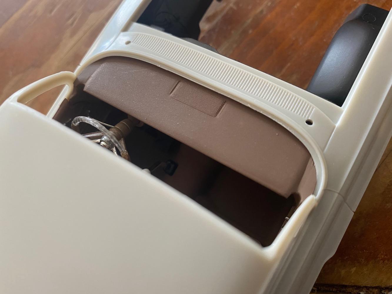

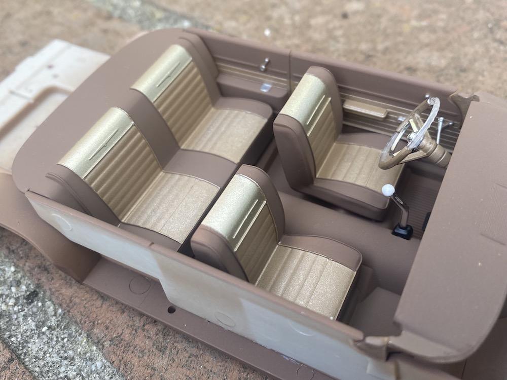

  19. Thank you, Bill! That means a lot coming from a true master like you. Your Green Hornet build is incredible in all aspects. Roll-up windows? Killer! I have your site on my Favorites list now. I do have the benefit of being retired, so when I sit down at the hobby table, I lose all track of time and get more accomplished than I expected to. I know I have to stop and eat when the hypoglycemia kicks in, and my hands shake enough that I can't do detail painting! So I test-fit the bodyshell, and you're right about not seeing the pedals really well, so that is some comfort. I'm really impressed with the fit of the interior to the beltline of the greenhouse...a benefit of gluing the glass in from the outside. I really like this Moebius kit for the most part. You can see some very fine striations in the body panels from the mold, but these will disappear with some very light sanding and a coat of primer. Gotta love the Ventura's A-pillar.

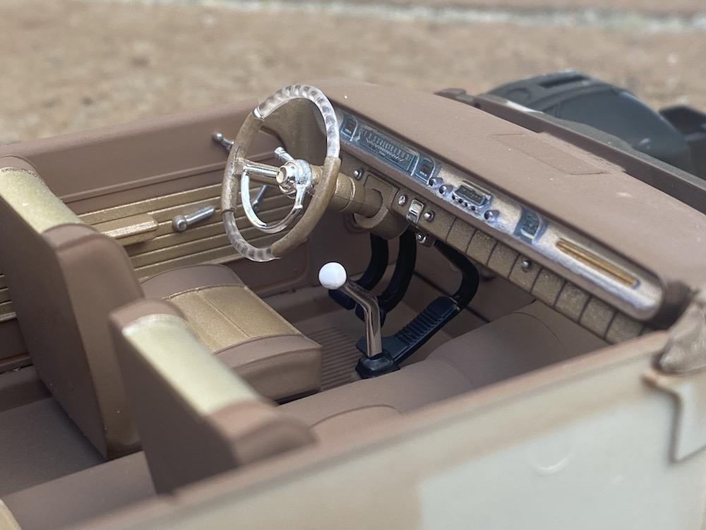

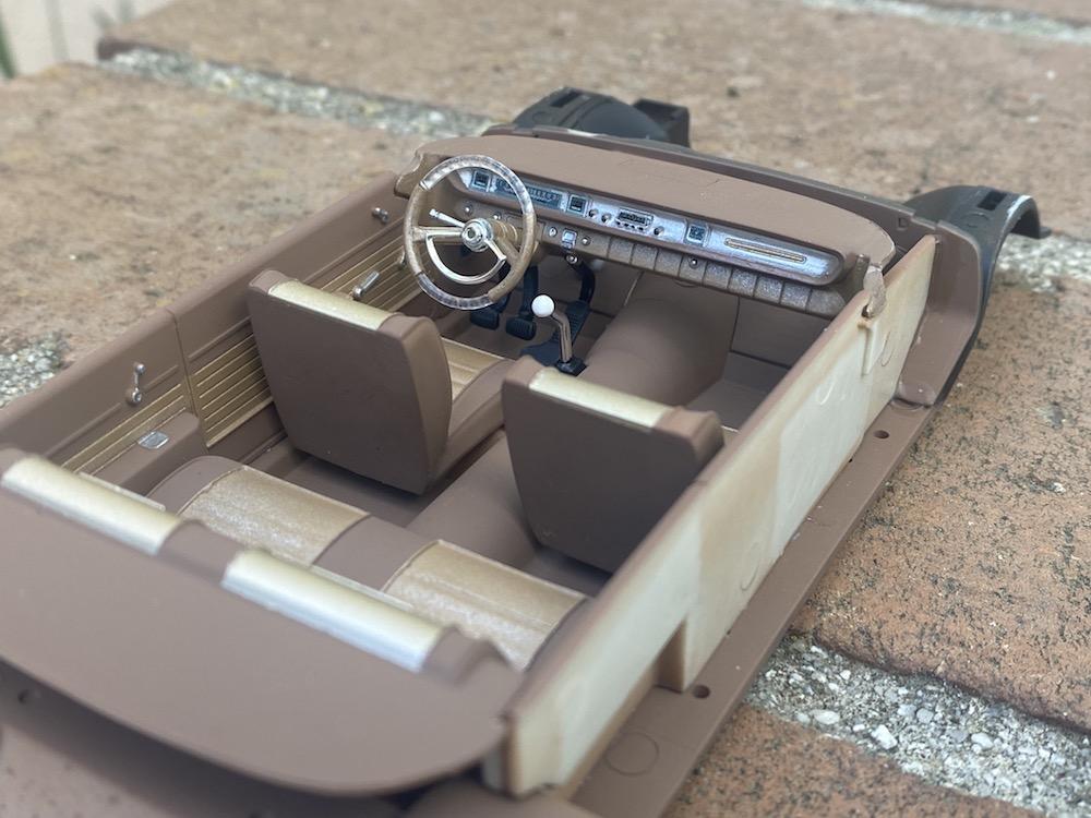

  20. Thanks, guys! Doing the dash is my favorite part of the build. Tweezers and a magnifier are your friends, for sure. I finished the door panels this morning, painted the handles, etc. and put it all together. A couple of observations: Man, the pedal cluster is way out of scale!! It also extends too far toward the seat, something that's really apparent when you assemble everything. Some of you building the kit may want to scratch-build another cluster, or modify the existing one. I think just cutting 25 percent off the bottom of the throttle pedal, and maybe heating/bending the brake and clutch backward would help. Oh well, pedals are not all that obvious when the model is completed. Also, if you anchor the steering column to the little circular recess on the firewall, the steering wheel angle is too shallow., VW Microbus-like. I moved the anchor point to just above the recess, and I think it looks better. On to the chassis!

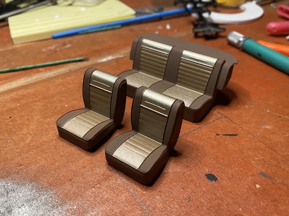

  22. Must've cleaned out the airbrush 6-7 times this afternoon, but I got the seats and dash done. I shaved the raised border on the lower seat cushions because I wanted the center section here to be all one color. Dash is tri-color too, the silver being airbrushed Testors enamel. For gauges, I left the backing on the decals, cut them out and glued them in place with canopy glue. I find it much easier to handle them with the backing still in place.
